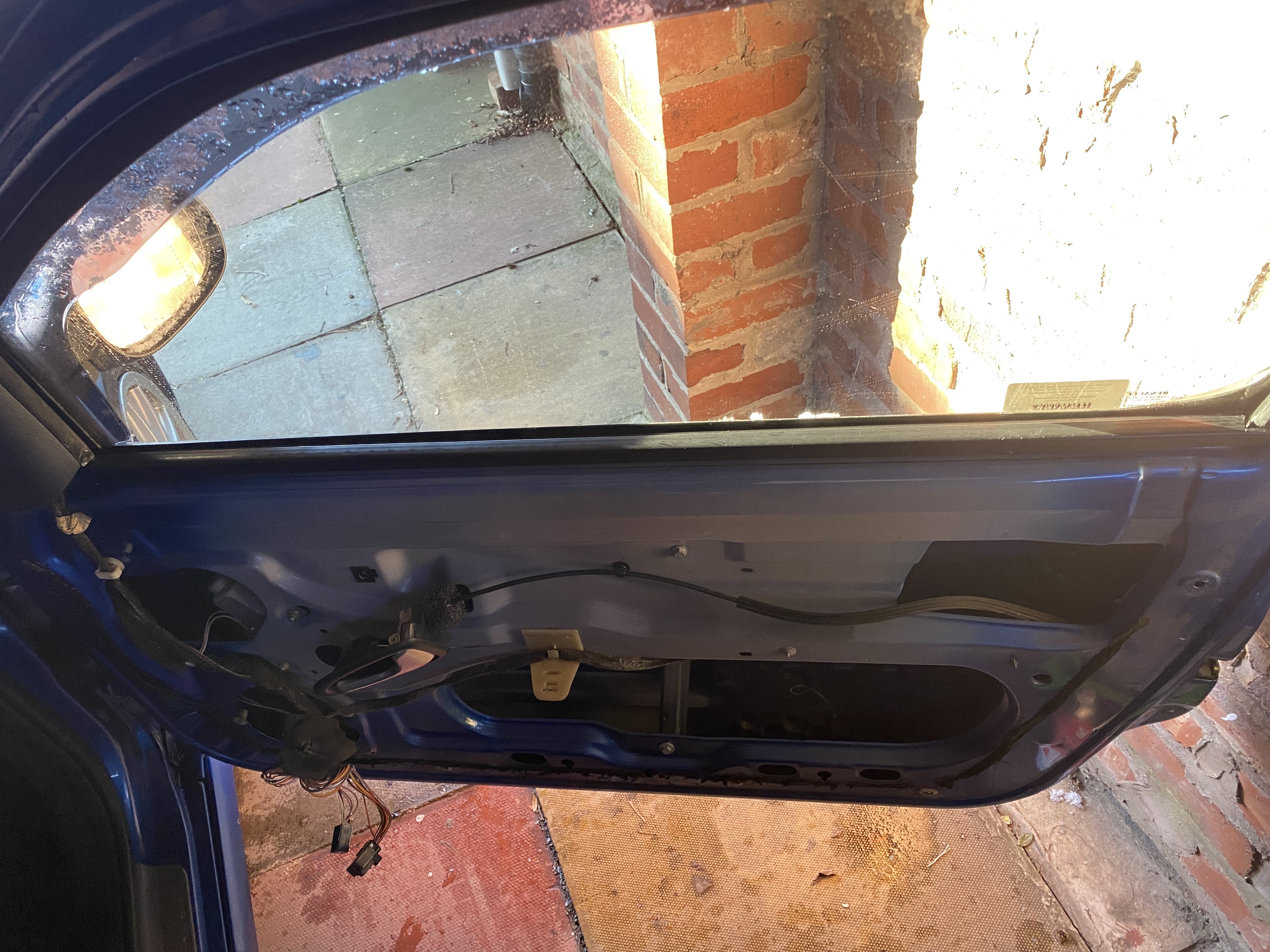

I decided to fit the door trim that got to replace the exploding one. I took the card and bits off again and had to cut the strip a little to fit. It’s not the same as the original but you wouldn’t know unless you looked at the other door. I couldn’t find another so it’s fine for now. Some of the trim is loose but I guess that’s a lot of 172’s are the same as there is nothing missing or broken. I need a fix for it and have asked in the interior thread.

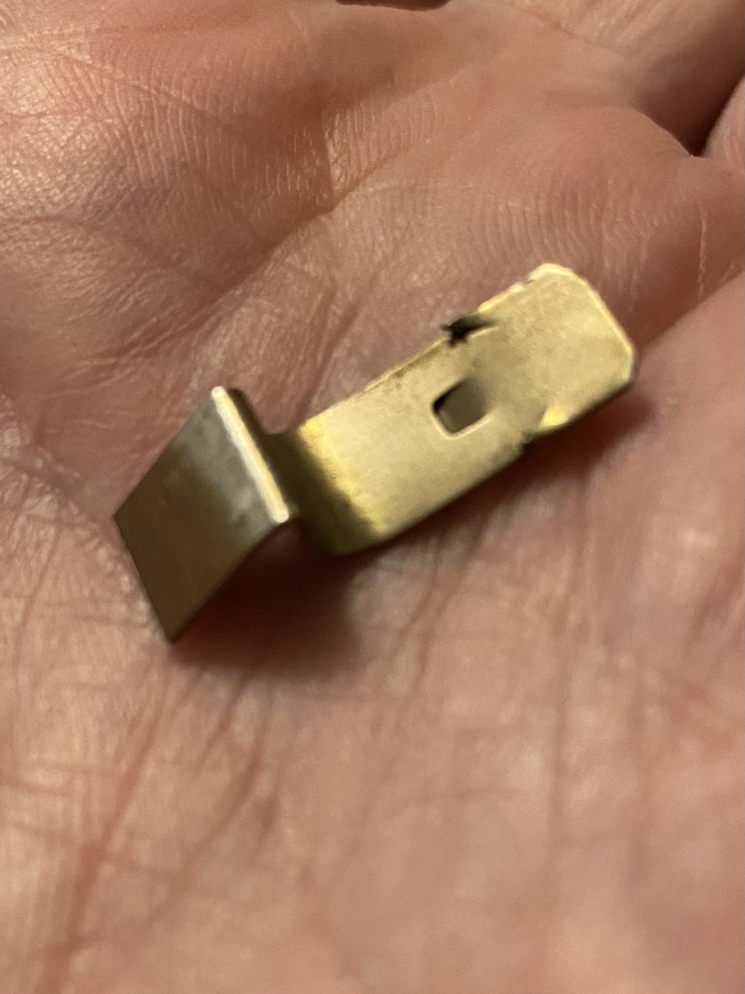

Show a photo of the inside of that bracket and the inside of the door where it fits.
I'm sure it's meant to have a little hook at the bottom but I can't remember now
This was inside the door card loose when I took it off. I’m not sure how it fits. If this is what you mean I’ll have to take a look at the other side as well as that’s not perfect but not as loose as the drivers side.

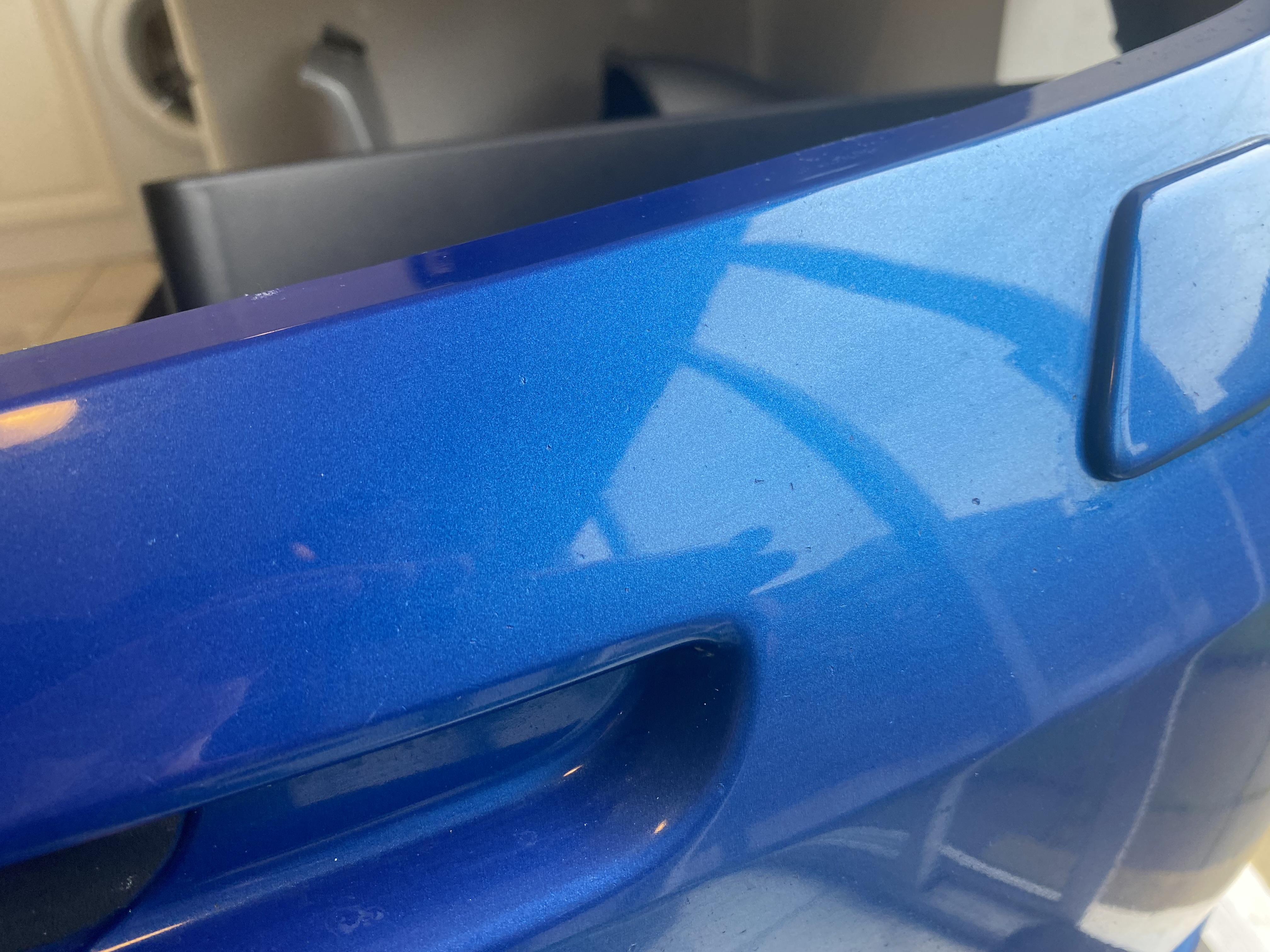

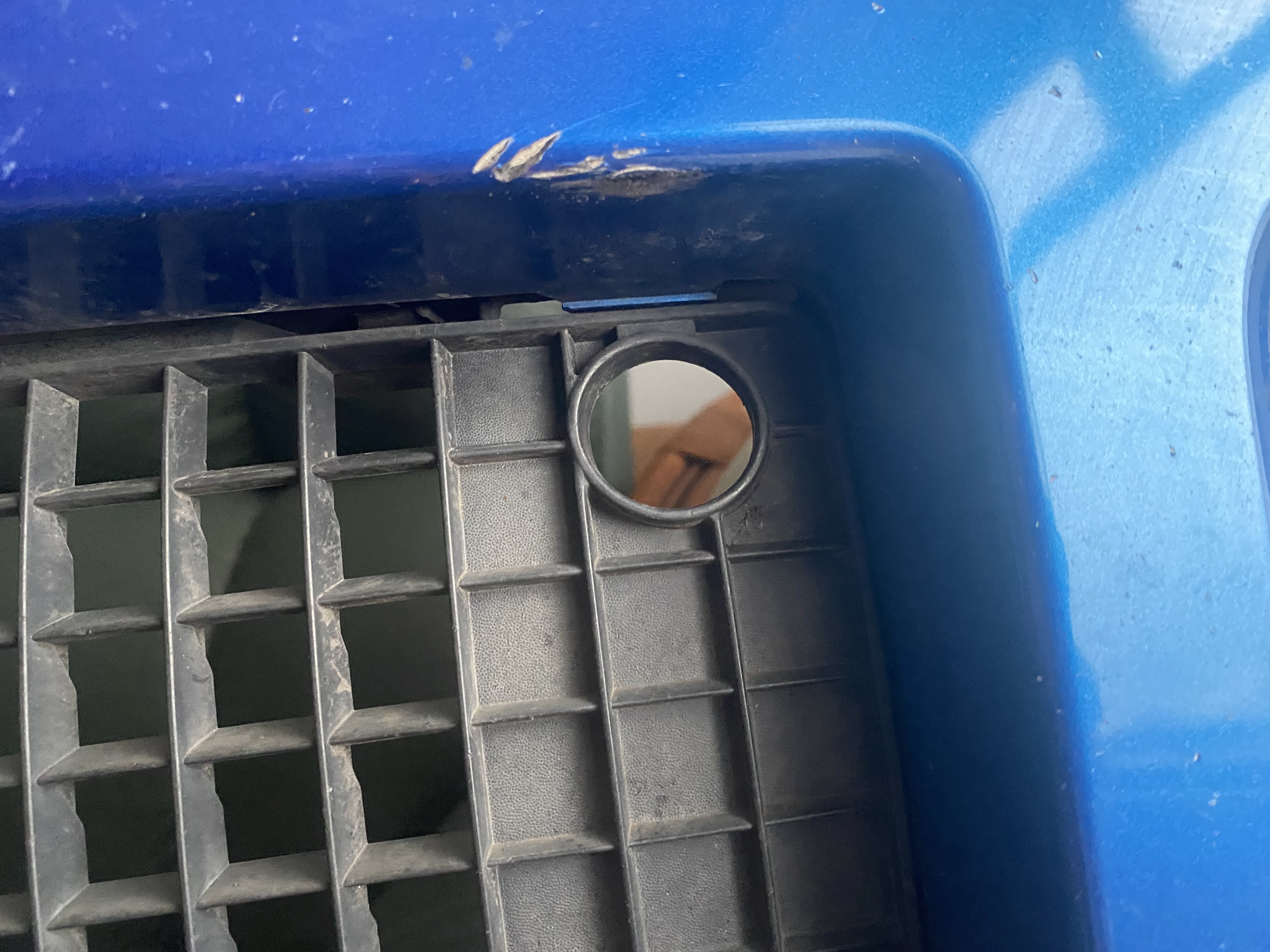

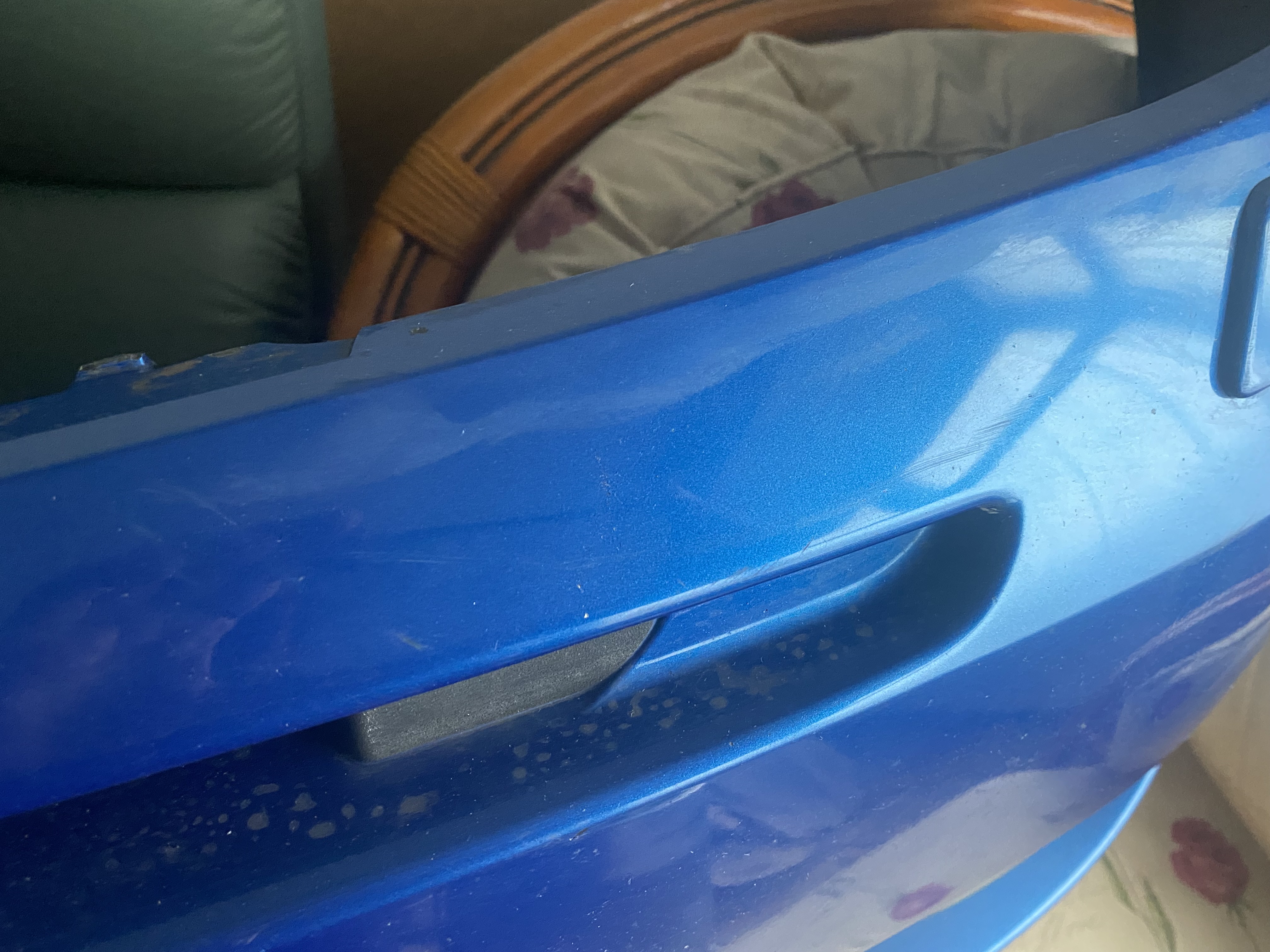

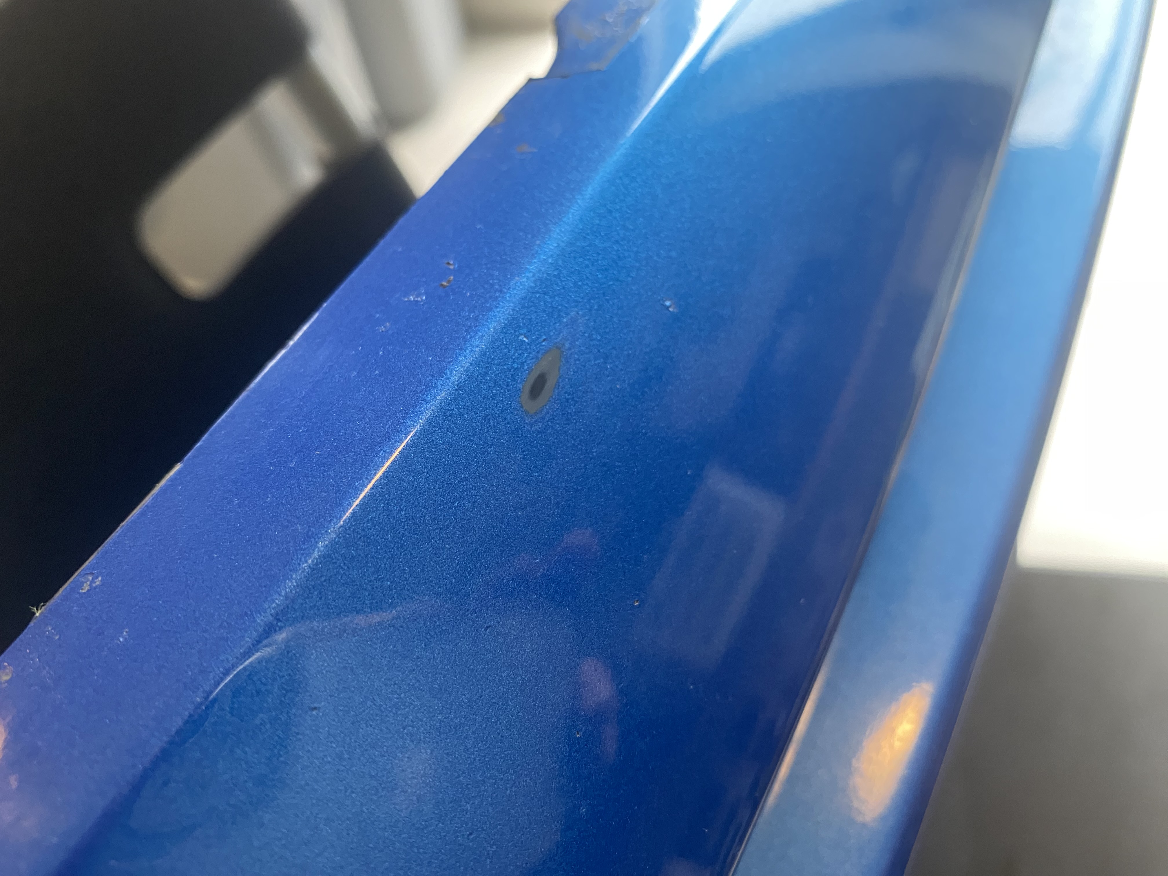

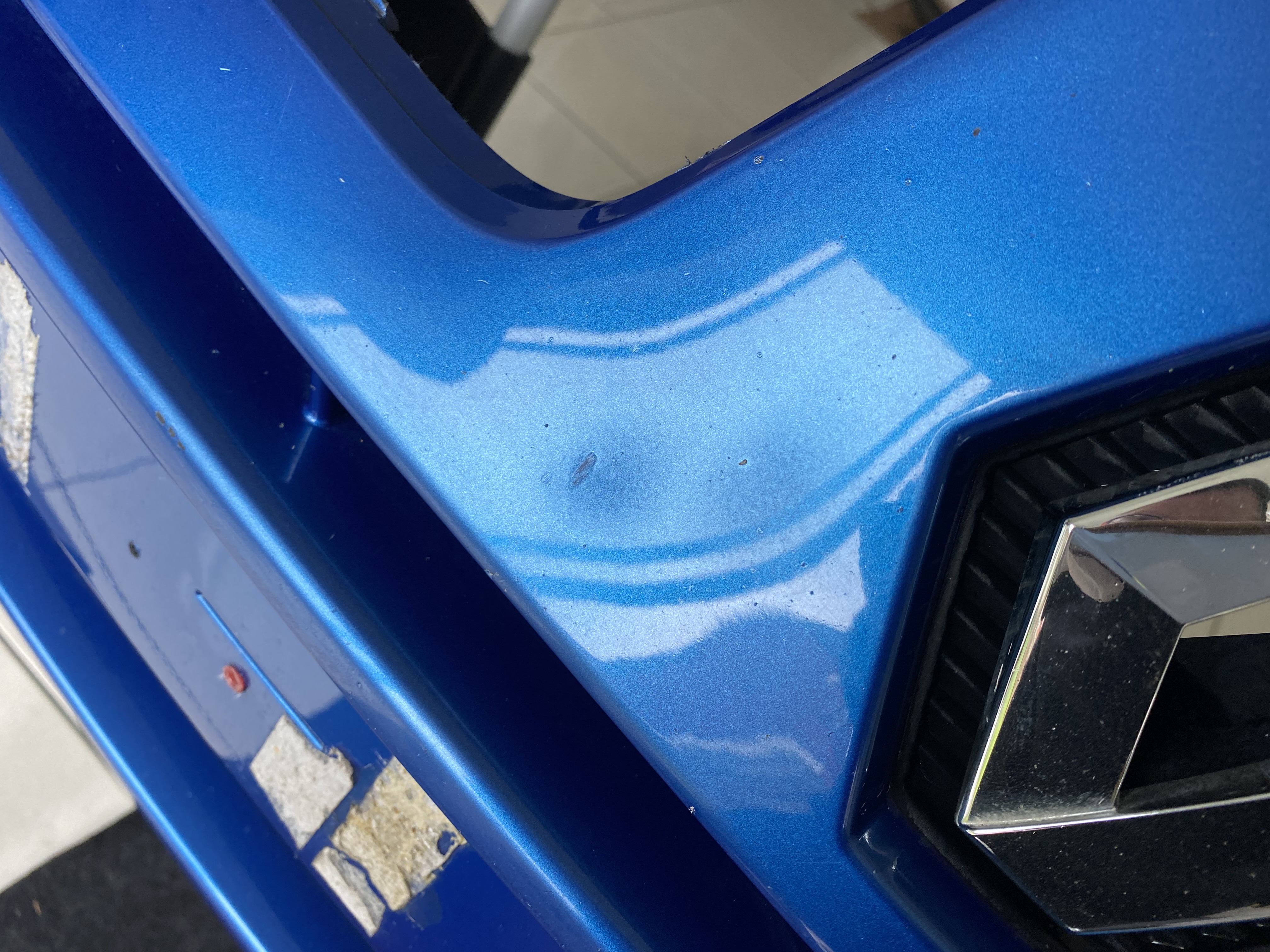

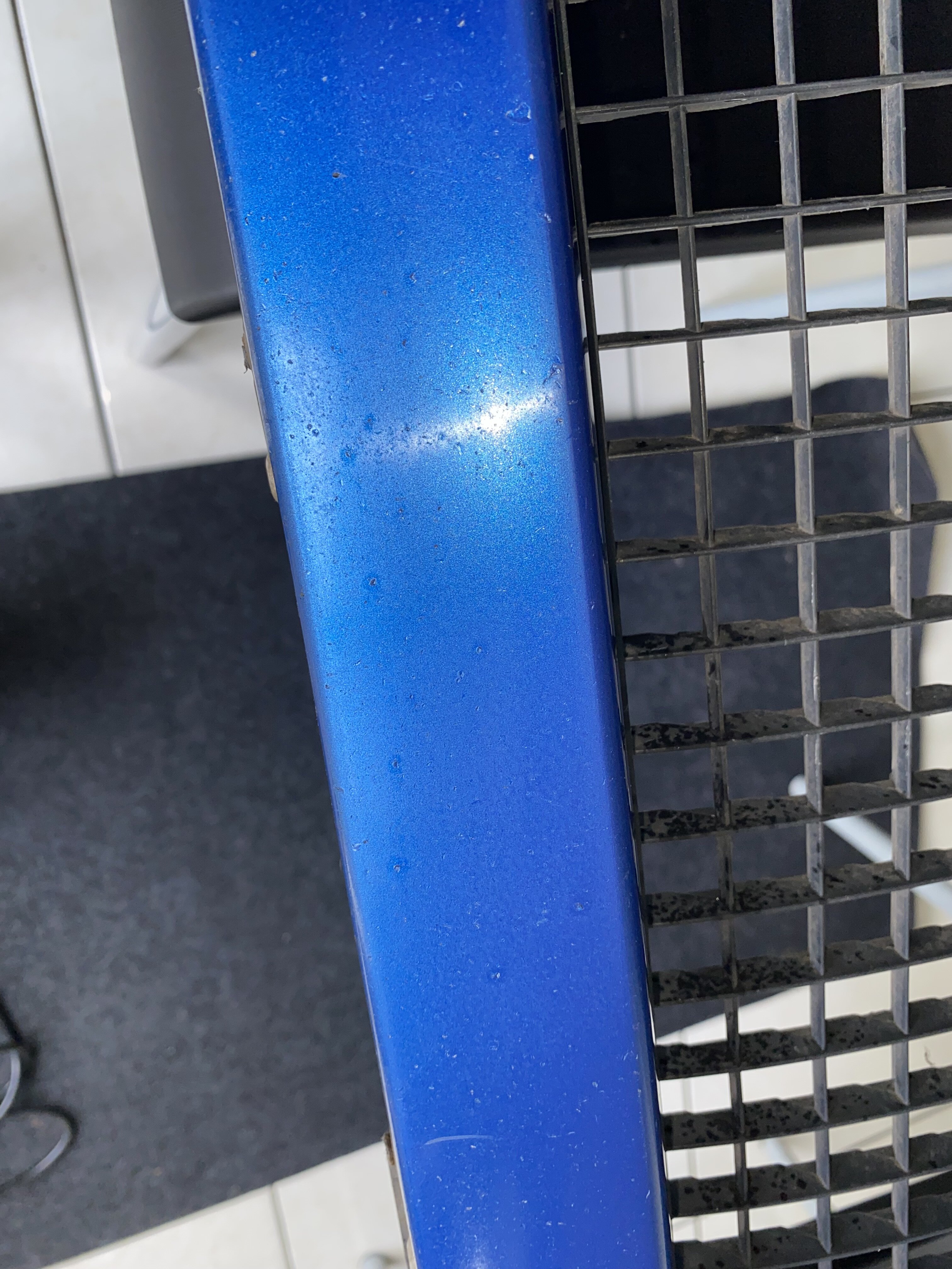

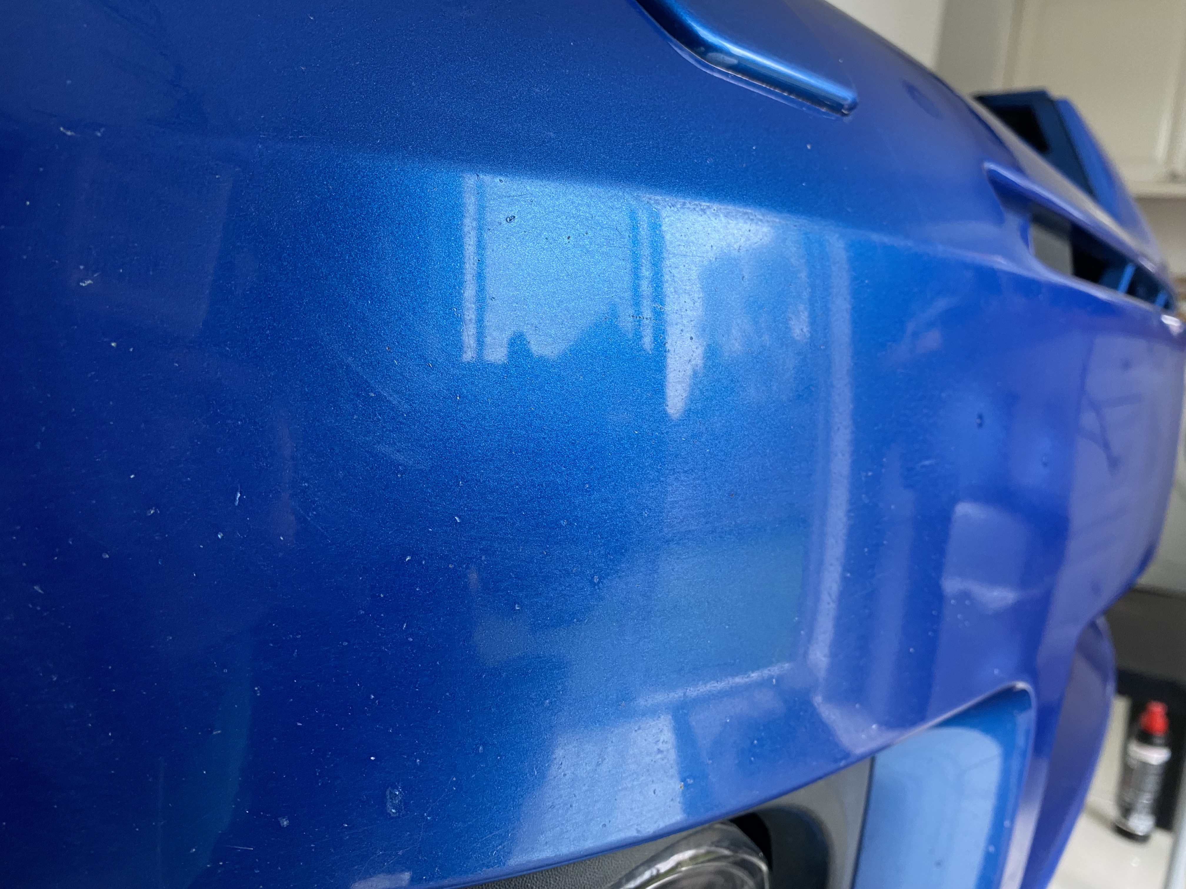

The front bumper has arrived. It’s exactly as described, but it does need a few bits repairing on it. The idea is that if it was in good condition, and it is, then this would be a sensible option to have painted at a body shop rather than my damaged one. There is of course a chance that I can polish and repair this and the paint match is good enough with my car that it won’t need to go into the body shop. Don’t forget, the paintwork is 23 years old so although it looks okay it’s not perfect. I’ll get to work over the next few days cleaning, repairing and polishing the marks in it and see how it looks. Hopefully I can fit it on Wednesday and get a better picture. All the plastic inserts on it are much better than on mine and also the attachment points for the wings are really good considering its age. Even the fog lights surrounds and fogs are in good condition compared with mine and if they work, I will leave them in.

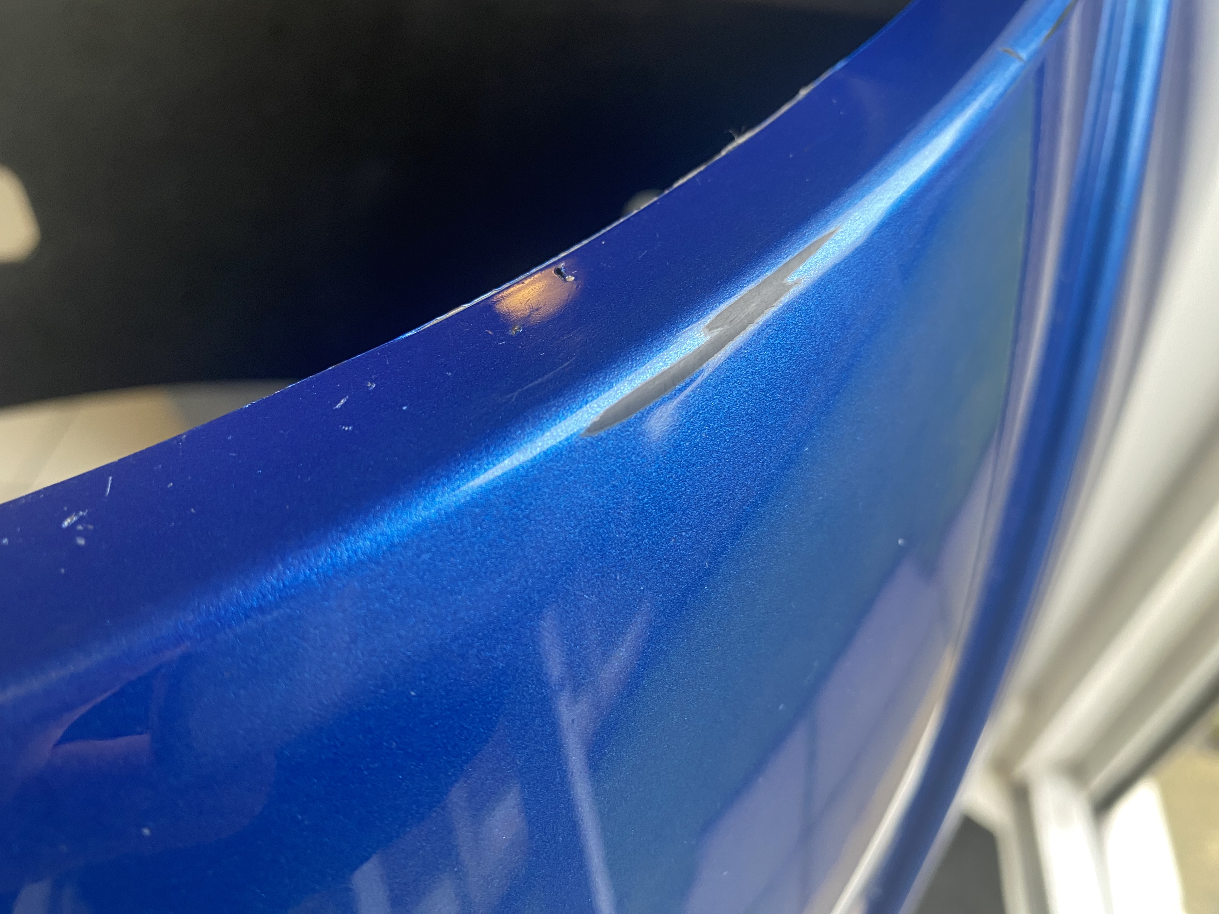

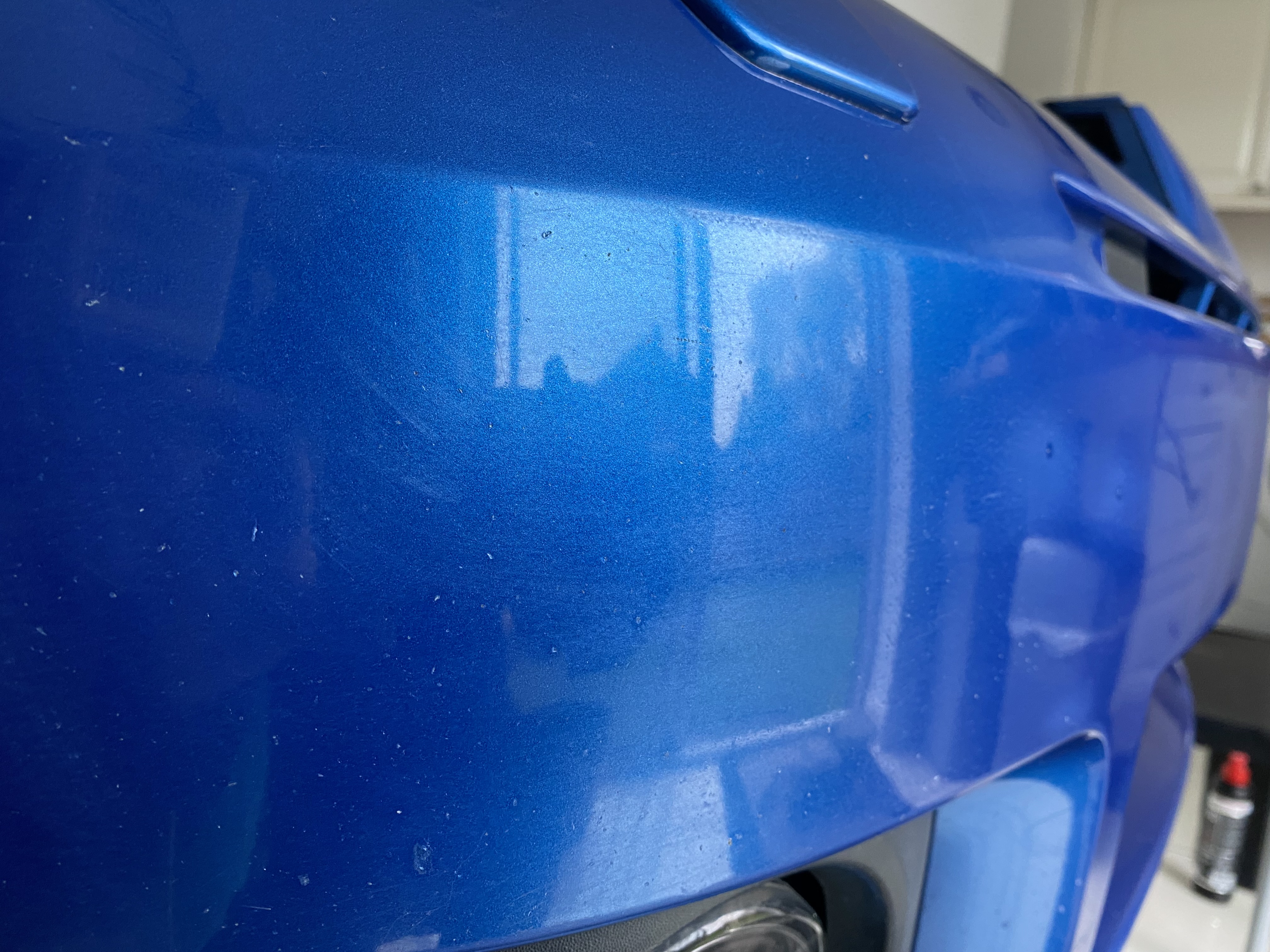

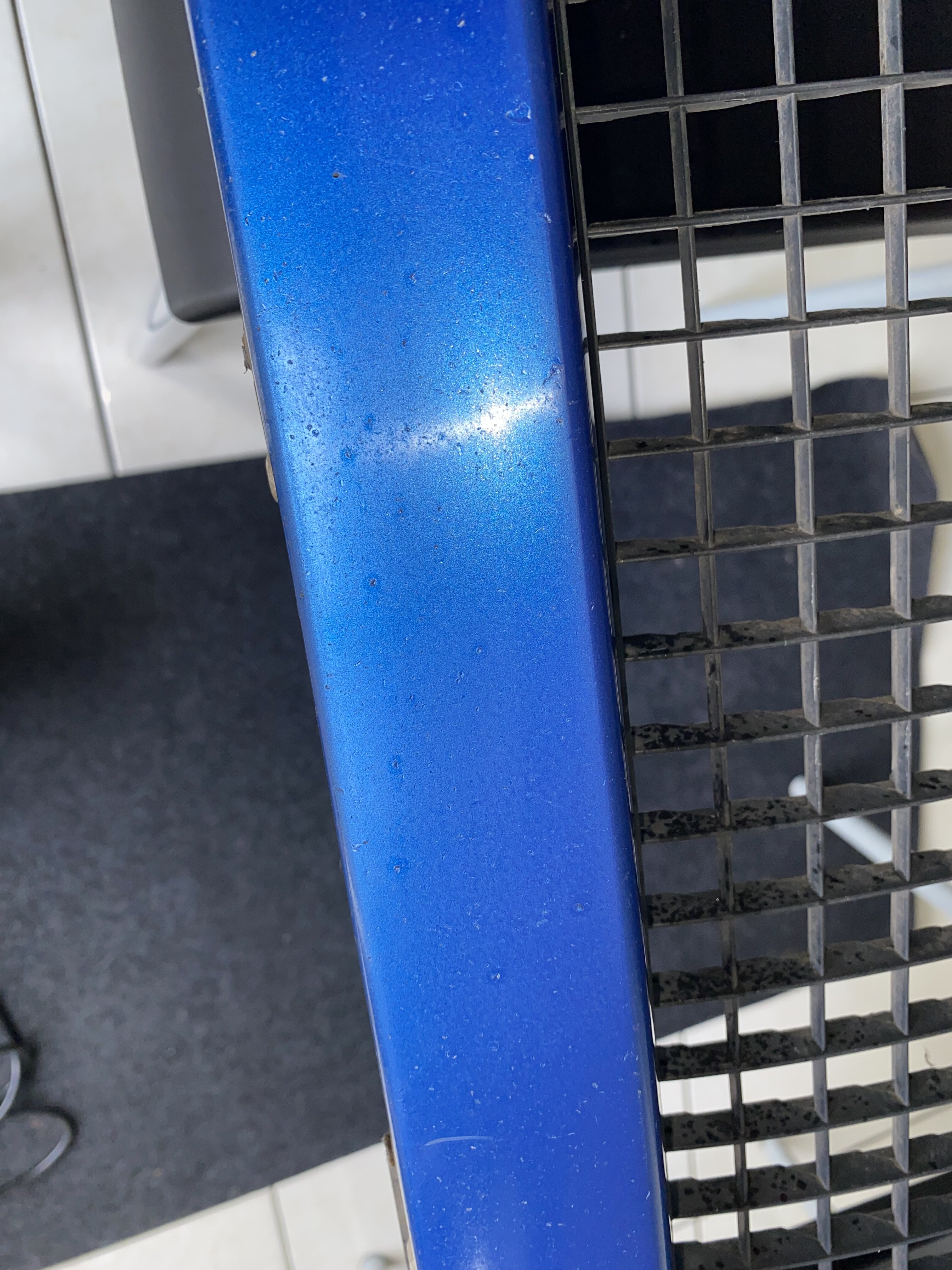

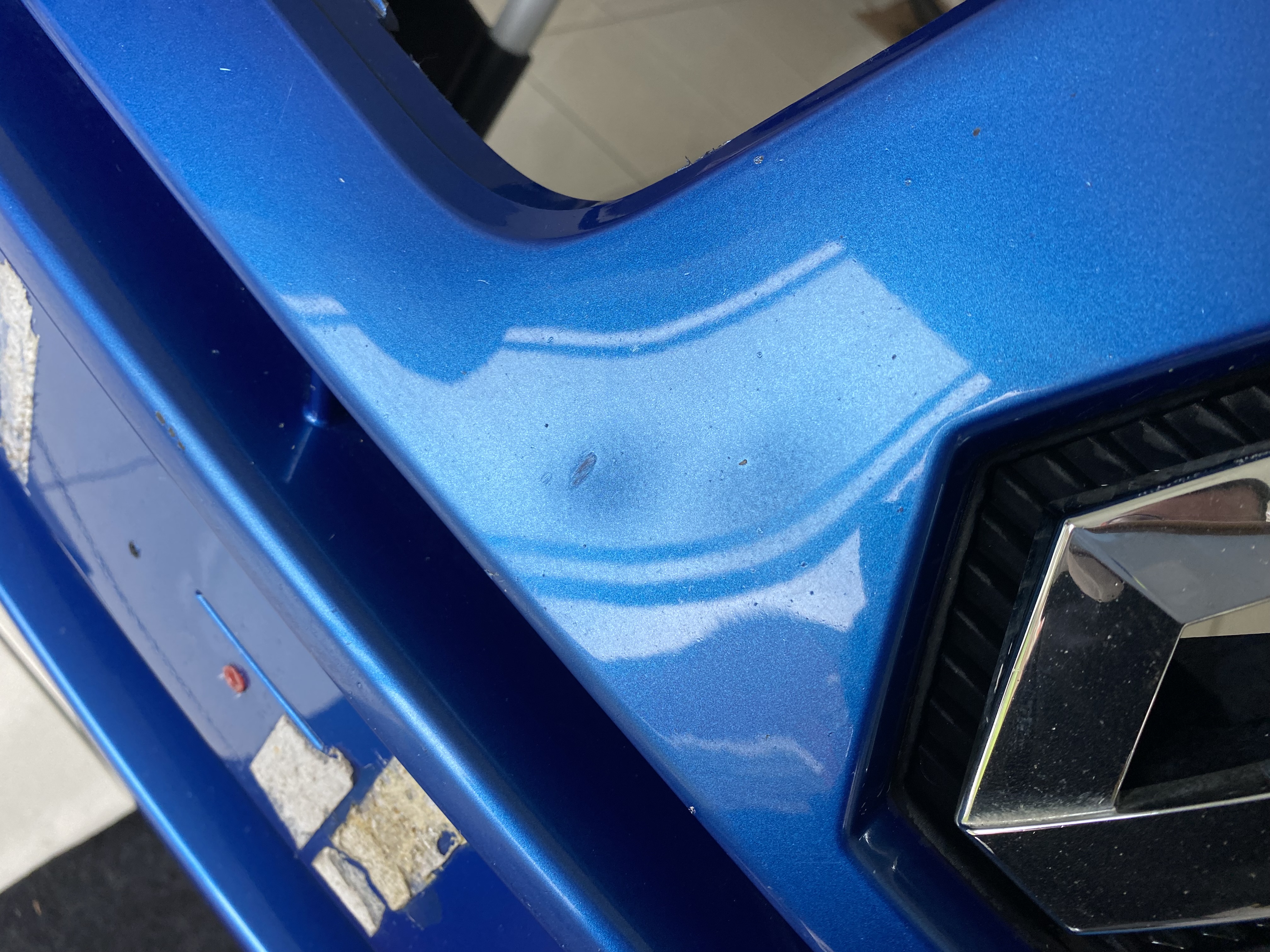

I’ve just had a go at polishing out the worst marks on it. There are a couple of spots where the paint has been rubbed off and they would need repairing. I know from experience that if I do the touch up correctly the touchup paint will definitely be in contrast to the original paint. I think what I will do is clean this up as best I can, repair any imperfections and fit it to the car to see how it looks. I know that if a body shop was just going to spray the bumper on its own then it will be around £250 to do so.
This morning I went over the bumper with 3000 grit wet and dry. There’s a ton of road rash on it and some scratches that have needed touchup. I’ve done the touchup and once it’s dry I’ll wet sand that down and then polish the whole bumper to see how it looks. The local body shop, who have a good reputation, have said that they can match it without it being fitted to the car. If I’m not happy with how it looks after polishing I’ll take it round to them and see what they can do. I’m just a bit concerned that a freshly painted front bumper, even with the correct colour match, might stand out a lot.

I think I'd rather have a freshly painted bumper thats not a 100% match than one that's peppered with chips and scratches.
I had my back bumper painted, edge to edge with the tailgate and rear quarters you'd never know, the match is perfect, they charged me £280 all in.
Yeah, to be honest, it’s looking like this will need to be repainted. At least if it is they will be painting a good bumper and not a damaged one.
As yours was painted whilst it was on the car, how long did they have it for?
