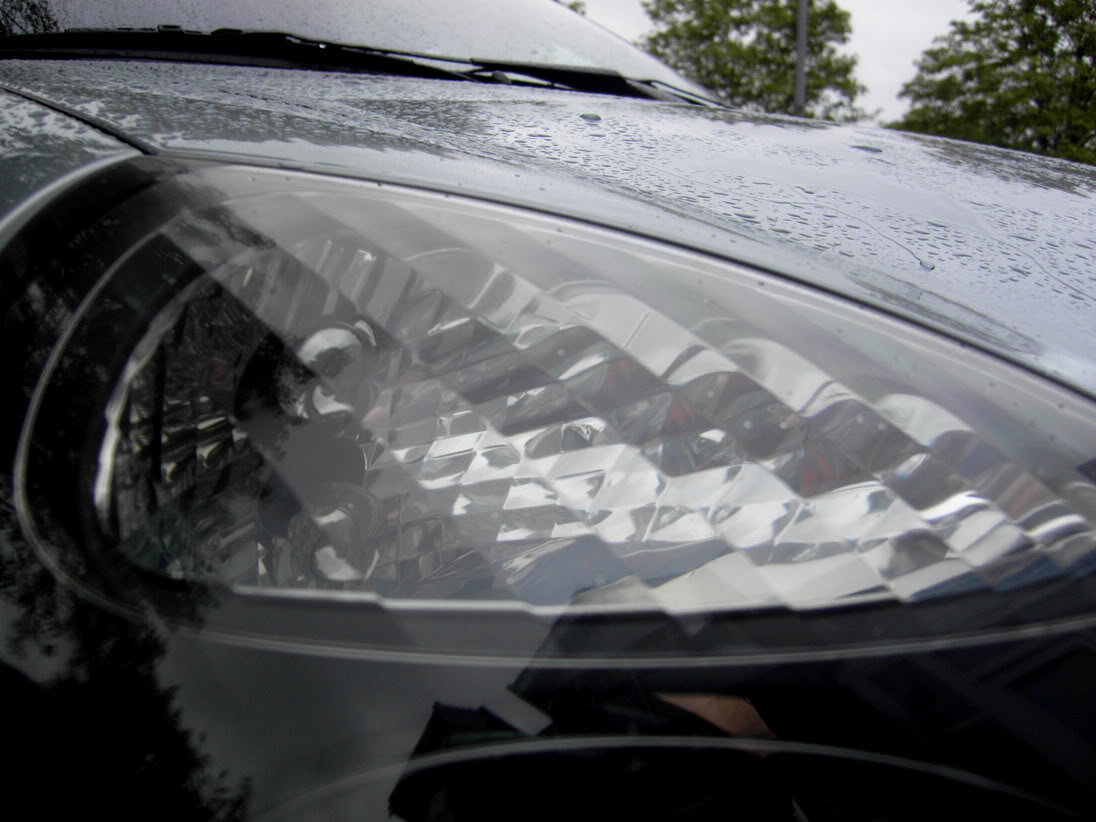

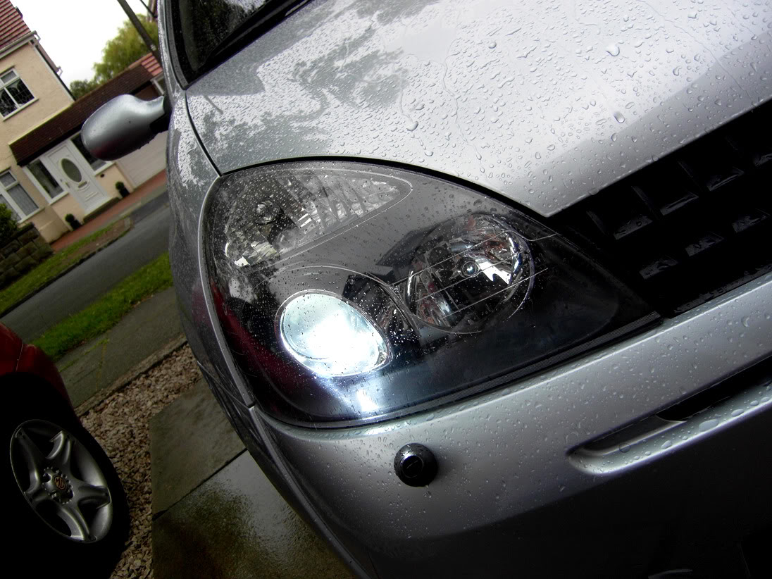

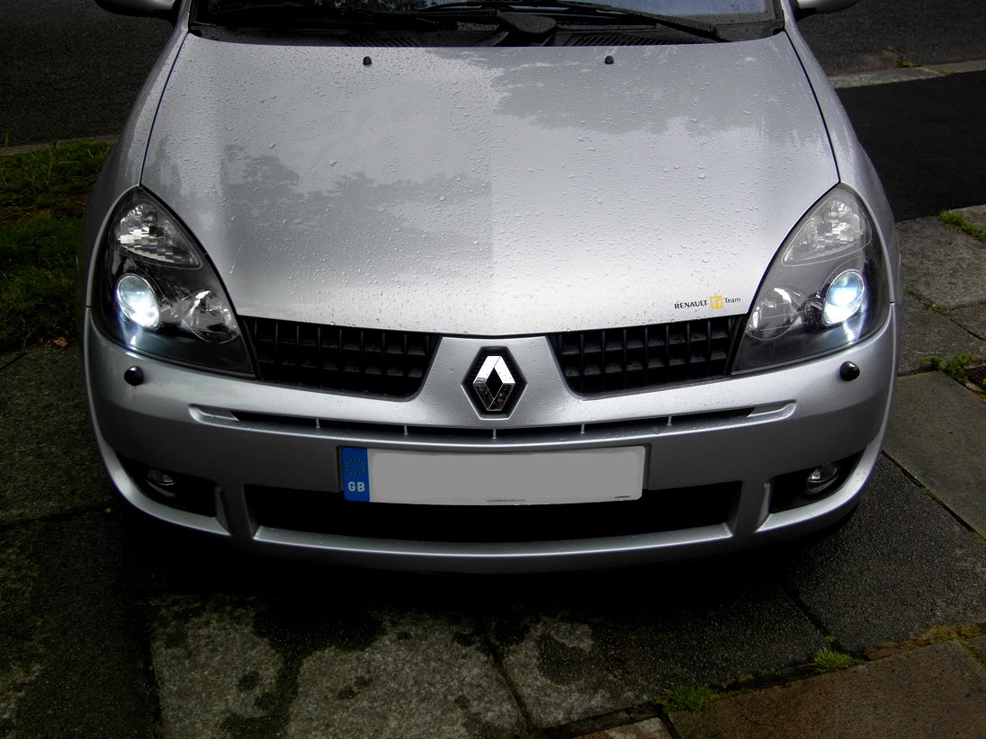

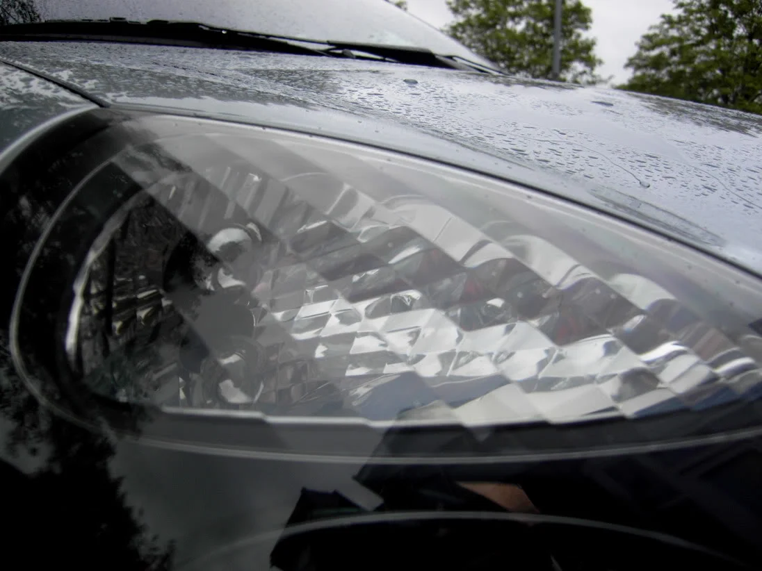

I've just finished doing mine as mine were looking old/hazed. I used 1500, 2000 and 2500 grade sandpaper and a lambswool buffer pad attached to a drill and some Meguiars Plast-X. They've come up looking really good!
[IMG
hi where could.get the lambs wool on drill buffer? And is.meguiars plas x.similar as meguiars scratch x
The lambswool drill piece buffer I got was in a Silverline sanding/polishing kit I got from Tool Station and the Meguiars Plast-X can be found on eBay. Search for "drill buffer" on eBay and a few come up!
