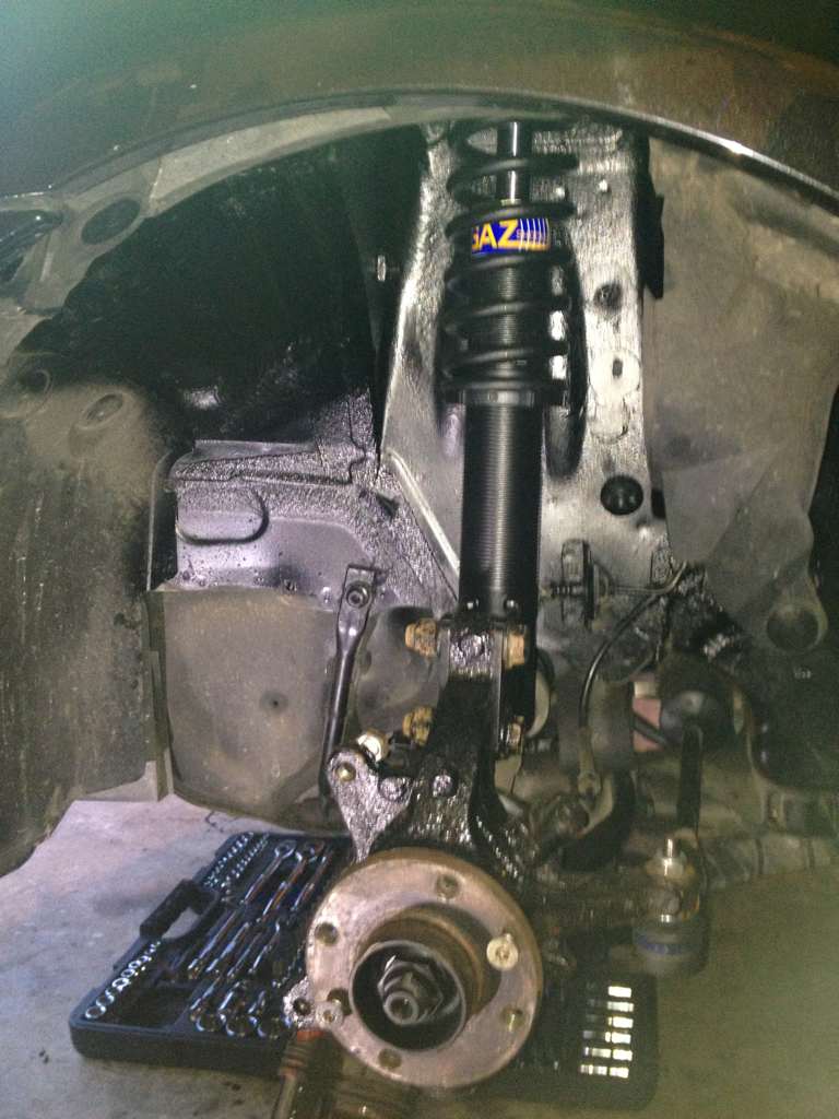

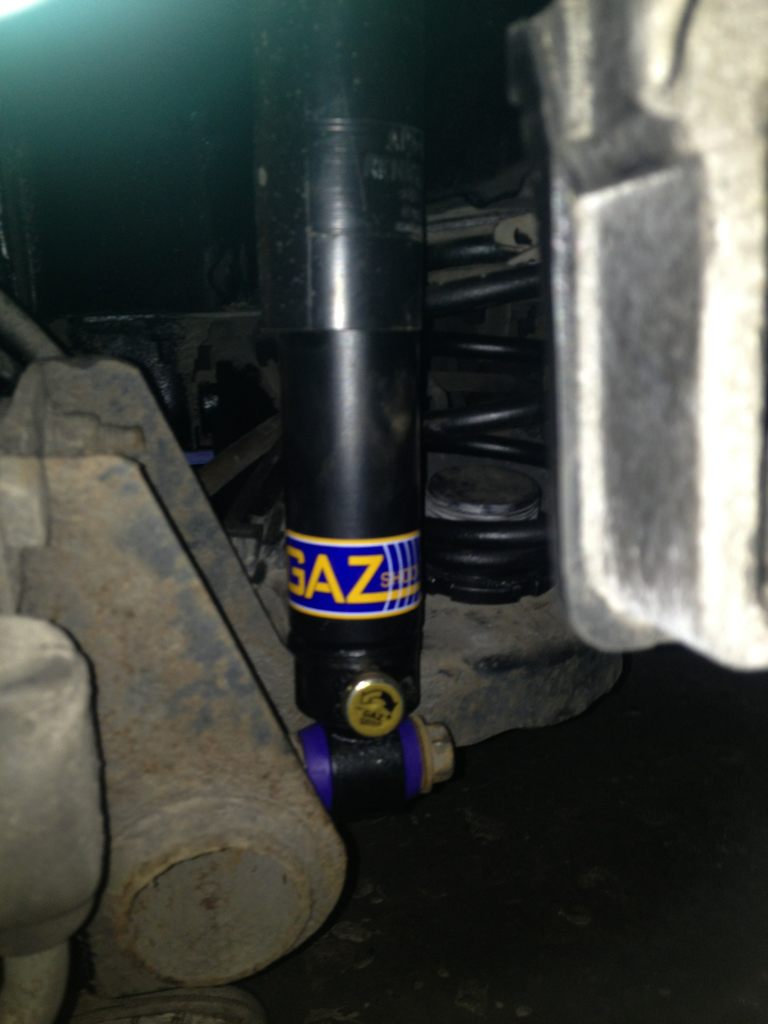

little update ; coilovers have finally been sent to gaz for a refurb . waiting for there call now to see what needs to be done . probally the lot . umm not much really goin on atm with my mrs bday and xmas :/ bt should be back on road by end of jan
Update: gaz have quoted me for the refurb its goin to cost £195 for a full rebuild of the fronts and rears . So not bad they shall be back somtime next week.

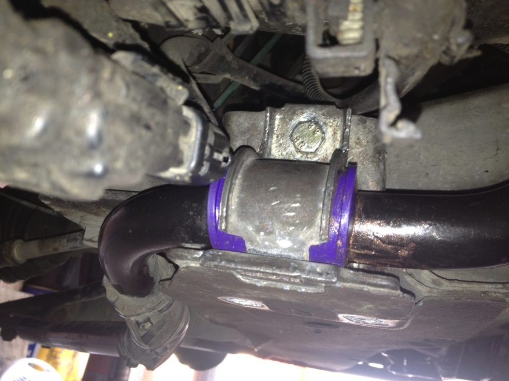

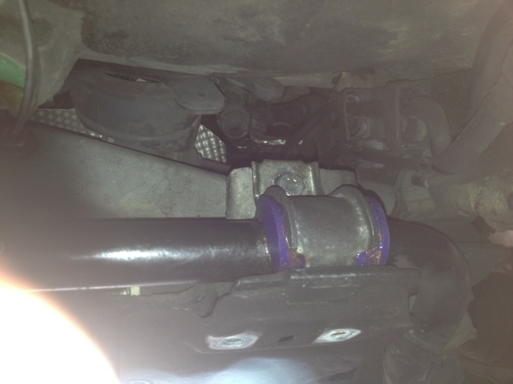

Also got round to fitting the outer arb bushes this evening pretty straight forward so much easier than the inners!

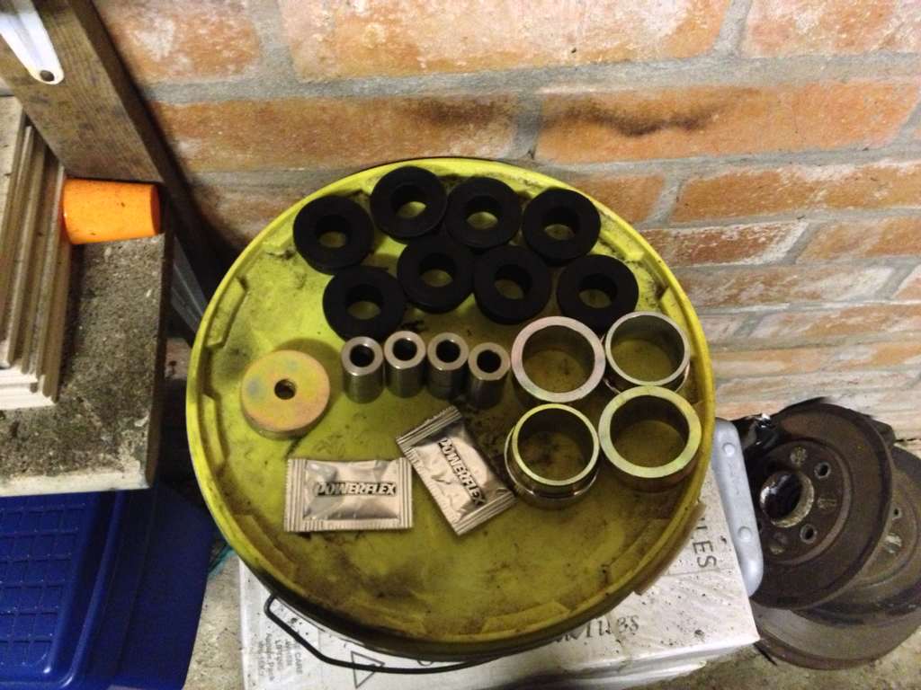

Also my new style powerflex wishbone bushes arrived these in most places are 90+ pounds but theres a company on ebay selling them 66 posted ! So it was rude not too .
These are the new style bushes they require no welding i asked powerflex this and they told me themselves also.

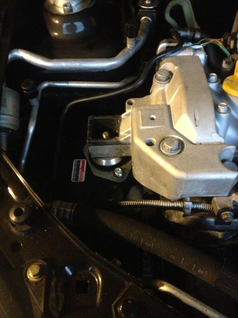

Vibratech engine mount

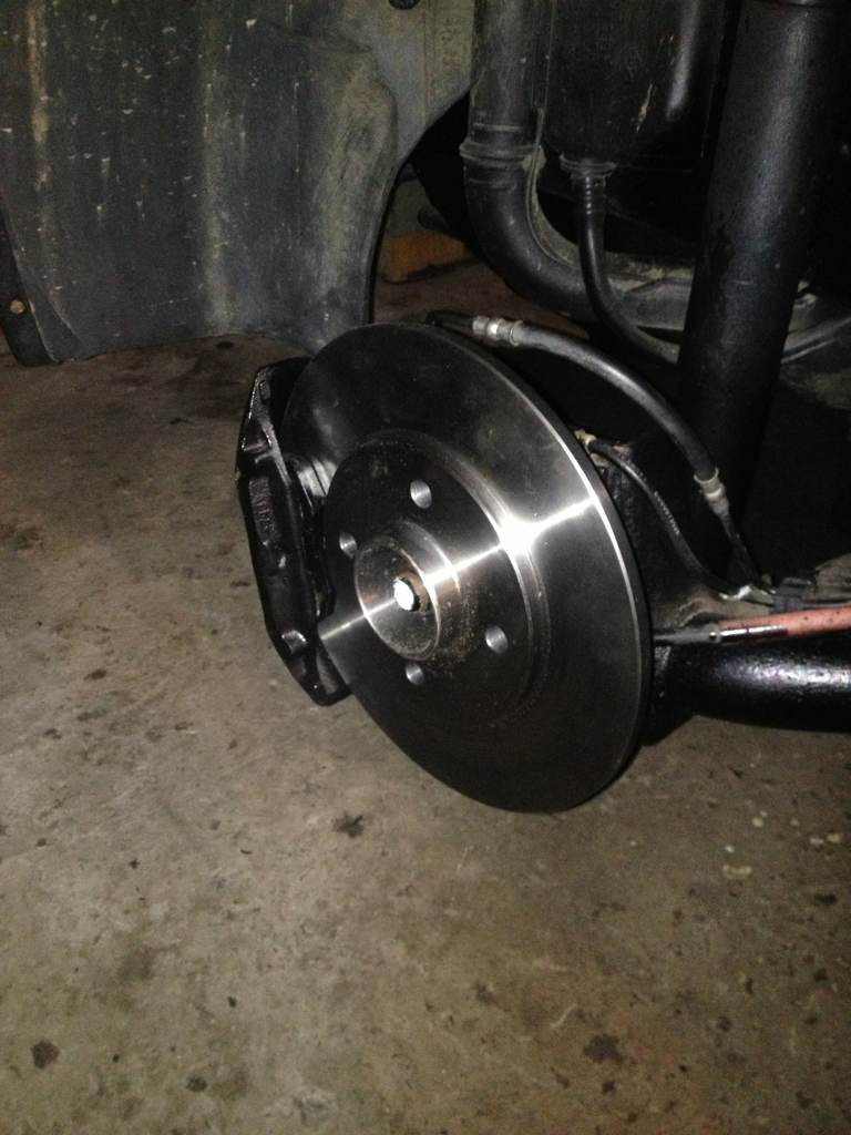

Front discs

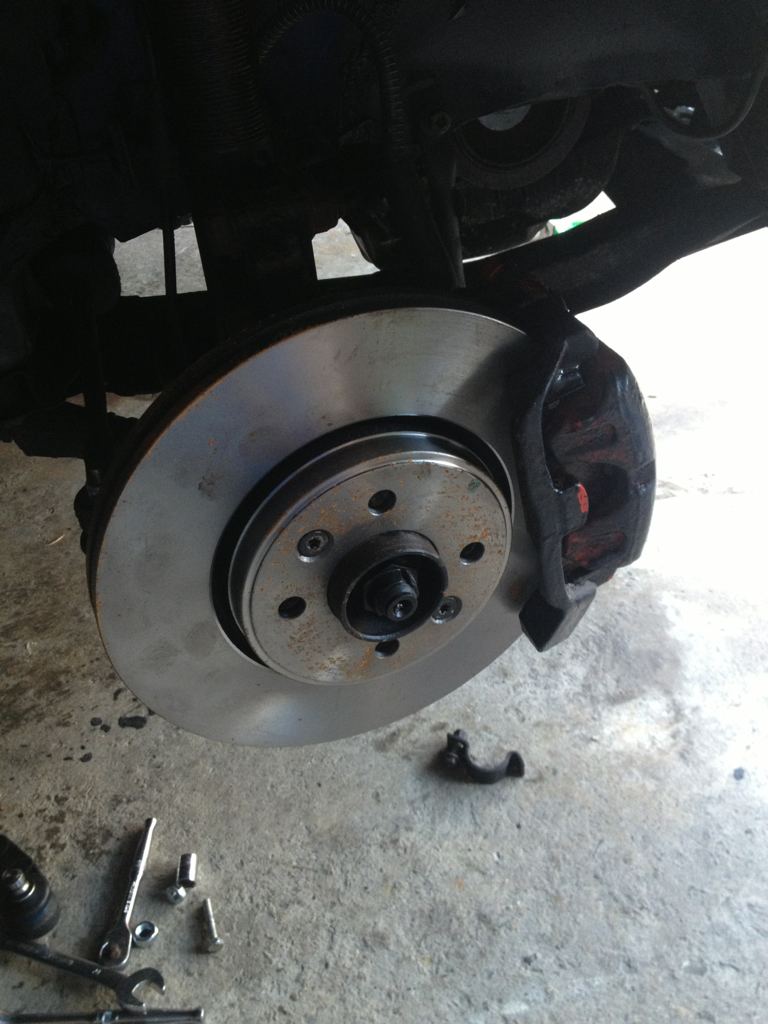

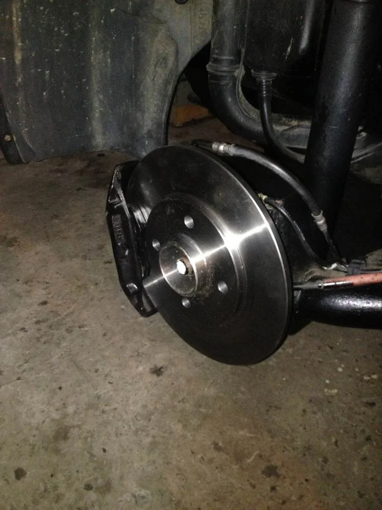

Done a few bits last few days ive assembled my front brakes small hiccup the bottom slider bolt was seized so a bit of a wiggle and a good pull on some mole grips managed to free it up . Also fitted my wind deflectors the other day they look good .
Ive adjusted my coilovers to what i think will be a decent height cant really test this out as ive got no wishbones on the car at the moment as the powerflex bushes ive fitted are giving me grief . So im on the hunt for some cup wishbones for the additional castor .

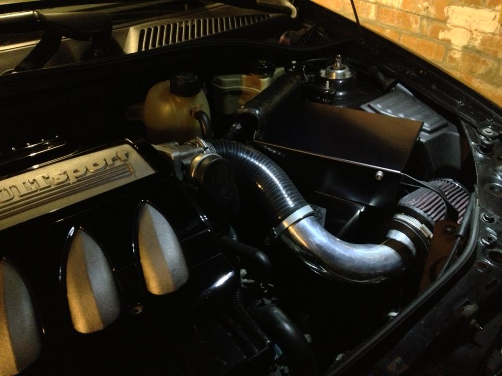

started the car up last night for the first time in months started first time on the key ran a bit lumpy for about 10 mins but soon cleared can feel some slightly more vibration due the vibratech mounts but nothing dramtic imo . gave it a few blips with the ktec style induction and what a roar cant wait to get it out on the road now . just hope everything works as it should
guna go round the whole car 2moro and torque up all the nuts and bolts ive taken off just t be safe . also need to adjust my dampers as i want ahppy medium with them not to had but not to soft .

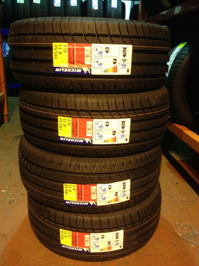

taking my wheels to work next week to get my michelins fitted then goin to give the wheels a good clean removing all the tar and brake dust to make them mint again also purchase some speedline decals as mine has washed away over time .
