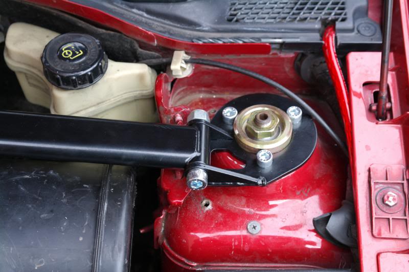

- Pure Motorsport Top mounts with matched strut brace

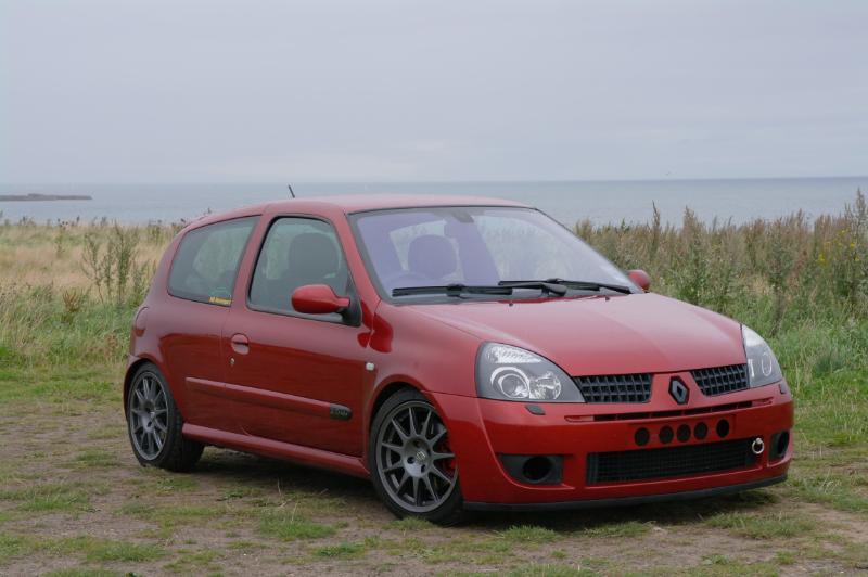

Also got the following tiny bits sorted...
Carbon bullets on the side;

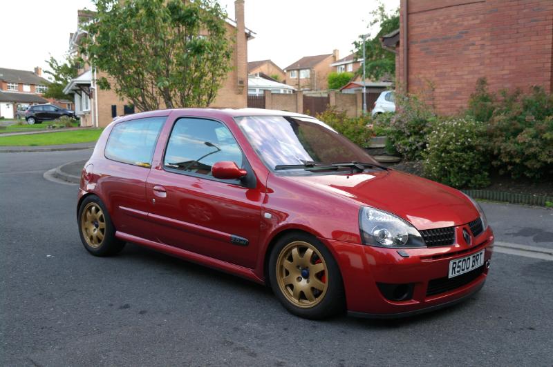

Pro Race 2 alloys with R888 tyres;

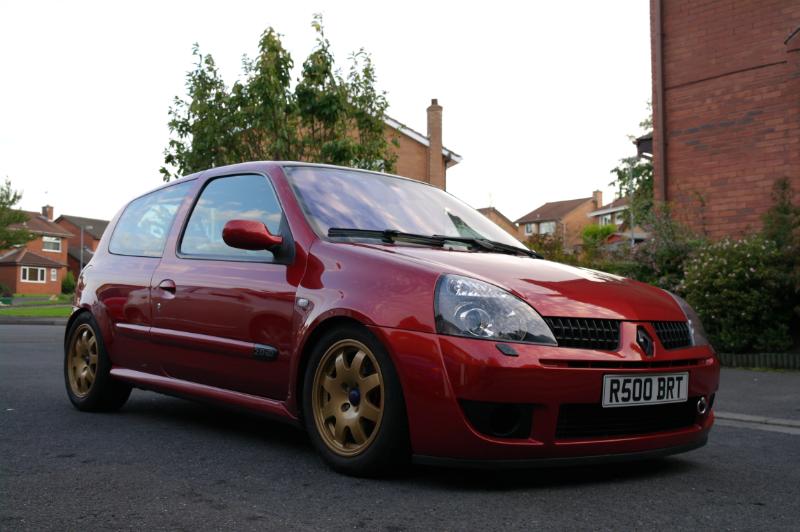

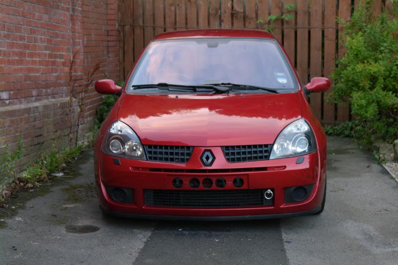

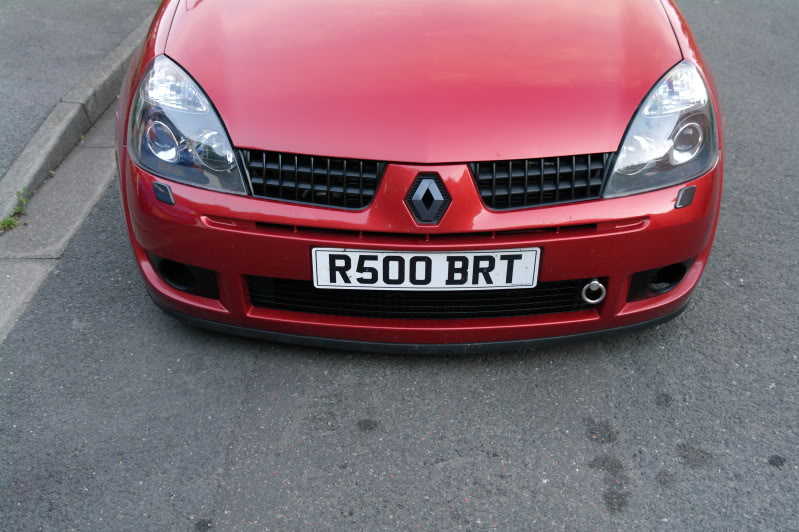

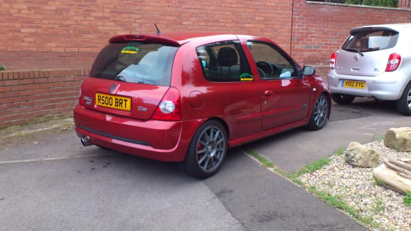

Fitted the Pro Race 2 wheels and R888 tyres then took the traditional N111JST reg off and fitted my private plate;
Started adding additional vents for cooling;
Also got a cup spoiler and now have a full set of Cup Turini's including a spare - these are going for refurb in a light anthracite

Good stuff dude! Those extra vents make the car look a lot more aggresive without the plate!

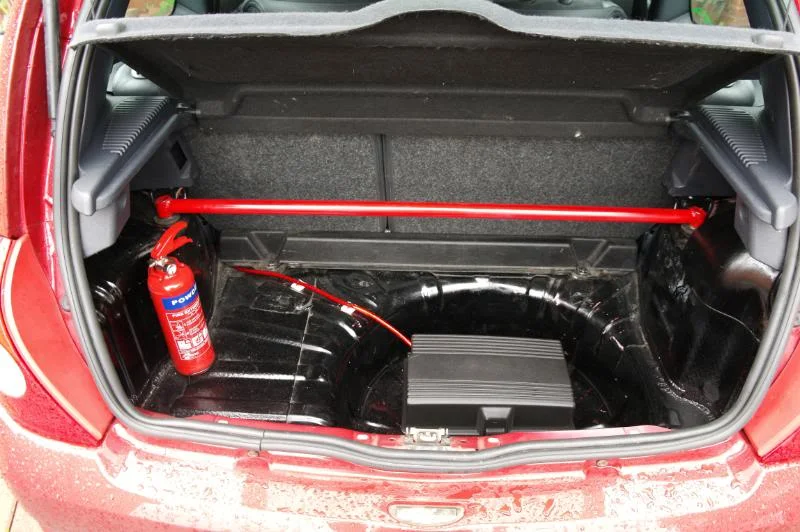

Todays job list;

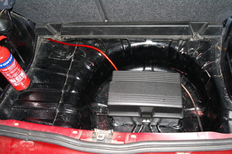

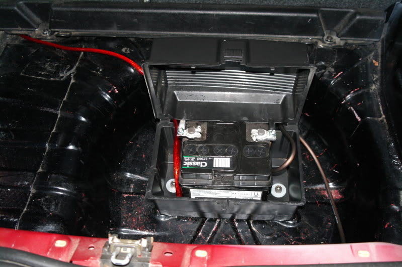

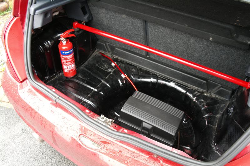

- Move battery to boot
- Install BMW remote positive terminal in engine bay
- Make up 5m positive cable
- Make up 1m neutral cable

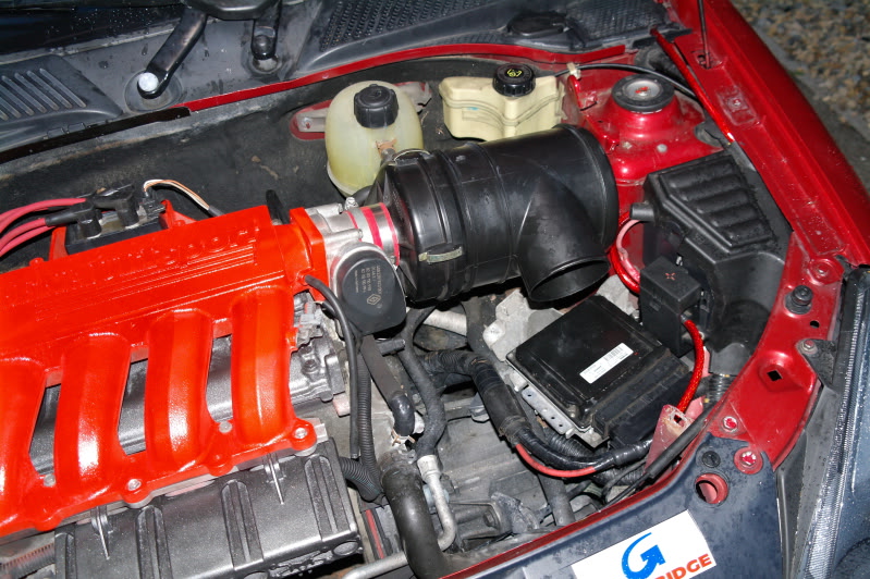

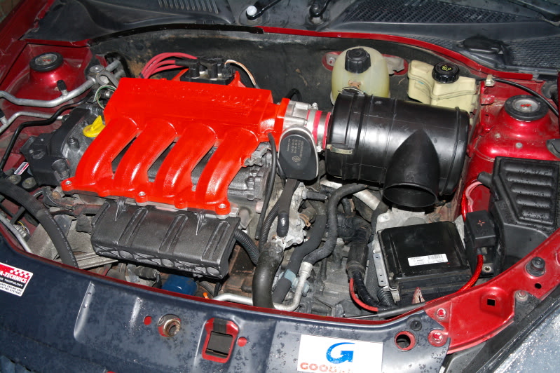

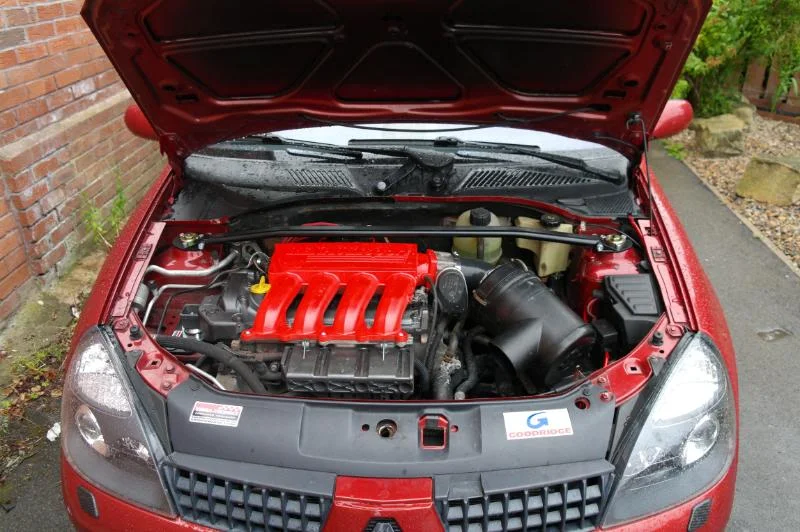

- Mount ECU horizontally
- Mount V6 airbox straight onto throttle body
Still need to fit the battery securing bar but not using Clio so all is well

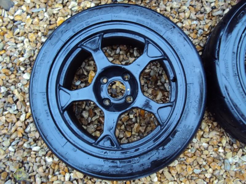

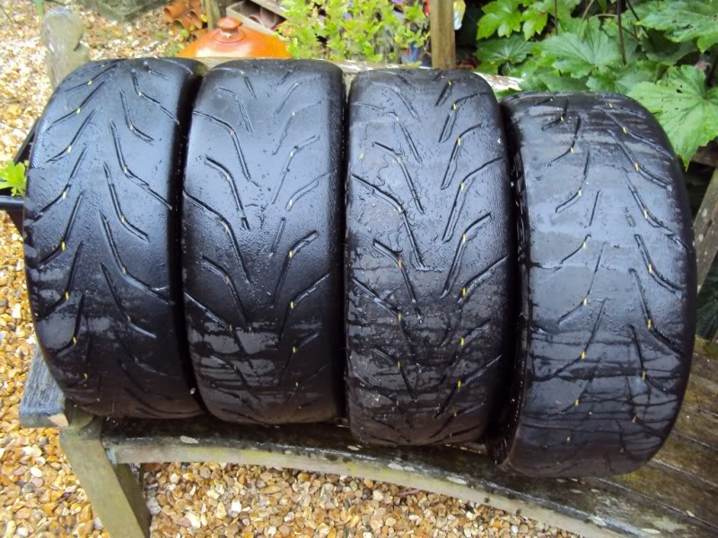

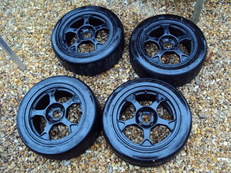

Also got some wet Michelin track tyres;

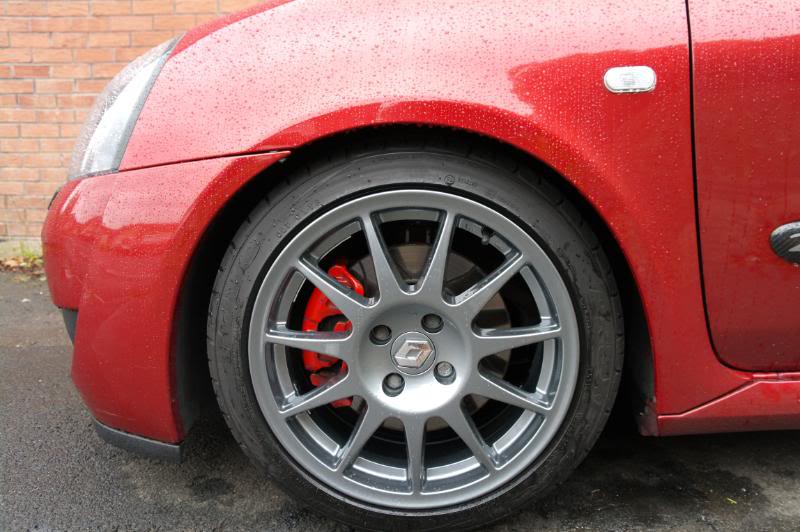

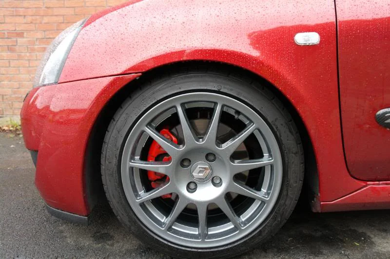

So I dropped a full set of Turini wheels off at SEM in Sunderland for a full refurb and painted in a custom grey mix;

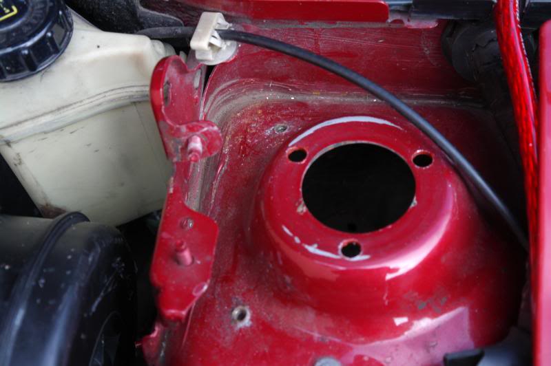

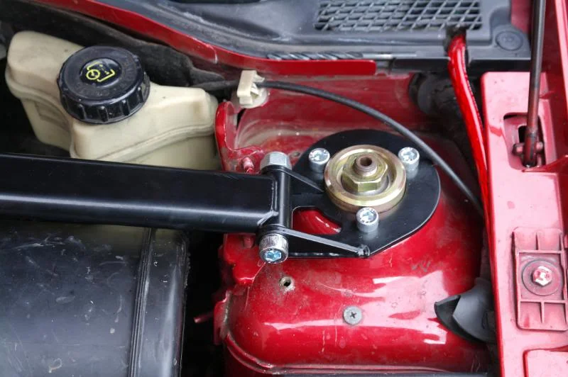

I also got the Ktec coilovers off along with the Renault top mounts.
In their place was H&R coilovers with Pure Motorsport top mounts and matches strut brace;

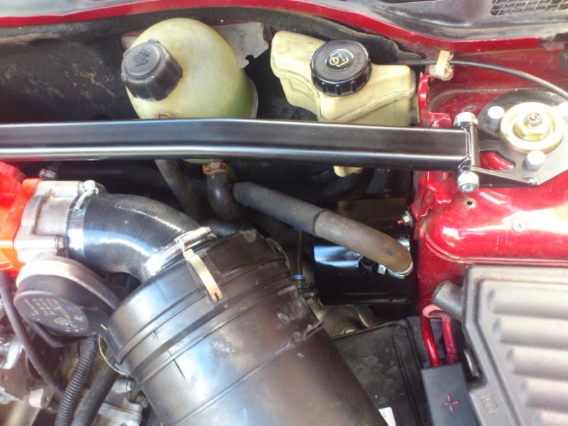

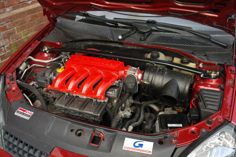

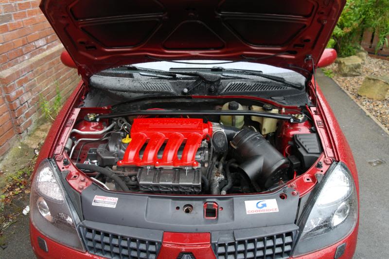

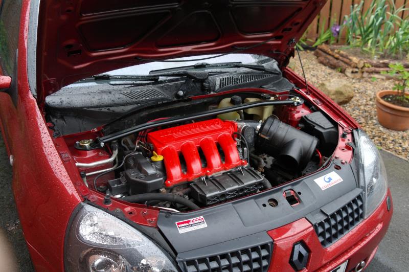

I didnt like the closeness of the airbox to the coolant return pipe so moved the airbox again;
Now on sorting the Pro Alloy radiator and need an oil catch can
Rob

H&R rear suspension fitted, strut brace for my camera mount, cables tidied up and it looks alot better;

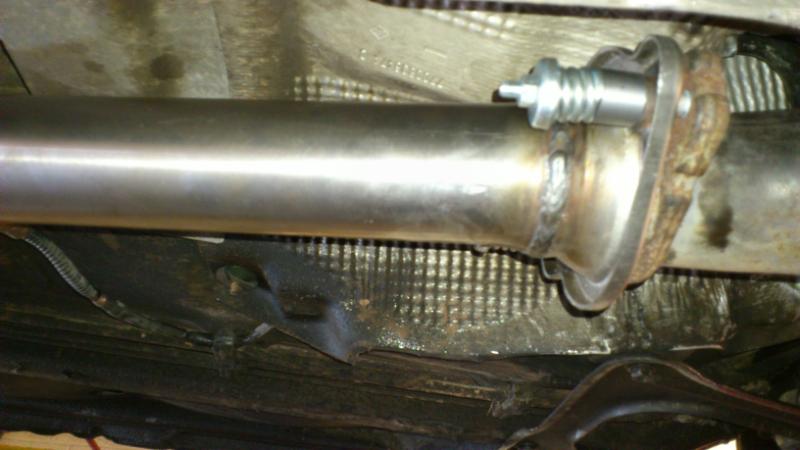

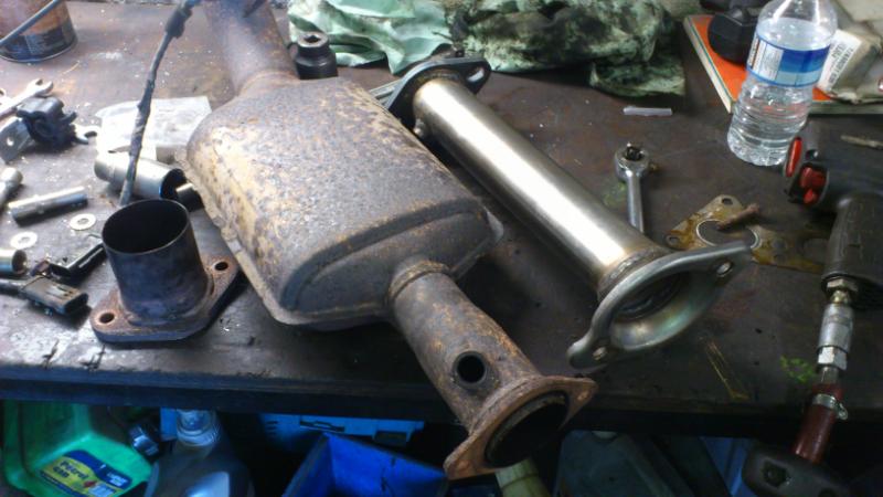

First up was fitted the Clio 182 4-2-1 manifold, Ktec link pipe, all new gaskets and hangers. The spring and bolt arrangement between the link pipe and manifold didnt seem as secure as we would have liked so 2 spacers were machined in order to compress the springs more and give a more secure fit.
This had the subframe dropped down to aid access and also meant the gearbox linkage needed dropping. The front bush in the linkage was completely trashed - step in Mich on the lathe and a new steel insert so now have a lovely crisp movement with no worrying about the bush perishing.
Once rebuilt the exhaust was aligned and secured and now is 100% better than it was before.

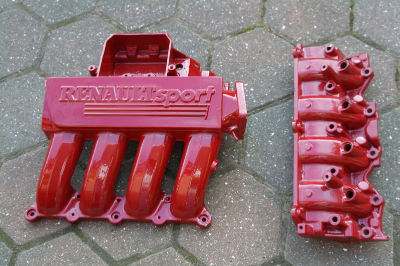

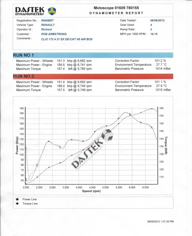

Bought some inlets which have had some porting done and just needs finishing off;

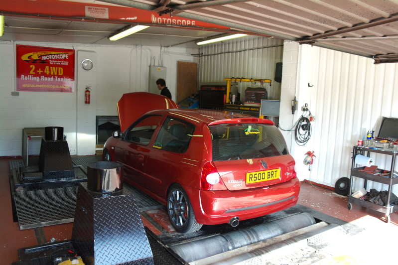

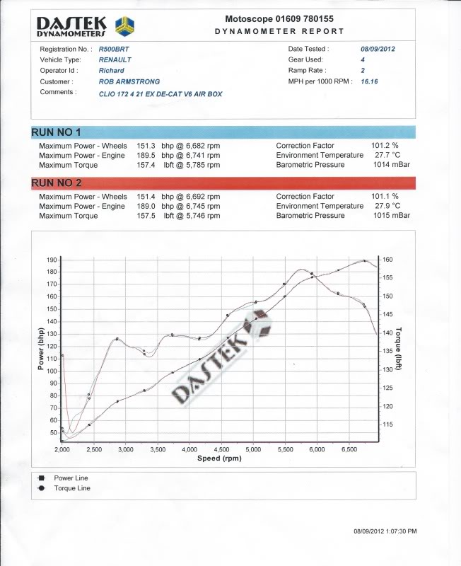

Also called into Motoscope for a power run to give me an idea of what I am working with, Rich commented on how smooth and strong the engine felt. The fans on this rolling road are enormous in comparison to most rolling roads as well so keeps the cars temperature controlled lovely.
Got a result of 189bhp and 157Ib/ft
Performance mods are;
- 182 4-2-1 manifold
- Ktec decat link pipe
- Janspeed cat back system
- V6 airbox on smooth angle hose
- Pipercross filter
On uploading a video now of the runs on the rolling road
Rob

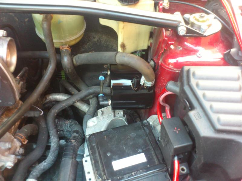

Well got an oil collector pot fitted. Unfortunately the paintjob looked nothing like the pic so rubbed it down and repainted it. I mounted it in its current position for quickness but will need to orientate it 90 degree once another location tab has been welded on.
Also when I was out for a drive I got a few pics;

the car lookgs good, how do you find the pure motor sport top mouns
  182 Cup & DCi 172
Fantastic but I did swap to the H&R coilovers at the same time so might not be the best person to ask haha.
The quality is immense and the fitting is very straight forward. Strut brace is the same but you get a good package deal when bought together.

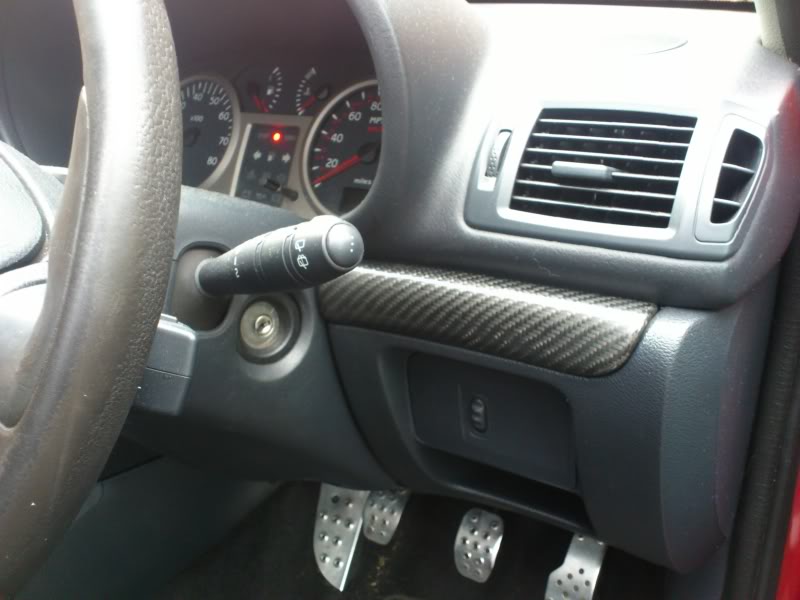

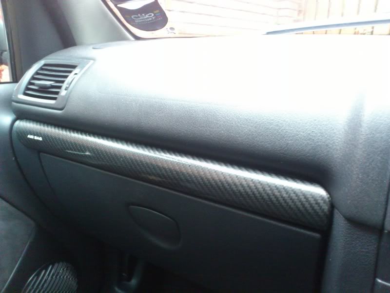

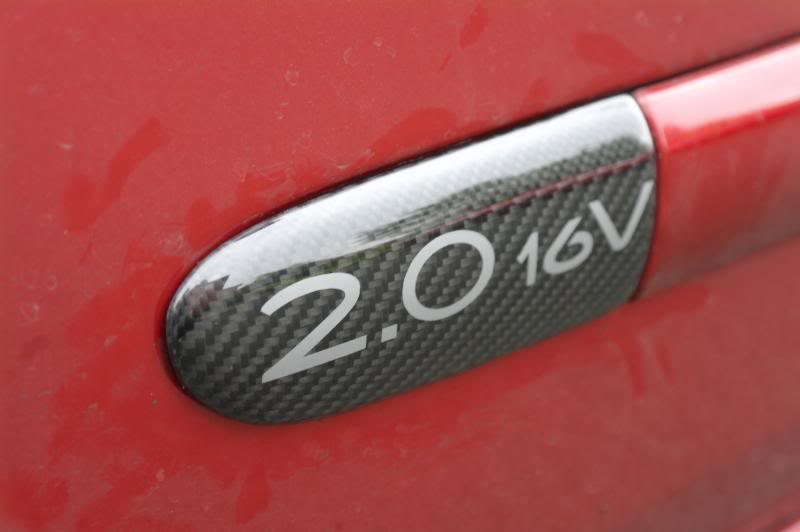

Carbon dash strips have been fitted;

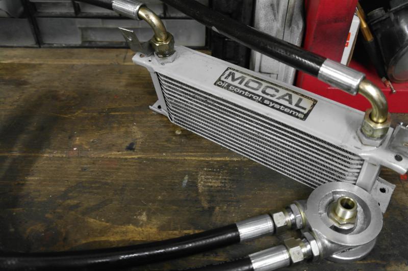

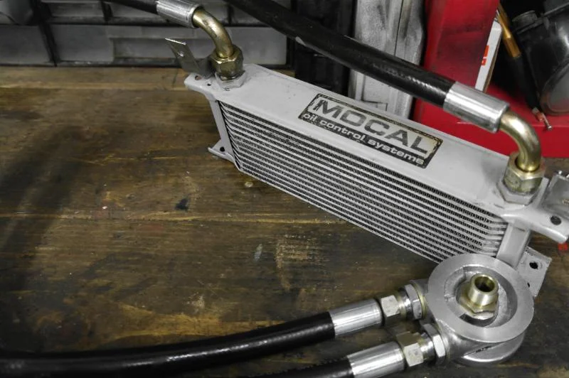

Mocal oil cooler has arrived and next time I change the oil will fit it, just spent abit time cleaning it up;

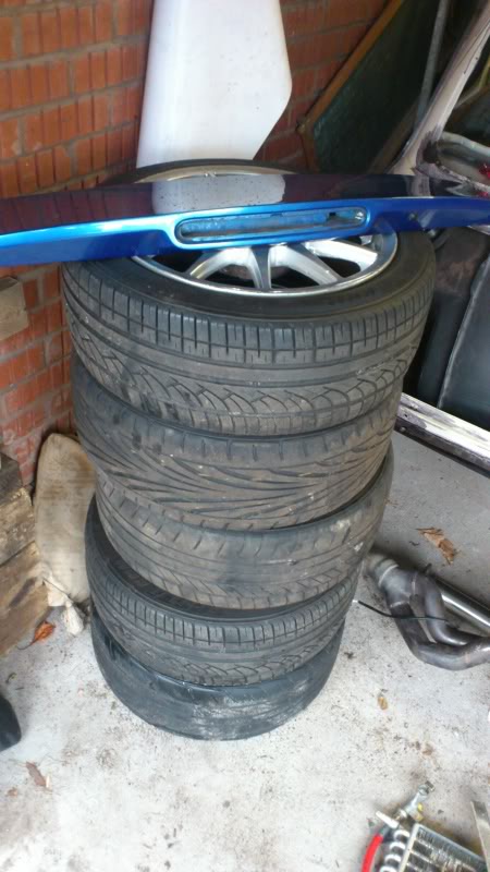

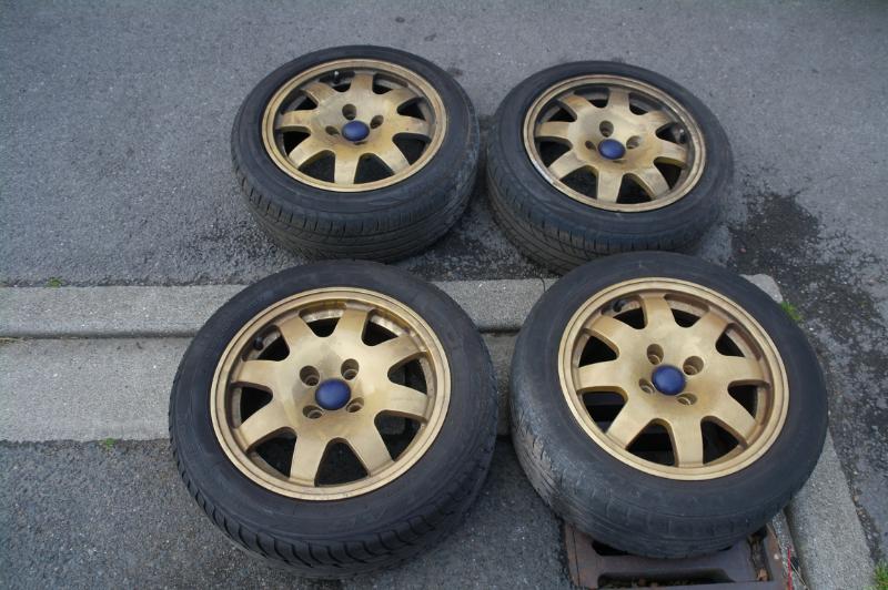

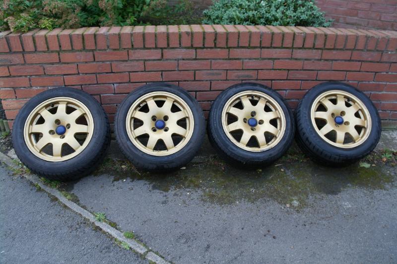

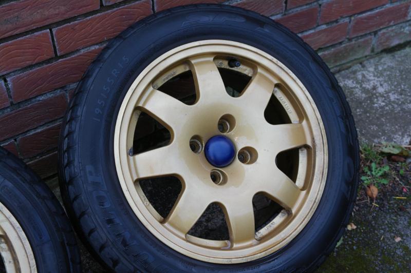

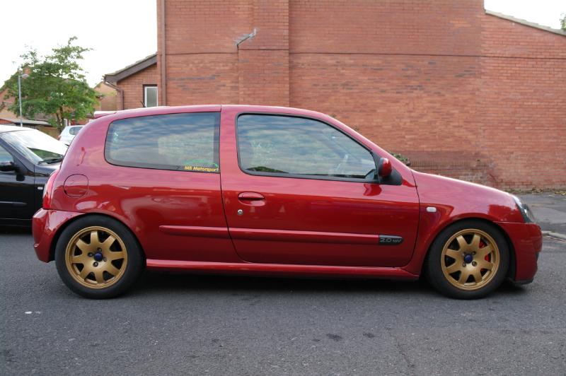

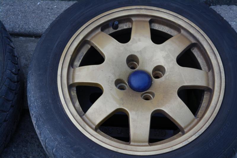

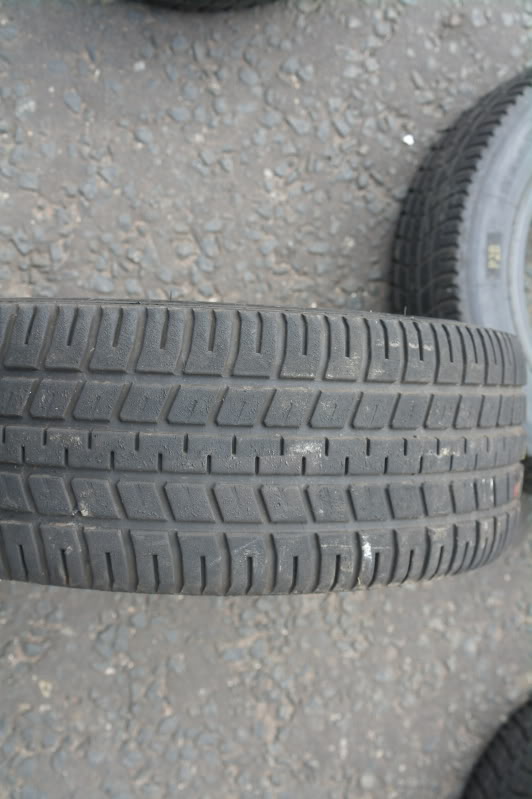

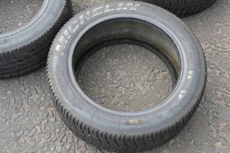

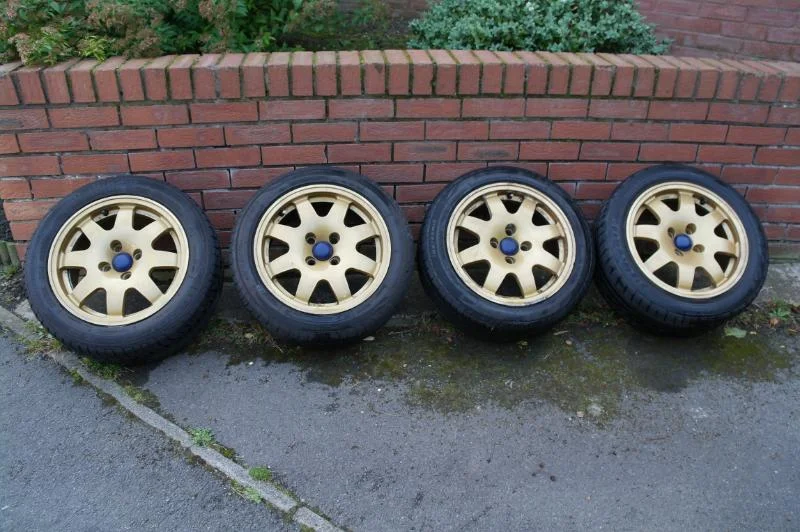

Picked up a set of Williams alloy wheels with some 195/55/15 tyres on. These rims will be getting the R888's on and the Pro Race 2 alloys will be getting the Michelin P2B wets on as I much prefer the Gold track alloys.
They aren't kerbed but could do with a repaint as some is flaking slightly. Bonus is the tyres they came with will go on the Ford Ka I got the girlfriend.
As they were picked up from the scrapyard;
After a good clean;
The remaining marks wont shift but are clean enough for now.

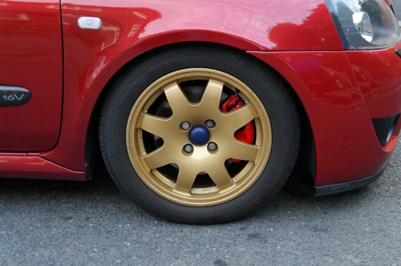

On the car;
Rob
  182 Cup & DCi 172

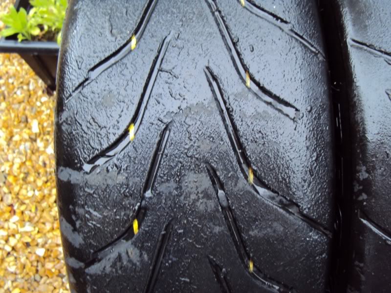

It took some getting used to but its only for track or in the summer with the R888's on. Hunting for another set of dry track tyres as the current Toyo's dont have loads left on.

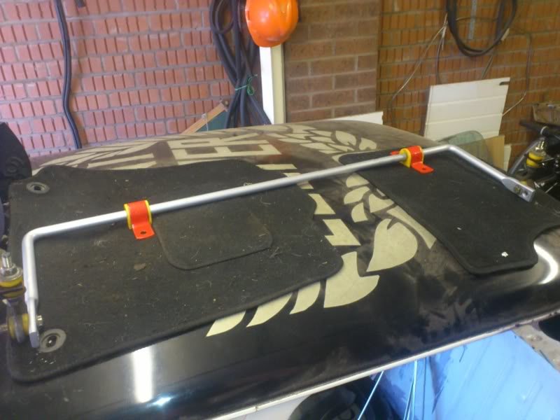

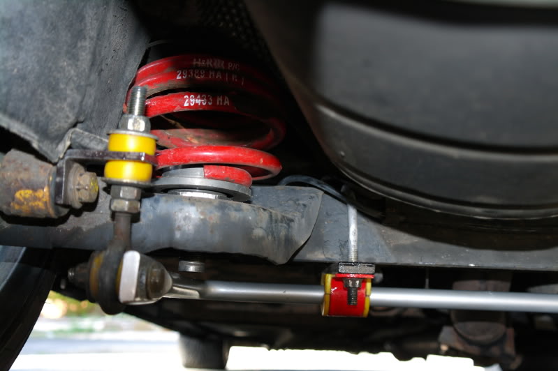

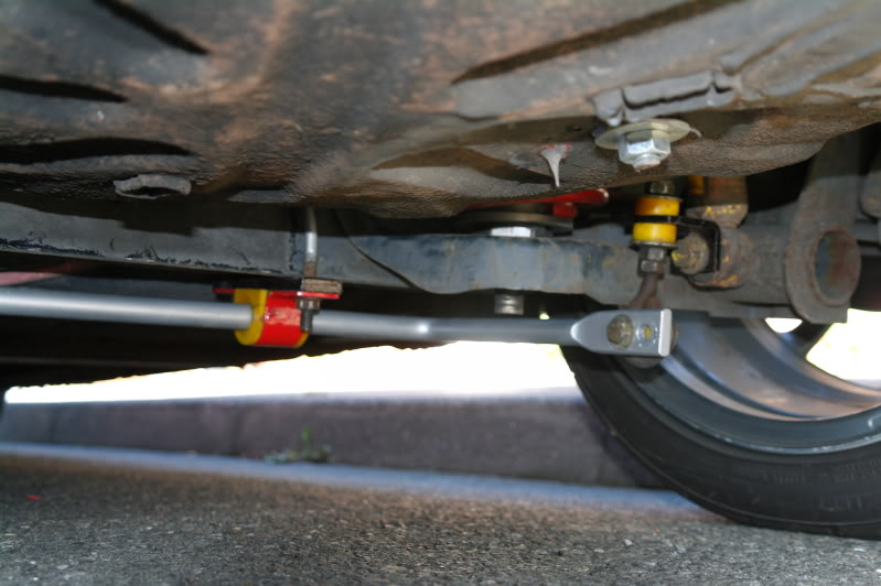

Got my Whiteline adjustable RARB through this week and painted it all up as was looking a bit tired.
Painted it Ford Moondust silver with red bush hangers, black spacers and silver axle clamps. Some touchups will be required on the axle clamps as marked them during fitting.
And fitted, ignore the mud splashes as it needs a full underbody clean. Since these pics were taken I have started on the rear with snowfoam and pressure washer;
Tomorrow will be engine clean along with interior and hopefully my selector seal kit should be ready
