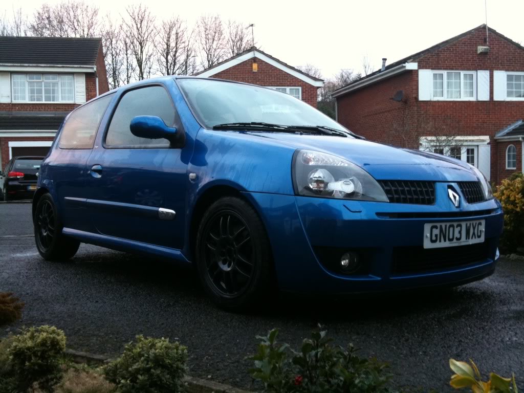

So when I had settled in the house and got a bit of spare cash I decided to get another 172, didn’t want another Ph1 so set off looking at Cups. I ended up buying the first I looked at. It was on 17’s, had a double barrel Powerflow exhaust, PiperX induction kit, lowered on Apex, splitter was knackered and a front fog light was smashed. But the bodywork was immaculate, had only done 47300 miles, FSH and a recent belt change.

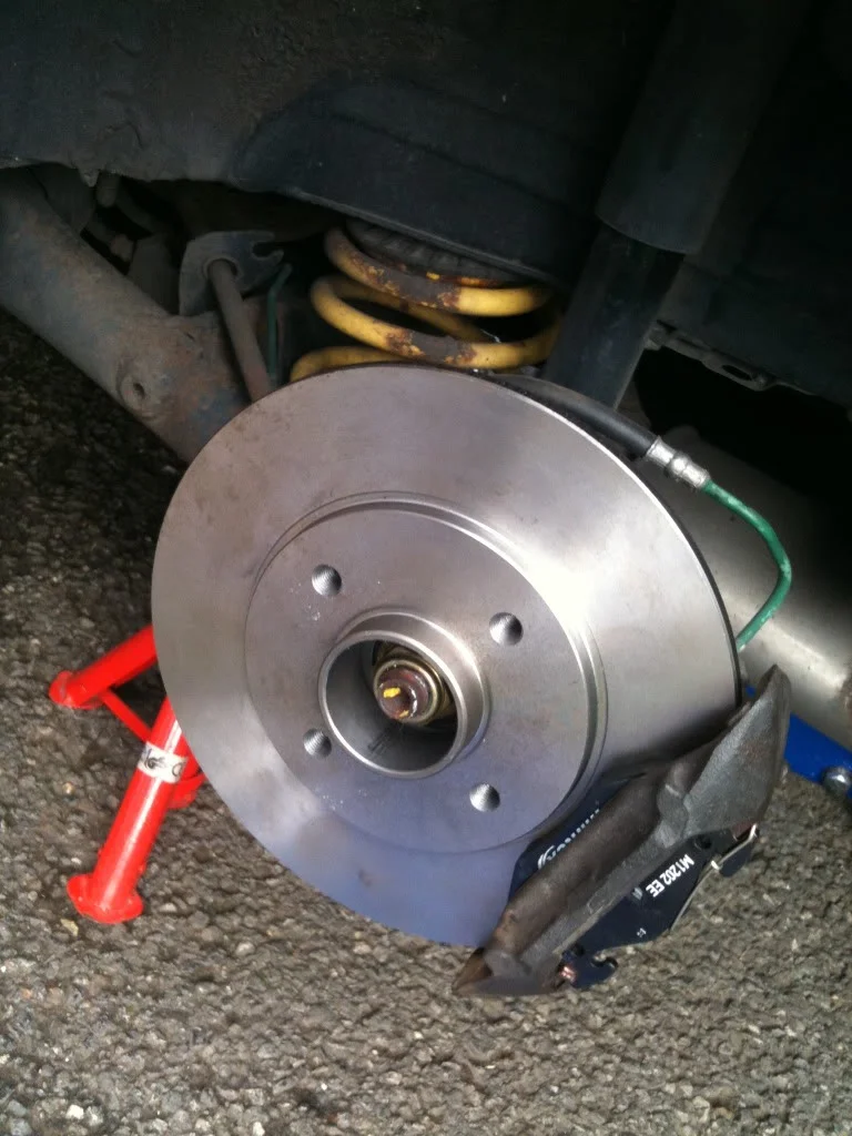

One of my rear wheel bearings was shot and the brakes on the back had seen better days, so I decided to replace the discs, bearings and pads. My new next door neighbour works for Mintex so thought I’d give them a go.
I’m going to do the fronts soon and will spend a bit more money on them I think.

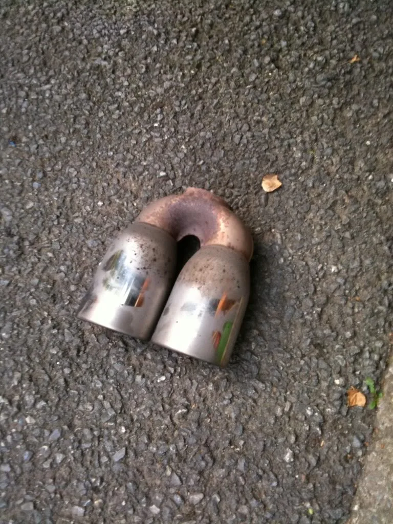

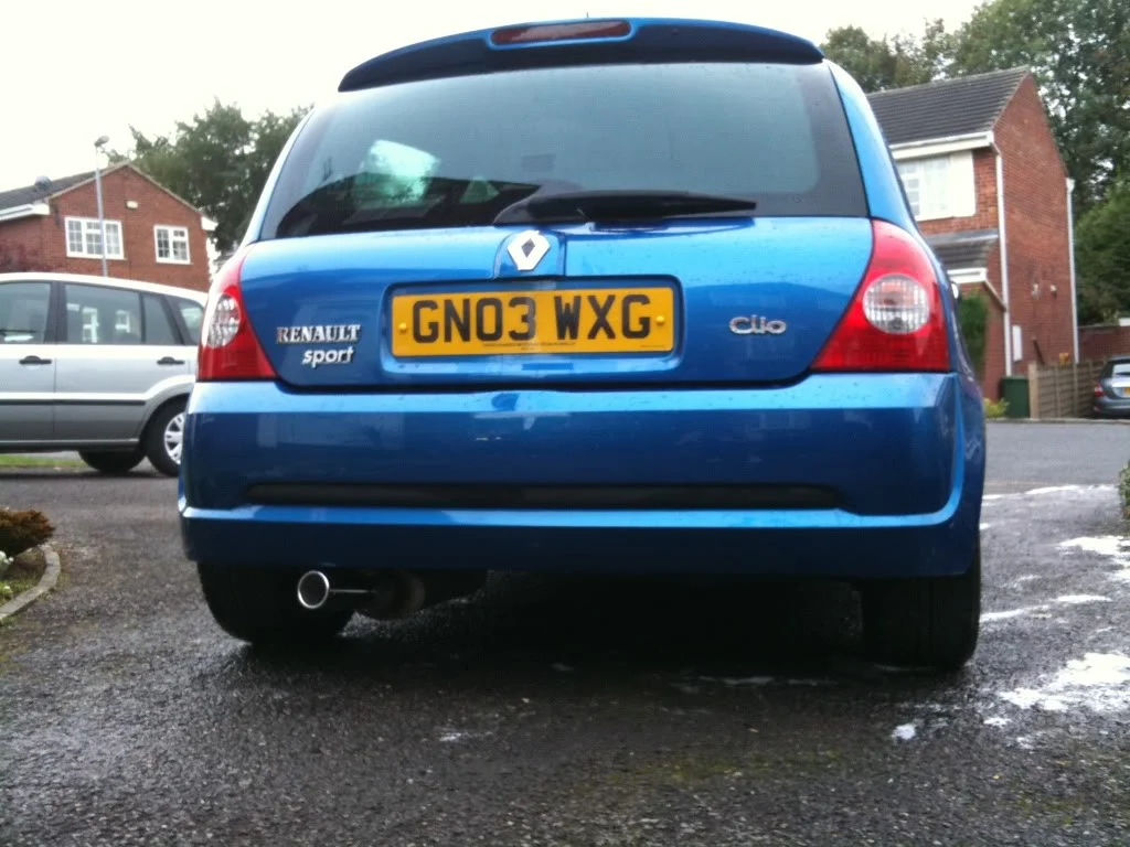

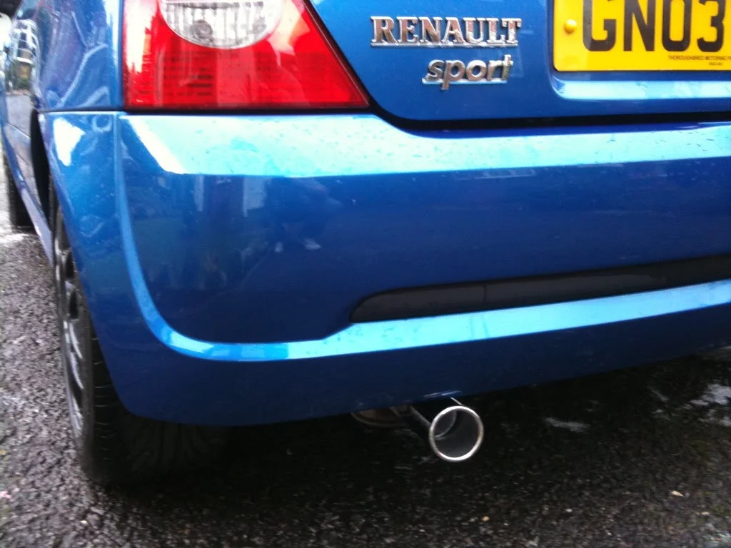

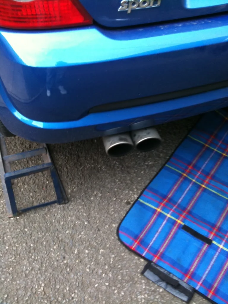

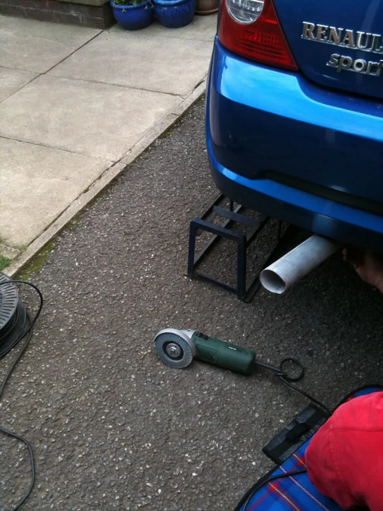

The exhaust on it is a cat back Powerflow system and I’m pretty sure it’s in one piece, which isn’t something I’d seen before on a 172. It sounds alright but the tailpipes really let it down.

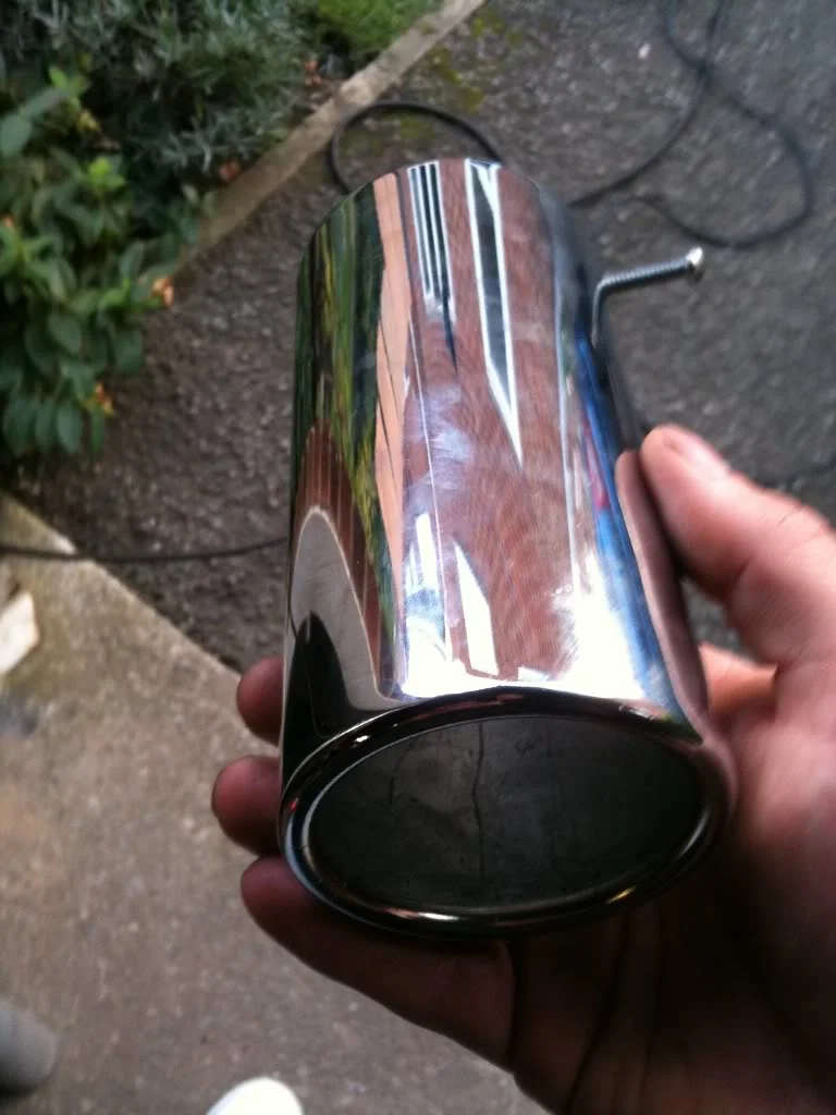

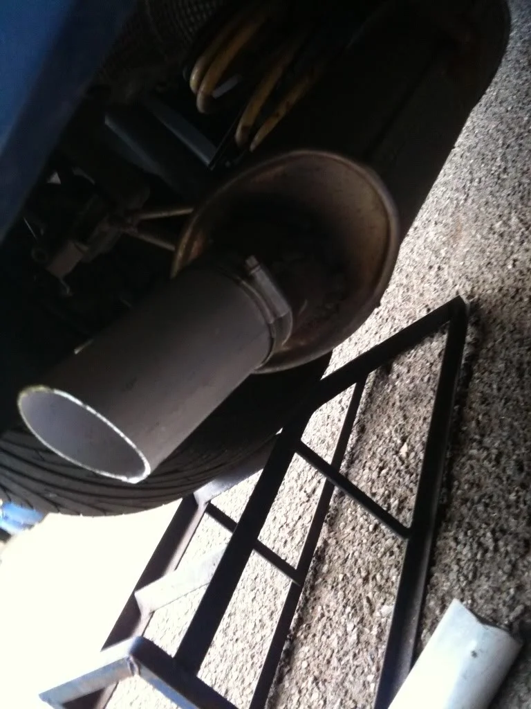

So I cut them off…
I had this in the garage, it’s not great but thought it would be an improvement.
It wasn’t quite long enough so had to extend it with a bit of aluminium tube.
Cut to length and secured…
It’s not ideal, but I think it’s an improvement and was worth the hour it took to do. It will probably end up having a custom stealth system fitted in the next couple of months.

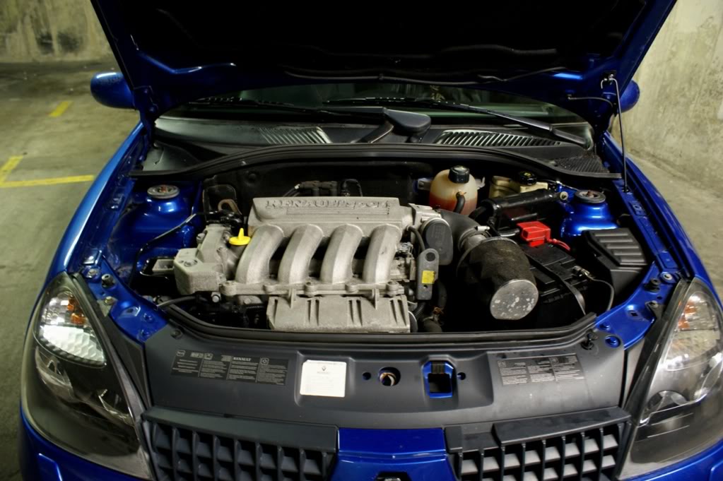

I imagine the PiperX with be causing a bit of heat soak, don't worry though I have got a standard airbox and elbow to go on, I could just do with getting some feed sorted before I fit it.
I loved the black Ph1, Like the new car too, Exhaust tip is a great mod, Still would be better with a recessed system...

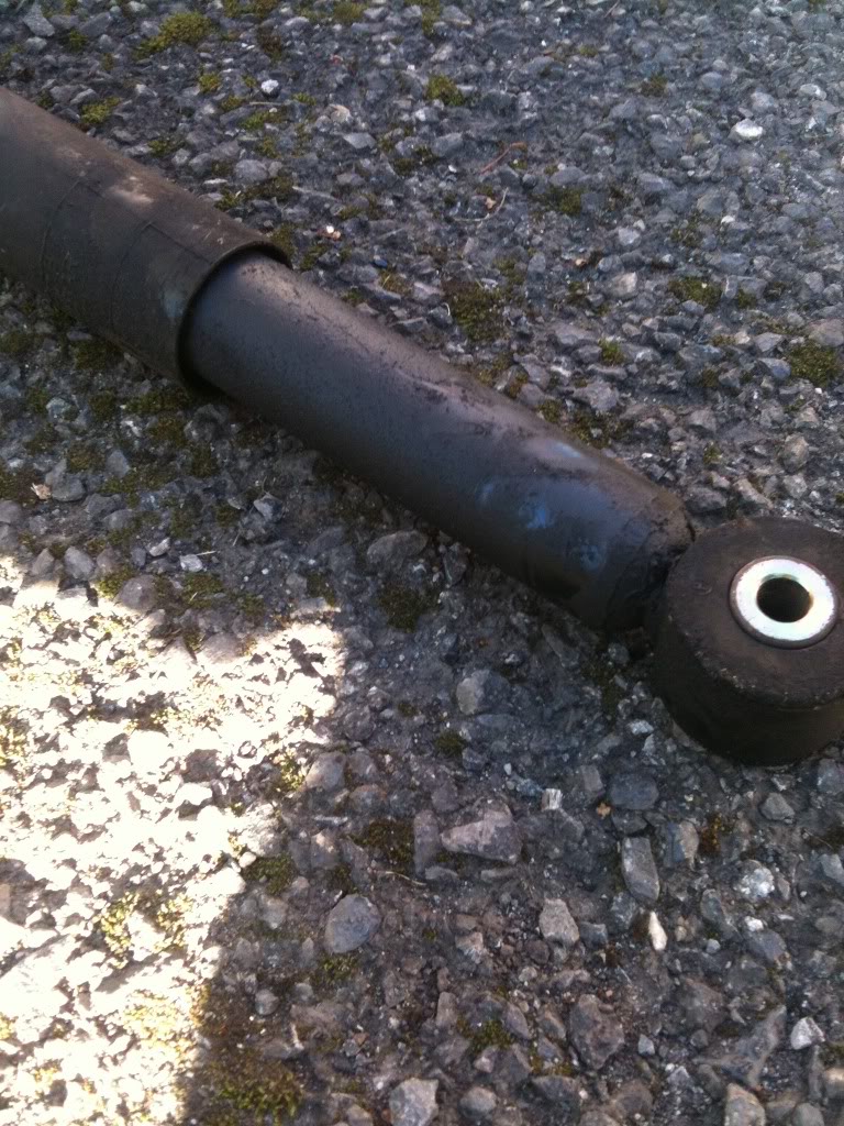

3. Offside rear shock absorber has a serious fluid leak.

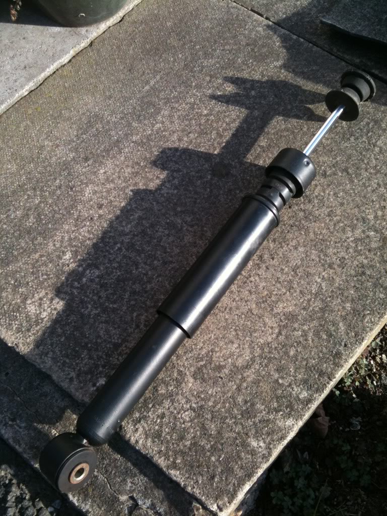

First thing was to replace a rear shocker with one off my PH1.

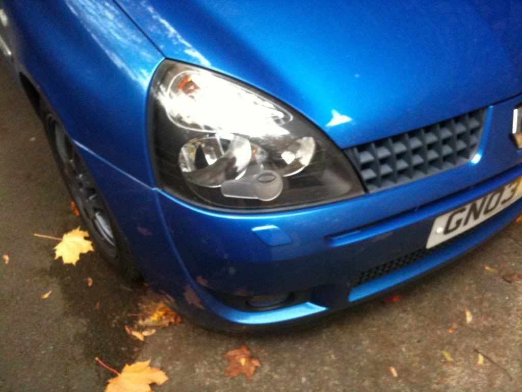

The lights were abit strange, it seemed it had been fitted with LHD lighs so for the time being and to get it through it's test I stuck on some "beam benders".
Not too obvious from a distance.
If some cheap headlights crop up then fair enough but if not I'll hold out for Xenons.

I thought that, but the paint depth on the bonnet doesn't indicate a respray and the little black stickers are still there, which are rarely replaced by a bodyshop. It could have spent a couple of years abroad I suppose. That's if they are left hand drive lights, the MOT station said they'd had similiar readings from cheap ebay bulbs. You can check on the back of the lights normally, if DD is ticked then I think they are UK and if DG is ticked they are left handers. Both DD and DG on mine are blank.

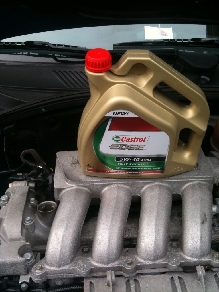

Gave her an oil/filter changer yesterday. Asda are selling Castrol Edge 5-40 for £30 (4l), an extra litre is a tenner.
Bought some Goodyear F1's to replace the Tornado ditch-finders on the front, they are getting a bit scary now the weather has taken a turn for the worse.

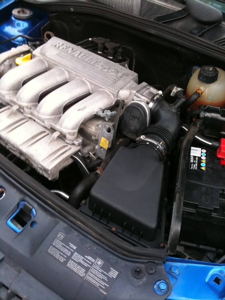

Finally fitted a standard airbox today.
Before...
After...

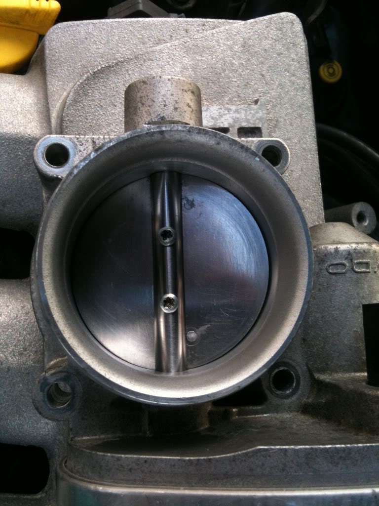

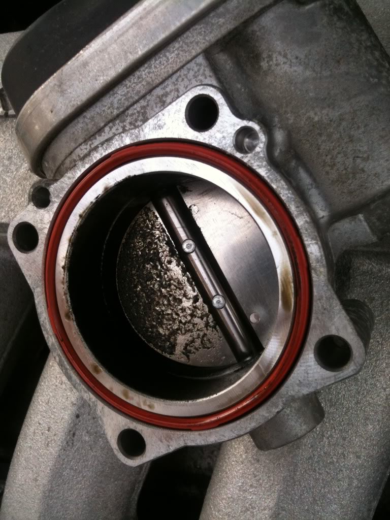

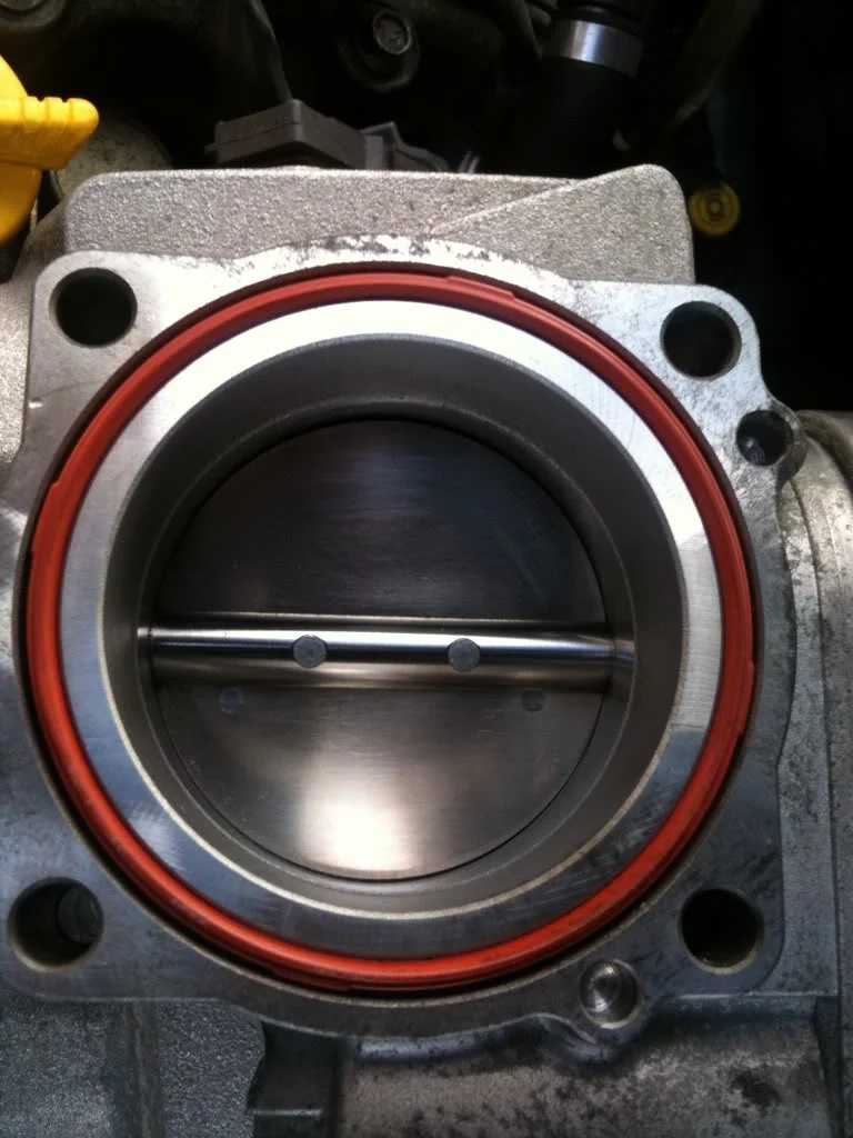

Throttle body looked like this,
So cleaned that up whilst at it.

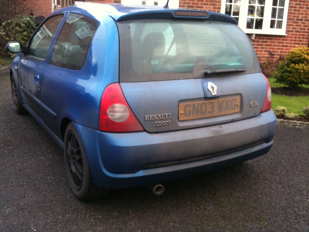

I'd done about 1100 miles in the last 3 weeks since her last clean, so with the weather was looking like this.
3 and a half hours later when it was getting dark it was looking a bit better.
No idea mate, maybe the "PiperX" wasn't doing such a great job as being a filter. Although I do think when I cleaned the throttle body on my last PH2 with 85k on the clock it was in a similar state.
edd... looks the same as my throttle body befor i gived it a clean..

N00b question. Do you have to remove the TB to clean it :o
It's a lot easier to clean taking it off, just dis-connect and take out 4 bolts, will take you 5 minutes max to take off.
yeah as edd saying it so much better doing it this way because you can clean it alot better than if you leave it on...
take 5min to take off also you can see wot your doing.....
at the same time i cleaned my crank sensor and itg panel filter....
