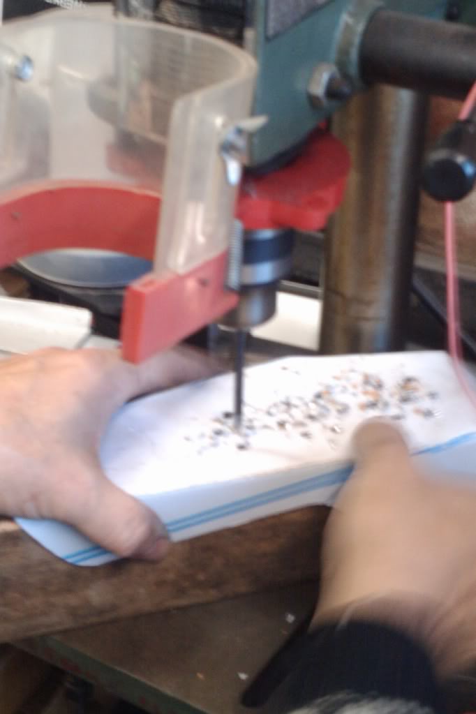

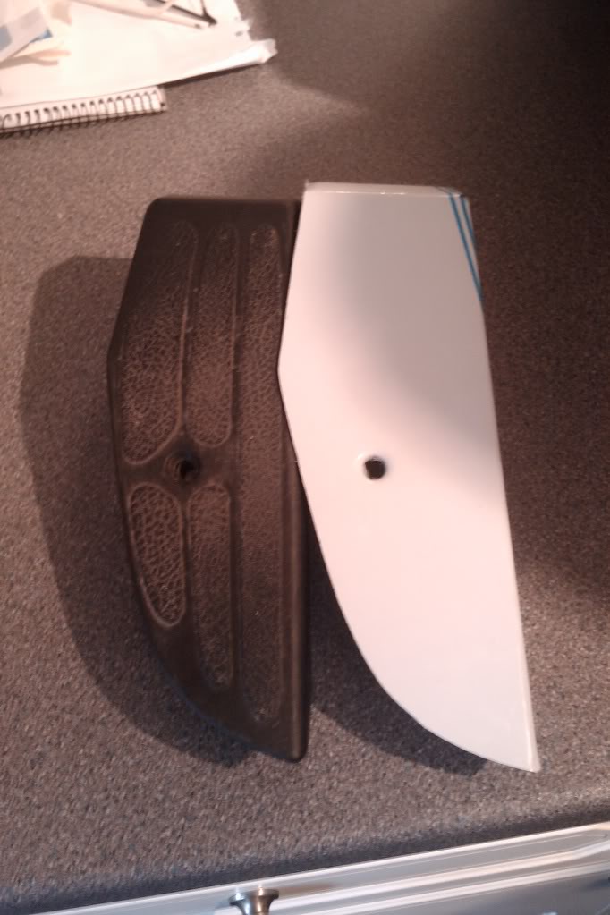

So had a spare hour, so decided to make an ally foot rest to replace the horrible plastic job renault supply.
Heres a little build of it.

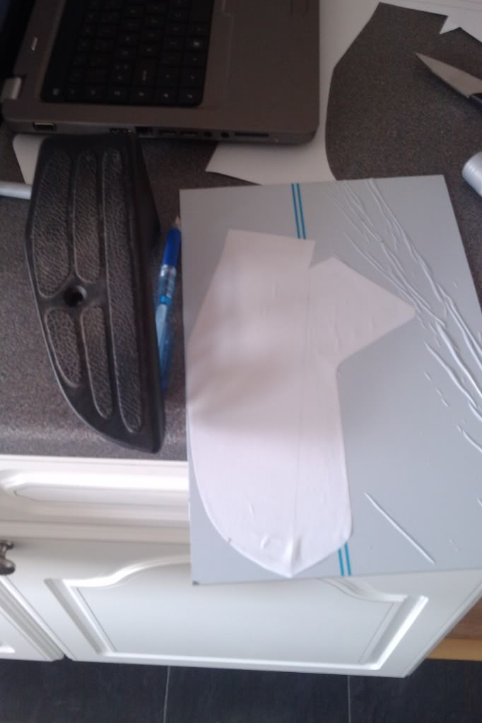

Paper template stuck onto ally sheet.
Cut and formed into shape

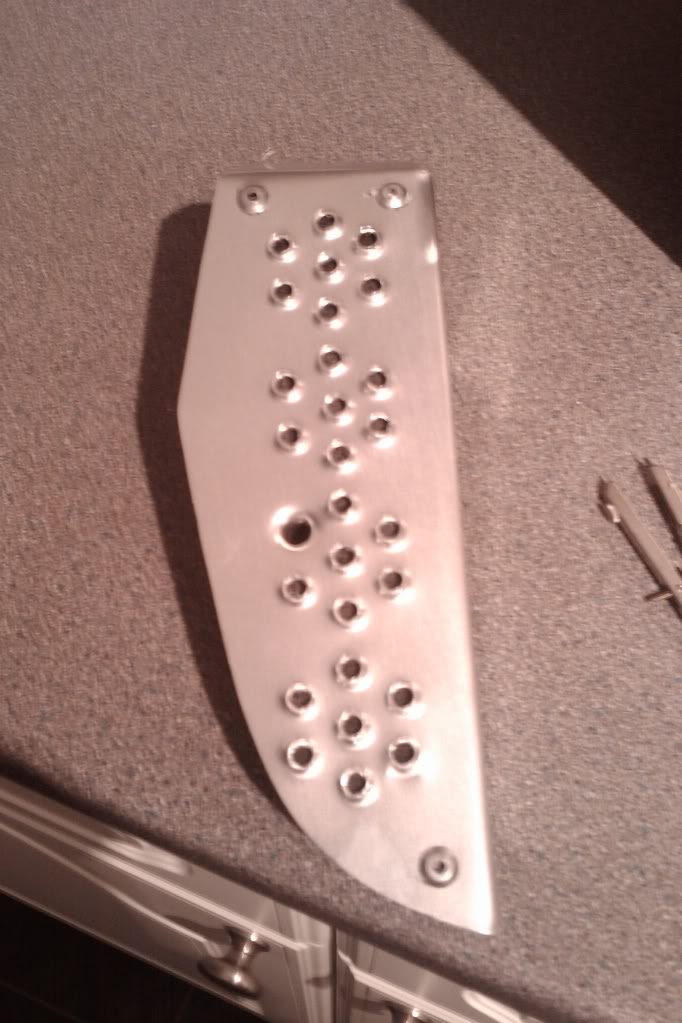

Holes measured to match pattern of the clutch and break pedal then drilled.
Piece of metal with a counter sunk hole so we could tap the holes out to give them shape. Also opposite counter sunk hole so we can retain the screw to fit it back. And then Pop riveted back to the original plastic rest.

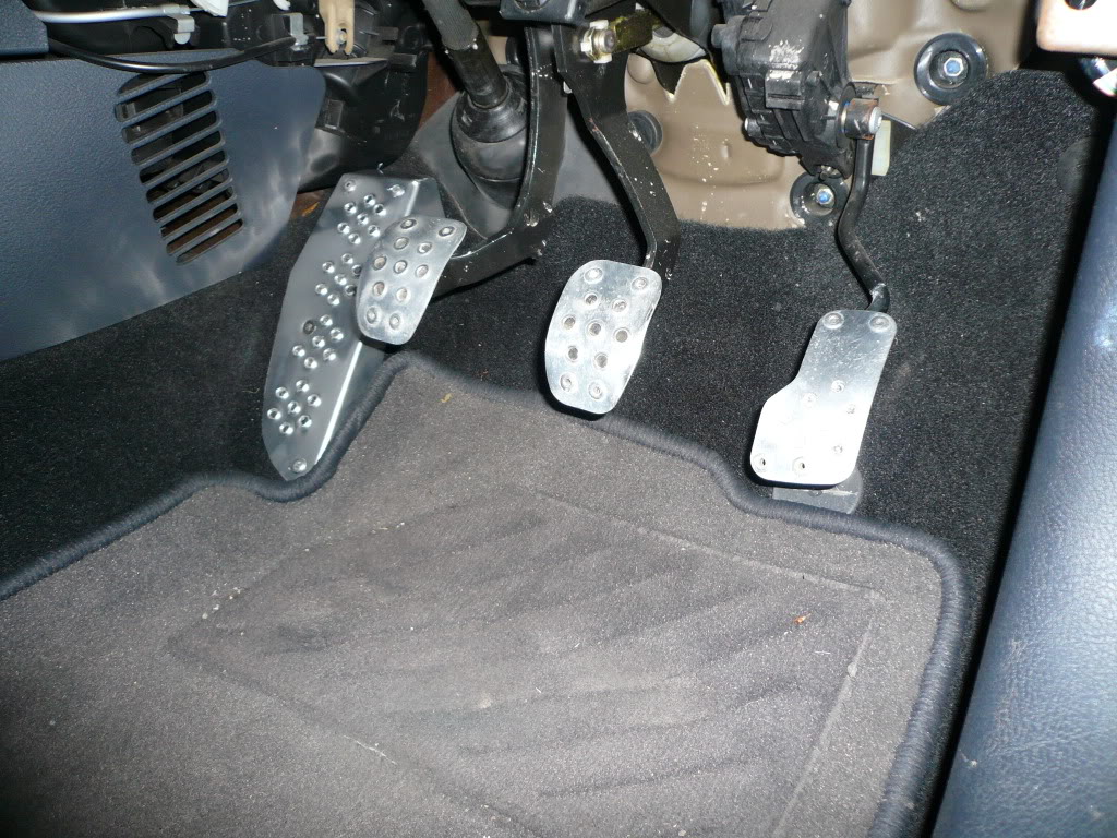

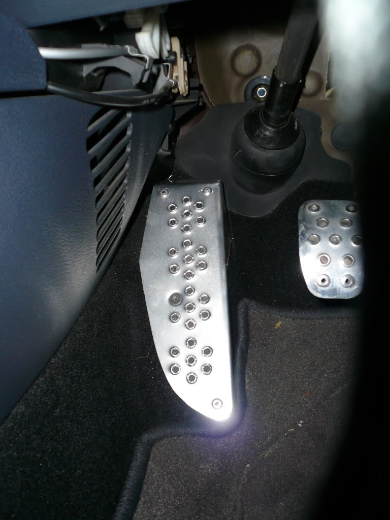

Finished result :cool:
It's going to be Scotchbrite'd to give a brushed aluminium finish then lacquered.
Hope you like and I haven't bored you.

Don't lacquer it!
Leave it exactly as it is and let it wear away like the pedals :)
Either that or just polish the pedals up :)
Could do, but as it's raw aluminium it may end up going white. So I'm going to make the other pedals more presentable :)

Good effort Matt, looks really good matching the pedals.
Needs some of the RS mats! ;)

Thanks, Don't think I'll anodize it, but it definitely needs tidying up a bit, the holes are a bit rough round the edges and after a good polish and it'll be reet!
