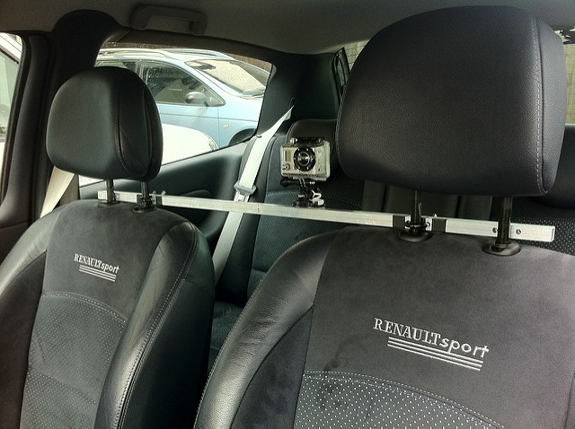

Nice DIY mount, however whats wrong with the sticky back pad mounts you get with the camera? I've got mine on top of the clock on the dash and just fix the camera onto that?
id suggest cutting it in half and using both head rest posts on the passenger seat, if you need to recline your seat or move it for what ever reason you have to mess about with undoing it and repositioning it, i made one like that years ago and found that with half the length and fixed to both head rest posts it was stable enough even for the big ass video cameras.
cheers narf, i did consider only using one seat as the mounting point but i wasn’t sure it would hold steady ... suppose i can always make another half length mount with my left over metal so I’ve always got the option between the two.
