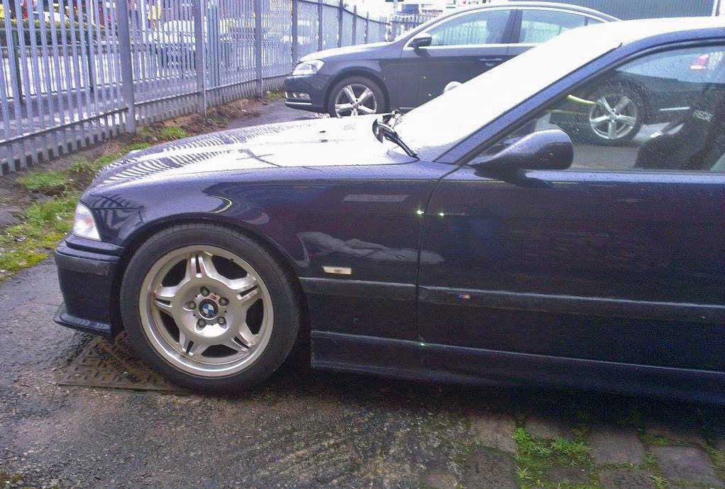

Mine's staying as is. Just gonna tighten up with polybushes and get geometry sorted. It's already dropped 50mm or so. Drives so smoothly I'd just ruin it.

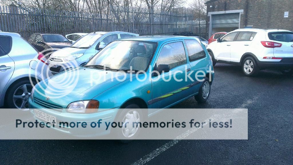

Oh yeah, got a daily.
£250. It's like having a first car again!

Jesus christ. How can you drive round in that. I'd honestly rather get the bus.

It's covered in mud, it'll be reet. As said it gets me to work. My commute is approx 20 minutes doing 30mph and 40 minutes sat in traffic. It's going to save me a s**t load. Even taking insurance/tax into consideration.

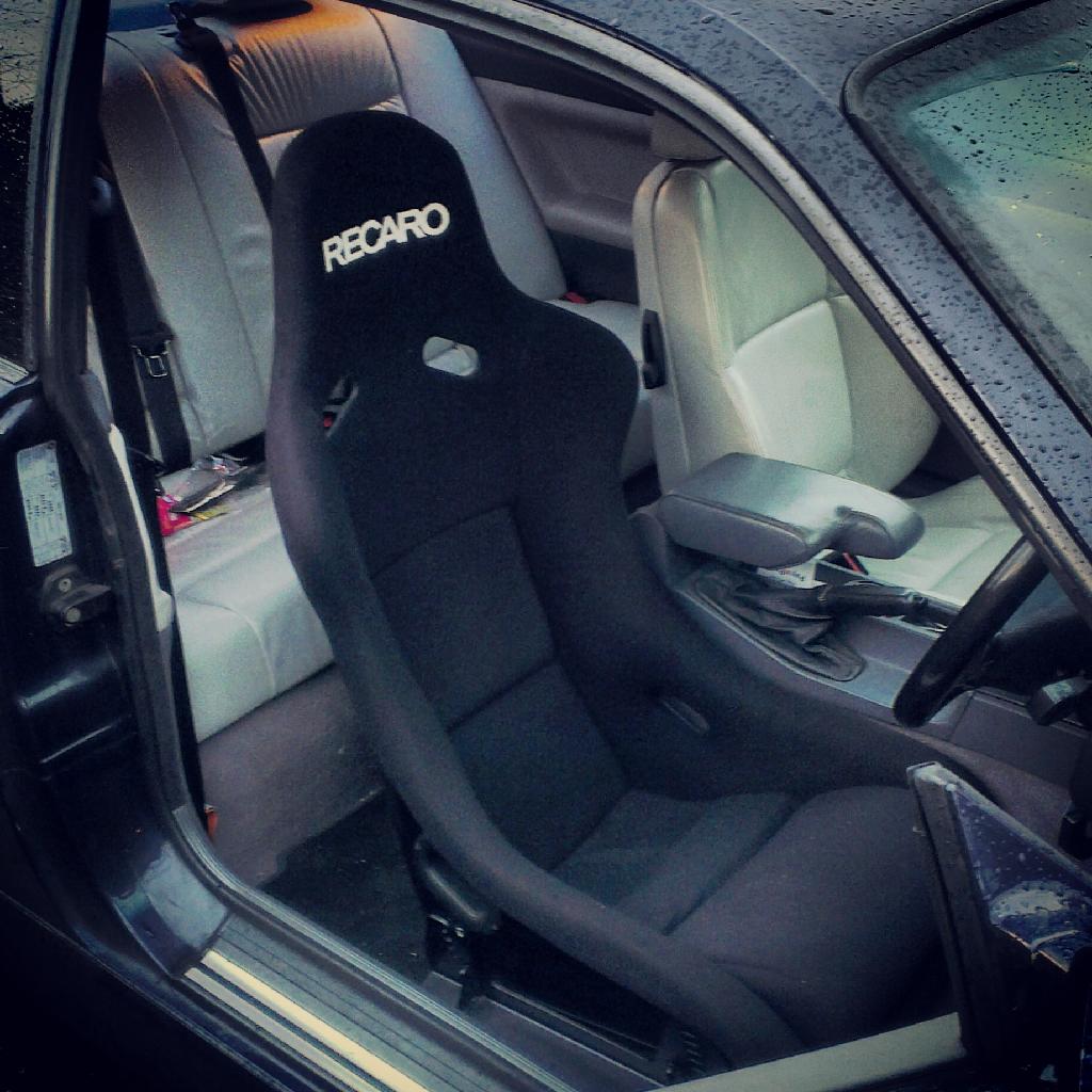

It's too wide. It didn't occur to me that DriftWorks might not have accommodated wider based seats with their mounts, so I've got some chopping to do. Also triggered the airbag light, so that's going to need sorting. FML. Looks good though.

I'd have left the luxurious leather one in to be honest until you found a matching one... But then again it's not my car! I love reading the E36 threads, I would love a tourer!
Couldn't quite believe how much the leather seats weigh. It's ridiculous! No point in waiting, I'm not going to benefit in any way - not a daily anymore.
They weigh a TONNE, absolute joke really. Very good for cruising about but anything else just no!
Had the same seat in mine but I'm just used to really deep ones for track day driving so did a swap. Was a really good all rounder though!

I've raised the front end - I liked the way it looked, but ultimately it drove like s**t. (sits ever so slightly lower than this on a level road)

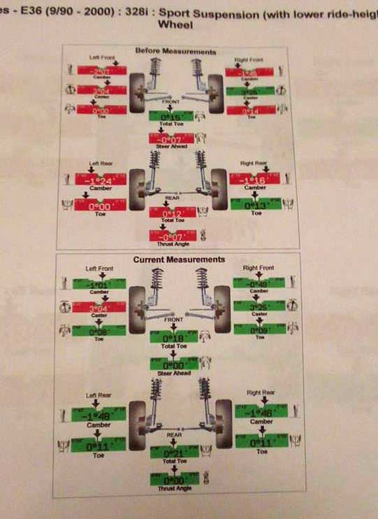

Took it for a geometry setup, was surprised how bad the rear end was considering I'd not touched it and I've not slid it into a kerb. Previous owner must have been talking s**t when he told me he'd had it aligned...

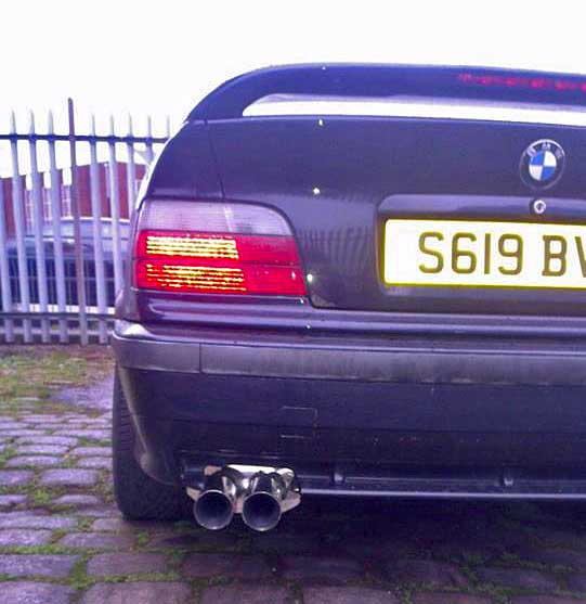

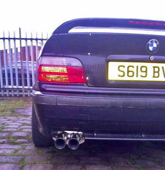

And fitted a cheapo exhaust that doesn't fit right. Sounds good though. And it's light! (Will try and make it fit better at some point - it's against the rear subframe near the diff at the moment, yet it needs to go further towards the diff to make it sit right in the bumper. Odd one.) Also it's far too shiny, so I'll probably spray the box in VHT black paint. Horrid looking thing!
Also, the Recaro is in properly and is AMAZING. Seriously best seat ever.

£140 IF NOTHING's seized? I rang them and they said they couldn't do mine as the arches hang over the rear tyres.
Yeah, something like that. Jon.G and another friend have had their 3-series set up there so can vouch for their work - they know what they're doing! I imagine that'll be because they can't fit the alignment gear onto the wheel. Raise it up a bit ;)
I think if you just want the toe adjustments doing it'll be much cheaper. Mine included camber and them setting the height so it adds to the cost

taking it to the garage on the locks to get it powerflexed front and rear. will ask if he can have a go at freeing bits up so i can take it to grinspeed or blink motorsport
Mine used to touch the stud (front of the rear subframe), i ended up bending the pipe out of the way in a press. This was soon resolved when I swapped the studs for the E90 bolts to hold the subframe in place (dont stick down in the way). I've swapped to the stock backbox now anyway so its not a problem anymore... but seems to be a common thing with aftermarket ones!
£140 Isn't that bad. I guess some of it depends on the design of your suspension. The camber plates on the front of the E46 are a bit crap, so the damper had to be unbolted every time the plate needed adjusting. Obviously this added to the cost. Same as the E36 (and probably most cars)
I'm sure Joe will agree that the drive difference is night and day after its been properly set up, as with any car.

Yeah guess that's why I've been really struggling to get a concrete quote for my e36.
Really annoying though, I like to be able to budget!!
I think it's actually against the subframe, so I'm going to have to bend it somehow. Need to take a better look at it tbh. It's odd, because it's pressed against the other side of the bumper, so it's like they've not bent it enough when it was made...
