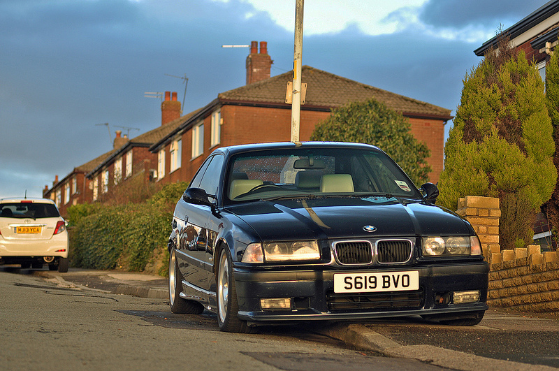

Clear indicators & 15mm spacers added.
Really unsure whether to bother putting on the rear 'coilovers'. The gap between the arch and tyre is fairly similar as it is now, so I'm not sure there's really much point... Also possible awesome seat content on the way...

I'd say get the rear coilies on though! I know you don't use it on track but mis matching suspension doesn't seem a grand idea to me.
What suspension is on the back? looks a lot like how mine sits with eibach pro springs.
Bilstein dampers with eibach springs. So yeah, it'll be similar. And I'm hoping to track it eventually, but I'll be investing in some better suspension when that happens. This is pure daily spec at the moment, need to buy a shitter for my commute to work so I can start making this thing proper!
How does it get along then as a daily being that low?
I'd like mine to sit similar in the future, but don't want to be scuffing sumps!
It's fine. Only issue I've ever had was yesterday when I ran over a large rock (no chance to avoid it). It made a lot of noise, hit a load of s**t underneath but the sump was untouched. As Jord said, other stuff would hit the ground first. Main issue is the tyres coming into contact with the wings tbh. Only happens on the passenger side now I've reduced the spacer size, and that's only because I've not added enough negative camber. Speedbumps etc are a non-issue!
Stuff hits the chassis rails and exhaust first, sump is plenty safe enough!
Cheers!
Are your wheels genuine M3 ones? I was told the sport BBS would sit fine with 15mm spacers and no rubbing, surely the sizes can't be that different?

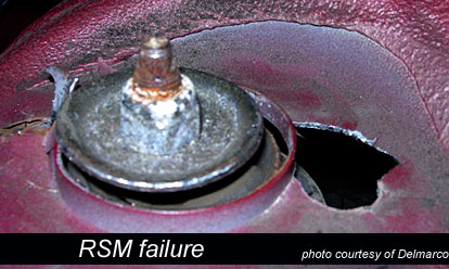

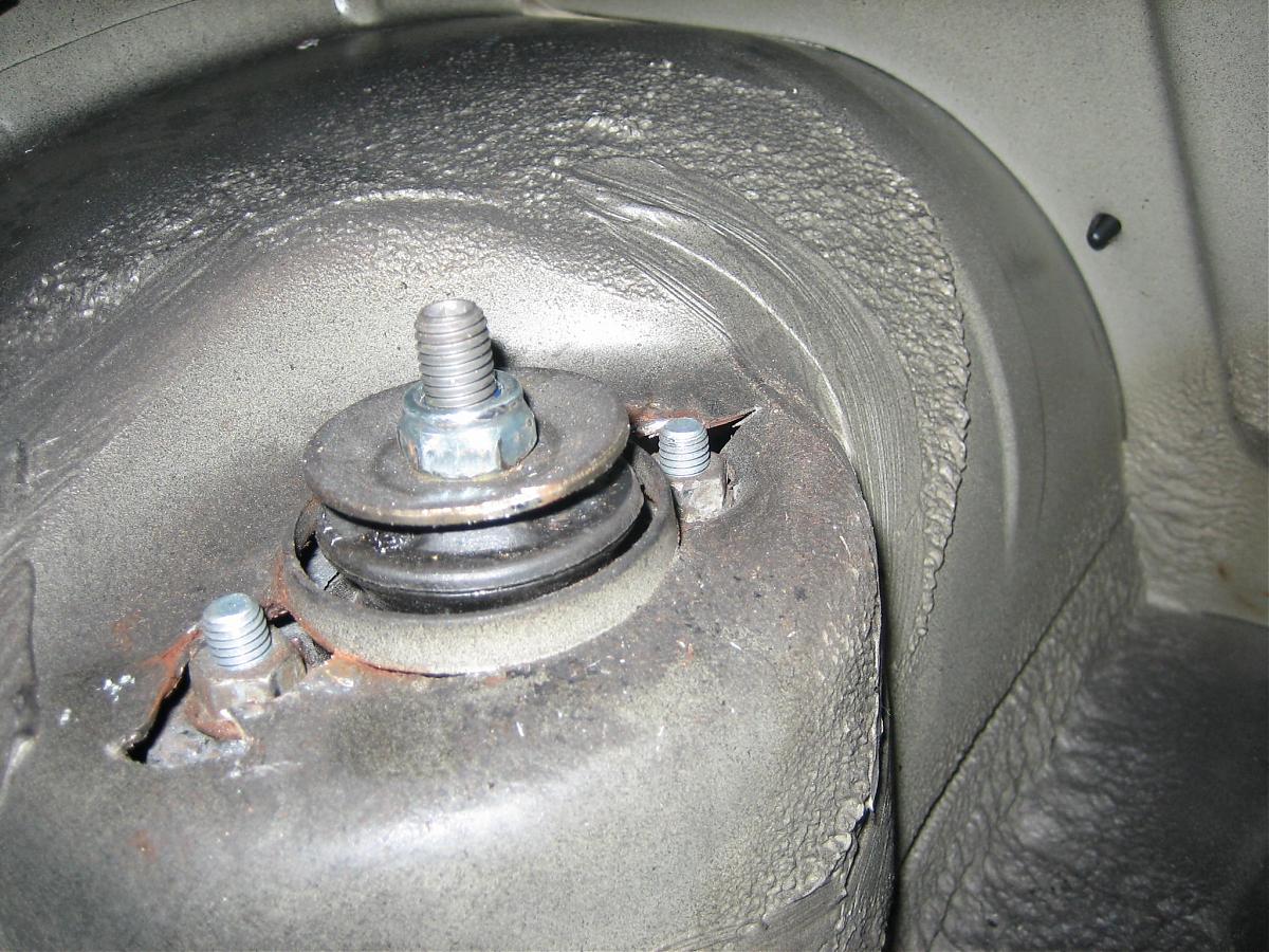

It's probably worth putting the rear coilovers on if you have them! If you're going to do it at some point anyway. If it hasn't already had them you can use that as an opportunity to replace the standard rear top mounts with the e46/z3 ones with reinforcement plates.
Care to elaborate on this mate? What are the benefits?
Apparently the way that the rear dampers are attached (two bolts hold the strut in from the underneath) puts lots of stress on the sheet metal that the bolts go through. Under lots of hard cornering or on a very old car the sheet metal is known to snap:
When the time came to design the Z3/E46 tops BMW changed the design and you can buy uprated ones on Ebay. The uprated ones have a plate that spreads the force more evenly - currently working with my brother on an E36 328i project and for about £14 we thought it was worth it.
I have some Z3 plates on mine and they still aren't really sufficient for heavy track day use IMO. Without them the top mount area would be knackered by now mind! Going to come up with something to weld in to place with more surface area this year.
View attachment 107442View attachment 107443
After seeing those pics I'd be a fool not to, thanks for sharing!
