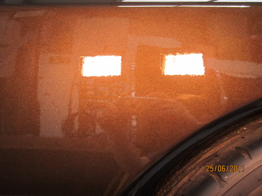

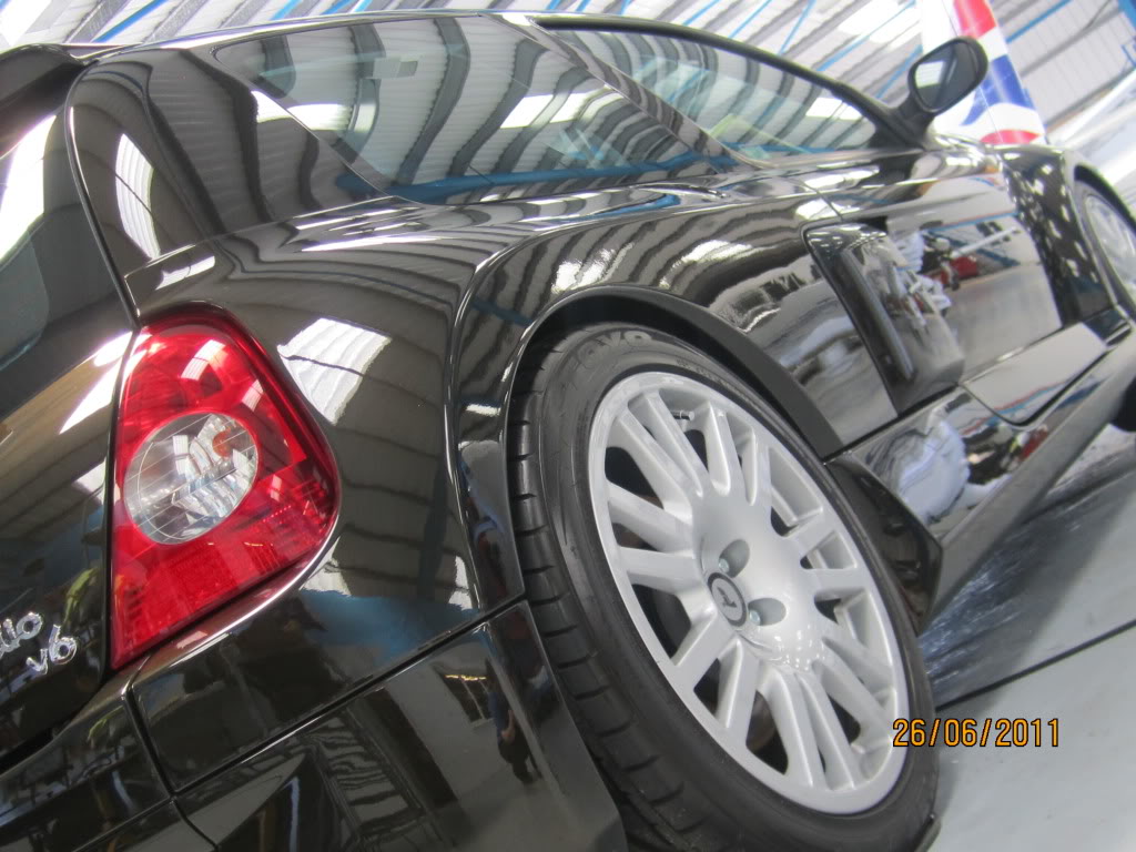

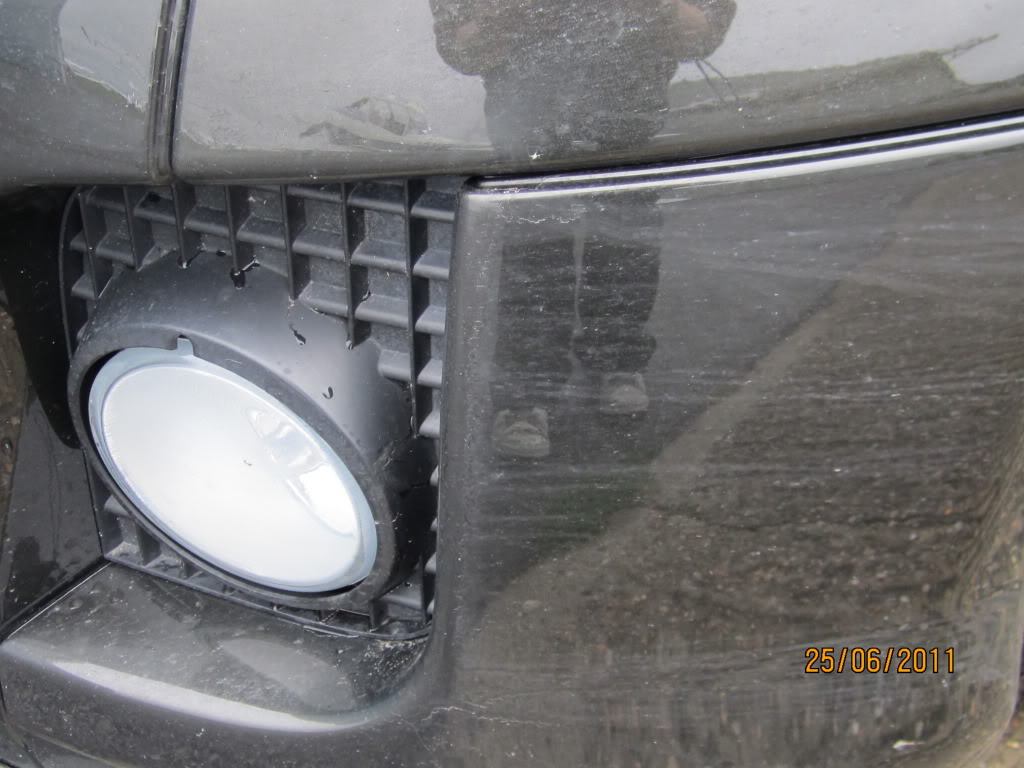

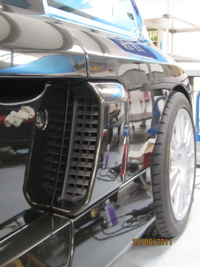

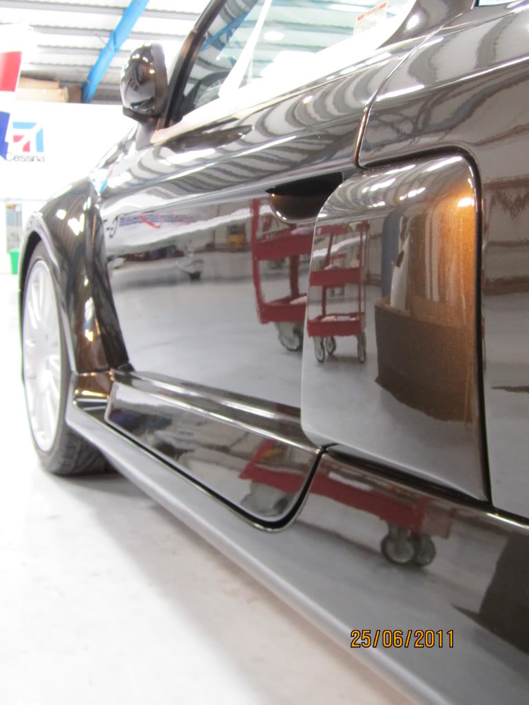

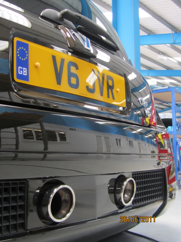

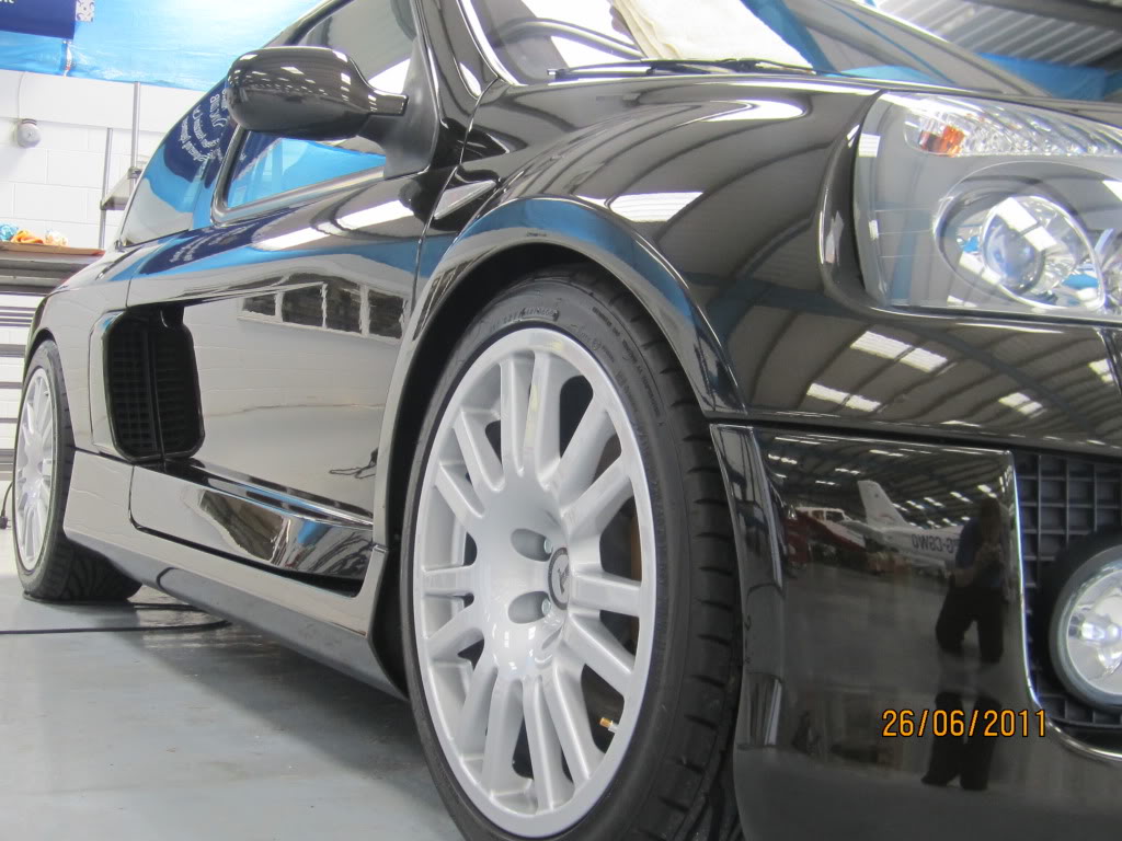

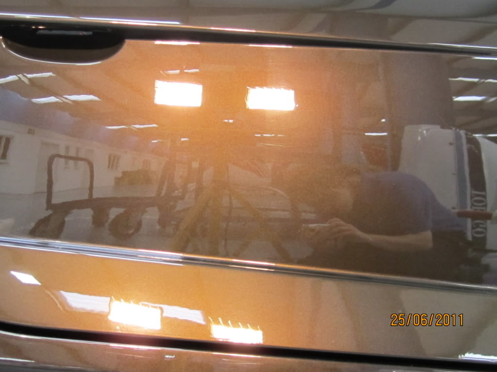

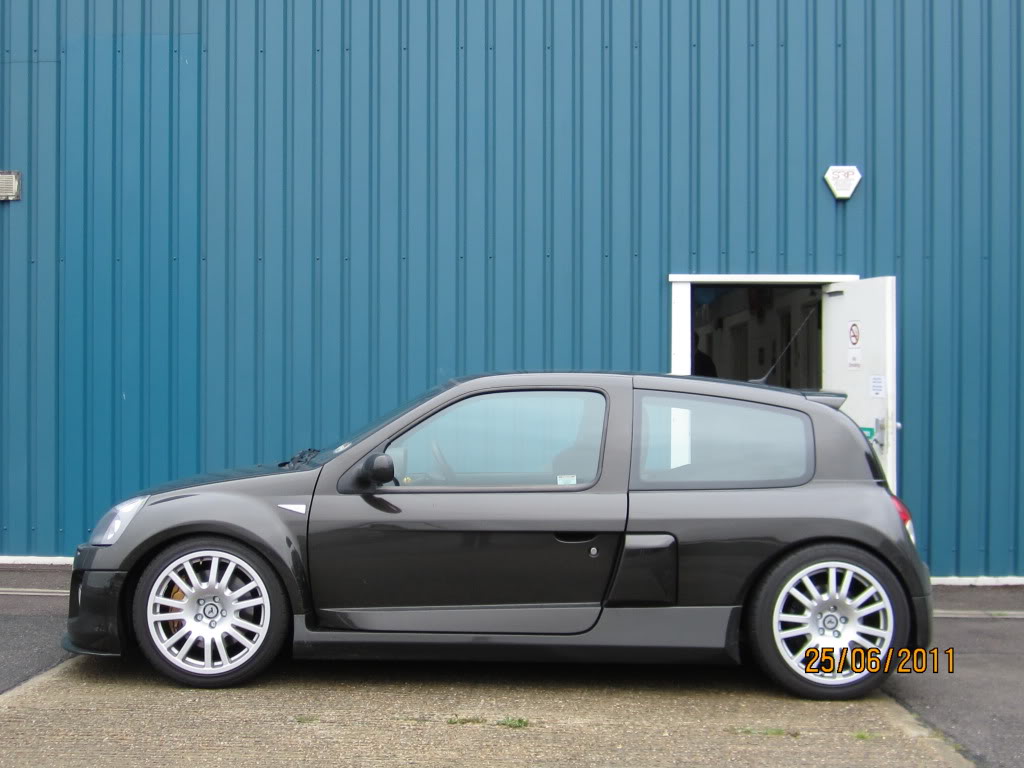

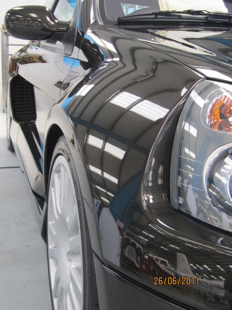

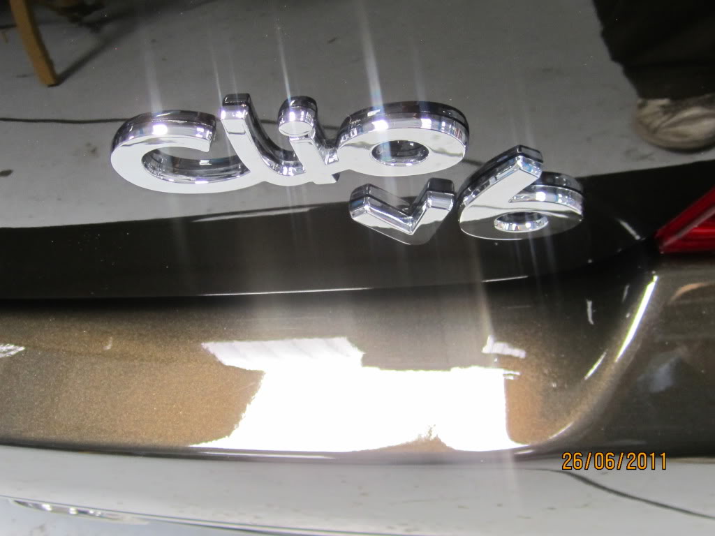

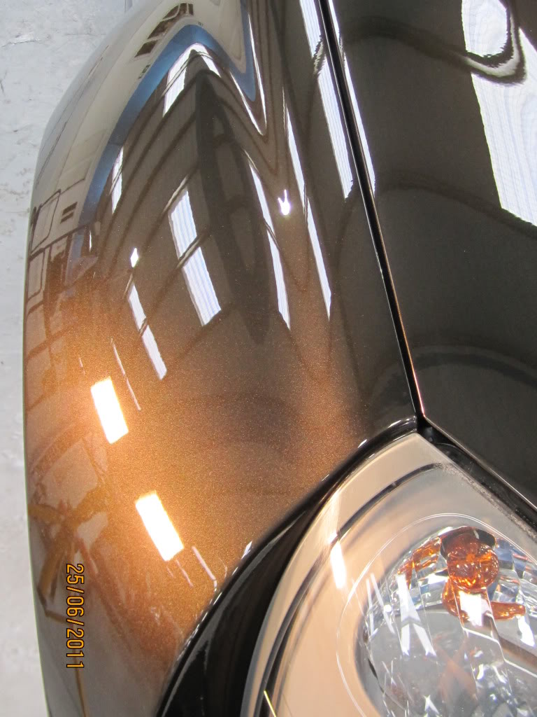

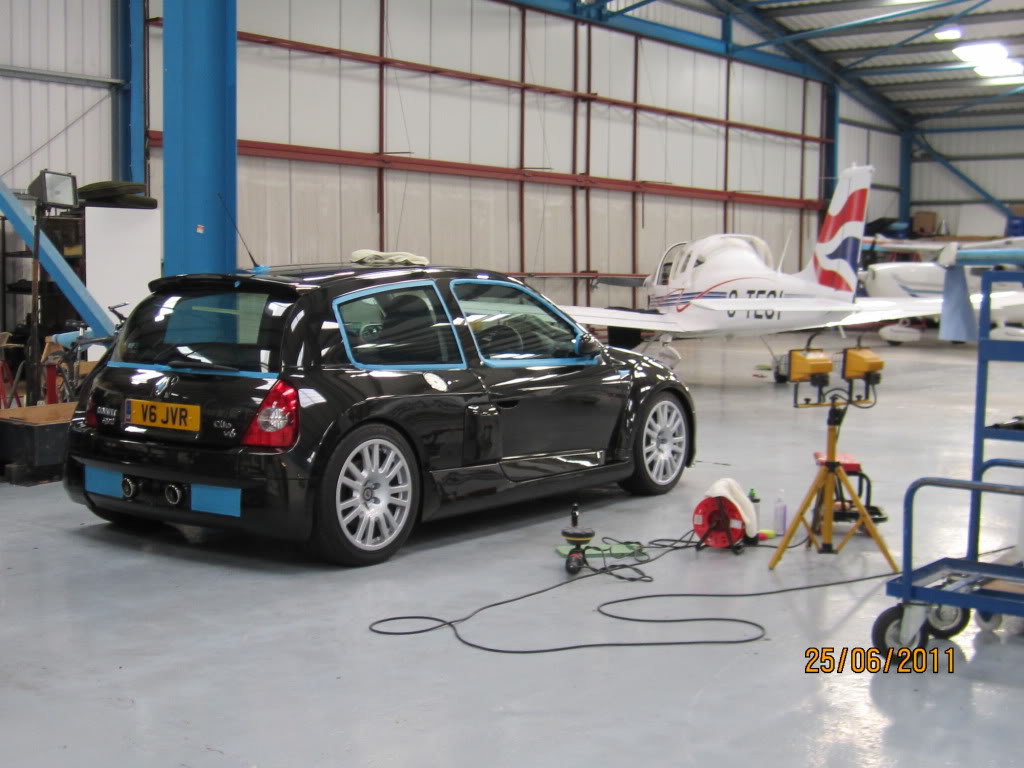

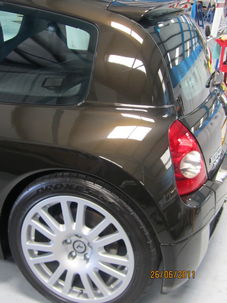

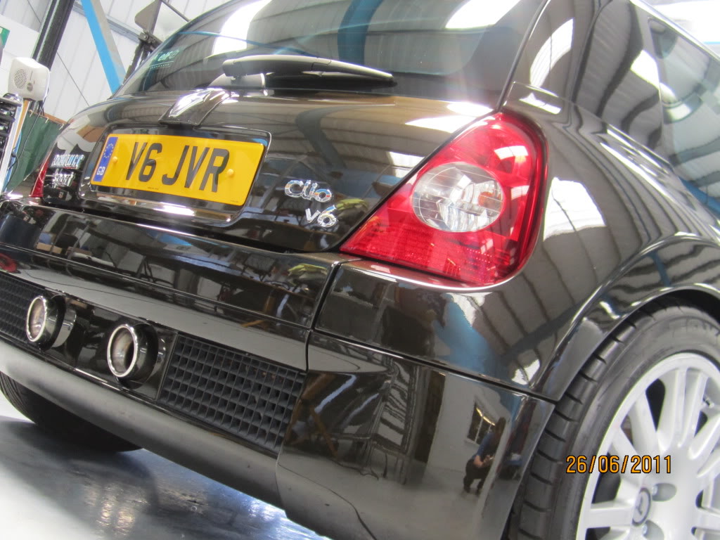

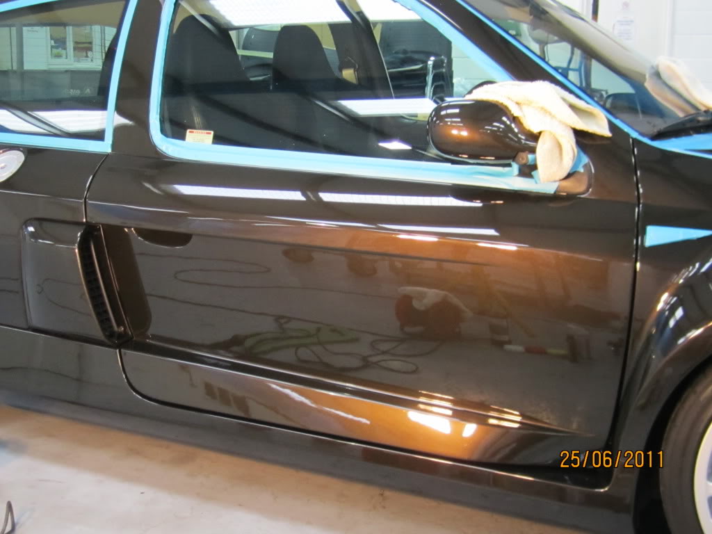

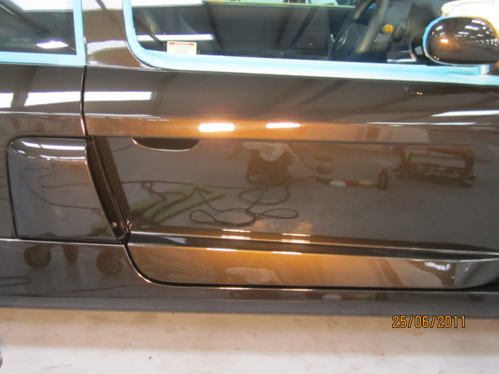

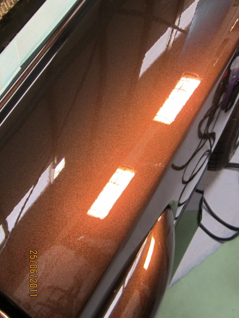

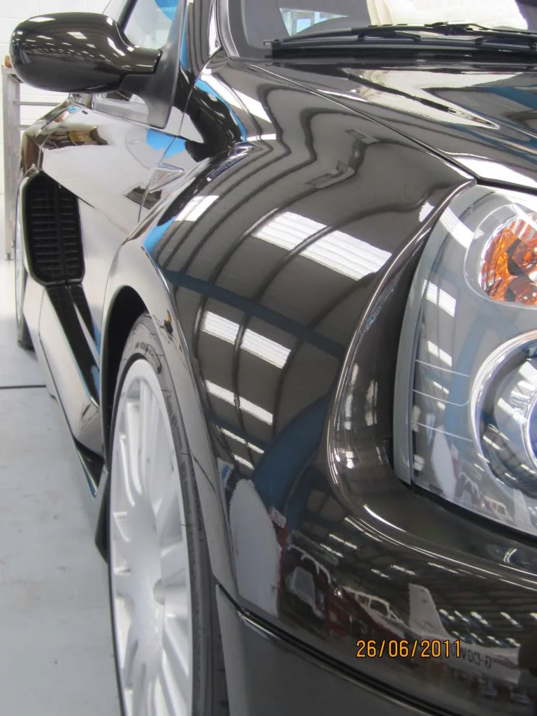

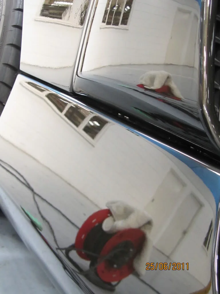

Hey guys, James decided he wanted his vee getting some machine polish love. Love doing his vee, she's perfect! Process over the weekend was -

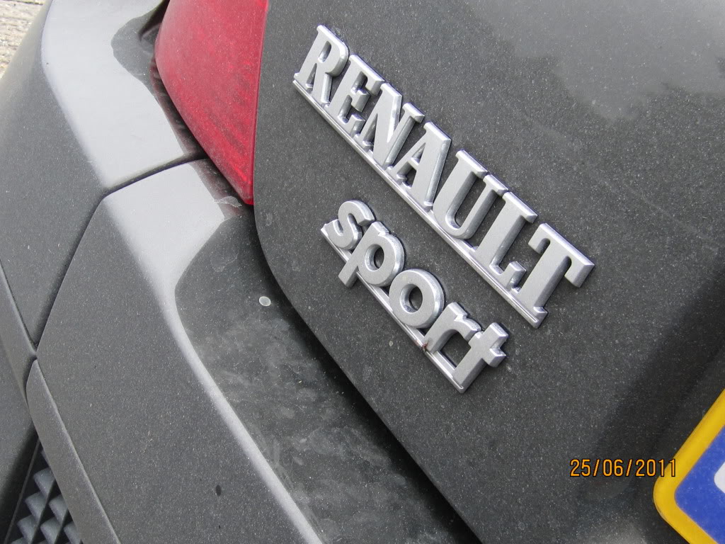

Befores

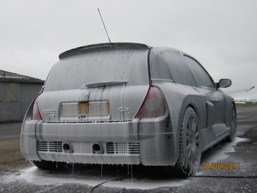

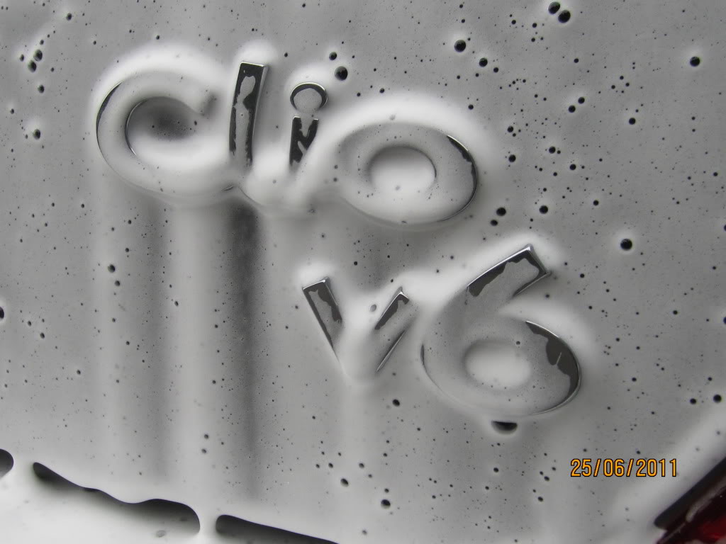

Snow foam mix of G101 & btbm

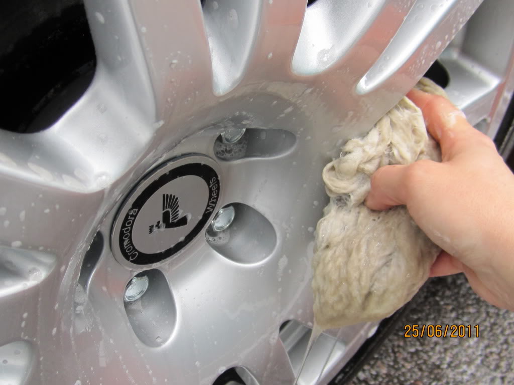

Wheels cleaned with btbm, wheel woolies, Vikan brush & dj mitt
Washed with Carpro wash mitt & btbm
Clayed with Autoglym bar & born slippy (no pics as not much contamination, very clean)
Snow foamed again
Washed
Dried with dj soft touch towels

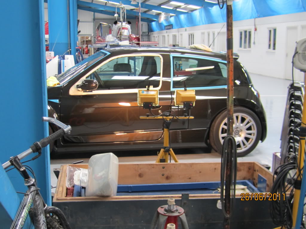

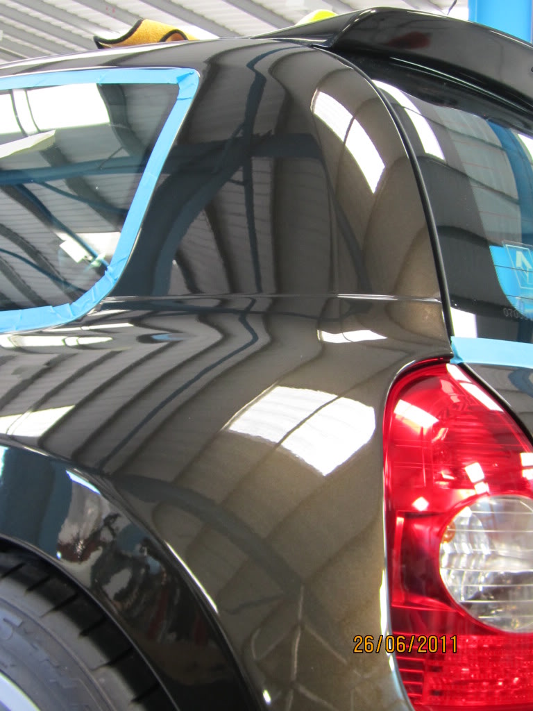

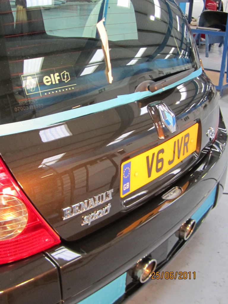

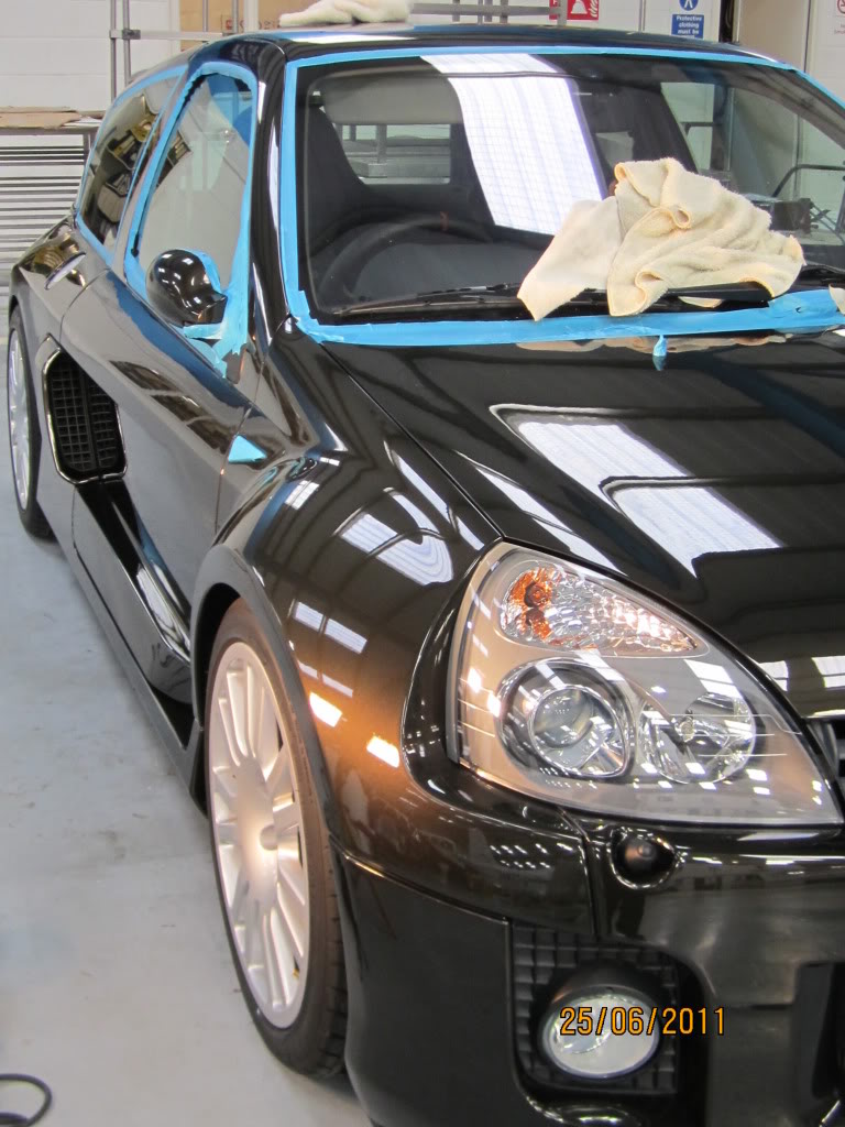

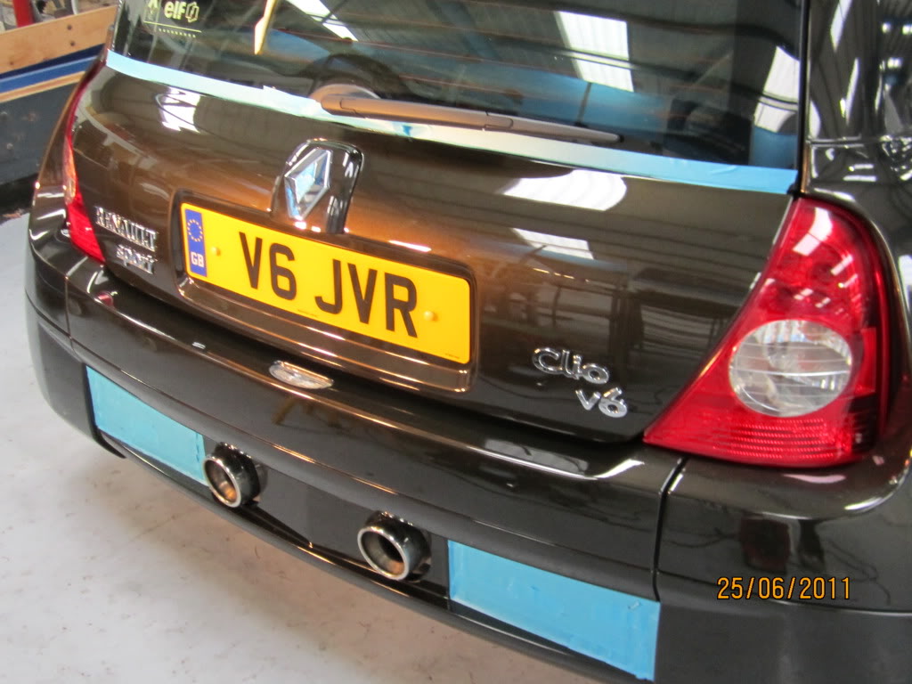

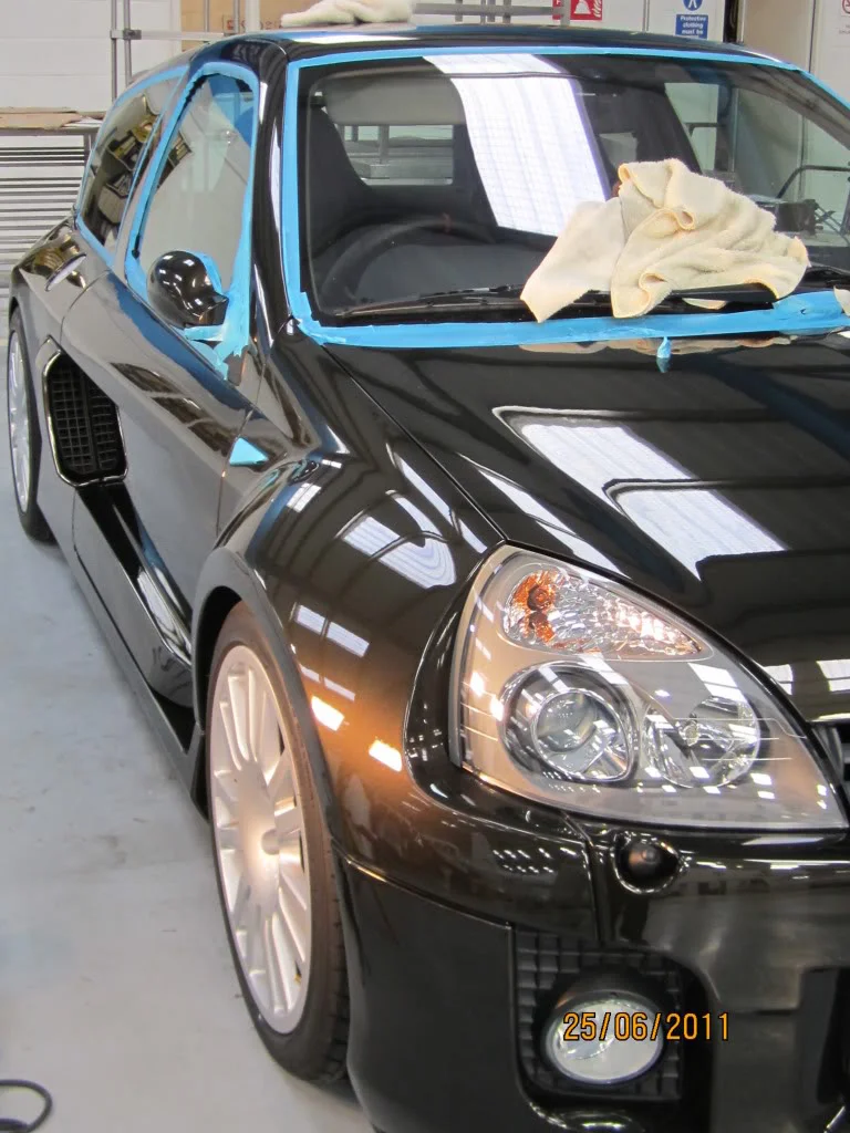

Taped up

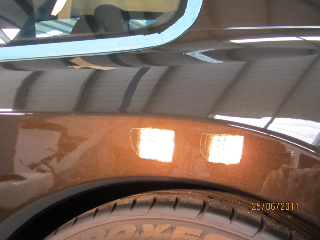

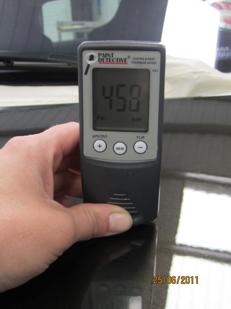

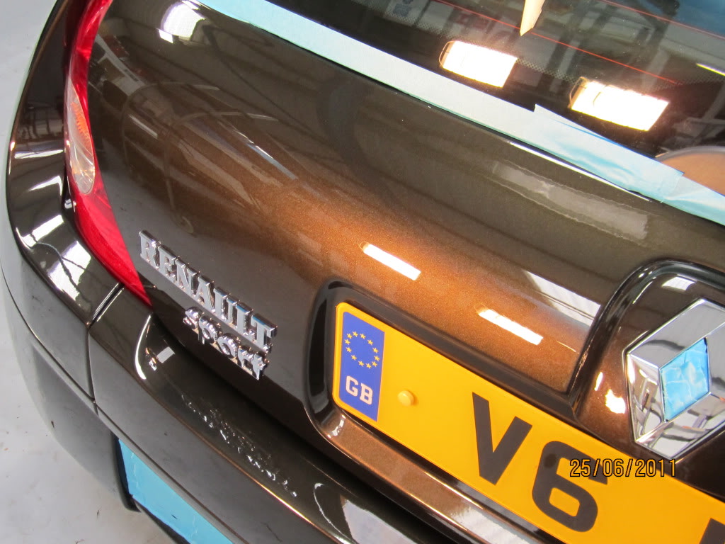

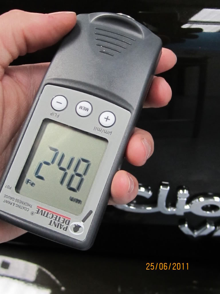

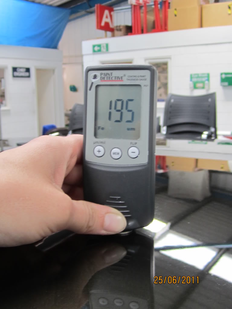

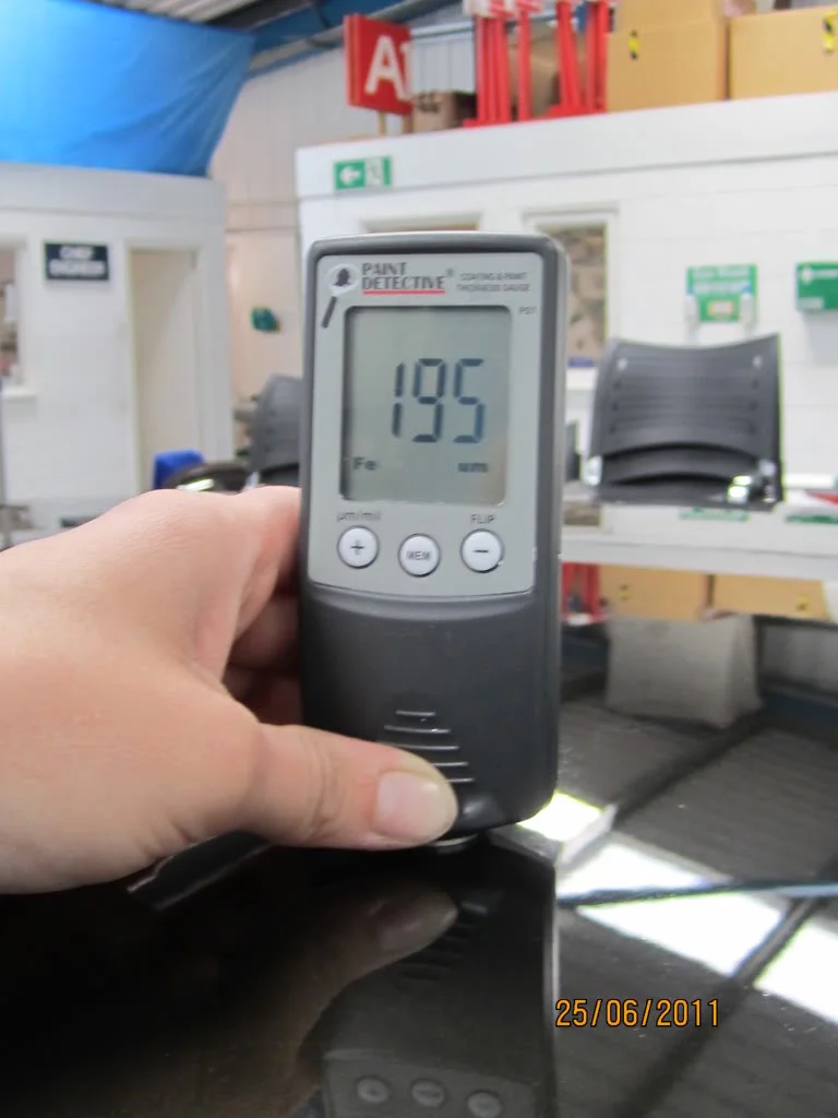

Paint readings taken (front end & bootlid respray)

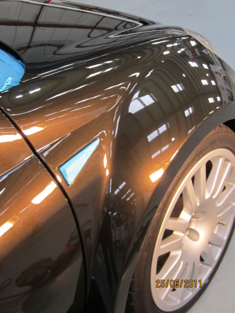

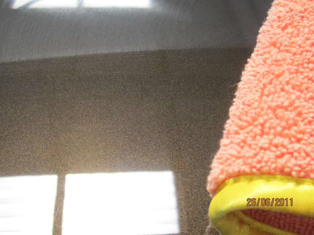

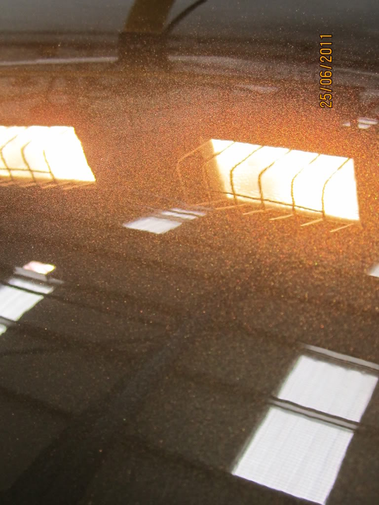

I managed to enhance the paint with 205 with a combo of polishing pads, then went over again with a finishing pad (chicago rotary) No particular order

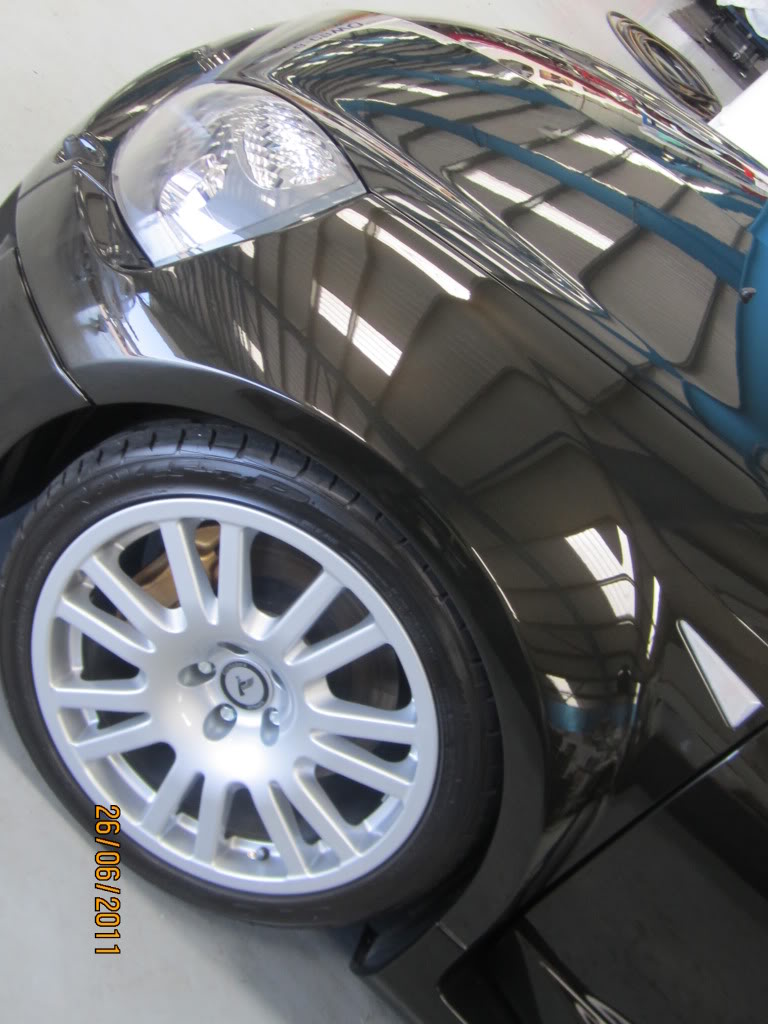

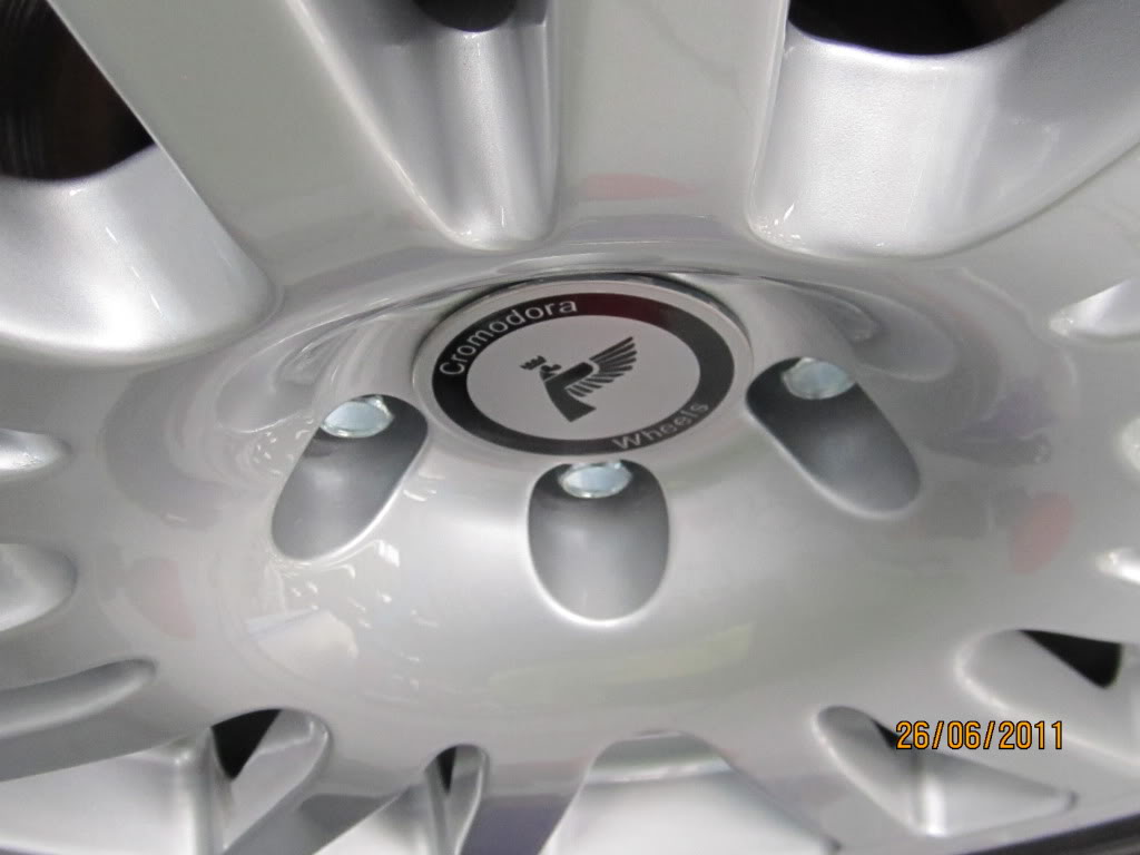

Wheel faces polished with a polishing spot pad & 205

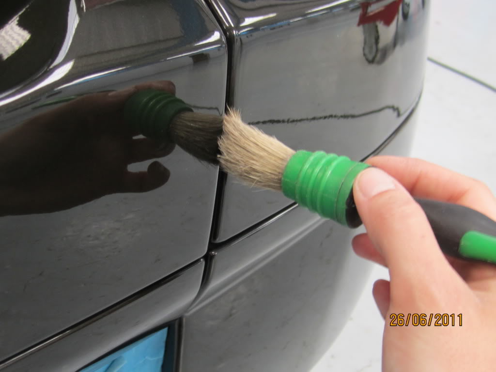

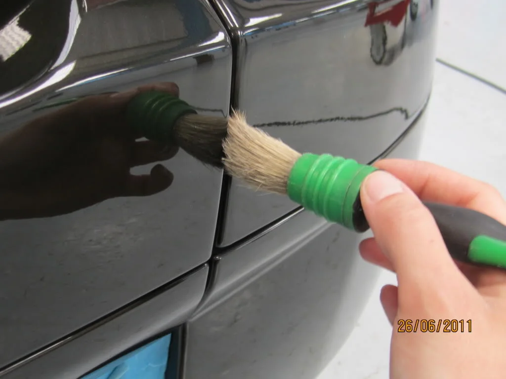

Nooks & crannies lightly brushed
Door shuts 205'd

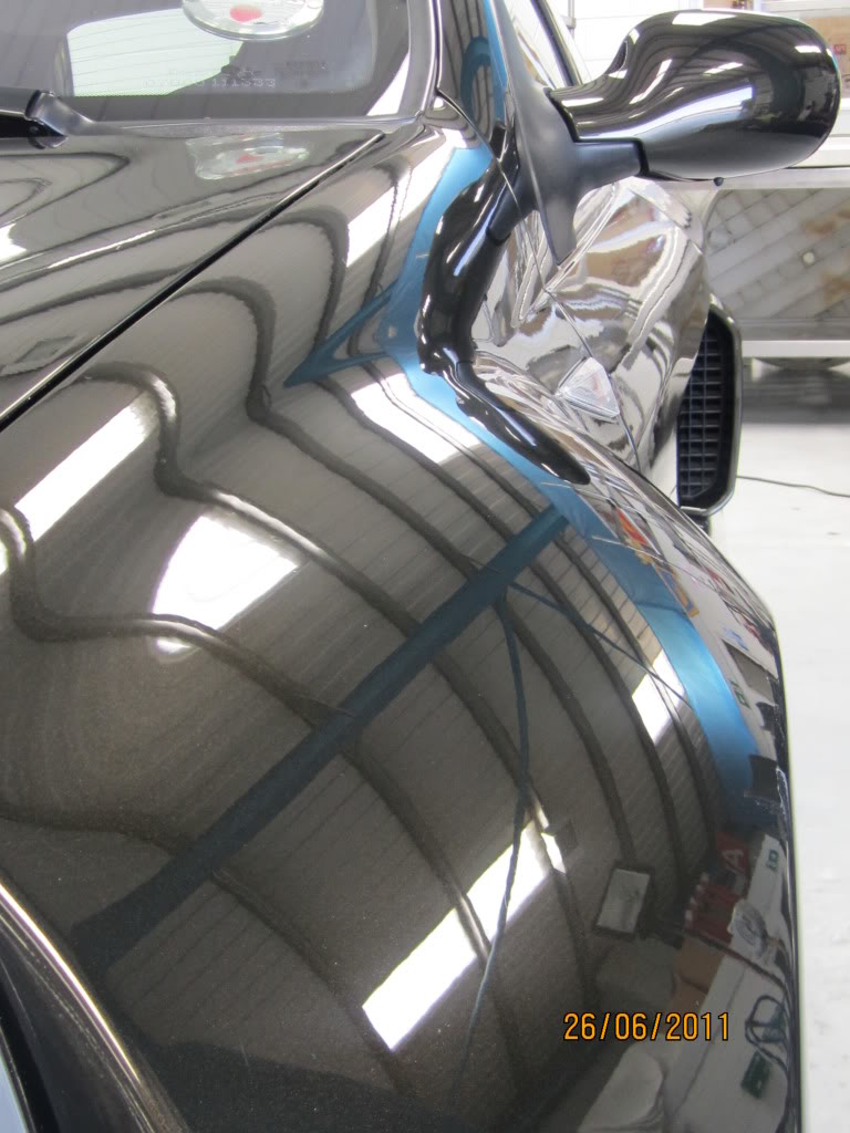

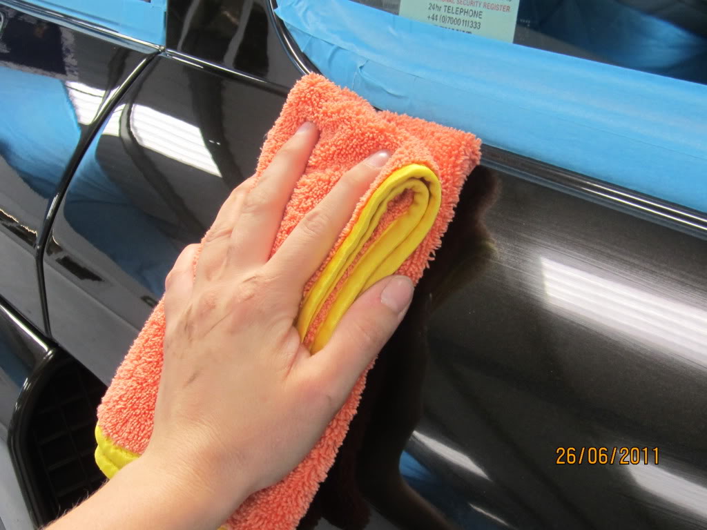

Bodywork wiped down with Gloss it QD

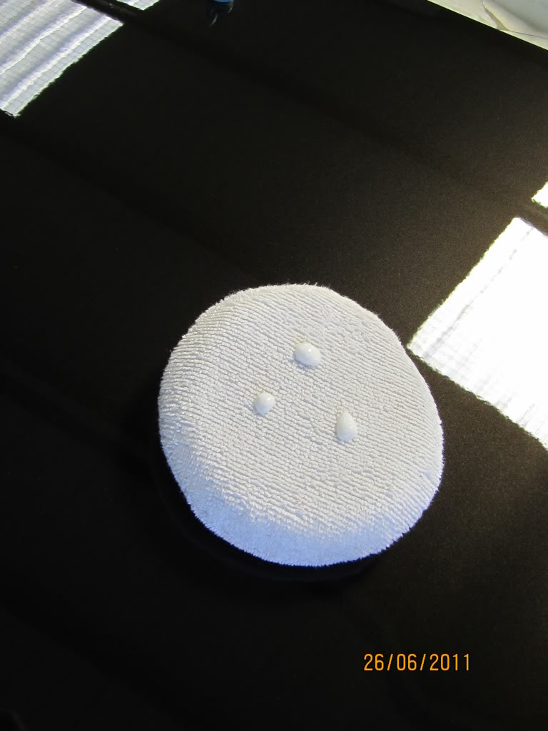

Then applied Blackfire enhancing polish via megs app & left for 15-20 mins
Then I cleaned the windows with dj Menthol
I then applied Blackfire Sealant via lake country app, left for 15 mins
Then I polished me windows with dj Polish
All the tape removed & dusted down
Bodywork wiped down with Blackfire Deep Gloss Spray

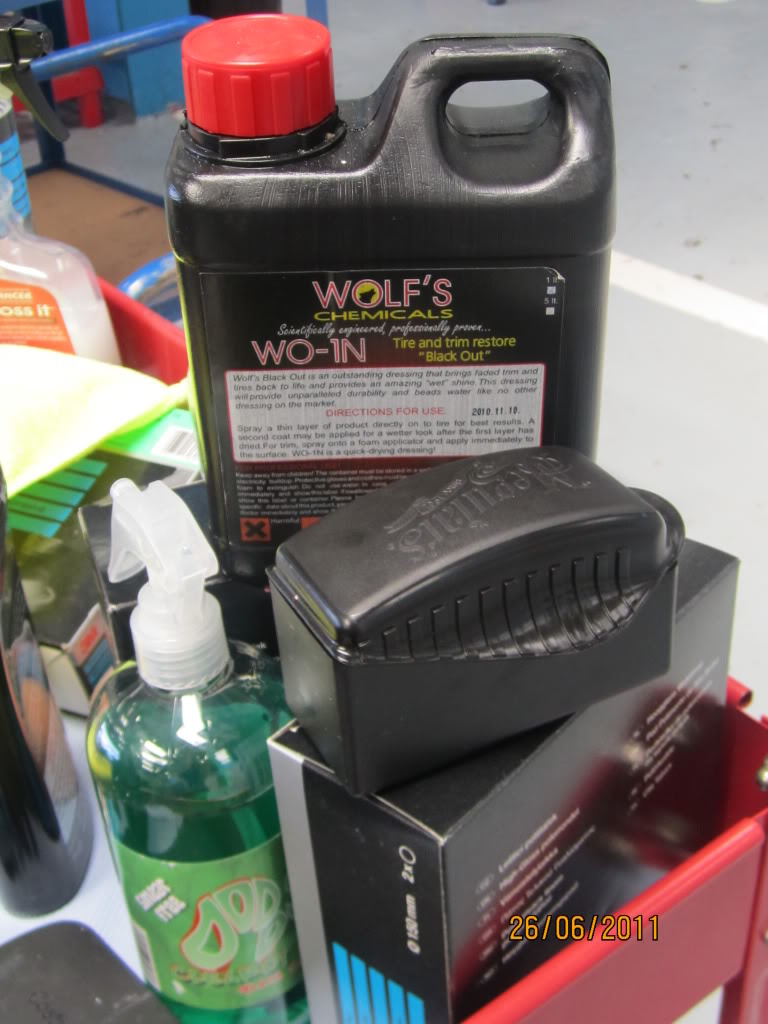

Tyres dressed with Wolfs
Zorsts polished with Autosol
I think that was it! I did want to use Project Awesome topeed with SN Hybrid but I have lost my DA spanner, so I couldn't change backing plates :wall:

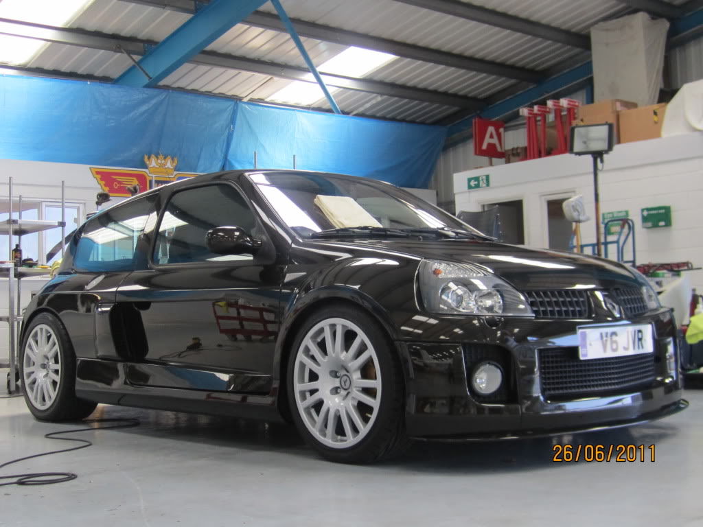

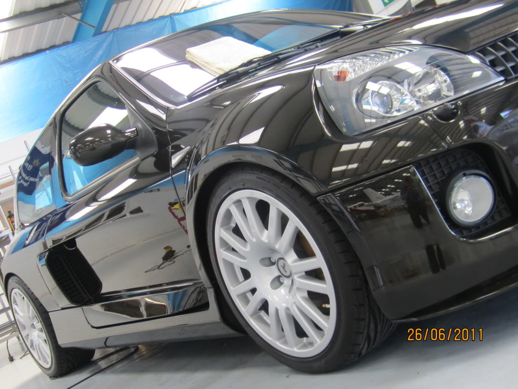

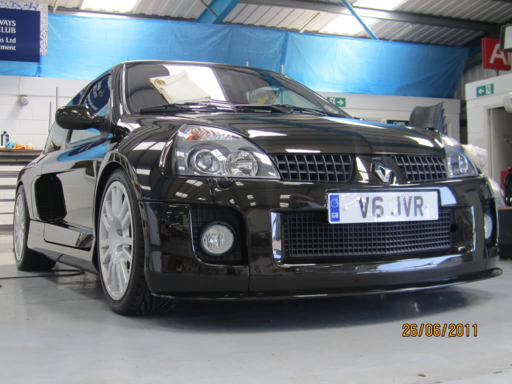

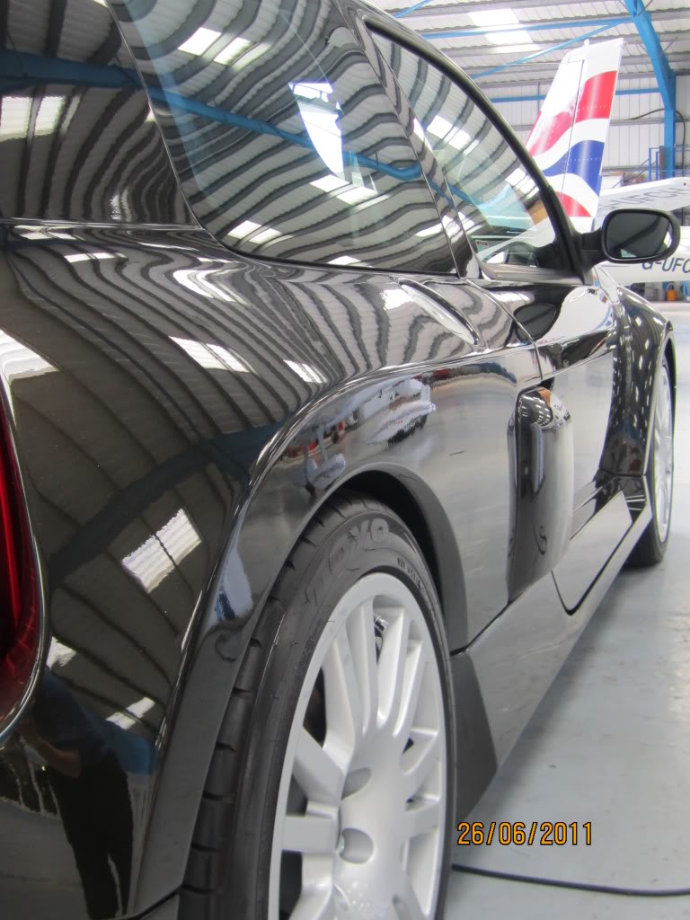

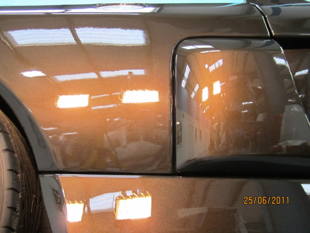

End results & a very happy mate!
Cheers!

458 on the paint dectective? Geez that's alot of paint!
(Very very nice indeed!!!!!)
Very nice, if it had no orange peel it really would be nigh on perfection that colour.
Cheers guys, yup I lol'd at the thickness on the bonnet! Better than none at all!
