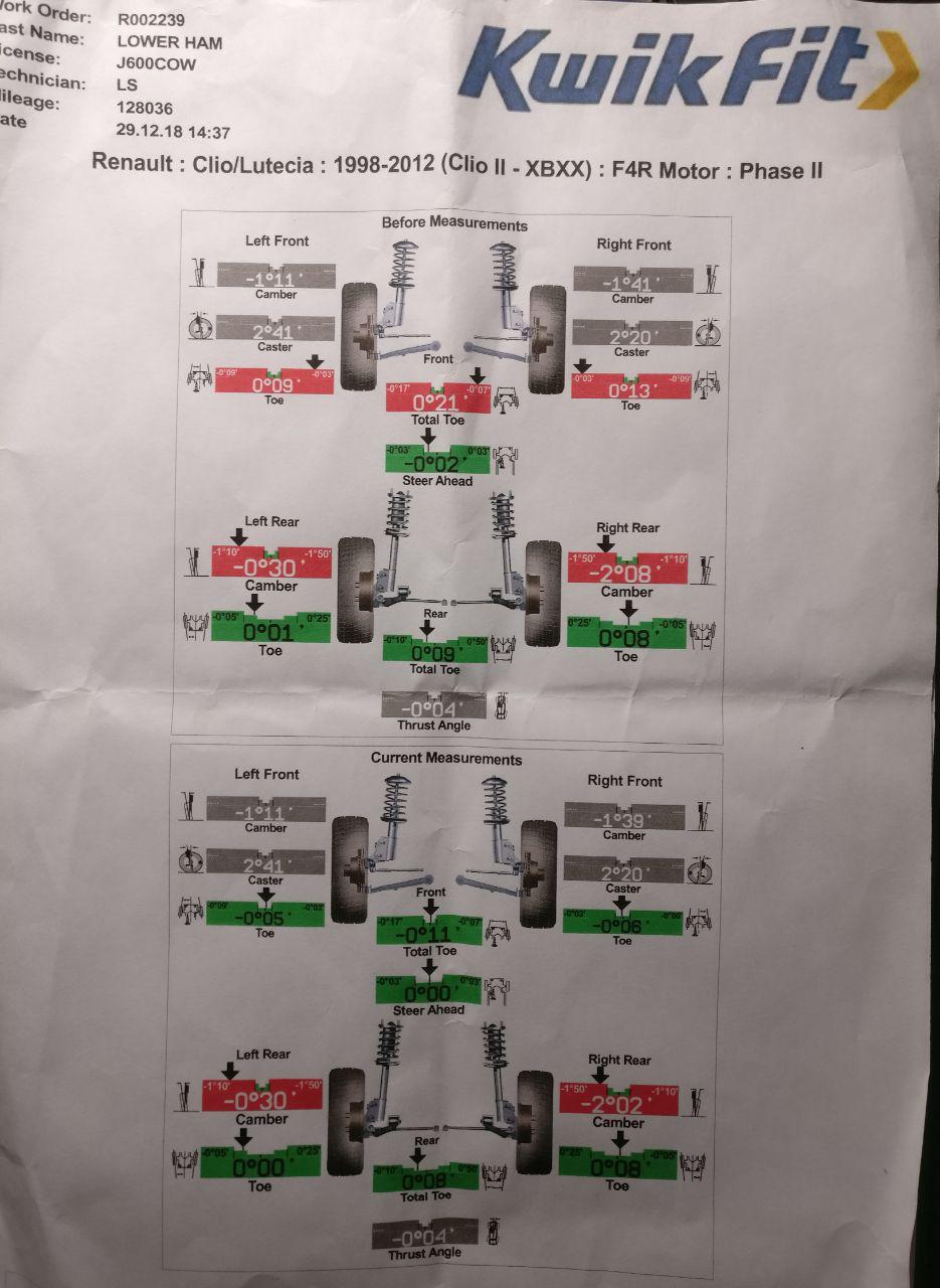

Got my geo setup at KwikFit yesterday and noticed something strange with the rear camber - the left is -0° 30 and the right is -2°02. Doing some reading it seems like the rear beams are not very square from factory, so this might be normal(ish)!
I was thinking of fixing the rear camber with a -1° shim on the left and 0.5° shim on the right (-0.5 flipped upside down..) to bring values back into spec.
Is this worth fixing or could I just leave it?

The only way to do it is with shims...I just want to know whether it's worth doing and has a handling impact

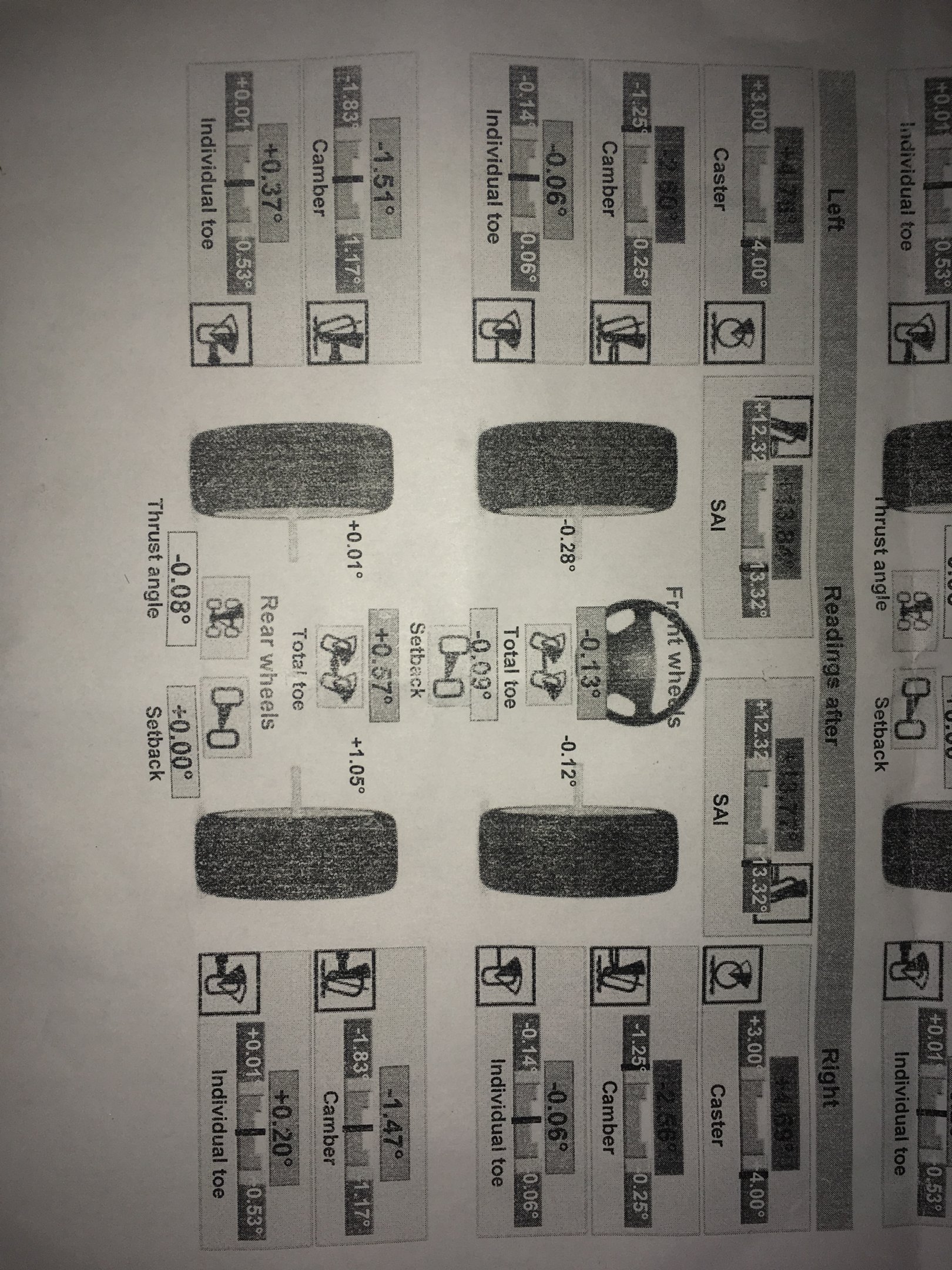

Go and look at the wheels in person, that should be quite obvious if it really is that out. My rear toe is 0.37 and 0.20 and I can see the difference. Personally if it really is i would get another beam but someone else might say other wise

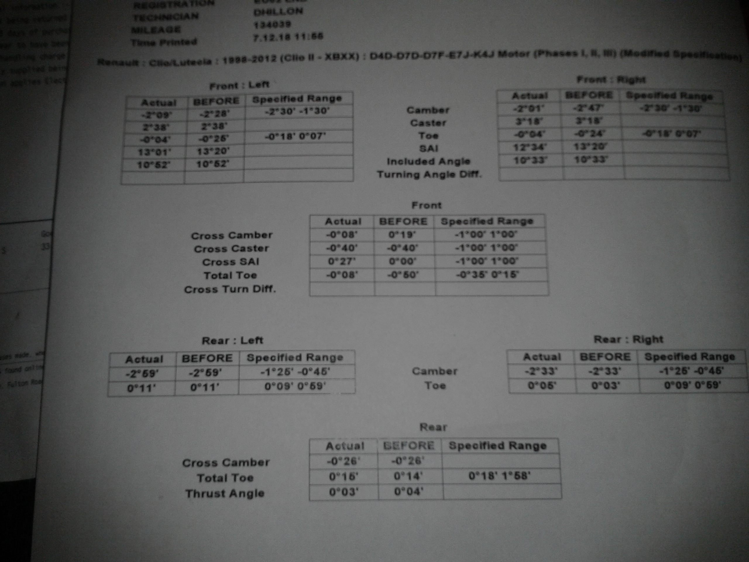

Looking at it again, it`s closer to -3.0 on the LHR.
I might adjust it one day, but it can wait till the next time I have to disturb something.

An update on my rear camber issue - I jacked up the car to look at the rear and the rear beam bushings are completely disintegrated, chunks peeling away when poking it with a finger. Wheel bearings are fine, so will replace bushes with powerflex black and see what difference it makes (I assume it'll sort it!).
