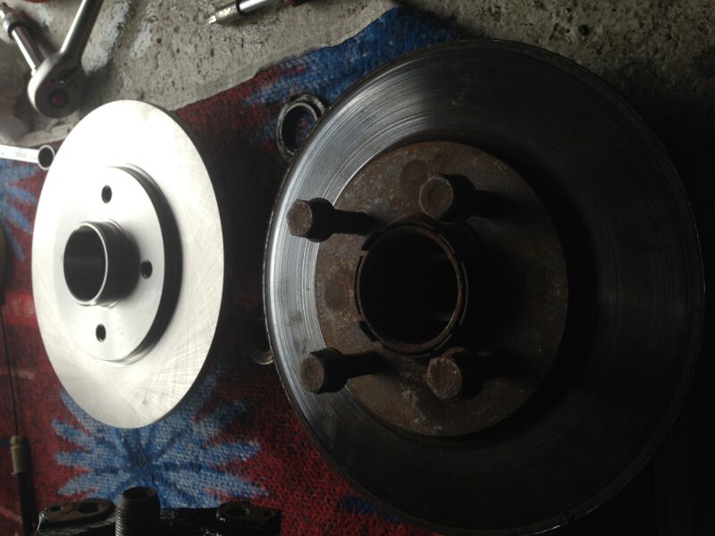

New Rear Bearing for the axle
new front bearing complete with suspension arms

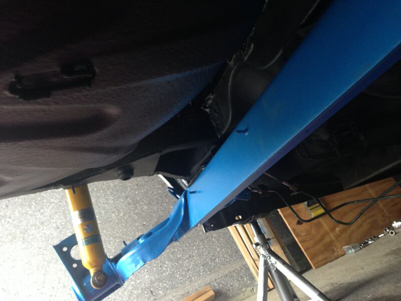

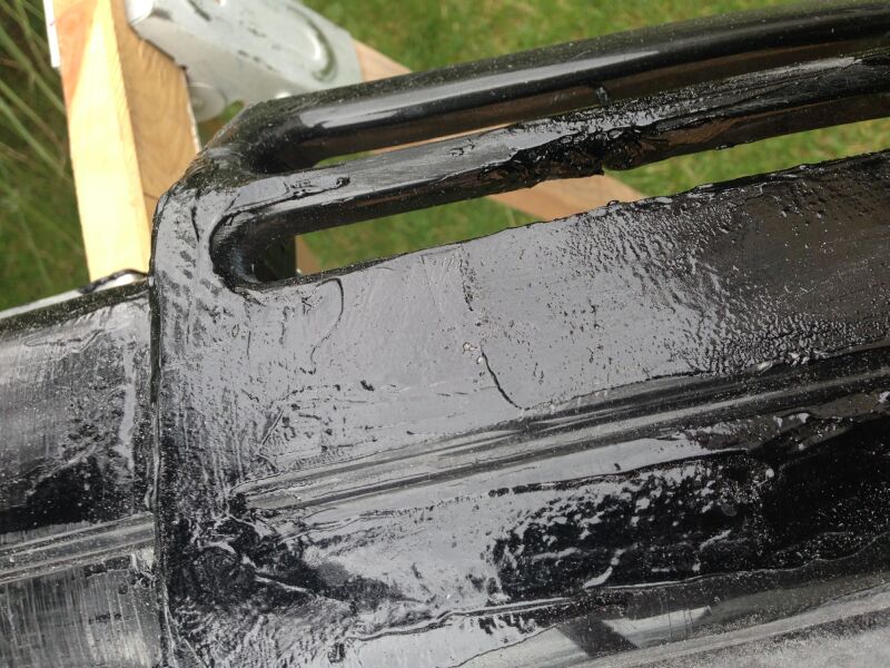

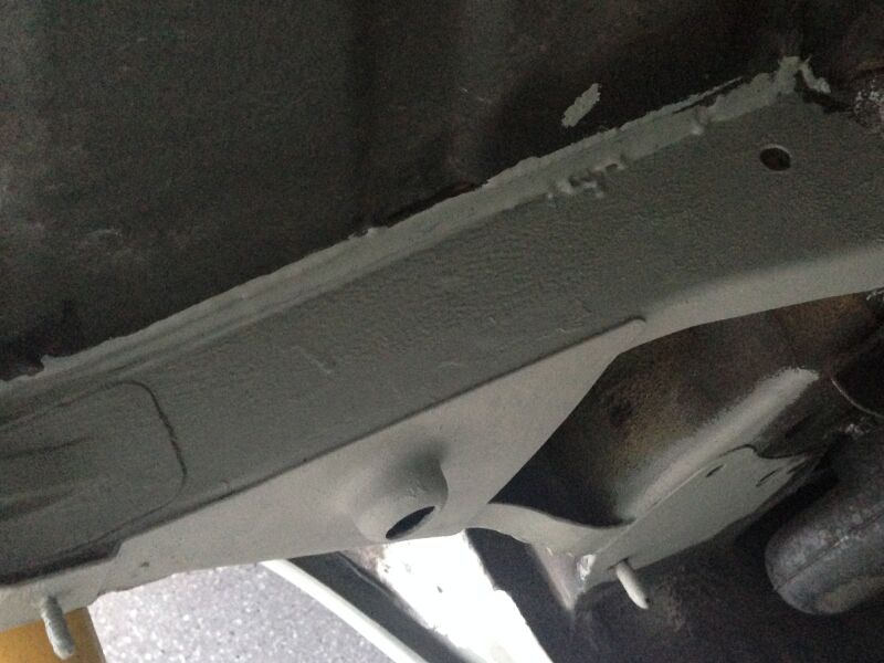

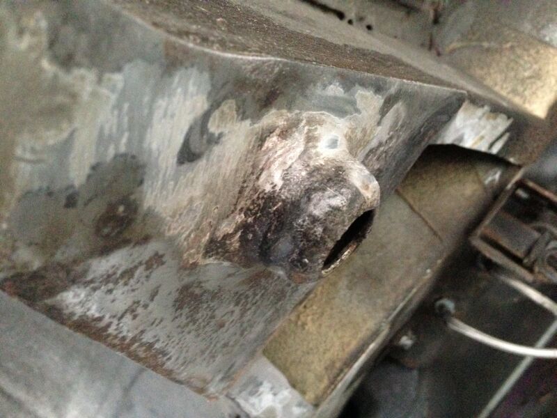

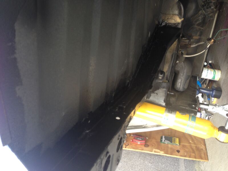

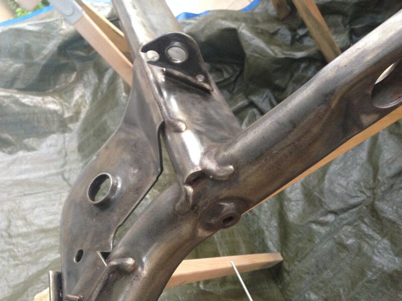

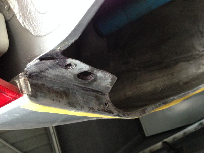

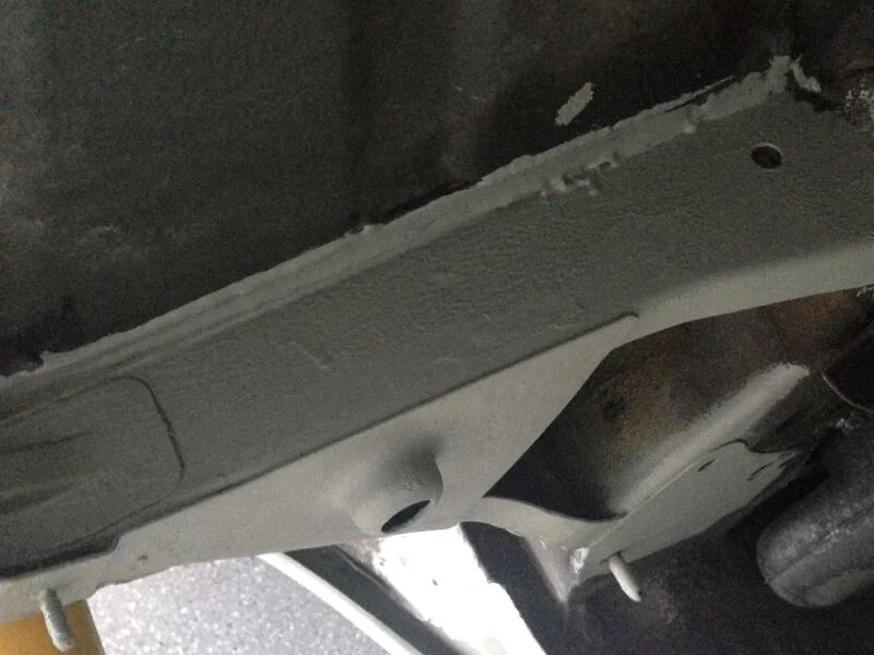

After this i gave him rust converter from fertan. Also to have a good primer.
Fertan i did 2 times. Between first time and last time i send it off to catch more rust.
Now other side :D

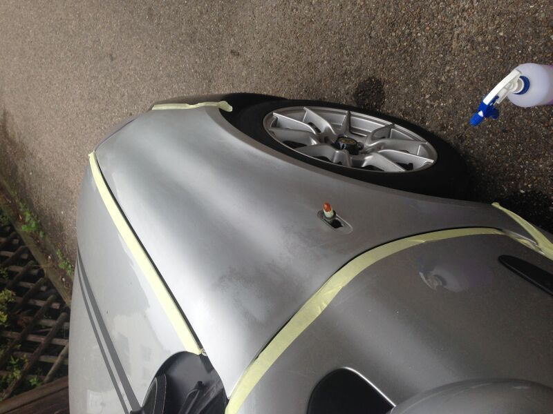

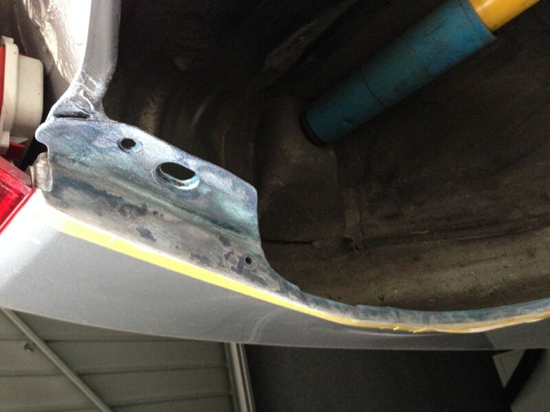

grit the partialy painted fenders
clear coat was 2 component coat. Sanded with 2000, 2500 and 3000 followed by Menzerna 400 and Menzerna 2500.
Same at the front fender, it was repaired and also partialy sprayed.

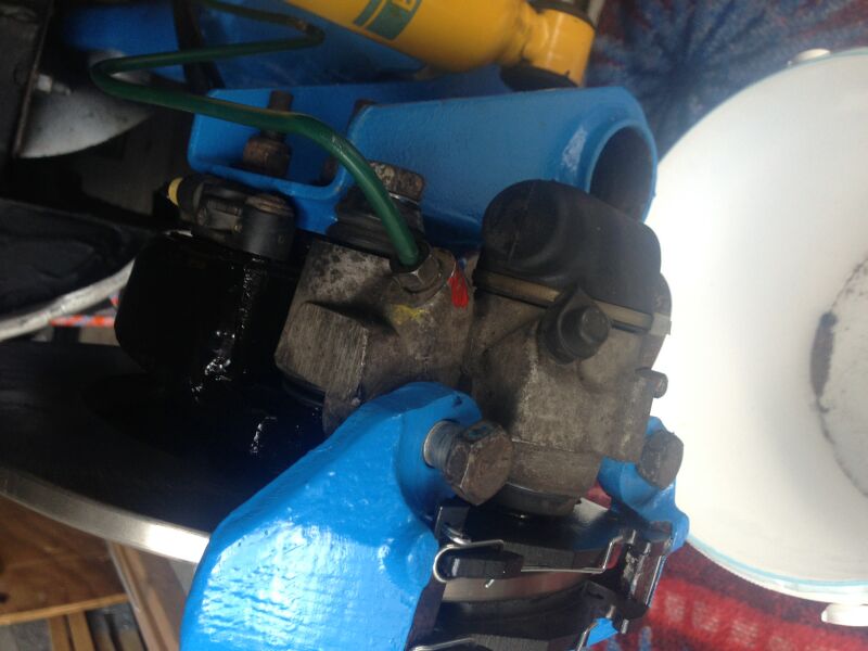

Next step will be new bearings for the front dampers.
I'm driving to the nürnburgring this weekend so a lot of work to do.
Changed topmounts

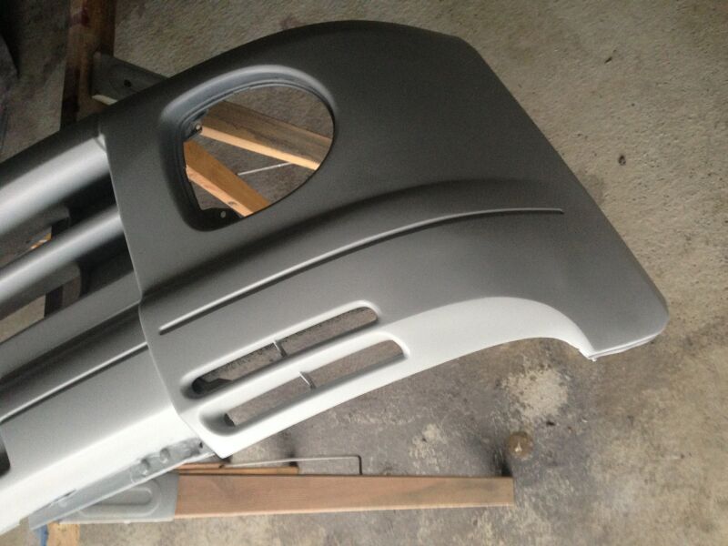

Also decission was done to get the frontbumper back in silver
but at first there was a need to repair it.

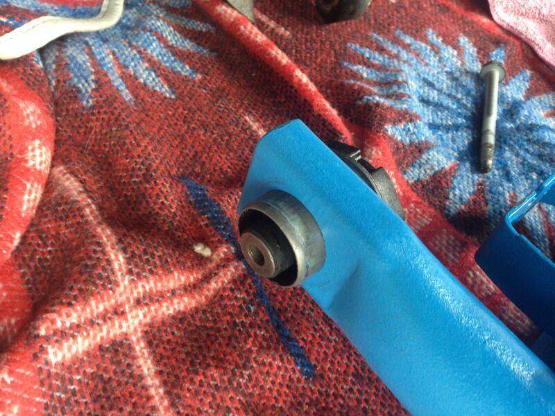

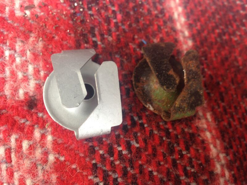

Hi,
small update. Went to the ring in September and the car felt great. New bushings worked fantastik at the rear axle.

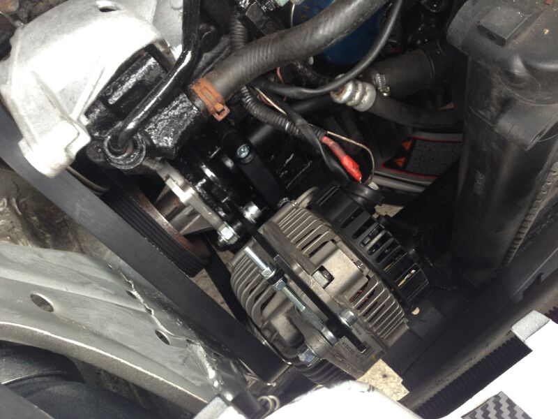

than the car take his break and I ordered the pure Motorsport Aircon Delete kit
Kit is ok but for trimming the belt i Need to cut one wrench.

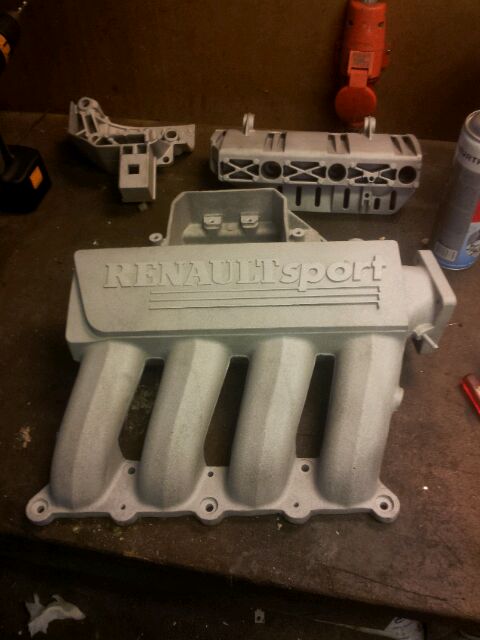

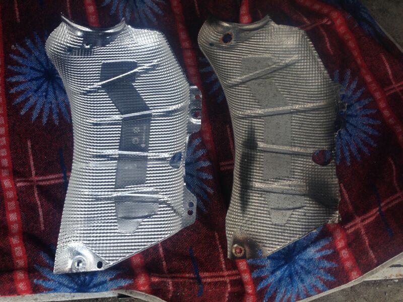

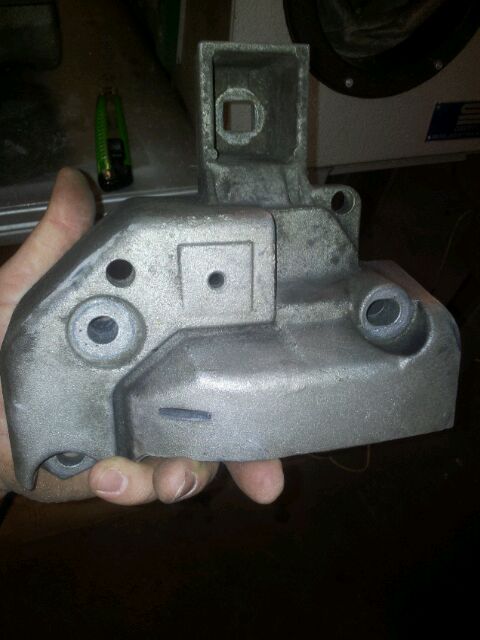

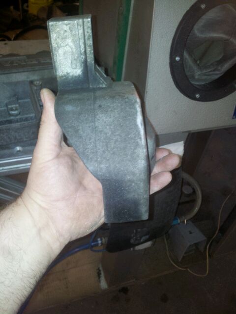

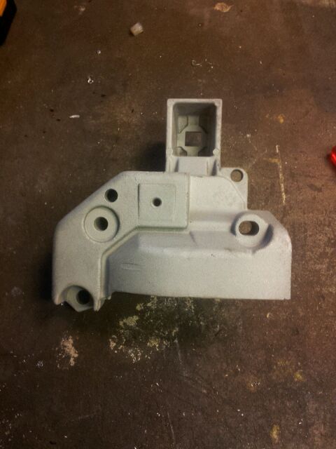

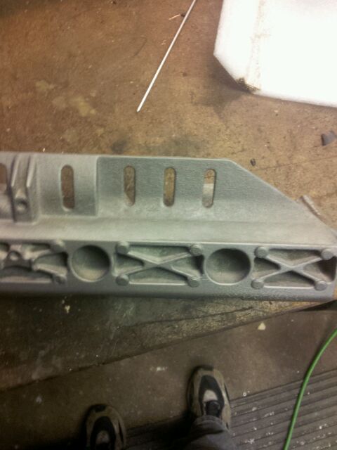

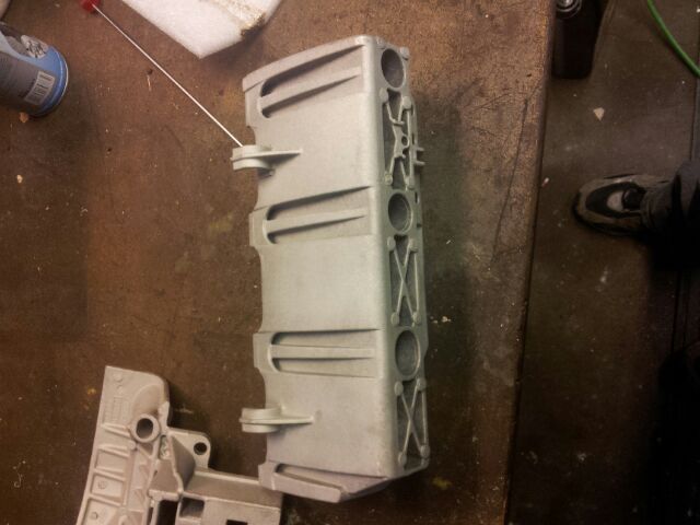

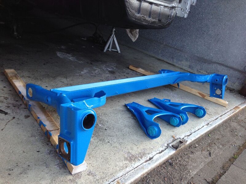

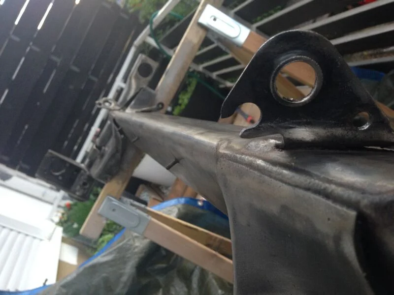

Also i gave some parts for powercoating. Before that they where dry ice blasted which is the current Status now.
From This:
to this:
