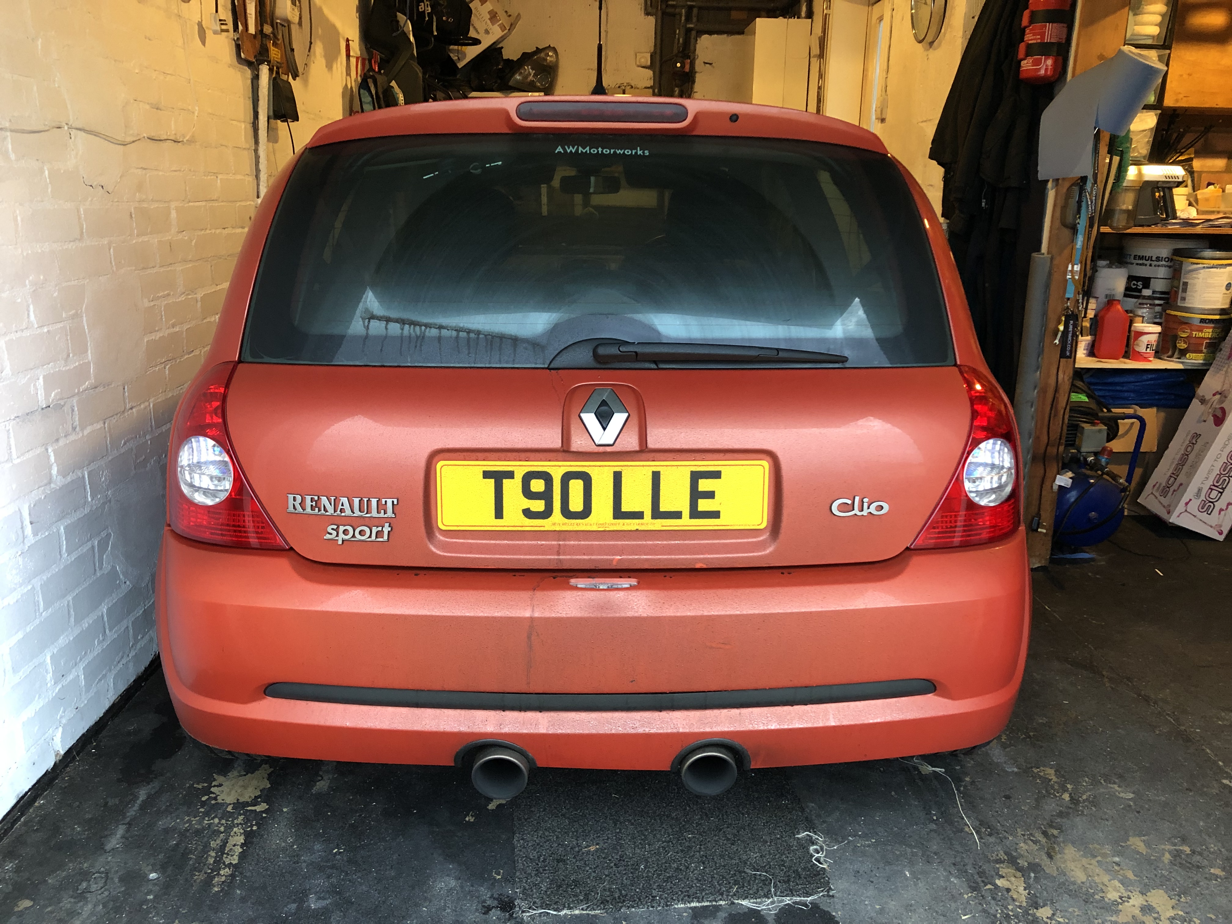

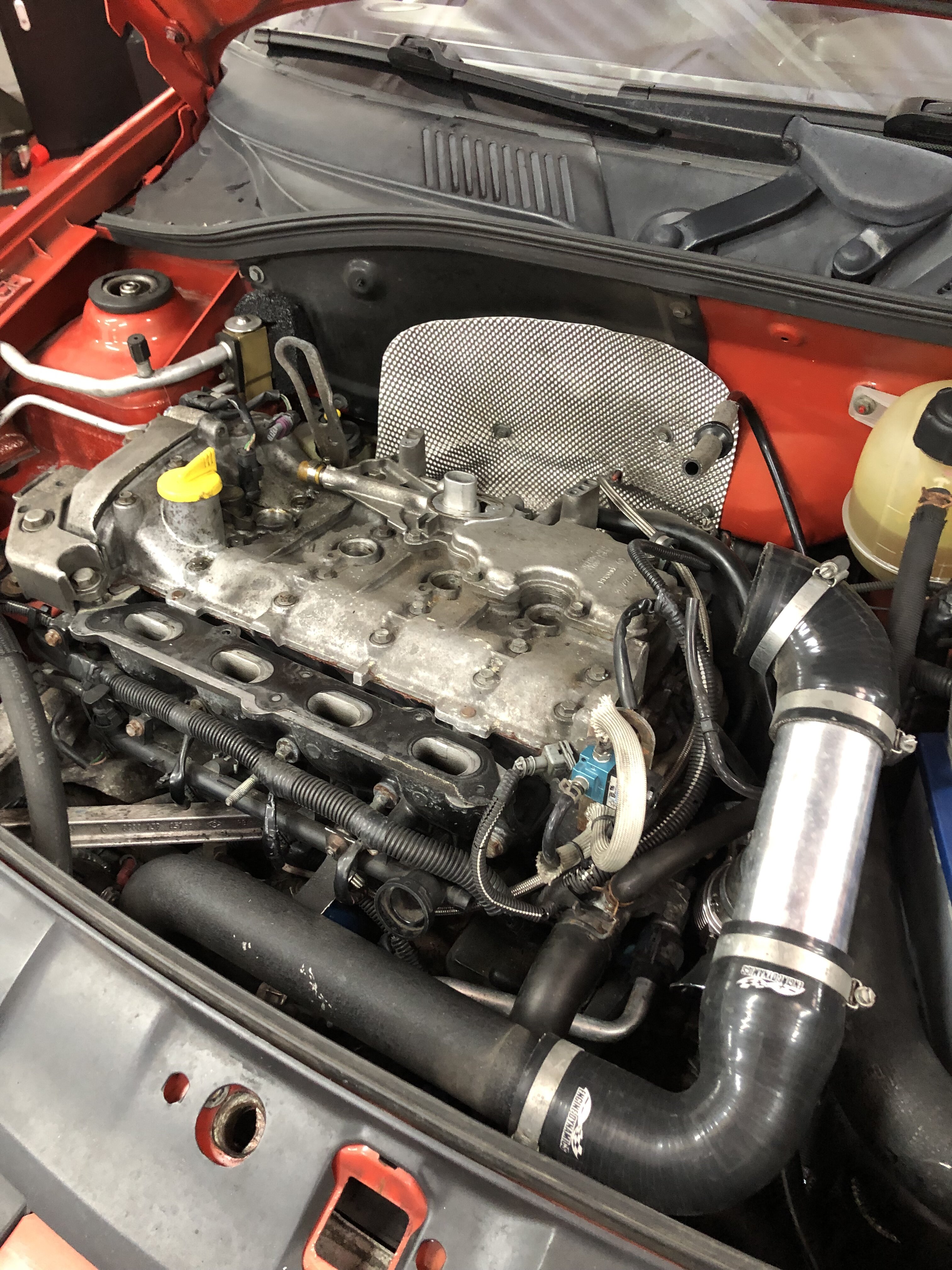

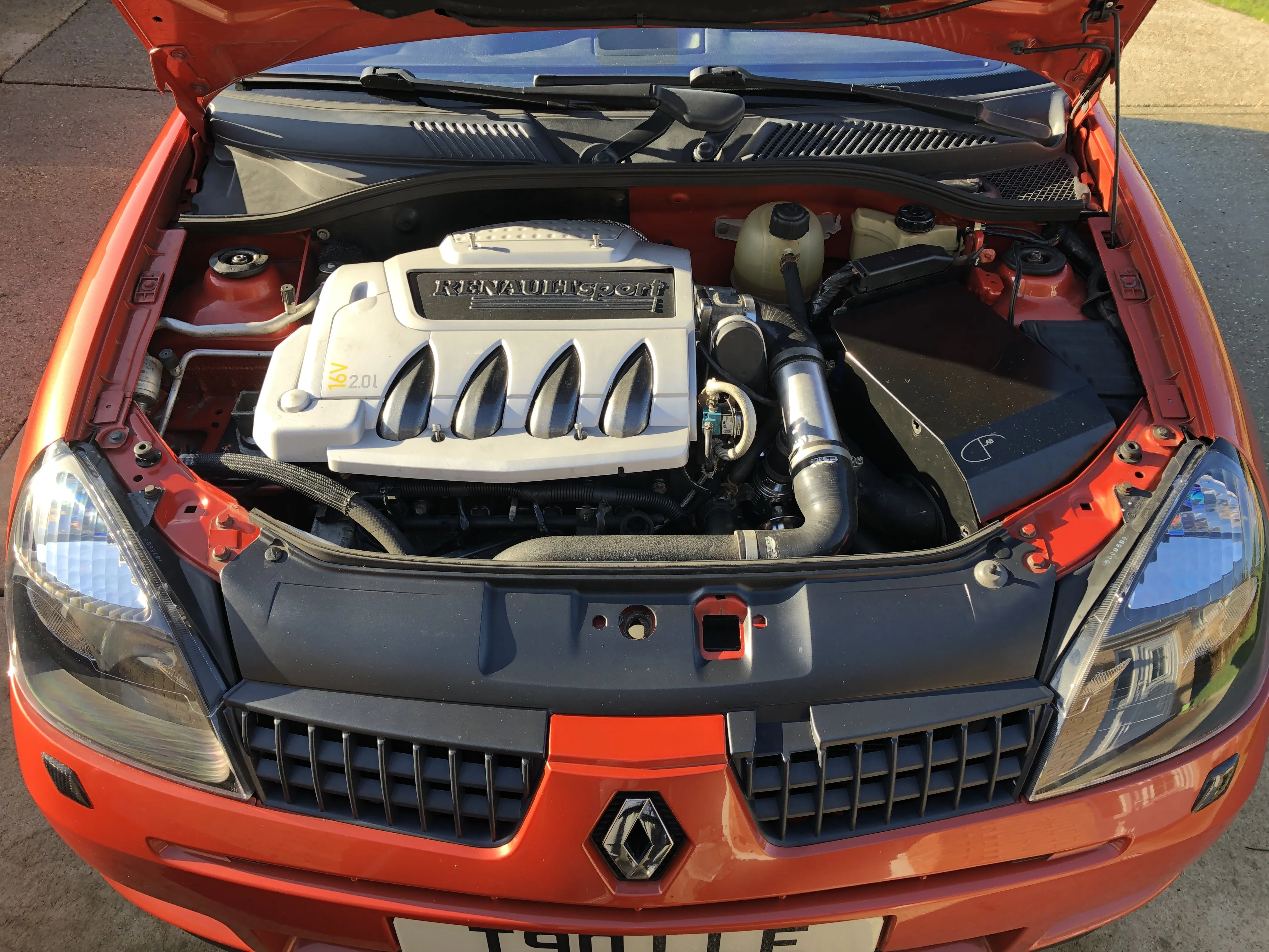

So 5 1/2 hours, 200miles and a mpg of 41.9, I have been there & back to have the Inferno looked at by Alex at AWMotorworks.
He jumped in the car to pull it into the workshop and the engine flashed low oil on the dash, he drove it inside and my car had left a nice rainbow pattern on the floor and it had only been parked for 5mins. He pulled the dip stick and oil was just on the minimum mark, So in the 2hr drive down it had used/blown out most of the engine oil.
Alex pulled the plugs and they were soaked in oil, I mean dripping which definitely wasn’t a good sign to start with after him hearing “piston slap” I think he said.
Compression test gave 3 cylinders on 170psi and number 2 on 150psi. He said if they’d been similar across the 4 it wouldn’t have been such an issue but since one is down what he thinks has happened is one cylinder has got too hot or seen to much pressure which may have caused one of the ringlands to potentially crack thus letting oil into the chamber and/or pressure into the engine hence why it blows its oil out of the breather. Next in was a borescope into the head and the pistons are sooted/carbon up but no real damage or scoring was seen.
We found other issues like it’s got no oil cooler line on the turbo I think he said, fuel lines are mounted wrong side of a heat shields, manifold is just about sitting on the subframe, the turbo I was told was a Garrett isn’t, it’s the ED kit one which is no real problem just annoying being told something is, when it’s not. The turbo blanket isn’t really doing naff all as it’s not mounted properly. And then then the engine had been swapped for a 172 lump!! But I explained that I was told it had a ph1 head for the bigger exhaust ports which may be true. There are other things to but nothing too major like the main issues above. Moving forward with the car the plan will be to rebuild I guess as it wouldn’t be worth much to anyone as it is.
The rebuild would go on an engine build swap basis as he has a few 1*2 engines about. He would get one built up with new forged parts and then pull my lump out, swap all the ancillary’s and turbo kit over rectifying other issues as he went and drop the new freshly rebuilt engine in. I can’t thank Alex enough to be honest, he talked me through the all issues we found and explained what would need to be done to rectify the problems. I must admit it was still a kick in the nuts though!!
Drove the car home like Miss Daisy not going over 3k and I’ve chucked it in the garage until I receive a quote for how much it’s going to cost me to rebuild.

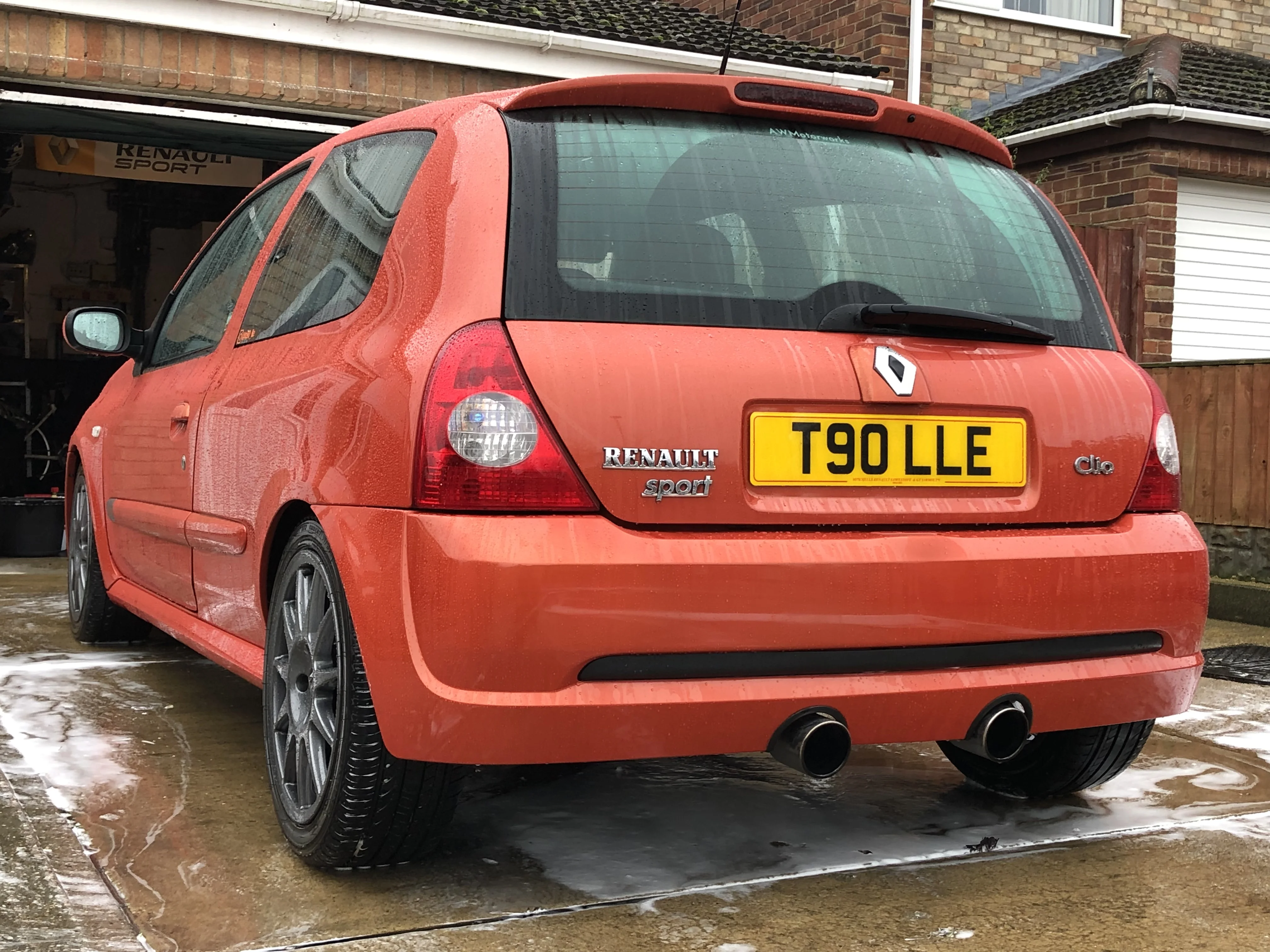

Saturday the Turinis went for full asking price which even I thought was optimistic.
And today finally saw the BG drive off into the sunset with its new owner up to Durham. Before it left though I took the opportunity to swap over a few more of the “mods” the previous owner had done to the Inferno onto the BG.

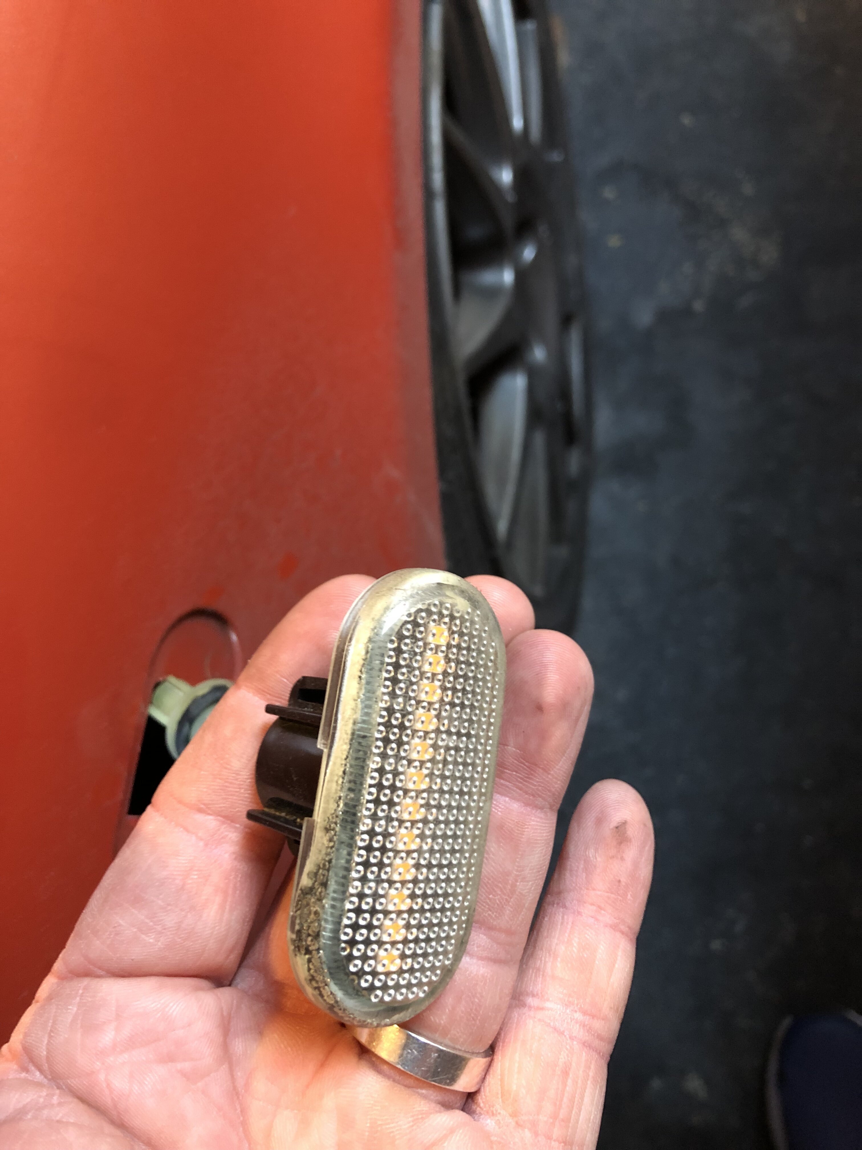

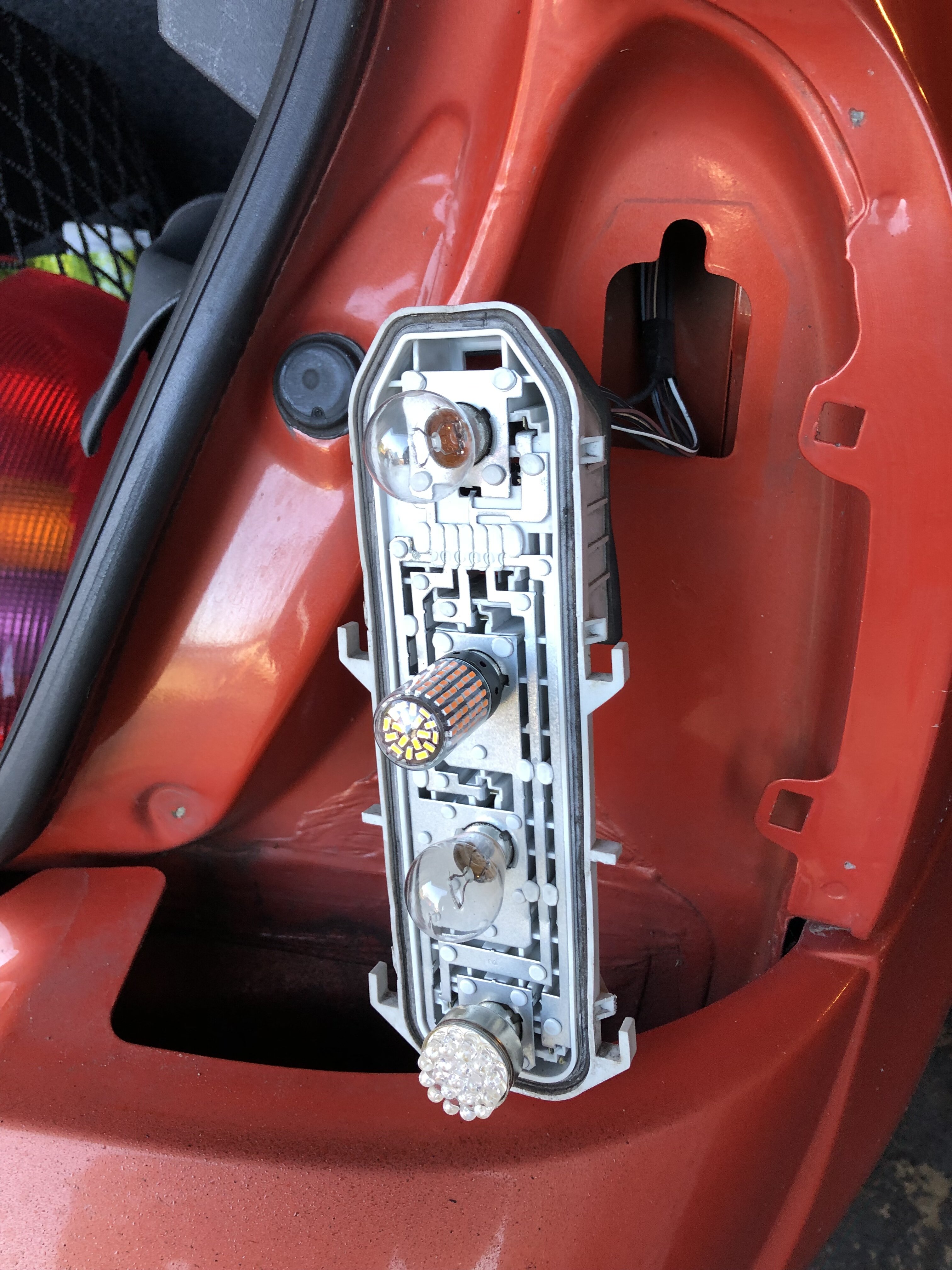

1st for the chop was the super bright LED indicators and brake light.
The sides were swapped out as it was a whole unit and the front and rears replaced with the iridium effect ones. I may change these for some silver visions but as yet I am undecided which would look better.
If you follow me on instagram you may have seen a poll regarding the rear lights?
So welcome back the ph2 rears… Don’t know how long they stay for though!

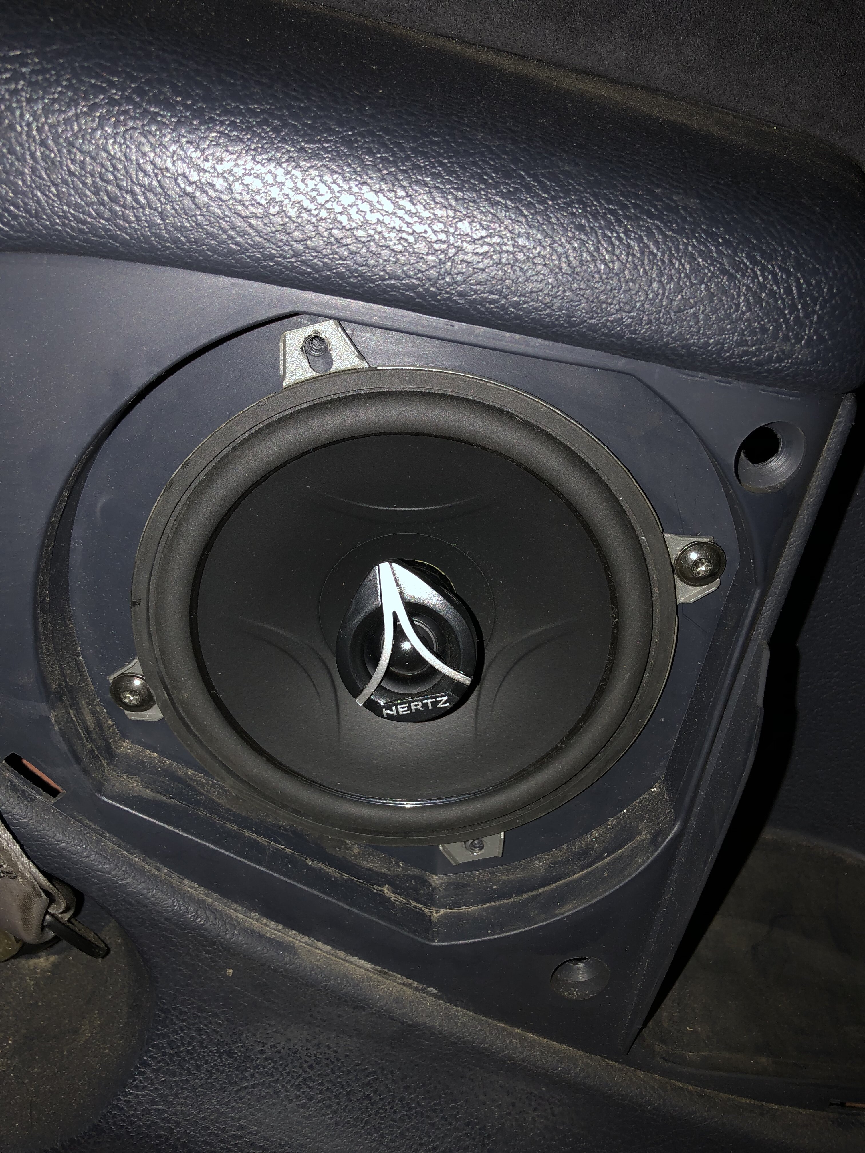

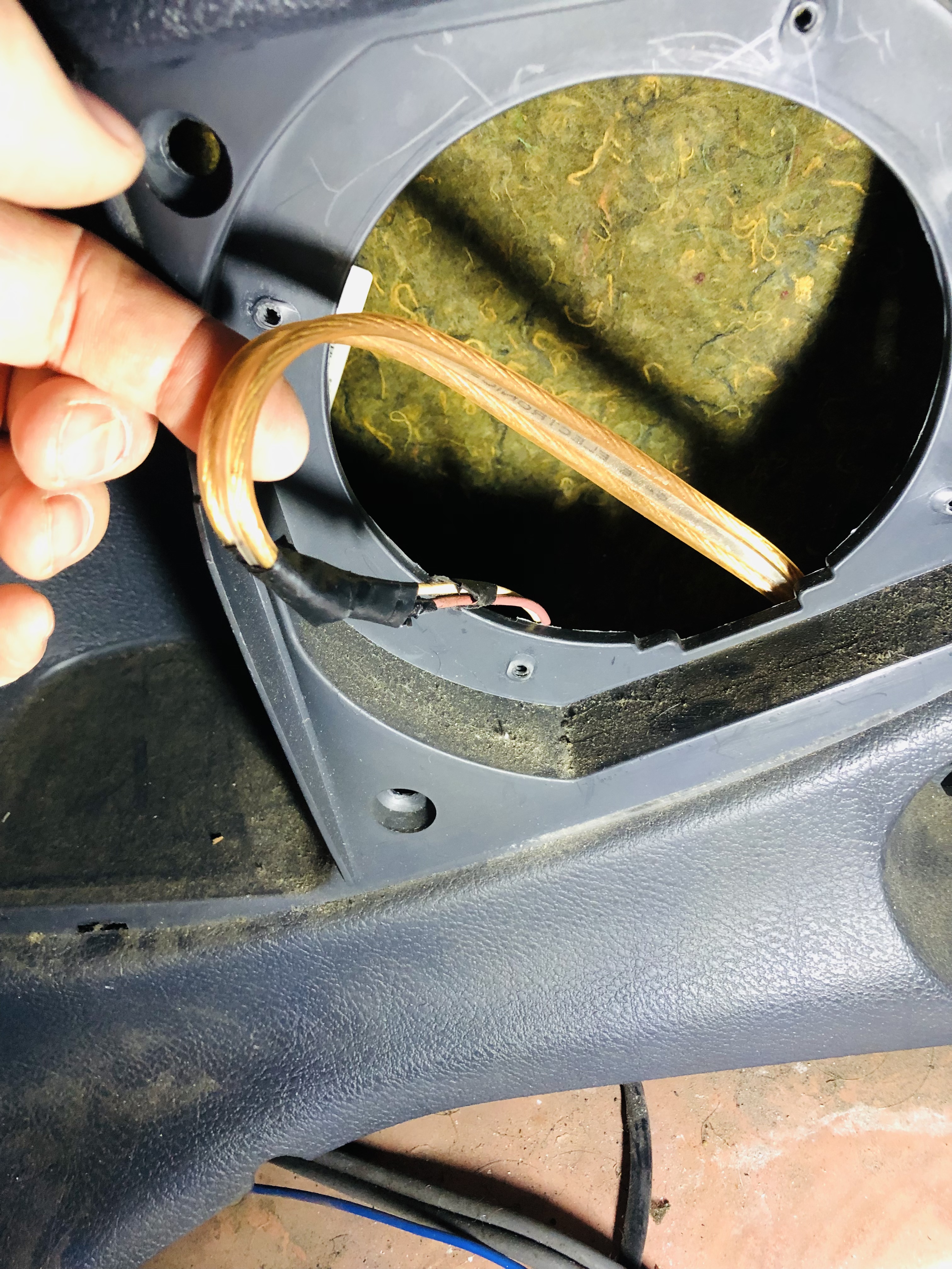

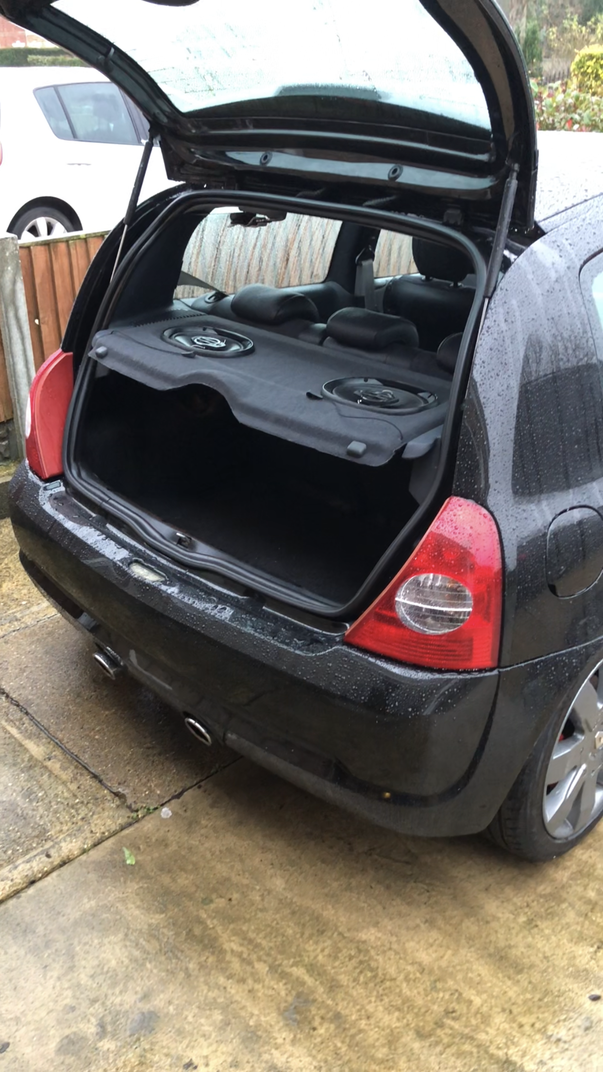

Next in the block was some Pioneer 6x9s and Infinity 5” door speakers. These were put in the BG and my Hertz speakers I’d previously put in it swapped back into the Inferno leaving me with a nice clean parcel shelf

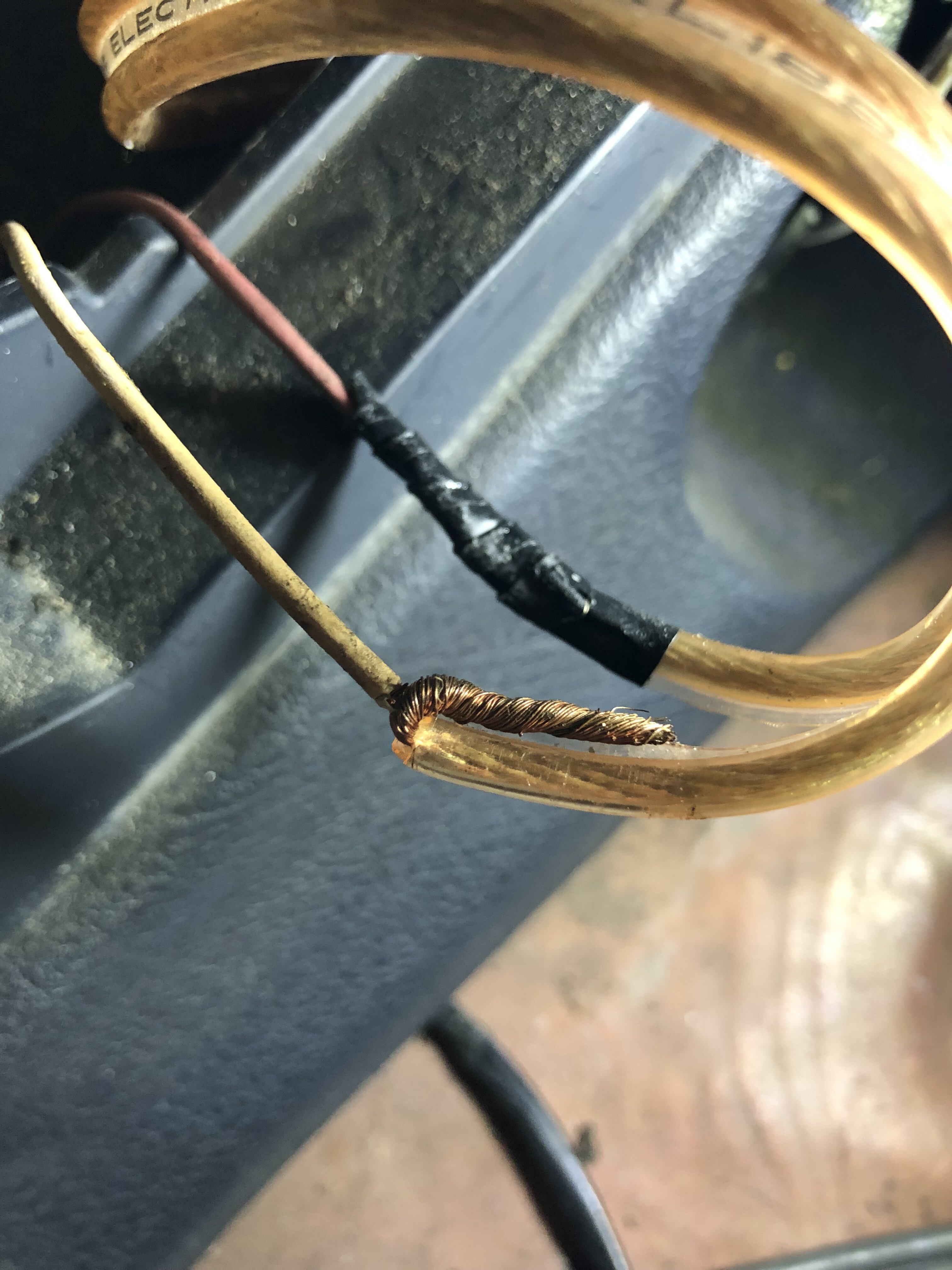

The only problem now was the wiring the previous owner had run into the boot!
I mean I’ve seen some dodgy speaker wiring before but this is up there with the best of them. No use of a bullet/spade connector anywhere in sight.
The extra cabling has been removed and proper spades added to the oe wires.
A quick forum search came good with the + and - for the cable colours and now I have a full Hertz system again.

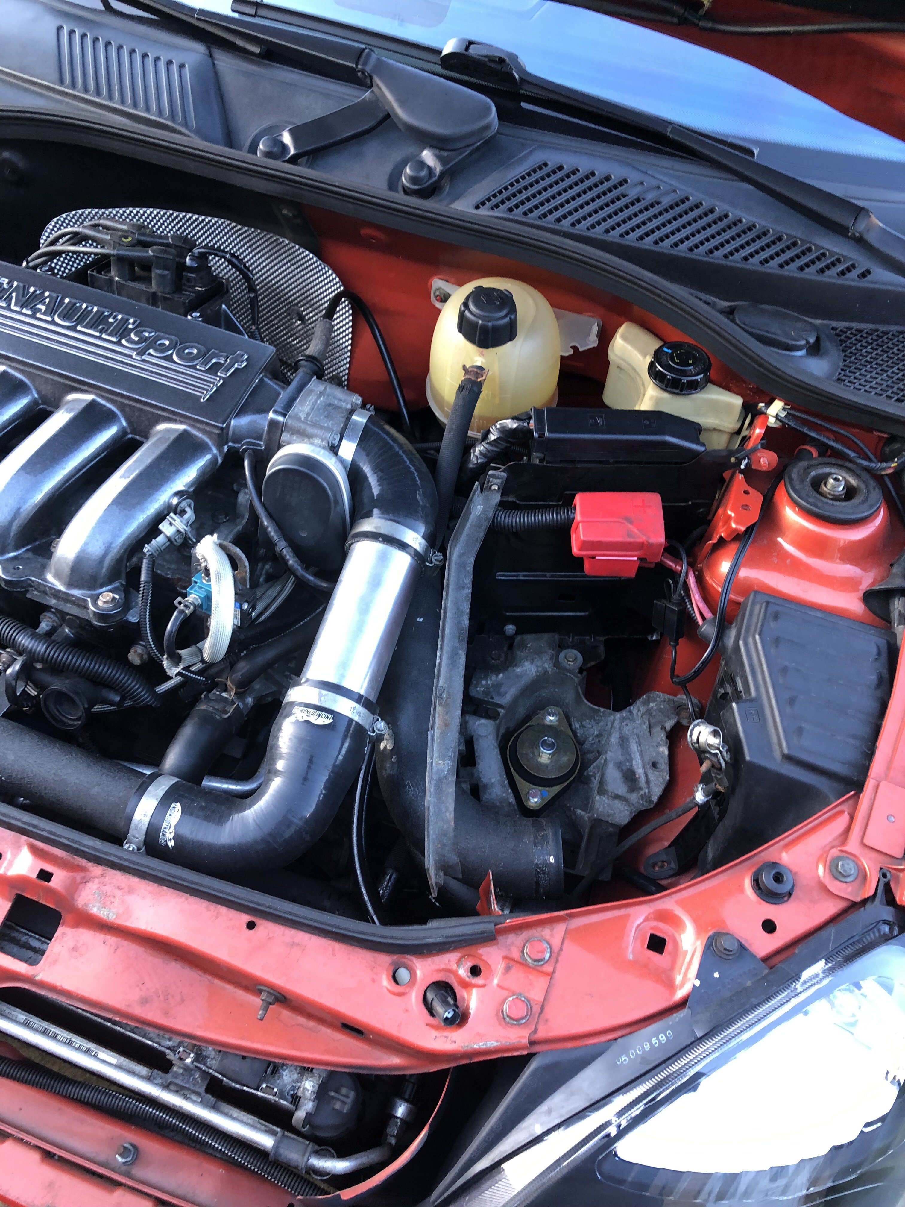

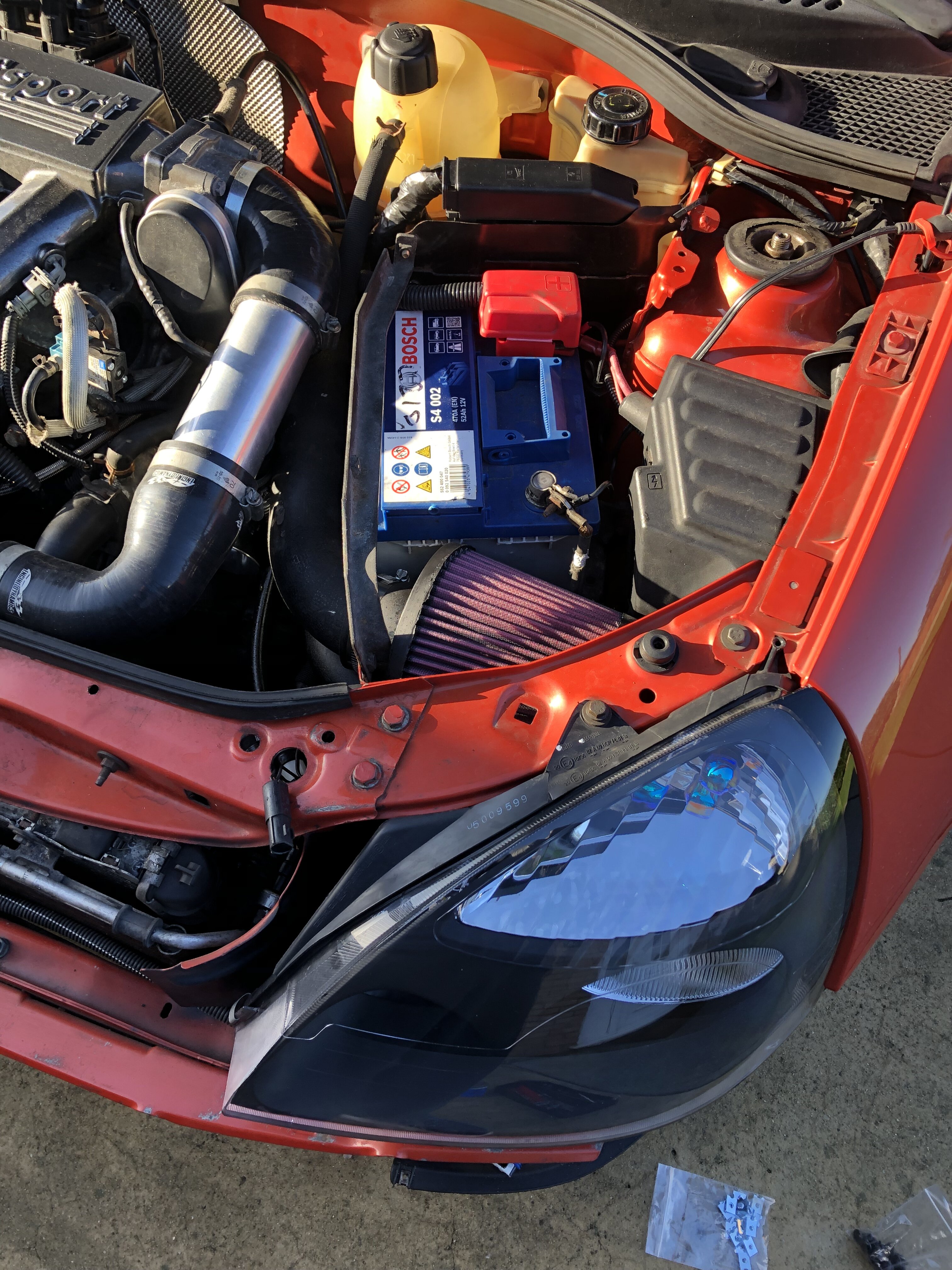

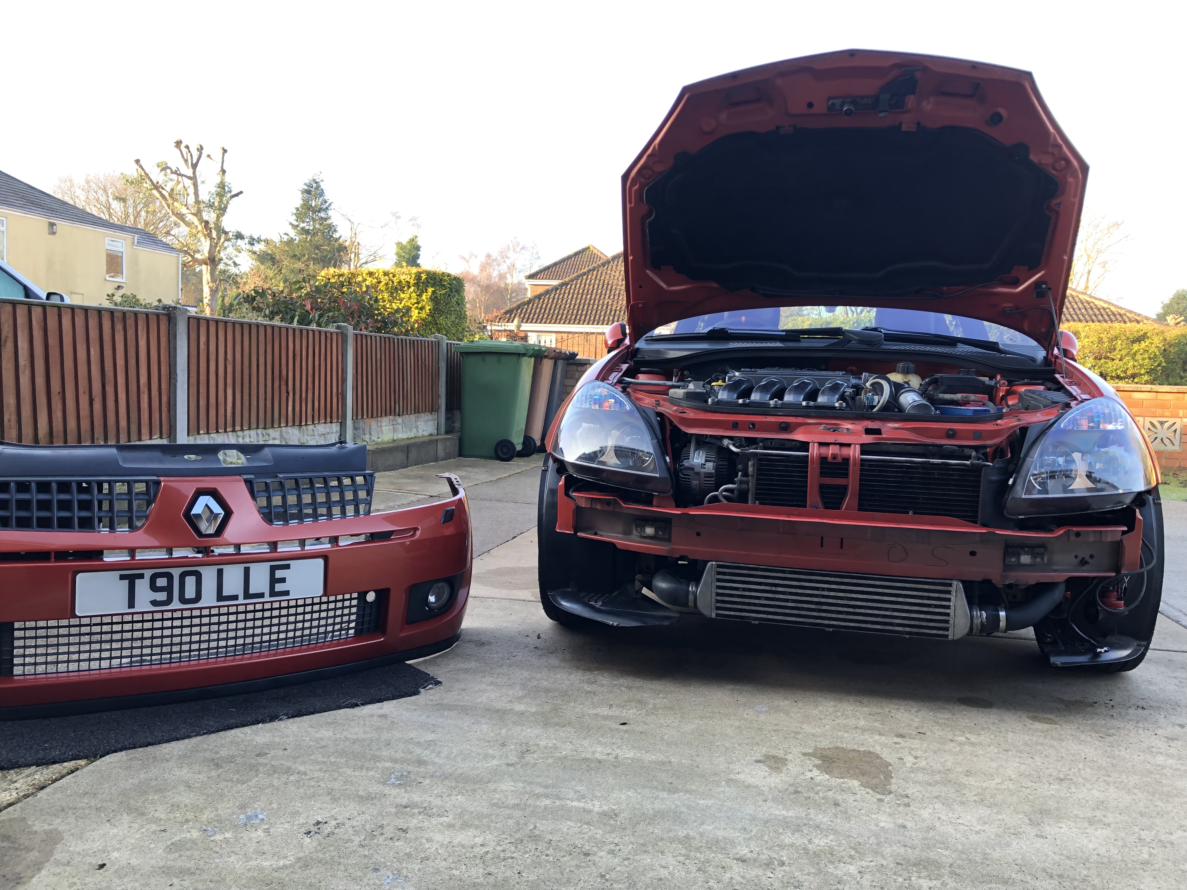

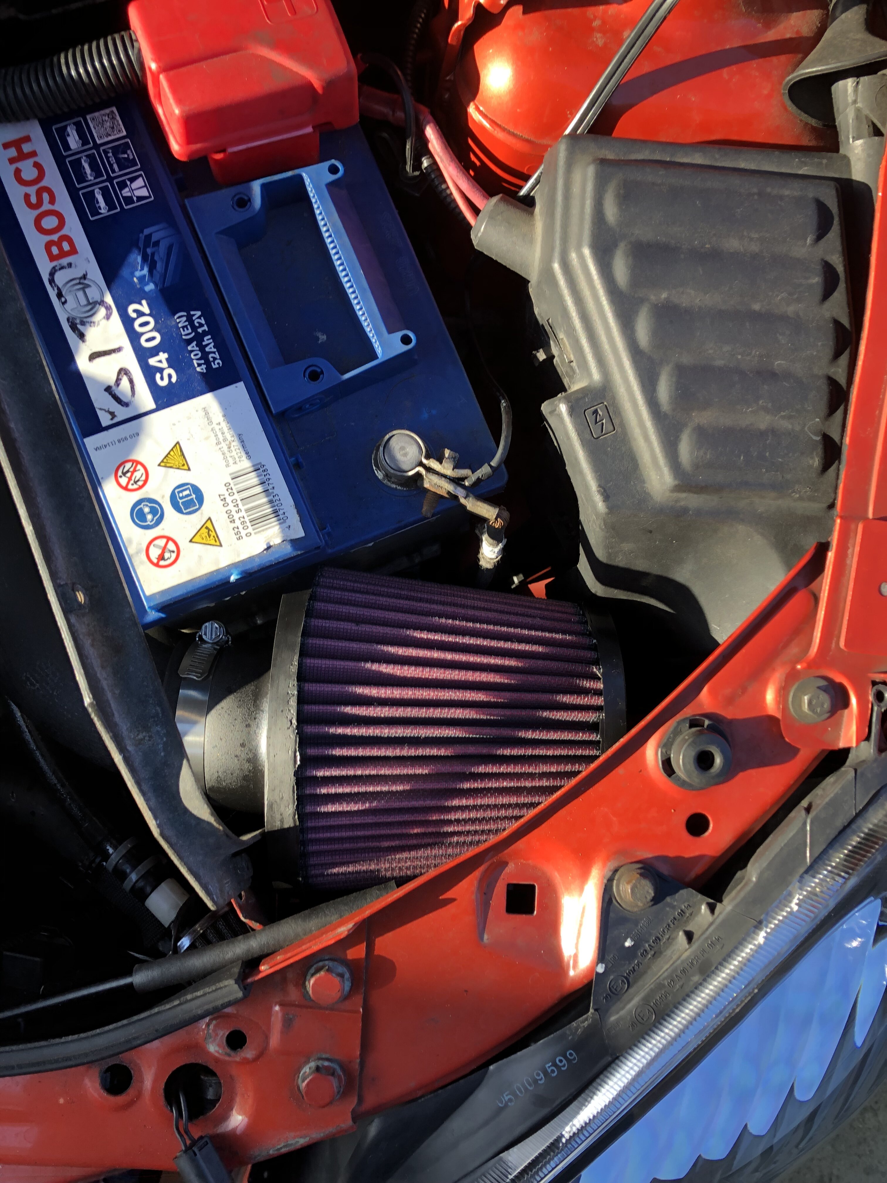

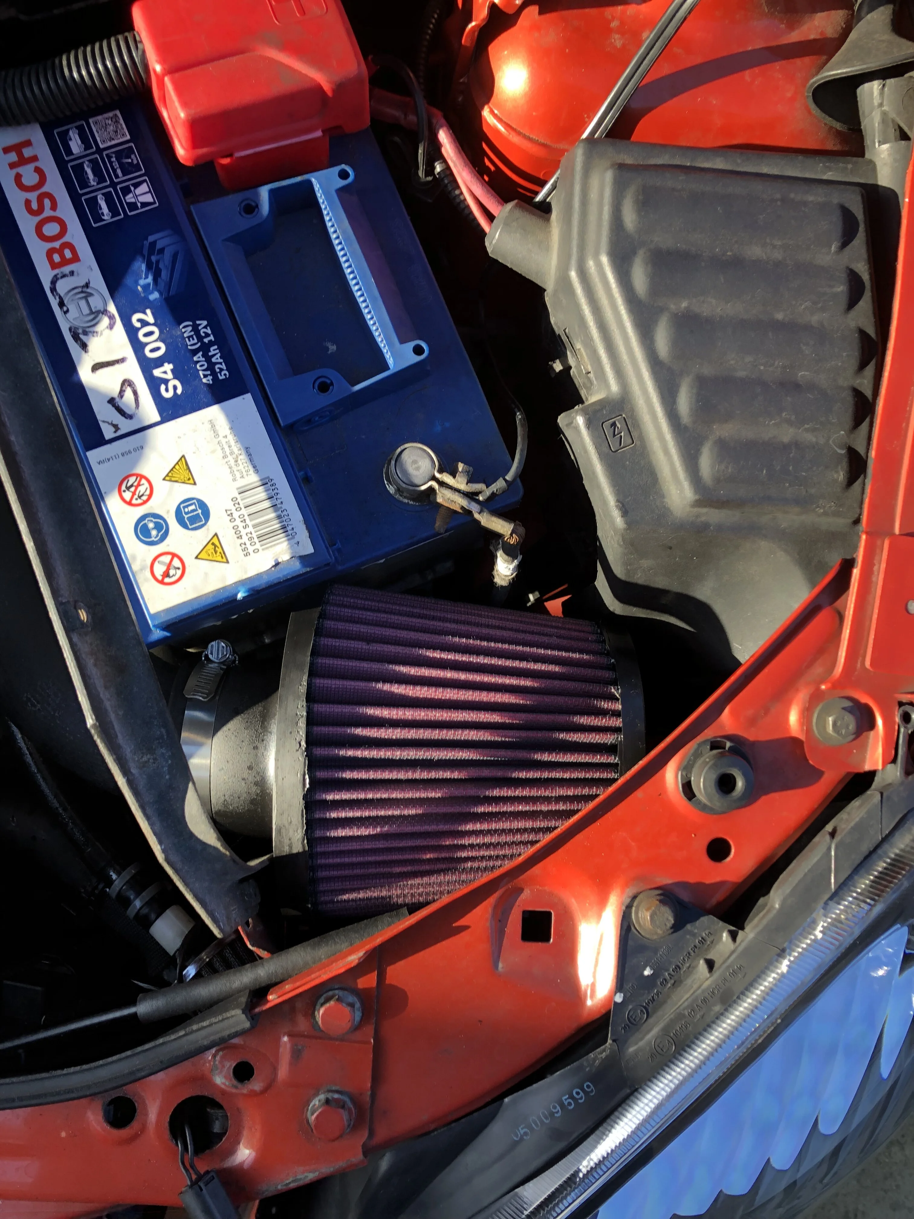

Today I set about putting the front end back together either the newly acquired parts.

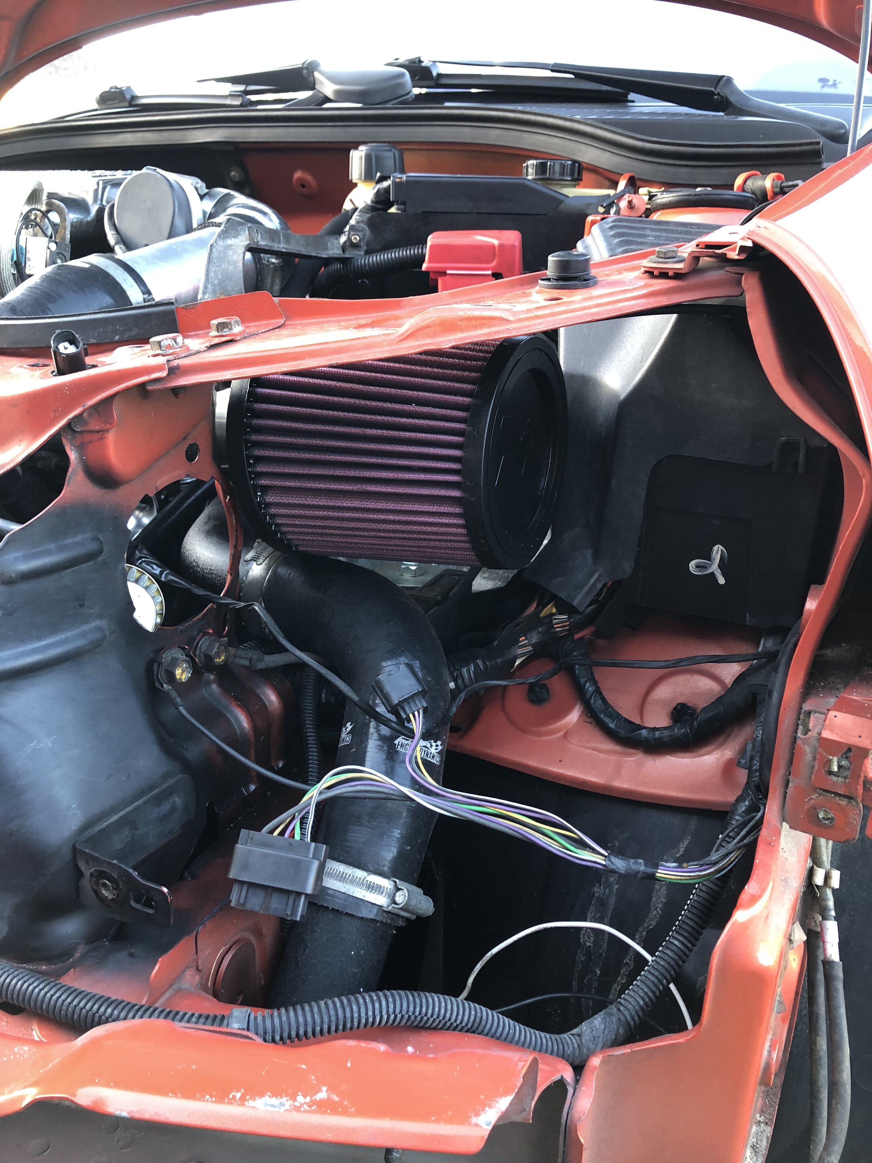

I initially tried to get the K&N in the hole the old filter came out of but it soon came apparent that the battery was in the way.

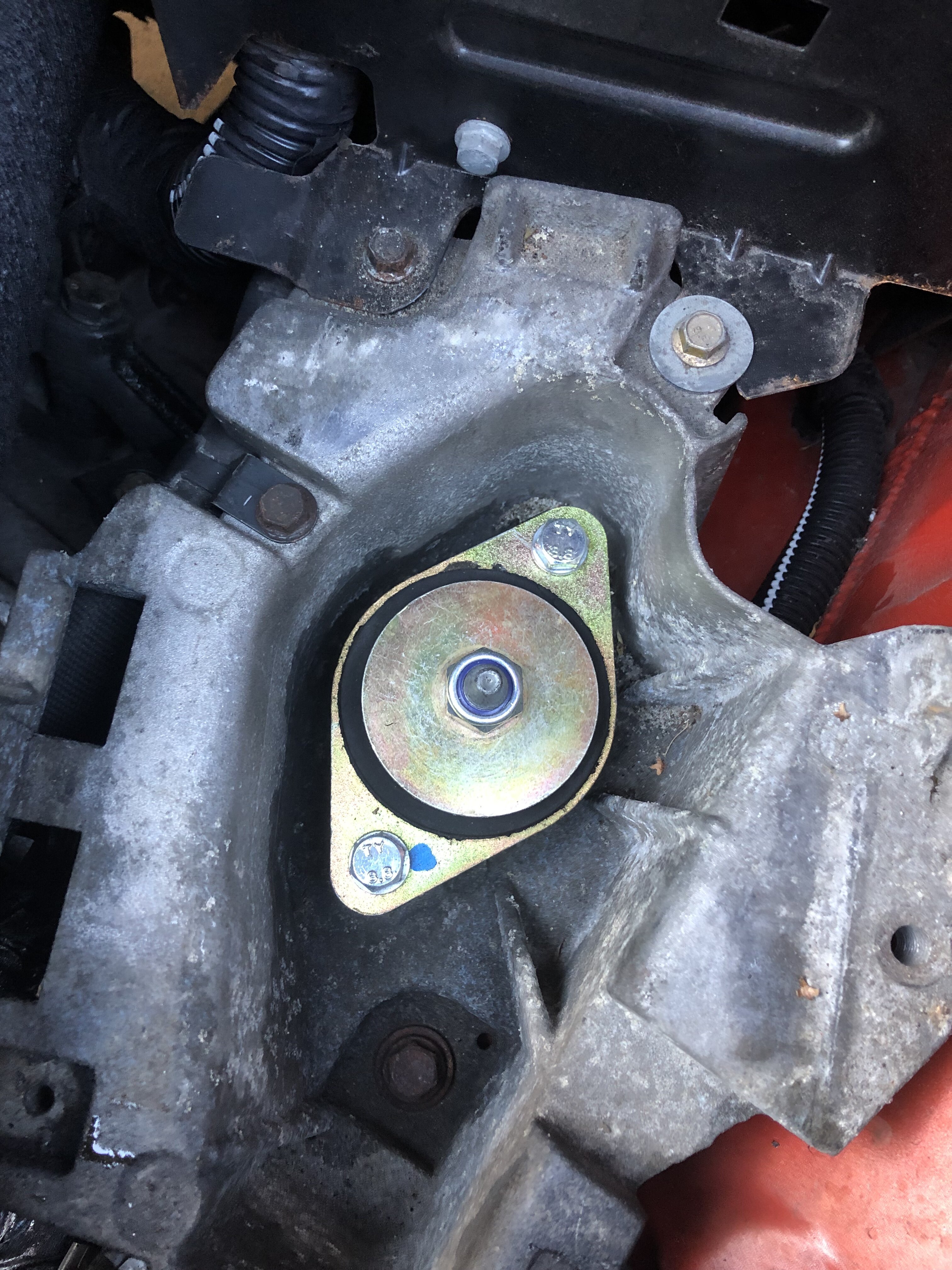

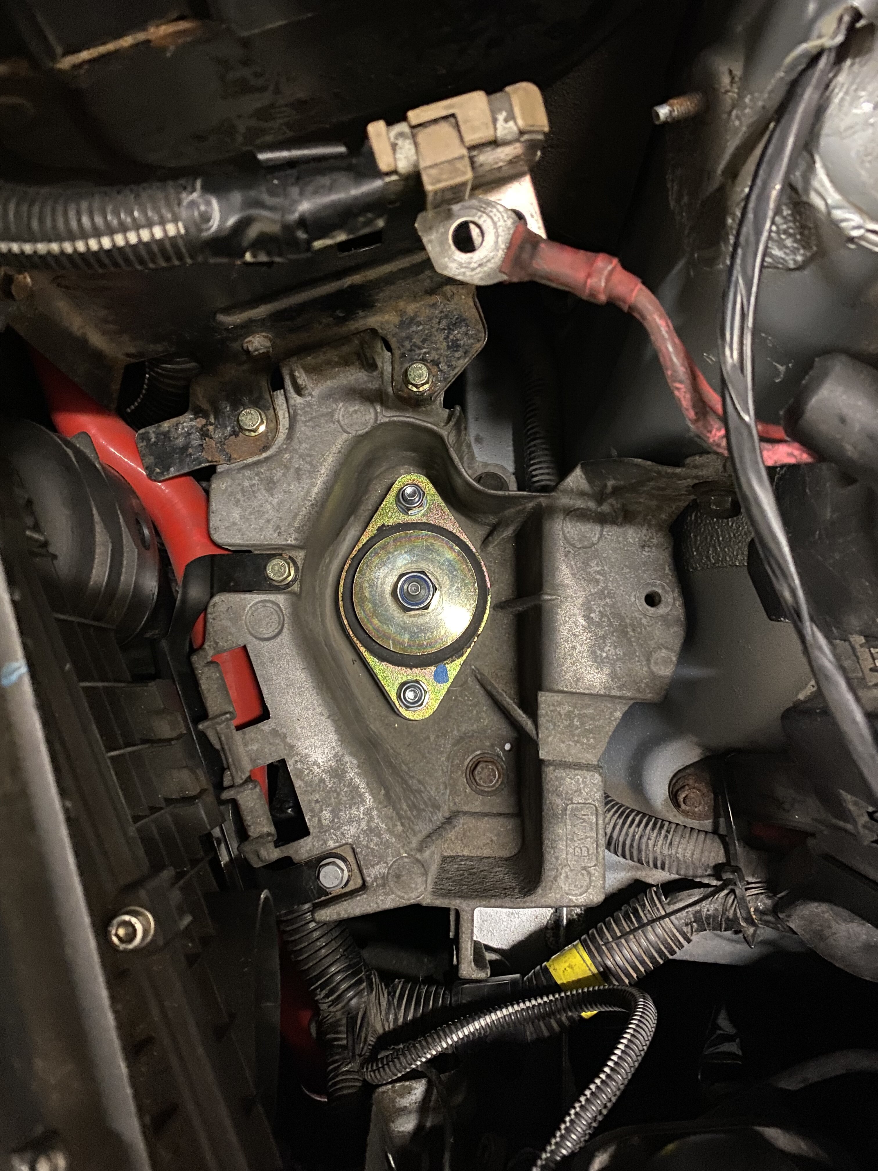

Battery out revealed the alleged K-Tax gearbox mount but to me it looks very oem.
I may be wrong though as it has the K-Tax engine mount and Evol lower gearbox, I’ll have to check the receipts folder.
Even with the battery out I still struggled to get the new filter in as it’s slight wider and taller than the old unit, so out popped the headlight too!
I did abit of cable re-routing whilst it was out as the negative terminal lead was extremely tight under one of the boost pipes.
Space is definitely at more of a premium now in that corner of the engine bay but I’m happy it’s in.

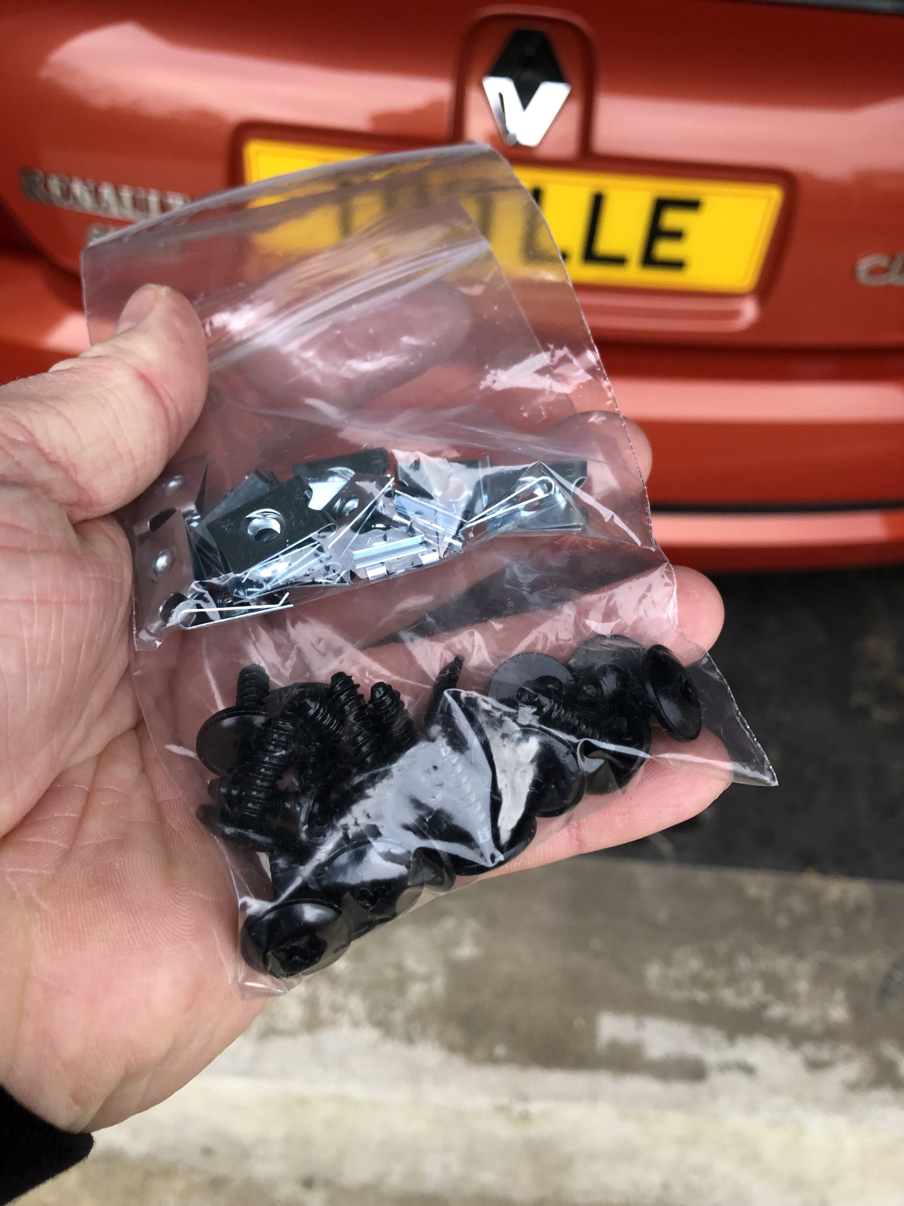

Next up was the new bumper fasteners.
Very happy with these and the new retaining screws with loads of spares left over as they inevitably get lost.

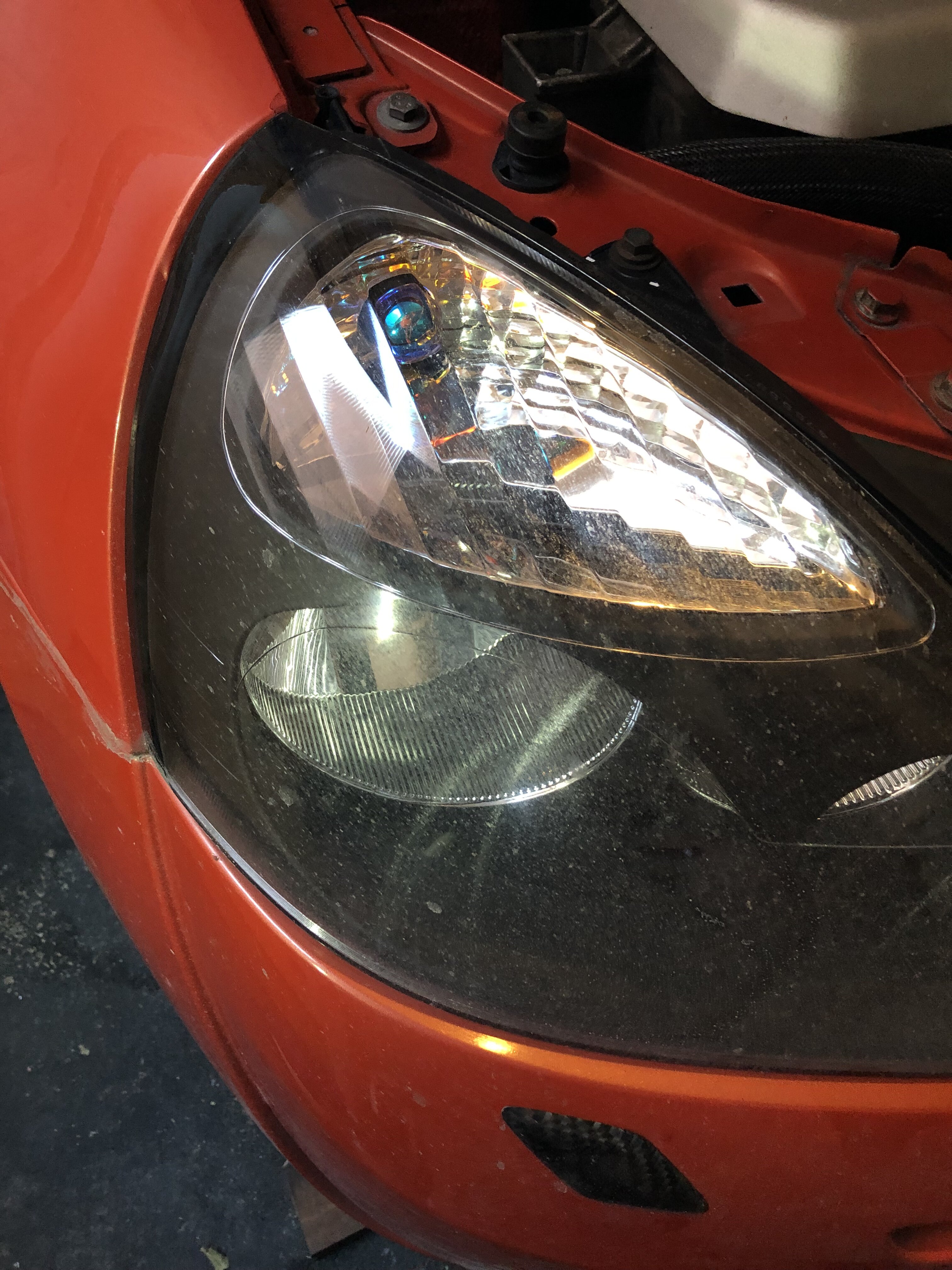

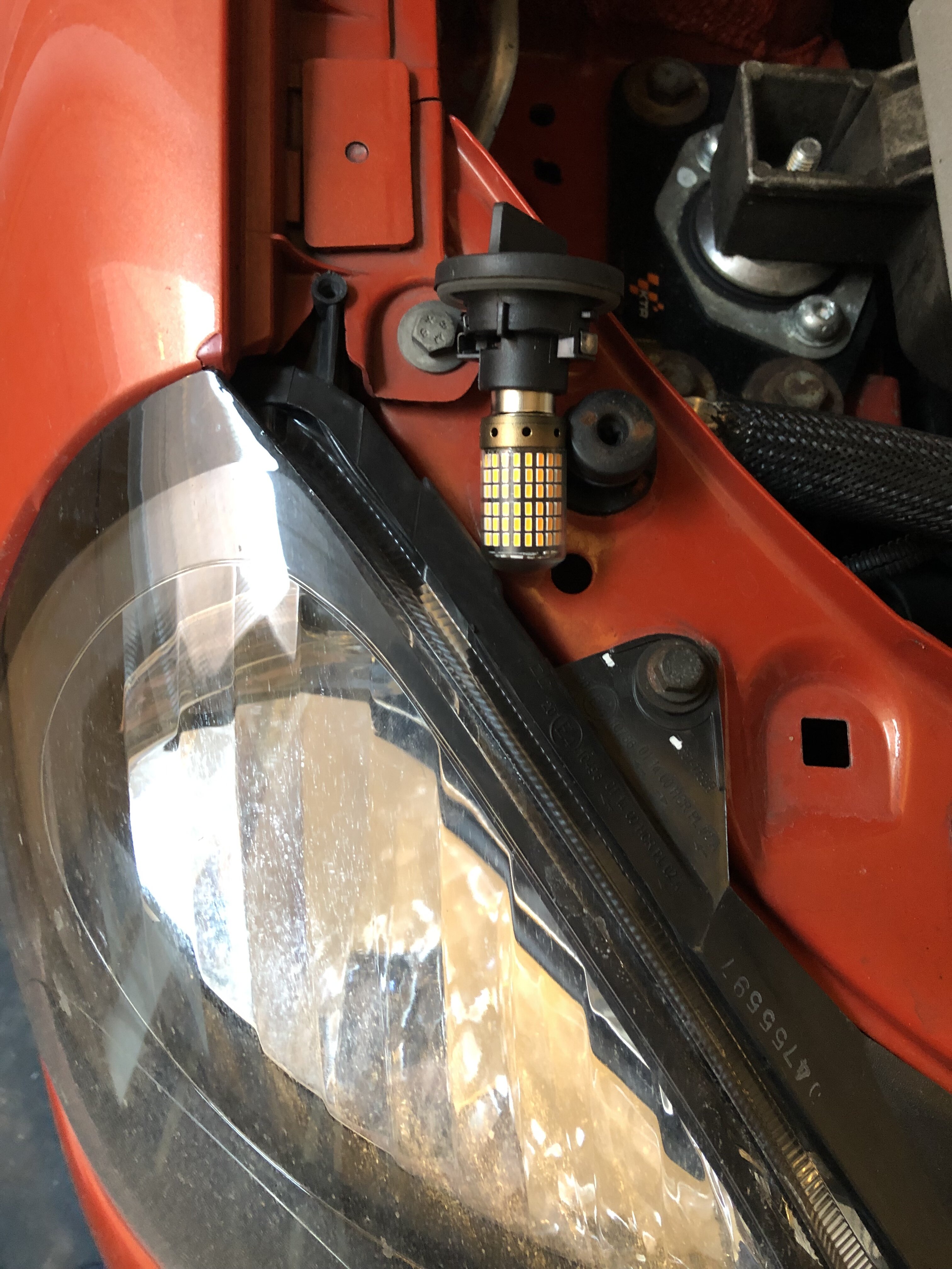

Whilst the bumper was off I took the opportunity to replace both fog bulbs as one was an Osram and the other a Philips.
I now have a matching pair of Halfords 5k H11 bulbs fitted with a slight blue colour to the bulb which matches the iridium indicators well.

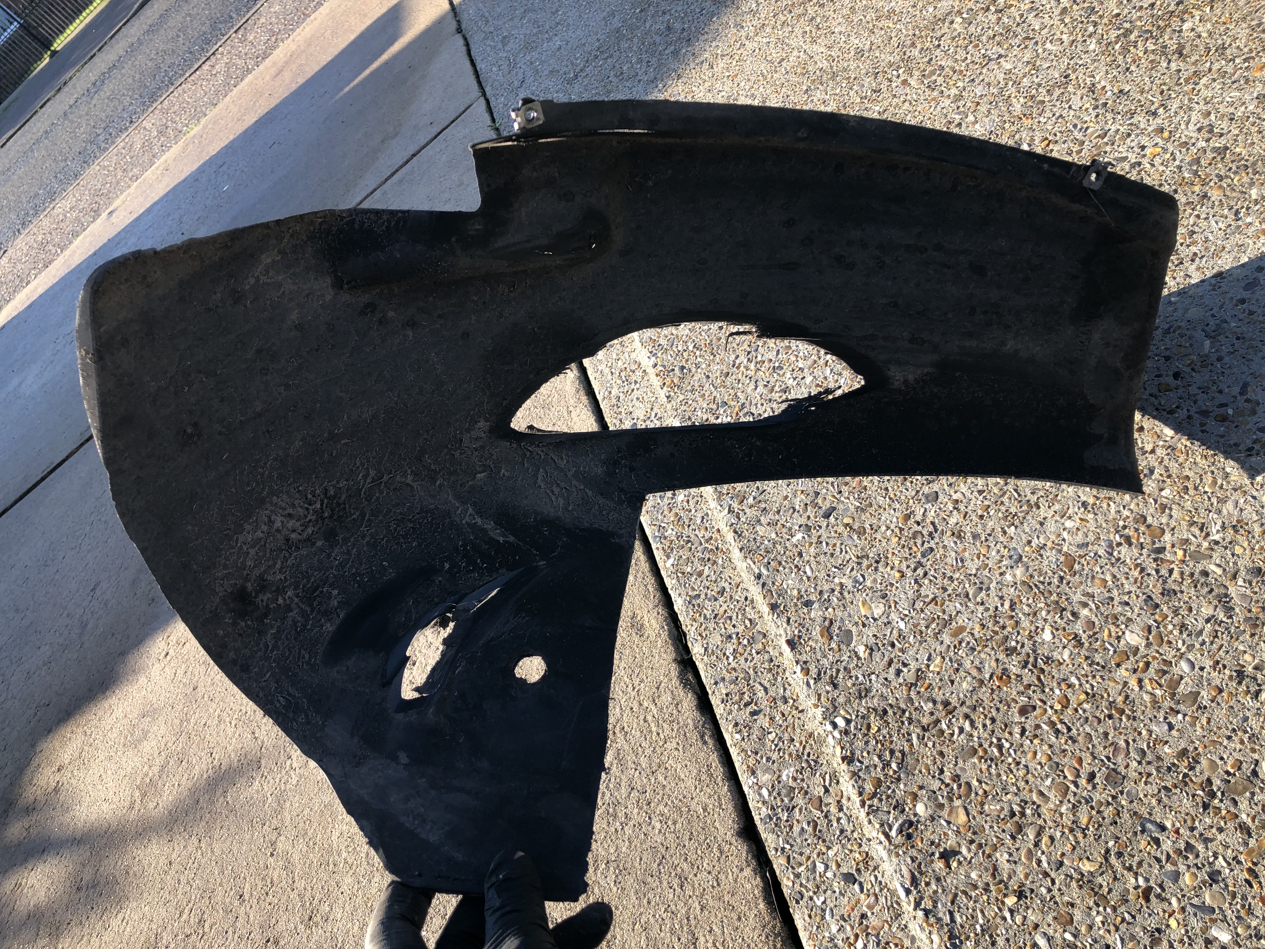

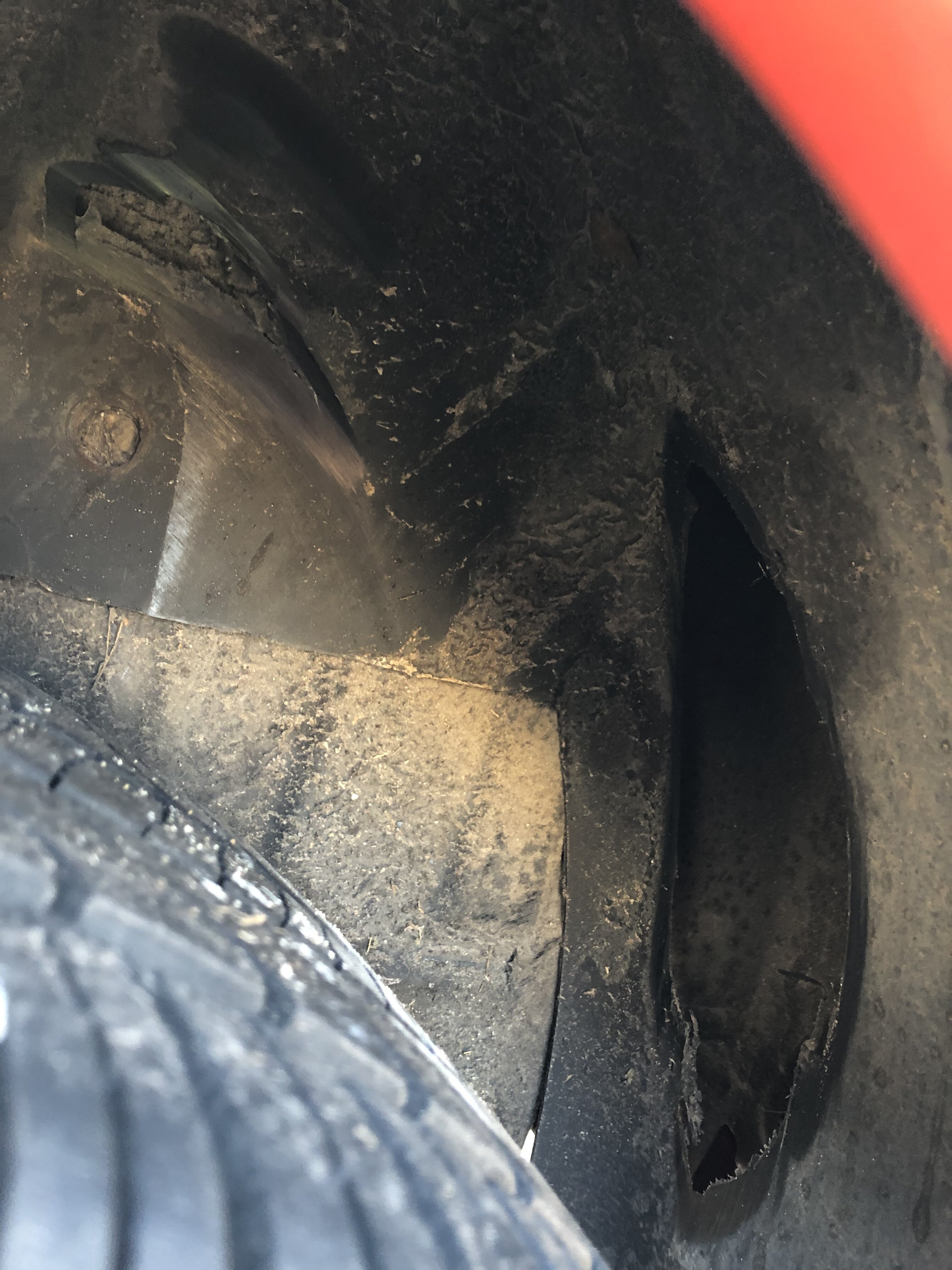

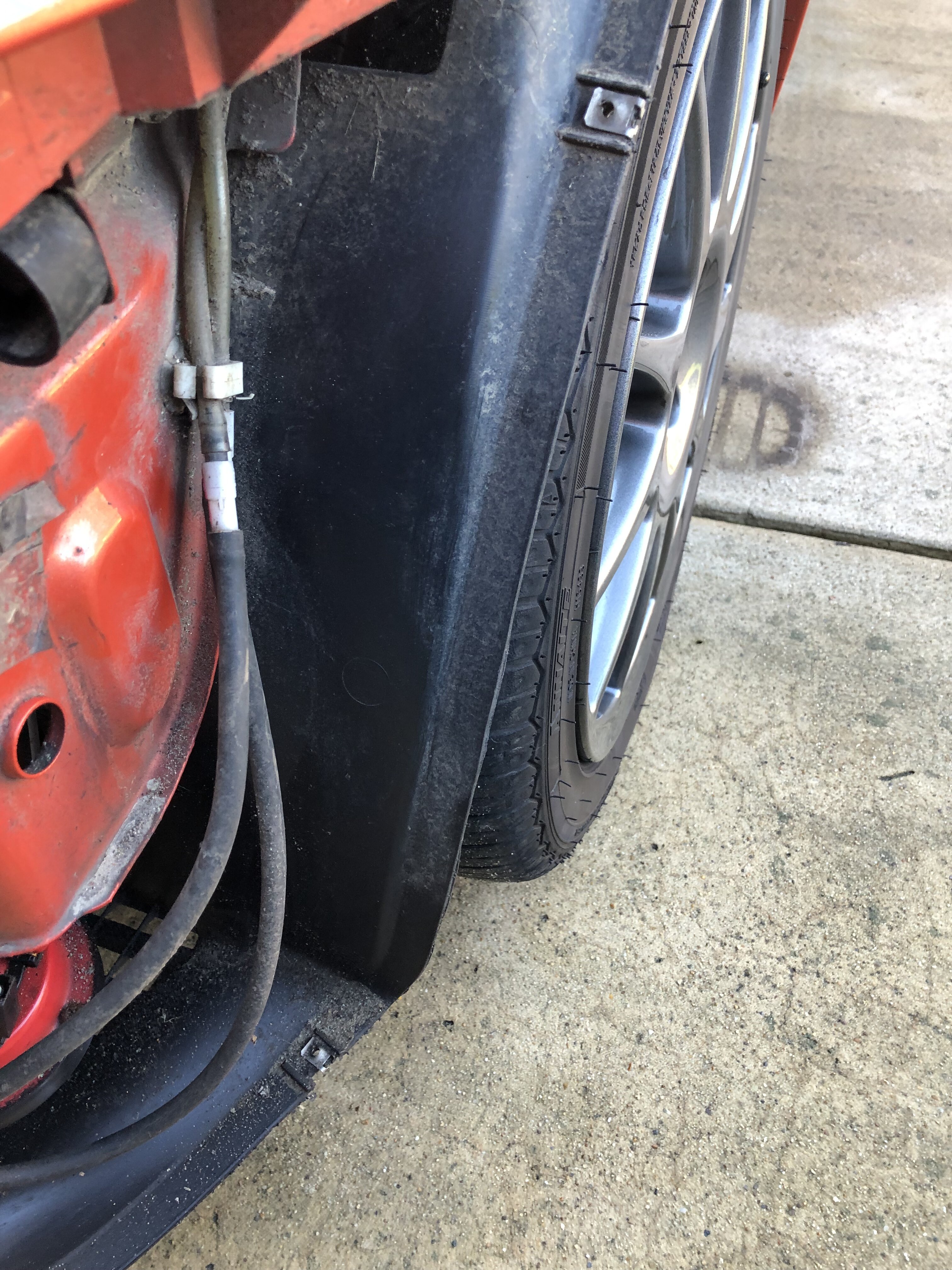

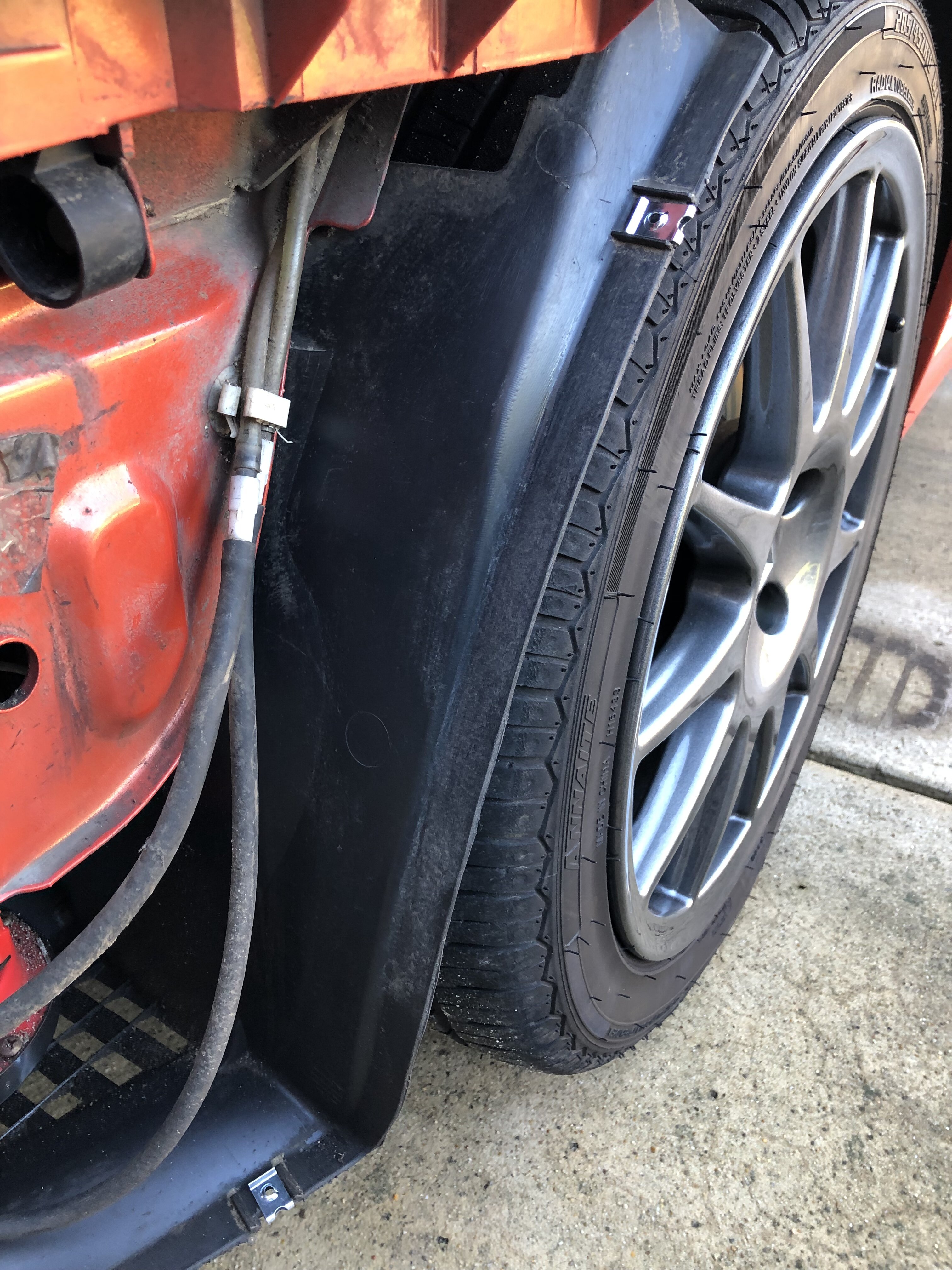

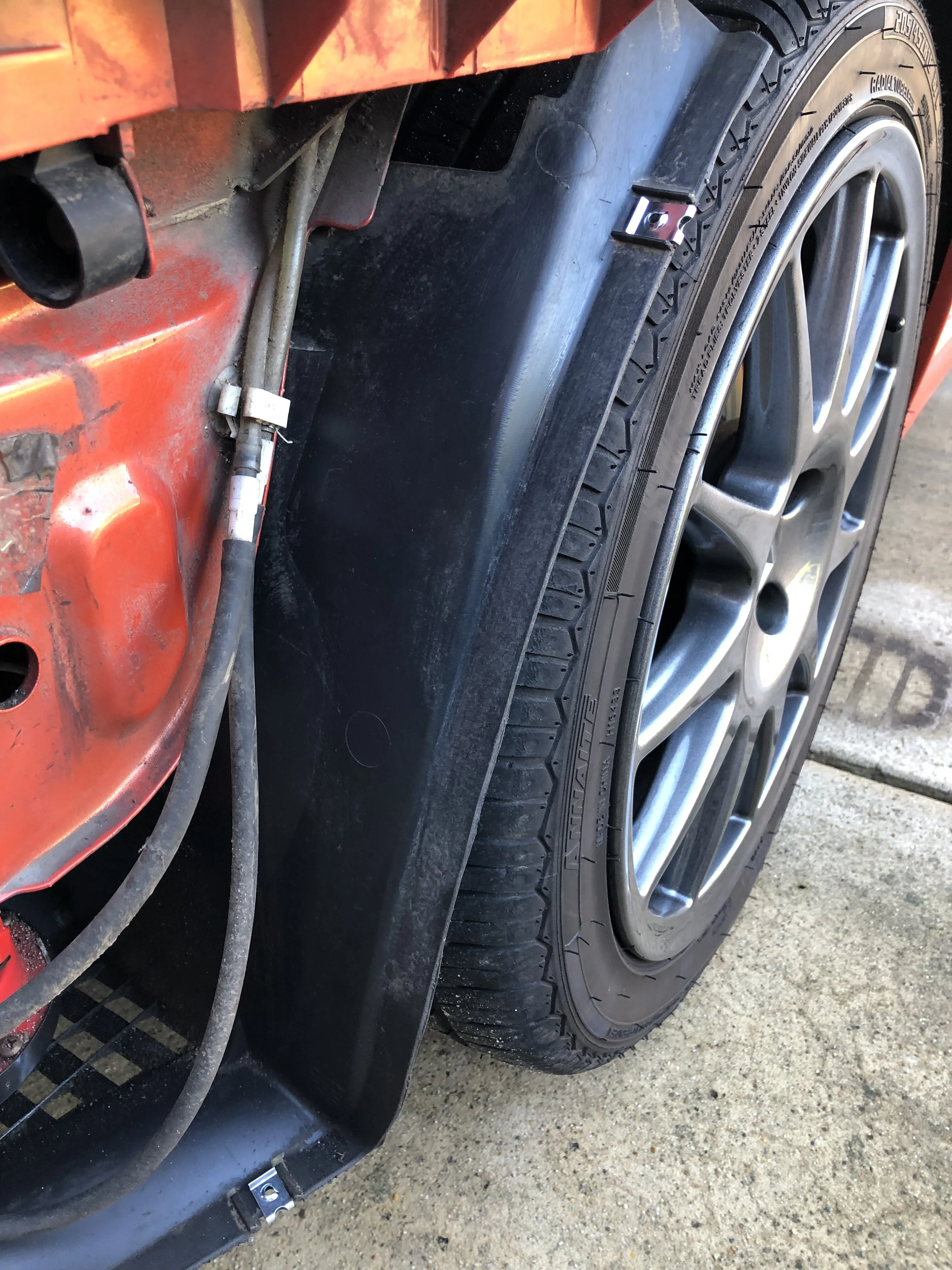

Finally… I wanted to address a rubbing noise I’ve been hearing whilst moving the car in and out of the garage.
Turns out the secure clip/bracket has failed at some point allowing the NSR arch liner to fall down and rub on the tire 🤦🏻‍♂️

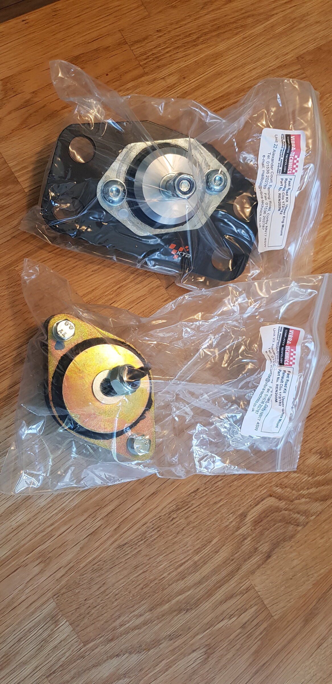

These are the ones I purchased from ktec and the same as fitted to my track car.
I have owned my fair share of Clios over the last few years. I have always found if just one of the three main mounts is uprated(especially dog bone on its own), then this seems to cause a lot of interior vibrations. I also think it then causes that one mount to be taking more load than the others and transfer to the car.
I thought originally that by fitting solid(they are not completely solid, not far off though) that the vibrations inside would be unbearable. Completely the opposite. With engine, gearbox and dogbone replaced together it is excellent. I have used my track car as a daily for various periods of time over the years and if the mounts were that bad would have changed them.
With the turbo set up there is too much torque for the standard mounts in my opinion and these are perfect. There are obviously some vibrations, but greatly reduced from the set up I did have.
Hope that makes sense.
I done some digging and it turns out they are in fact K-Tax solid mounts 👍🏻

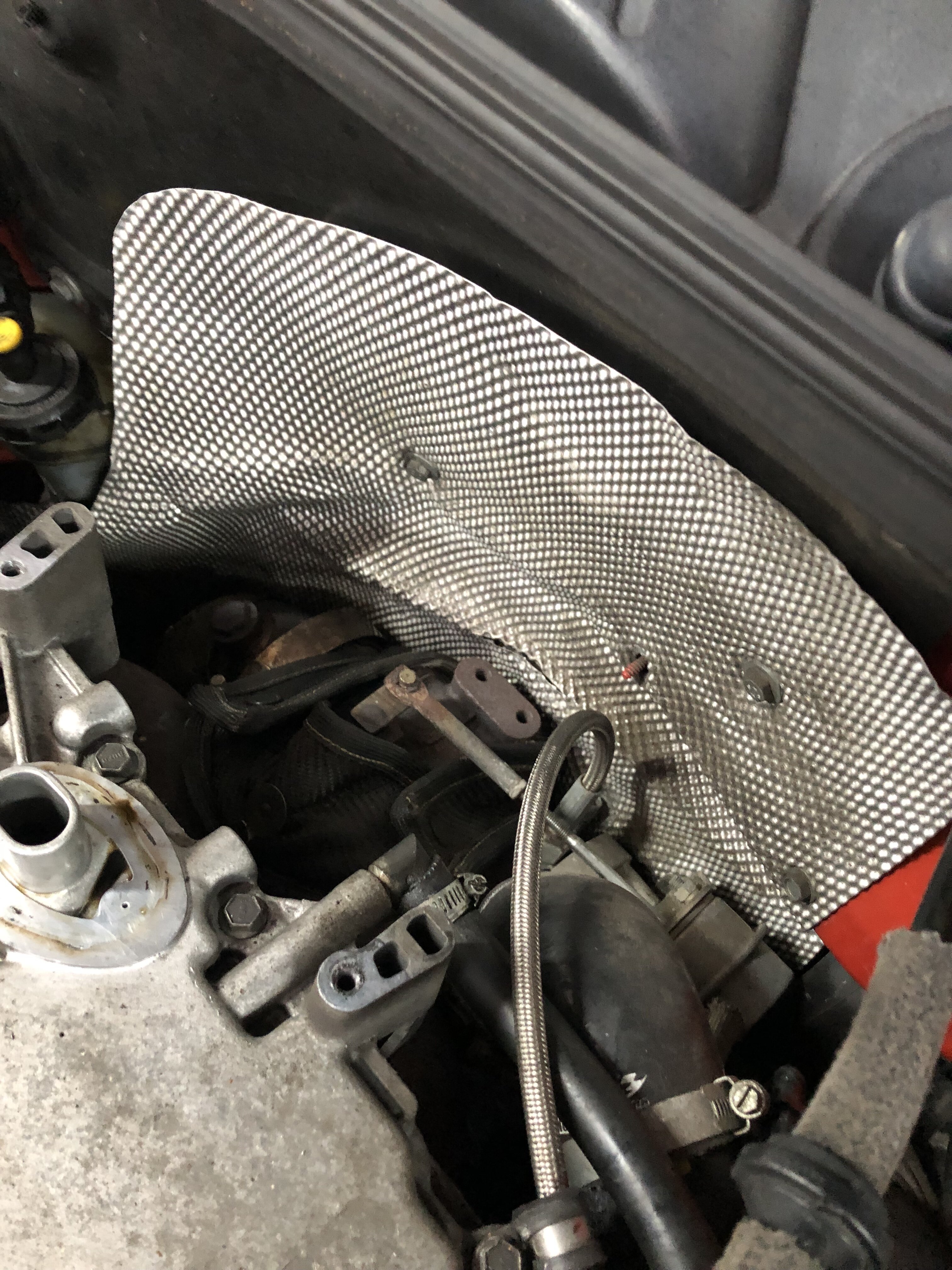

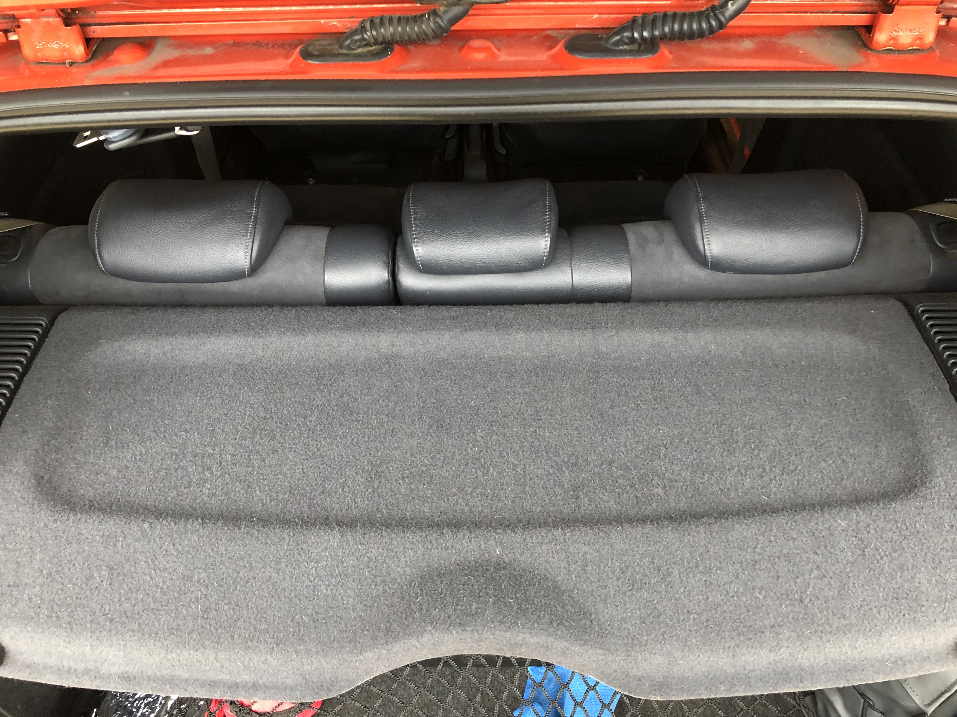

Cover looks good mate, did we get an ecu repor tab out to you? Noticed yours was broken with a cable tie and I can’t allow this im afraid 😆.
coming together now mate 👌🏼
