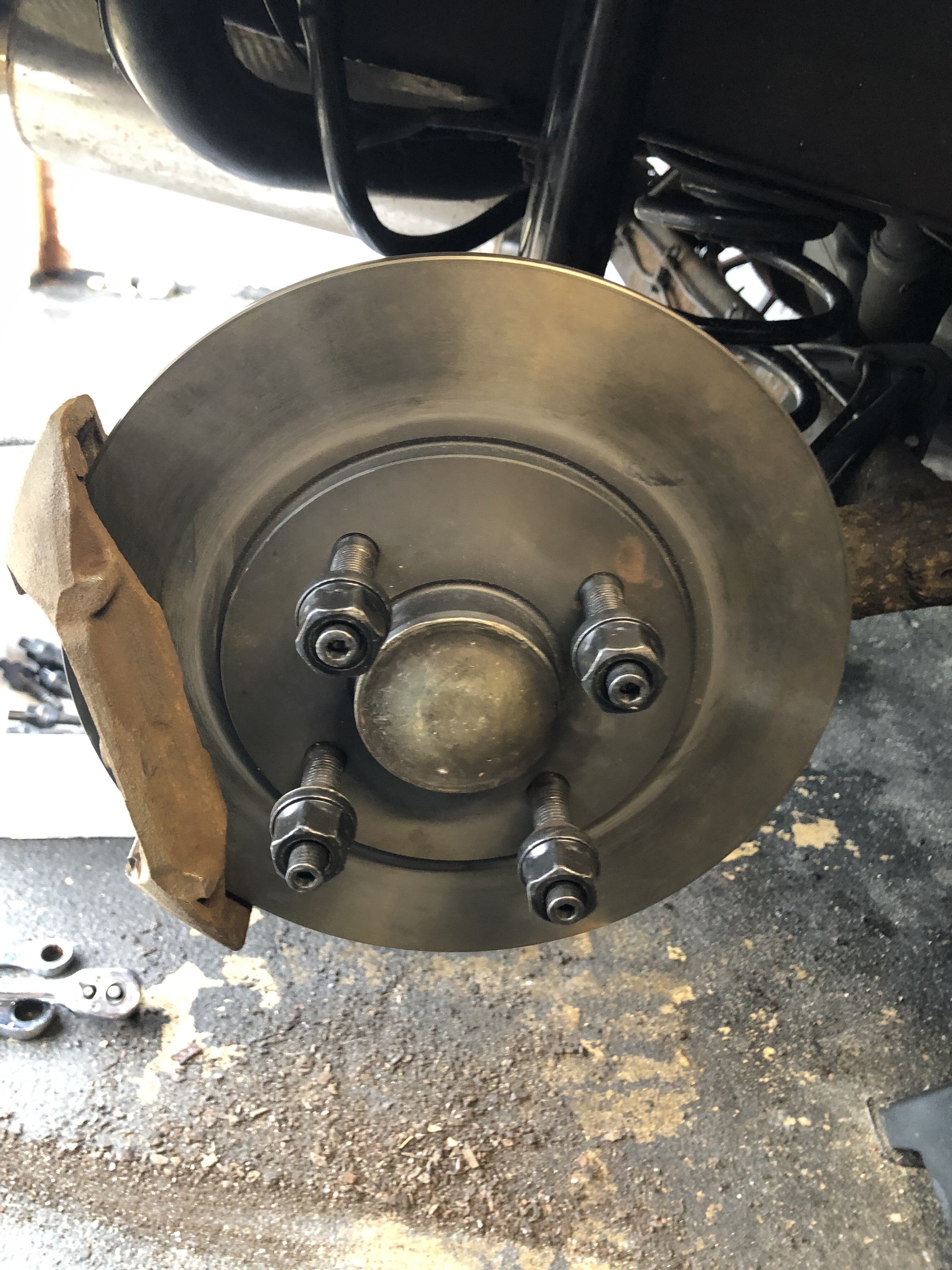

More progress on the rear end today.

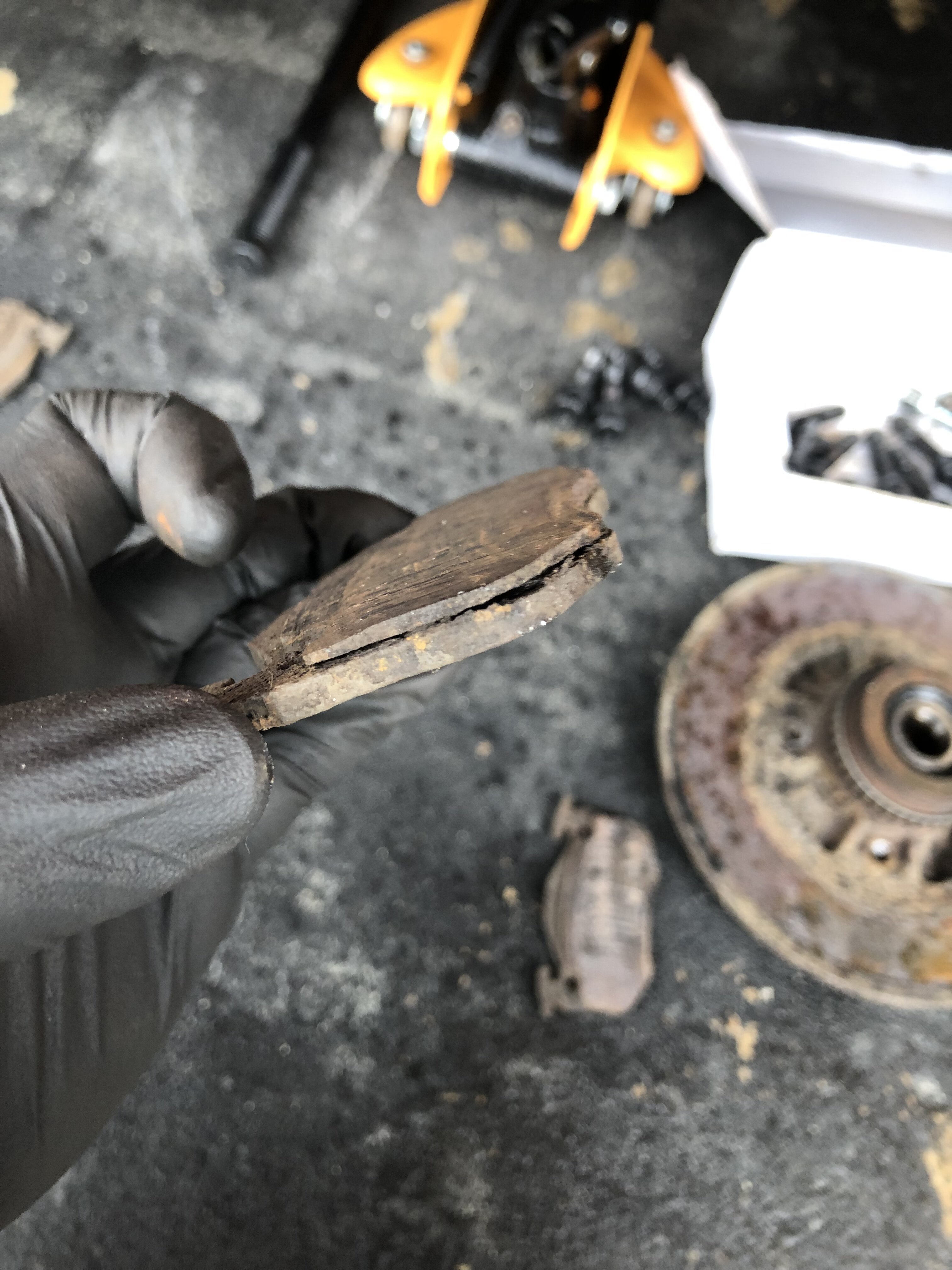

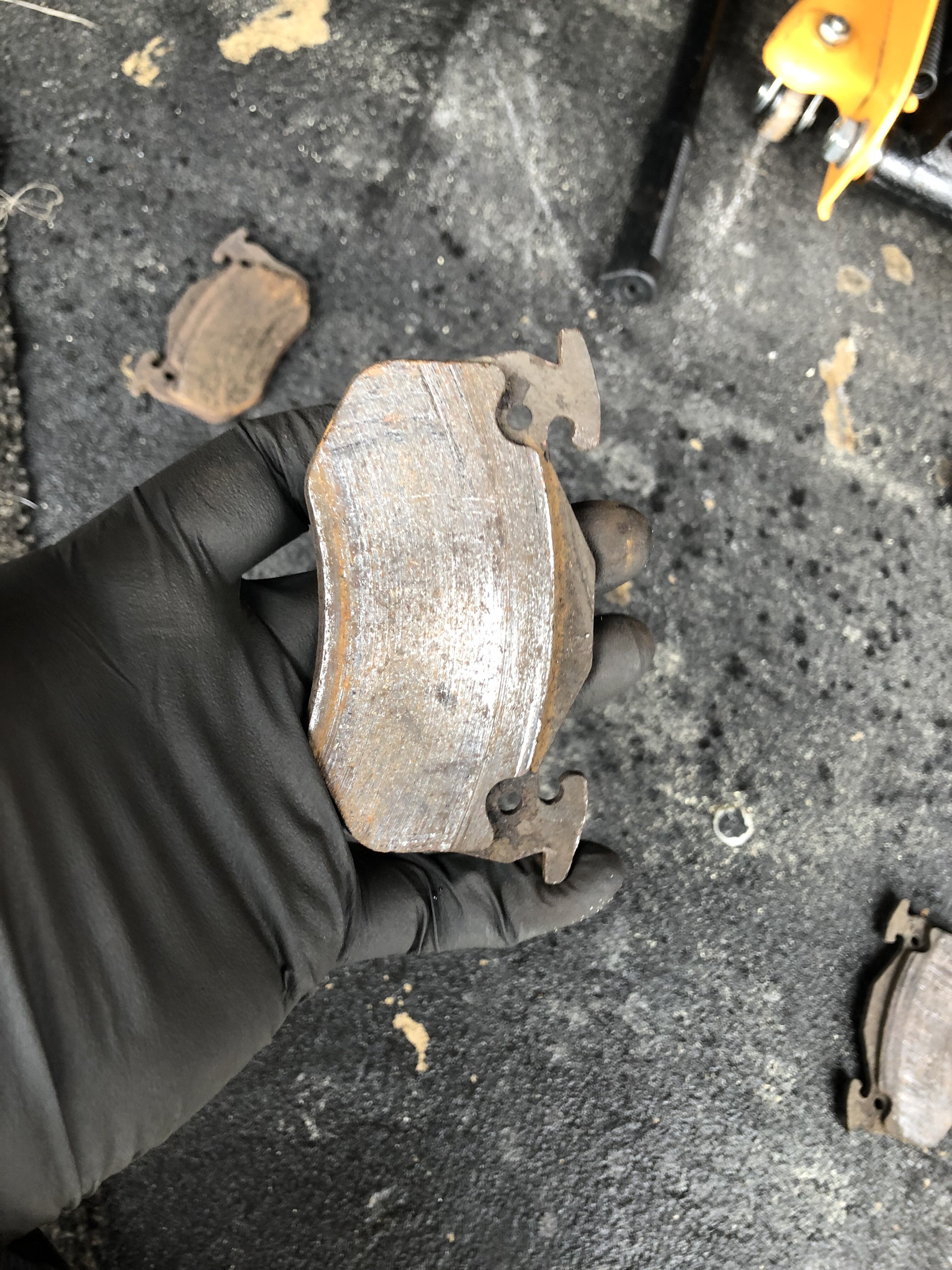

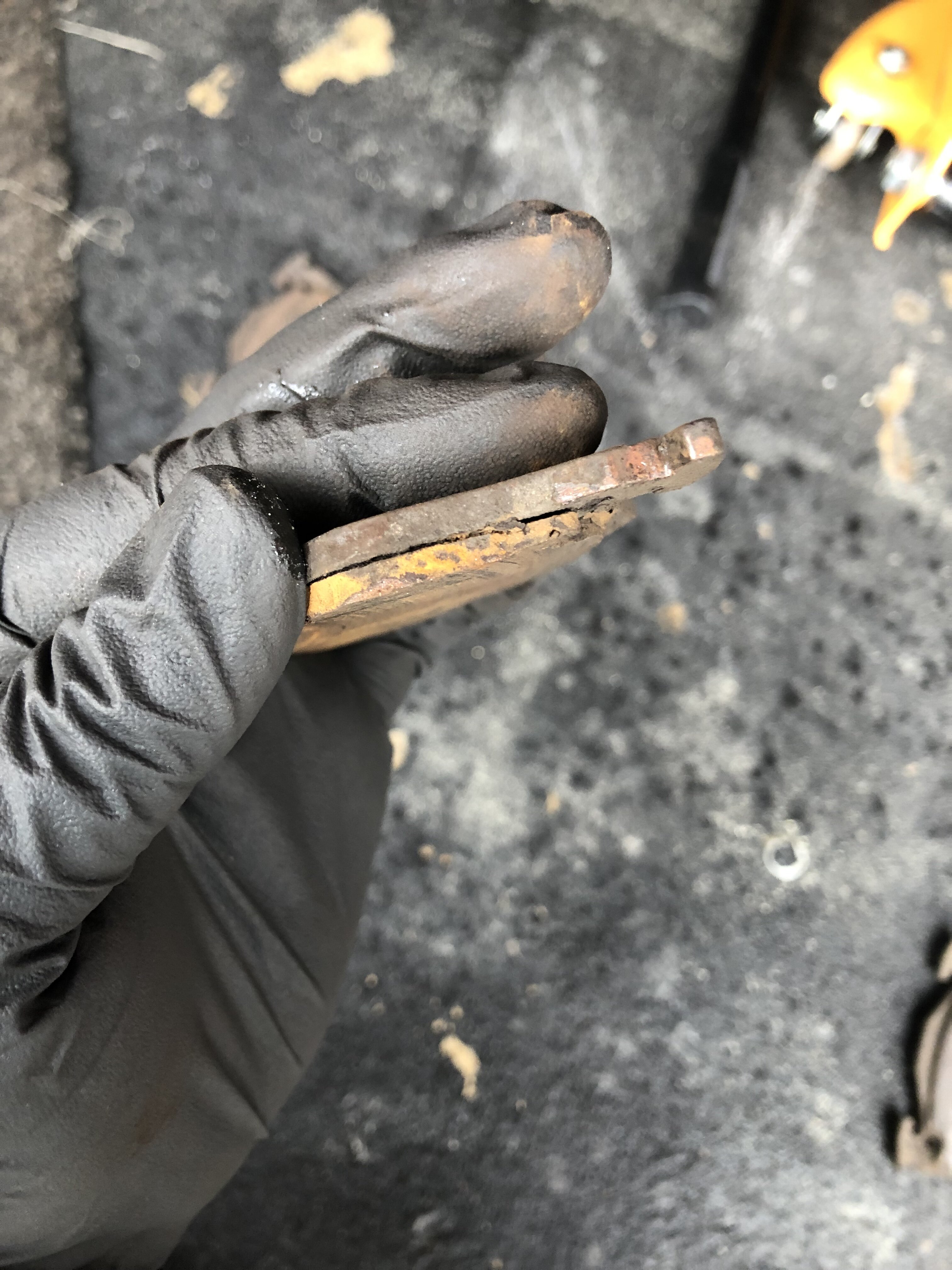

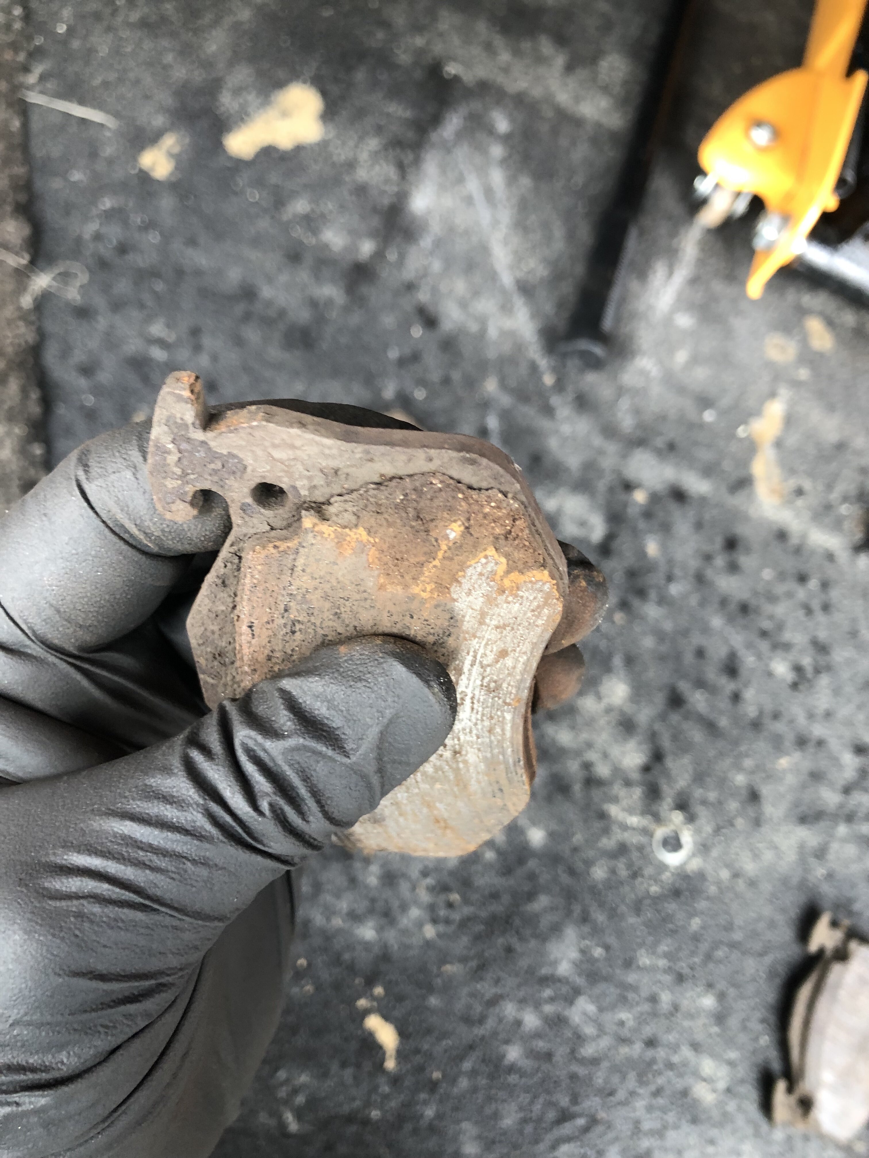

@pure-motorsport spacers fitted, new disc on but the pads given to me were the same shape but the compound itself was different between the pair. Super tight to fit and just didn’t look 100% right.
Straight in the bin they went and a quick order on @George@RTR_Parts web page and a set of brembo pads should be on the way to me soon.
Been lucky with the pads removed tbh…
This is how I’ve left both sides this afternoon while I wait for pads. I need to get some paint for the calipers too but still undecided on colour.

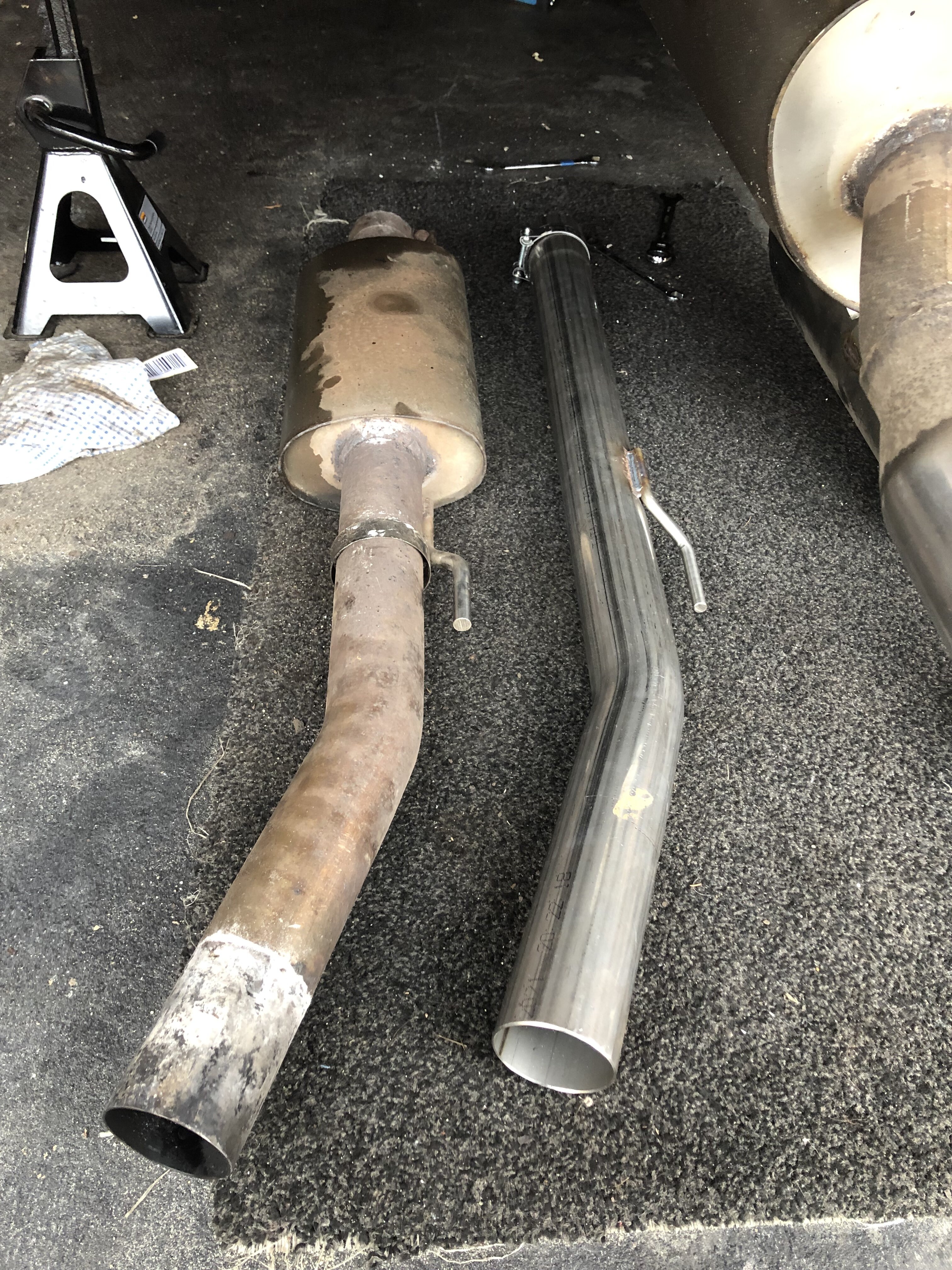

10mm PMS spacers for the front from @cjgower to run instead of the 16mm I normally would do and a non-res pipe for my Milltek system to hopefully release a bit more noise.

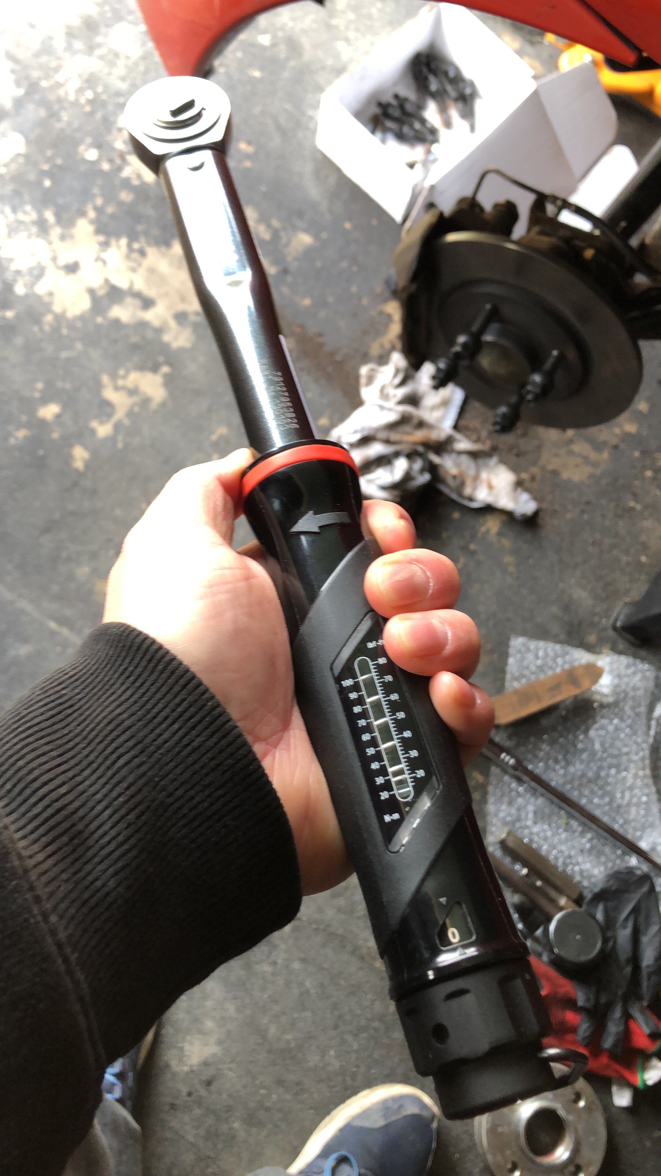

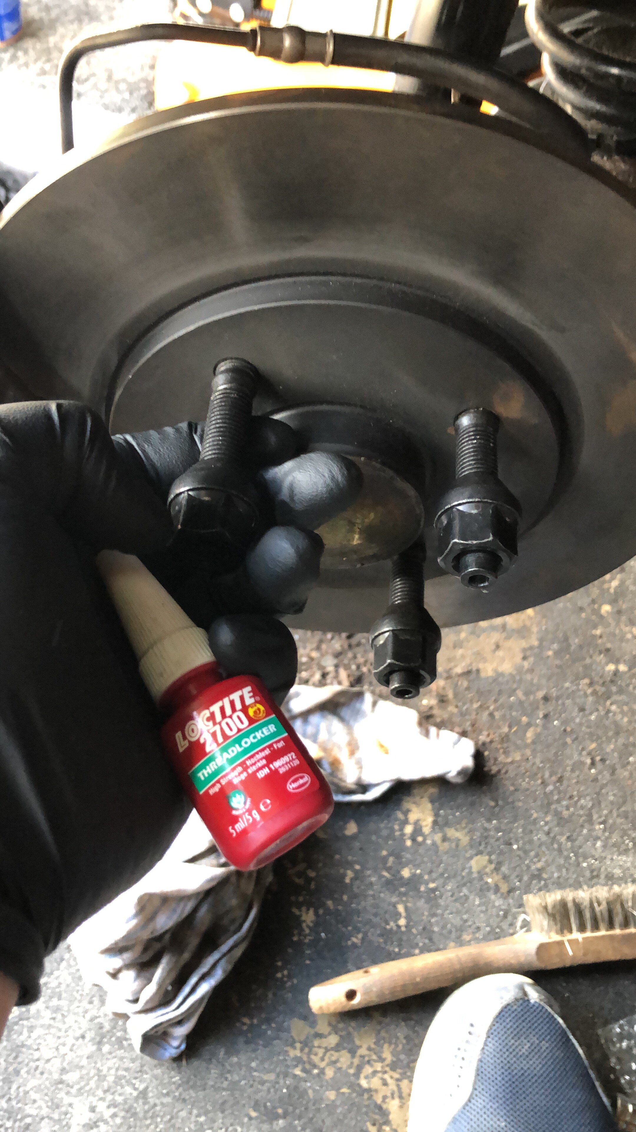

Let’s start this update with shiny new tools… Norbar 20-100nm Torque Wrench 🤤
Which after arriving today, promptly and correctly torqued my studs in situ.

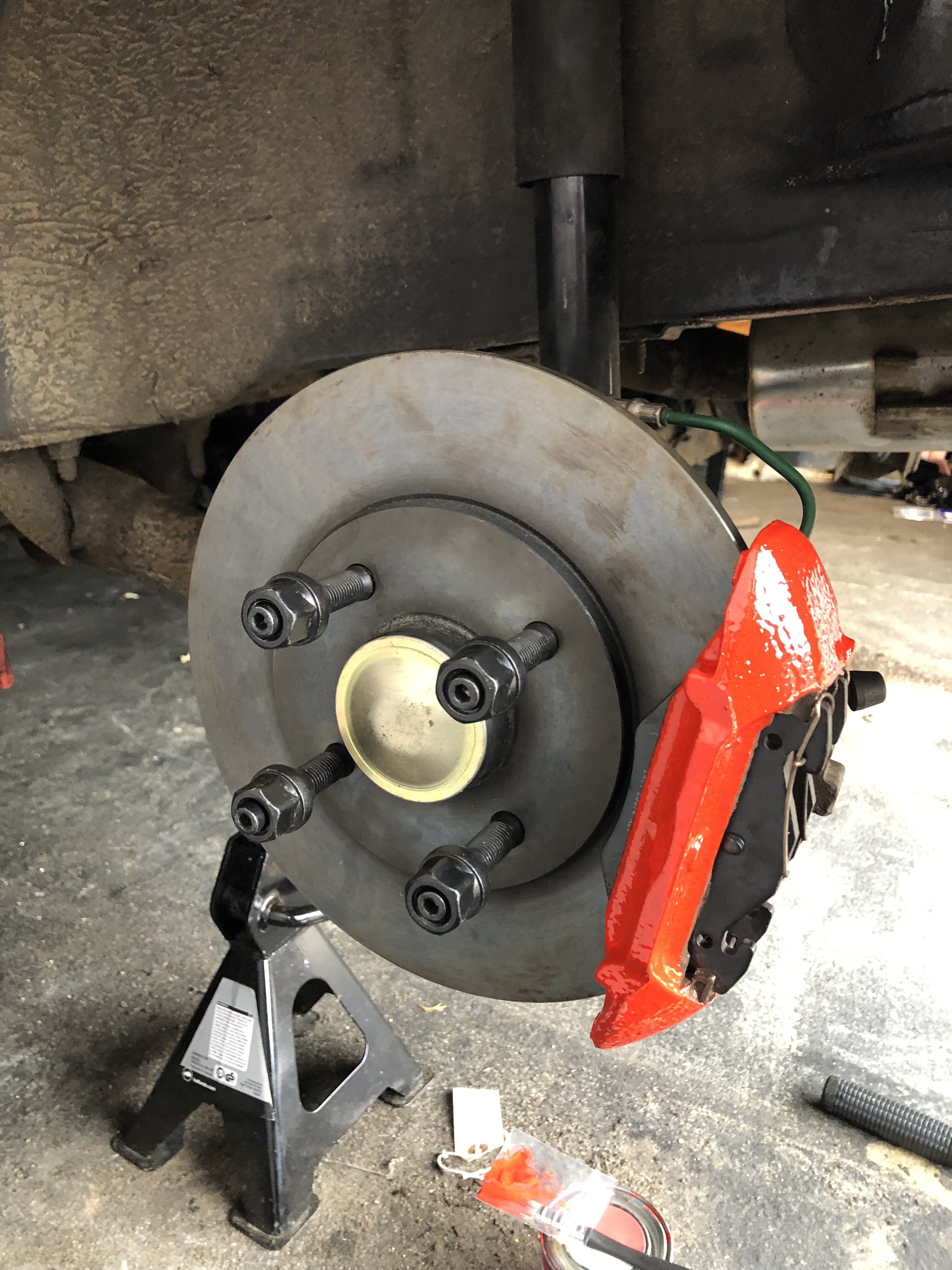

Still waiting on brake pads from George for the rear but I have dug out my red paint ready to give the calipers a freshen up of paint. Whilst working today I also drilled and tapped a hole to re-secure the rear arch liner.

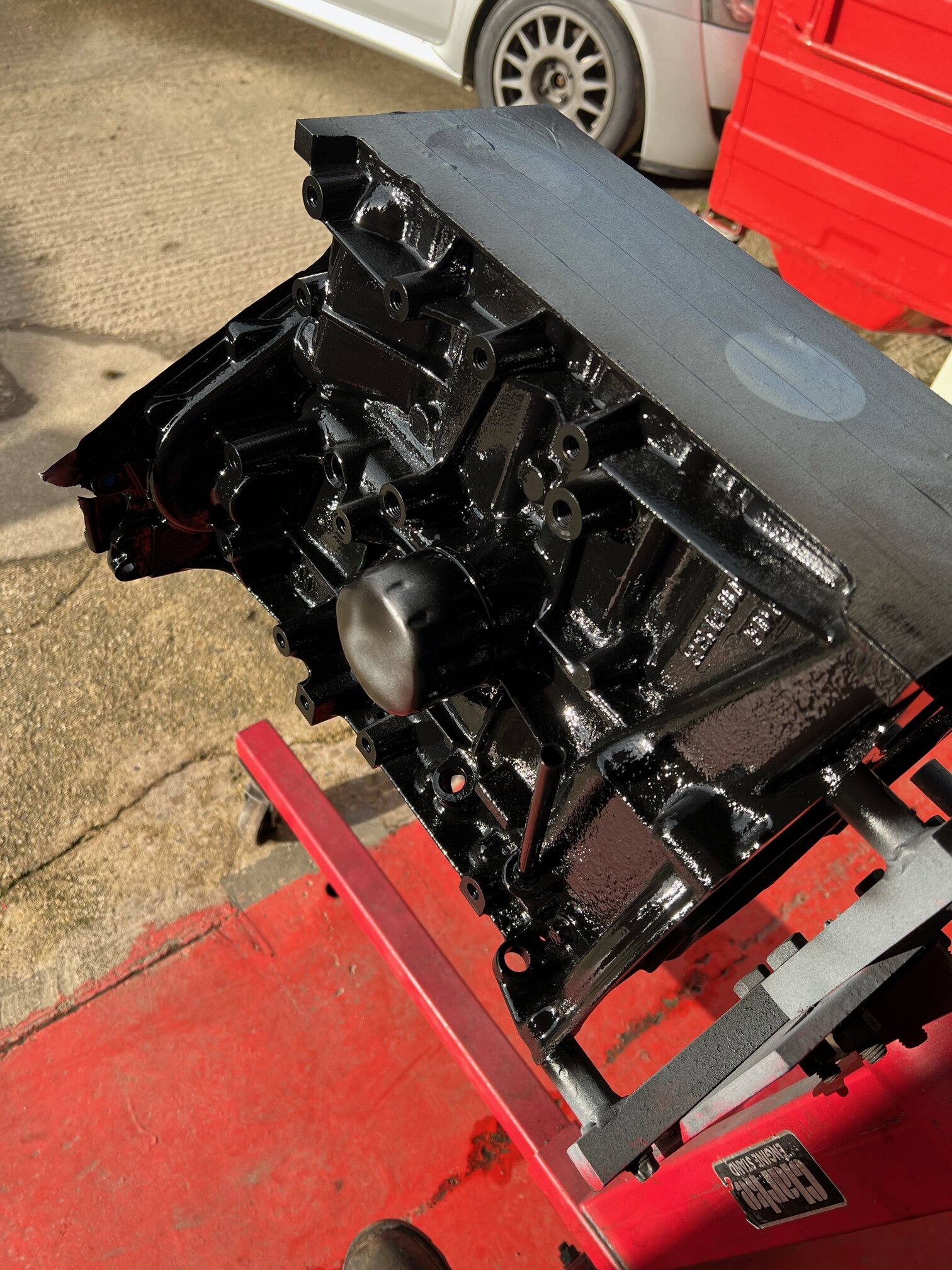

The block came back from machining today.
Forgot to get a bare photo but core plugs fitted & fully painted. I’ve got a couple of busy days but hopefully get bottom end built this week, head is on the bench fully stripped, lap valves in that, clean, assemble & refit sometime next week, quick process from here.
More updates soon & we’ll plan a date.

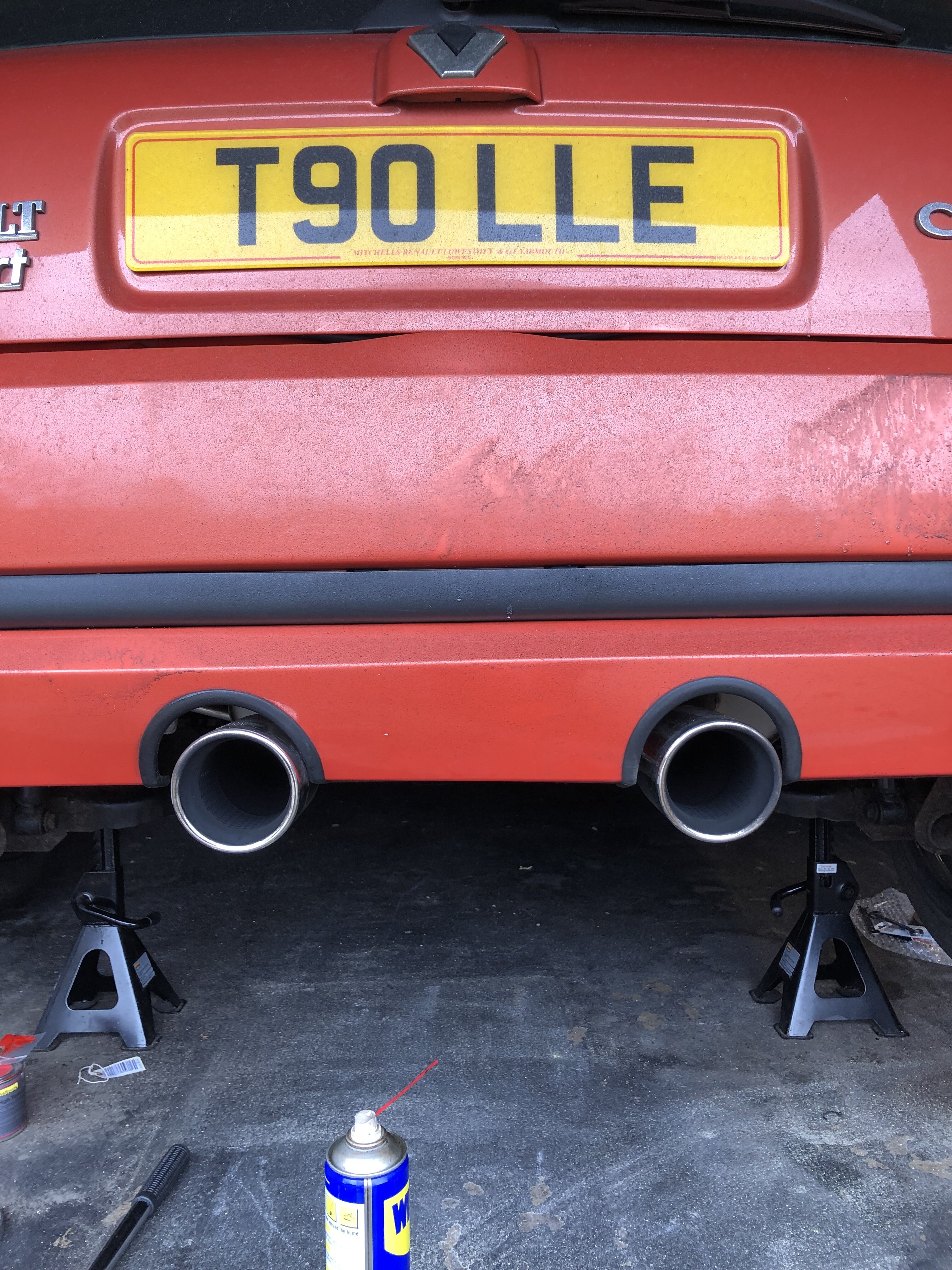

De-res pipe fitted…
Which has now led to major misalignment at the back end.
The right side sits nice but the left just will not move over at all, honestly thinking about applying some heat to bend it over!

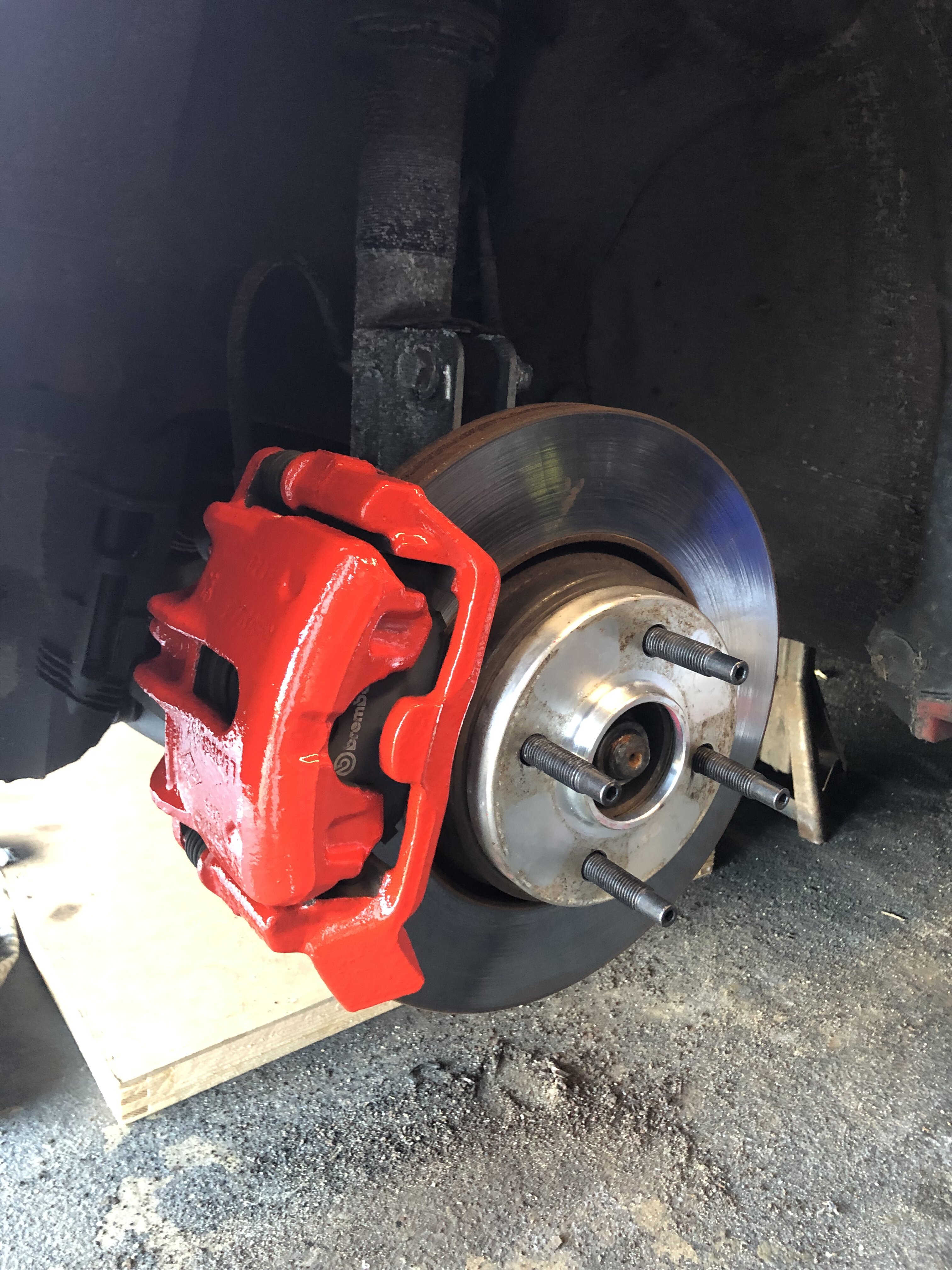

A quick lick of paint to the calipers after fitting my new pads which arrived this morning whilst doing the exhaust
Then a quick fit up to see it all come together.
To recap the rear end has had…
PMS 10mm stub axel spacers
PMS Stud conversion
New oem discs
New brembo pads
Freshen up the calipers with paint.

Looking good mate. Is that a custom centre section?
Fleabay special mate got it for £60 which good considering it’s up for £94.50 and some others are £100 plus.
I know you were looking for a while which is why I asked! Glad you're sorted. Milltek sounds epic straight thru.
Yeah was looking for ages! They just don’t seem to come up for sale used much.
The BG I had was straight through with a single John Ashley box an it was probably the best sounding n/a Clio I’ve ever heard.
But when I fired up the Inferno I didn’t think that it sounded different to when it had the centre box, probably because I’ve not run it in ages haha.
Hopefully it’ll sound decent when I get it out on a run!

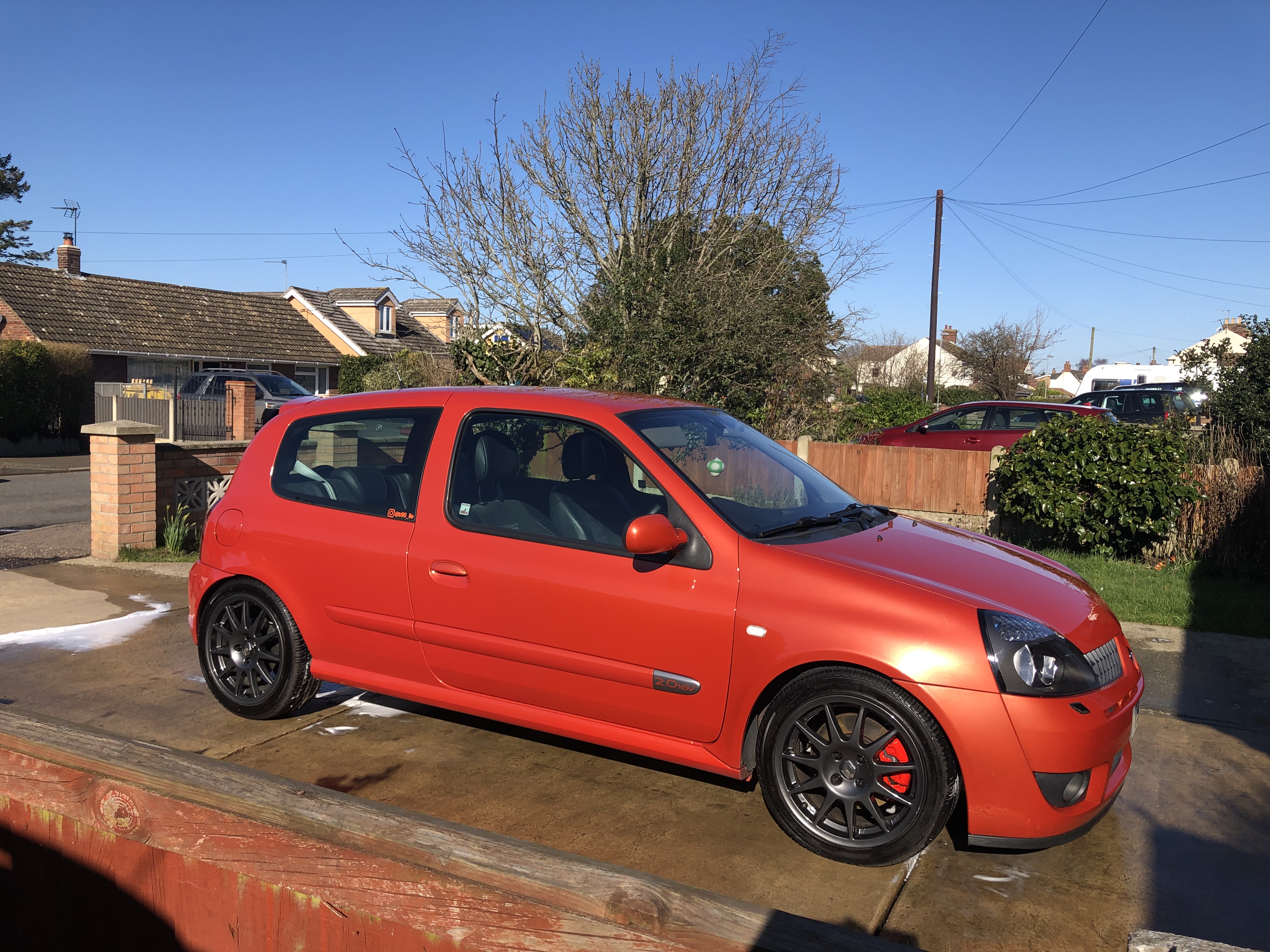

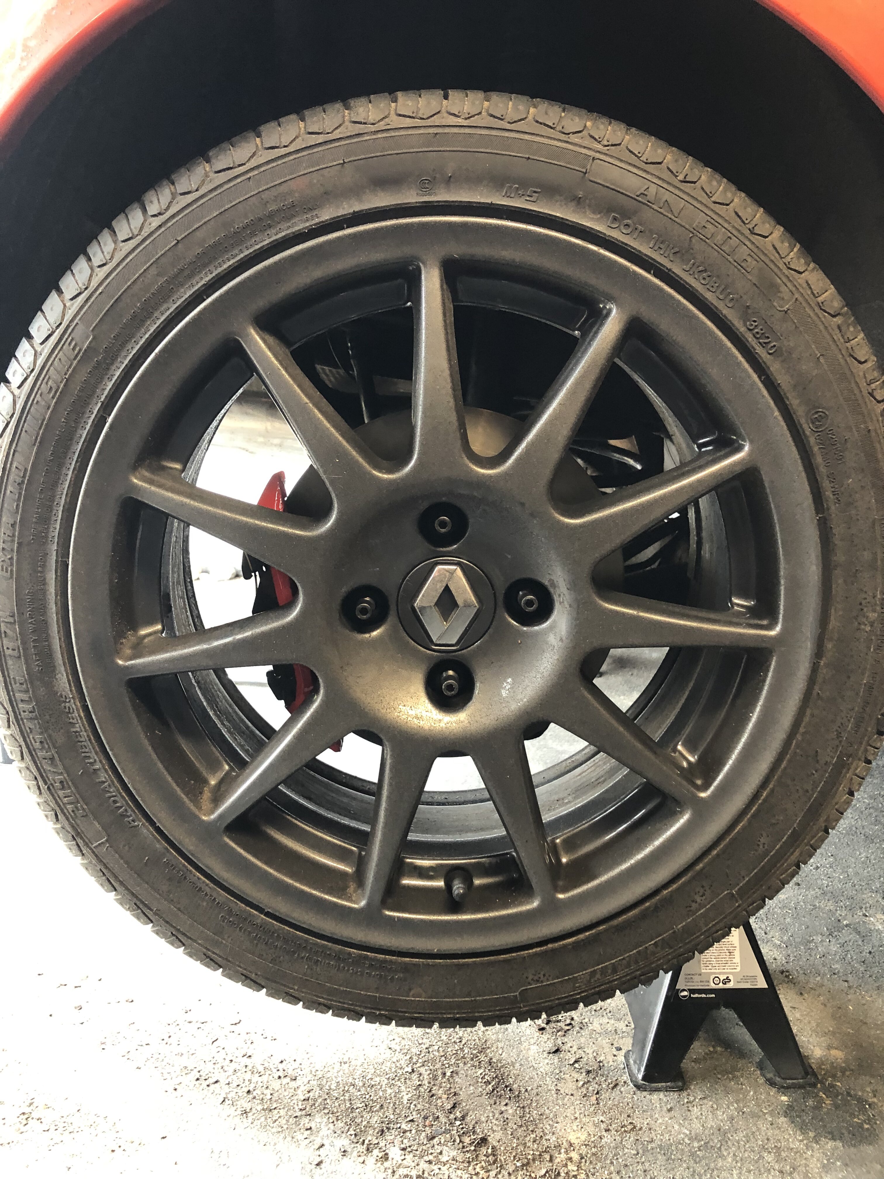

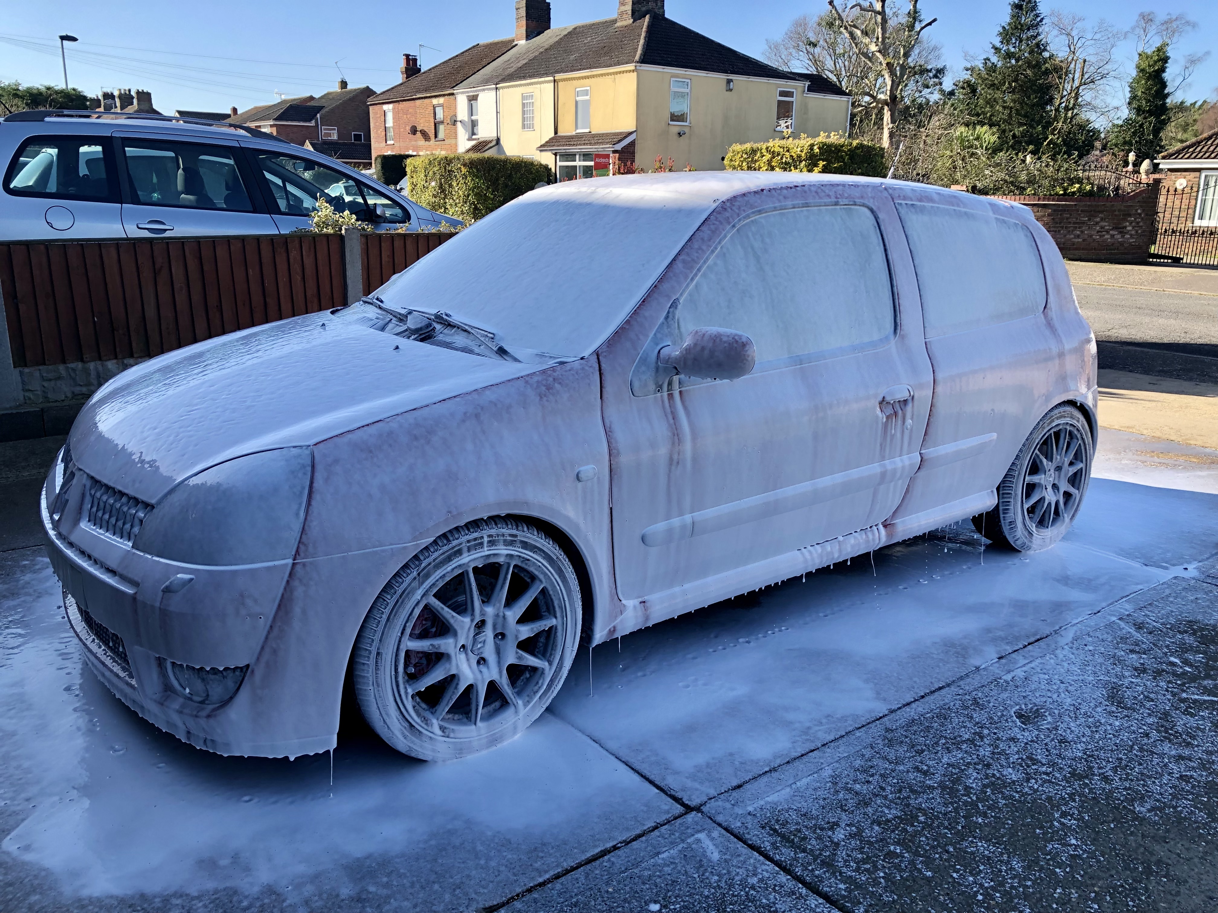

Finished off the front yesterday and gave her a much needed bath as it’s been covered in grime/salt for the past 4 weeks.
Put the 16mm hub-centric spacers on but I think I’ll be changing these out for the 10mm PMS ones I recently acquired as they rub when turning lock to lock. I also need to raise the back up a bit more as again I scrub ever now an then over bumps.
Photos don’t do the colour/paint any justices as it really pops in the sunlight.

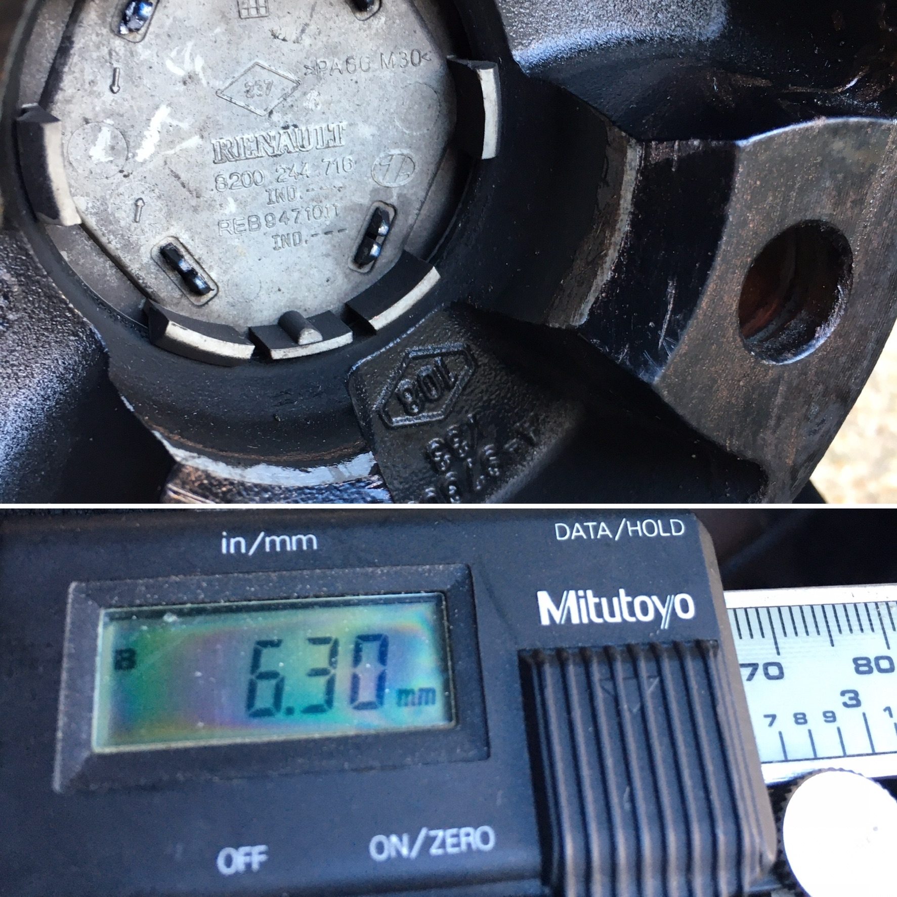

You won’t be able to run 10mm slip on spacers with the Turinis. 10mm on the hubs leaves only 4mm of the hub nose protruding for the centre of the wheel to locate on.
The Turinis have a 6mm chamfer on the rear which leaves you 2mm short. For this reason you should only run a maximum of a 5mm slip on on the front with a Turini, failing that, a 16mm is the next size up as these are hubcentric and have their own centring hub for the wheel centre to sit on.
Some idiots will tell you that you don’t need the wheel to locate in the centre and you just use the bolts/studs to centre the wheel but this is incredibly dangerous. The studs/nuts are not there to hold the wheel true, they are purely to stop it falling off.

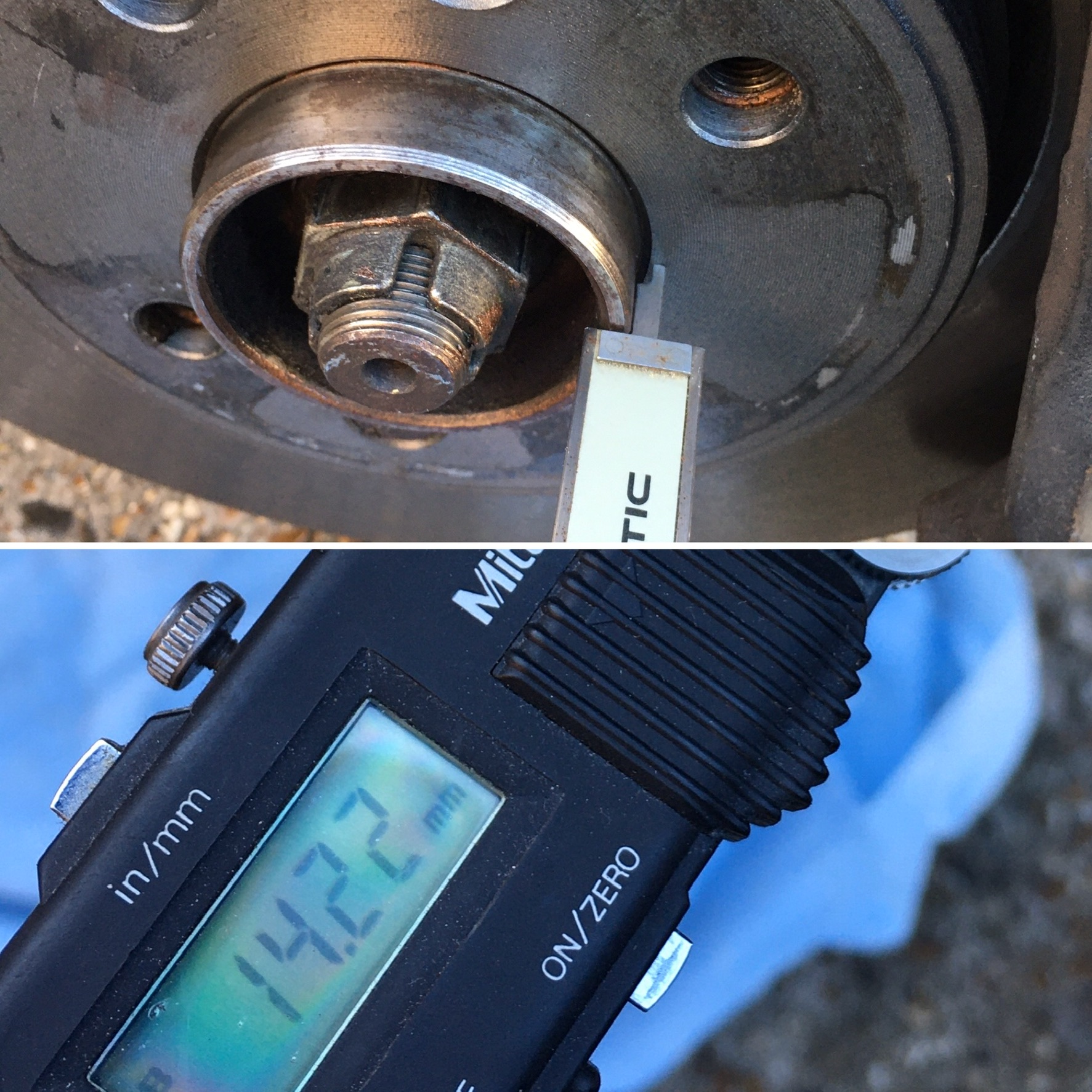

Can’t you get 10mm hubcentric spacers from H&R?
The OEM cup hub nose protrudes 14mm so you physically can’t fit anything less than that in a hubcentric fitment. This is why most you see start at 16mm to allow some clearance.
Is that different for non cup pack hubs? I may have to drop the front wheel and measure later.
I don’t know for sure mate. I only have Cup hubs so can only go from what I’ve measured on my own car.
A lot of this is outlined on the PMS website too.
A Speedline 2118 for example had only a 2mm rear chamfer so can be run with a 10mm slip on spacer without issue.

I would like some 2118’s but are they not about twice the weight of a 16” Turini?
edit: just seen one of your older posts a set of 16” Turini vs 15” 2118 with tyres is basically the same weight 🤔🤔

Looks like I’ll be running the 16mm until I get some 2118s then 😂
Depends. I'm running RCK hubs which bring the front s out 5mm, so a further 5mm spacer makes 10mm overall and 20mm increase in front track. So yes its can be worth it. All depends on what you're looking to achieve.
