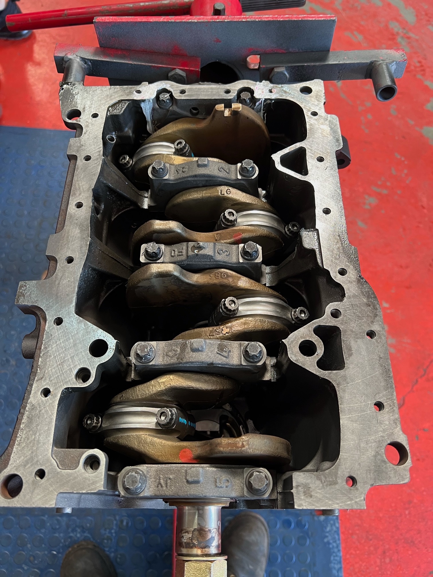

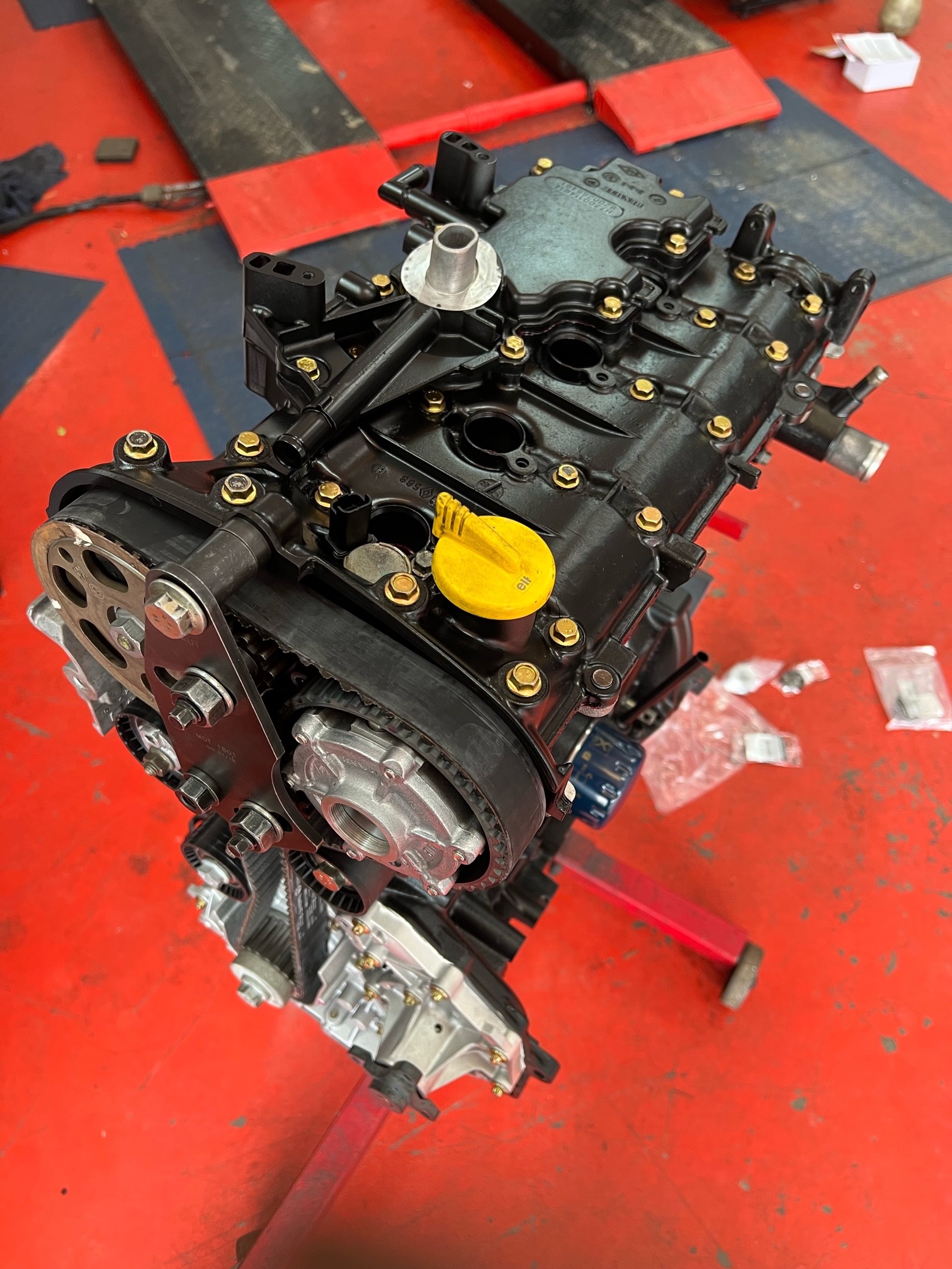

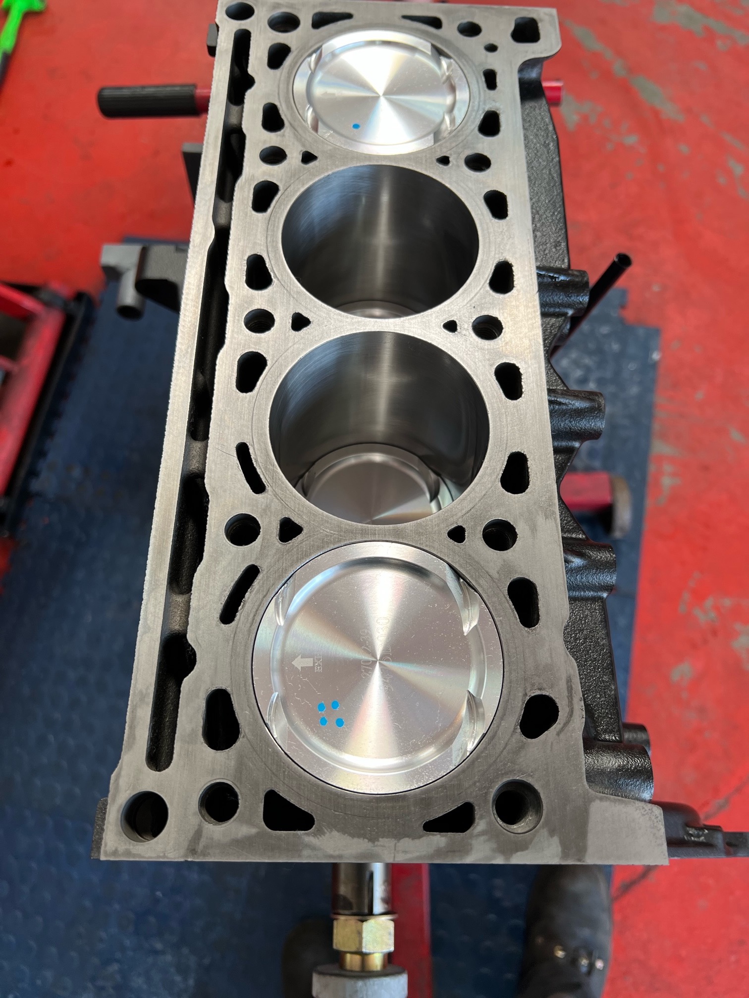

Sorry for delay, the crankshaft I had initially chosen for your engine I rejected as it wasn’t perfect, meant I had to wait for another crank back from the machine shop, as it’s been polished for a perfect finish.

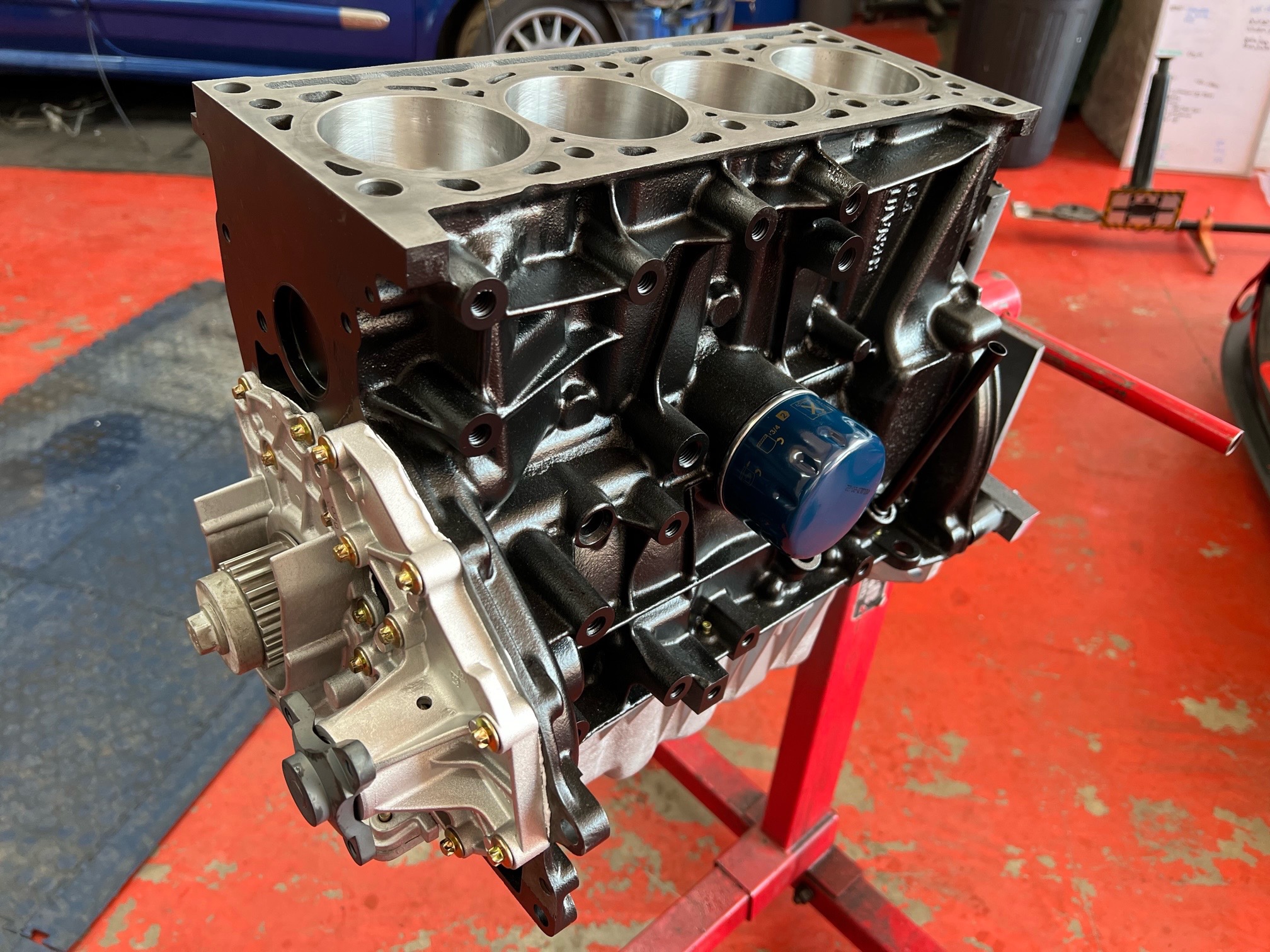

Anyhow, now we have a complete bottom end;
Polished crank, PEC forged conrods, ARP conrod bolts, genuine Renault big end & main bearings, new genuine Renault oil jets.
Wossner forged pistons, 9.5.1CR, 83mm 😎
Complete bottom end minus a few trinkets, genuine Renault oil pump & painted sump on, genuine Renault water pump, keywayed bottom crank pulley, with plated bolts throughout 😎
Head is progressing, had a machine break so only got about half way through that but will have that complete & fitted by end of week along with cambelt etc, leaving the final bits to be swapped from your old engine once we have it out.
Any preference for cam cover etc colour? Ideally black or silver! Contrasting inlet normally works well.
Many thanks, Alex

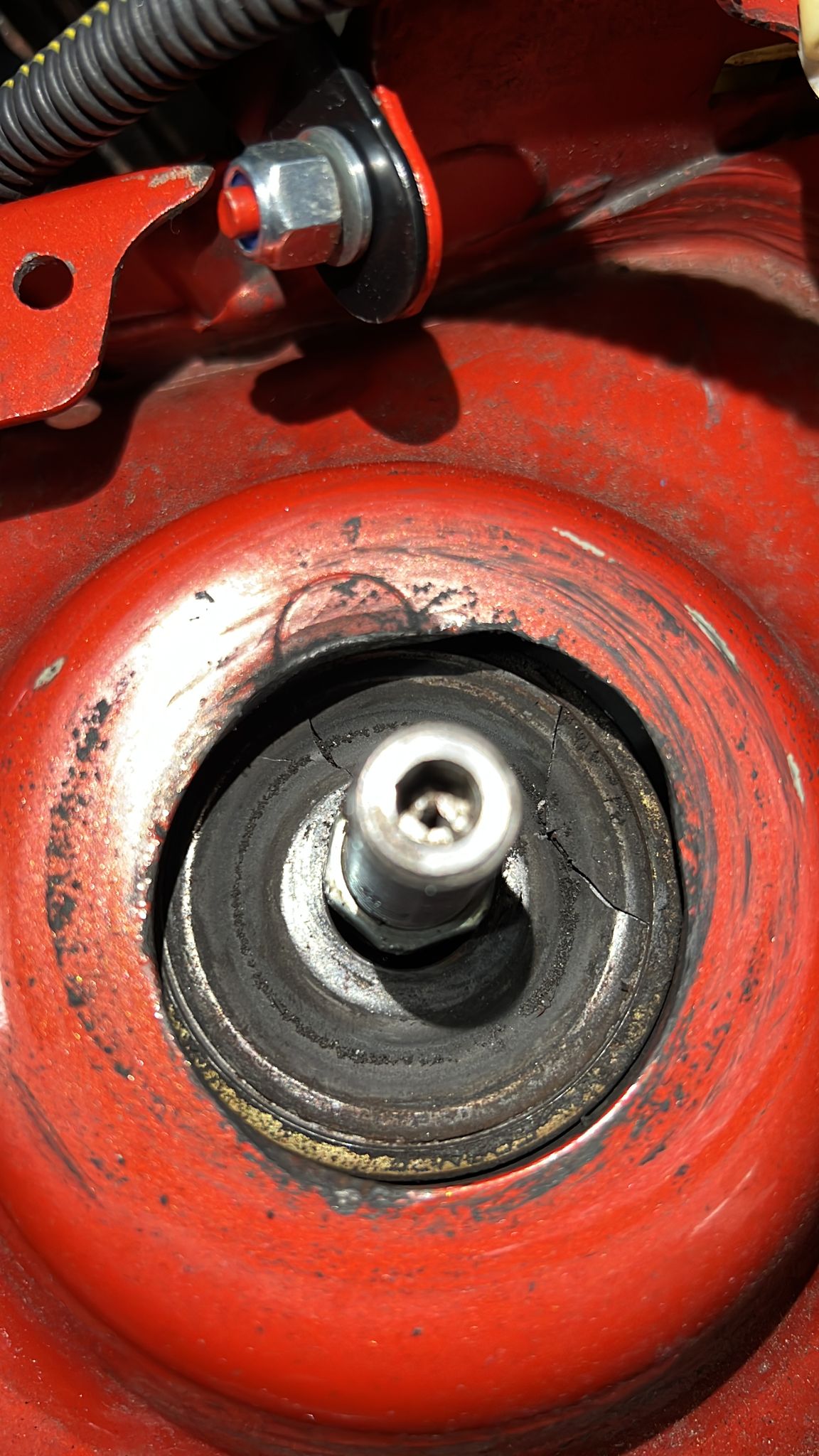

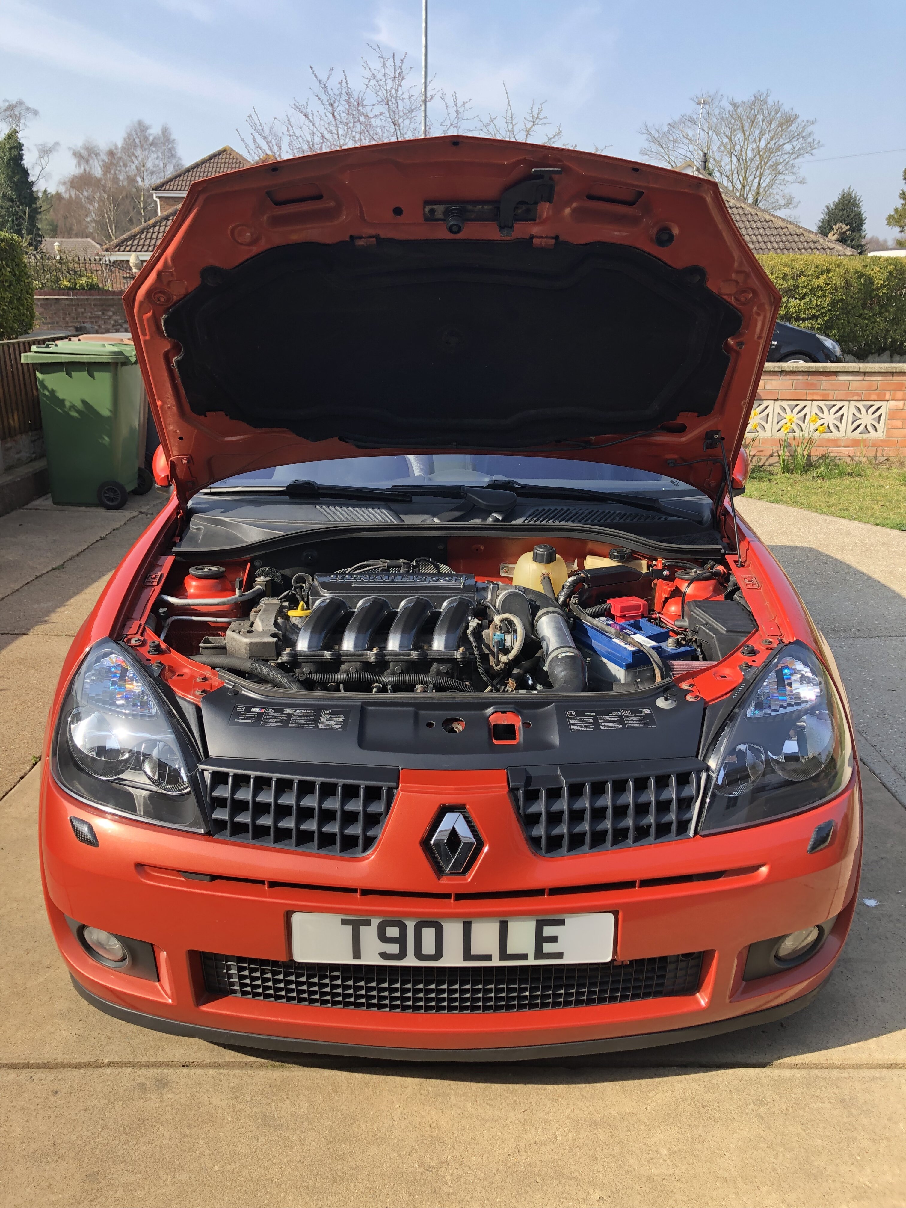

Had the car out of the garage to day to have a little tinker with it in preparation for taking it to Alex and just to let it see some sun!
I’d stated in previous posts that the rear scrubbed a little since I put the stub axel spacers on. I raised the rear end of the car up a few mm so hopefully it won’t catch anymore and if it does it’ll only be on big bumps.
Gave it a dust off too and checked the pressures and fluids.

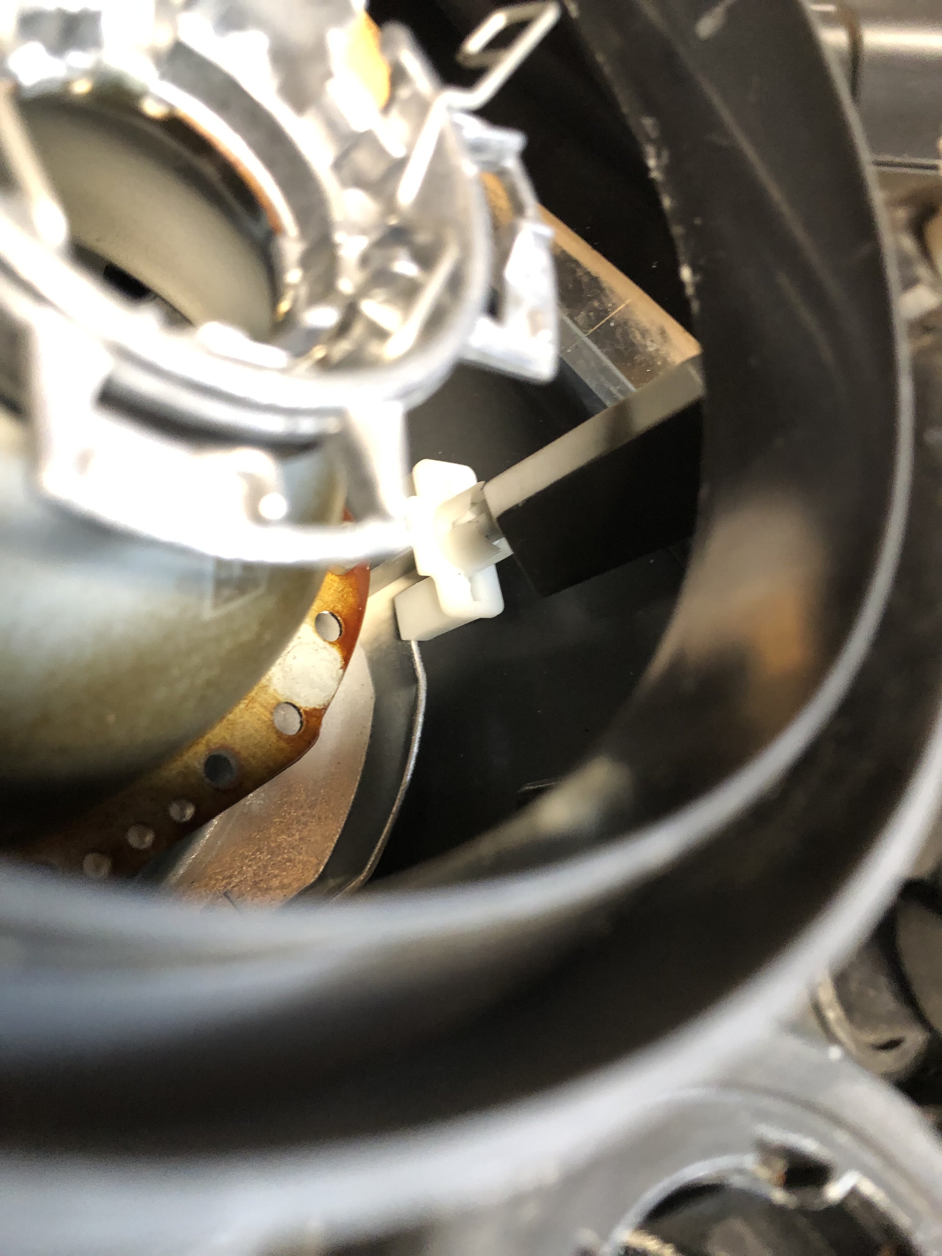

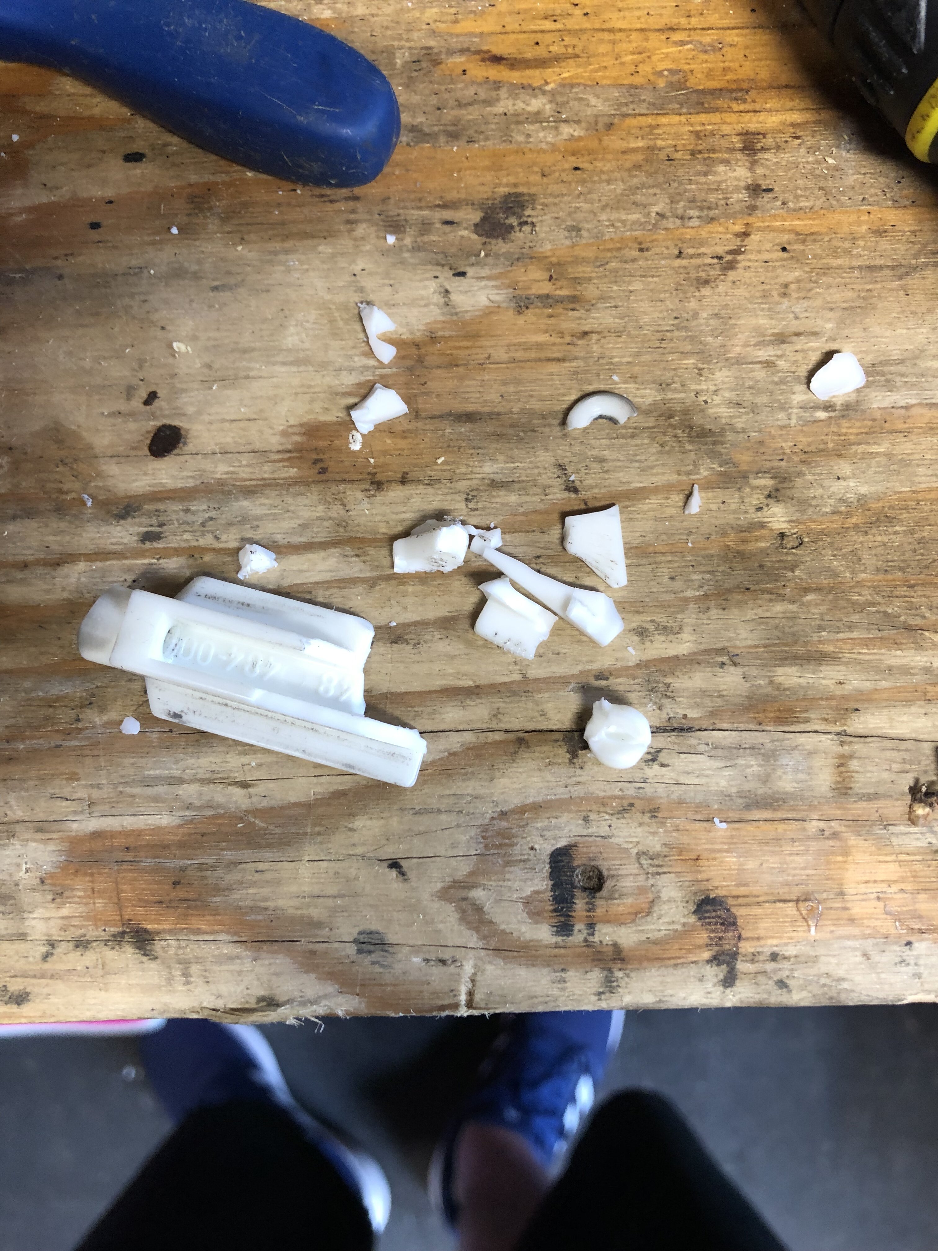

It was supposed to be soooooo easy!!
Just take out the broken clip,
Draw back the new one,
Tell the wife I’d fixed it,
Grab the light and fit it!! 😂

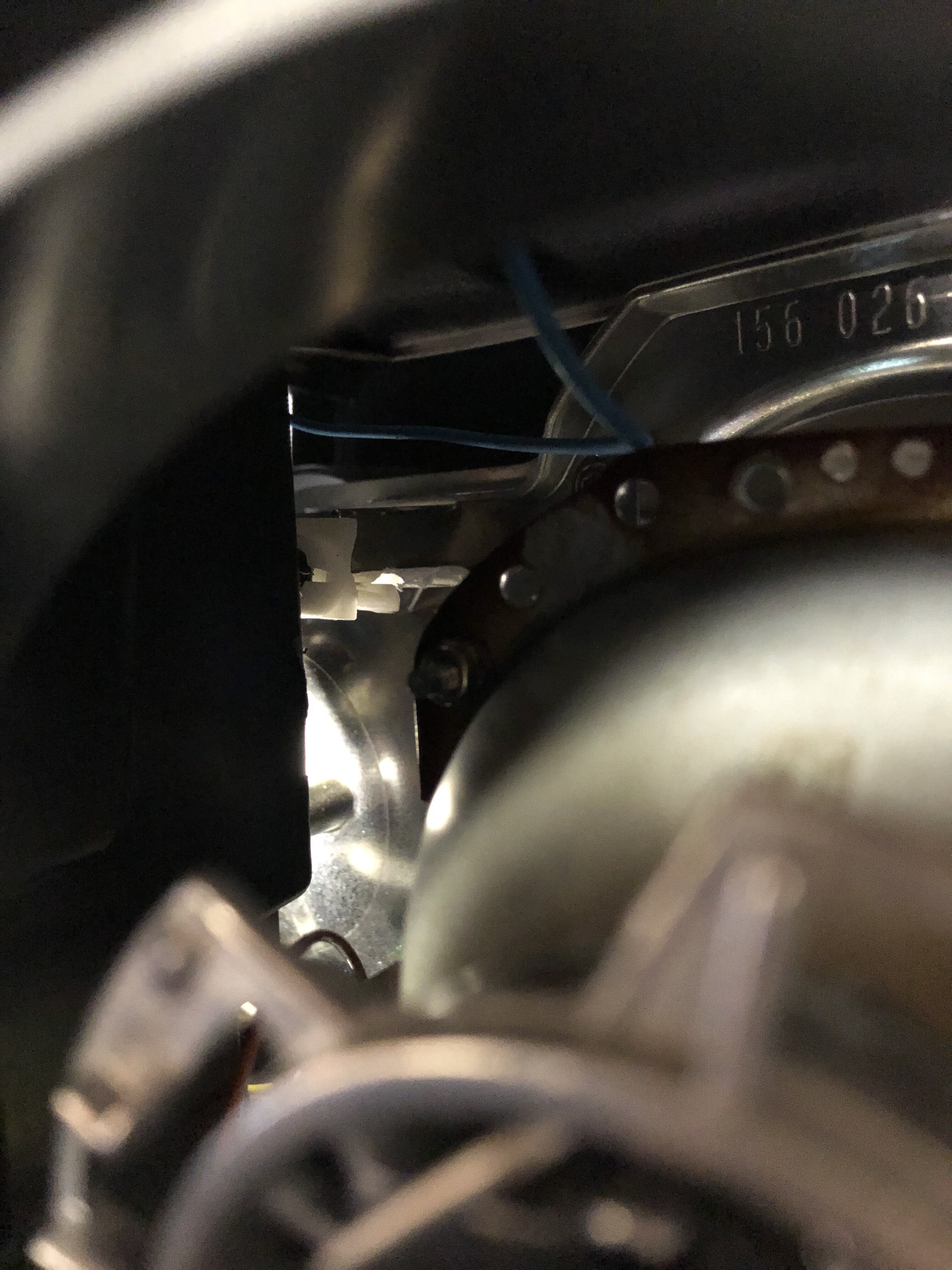

Pieces of the old one, I can’t believe how brittle it was! I ended up using a set of picks to get the ball out.
New one fitted…

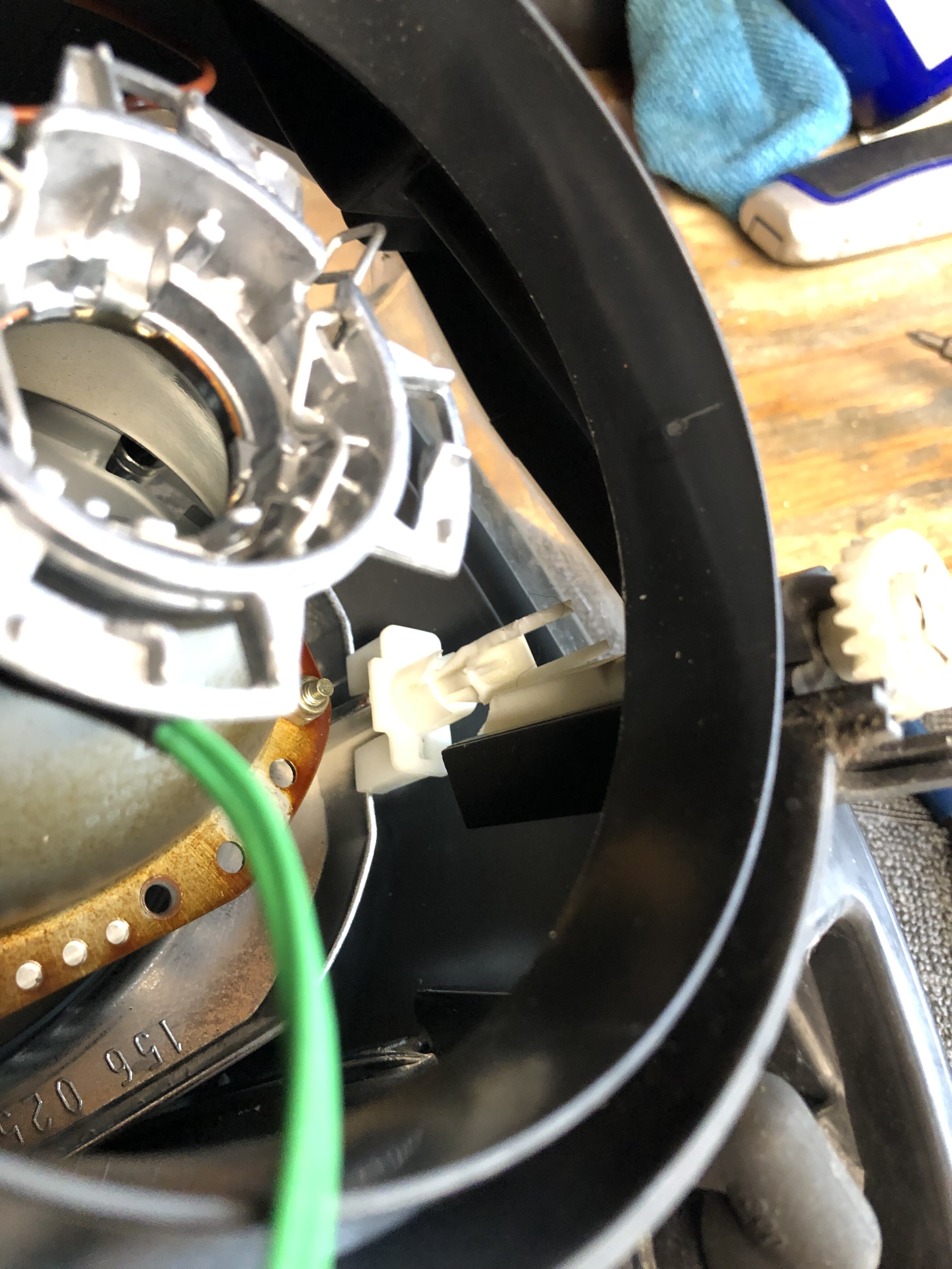

With the nearside all fixed, I thought I’d check the offside which seemed a little wobbly.
The adjuster was ok, it was the locator at the top in the middle was unseated. I managed to get it re-attached an was chuffed as it’d only took 25/30mins to sort them both with no real issues.
Until I gave it one last check at which point it decided to crumble & snapped off! 🤦🏻‍♂️
So now I need to either split the headlight and glue it all or get another grey insert.

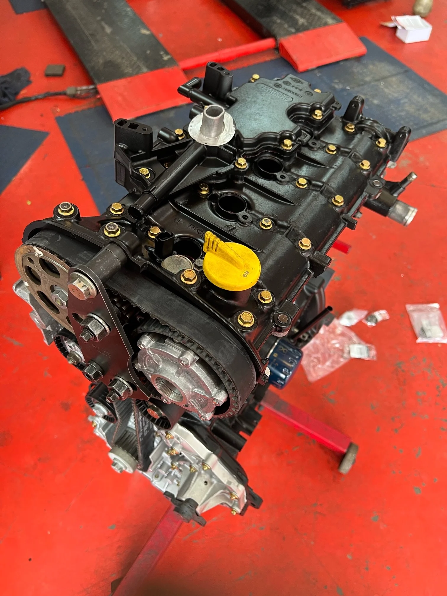

UPDATE FROM ALEX… 6/4/22
Hey Ollie,
Head on etc, looking more complete.
Then onto ripping out the old one!

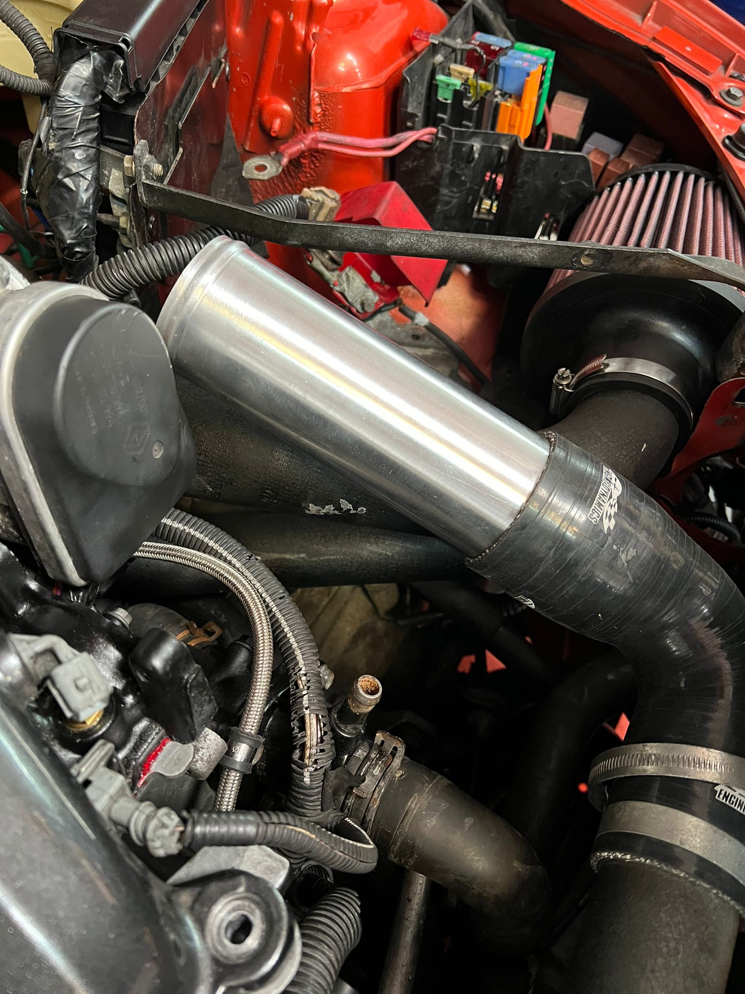

I’ve sorted boost pipe.
Plenty of other bits to sort along the way!
Got a bit delayed with previous car, but yours will be complete by end of week hopefully! Leaves us a bit of time to ensure all is well.
Update again by end of week.
Many thanks, Alex
AW Motorworks Ltd

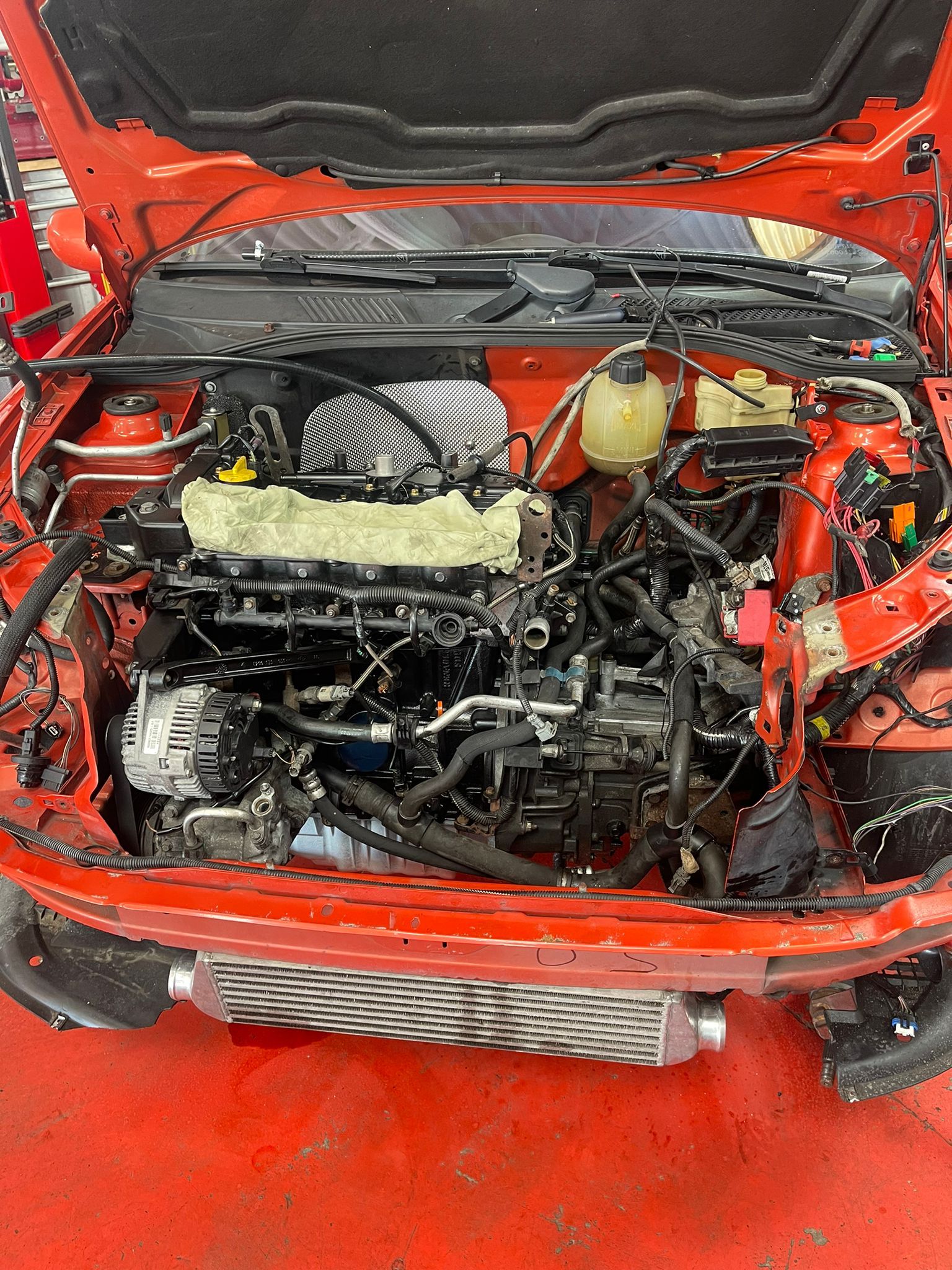

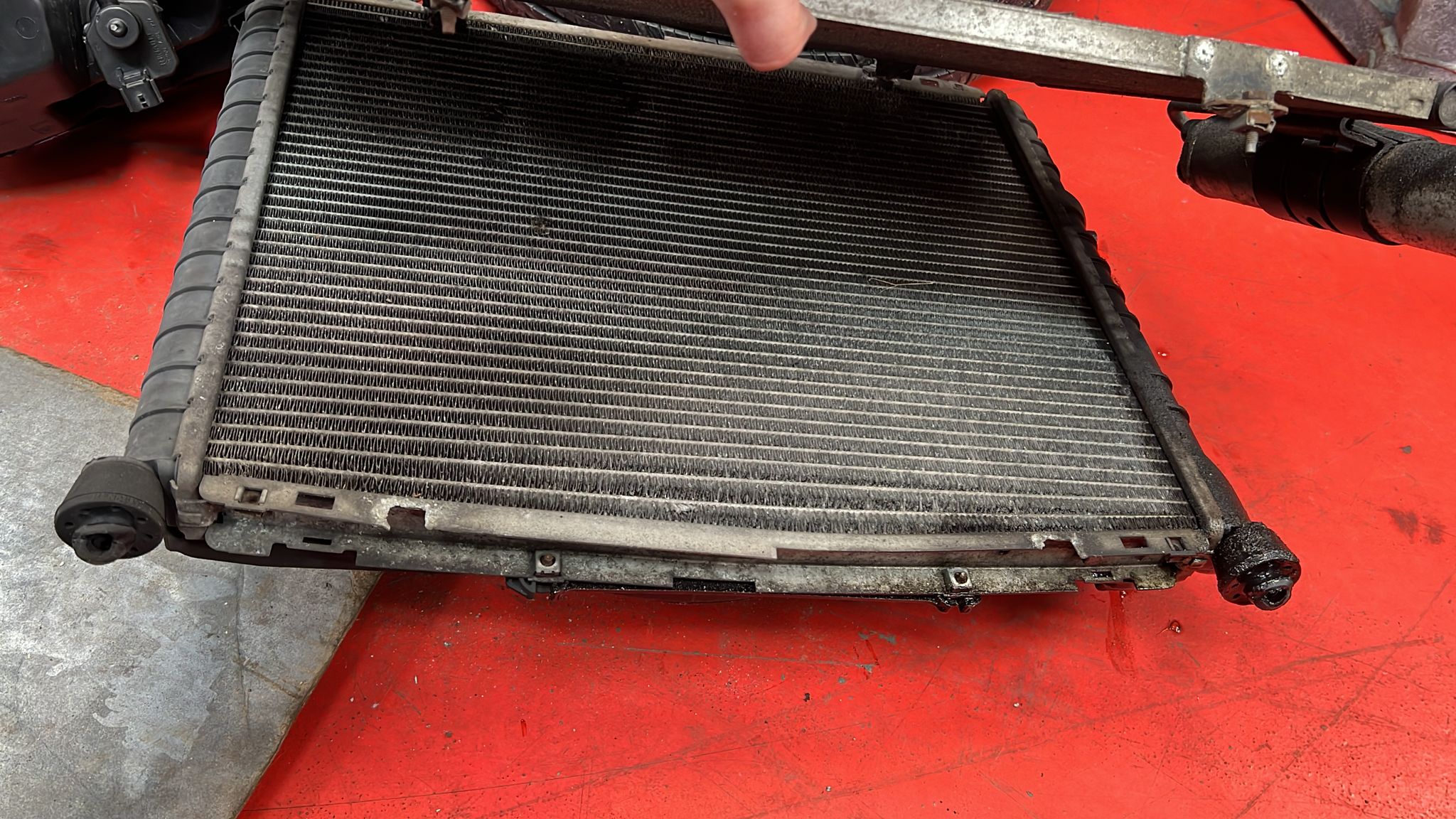

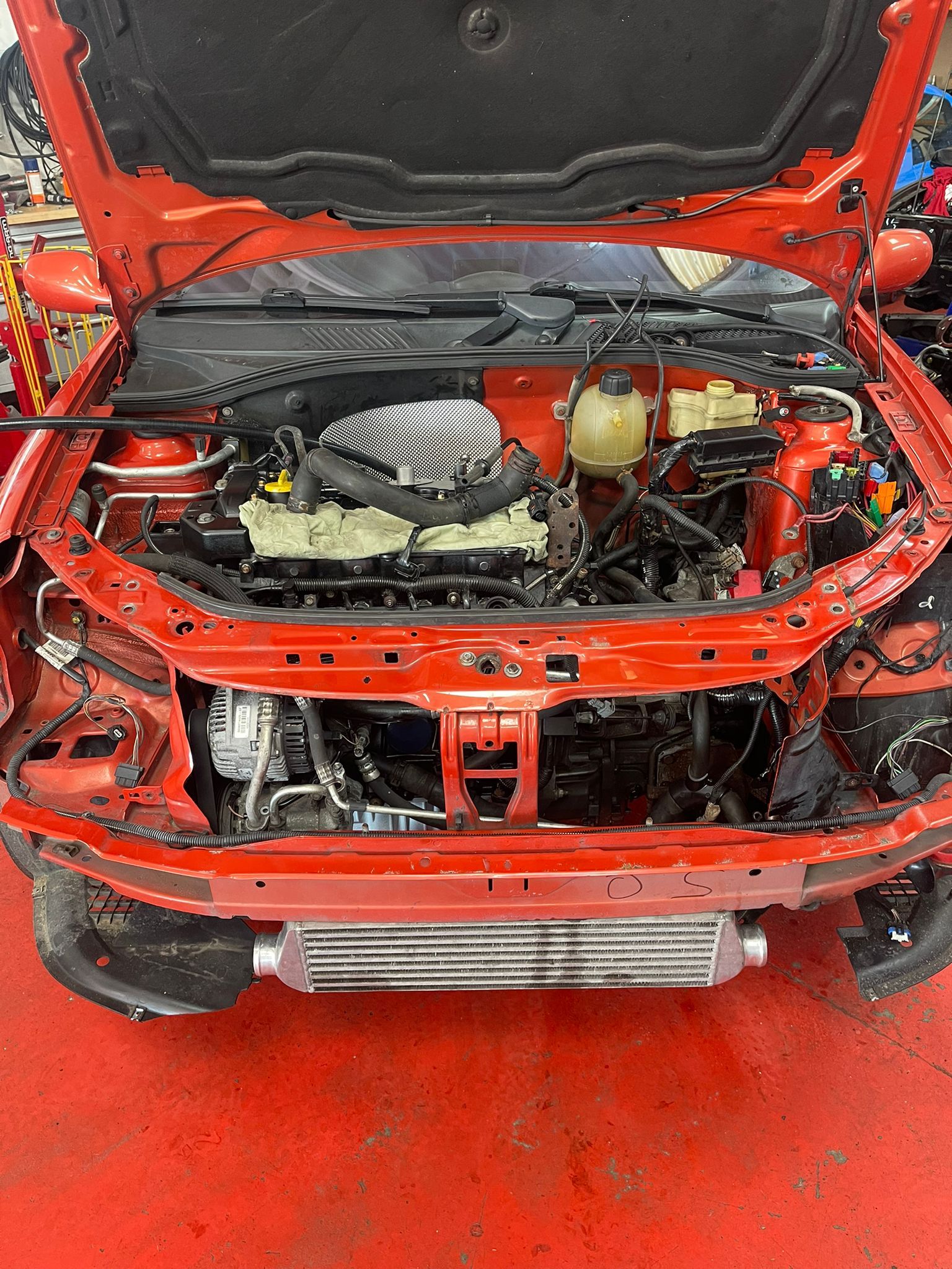

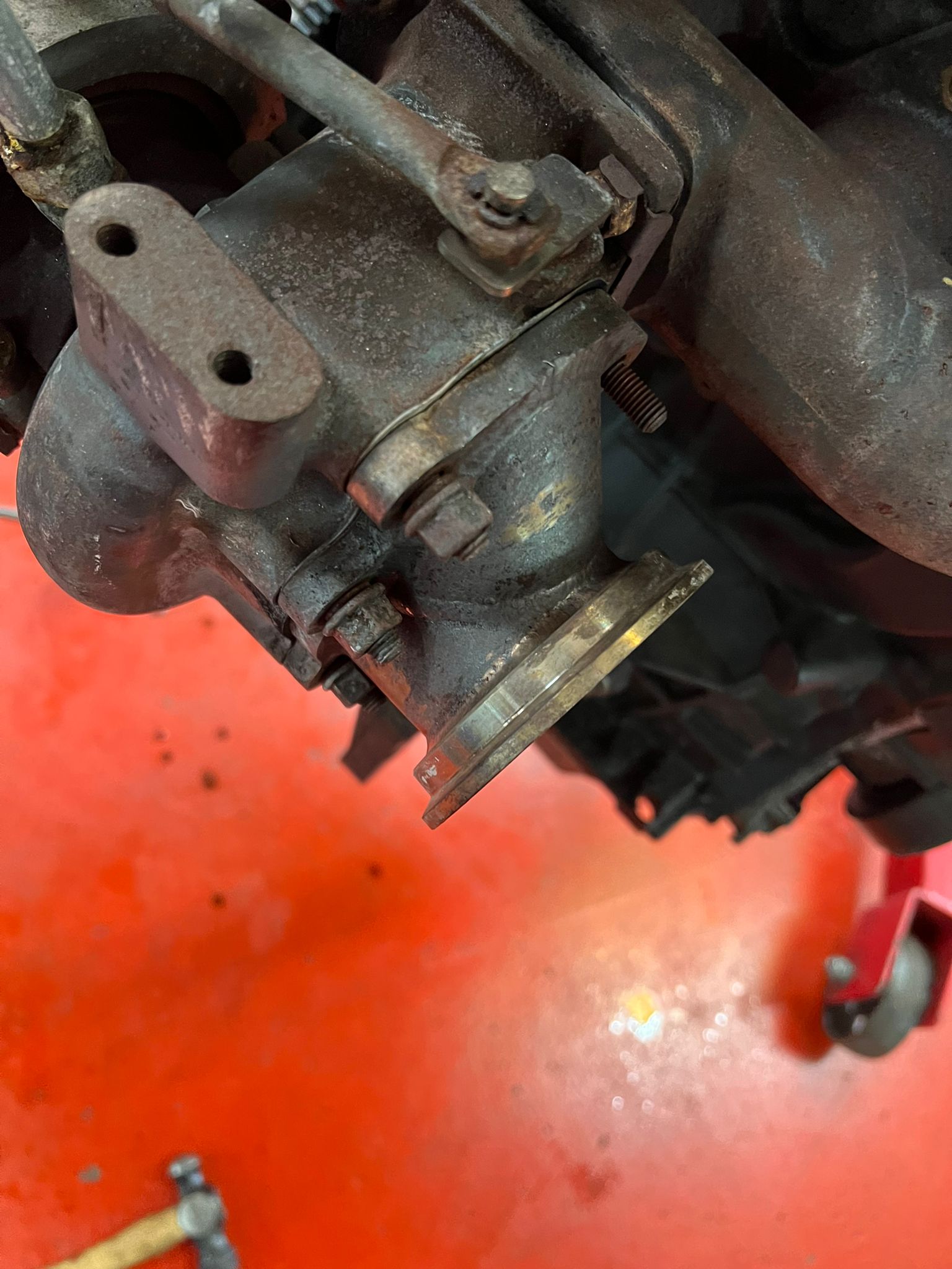

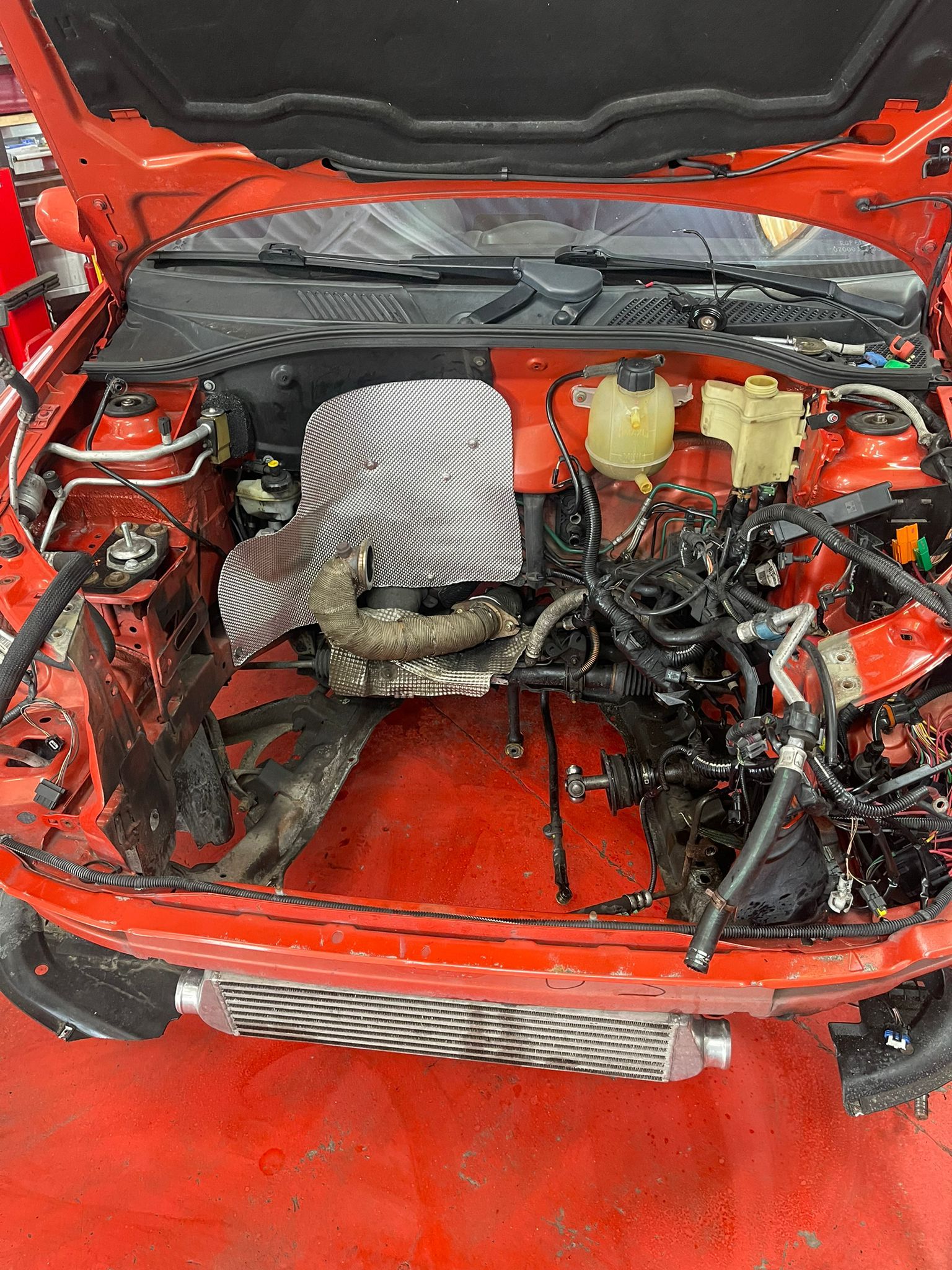

SIT REP… 7/4/22

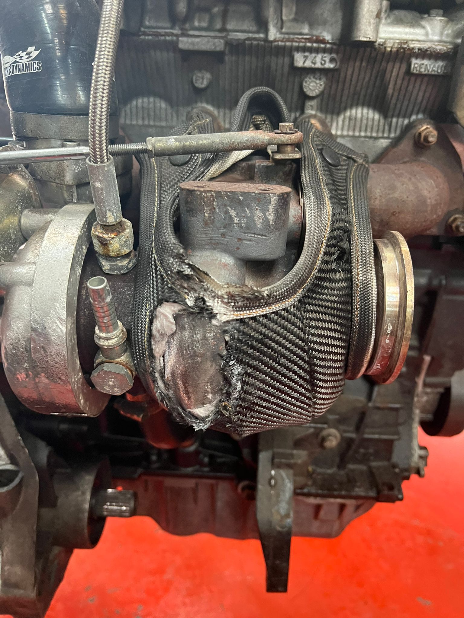

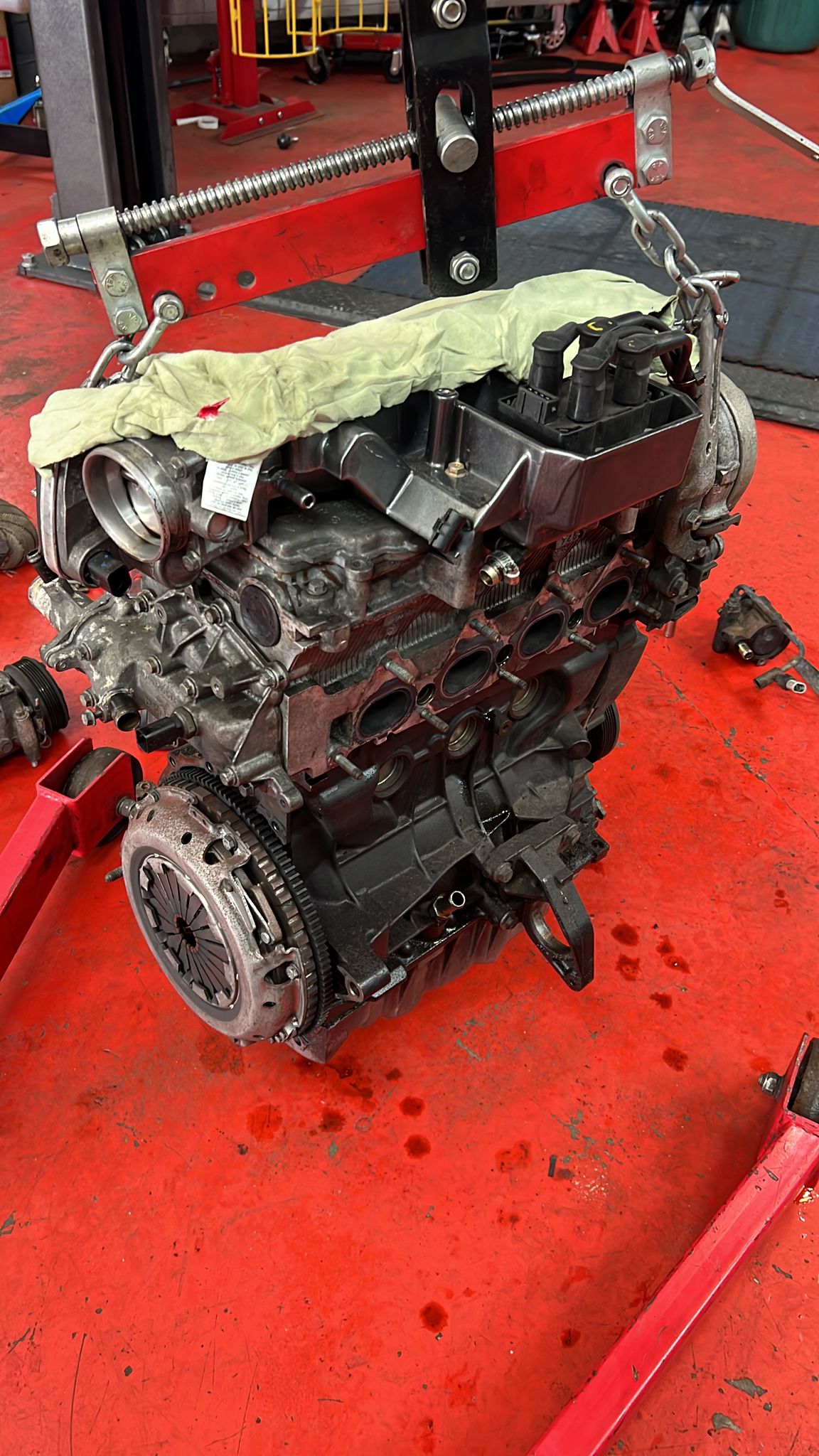

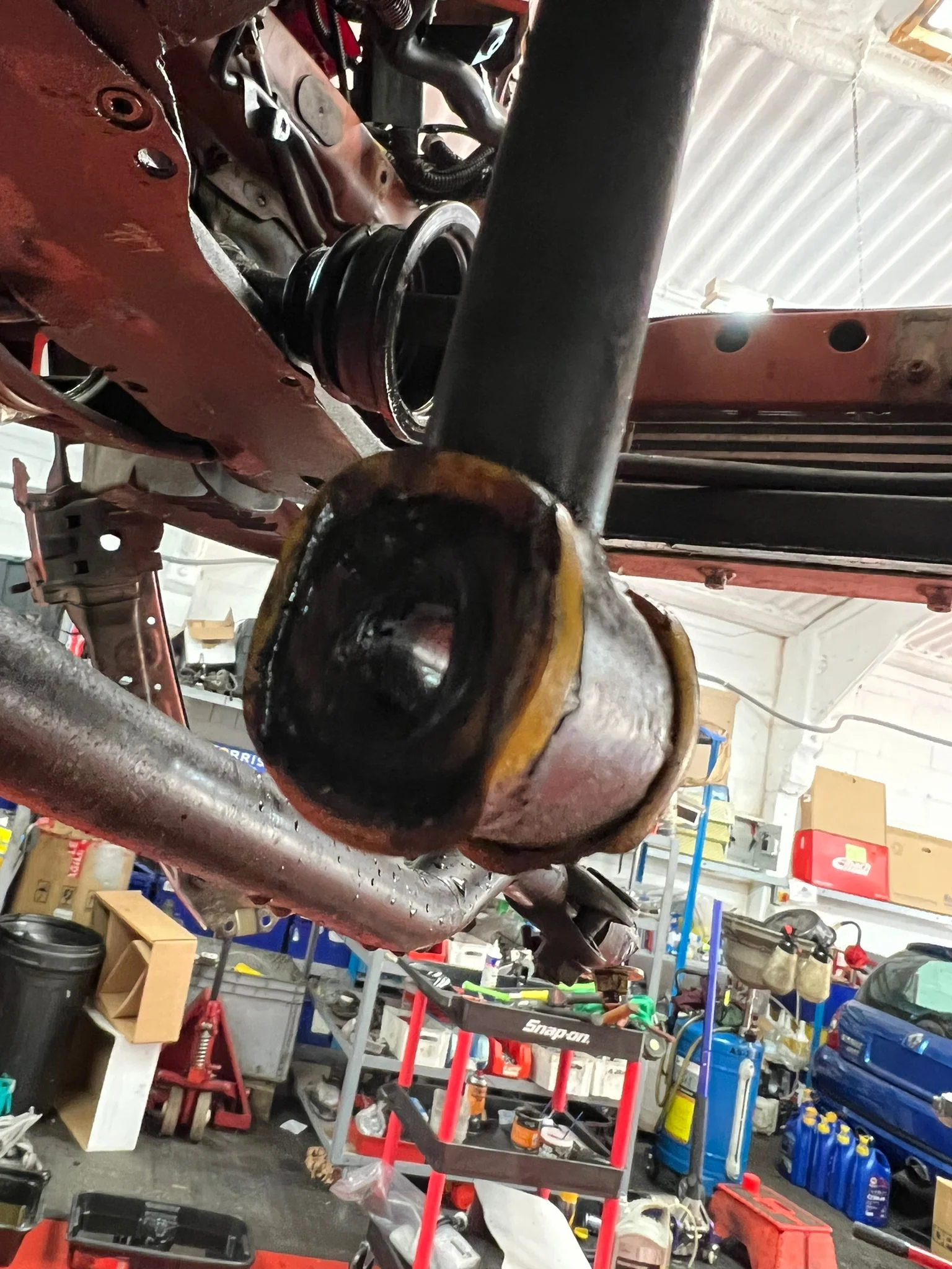

Turbo blanket = f**ked. Rubbed on bulkhead due to incorrect heatshield fitment. Kinda nice thing to have but not an absolute must, most turbo clios don’t have.

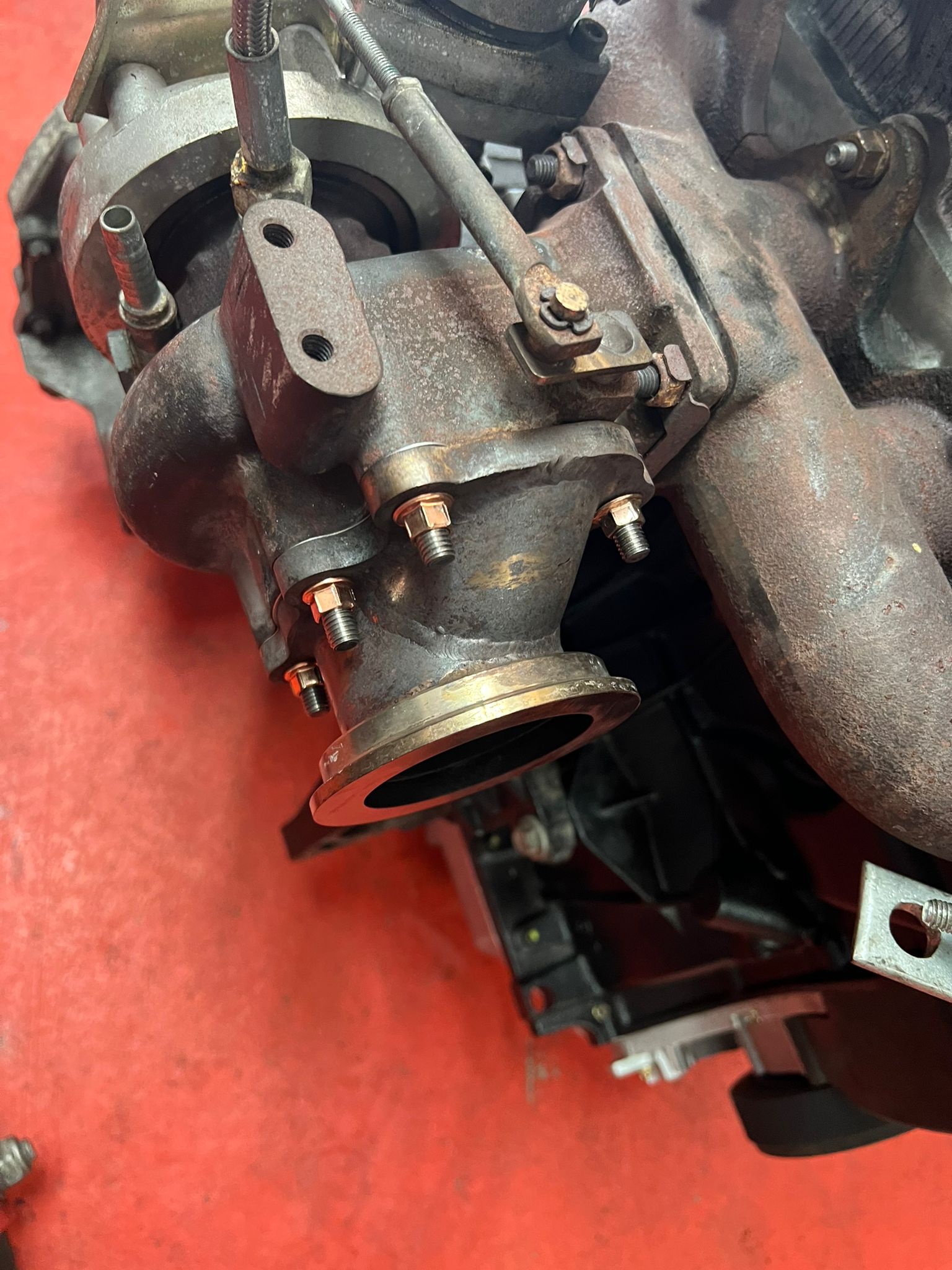

Downpipe nuts etc come loose
Inconel studs & locking nuts are a good fix for this, we can sort. Obviously been blowing and at joint further back but I’ll sort that.

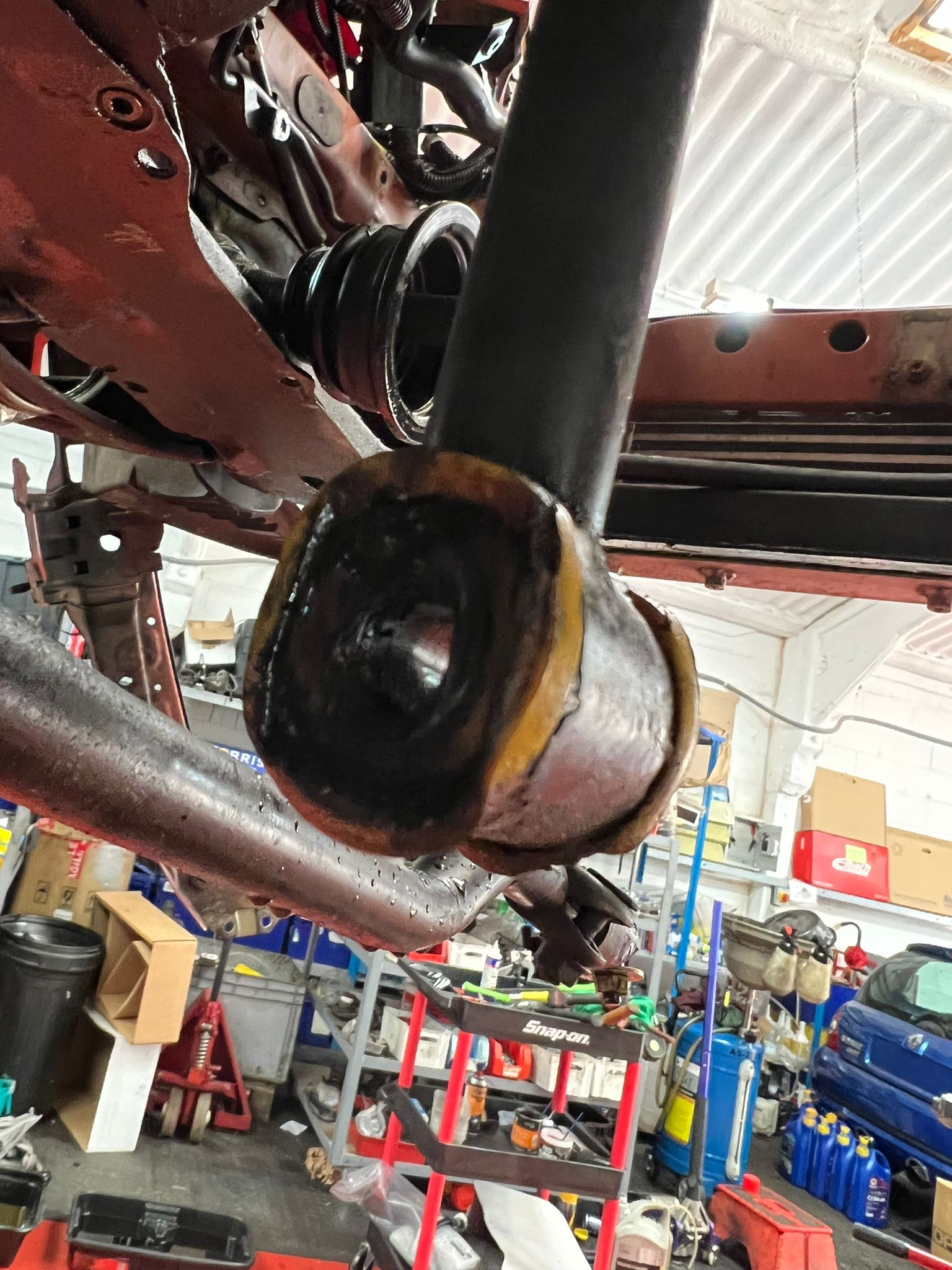

Evol dogbone mount ruined as always, they’re s#!te I’d recommend going Powerflex in oem mount.

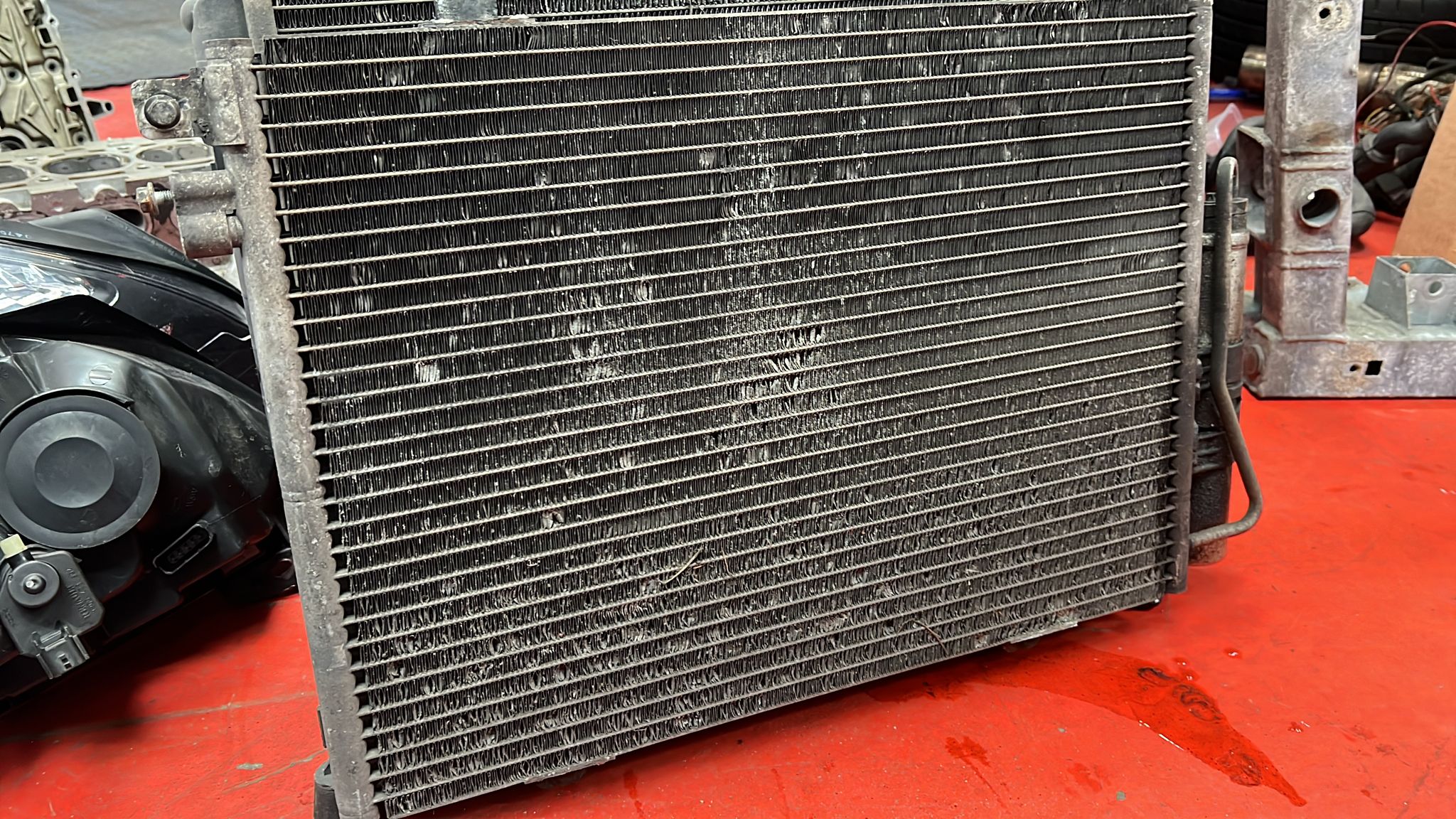

No AC gas, condenser quite rotten.
Coolant radiator, rotten at bottom (Condenser not secure), smiling at us with its rotten-ness.

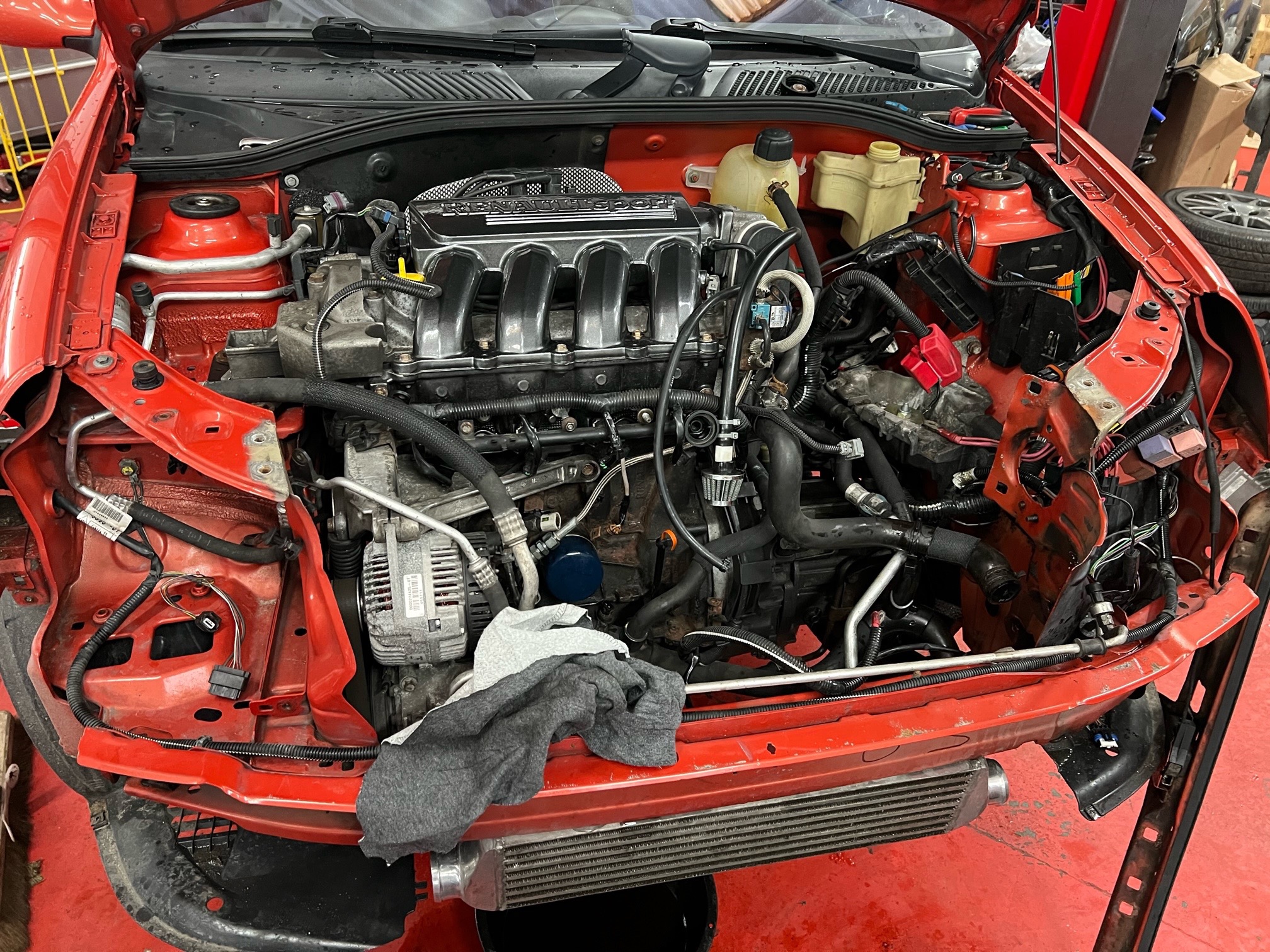

Otherwise it’s out & being stripped & parts transferred across to new lump.
So all the above is snippets from Alex on WhatsApp who has been awesome throughout this so far! We’ve decided the turbo blanket will be dropped for now as it’s only a nice to have and can be put back at a later date. I’ve given him the go ahead for the inconel studs and lock nuts to stop it coming loose again.
The dog bone mount will come back as is for now and I will either replace the Evol rubber inserts with new or as Alex suggested use an oem mount & Powerflex inserts.

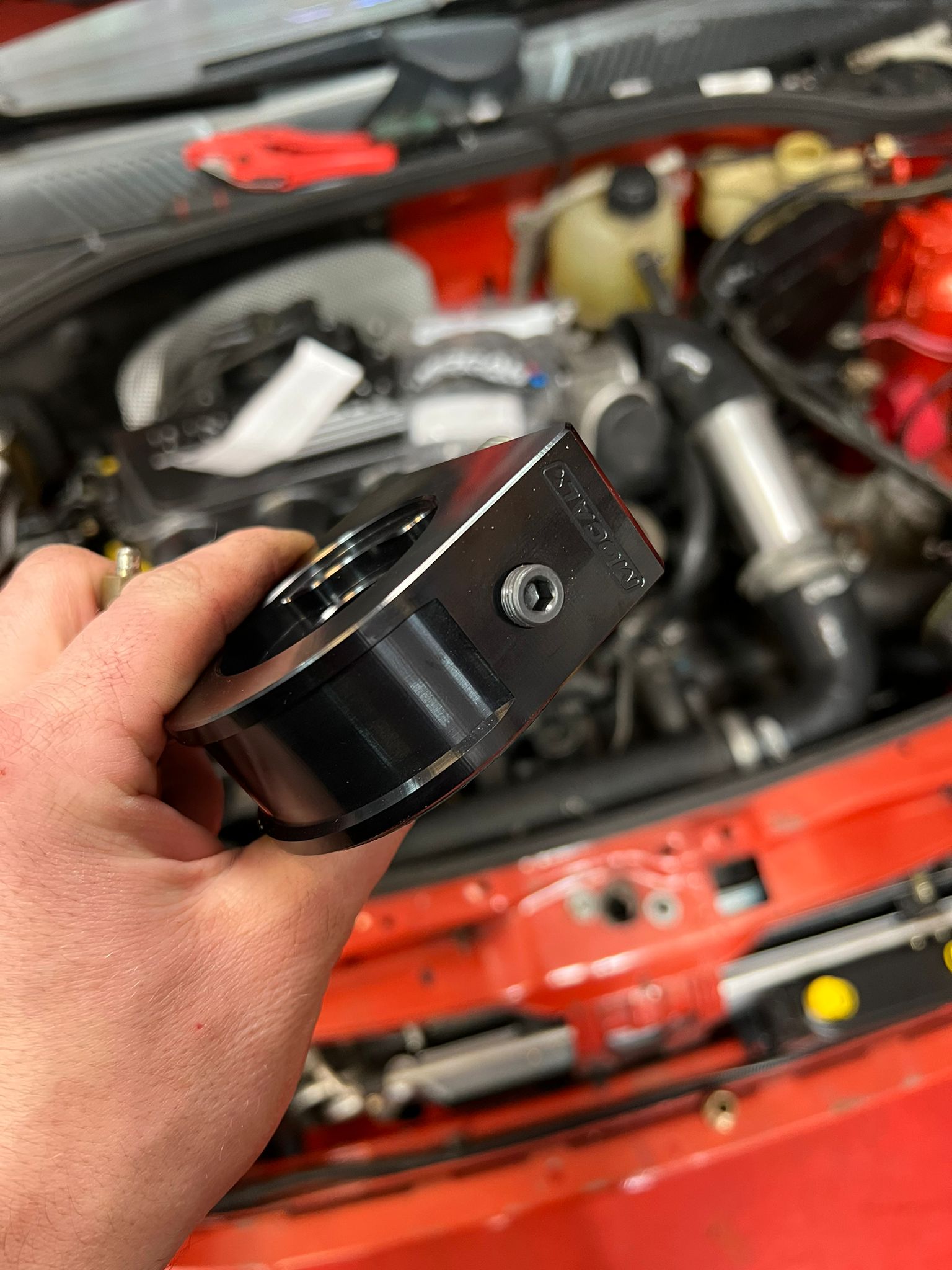

I’ve also agreed to have both new coolant radiator and ac condenser/driers fitted to stop any issues in the future along with an oil cooler and sandwhich plate with take offs for temp and pressure at a later date.

Update from Alex… 8/4/22
A minor point to consider in future is coolant hoses. That oil breathing onto both the top & bottom hose hasn’t done them any favours.
Sorted this s storm, inconel studs and new lock nuts. Engine back in, connecting up as we speak. New coolant pipes onto turbo.
Oil cooler will be done early next week.

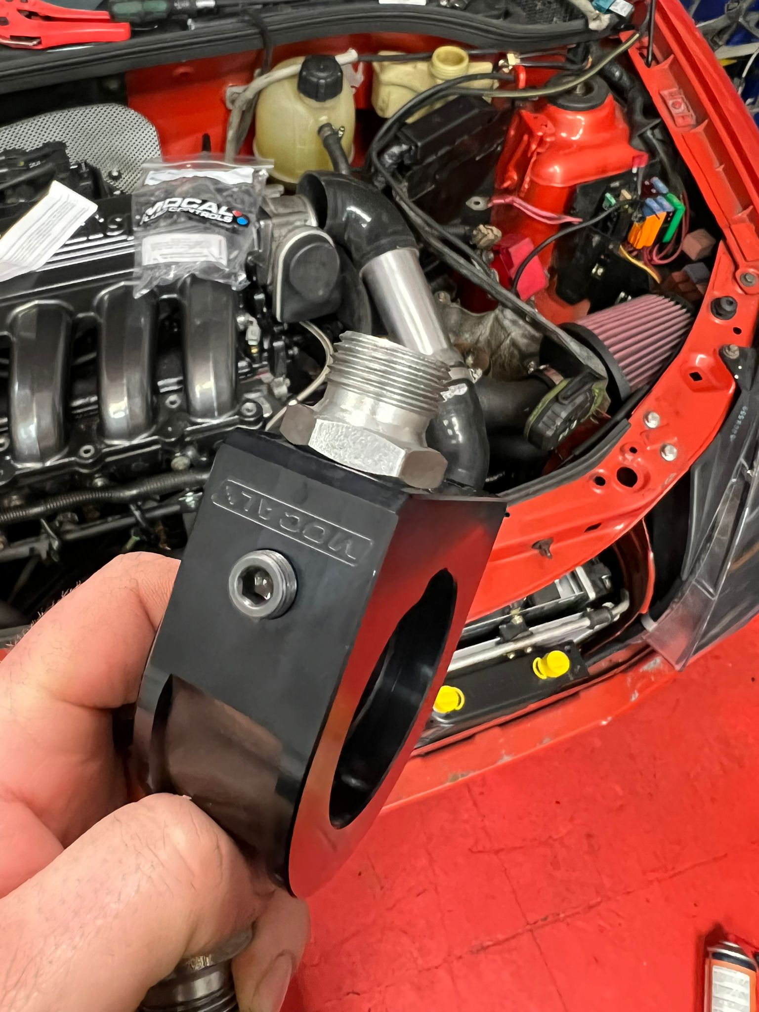

No more horrid ultra sonic mega boom dv as Alex has replaced it with a straight pipe for me so have some nice flutter again.
I’ll have to get some crackle effect paint for it to match the other pipes.

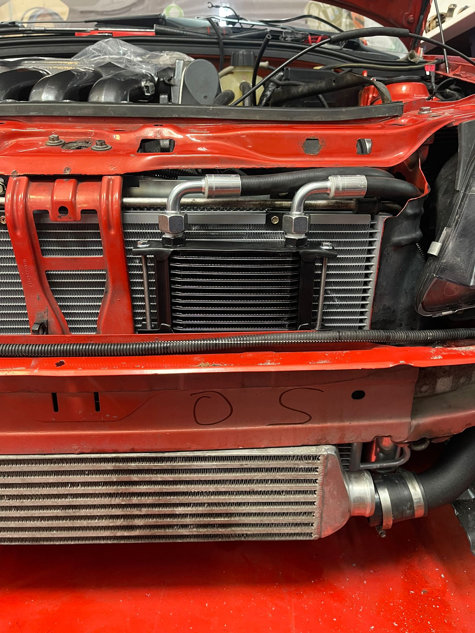

Nice new mocal oil cooler with 2x 1/8npt take offs for future gauge installs.
I’m think Spa twin oil temp/pressure gauge and obviously boost gauge! 😂 For all 7psi!!

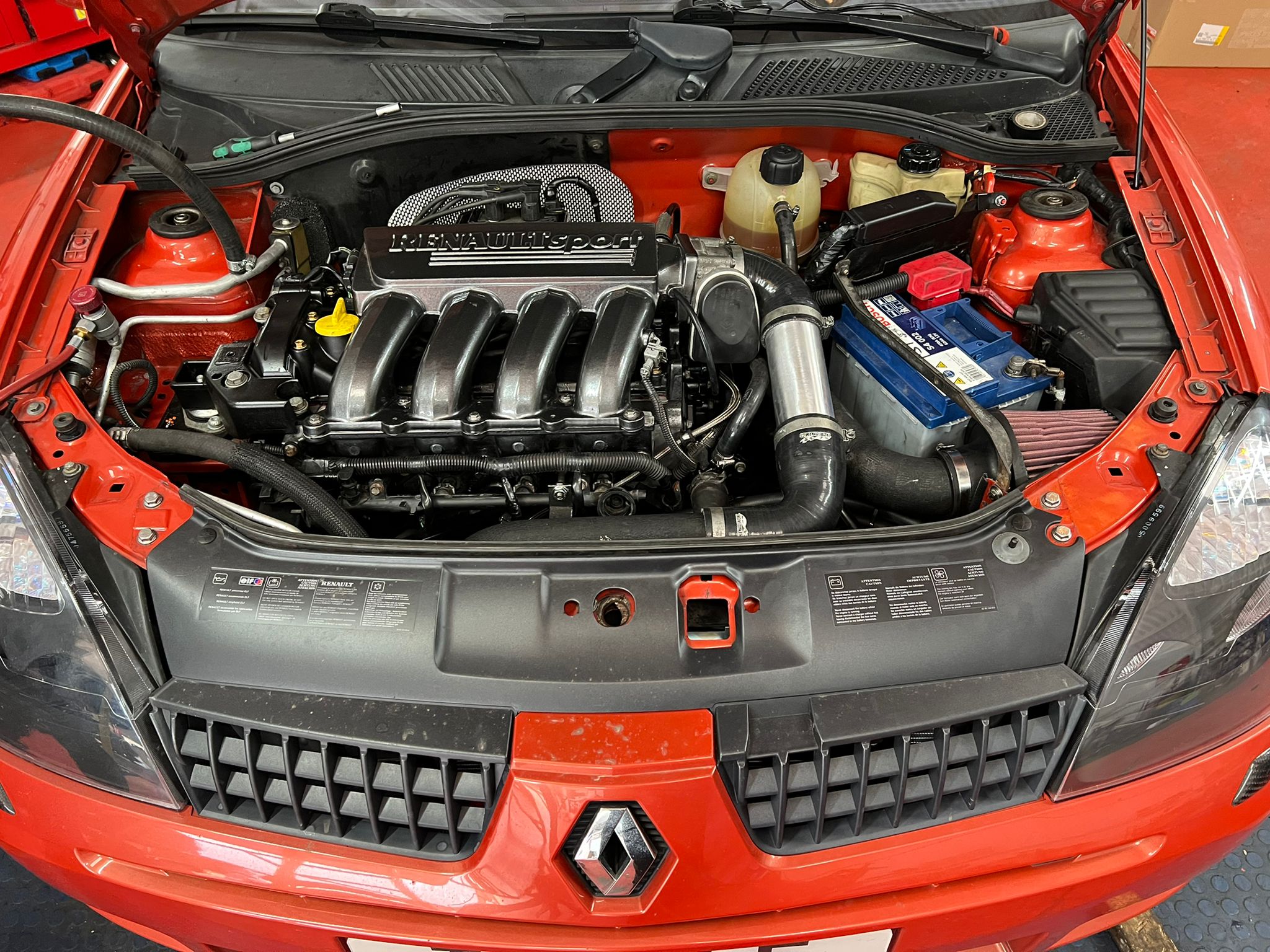

CFAB
ClioSport Trader
  Cliosport 182 ff
You could probably drop the pipe off at Rolling Rims in dunmow for a cash job being local/Dunmow based perhaps. Satin black would be in keeping 👌🏼
R29TJR
  2005 RB 182 Cup
Absolutely! Can’t fault the guy once he’d got the car there and we’d switched from email to WhatsApp updates.
Alex sent me further updates later this evening too.
View attachment 1588185View attachment 1588186
Just a couple little more jobs to do and then a shakedown run to make sure all is good.
Collection Friday hopefully!
Like all Alex's work looks so clean.
Look forward to the updates with it all up and running.

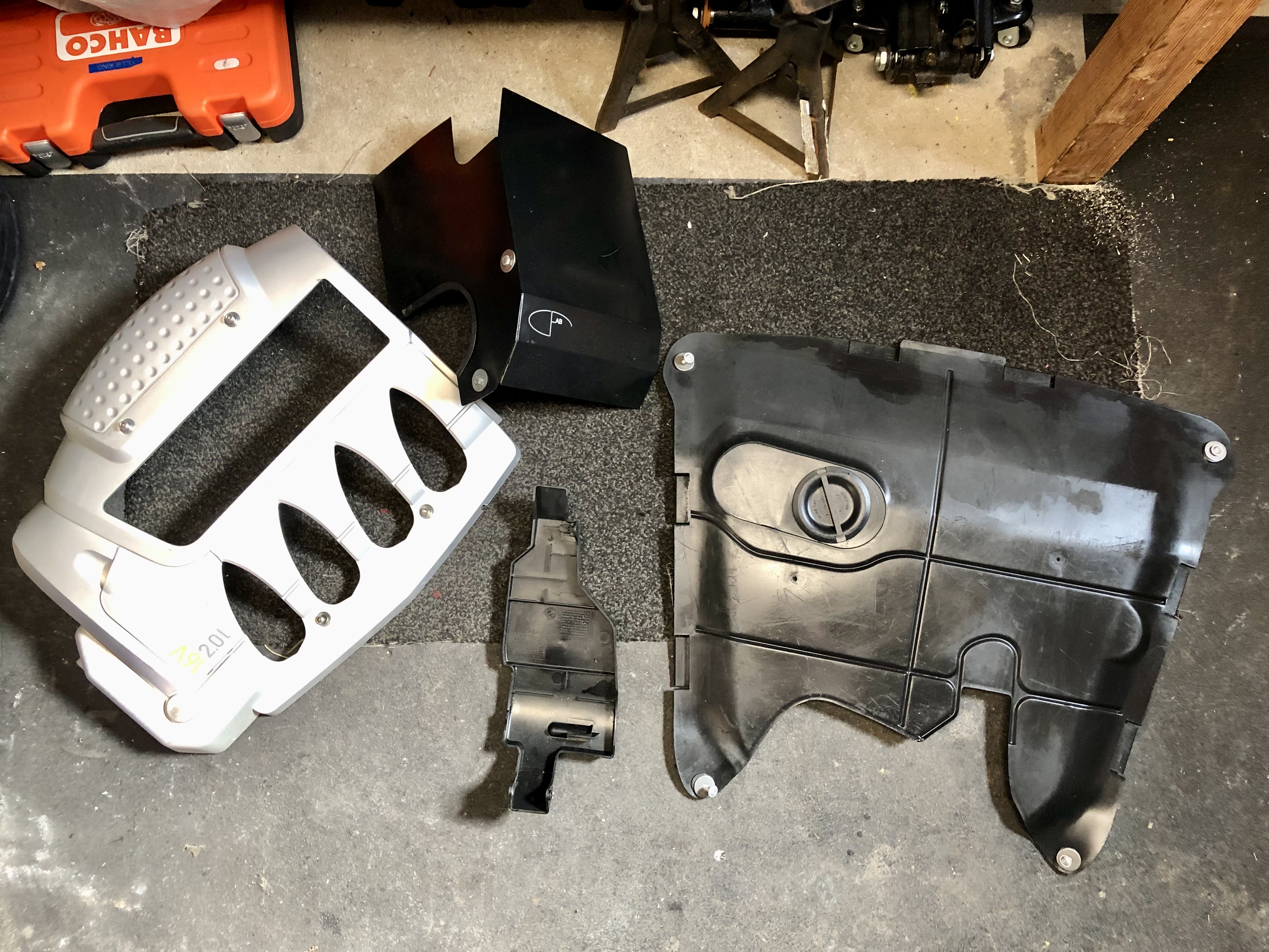

In my excitement to get the car back I’ve got together some parts I’ve been gathering.
One of the rarest parts!! The screw in cover for the undertray! 😱
The plan is to trim the back of the cover and then respray inferno coloured which will then contrast the inlet.
