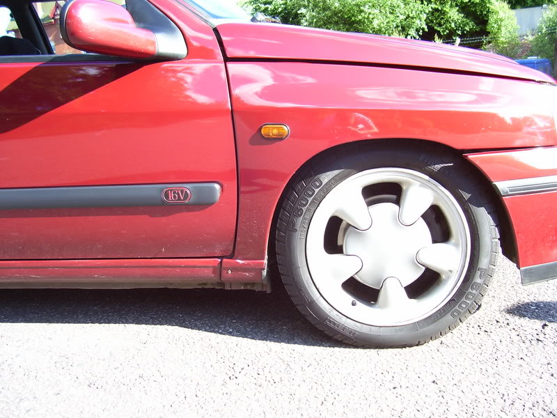

Bit of a blury pic but it's an rt shell with a valver lump in, or it was, not sure what happened to it

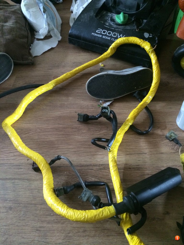

Decided I'm keeping the yellow engine loom!
Sorry Coops Turbo
It has now been wrapped in some brighter yellow, waterproof/heat resistant stuff
Will be buying some yellow samcos to match.
Sorry Coops Turbo

Oh that nappy in the pic, it's not a dirty one lol, it's what I used to wipe all the grime off the loom before applying the tape, didn't end up with no bits of fluff on, sprayed a little engine degreaser In the nappy and wiped clean. Did the trick :lol:

Looks tacky and cheap covered in bright yellow tape IMHO
It does look quite tacky on the photos but doesn't look all the bad in person IMO. Will post up a pic later of it all together.

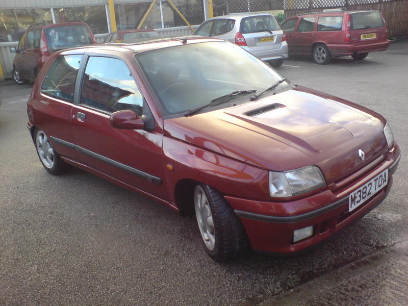

Still can't believe this was my car, I bloody loved this thing and expected it to be in a scrapyard by now!
Can't wait to see the finished result, I may even consider a little drive up to your end when it's all done and seeing it in the flesh!
I've found some old pics of her you might like to see :cool:

I've gone all warm inside :lol:
God it's weird to see it on a photo I didn't take lol.
More than welcome to come and have a blast when she's done if you like

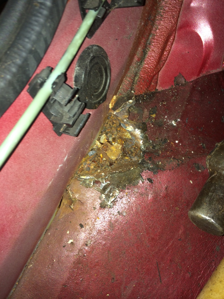

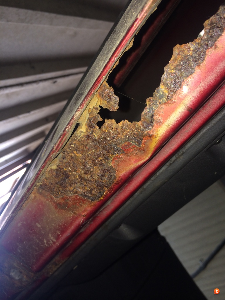

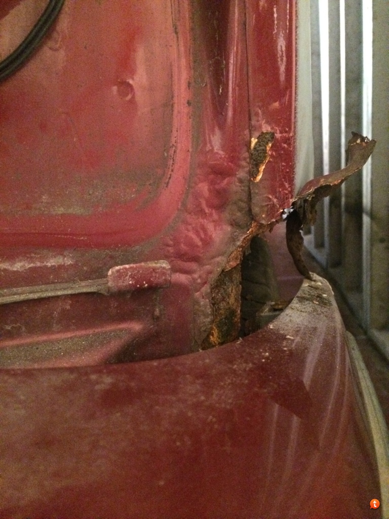

Today I was only meant to drain the gearbox and engine oil :lol:

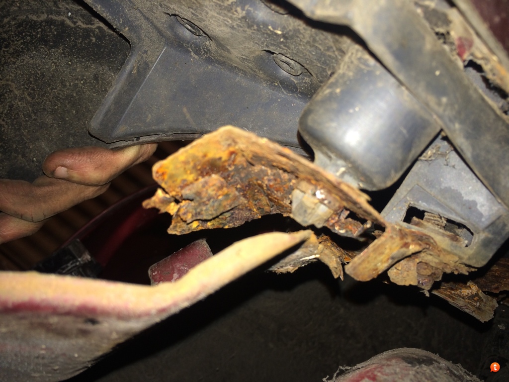

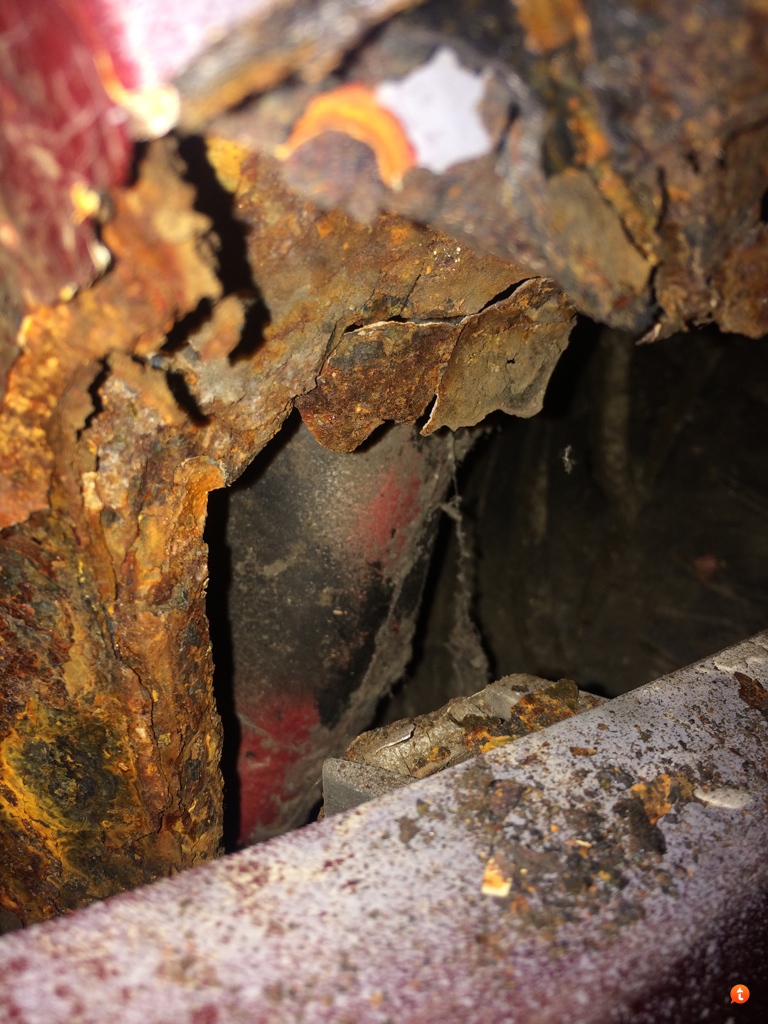

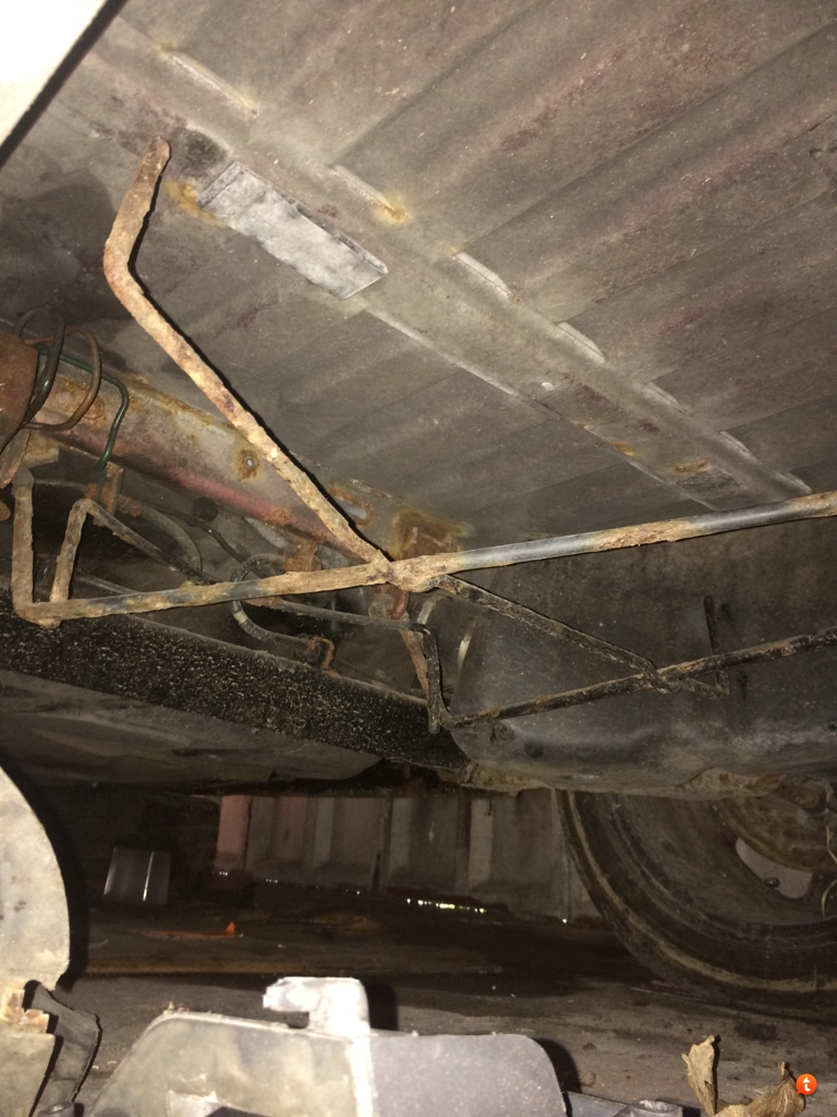

Ended up doing an inspection for more rot,
Found the following;
Well that's a bit f@cked lol
One for Wilkeh
  X2 Clio Valvers
Do that every chuffing time! :lol:

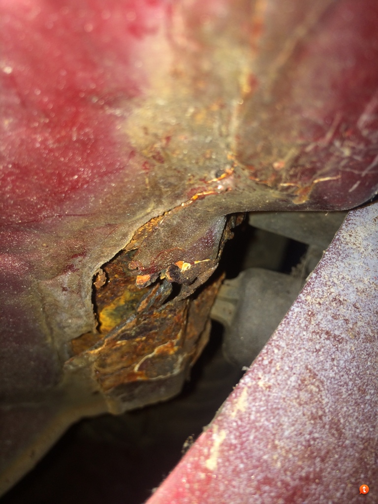

Most of the rot is just surface, but having worked in a body shop before "surface rot is covering a whole lot more, and there will be lots more behind"
Tad concerned about the bit near the bumper though can't quite tell if a new arch/rear quart will rectify it?

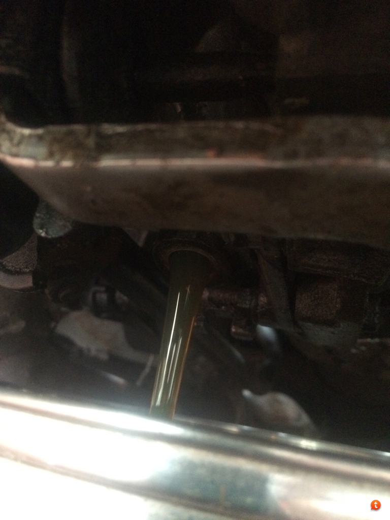

Gearbox oil was lovely and clean, this would sort of back up the "new gearbox" it has, failing that it had a change not long before I got it lol
Pic of the gearbox oil

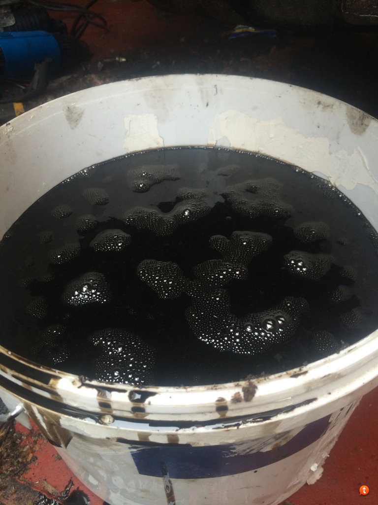

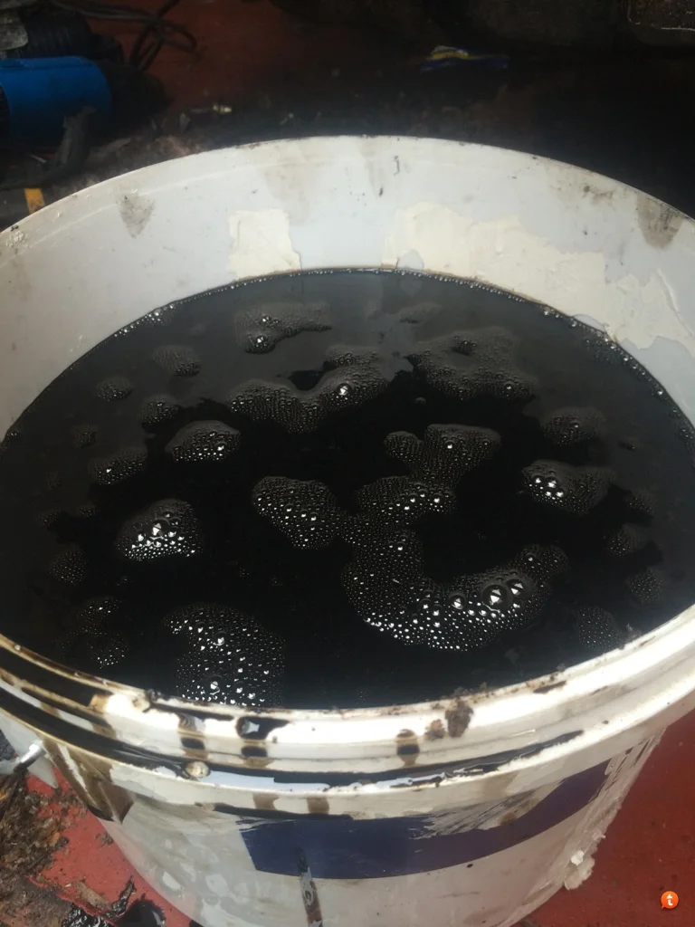

After that drained I did the engine oil,
Black breet but no lumps etc...

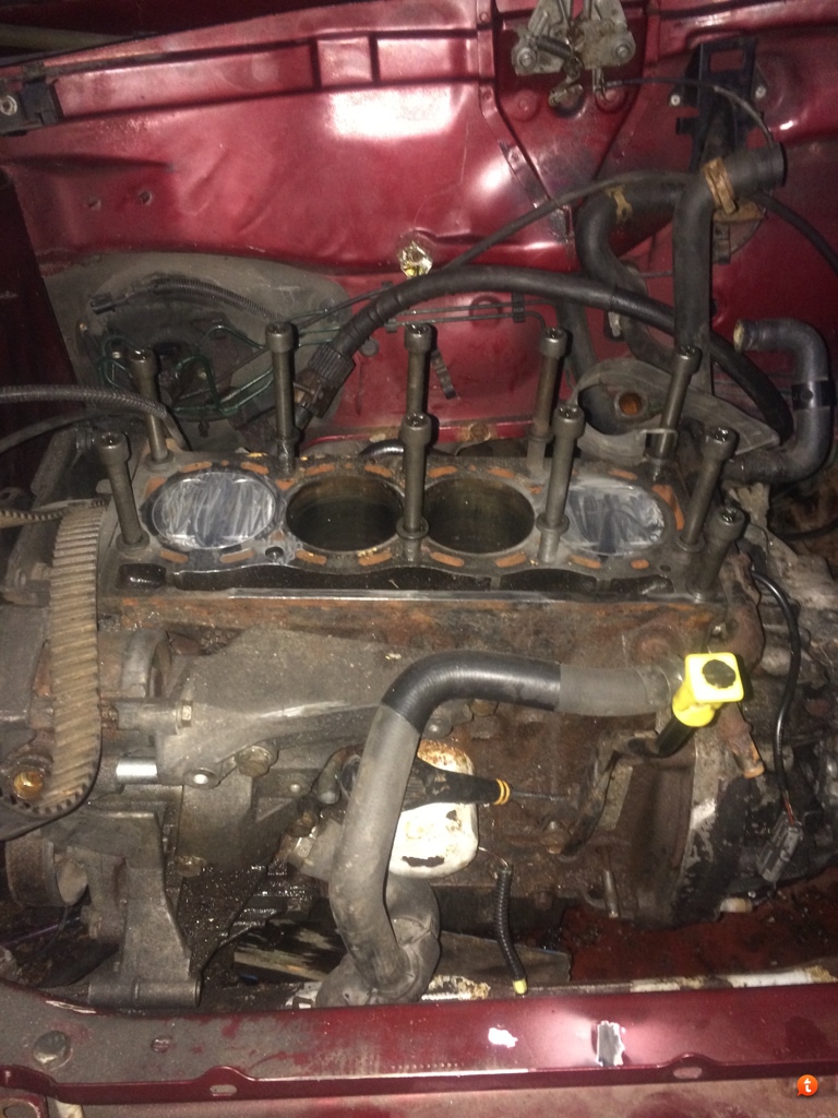

When dropping the engine oil I got a bit of a panic, once I'd fully undone the sump plug, loads of water came out not sure how it got in there? :lol: well afaik it was water, it smelt like petrol but obviously it would having just come from an engine :duh: :lol:
After those I removed the battery mount/gearbox mount ready for the faithful f7p722 block coming out tomorrow :hopeful:
Also cleaned 2/4 cylinder tops lol... Not sure why I did because I'll be cleaning everything at some point.

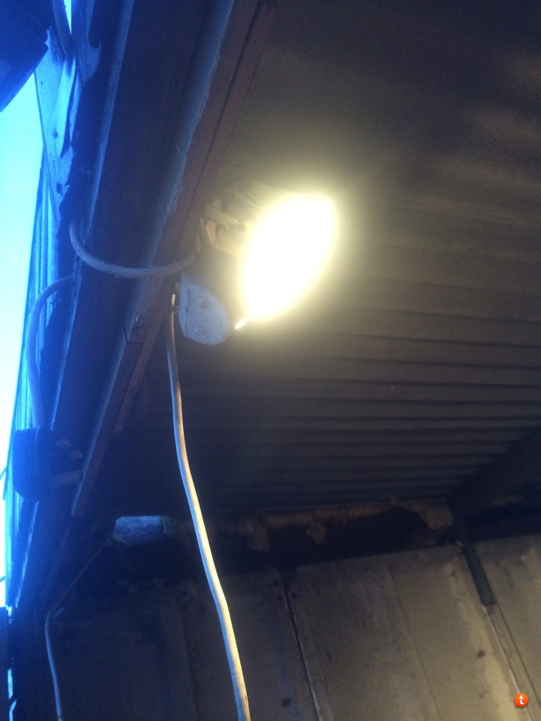

Then it got dark, so needed some light in the garage
10 minutes and a security light thing later :lol:
needs securing properly yet...

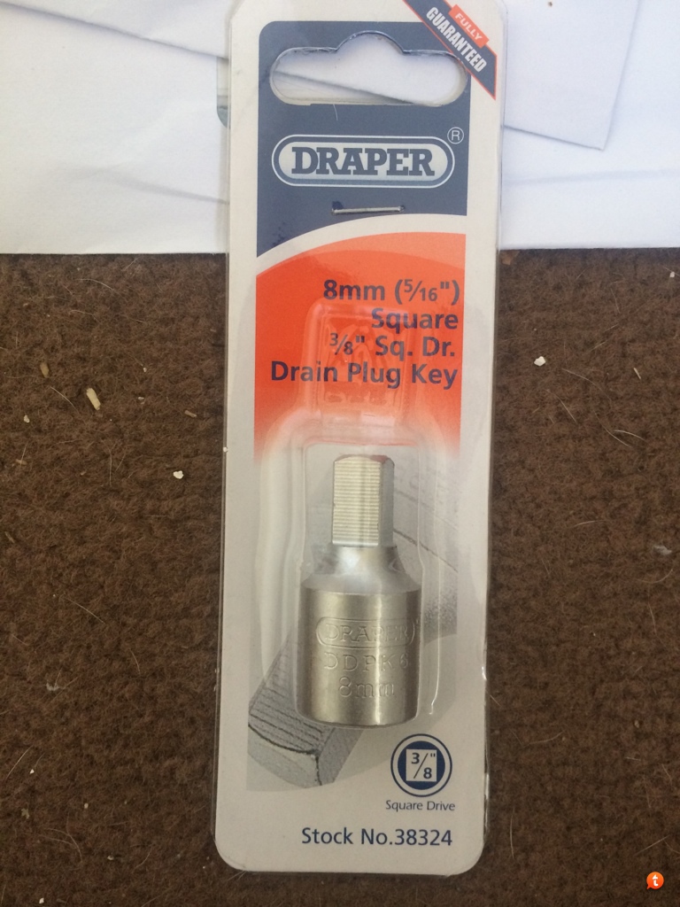

Also removed the drivers side driveshaft, didn't have a "suitable punch" to "drive out the roll pin" as stated in the Haynes manual I got off Coops Turbo
Cheers for that mate, comes in really handy,
Anyway, 9" nail and hammer FTW :lol:

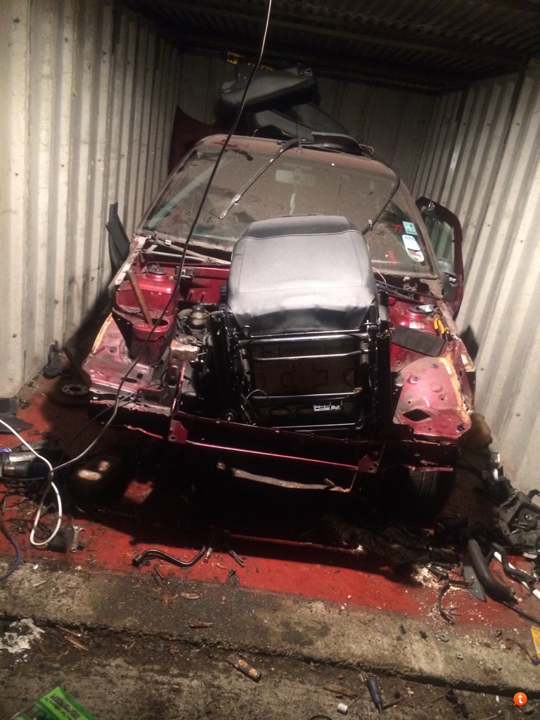

Then started the last few bits ready for the block coming out, jacked up the engine.... Oh f**k, gear selector is still attached :lol: luckily it's not damaged it :phew:
Then realised the time, got sick to death of hearing next door's youths shitty music, lack of English :lol: so called it a night...
Left The pant stainer for the night looking like so :lol:

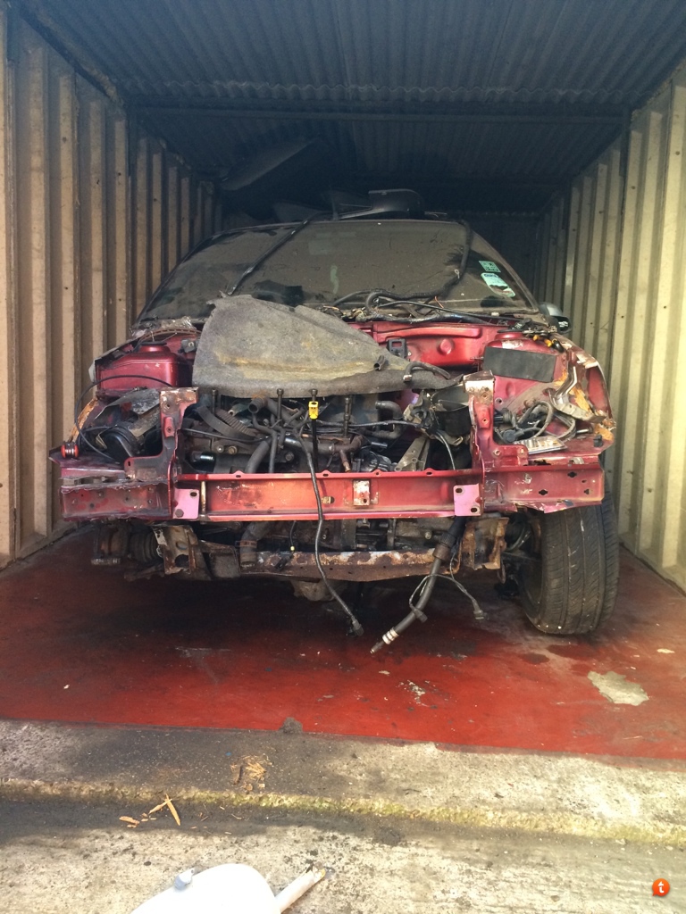

Where she slept before.....

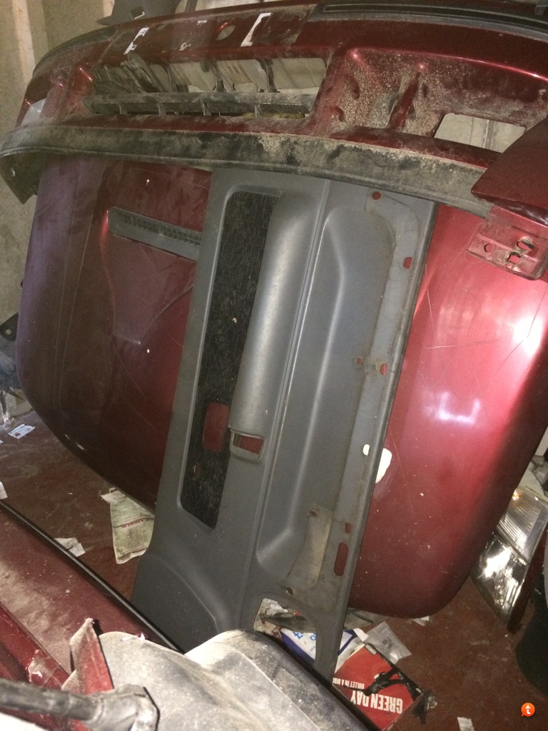

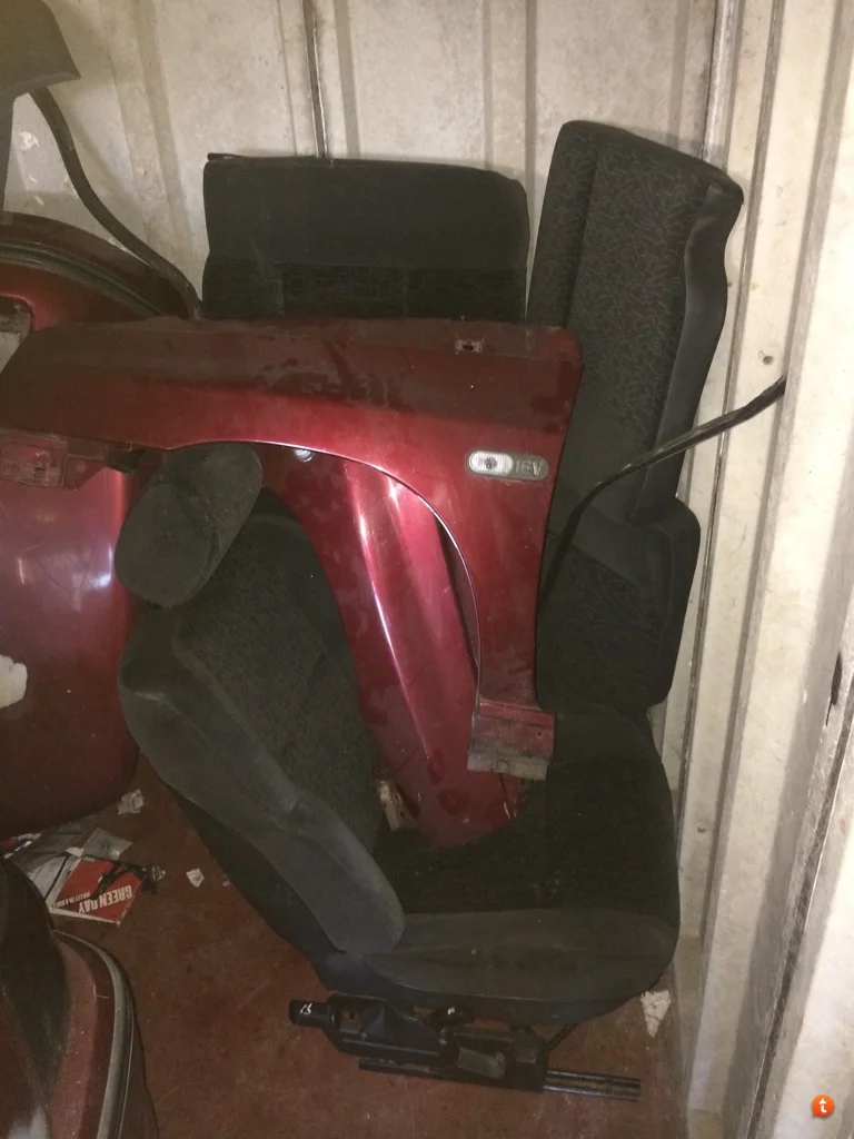

OCD has been a nightmare, so it was time to sort that messy messy garage!
She now sleeps like this, with all her parts nicely sorted and stacked...
So yeah! I now have a tidy garage lol. Sorted all the nuts and bolts into money bags, sorted all the parts into boxes all bar the big bits that are stacked up.

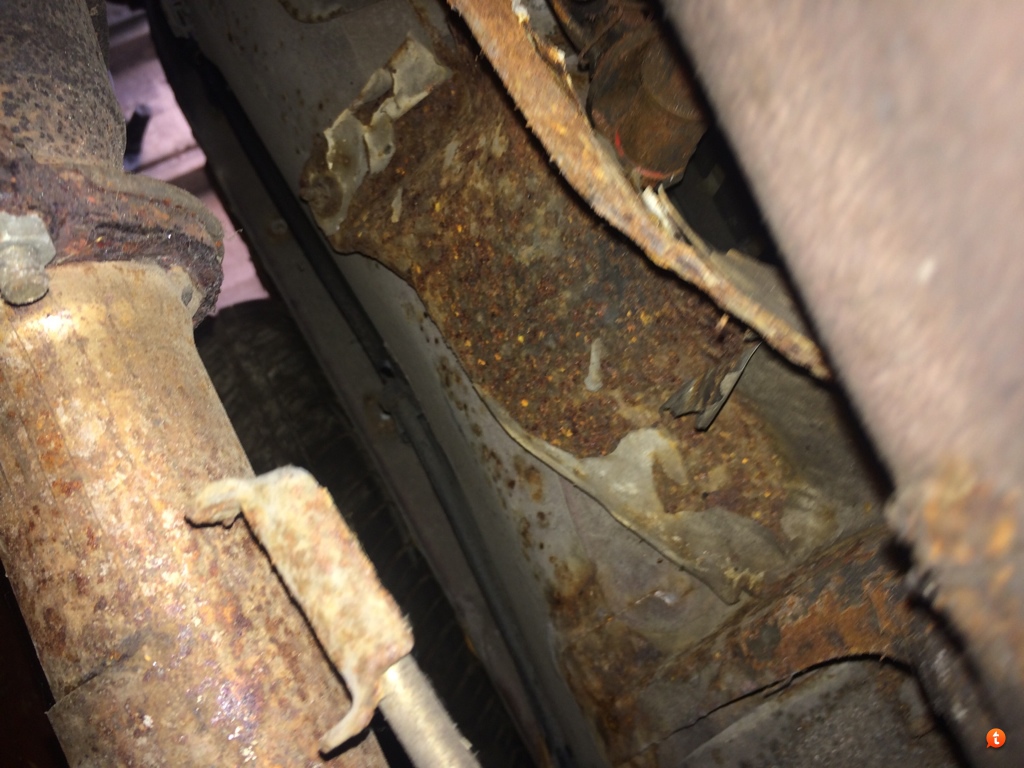

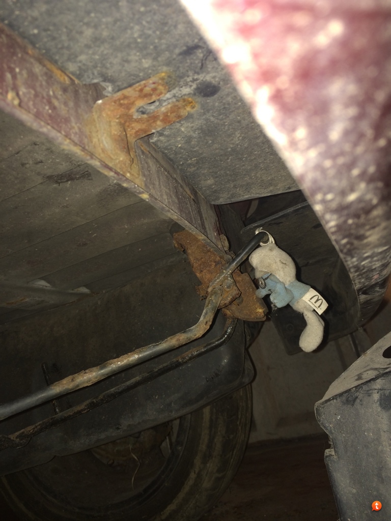

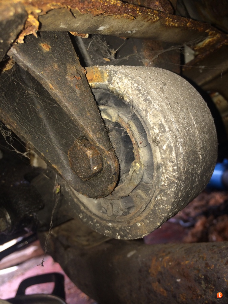

While I was tidying under the car I got some snaps of the rot... And come across more, joys of mk1 ownership! Lol :lol:
Nothing that can't be sorted though eh!

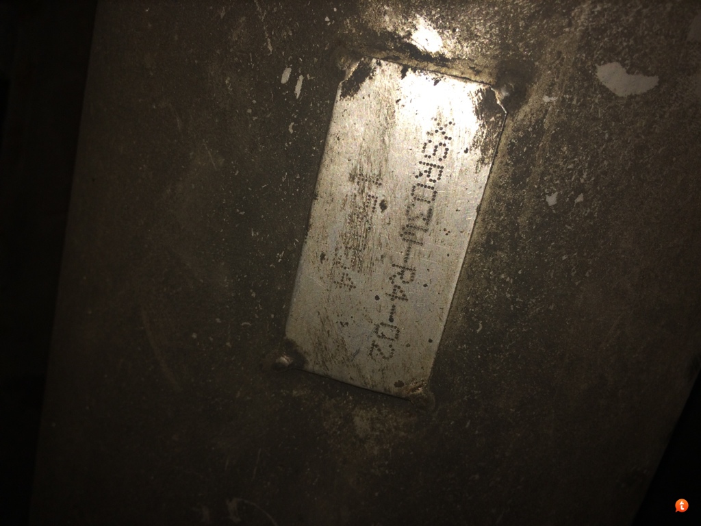

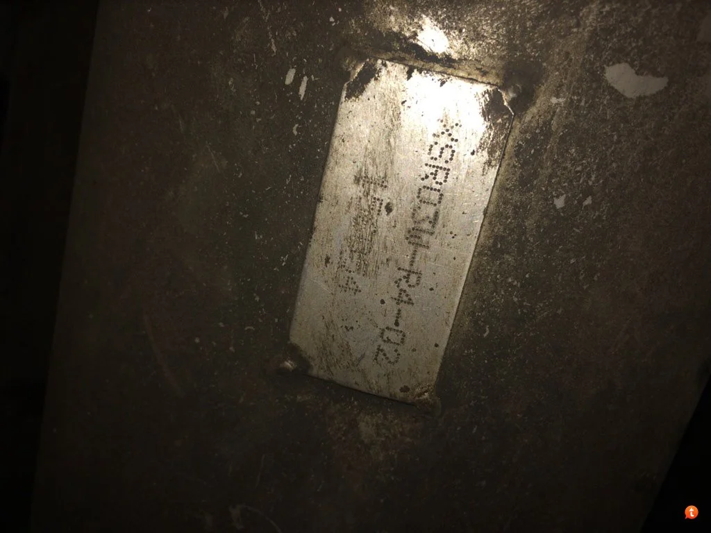

Also, does anyone know what this exhaust is? I can't see no brand names on it, just this

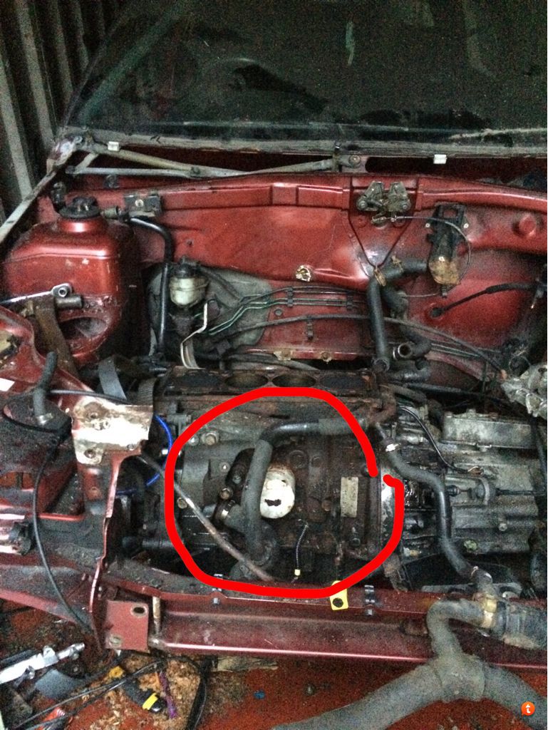

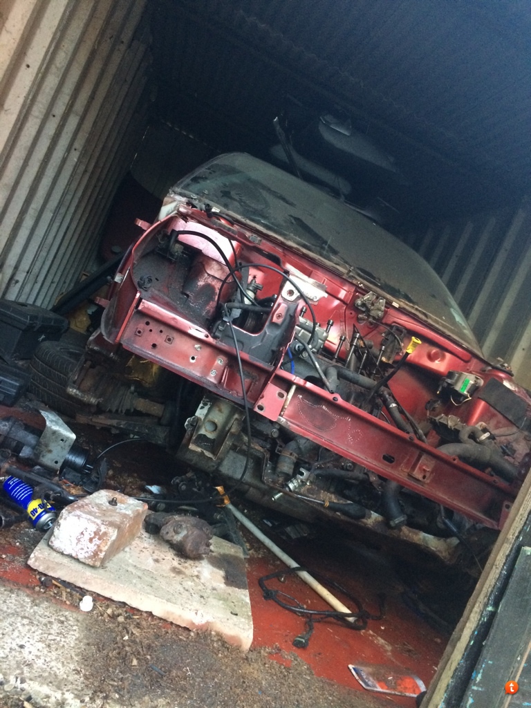

Bit of an update, its been a while as I've not had access to the forum as I haven't had my phone :[

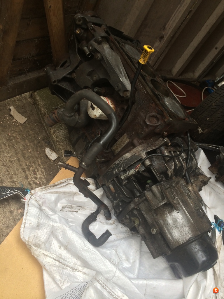

Anyway the block is finally out! Did it by dropping the subframe and man handling it from underneath the car lol. Was quite awkward as I can't get the ns front wheel off, nor can I get the other three lol. But now I can start work on the body, get the rest of interior out etc.

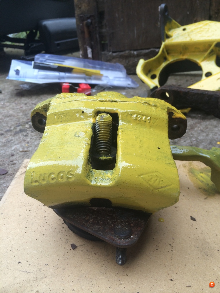

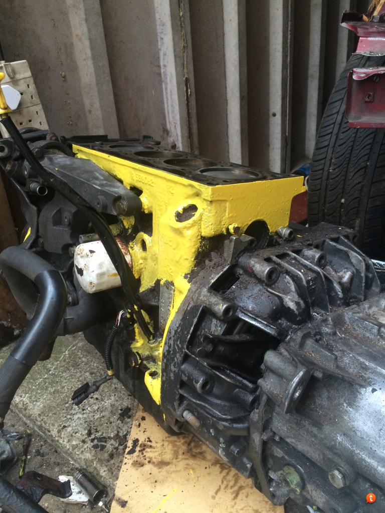

Well today I bought some paint to paint the block as it wasn't looking pretty
Loads of colours to choose from, but as I'm sure you all know I love lairy colours! So I went for...
Yellow FTW! :rofl:
But, as always, changed my mind, really stuck on a colour now, not sure wether or not to clean it and just lacquer it, paint it red, hammered steel colour or graphite, I really don't know!?! I know I'll be doing the gearbox silver, the engine mounts in hammered grey effect paint.
But I suppose I can concentrate on stuff like that later on.
Did the callipers for fun lol
Oh and the battery tray/gearbox mount (won't be keeping that as ABW I'm getting some goodies off 16v_paddy and included is a 172 box with spider etc, a jb3 box and a clutch from a volvo turbo :p

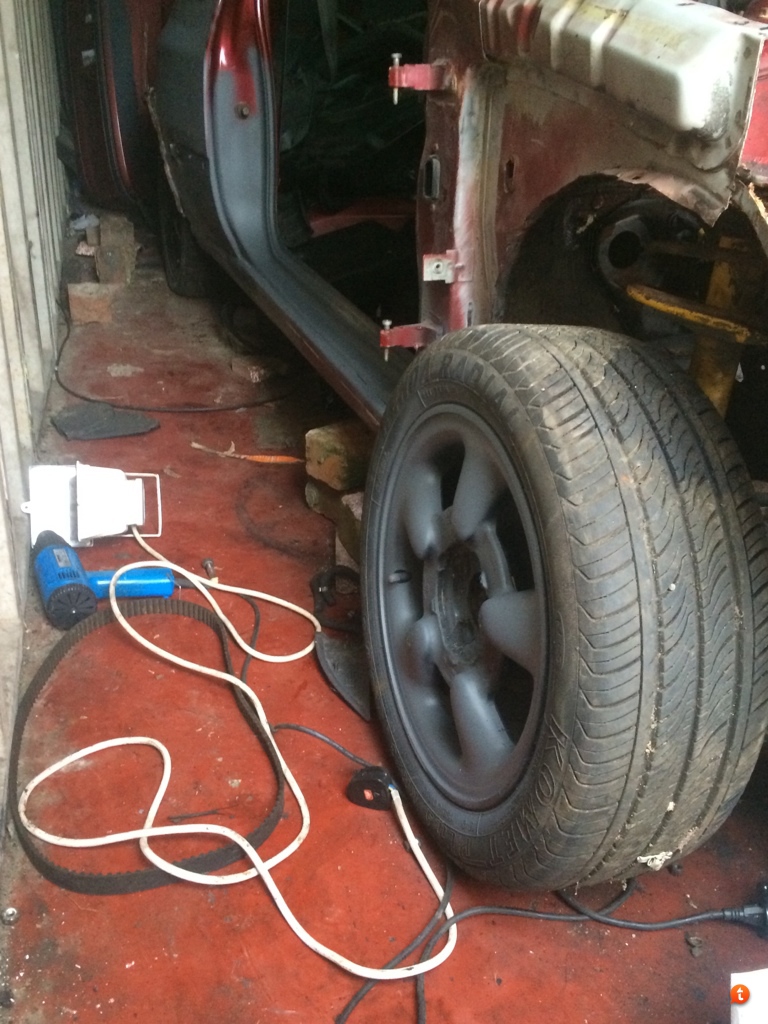

On another note, however, I think I may have chosen a colour for the wheels, looks alright IMO but other people may disagree
it's like a primer grey colour but it's not actually primer (can't remember the exact colour lol)
Would be that colour or anthracite/graphite but on williams wheels, other than that it's turbines in smoked chrome.

Found more rust the other day, but still not put off by it!
