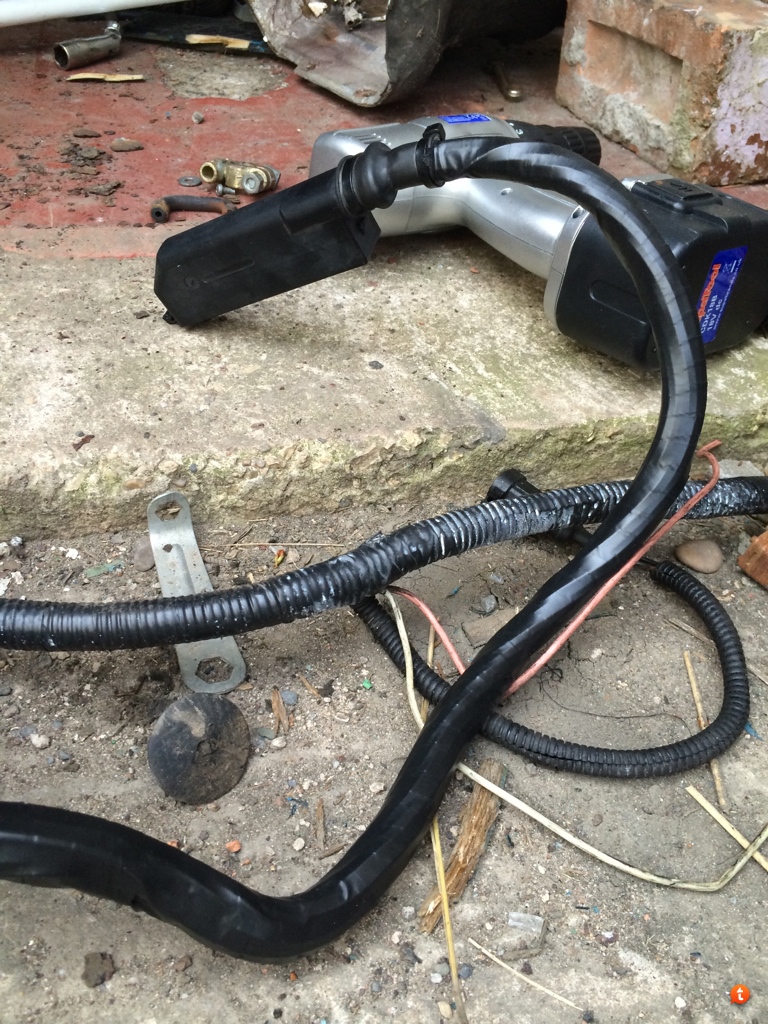

Was tinkering again yesterday, I did some more loom
it all now looks like the bit where the ecu connector plug is now,

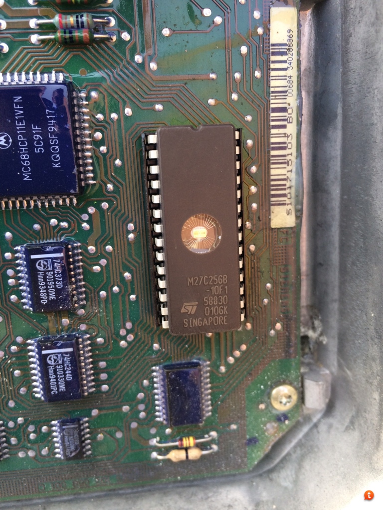

Can anybody give me information on this chip? It was in it when I got the car and I was just told it's a phase 1 chipped ecu but the bloke didn't know what chip etc.

Thats just a chip that people can then write a calibration onto mate, there is nothing on it that identifies what it is.
The good news is that you now have the chip socket in place to swap easily to another chip, as IIRC as standard they are fixed onto the board.

Okay mate thanks. Any suggestions on a chip? Or would you stick with this one

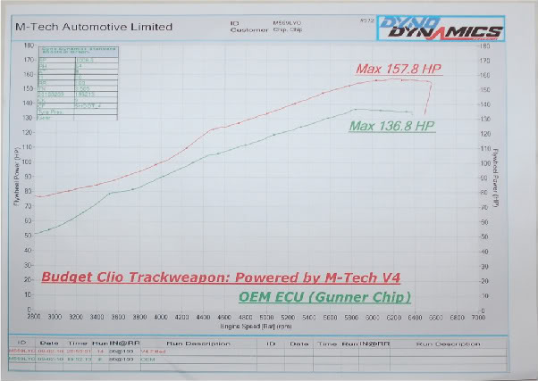

TBH one of the first mods I did to mine was bin the ECU and fit a mappable unit so I could map it myself. So I have no firsthand experience of the chips really other than the one I replaced which wasnt upto much was a "gunner" chip, and my remap on aftermarket that I did made a LOT more power.
There was clearly something wrong with the one on it, maybe it was wrong spec somehow, this does show much much difference a decent map makes though:
(thats a 2.0 (williams) engine I fitted not the original 1.8)
  X2 Clio Valvers

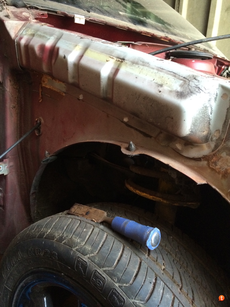

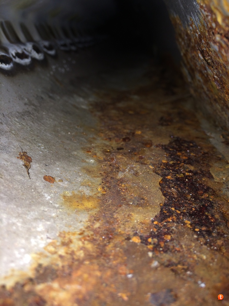

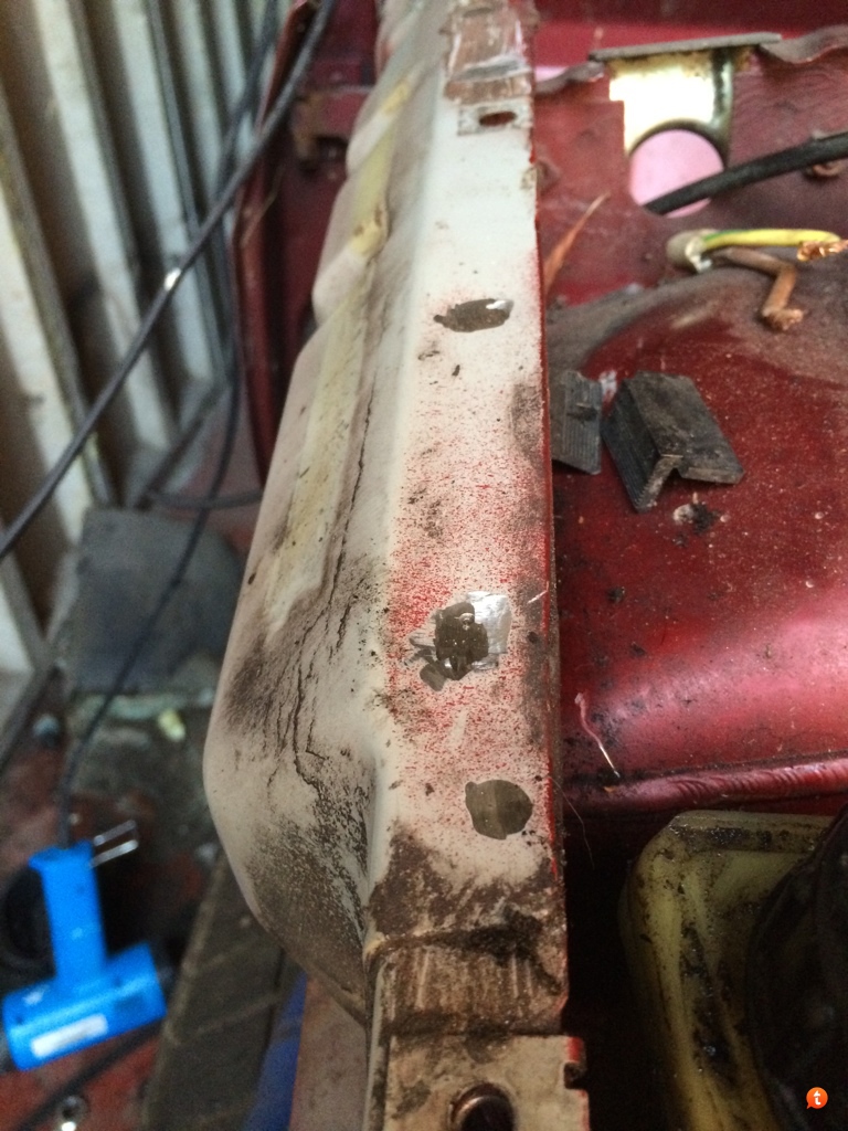

Been and ground out the spot welds ready for drilling, also stumbled across something that makes me feel a bit for the previous owner
The receipt he gave me for the work carried out said it had a full os sill, turns out it's been cut, peeled, patched and re welded! Well that's what I think anyway
On an upper note though the inner sill is good, solid as hell.
That seam sealer is horrid to remove, anybody know of an easier way than burning it off or chiseling it lol

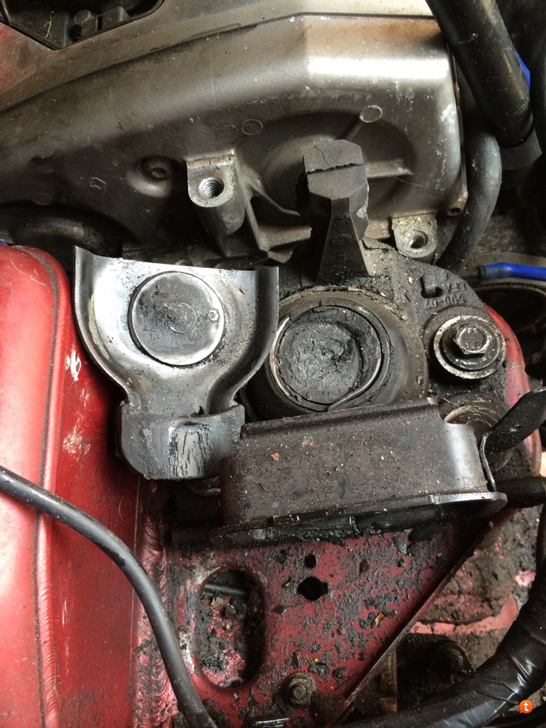

was planning on getting the engine ready for outing, decided as I can't get hold of an engine hoist I'm going to lower it with the frame and get a few mates to help me lift the shell, (did this on my stepdads escort rs turbo conversion)
Anyway discovered that mount is.... Well, yeah, probably the answer to a gangnam style engine lol.

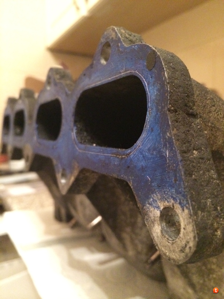

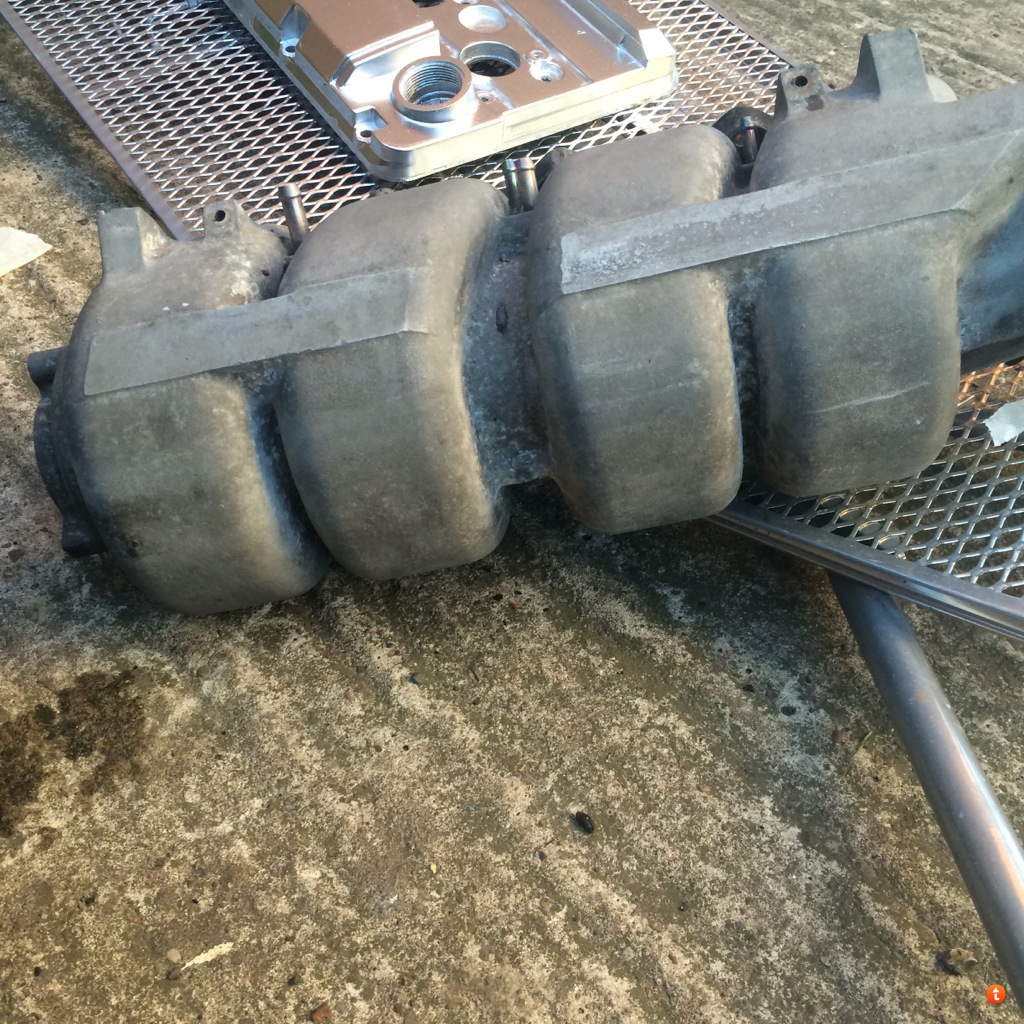

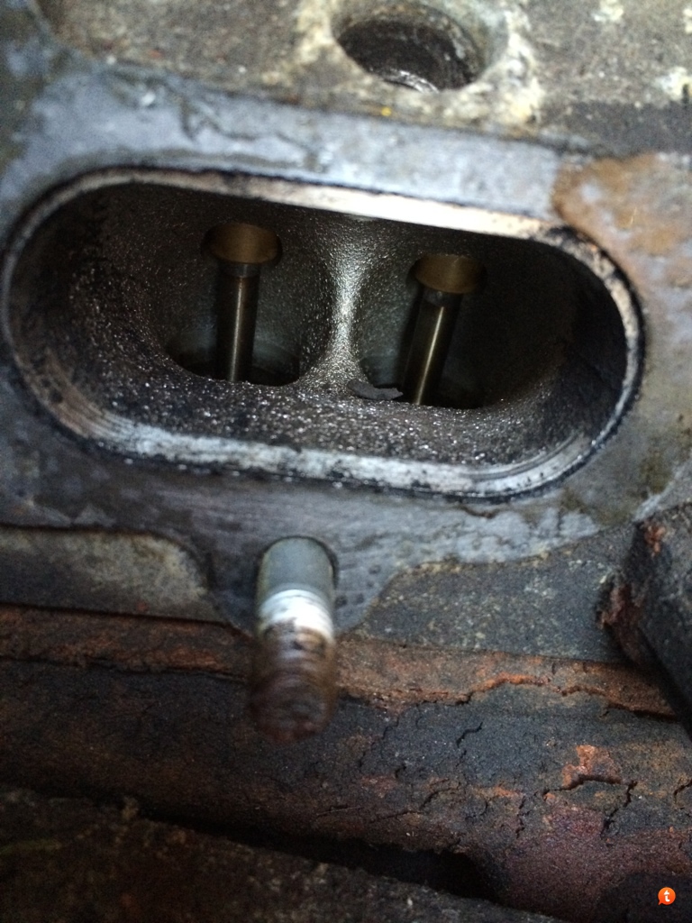

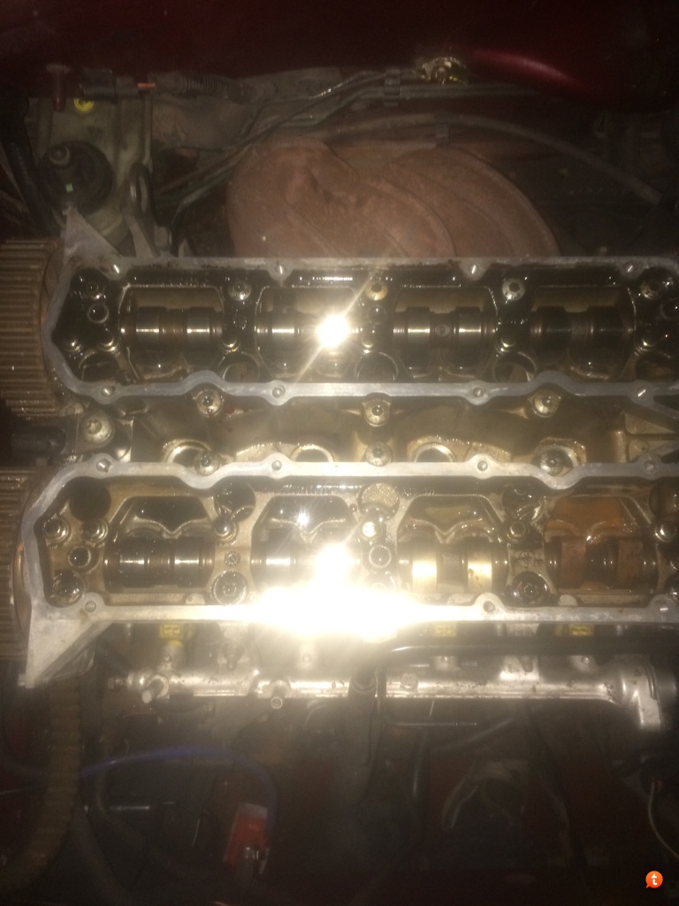

I've been poorly with the chicken pox the last week or so, so haven't been up to much. However I'm now all better so resumed working on it, yesterday I got the inlet manifold off and was quite surprised to see the internals like this
Anyway I brought the inlet in the house, cleaned it and set about matching it and porting it

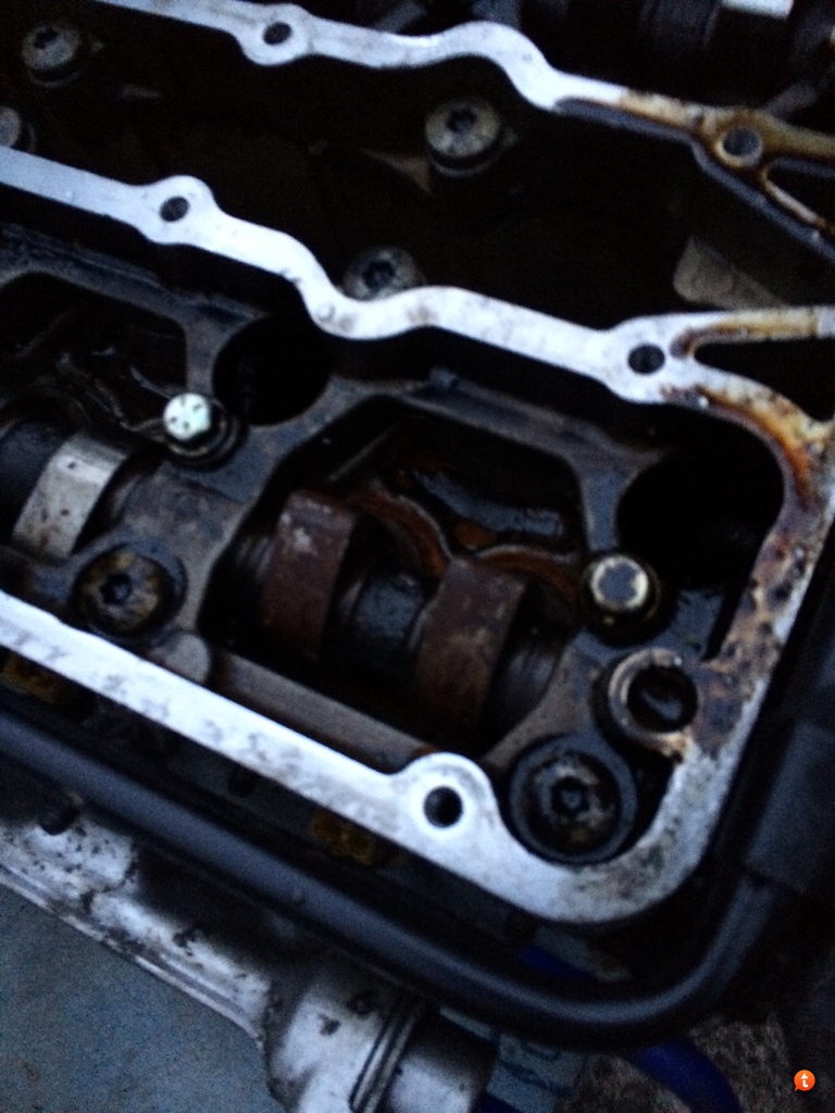

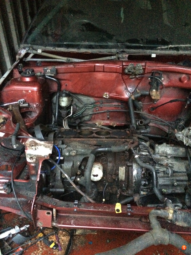

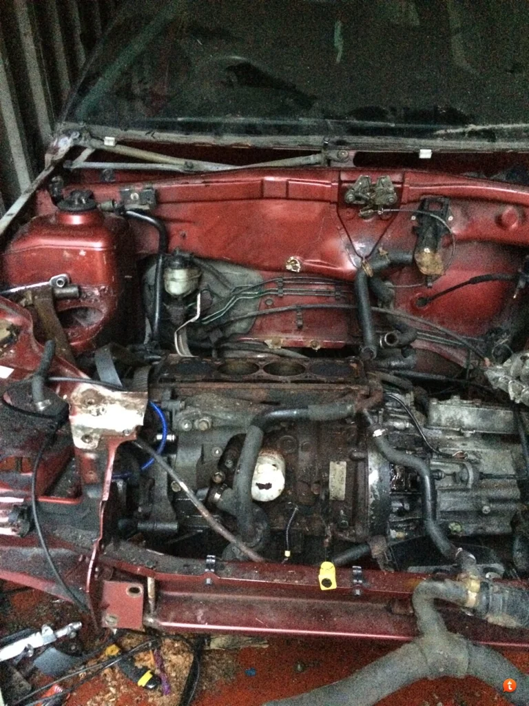

Been out today again :D had a good few solid hour, I've removed the brakes as they were binding, removed the downpipe so I can remove the subframe at a later date, I then set about removing the cylinder head as I want the engine out to do the body and I can do the engine inside lol. Anyway I took off the cam cover, the gasket was fubarred lol, started removing the torx that hold the cam carriers down but some are badly rounded so not sure what to do with em... After loosening about 4 or 5 my hand slipped and smashed straight on the cam carrier, how Sharp are them f@ckers!!! Bled everywhere, it was literally pouring lol, however I've cleaned and plastered myself up ready for tomorrow :D a few pics of the cams... Sorry pics aren't very clear!
I've noticed the far right front lifter has some watery type stuff in that looks rusty, in fact they all have some in...
I'll update tomorrow as I'm hoping to have the cylinder head off lol!!!

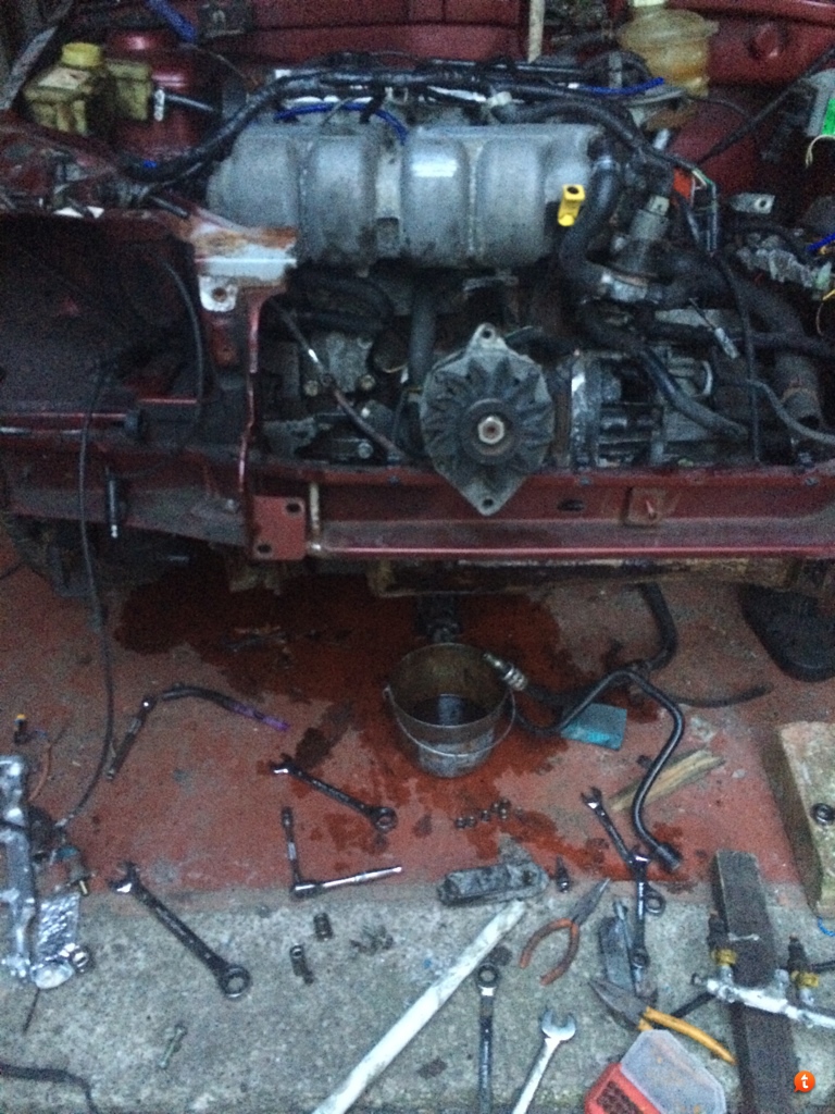

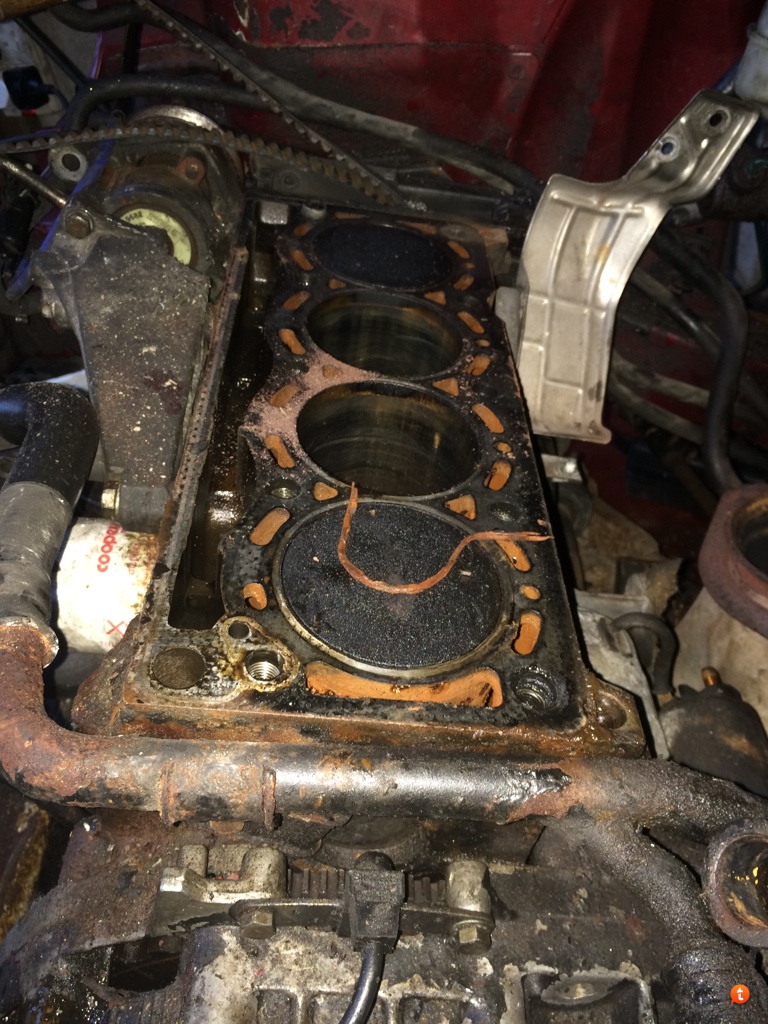

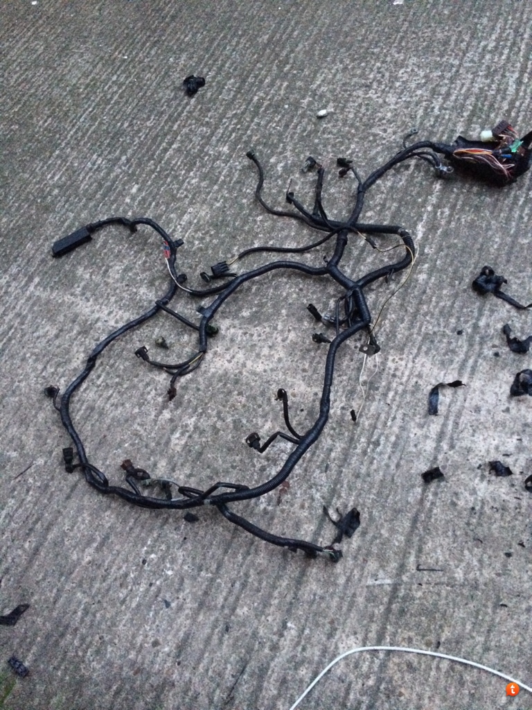

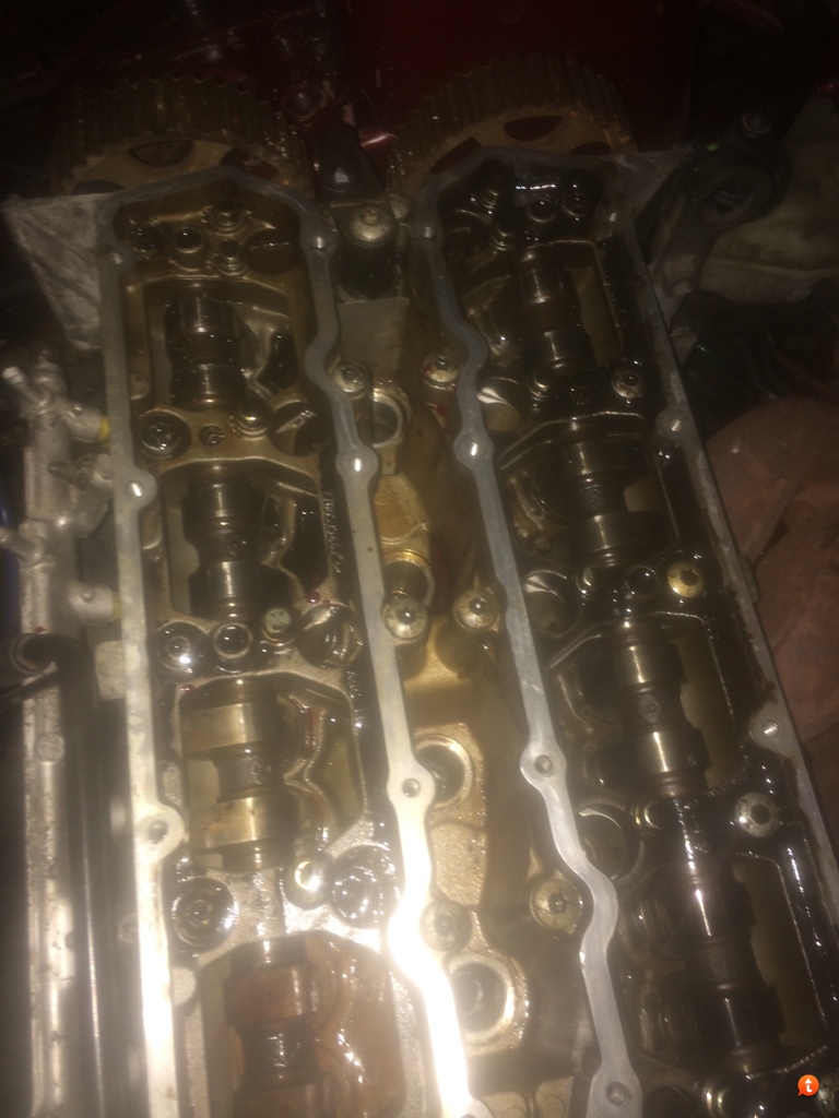

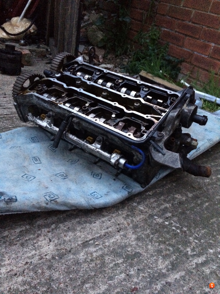

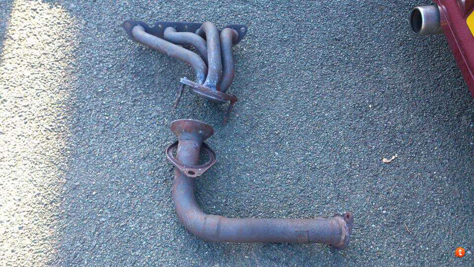

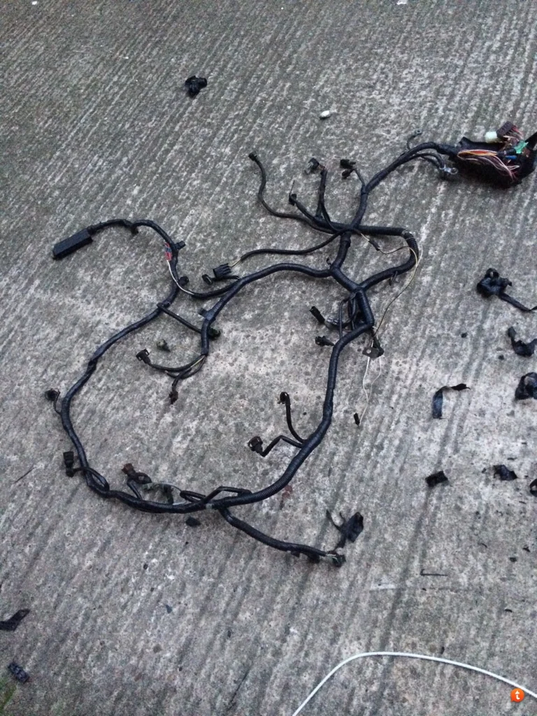

Finally got the head removed today after lots of struggling and swearing! Lol one thing that threw me was the amount of silicone on the head :/ gasket was fine but doing a rebuild anyway... Also completely removed the engine loom to redress it all as it looked like crap tbh.
Any how here's some photos
There was loads more than this but I forgot to photo it all
More to come tomorrow as hopefully I'll have the bottom end off...
Another thing, this area looks rusty but the rest are fine... Any clues as to why? Is it just from been stood?

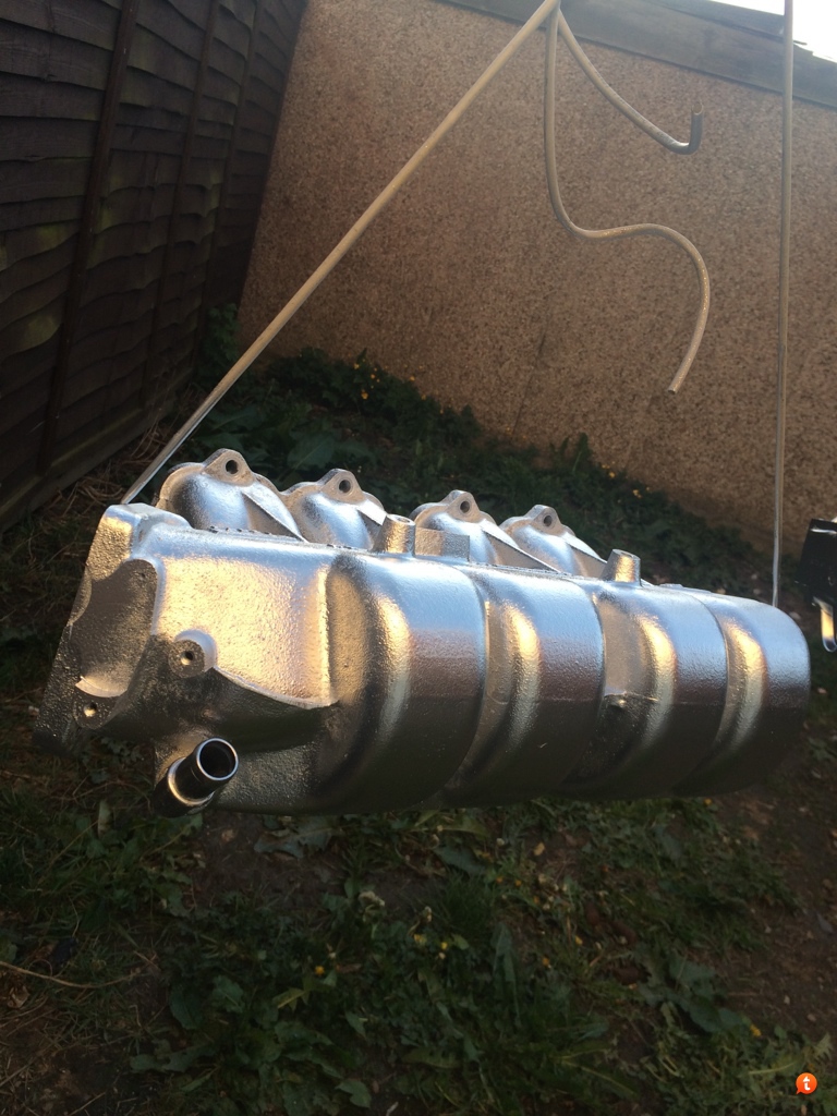

Right, after reading matt turners thread about the lunar beast, (which is inspiring may I add) I liked the look of shiney stuffs under the bonnet, so today while we were out shopping I bought some plastikote chrome paint, really I just wanted to see how it could look, eventually I'll have them chrome plated or powder coated, or I may just do a "proper job" with paint but use black primer (I'll get to why in a minute)
So first off I needed to clean the oily mucky parts...
So caustic soda assisted me...

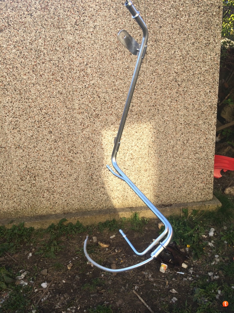

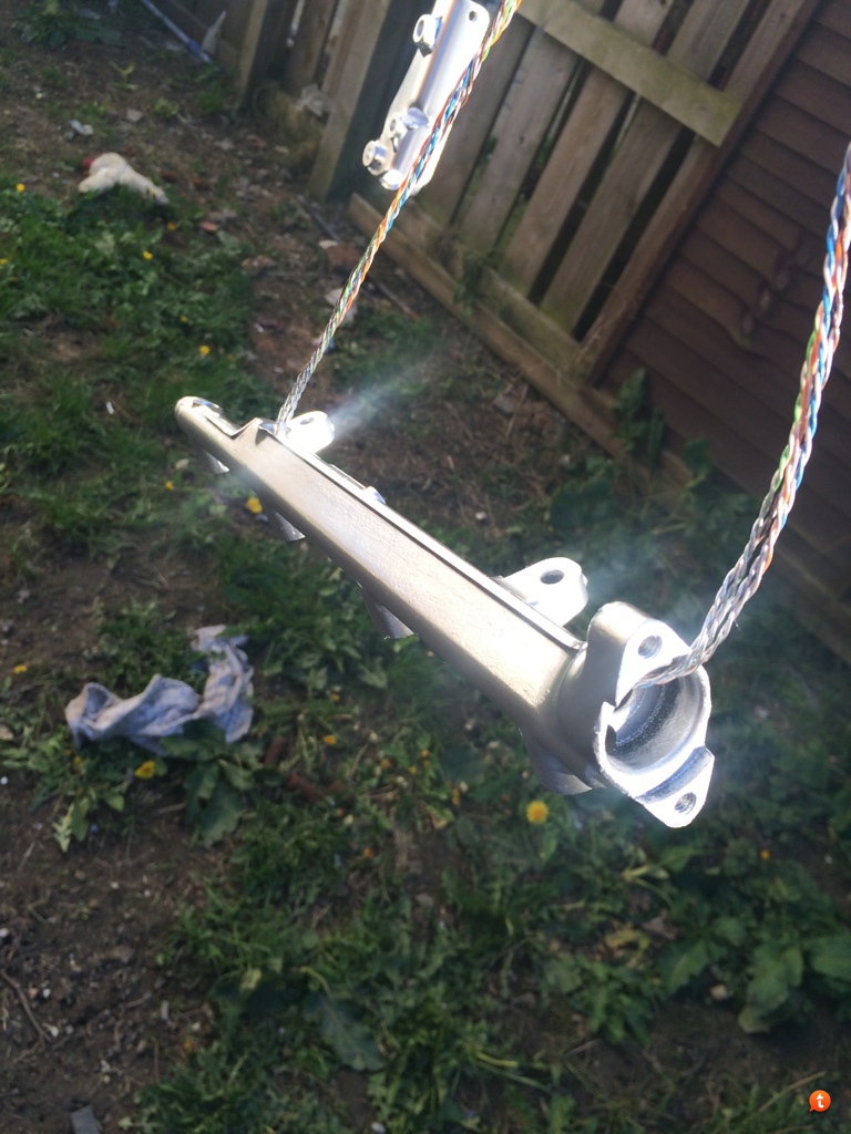

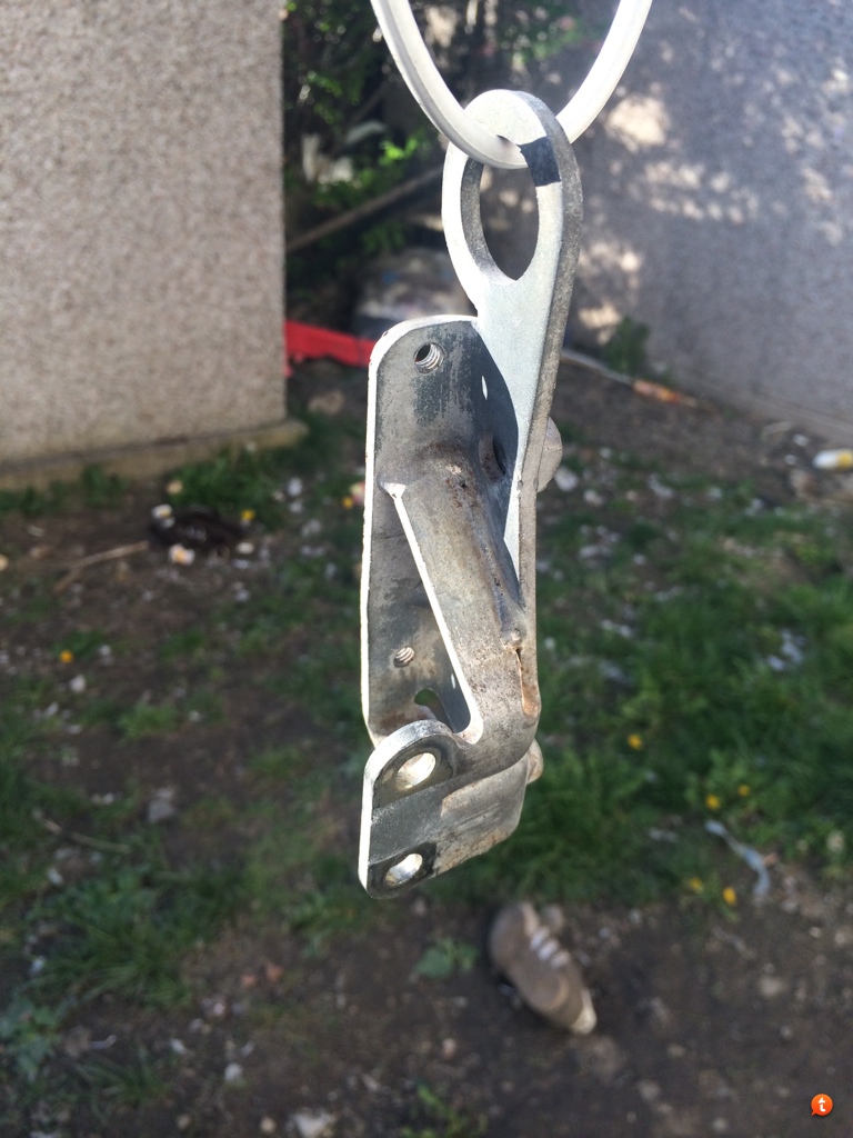

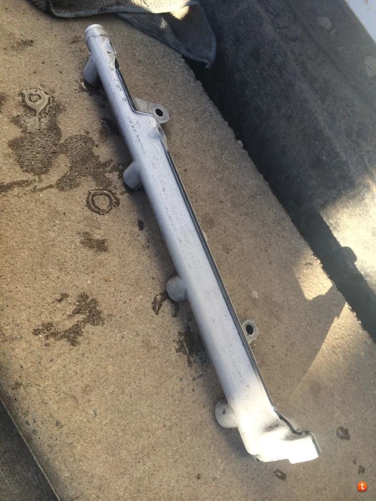

First up was the engine eye as seen before in my last post, secondly I did the other modified injector rail.
Looked like this after a soak
Hung on the washing line (with an old Ethernet cable lol!
First coat

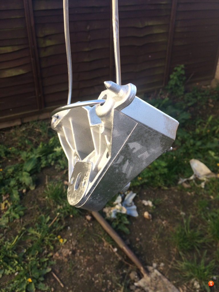

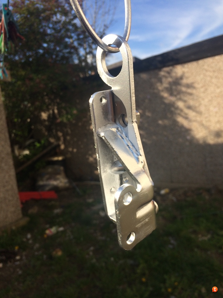

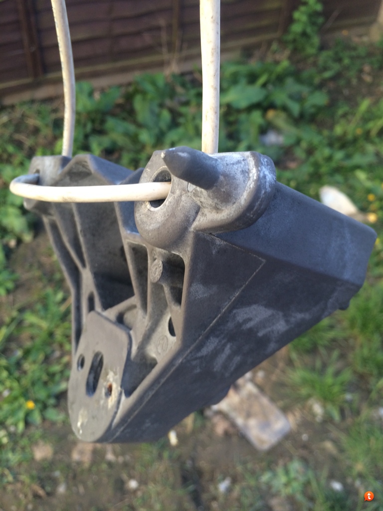

So then went and got the top engine mount cover thing
First coat

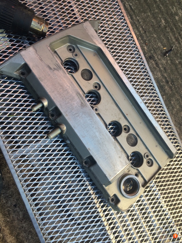

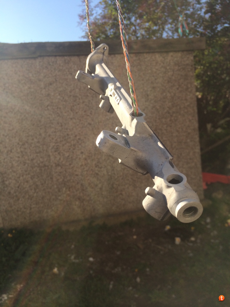

Then this became my favourite rather quickly! As I said about using black primer , this is why, the fuel rail was already black and after soaking for a bit it roughed up, personally I think it turned out the best, even after the first coat!!

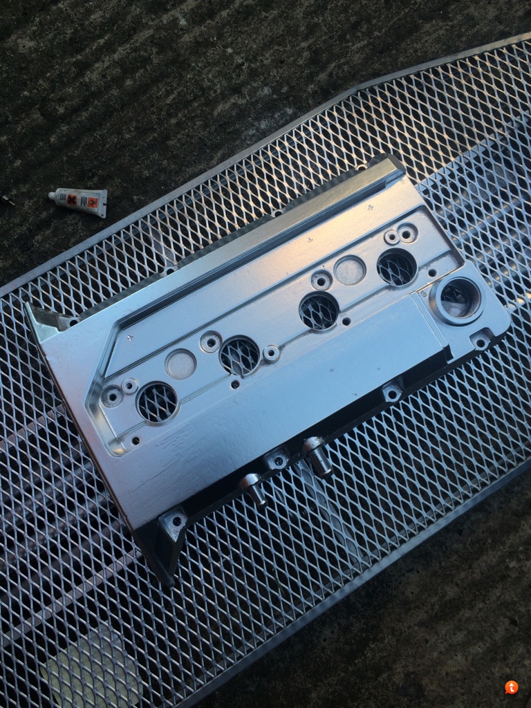

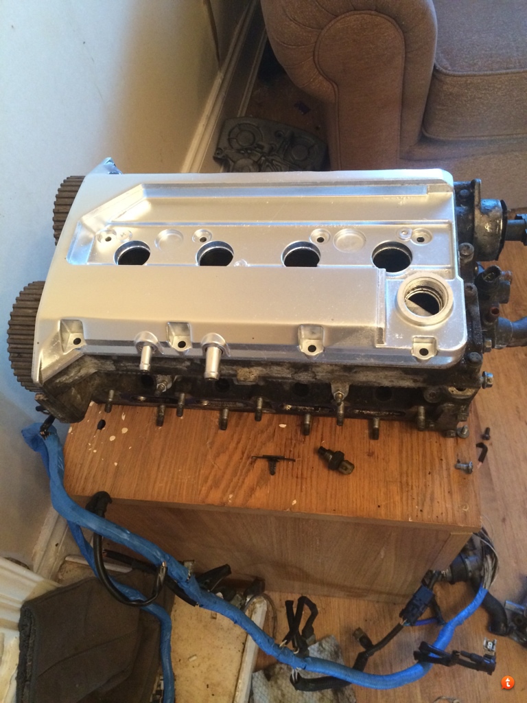

Then I set about doing the rocker cover, mine was already had a polished look but it had started cracking/bubbling etc so did the normal routine, soaked, and then painted.
Before
After

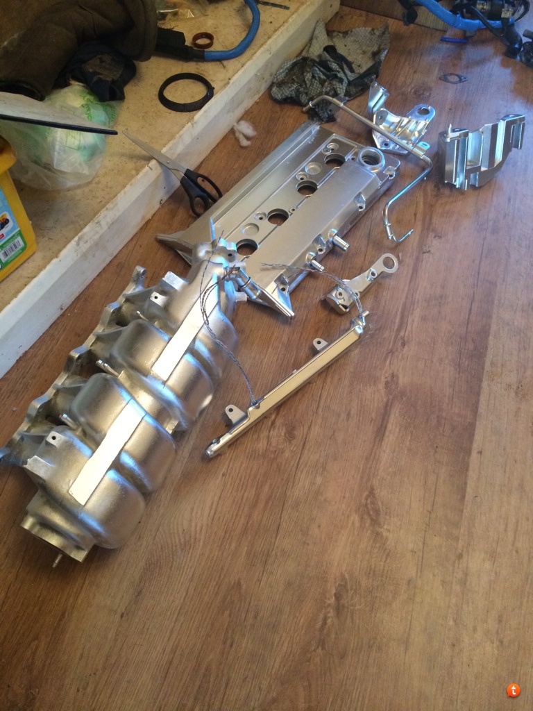

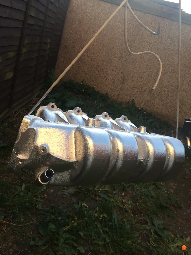

Then I did the intake mani, had to soak for well over an hour!

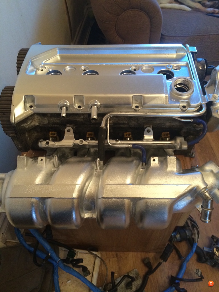

And then painted up
Tbh, I wasn't that happy with the result of the intake mani, think it looks like tinfoil lol.

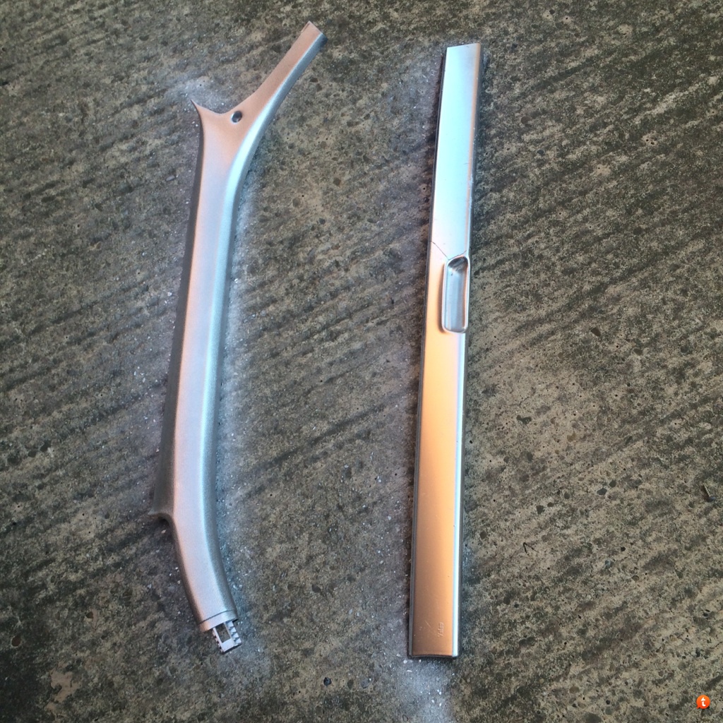

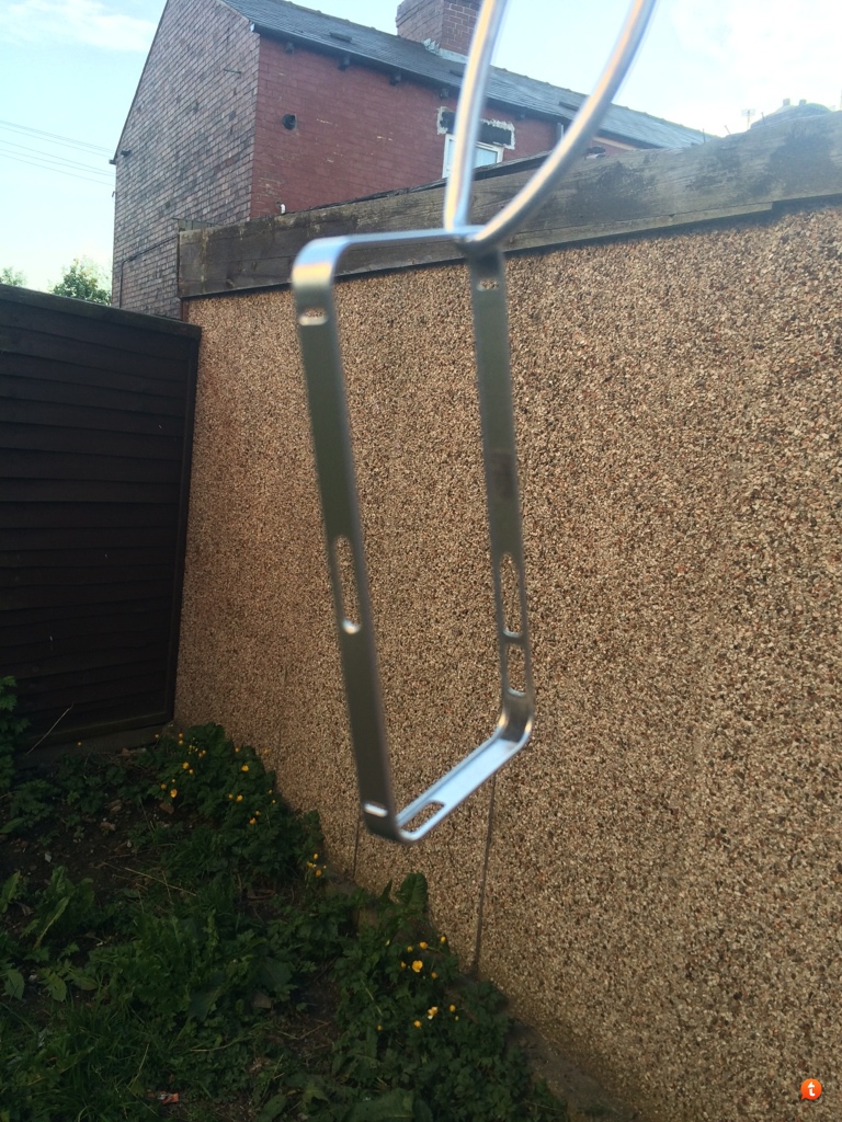

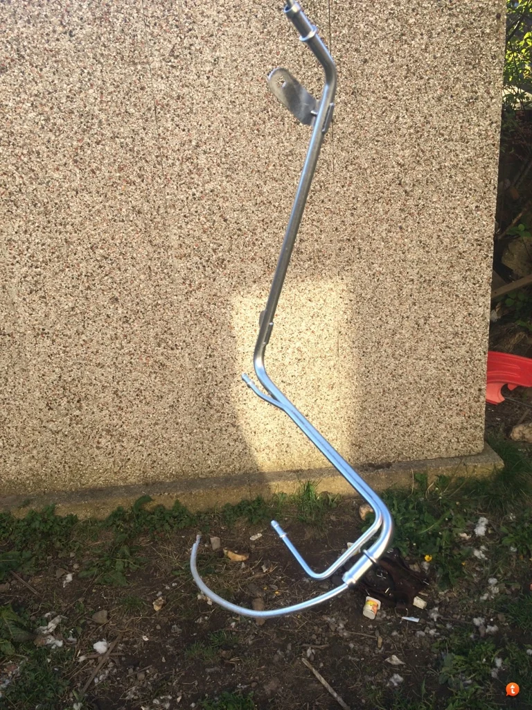

Also did these for fun as I'd painted everything I wanted to
Boot trim and interior trim

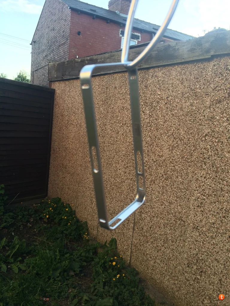

Iphone 5 aluminium case (was gold)
then chrome lol.
Everything after a final 3rd coat

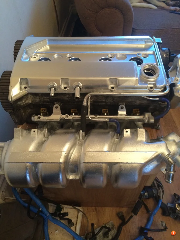

Then couldn't wait to bolt everything up to see the result!!! xD
