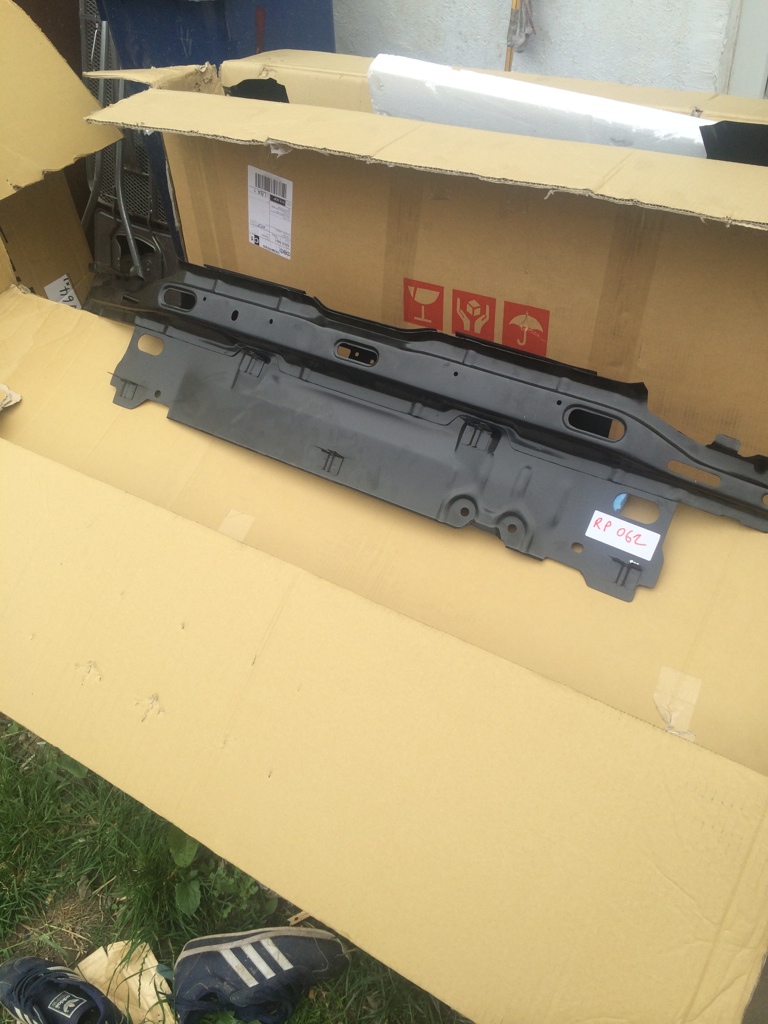

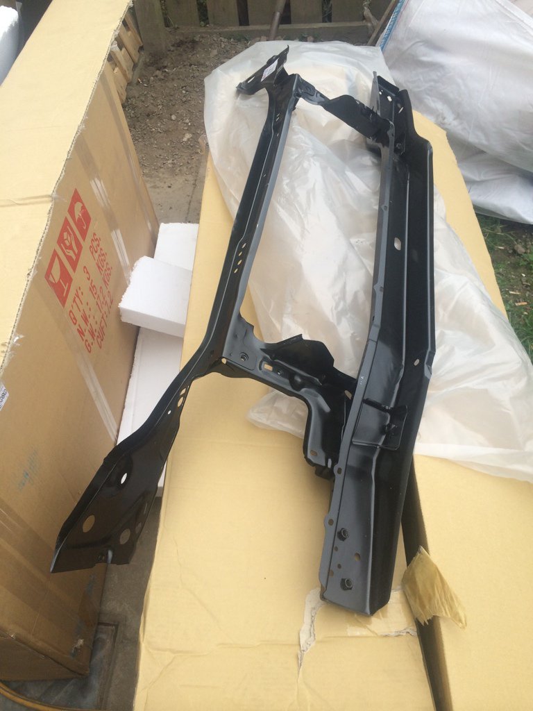

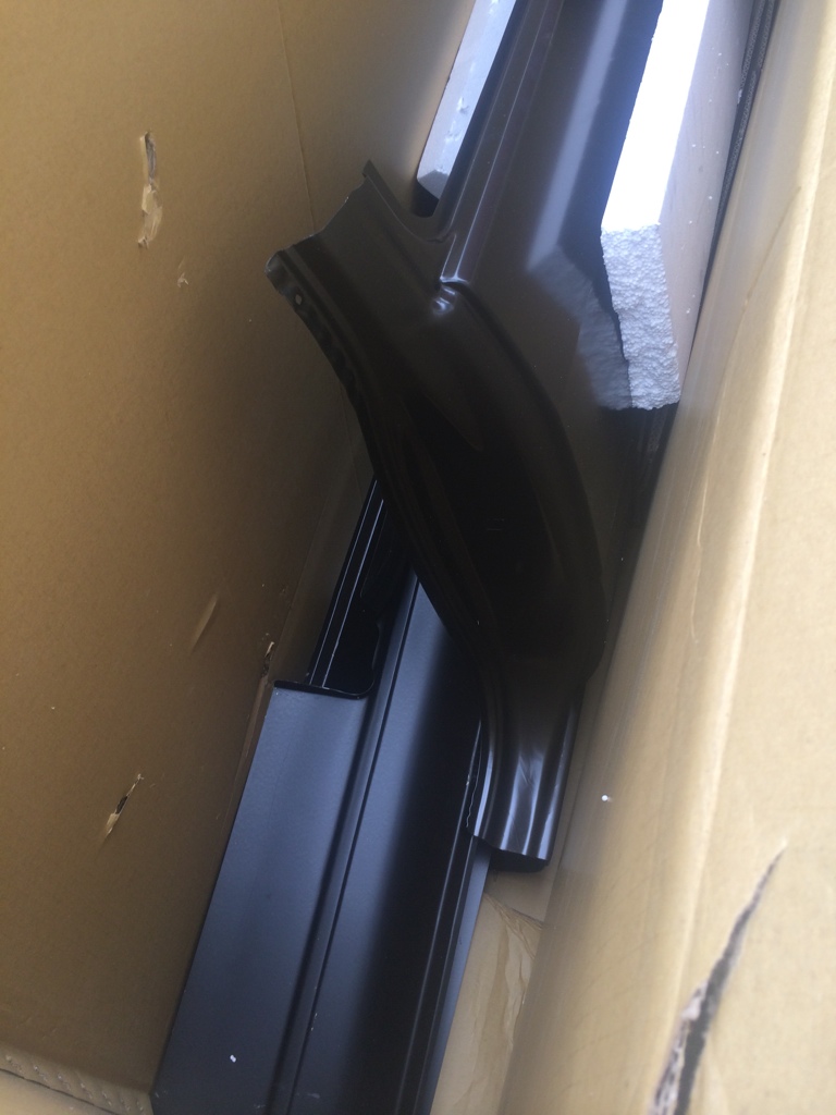

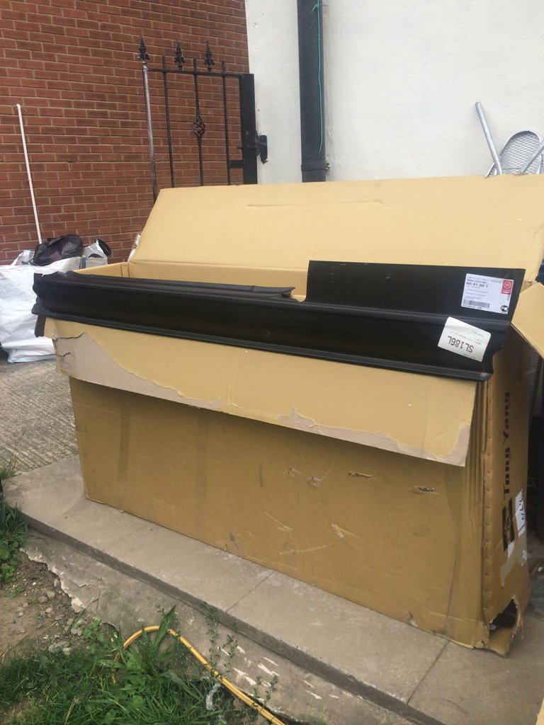

Today I got some big boxes! :cool:
And inside those boxes
So yep, that's a pair of sills, a pair of rear quarters and a full front and rear panel. Just need my welder to hurry up and make an appearance lol. While I'm waiting for that I'll probably get these rear quarters to flare as they're only pov spec ones.
Can't wait now, like a big kid lol.

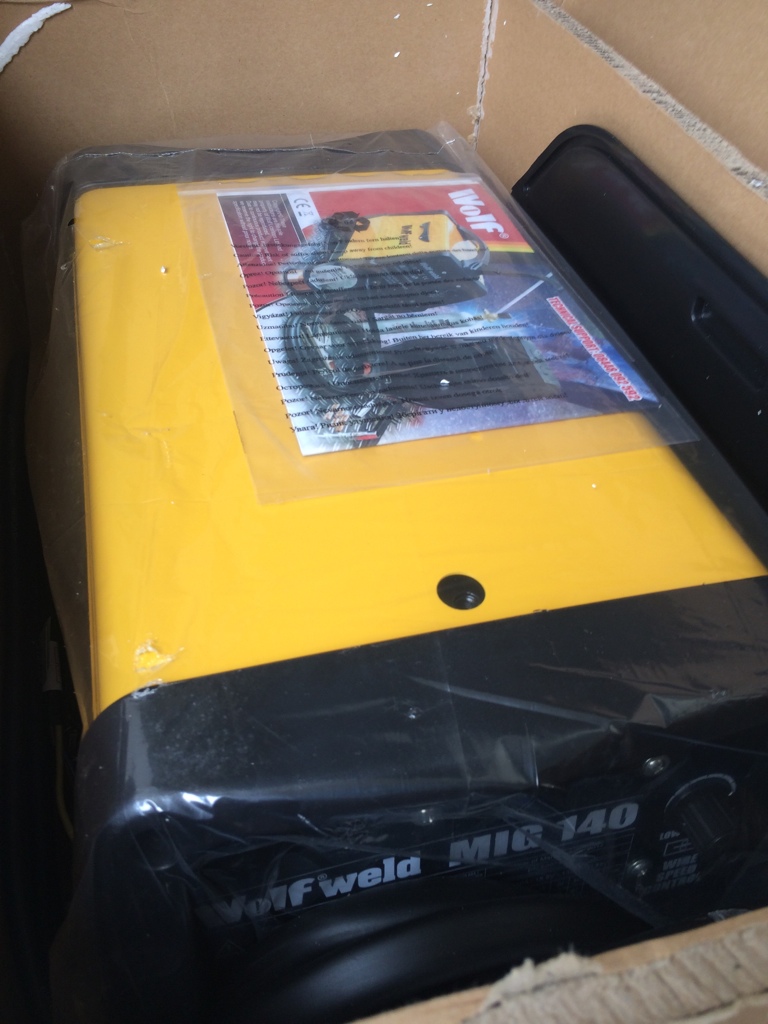

So as all reading will have seen, I've now got;
Mig welder
100Litre compressor,
Spray gun
Cut off tools,
Ap sander,
Mini sander,
Shot blasting kit
Impact ratchet thingy lol
All the usual other stuff that's air powered lol.

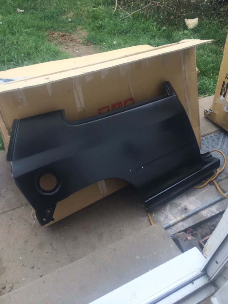

And today I got the body panels,
Obviously the flared rear quarters used on the valver and williams aren't available to buy anymore (I don't think anyway lol)
So poverty spec it is

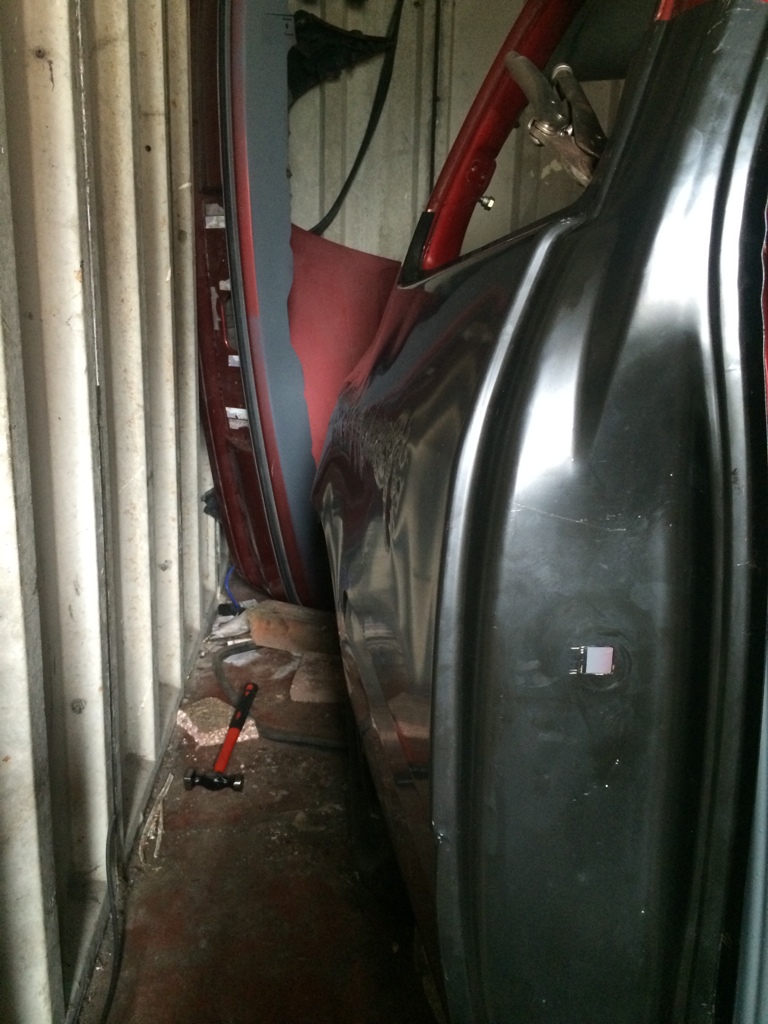

Got the rear quarters out of the box
Used my eye to measure where the flare starts and ends and what not
Sorry about the crap quality of that pic.
Did a little adjusting in the house :lol:
That was just giddiness really ha.

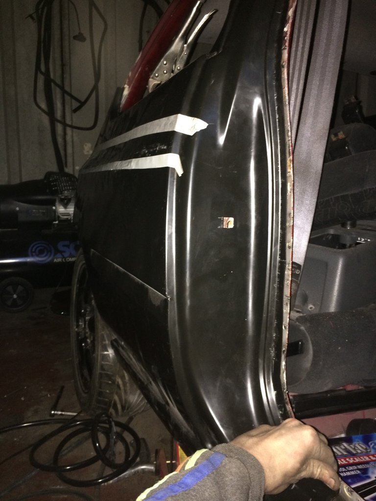

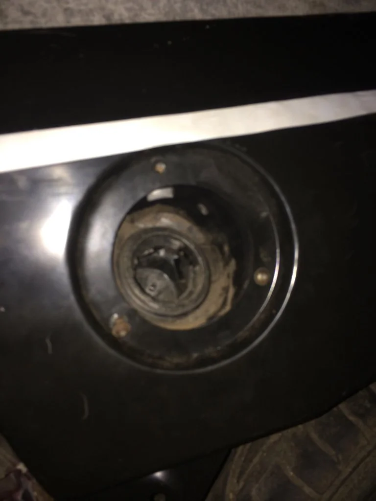

Then took it out to the car,

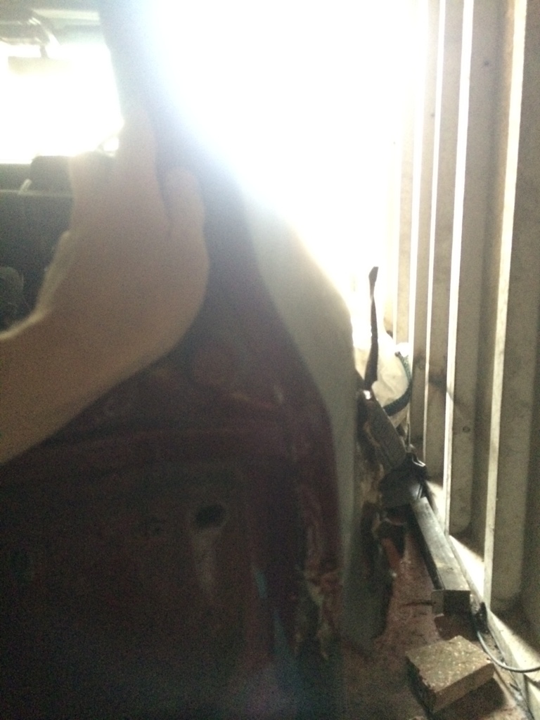

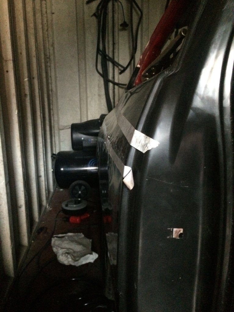

Clamped it on to the original to see how everything lines up as I've heard people say valver ones are longer than poverty spec ones
And surprisingly everything lines up near enough perfect, all bar an inch or so but that will go once the original is cut out I'm hoping.

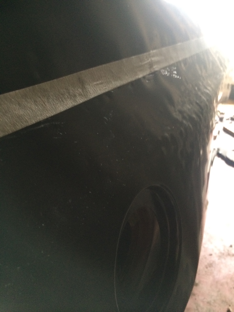

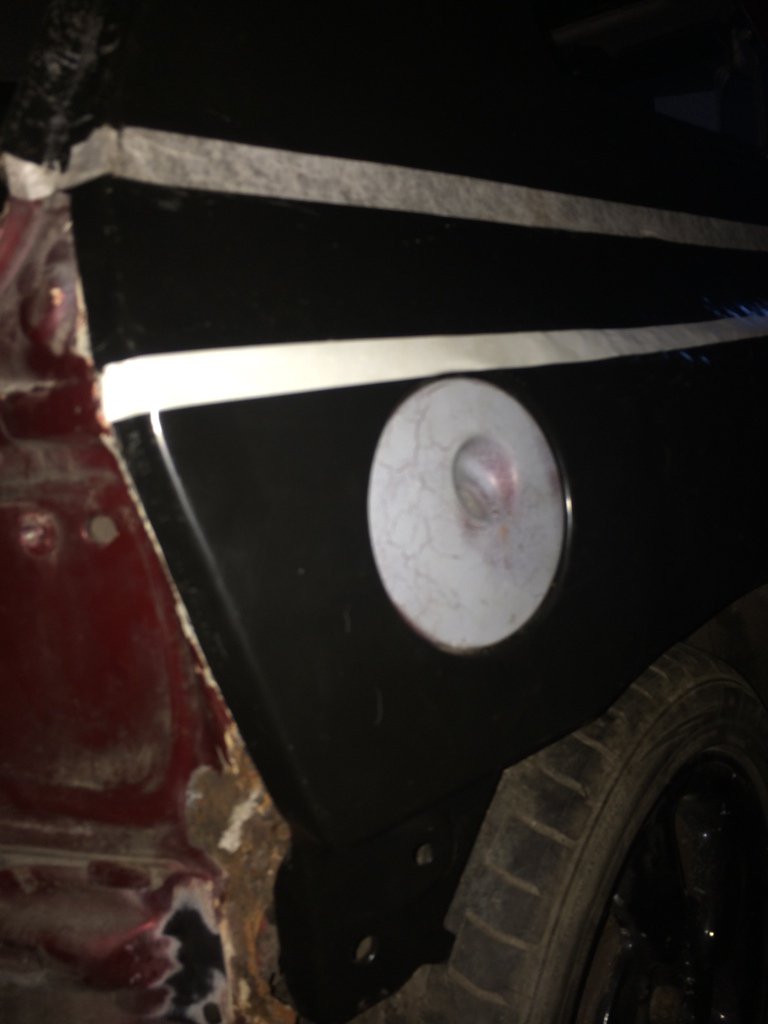

Then I used some tape to measure the crown length,
I did put some tape on the lower crown too but no photos as my battery died lol.

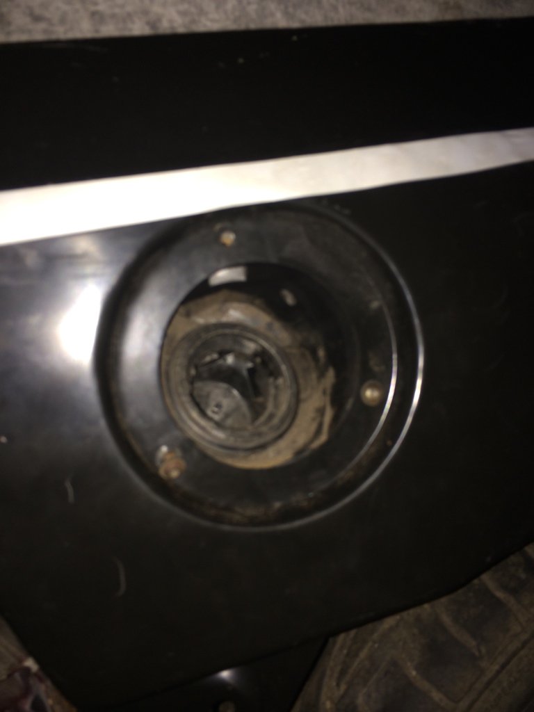

I kept making adjustments and test fitting, what I aimed for is about an inch or so difference as the original quart is still on lol.
I've managed to stretch the panel a little to get it to "kick out" above the fuel filler, and made a start on getting it to flare, but sadly no pics as battery was flat, so will take loads tomorrow :)

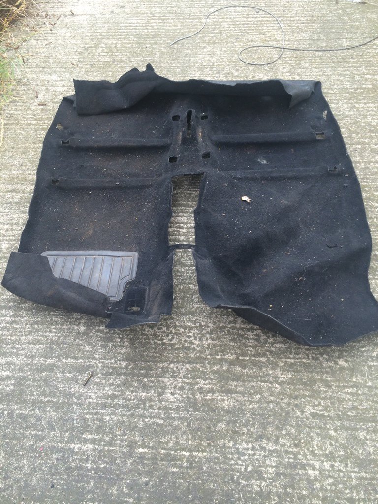

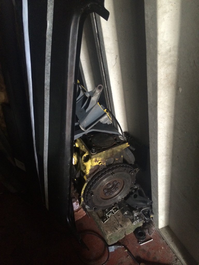

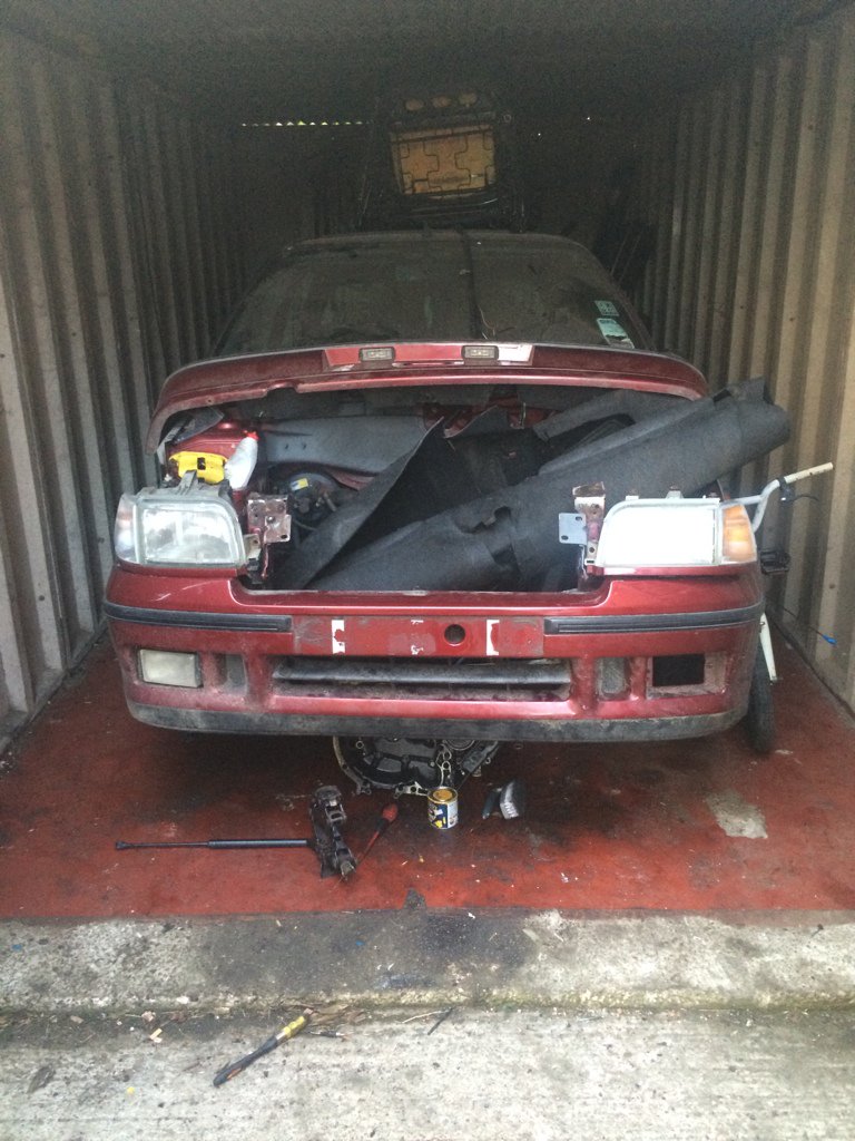

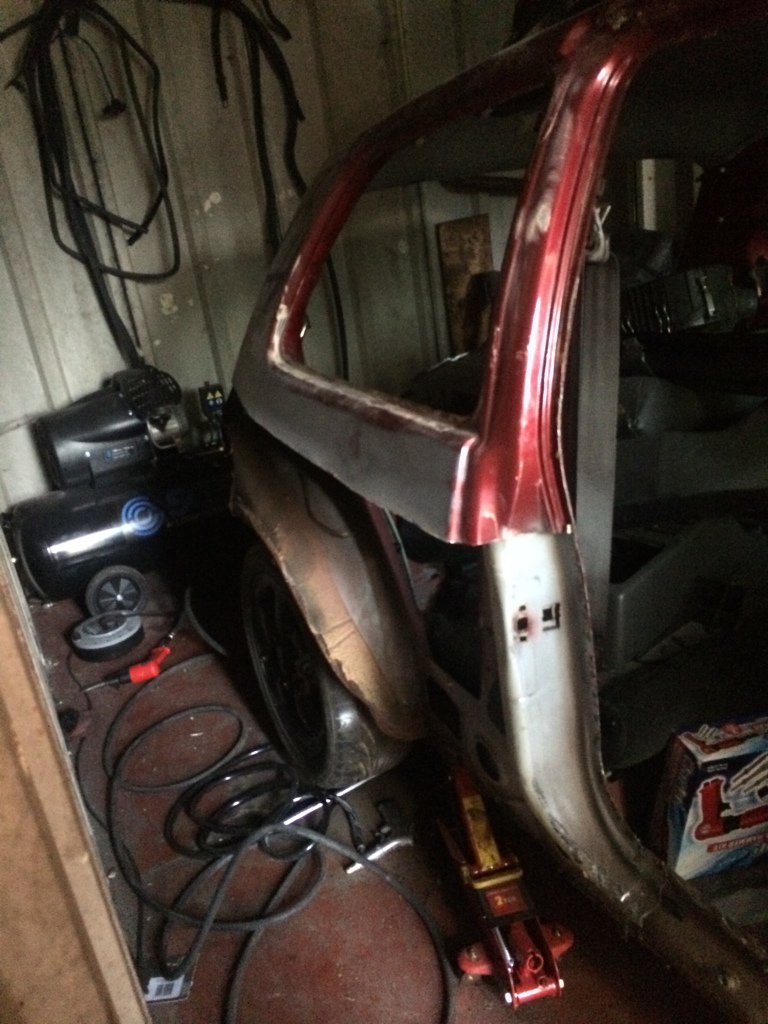

Here's what happened yesterday, I was hoping to make a start on the shell but had to tidy the garage out first...
Here's before I sorted everything
Messy messy garage, bits everywhere, so I started moving stuff
Engine and panels in one corner

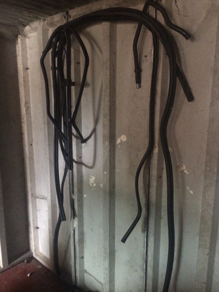

Rubbers arranged
Sorted through all the stuff, put some in the car and threw quite a bit, I was a bit stupid and wanted to keep a lot of little bits that were probably original to this car as they all had matching dates on. But space was needed so threw them out
Bonnet and front wings are stored in a box box at the bottom of the garden lol

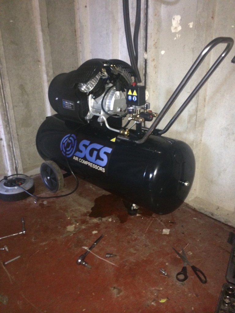

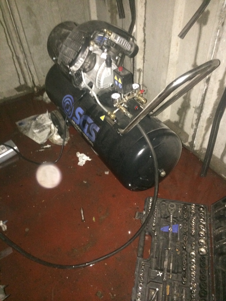

Compressor in it's location with the welder also

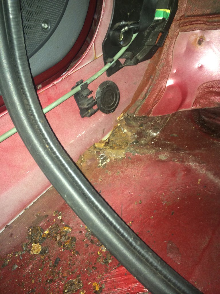

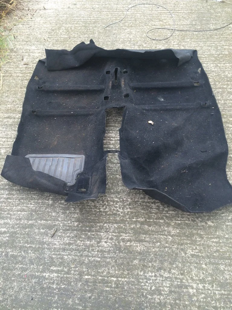

Carpet removed

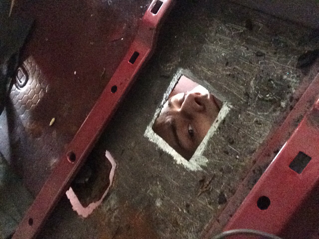

Through the floor selfie... LOL

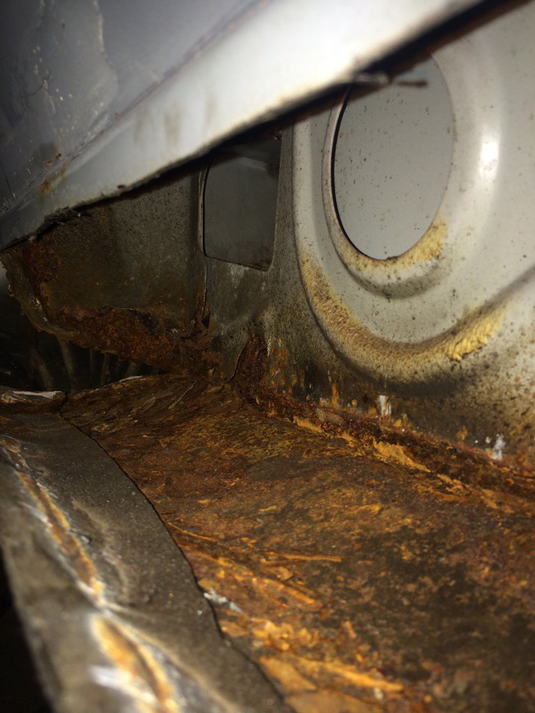

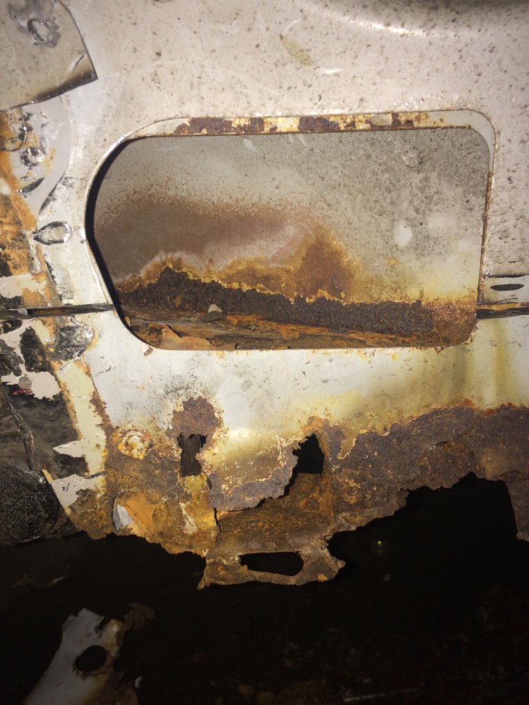

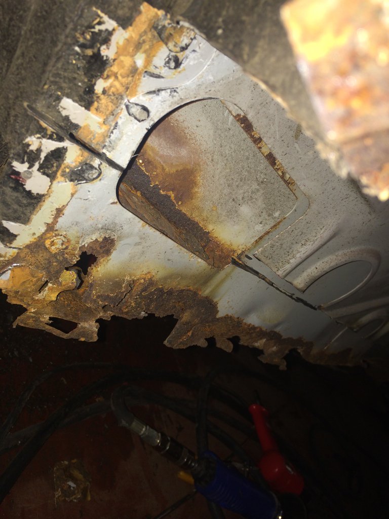

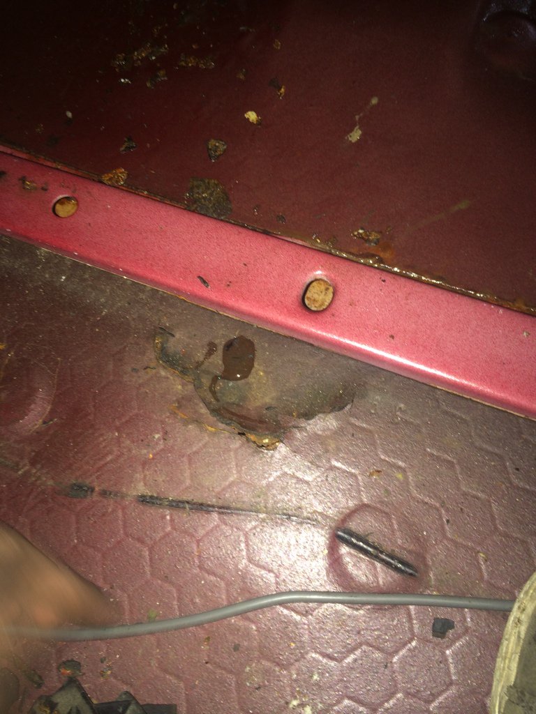

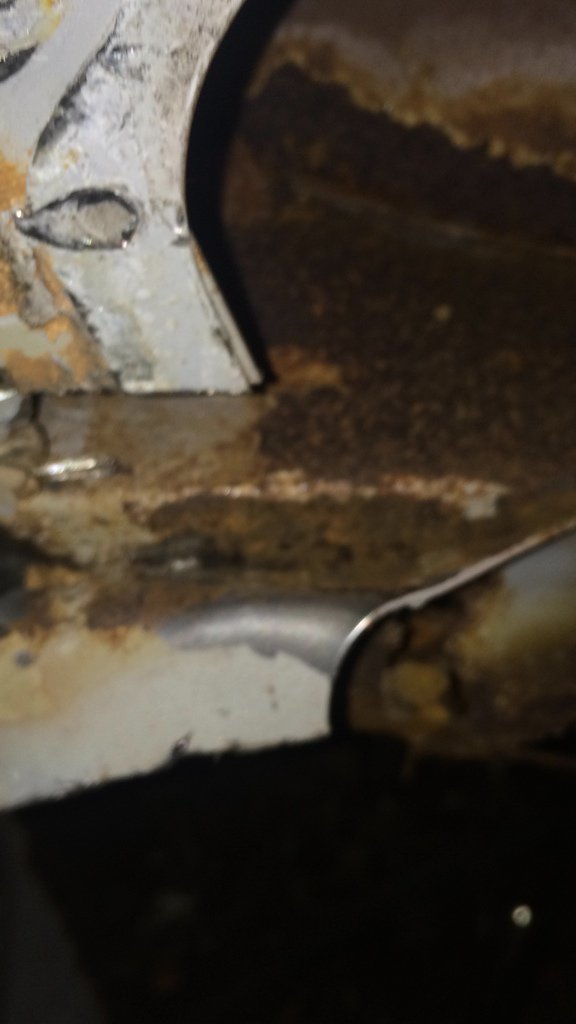

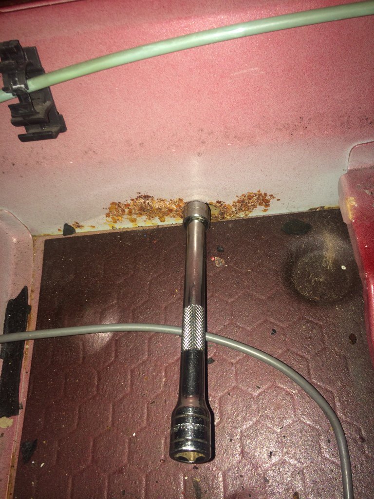

More rust was found, again, not all that bad IMO. I've seen worse on newer cars that haven't stood for circa 3 year
And how I left everything,
I need to go and get some quick release couplings for my air hose as they didn't send me none. So will try get something done later and update :)

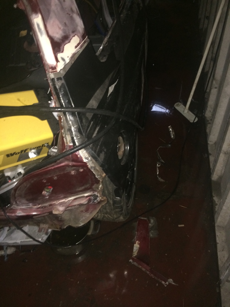

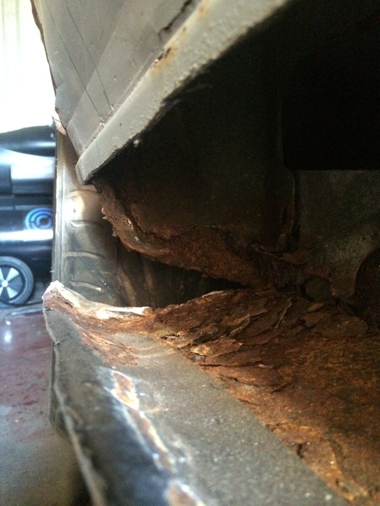

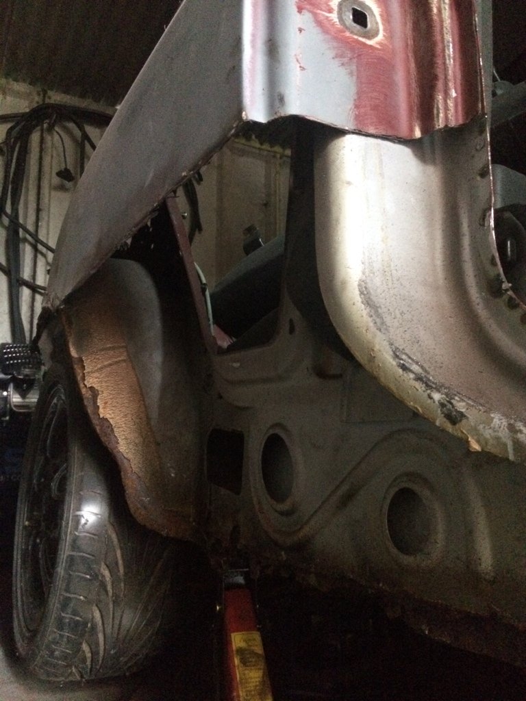

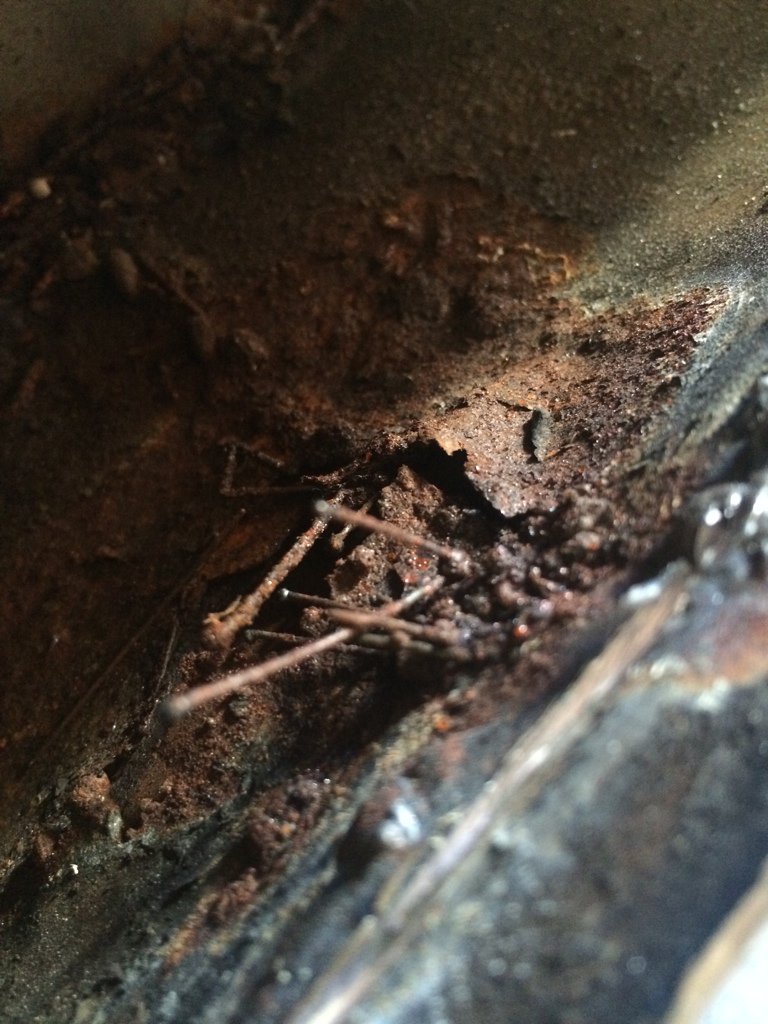

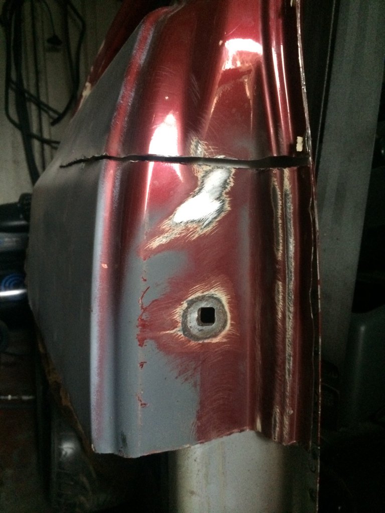

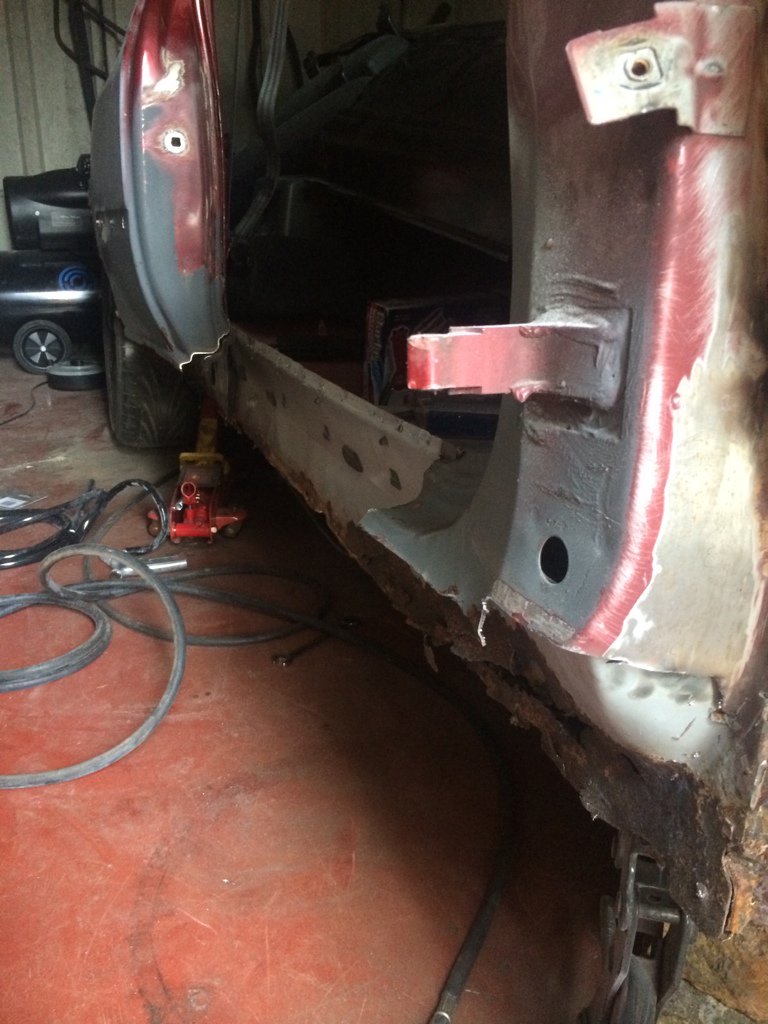

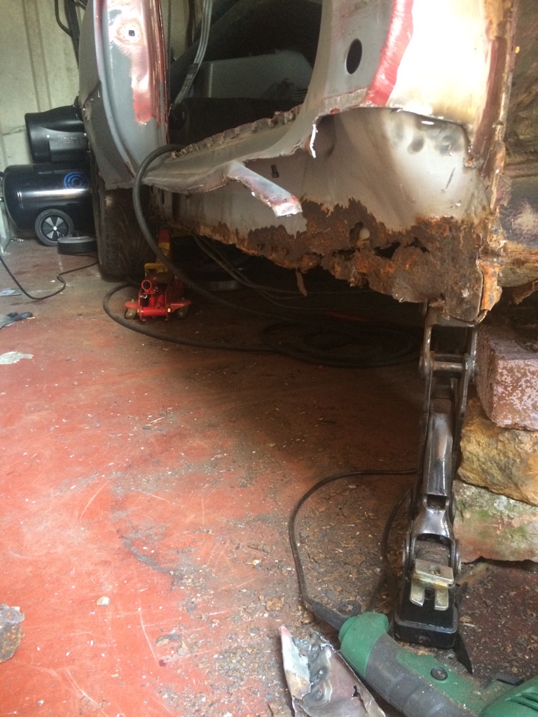

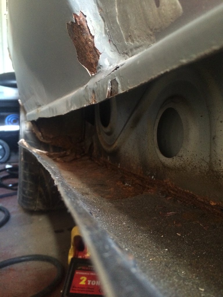

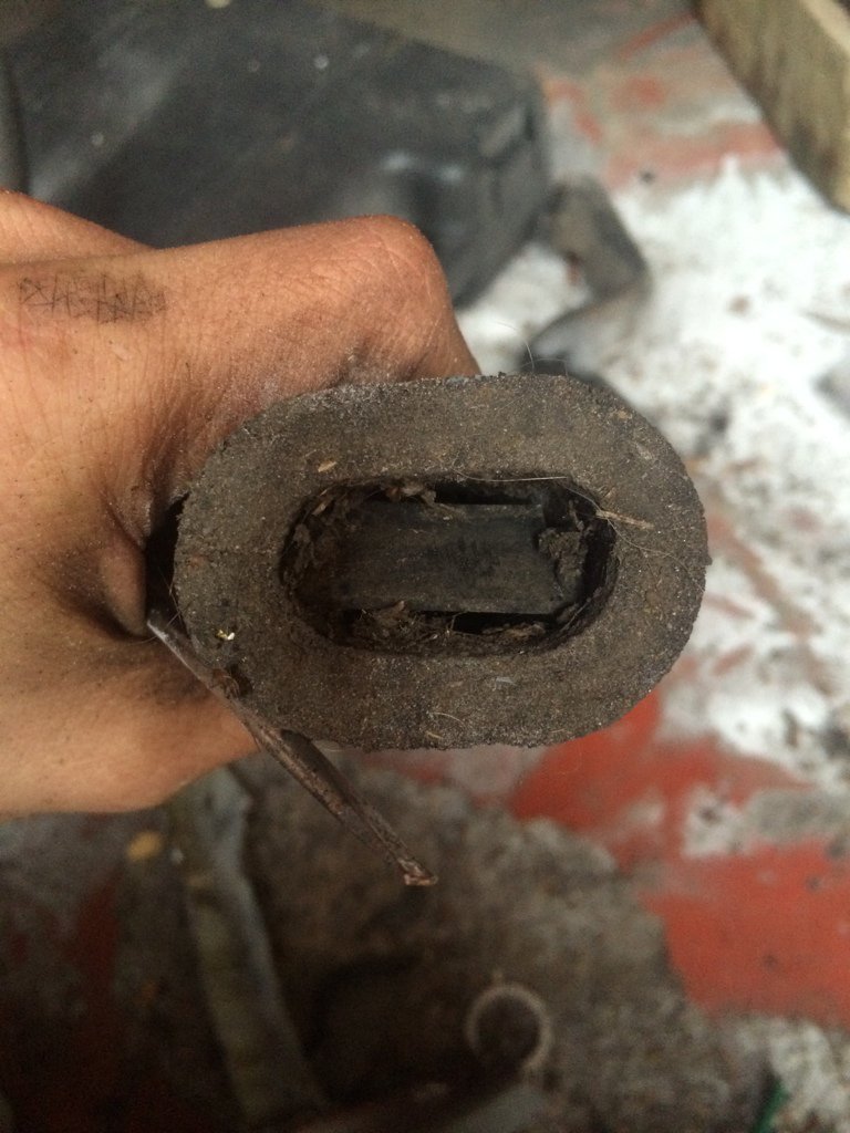

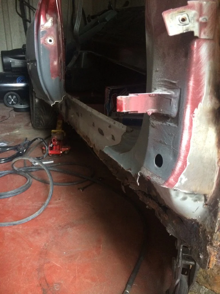

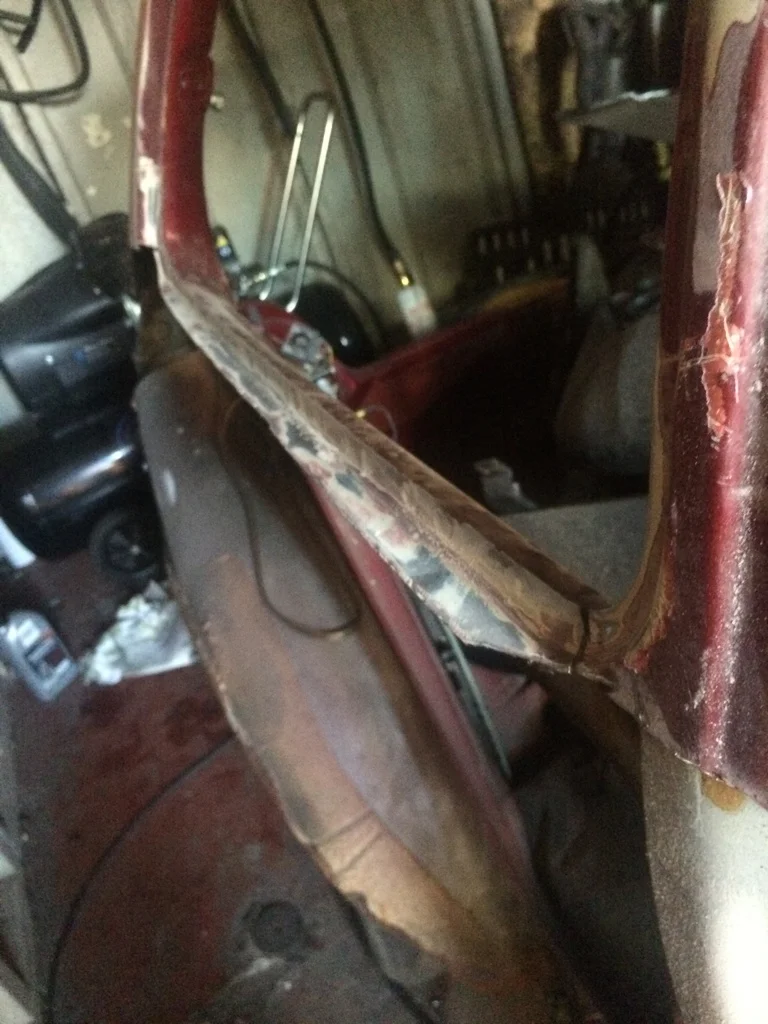

Not a lot has happened today, although I've got the drivers side sill off... Partially anyway lol. Was well confused as they're were 2 sill skins (outer sills)
peeled that back and it's Naples underneath lol. A very very bodged repair.
Evidence of too fast wire speed LOL
And it had only 2 spot welds along the bottom!
But it looks like this now
More tomorrow!

My battery had dies yesterday so didn't have photos of the sill removed. So here's a pic

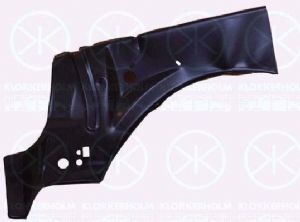

I need to do some fabrication for the inner sill and I'm going to order 2 inner wheel arches
Also ordered a pair of front inner wings too
a 3 week wait for them though as the supplier (carz2) had to order them from Klokkerholm.

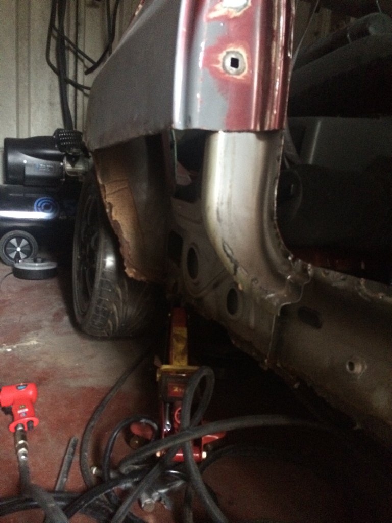

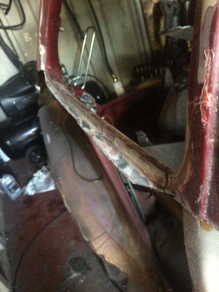

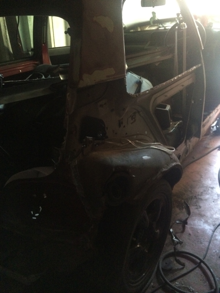

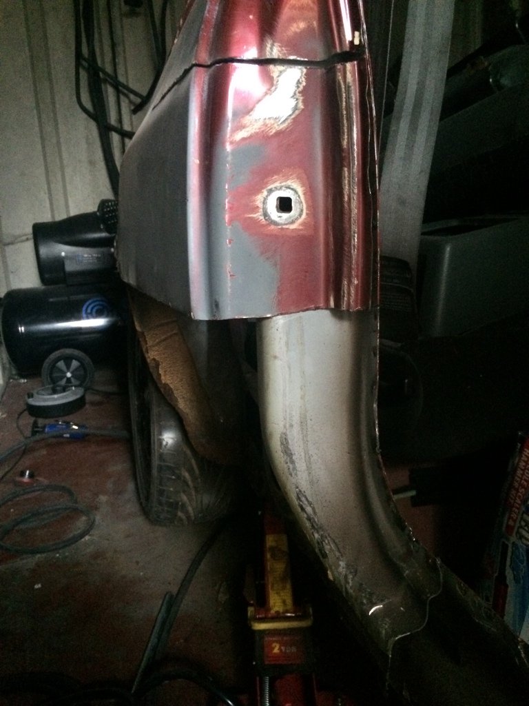

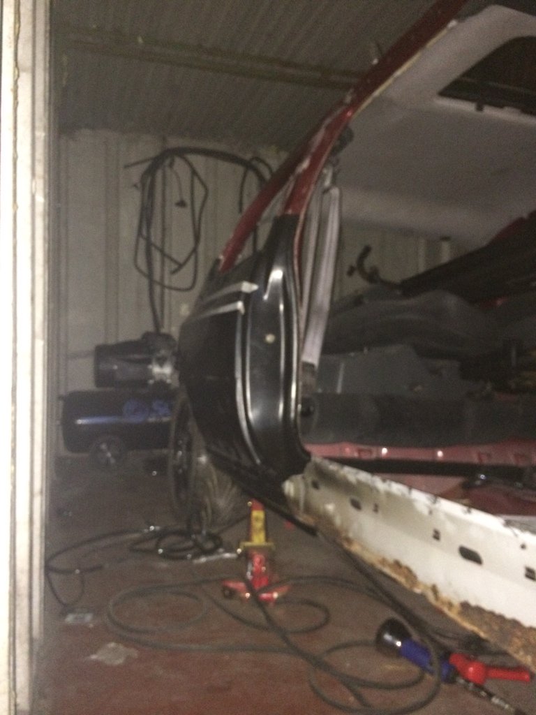

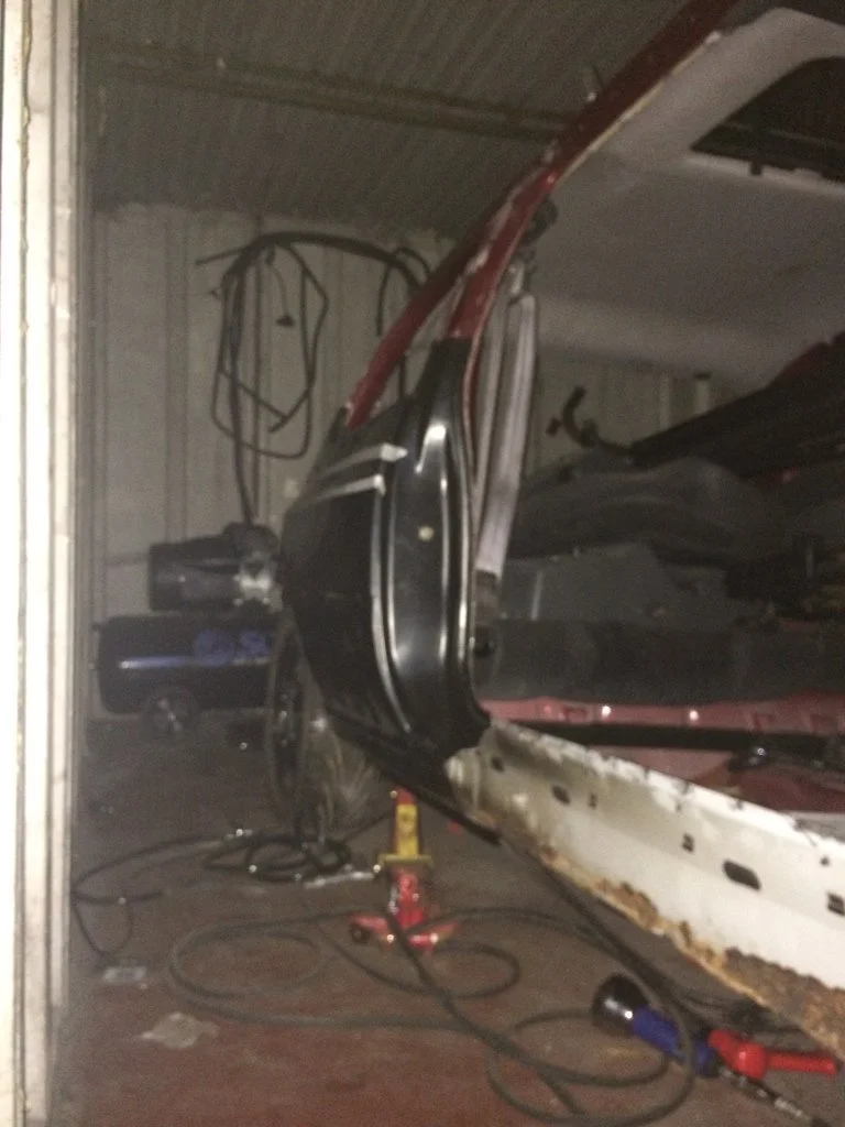

Okay... So today this is what I've done.
Started removing what's left of the sill
I did it bit by bit so I didn't cut it too short. Takes a little longer than it probably should but I'd rather not rush having not done anybody work in a year or 2

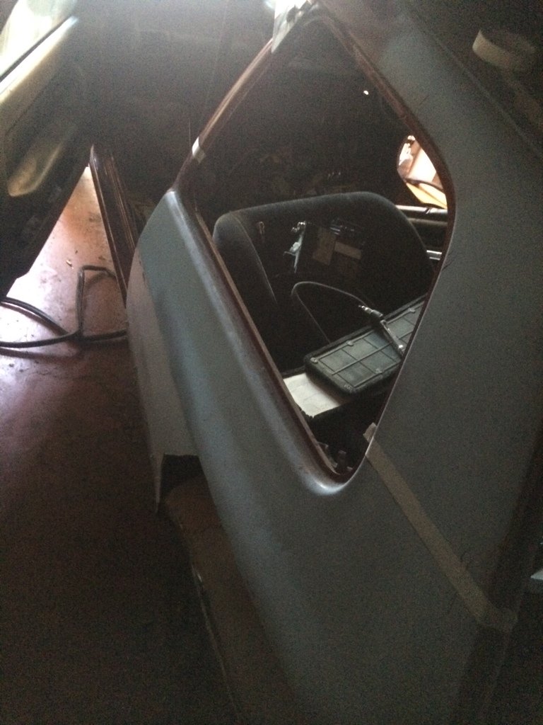

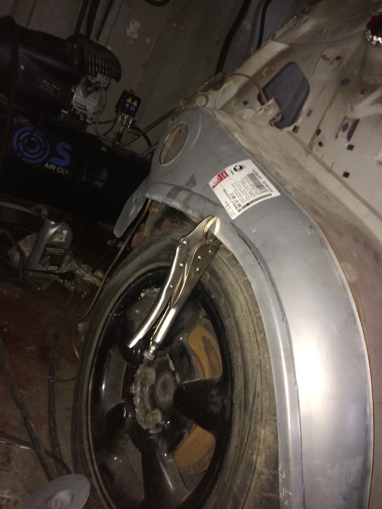

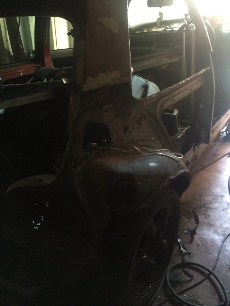

Removed the rear quarter, again bit by bit
And test fitted the new wing (I know it's not as flared as it should be yet but I'd rather have the shell ready for it to go straight on once it's done
Going to do the other side tomorrow, now I've got the "feel for it" back it will (probably lol) take me half the time than what today did

Not been able to do much the past few days, however yesterday I did get a bit ore if the rear quarter off
Now when the new panel is offered to the car it matches up perfect! And all those people saying I'd have problems, I didn't have none, other than stumbling across more rain lol.

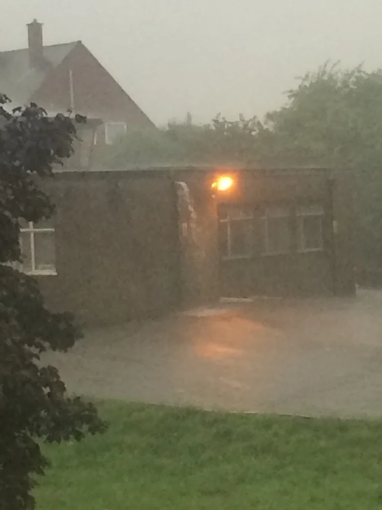

But today a problem arose :(

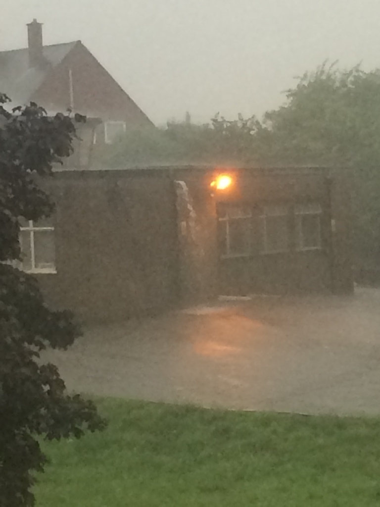

We live in a high area so the rain hits us hard, and with how it's came down today it flooded everywhere
I think I noticed just in time to be able to put my welder and other stuff into the boot of the car, but the nozzle of my welder was in water, the welder itself wasn't as it's on wheels so luckily it cleared the water, I don't leave wire in the welder when it's not been used so hopefully it should dry out okay :fingers crossed:
If the weather is decent tomorrow I'll have to resort through the garage and check everything is okay

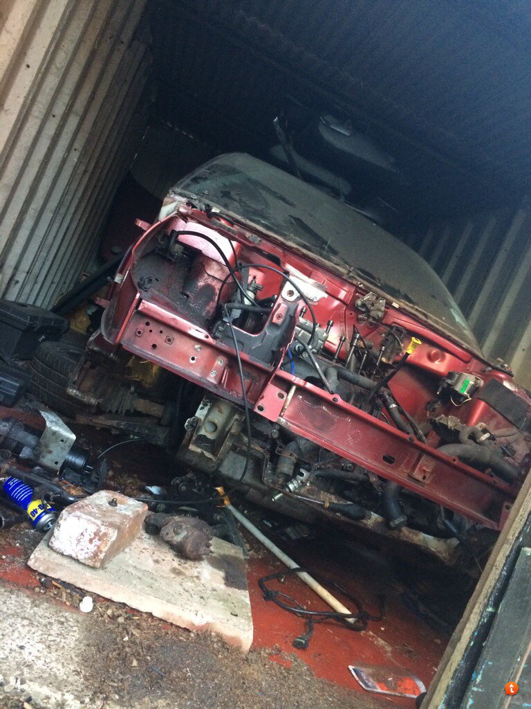

  X2 Clio Valvers

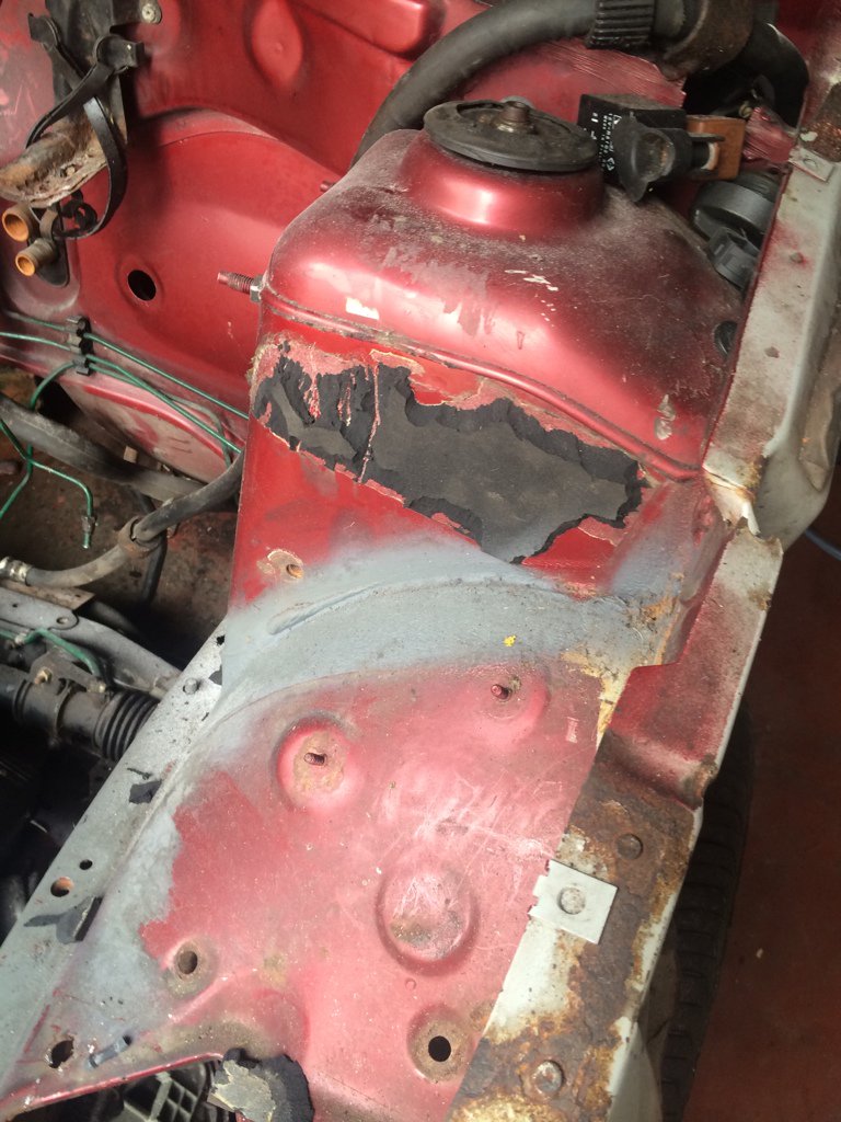

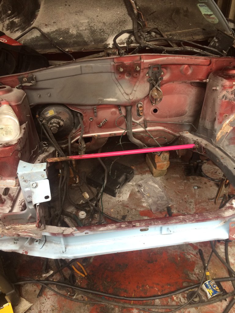

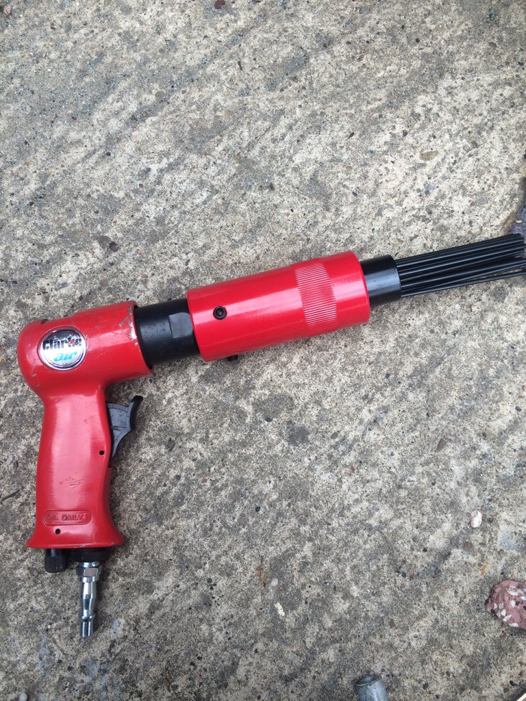

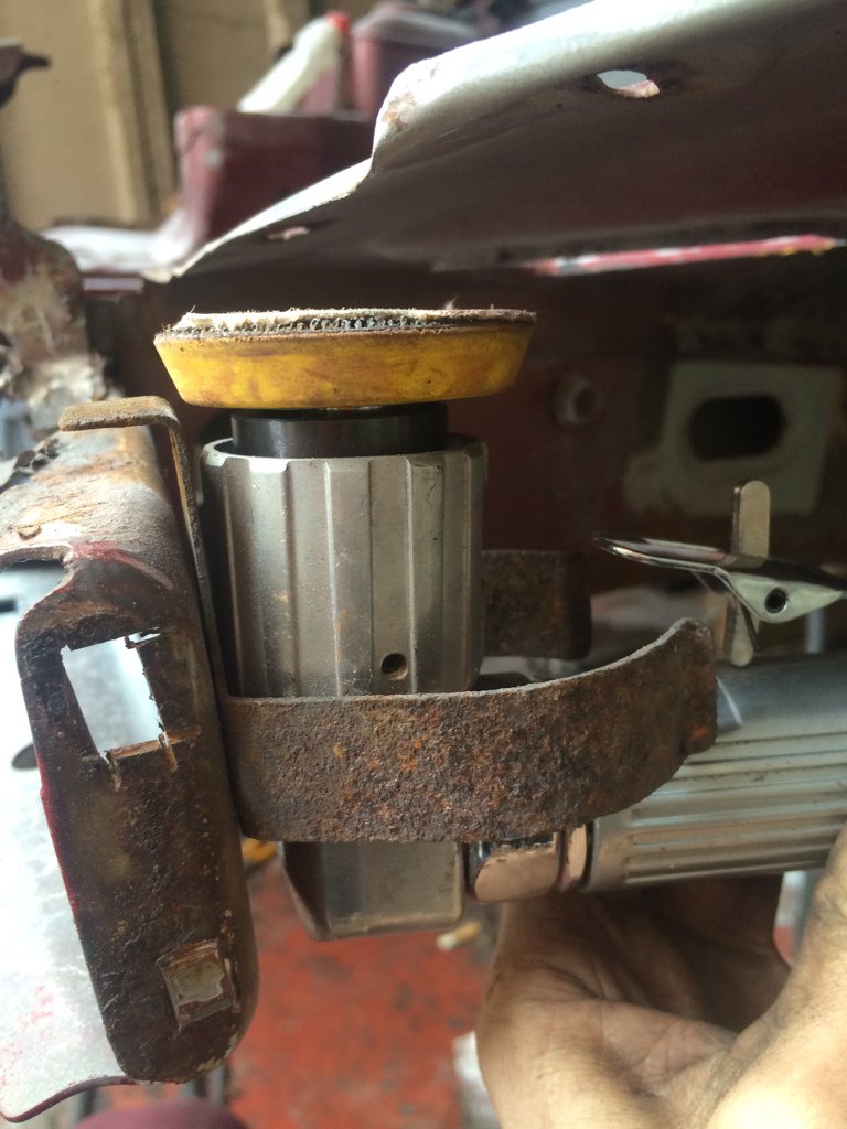

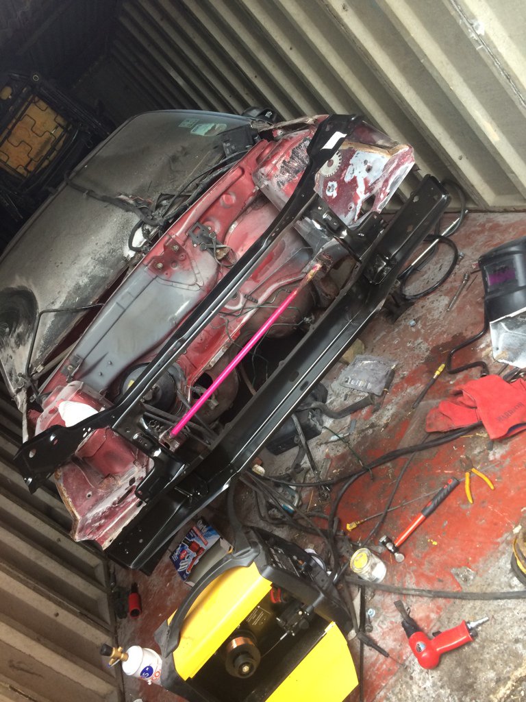

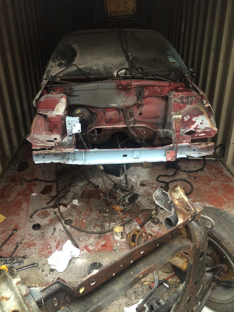

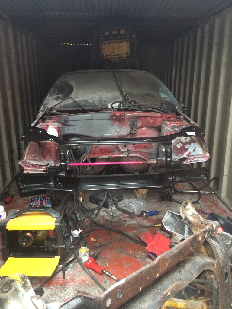

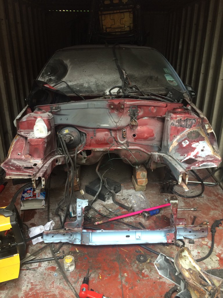

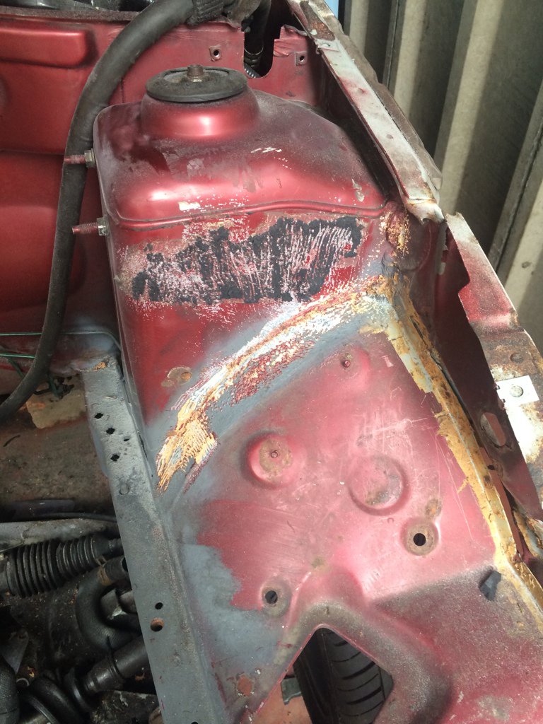

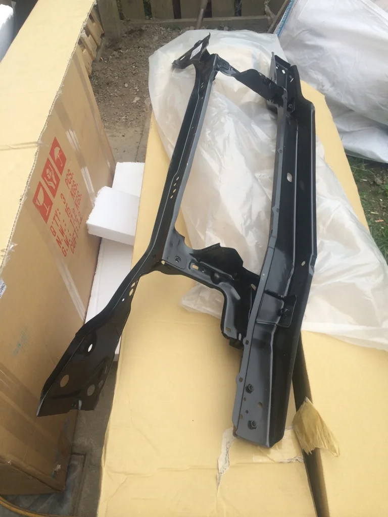

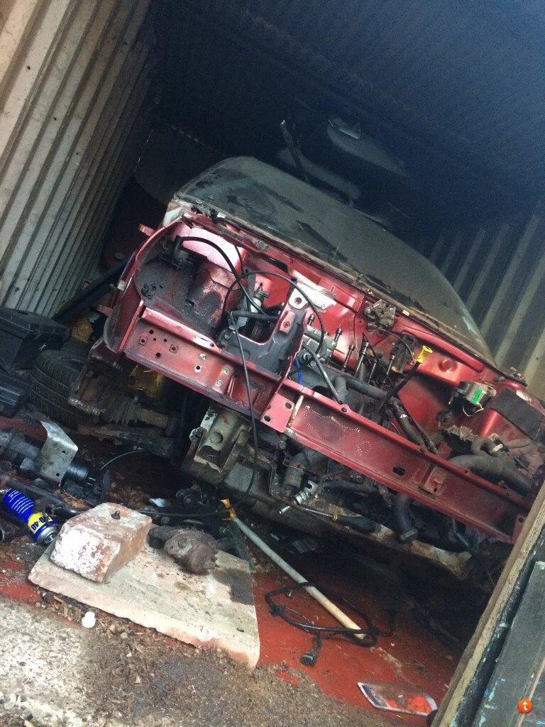

Been doing a bit of work on the car today, managed to remove the front panel and test fit the new one. Was going to sandblast the engine bay too but I'm going to leave it until I get a sealed gazebo
This came in handy for getting rid of the seam sealer in the hard to reach areas

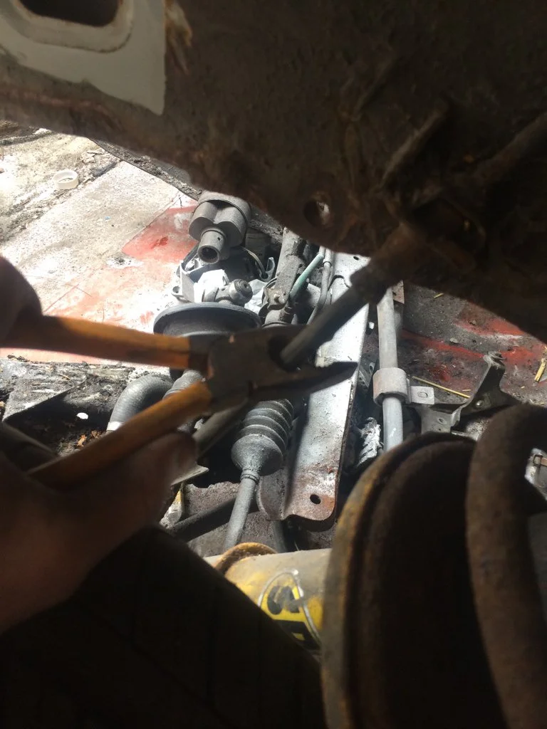

Removed the subframe and all attached bits
Brake hose nut was dead tight, so had to snip the tw@ lol
Salvaged an old mop stick to retain some stiffness lol

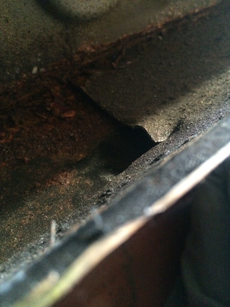

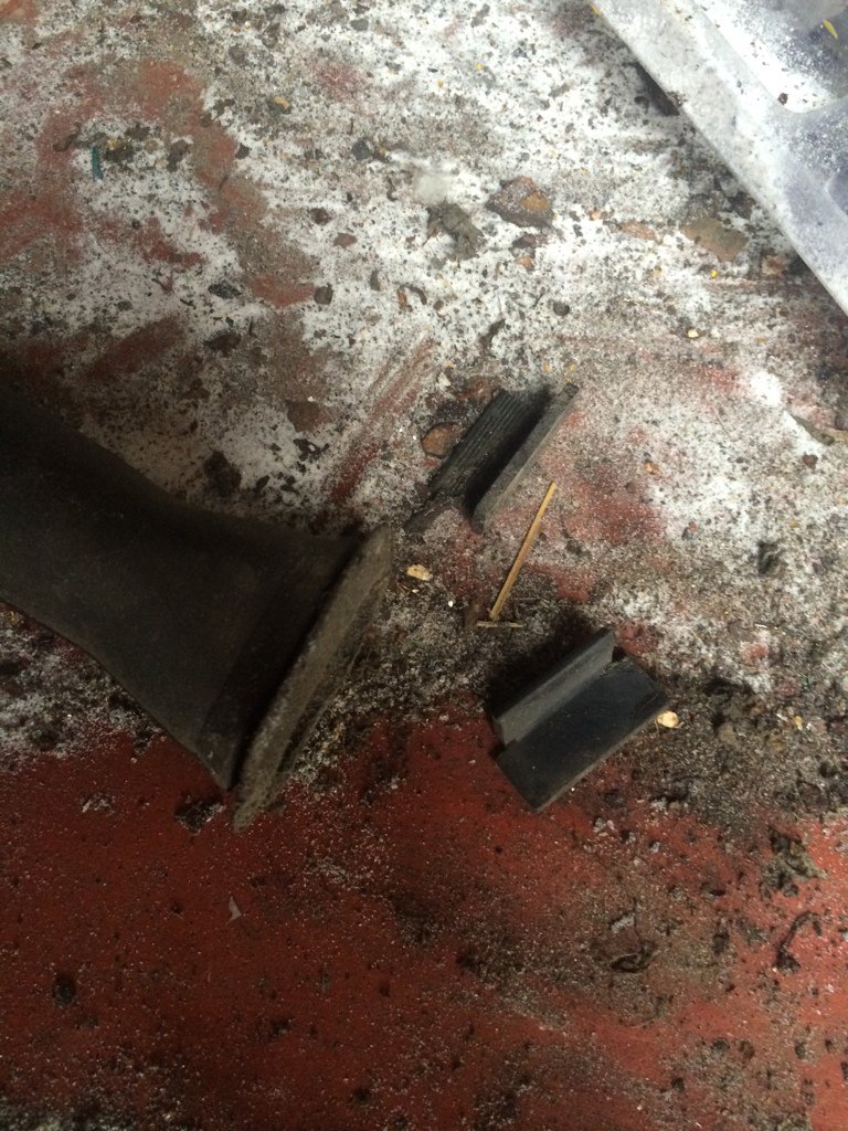

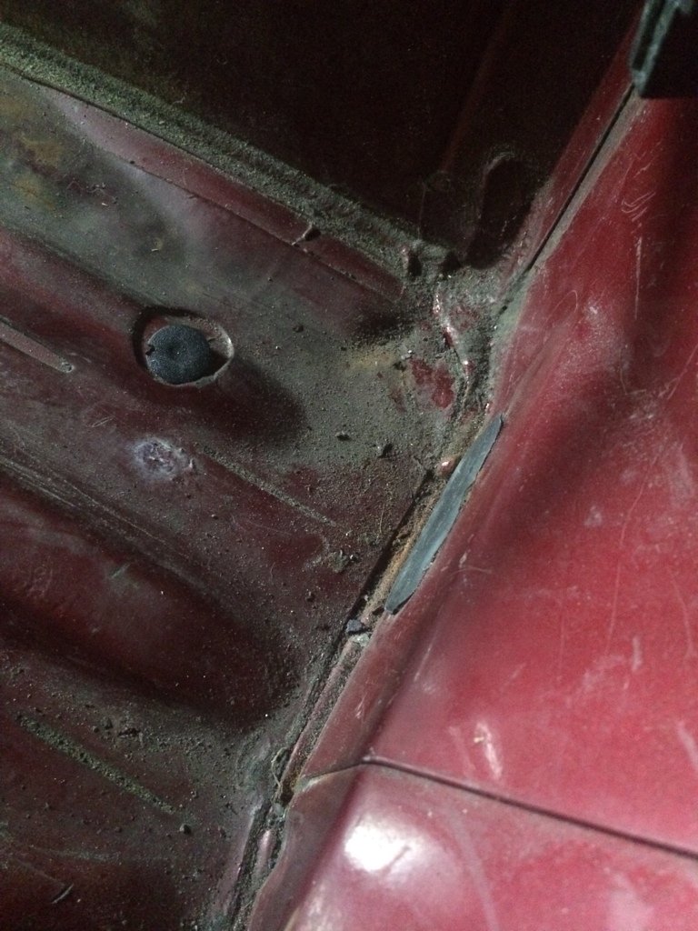

Always wondered why my scuttle would fill with water haha
that's one way to gain access from underneath with a sander lol

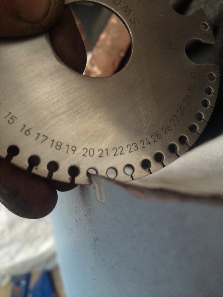

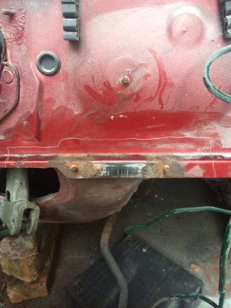

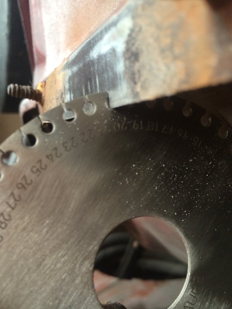

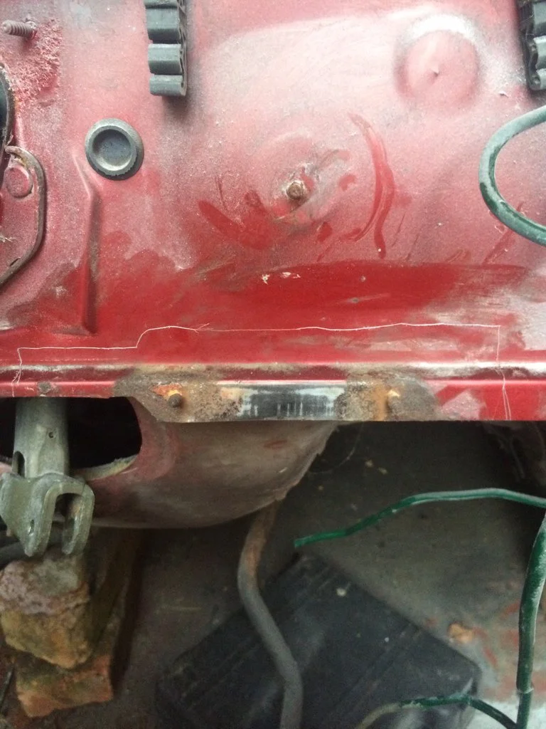

a rust patch was found, gauged up
A bit of the old quarter panel is the same gague :) waste not want not lol
marked ready for cutting out (line is shabby, I'll cut it straight and weld it better lol)
removed old front panel (forgot I'd not tacked the bar in place lol!
new front panel offered up to the car ( still need to cut some out for the removable slam panel )
that's it for today I'm afraid. My front inner wings should be here this week, so will be able to progress a bit more then. Also decided I'm buying new tools as some have been "borrowed" fml... Lol

How come you cut the rear quarters so high up - past the shoulder line of the arch? That is the part that governs the valver wider rear arch.
Josh
  X2 Clio Valvers
Top work!
I have all this to come very soon once I have stripped it all down to a bare shell.
Josh
Thanks mate. It's all good fun lol.
And because it had rotted away along the bottom of the windows :( I was just going to patch it up but I'll feel better doing it all lol.

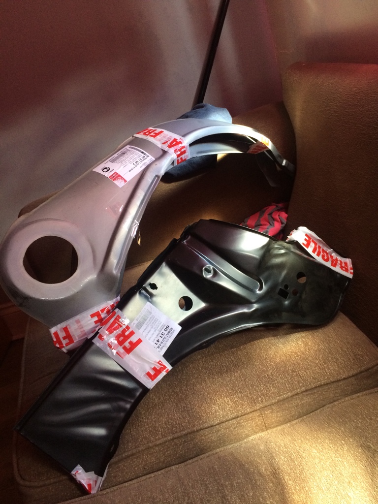

Got some more parts today
Front and rear inner wheel arches;
All marked today ready for cutting, then hopefully tomorrow I can get something done!
