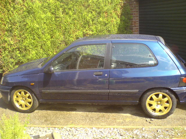

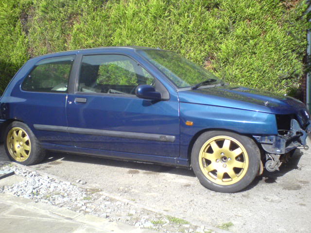

Right i was gonna wait until i had made further progress before posting this up but here it is anyway

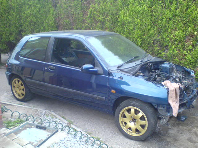

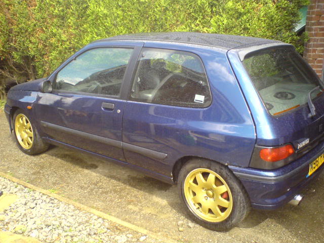

after having thoughts of selling my 106 for a faster motor i came to the decision of keeping my wee pug and buying a track/weekend toy that i could do up in my spare time. wasnt sure what i wanted but after coming back from FCS i knew i wanted a clio (especially after seeing northy and the yozzasport clio). so looked around and eventually found an M reg mk1 valver (williams replica, basically meaning it had some stickers and willy wheels :rolleyes: ) went to see it, looked in ok condition, non runner but i didnt mind as i had some 'plans' :evil: . borrowed my brother in laws van and a trailer and picked it up a week later, for the pricely sum of £280!
it had a near new ktec ss cat back and leather interior, plus the wheels so didnt think the price was too bad

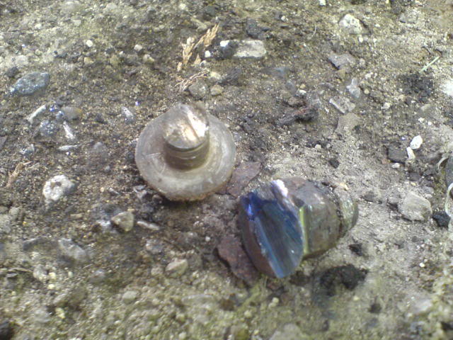

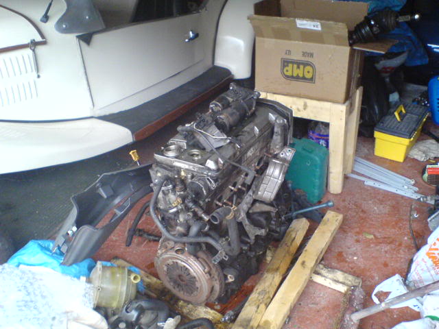

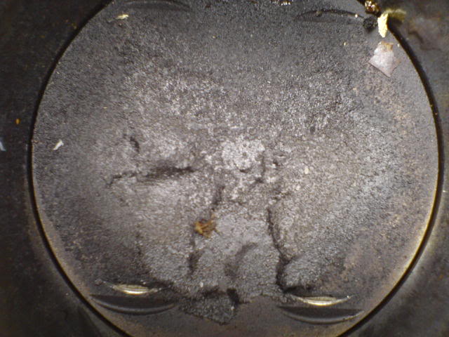

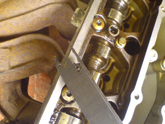

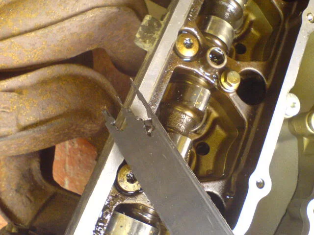

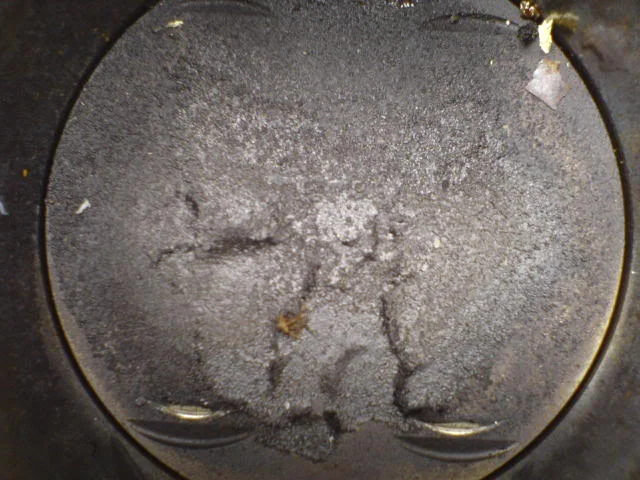

as soon as it got back i started diagnosing the running problem, soon became apparent that the cambelt had snapped so set about getting the engine out not long after
head off
the offending article
result

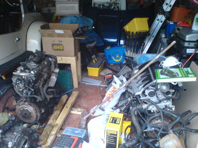

havent got an engine hoist and would be a while before i could get hold of one i resorted to taking the subframe off and dropping the botton end and gearbox out the bottom, but then my gf's neighbour said we could lift it out the top. i wasnt sure how much it weighed so was a bit reluctant but he talked me round to the idea :rolleyes: after about 15mins of finding a good grip and jacking it up as far as we could we man-handled it out of the car and into the garage
where it now rests

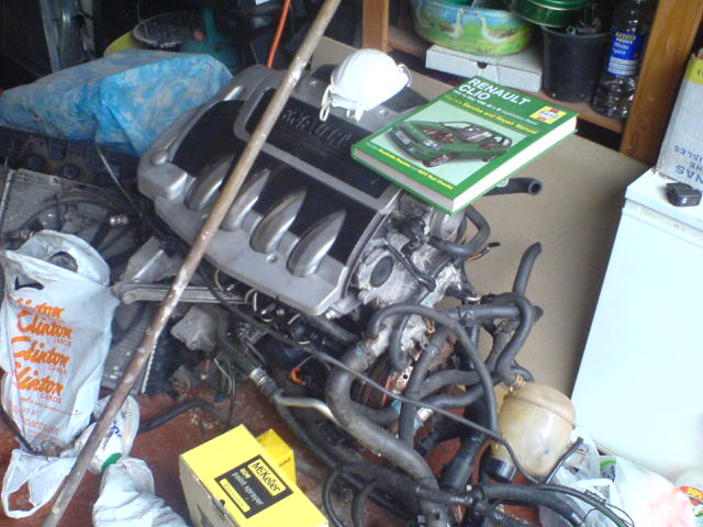

i toyed with the idea of a replacement f7r, but after seeing a few on here i decided on the f4r from a mk2 ph1. after a bit of waiting and searching one popped up on ebay for the right price. called in a favour from a mate with a wee trailer and away we went
where it currently sits
the tired valver lump has to sit opposite its younger replacement, cruel i know!

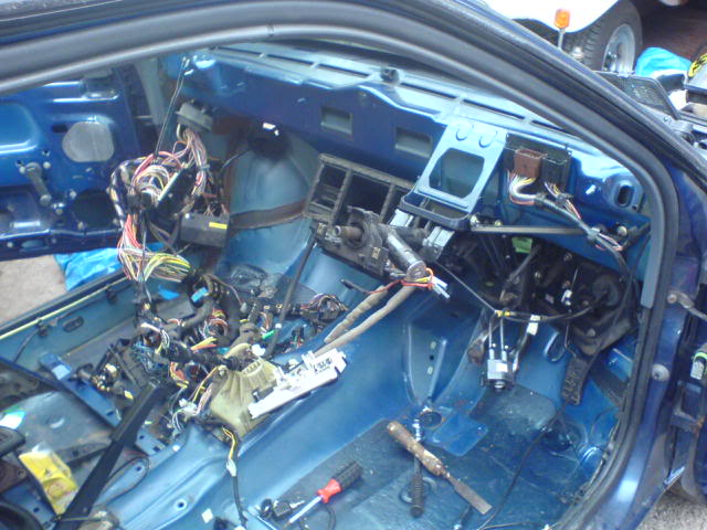

next i set about stripping the interior, helped by my gf (cheers hun) that didnt take long, and soon had a buyer for the leather interior and door cards which were taking up room in the garage
interior and dash out
although it is going to be a stripped track **** i decided to keep the heater, not cos of the cold, but because of people i know who have had major problems with demisting!

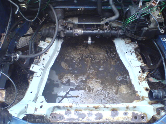

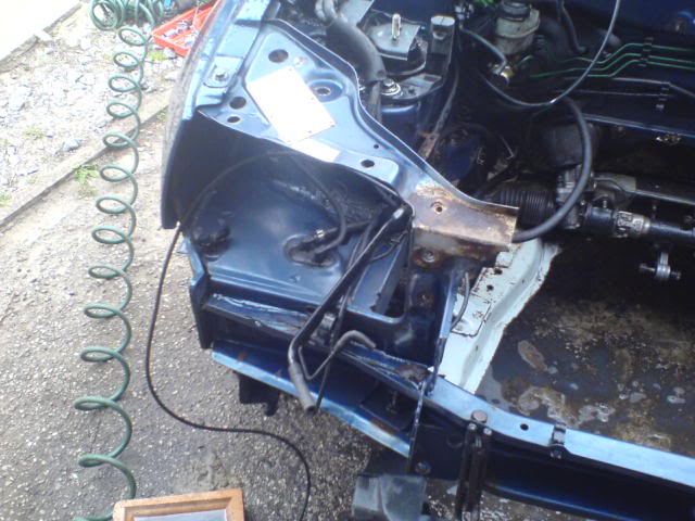

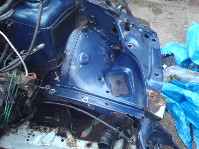

bought a tin of GUNK and let it loose on the engine bay area, have to say this stuff is top notch and will be using it again

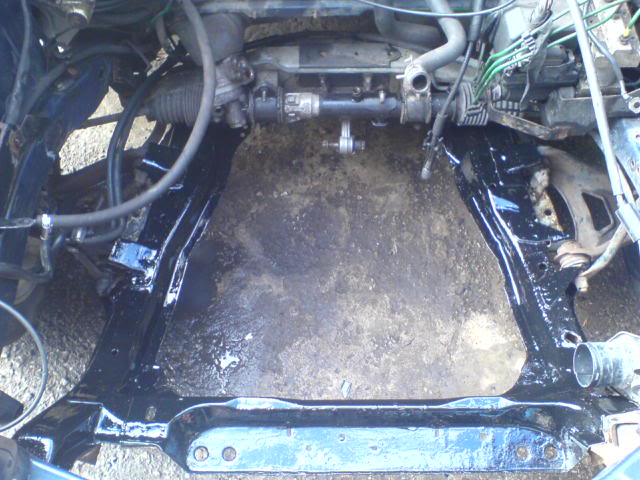

subframe with all the crap removed
nice and clean
my mate is doing his own saxo track car and after seeing his i was expecting some rust when all the dirt was removed. needless to say i was pleased to see there wasnt anything to worry about :)
got the hammerite out and gave the subframe a lick of paint

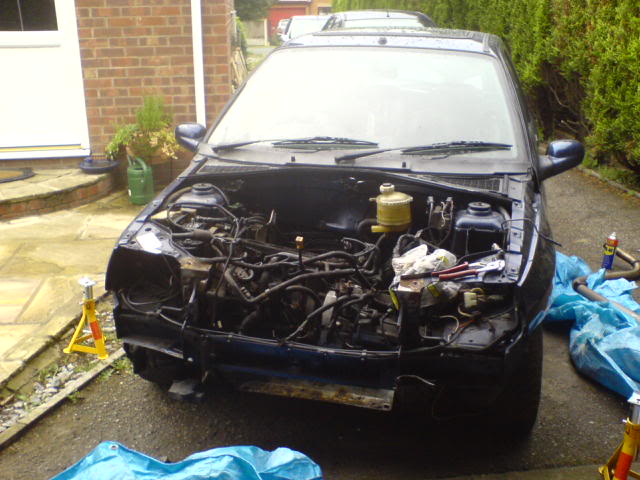

then the gf's parents were understandably sick of seeing the clio with a tarpaulin (sp?) over the engine bay

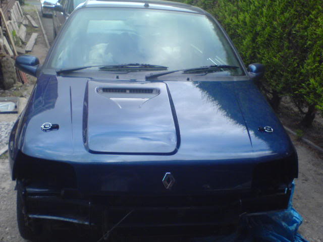

so i got some bonnet pins so that i can remove it quickly when wanting to work on it
her parents are happy and it saves me a job in the future :D

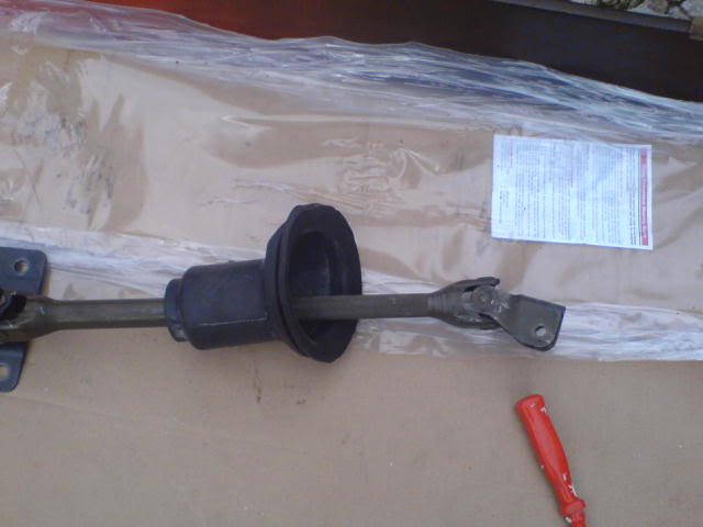

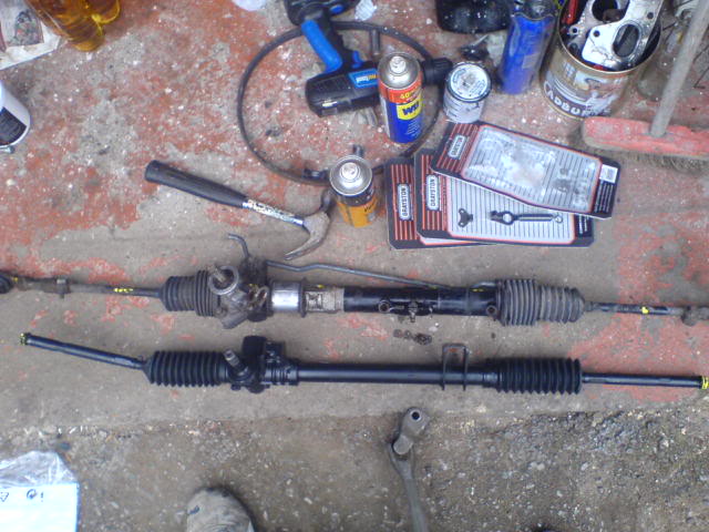

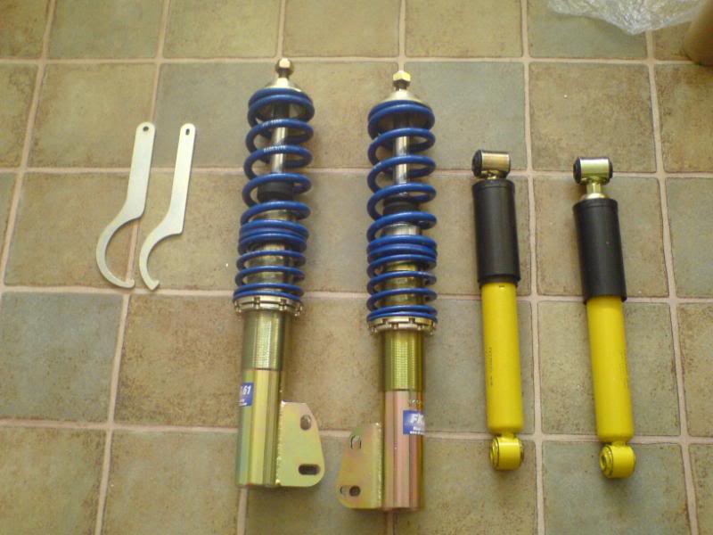

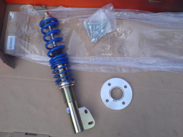

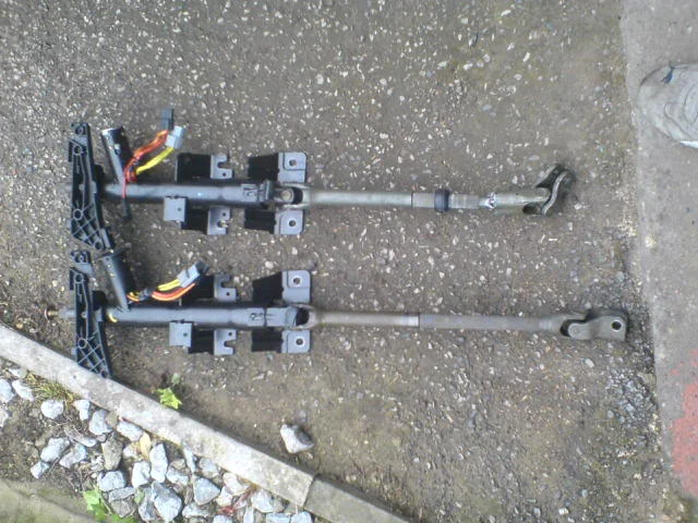

next i set about fitting the coilovers and steering rack and column. the ride height after the engine came out was shockingly high and was depressing me to look at (i like low cars:evil: )
had to get these out of the box and take a piccie
waiting to go on along with spacer
old and new rack

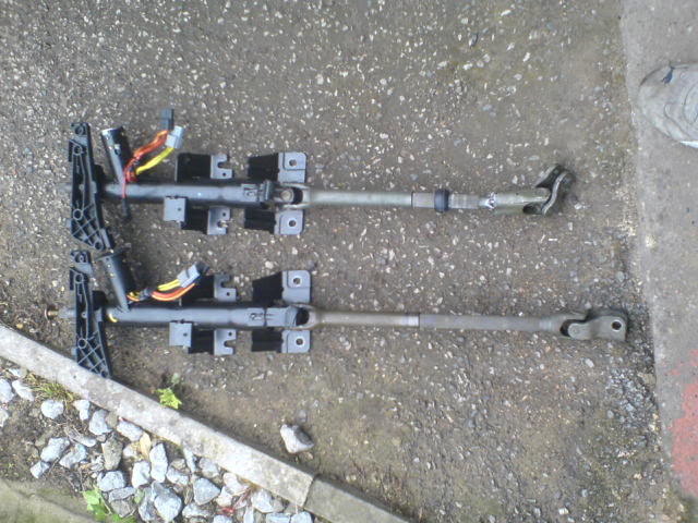

old and new column (notice the difference in length)
my apprentice technician inspected the new column and gave the go ahead (sadly he didnt stick around as apparently chasing flies is more interesting than helping your dad with the car:rolleyes: )
this rubber gaiter tested my patience, but i won in the end

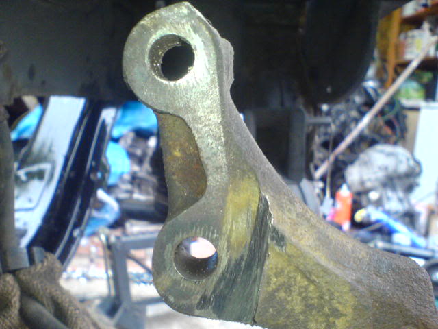

got the grinder on the hubs to aid camber adjustment although i may need to take a bit more off, depends what the camber reads as it is
while i was there i fitted my new bottom ball joints, a couple of the bolts were playing tough guys, so out came the grinder again
ahhh thats better
just the back to sort next weekend

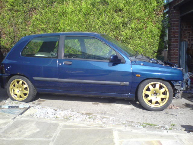

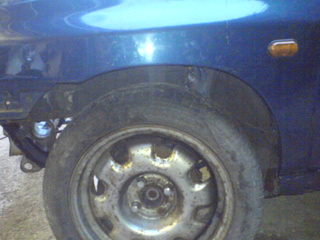

Great stuff although when you put the engine in the arches will sit on the tyres at that height!!
yeh i just left them at what they were set at in the box, were around half way so wasnt sure whether it would be too high or low
will adjust them when the time comes :)
