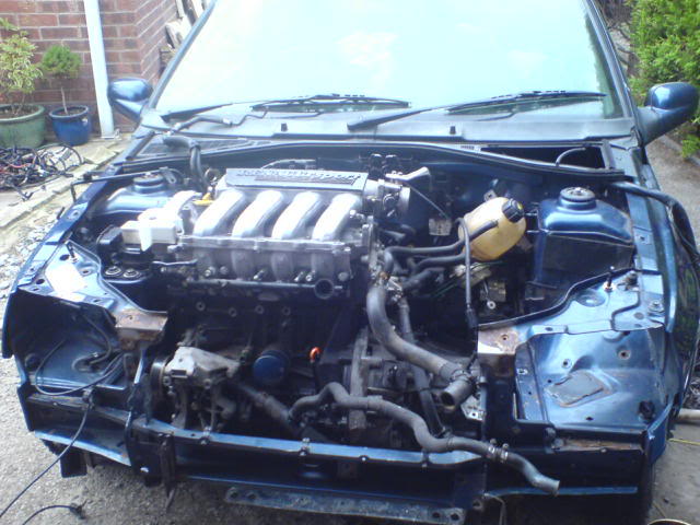

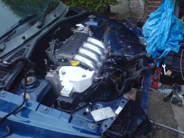

got my lower part of engine mount fitted, and i got my gearbox mount sorted, so the engine is all mounted up now

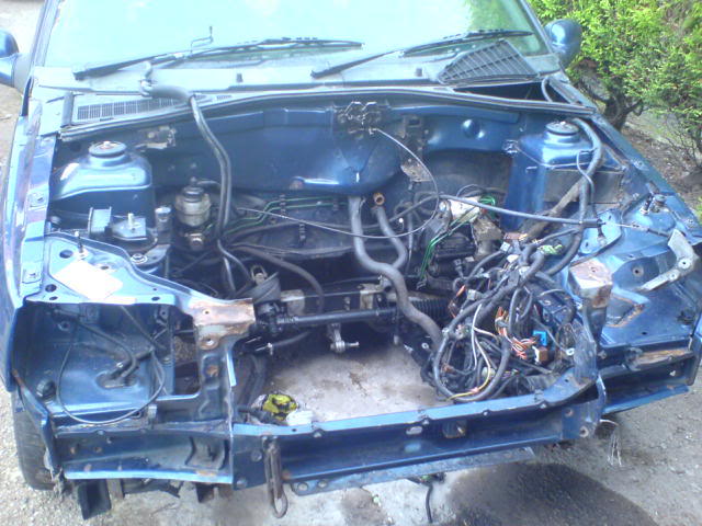

then turned my attention to the loom, started unpicking it and working out what plugs go where, but in doing this its become apparent that whatever scrap yard removed it got giddy with the side cutters :quiet: and the lad who used it before me has tried to rewire certain plugs. so i think its gonna be alot safer and easier to find another loom that hasnt had wires hacked! woohoo more expense i didnt need
