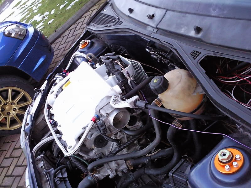

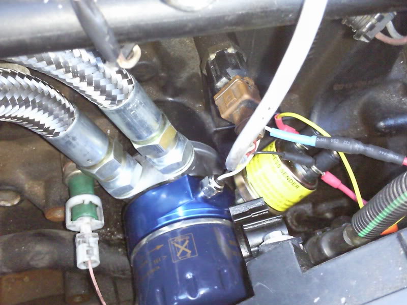

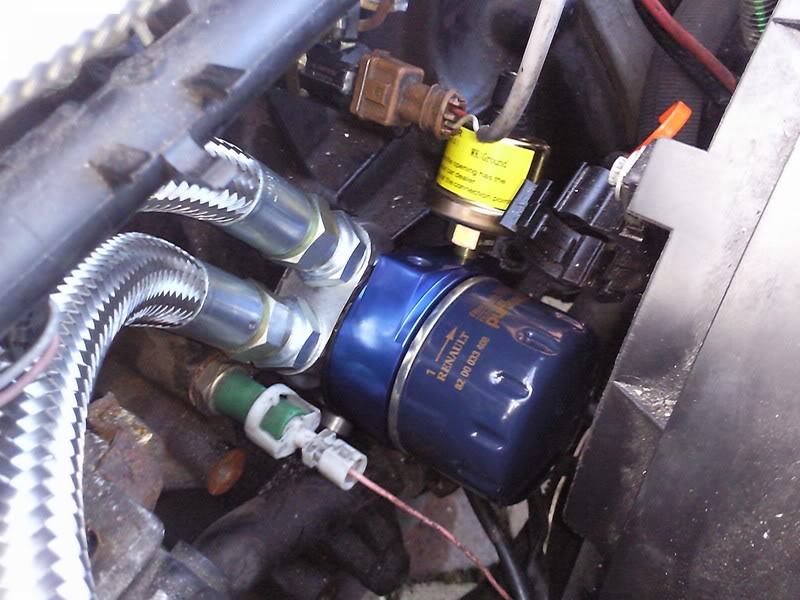

*btw i will be removing the coil pack plug and cranking the car over to make sure i have oil pressure (after fitting oil cooler) before firing it up properly* (handy little tip for anyone working on the oill system)
So I take it your hoping to get it on the track for '09 at somepoint![]()

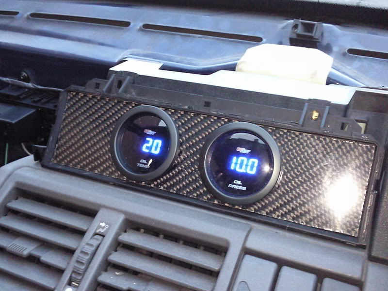

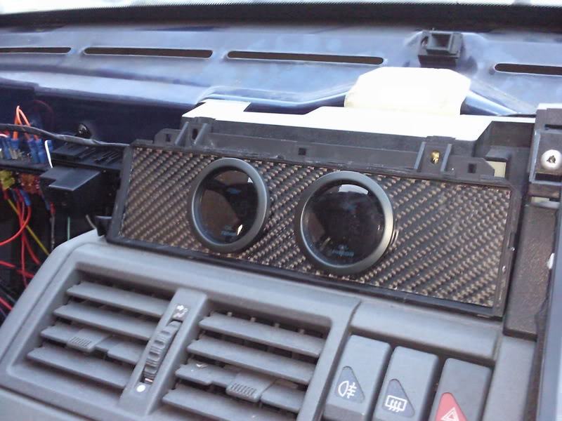

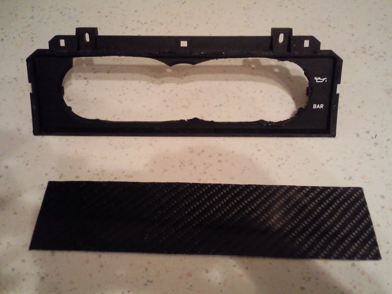

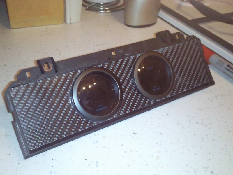

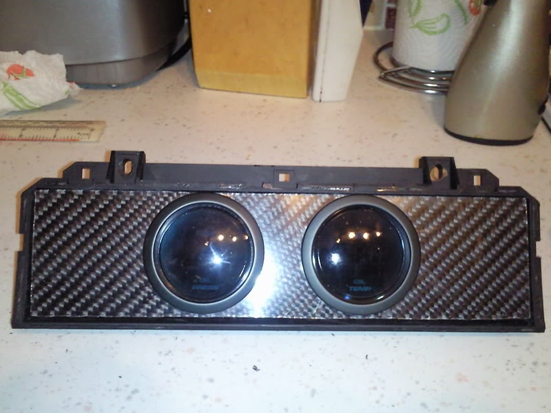

what's wrong with the original gauges that give you oil level as well?![]()
And by doing so you will fill the cylinders with un burnt fuel.
Id disconnect the crank sensor, that way you'd have no spark or injector pulse.

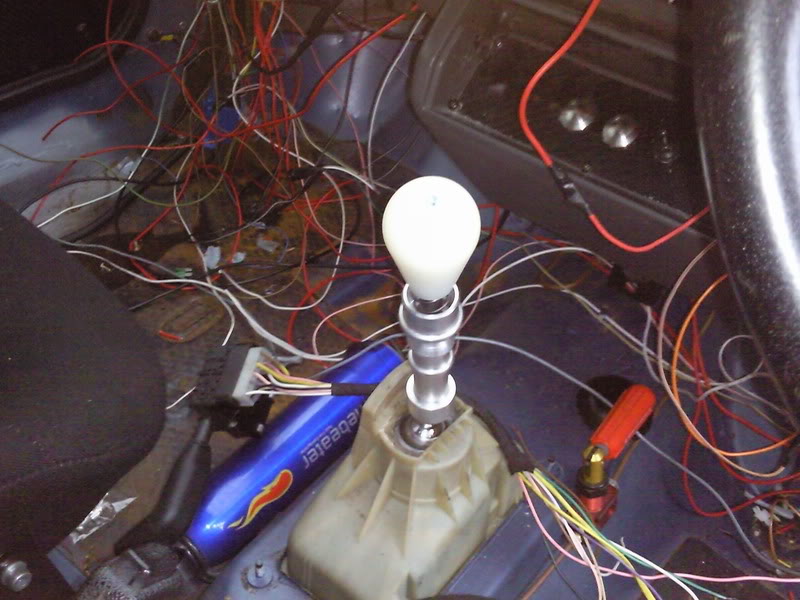

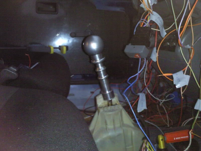

your wiring is![]()
