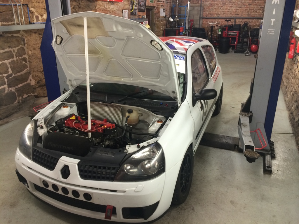

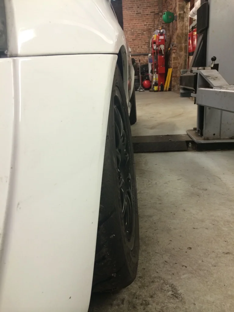

Well had the car on the ramp tonight to give it a thorough look over and spanner check, all is well. No signs if damages, nothing loose, broken or hanging off, can't believe it if I'm honest!

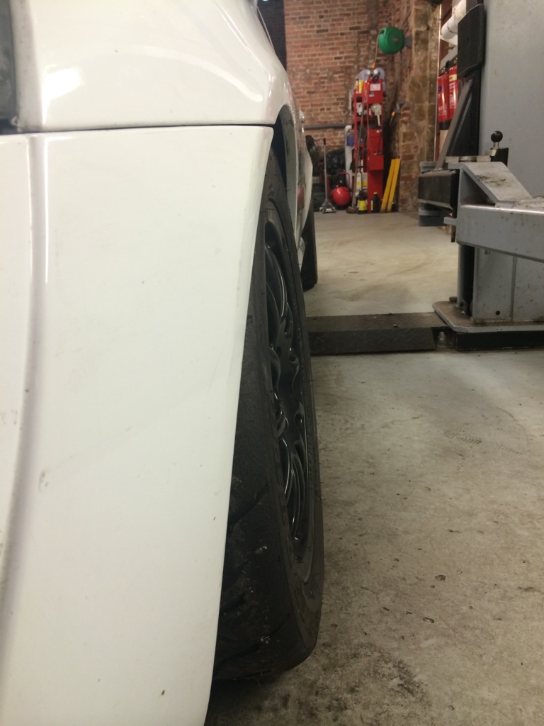

The only issue was the suspension geo had been understandably knocked out, was miles more camber on the n/s/f wheel and it was now towing in slightly.
Adjusted it all to the proper settings, or at least as close as possible using the camber gauge and tracking gauges.
All ready for oulton park now, just needs a proper wash and a good clean up before then as its filthy.

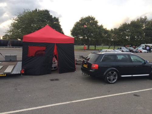

Got unpacked and setup @Tony Hunter is now my official shelter erector as its just impossible to do it on my own, cheers mate. Weather all good at this point, dry and bright. Got @khj100 's 200 unloaded and setup up too while he made the long trip up from brighton.

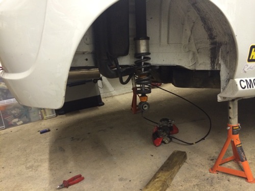

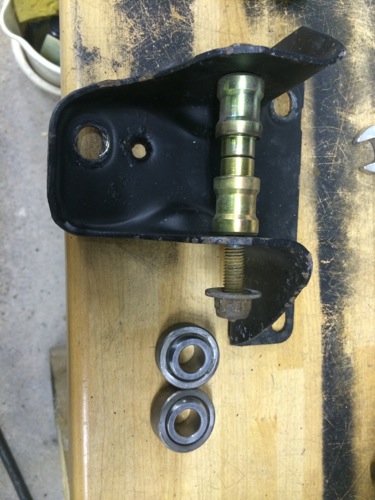

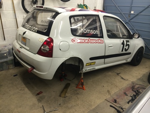

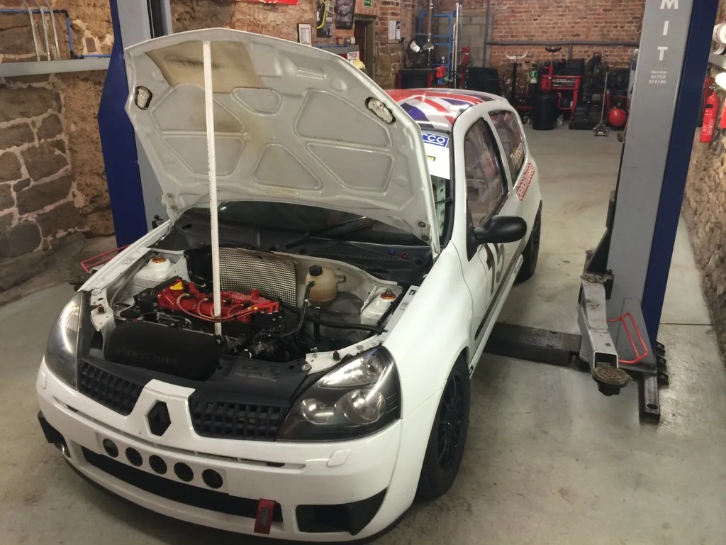

Well im not messing around, clio is in bits already. Removed the rear beam tonight as theres play in the bearings where the beam mounts to the car so thats a job to sort before i do anything else.
Got a list to work through that includes going through all the suspension and brakes, new front subframe, new driveshafts, engine and box out, box and diff to be checked, engine stripped and head sent to have valve stem oil seals done, newclutch and flywheel, some wiring to be tidying up and some paint to do.

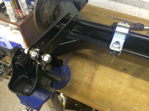

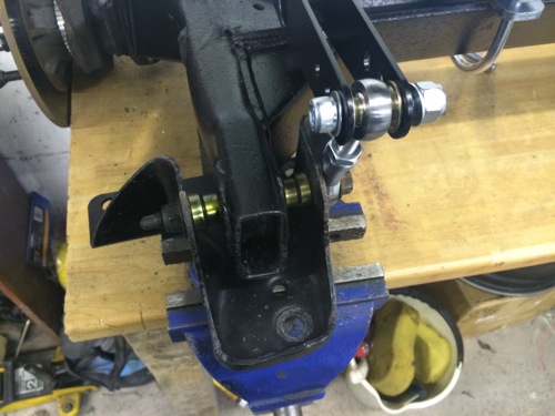

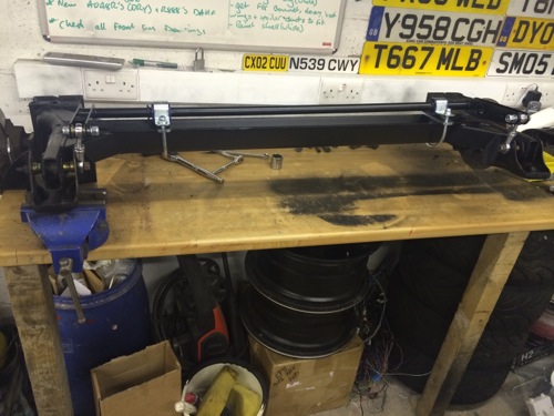

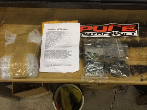

Been getting on with the beam this week, had a parcel arrive from Nick at Pure Motorsport,
comprising the replacement rear beam bearings and circlips. Also ordered their subframe repair washer kit for the wishbone mounts on the new subframe, going to try and strengthen it where possible so thought these made sense too.
Gave the beam a quick coat of satin black, after fitting the bearings, as it was chipped to hell after x2 gravel trap visits at Donny earlier in the season too.

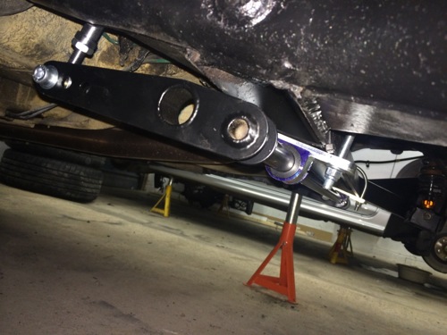

You might notice one of PMS's new rear ARB's attached to the beam as well, should be a bit stiffer than the whiteline that has come off so will aid me in my quest for a quicker turn in before i consider even stiffer springs in the rear. Really nice bit of kit as you'd expect, hopefully it'll perform just as well.

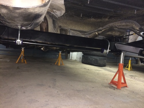

Got the beam back on the car, its probably the worst job on the whole car now as theres no getting around the fact its probably 50kg of awkwardness especially one your own.
It certainly looks better than the Whiteline once fitted as i think they look unsightly when following a WL equiped car as the bar hangs down the the drop links are visible, small potatoes probably but its a bit more out of the way from racetrack debris and gravel traps.
Ive ordered a new rear brake line for the osr calliper too as i wasnt happy with how id originally routed it, needed it to be a fair bit longer.
Gave the underside of the car a once over with some black stone guard to protect some bare metal that we welded last year and i never sorted + the aforementioned gravel rash.
