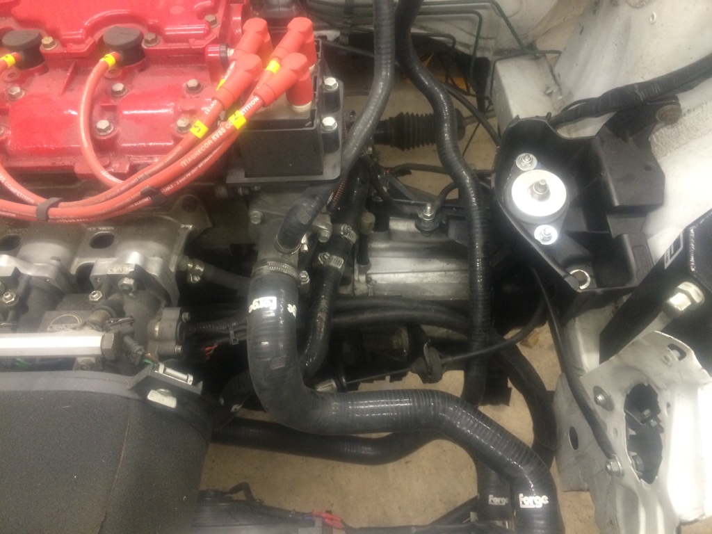

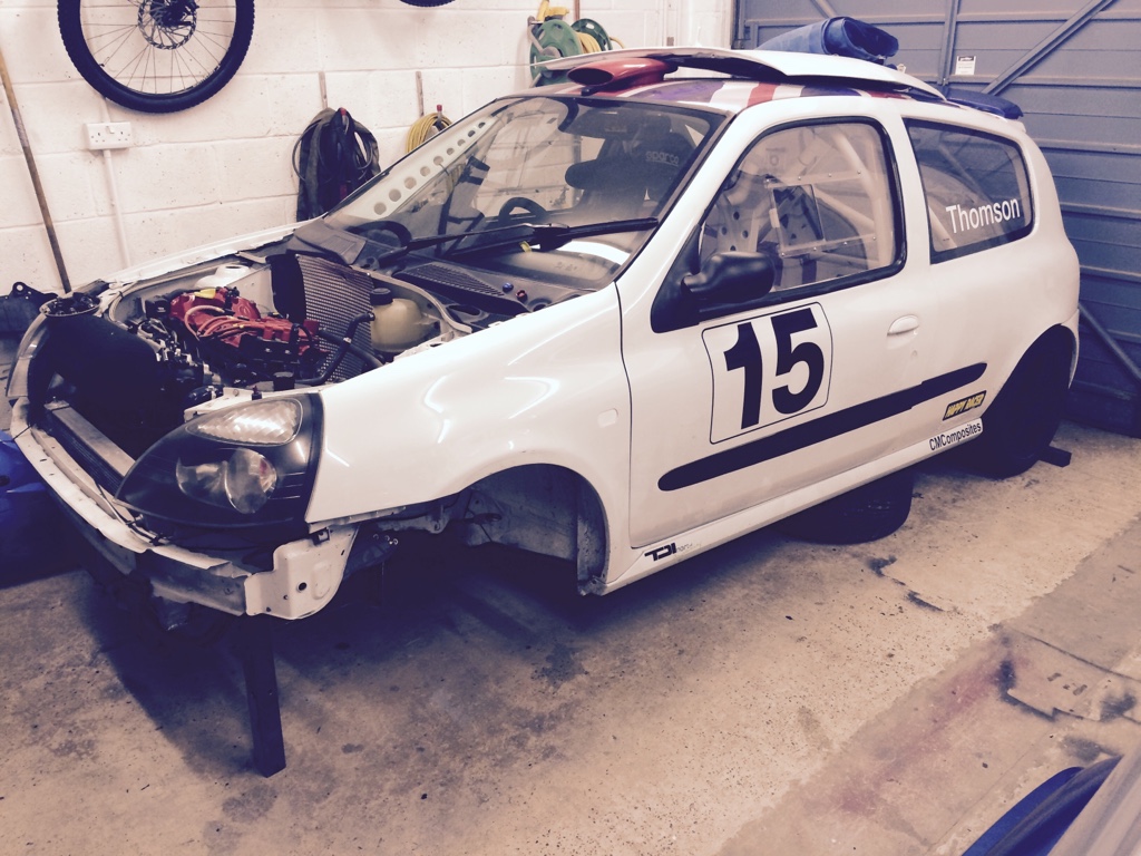

Not a lot going on really, just waiting on some parts coming to refresh the front suspension, a few bearings and new nuts and bolts etc.
subframe is off to have the wishbone mounts strengthened and some other mods to make the whole thing a bit more solid.

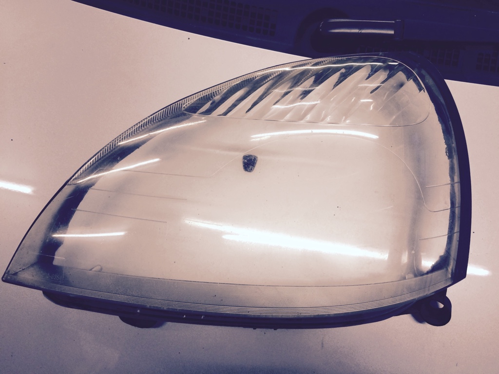

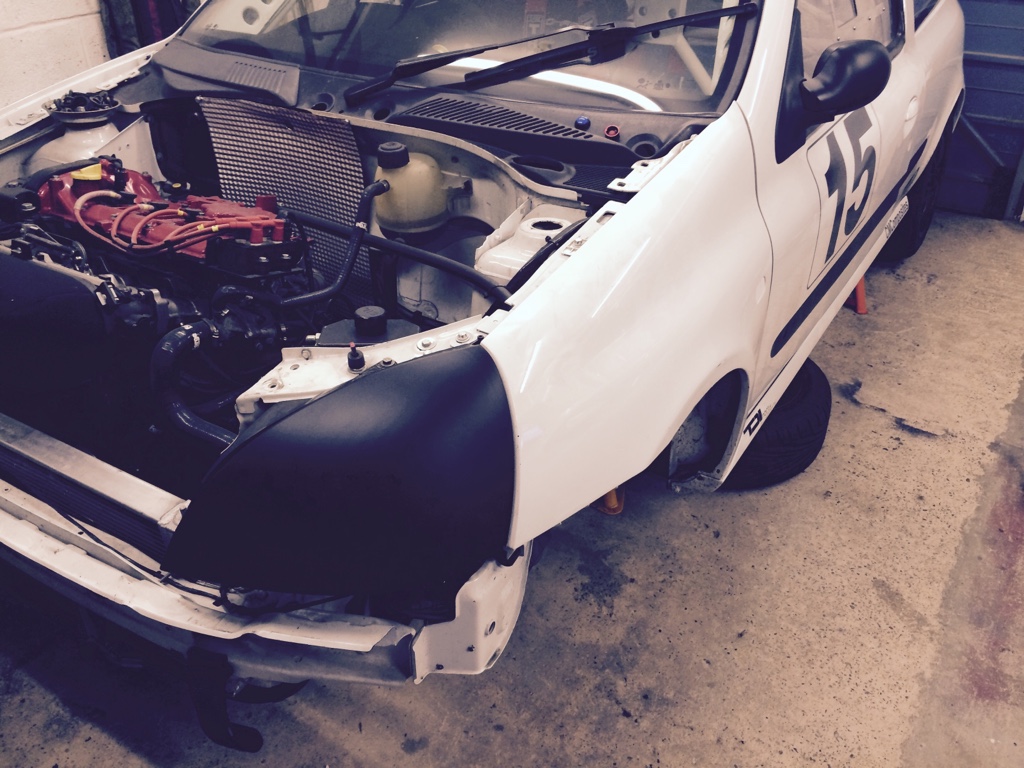

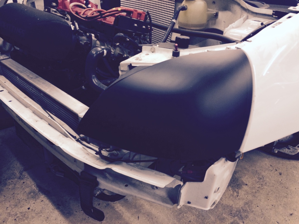

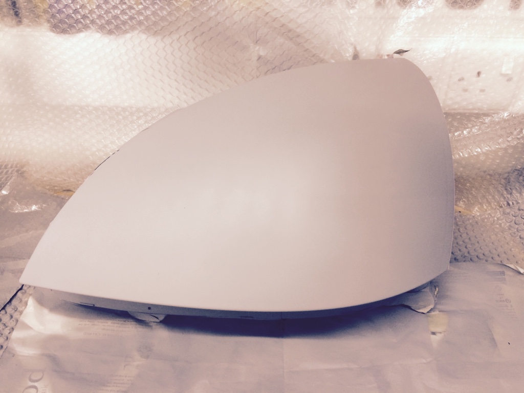

Although I don't agree with removing the headlights on a race car as there's more to be gained in safety by keeping them for wet conditions etc than in weight reduction of circa 2kgs. That said I thought I'd make up a set for dry running as its only a 5 min job to swap them over.
Just done one at the moment but I'm quite impressed, just needs flatted off and a few coats of Matt black applied.

Headlight blanks are done and fitted, head lights back on the spares box for wet weather.

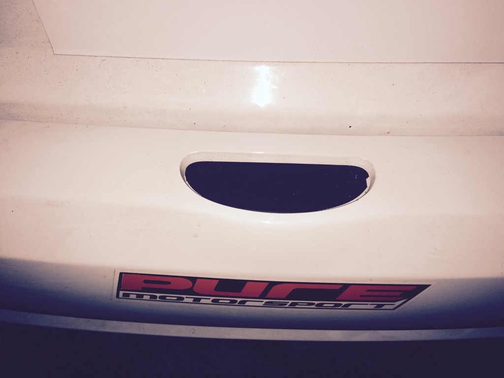

On the same note I've made a Matt black blank for the rear number plate light too

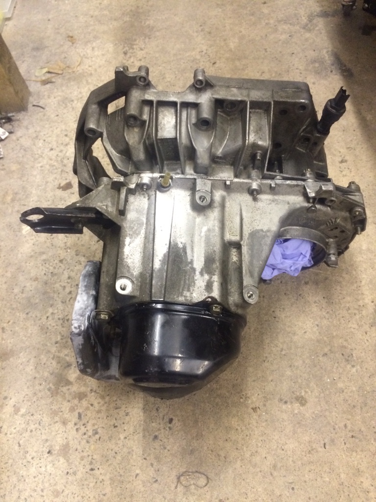

My gearbox has been to my man for a check over, the diff was sent back to gropper for s check over too.
The diff had some wear and tear and had some bits replaced and the preload reset as part of a standard rebuild.

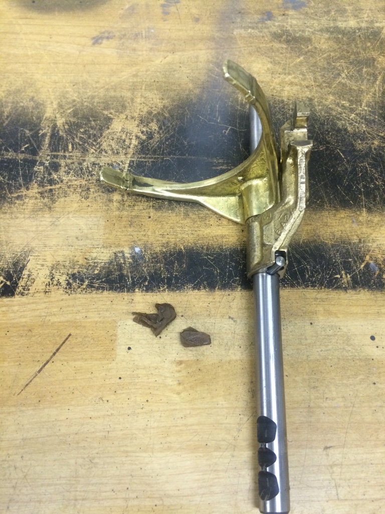

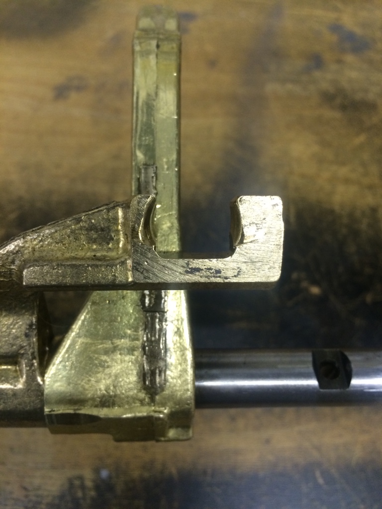

The gearbox however was in a worse state and needed a few unexpected bits. All bearings and seals as a matter of course but the 1st/2nd gear selector had 2 issues it had lost the plastic tips off both of the ends + the recess where fork sits in was worn quite a lot. Either one of these would give me grief let alone both, it's no wonder looking back over my vids now that I've missed 2nd gear off the line a few times.
It's all back together now though and dhould be like new. Replaced the selector pivot bush and circlip too.
And back in the car

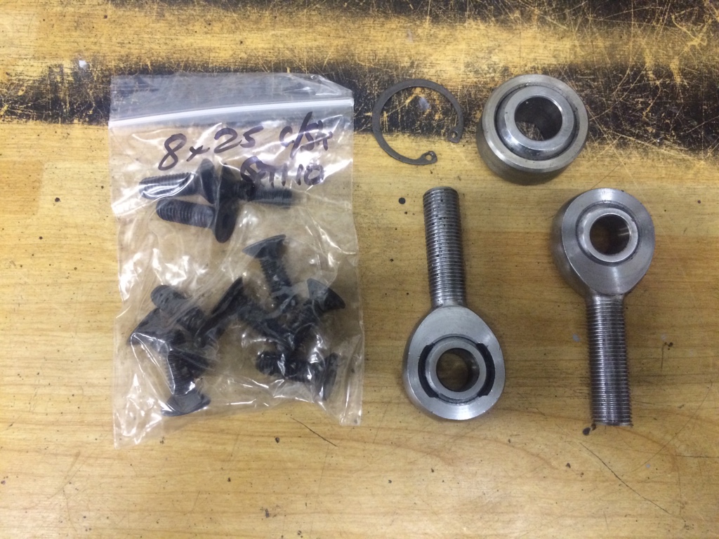

Still waiting for my mate to finish doing some little bits on the subframe before I can get it all back together. Got a few bits to replace, done any wishbone bushes that needed replaced. New track rod drumsticks are waiting to go on along with new special rod ends, lots of new hardware to be fitted and importantly lots to go in the spares box for race weekends. I've got pretty much a full set of all bolts/fixings for the whole car should I need them.

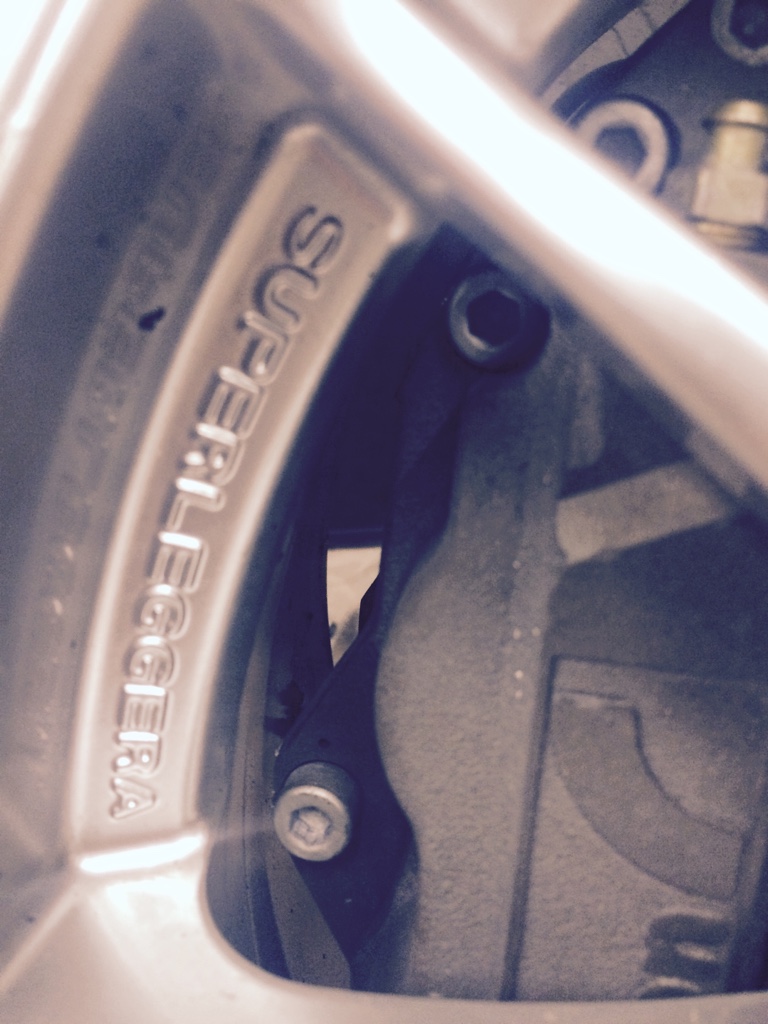

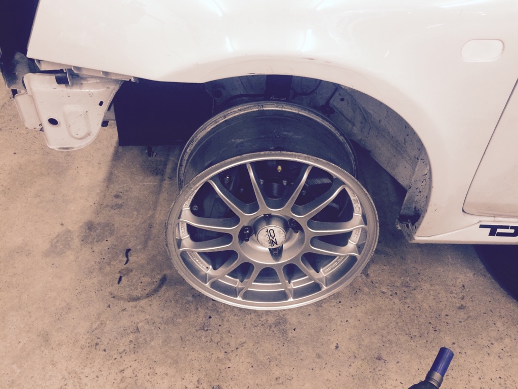

I've simplified my wheel setup now for next year too. 2 sets of Pro race 1.2's for wet and monsoon and 2 sets of OZ racing wheels for damp and dry. One set of OZ's are super leggera' so's was a bit unsure if they'd clear my brakes like the ultras do but they're fine, plenty of space.
