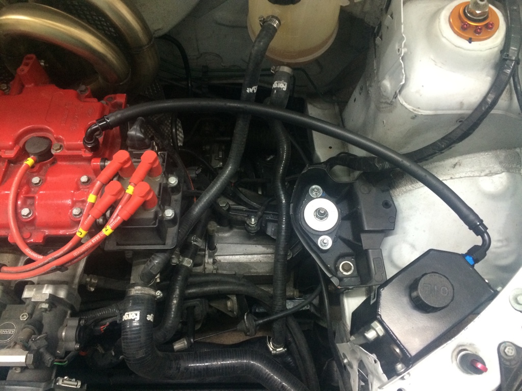

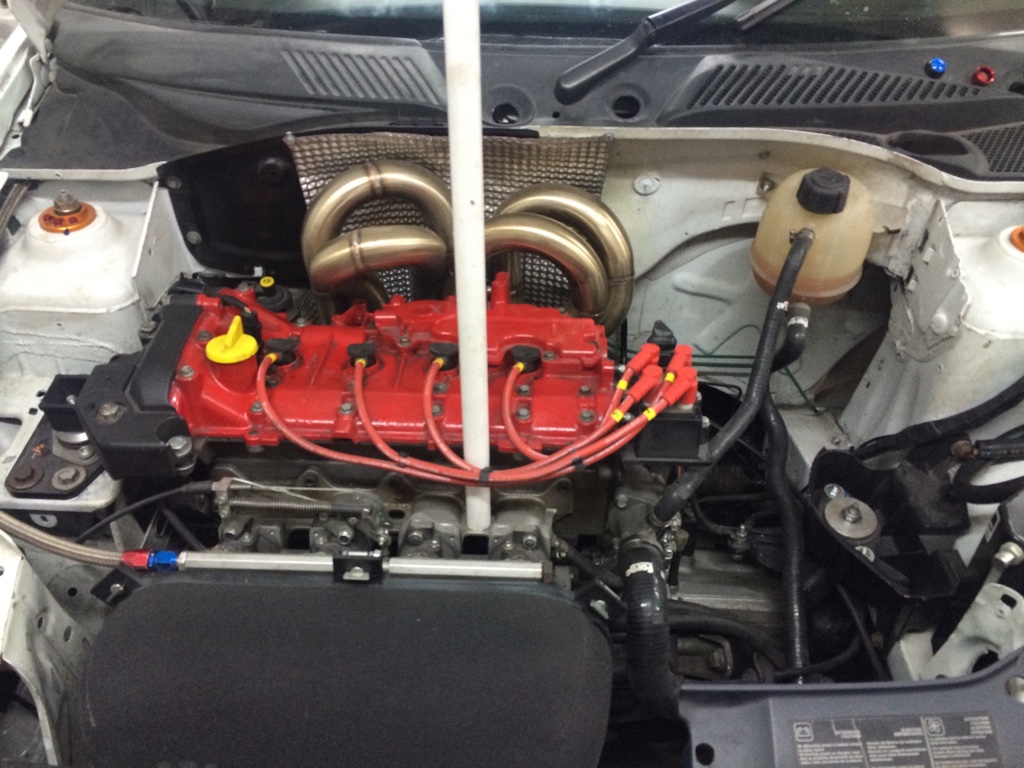

Thought about getting it ceramic coated Dave, chances are I'll probably do it when my other engine is ready. We'll see how hot it gets, ran it up to temp yesterday hence its gone gold. Also moved the coolant bottle over to where the pas reservoir normally sits. I'm going to shroud the brake reservoir more and run a new heat shielded line to the catch tank.
I think it's a little more raspy compared to with the 182 manifold fitted. Not sure if it's any louder, we'll find out at the first test, pms system before without cat or silencer was always 99/100db static.

Very interested to see if this manifold offers any benefit vs a 182 manifold once dynod.
Will keep you updated Steve, it's going back on the same dyno it was mapped on originally at TDi in the next couple of weeks so I'll get a rough idea if there's any difference. Nick from pure reckons it will be better than a 172/182 manifold on any engine spec but it's obvioudly optimised for use with wilder cams etc.

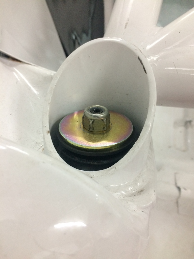

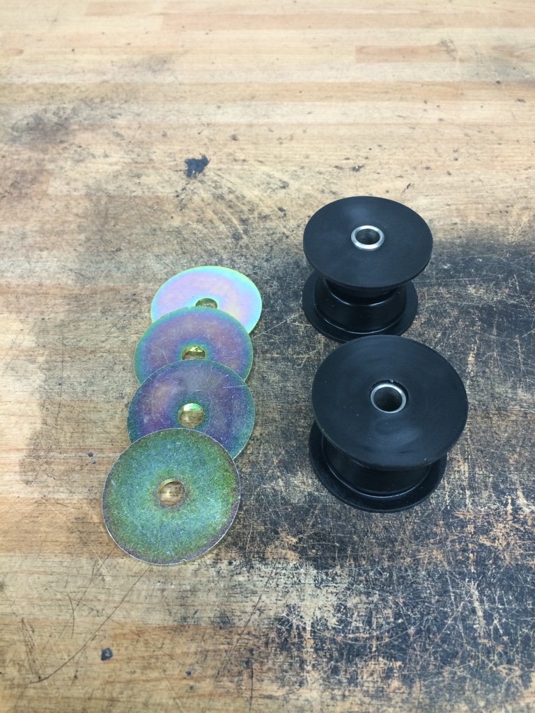

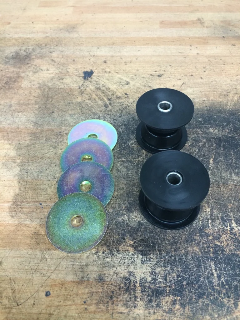

Grabbed a set of black series Powerflex rear shock top mounts this week to replace the oe mounts they're the only bush left on the whole car with any compliance left and I've been looking for a solution for ages, nearly got a set of nylon bushes machined up but seen these recently do thought I'd give them s try. Not a lot of excess movement to be prevented on that area but it keeps me happy.

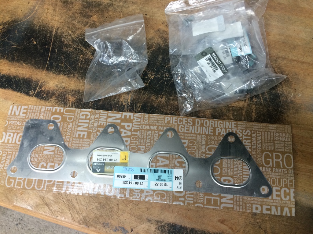

My box of 'new engine' bits isn't going well, only got an exhaust manifold gasket, thermostat housing gasket, flywheel bolts and clutch bolts so far!

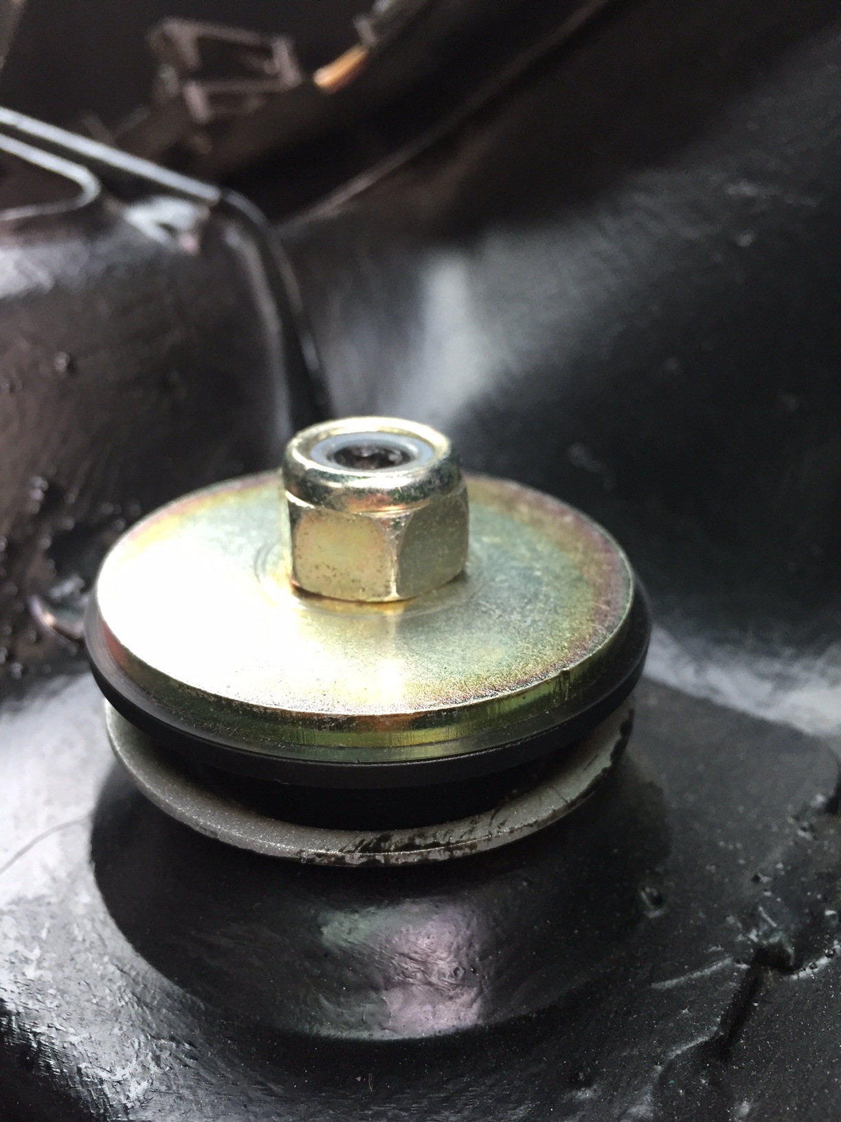

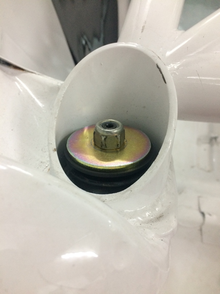

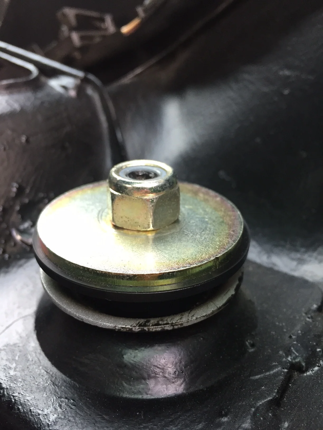

Would you mind posting a picture up of the rear top mounts once you've got those Powerflex rubbers on please.
Reason I ask is because on mine, because the washer is so chunky, the damper thread doesn't reach the nyloc in the nut properly... So would be good to hear your thoughts.
Nipped mine up so the top of the shaft is flush with the top of the nut but yeah know what you mean. I'll get a pic.

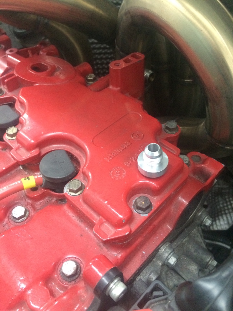

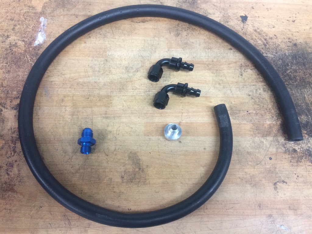

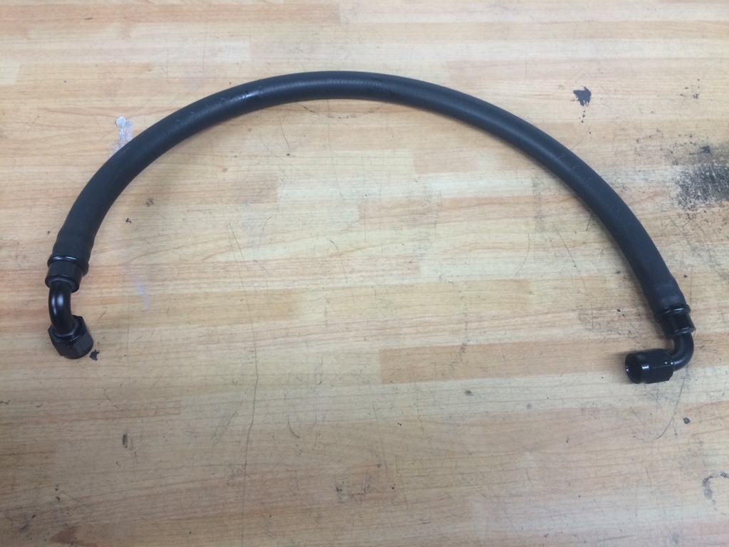

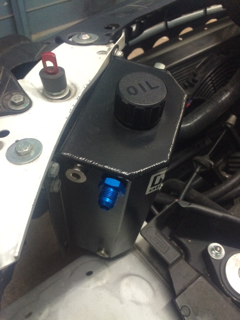

As far as the race car is concerned ive been gathering bits to alter the catch tank breather to move it away from the new exhaust manifold.
The breather plate is going to have a male fitting welded on the top and the oe outlet cut back and welded up.
Got the relevant adapter for the catch tank

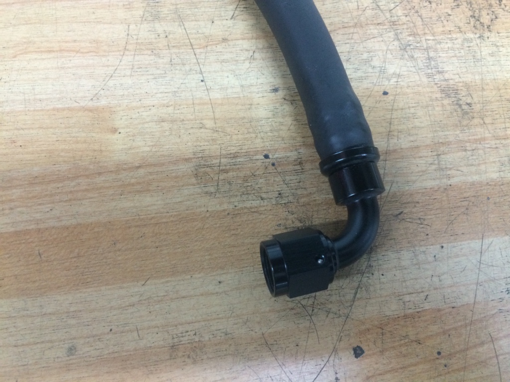

And made a new hose up with x2 90 degree alloy bends.
All sorted, just needed those bits welded now.
