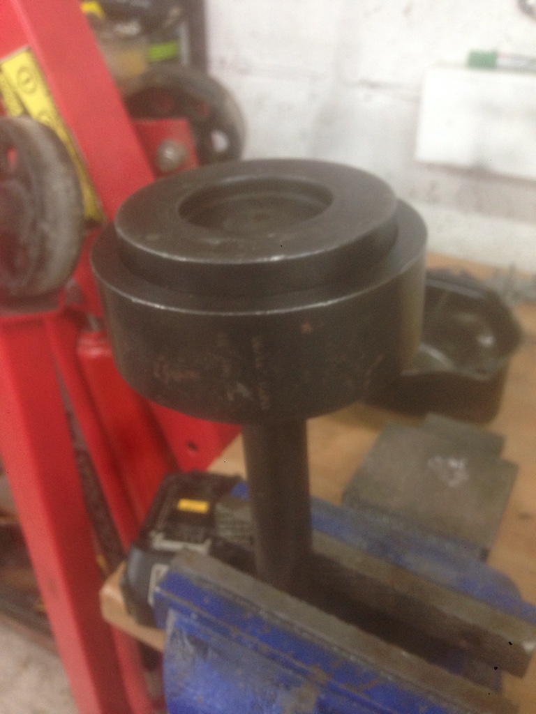

Those crank seals are a PITA!!!
Renault sell a special tool for fitting them, which sets the correct depth / force.
Yeah I know that now mate, shame I didn't know before. I've definitely fitted it too deep when looking at my spare engine. I've ordered another (genuine) seal and have pinched the proper tool from my Renault tech friend so take 2 coming this week!

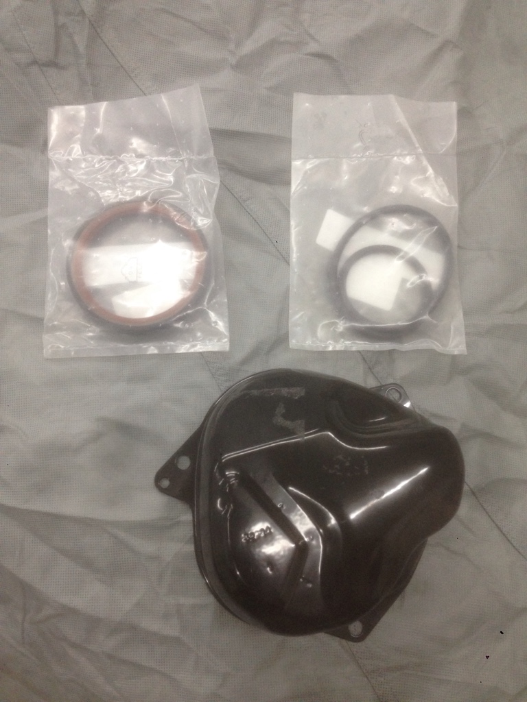

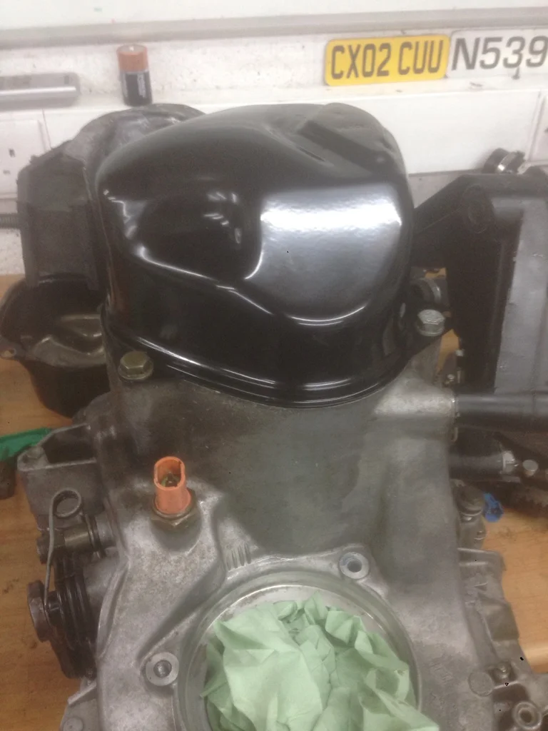

Ordered some bits from Renault which arrived today.

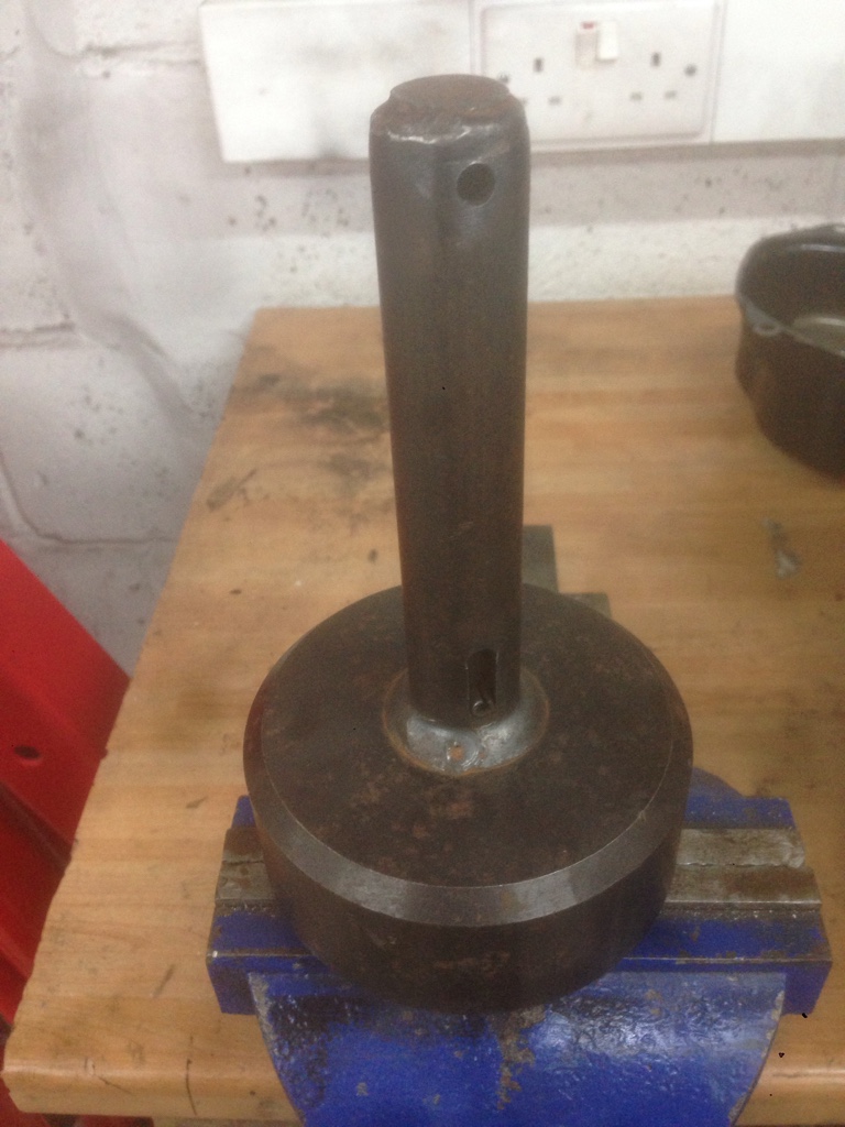

Crank shaft oil seal, gearbox 5th gear cover and seal. Also pinched the proper Renault tool for doing the crank seal from a renault tech i know while I was there.

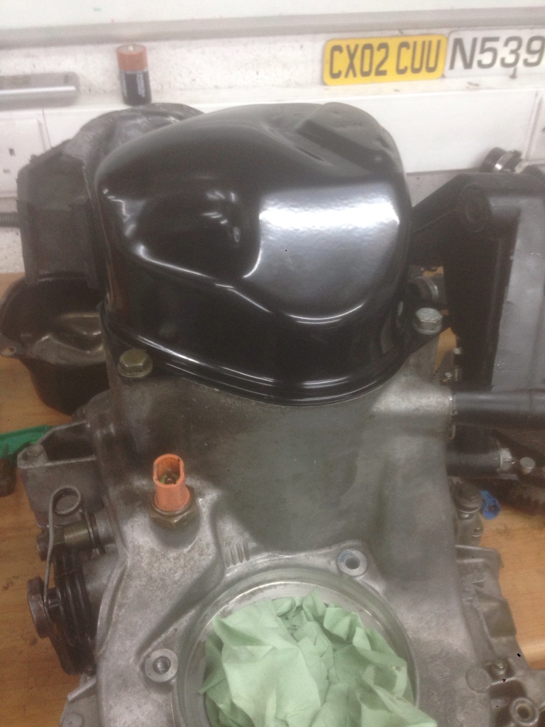

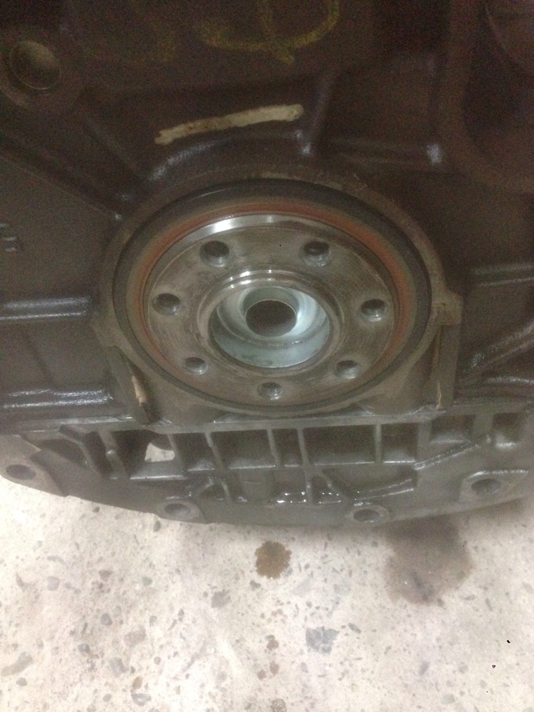

Crank seal fitted
You'll see it sits proud of the casting which is the mistake I made last time and tapped it too far in. It's now the same as another engine I have so should be ok.

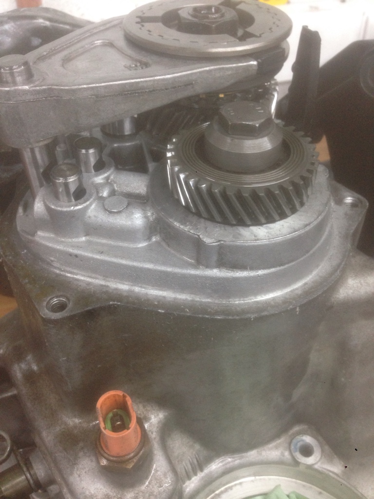

Got the new 5th gear cover and seal fitted too as it was leaking, old cover was corroded and paint was flaking along with the seal that was a bit slack.
Had a 'helper' tonight, well I think he was supposed to be helping. He's worked out how to open the door on the car so he'll be swapping engines in no time!
Still got to put a new clutch on the flywheel and put the 'box on but need to helicoil one of the near side M8 driveshaft threads on the box as its stripped. Should be back in the car and running by the weekend, plenty of time to sus any issues before cadwell on the 18 July.

I fitted a new crank seal when mines was out and couldn't figure why it's leaking now as I was adamant I'd put it in perfect.
Definately need to find that tool :pensive:
All Renault main dealers 'should' have one, they won't use it very often so slip a techie a tenner and pinch it for a while, sorted!

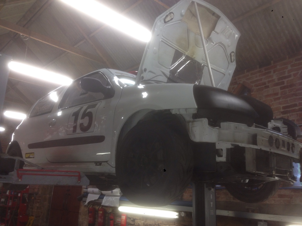

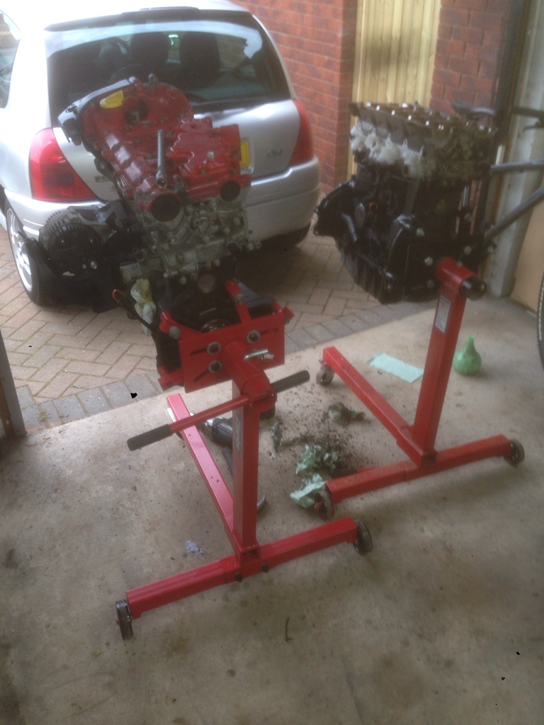

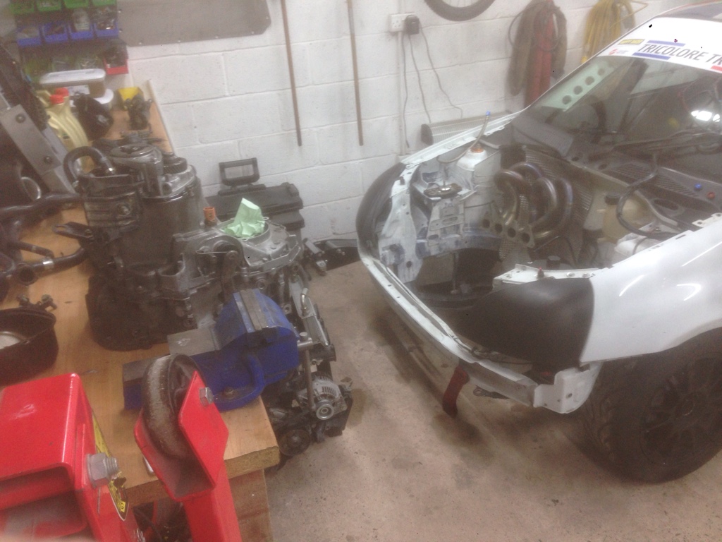

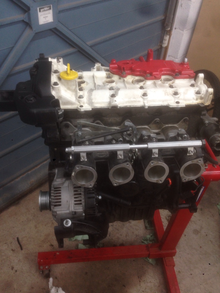

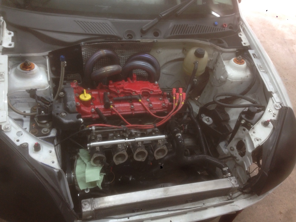

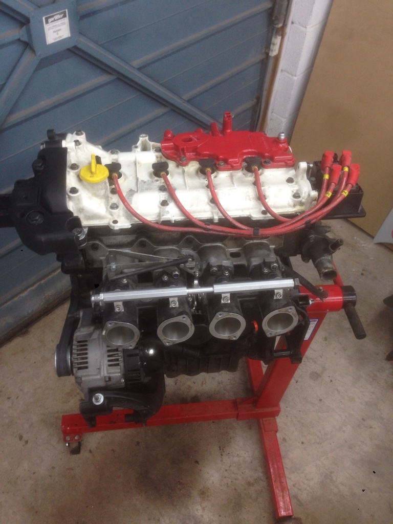

Still have a slight weep from the crank shaft oil seal so the spare engine is going in. Got them both on stands to swap the cams etc over.
I'll be at cadwell if I've got to push the car around!
