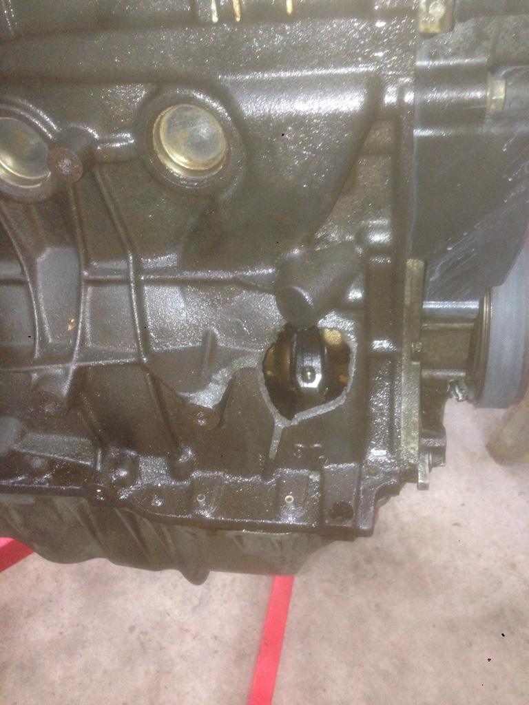

If you hadn't gathered I blew my spare engine up after 3/4 lap of cadwell park in qualifying last weekend. Shame it had to happen on a race weekend and before it had even done a lap but so be it, I've done well with reliability Since I built the car so hopefully my run of bad luck is out of the way now!

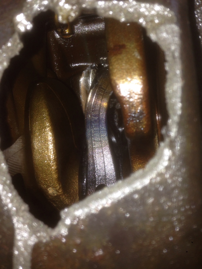

I managed to find the hole in the back of the block while poking around at cadwell so it's safe to say the motor is scrap. Fingers crossed the cams are ok.

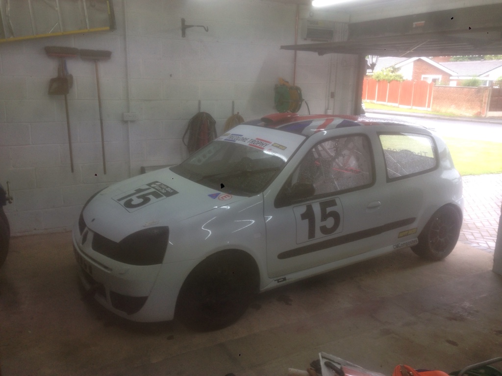

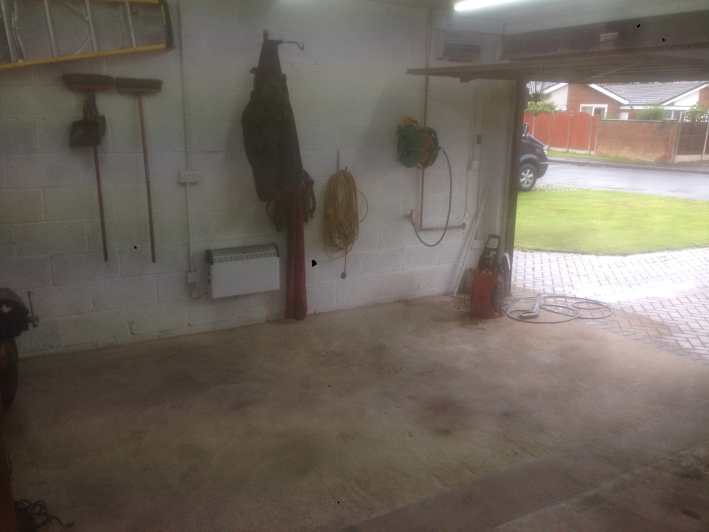

Cleared the garage out ready to bring the car in.

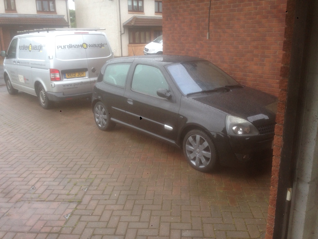

That meant putting my black one back together after putting cambelt + aux kit on it along with a clutch a big service. All done it was put outside.
This was supposed to be a winter project getting a megane turbo engine and gearbox in it but I'm probably going to sell it now as I need to build a proper engine for the racecar really.
So that's where we're at, car is back inside out of the rain.

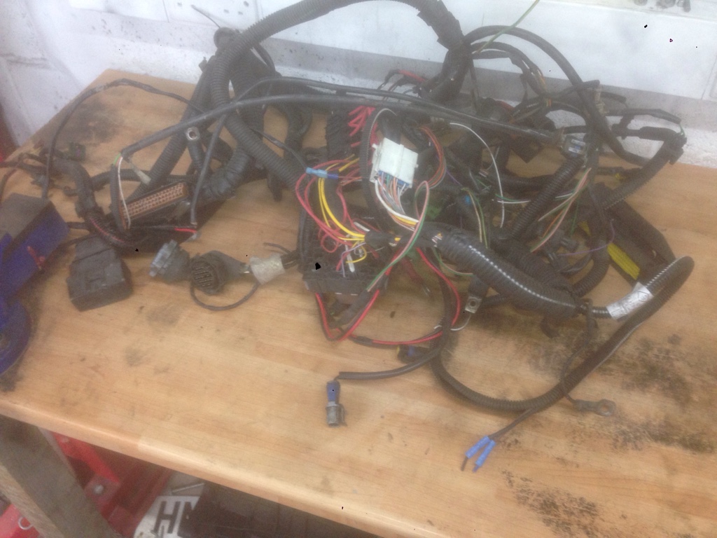

In other news best get cracked on with @TarkMalbot 's engine loom for his 172 track/race build. Dta ecu is here and oe loom, got it on the bench ready to strip down.

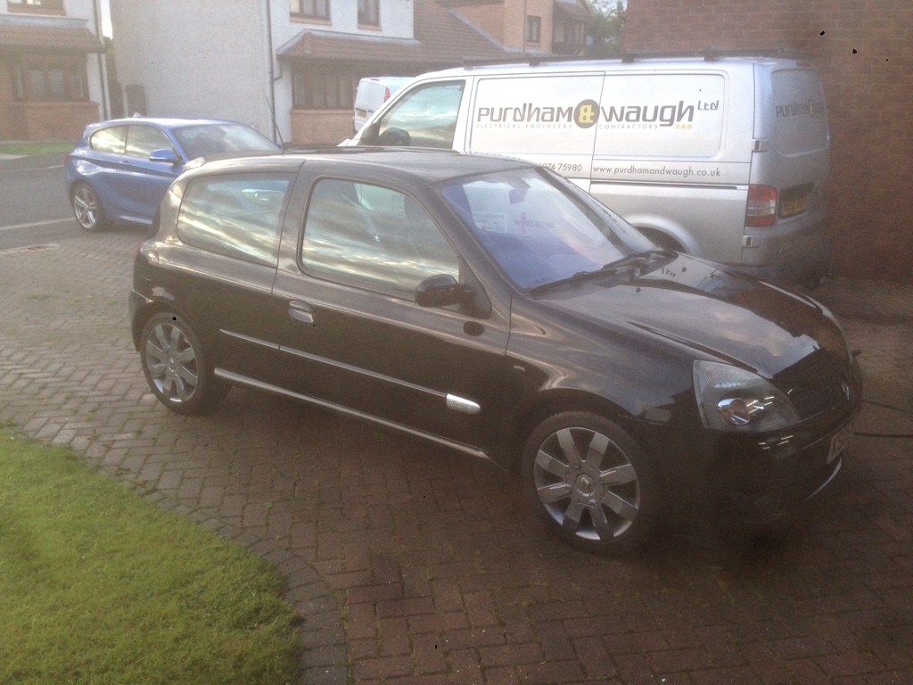

Had the black 182 on the ramp lad night to finish a few jobs and check it over. Gave it a quick wash and it looks really good, love Black Gold.

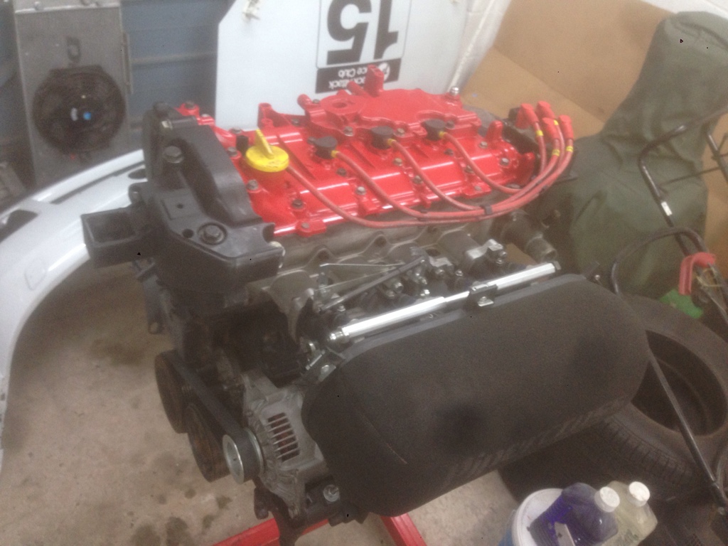

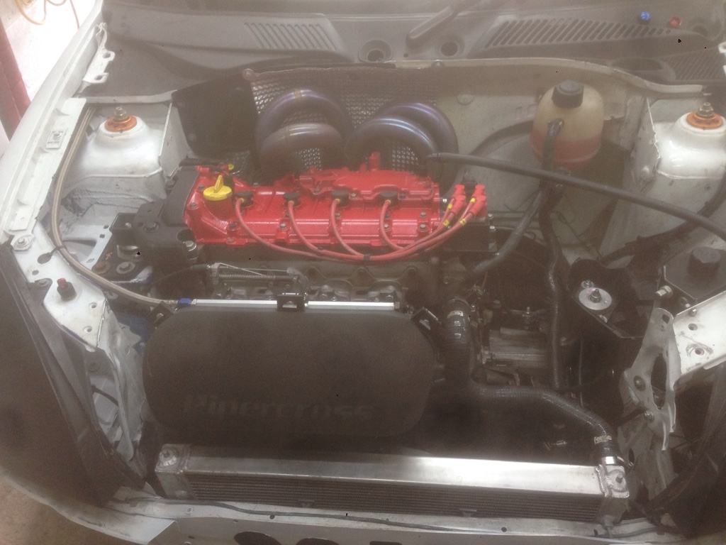

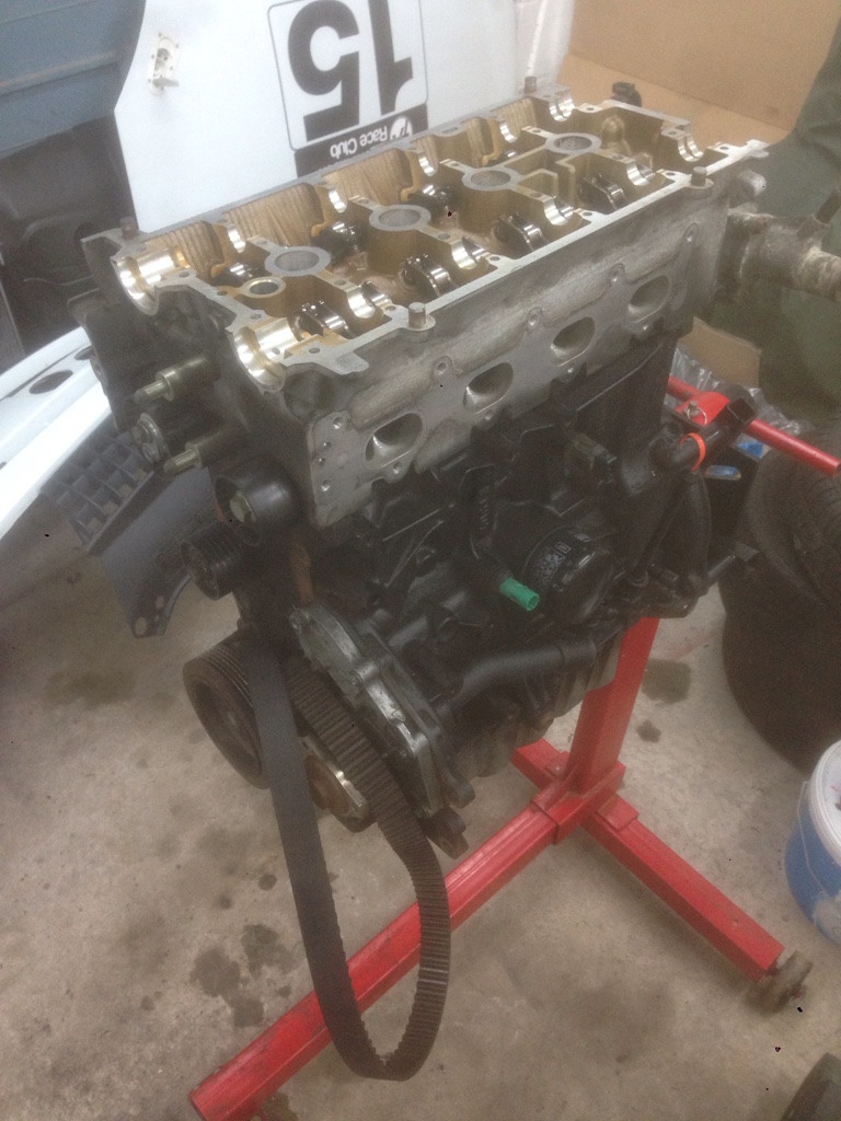

Got the engine on the stand last night after collecting it on Saturday. All looks good apart from the exhaust cam pulley nut was rounded off by the last person who did the cambelt. It would have been near impossible to remove in the car with the access available. Made a right mess stripping it down but it's sorted now.

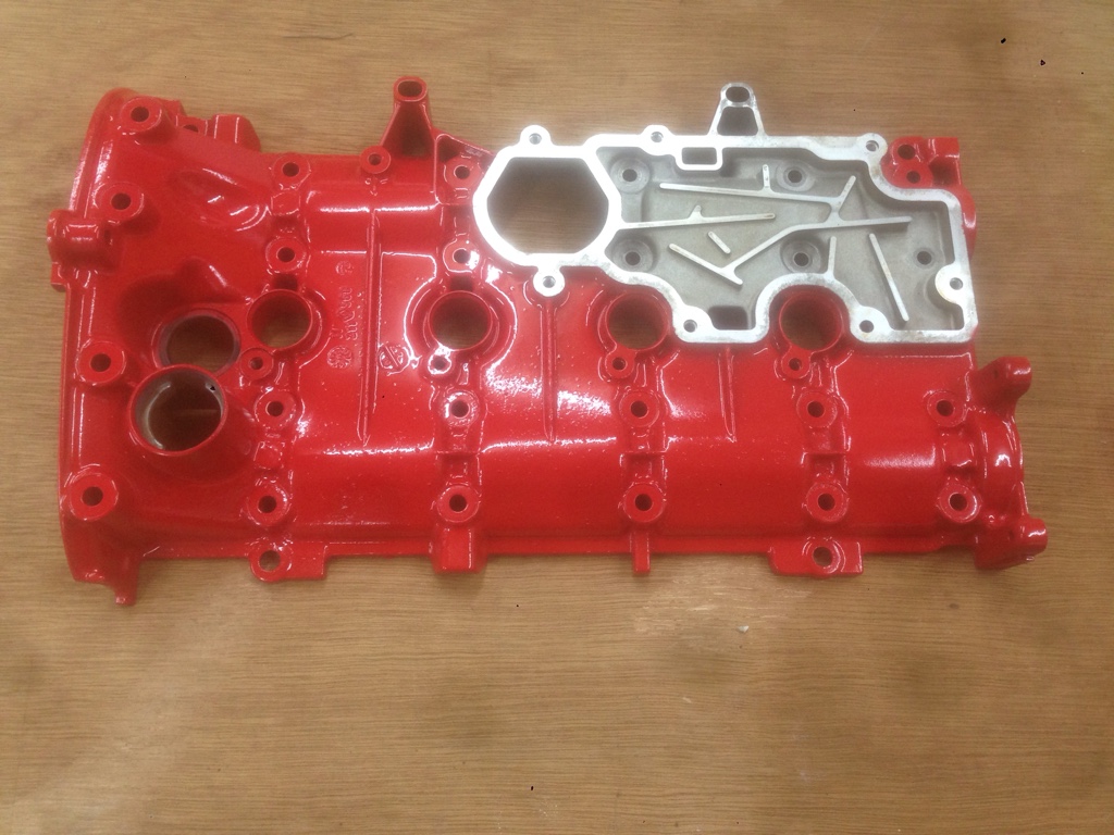

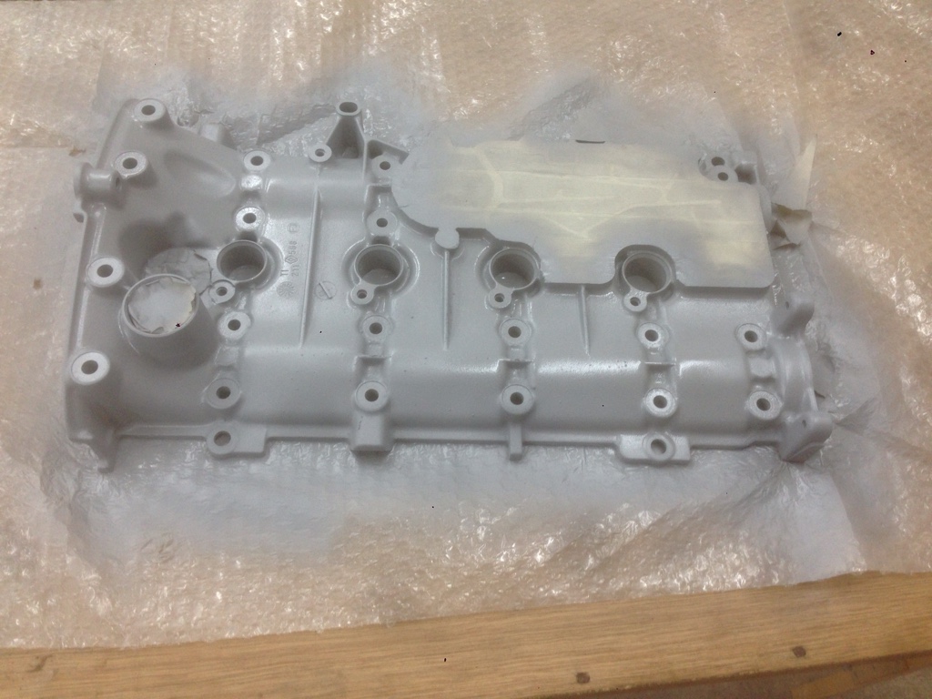

Degreased everything and gave the block a coat of matt black once everything was stripped off it. Been painting the rocker cover red too like my original engine.

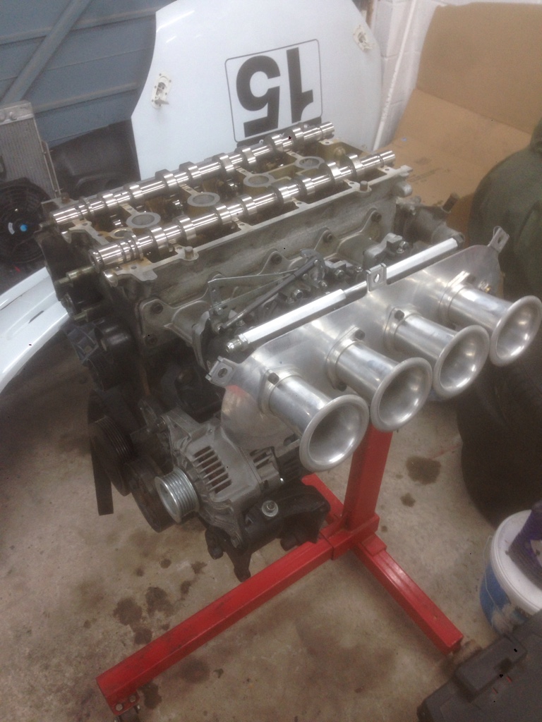

Can fit the rocker cover tomorrow once it's properly dry and time the cams up + fit the new ARP bolts and new plugs before putting back in the car. Got most of the ancillaries put back on tonight, low temp stat, itbs, alternator etc.
Be nice to get it in the car tomorrow night and running Thursday/Friday. Be interesting to see if it makes anymore power being a ph1 engine with the bigger exhaust ports.

Engine is all built up as of tonight.

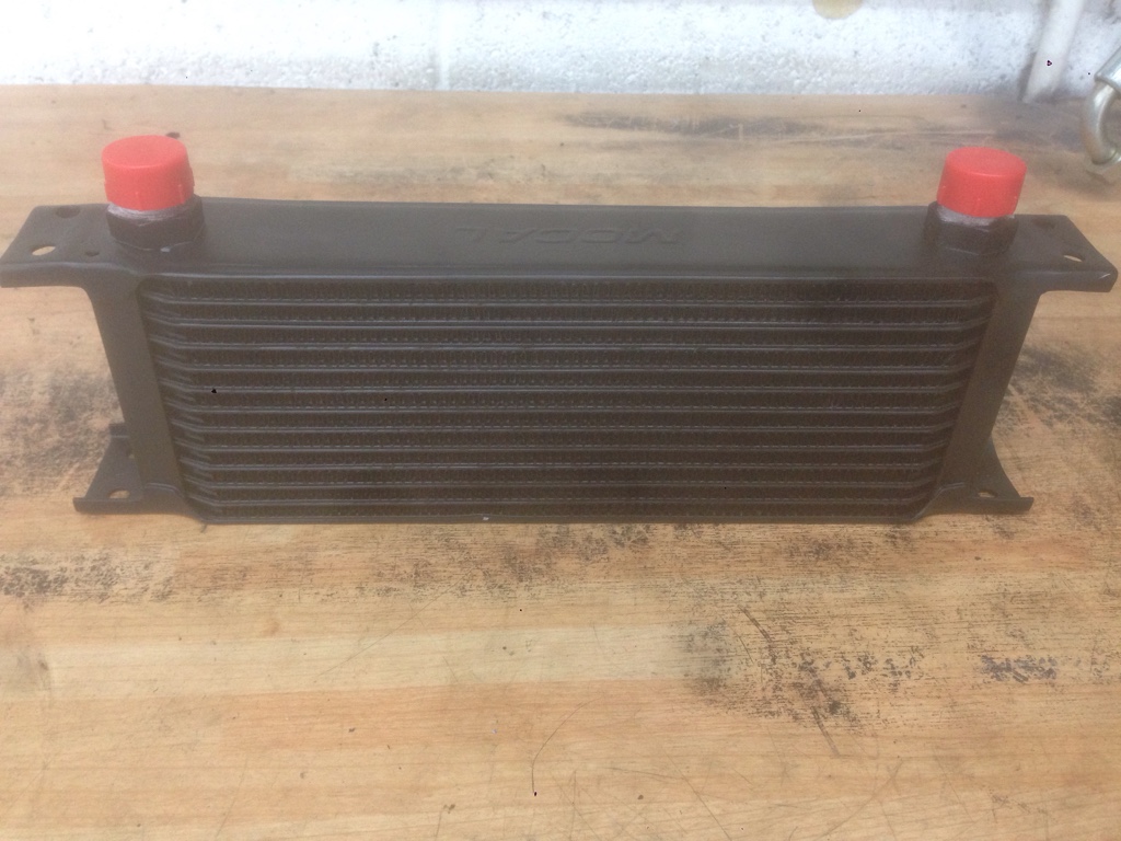

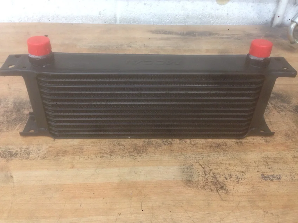

Didn't have a chance to get it in the car though so will have to wait until tomorrow. Need to order a new oil cooler tomorrow too as its full of swarf that I just can't get out.

She's alive again!
Just ran it up to temperature and left it idling for a little while. All seems good at the minute. I swear the exhaust is louder, maybe because it's a ph1 lump with bigger exhaust ports I don't know.

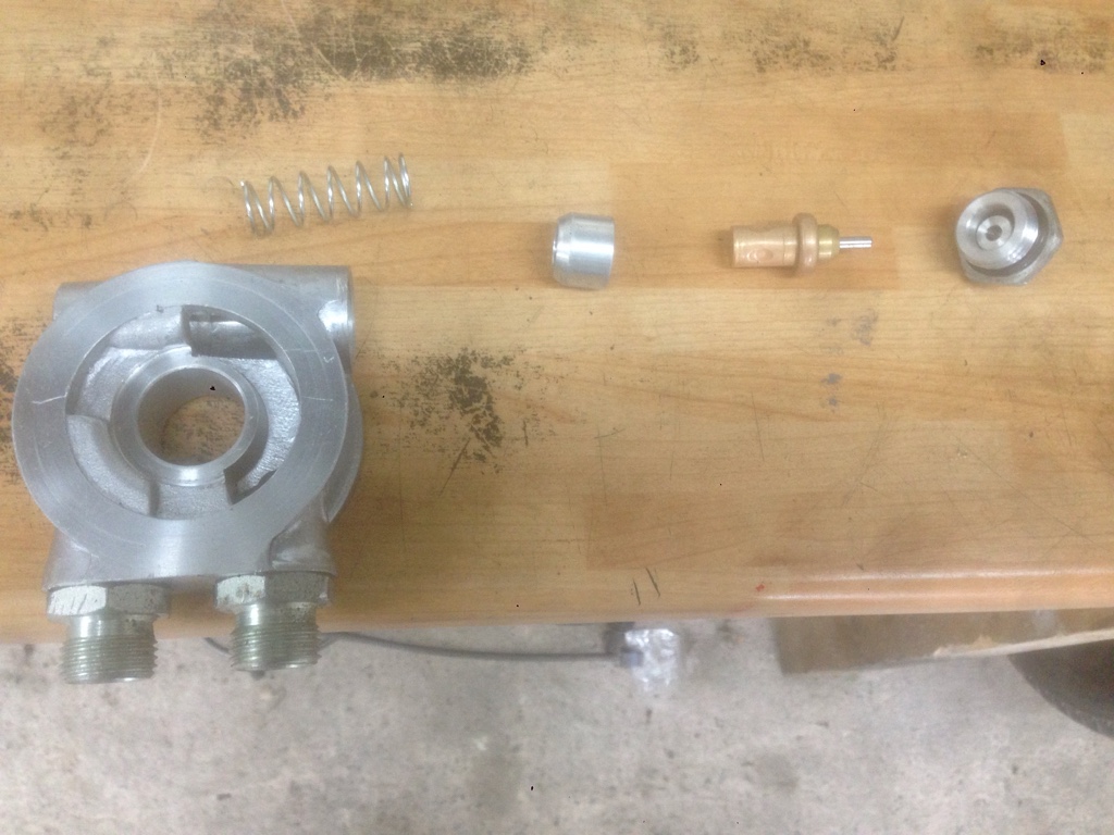

New mocal cooler turned up and I've flushed the cooler pipes out and had the stat in bits and is immaculate now. Pic below in bits if you're interested to see what's inside one.
Just need to drop the oil out and out and put my proper stuff in with the cooler etc. spanner check and a run up the road at the workshop and it's ready for having the map checked on Friday and Silverstone on Saturday.
