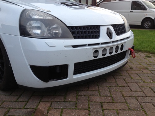

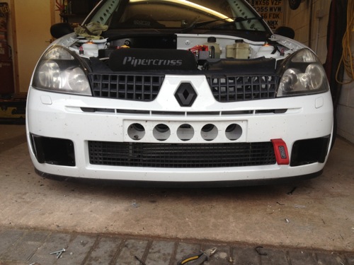

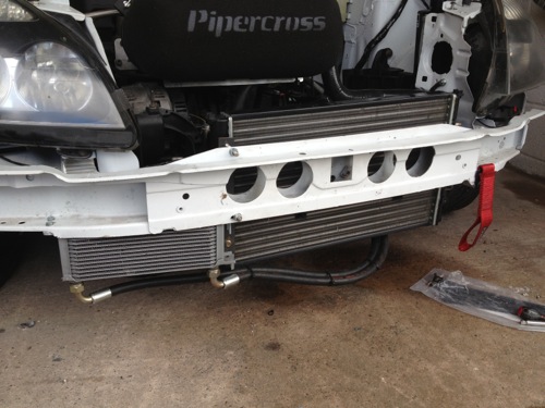

Have you drilled out the front panel ? 4 holes in mine makes 10deg difference.

Taking advice from various sources on the cooling issue ive moved my oil cooler from infront of the rad so it has maximum airflow to it, ive modified the original shrouding from the front bumper again to direct as much air through the rad as possible. Along the same lines i've raised the rear of the bonnet to allow the hot air to escape so all that has to help in my eyes. Took the thermostat out as well.

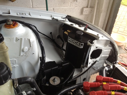

Looking for somewhere to mount my catch tank

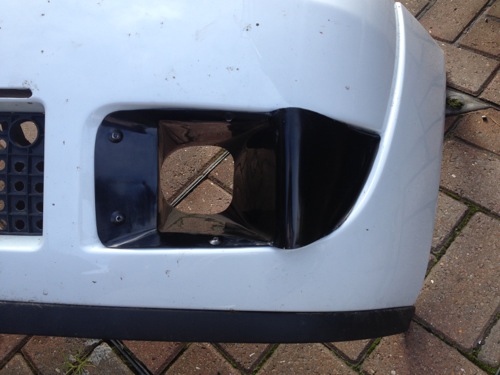

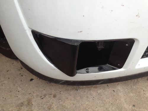

Got round to fitting a set of Chris' cup racer syle brake ducts too

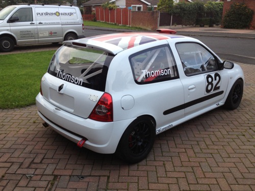

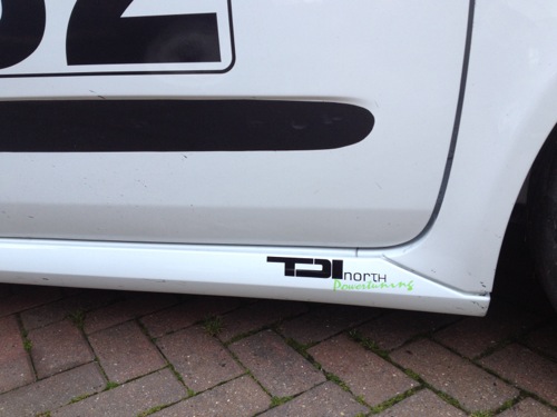

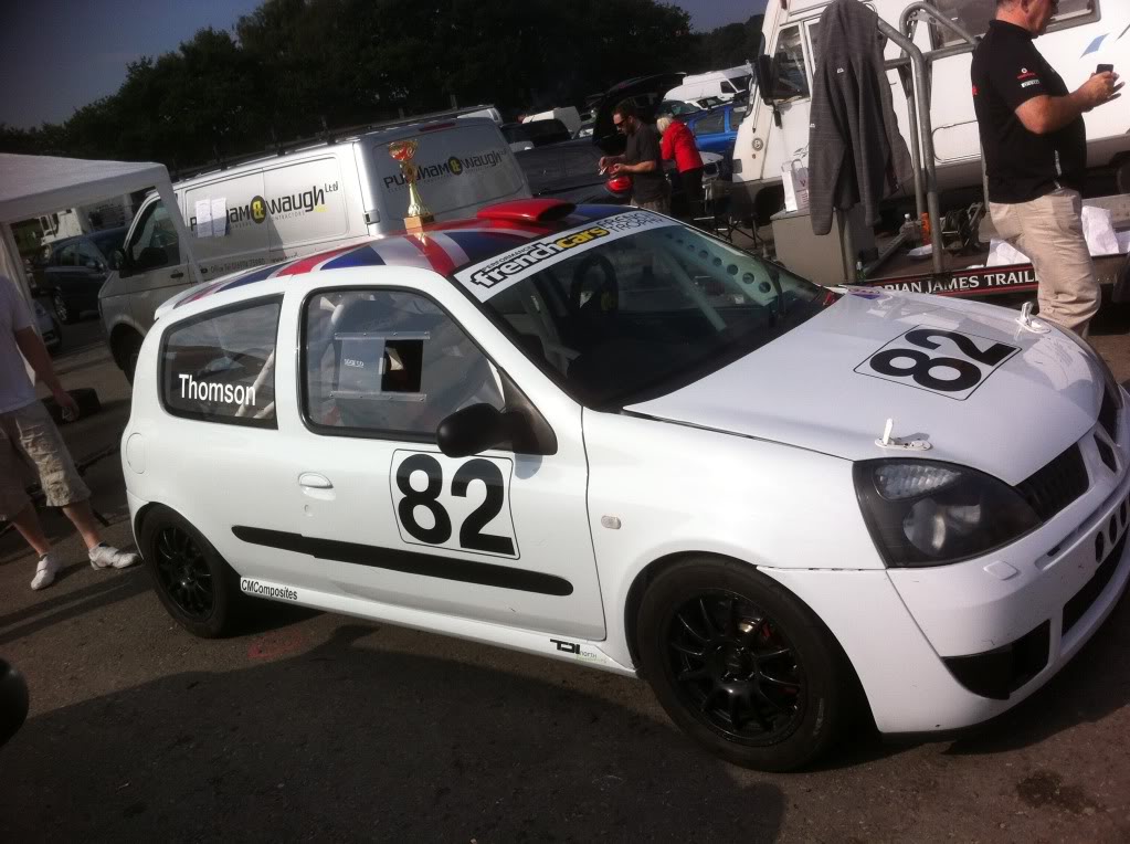

A pic with names and numbers applied and some more stickers. Paul West from TDi north in warrington did the mapping and hes done a gret job, he wasnt happy with the part throttle stuff but it drives excellent and makes excellent torque across the range. I've know Paul a long time and i'd highly recommend him, they mostly do Hondas but do a lot of other stuff too
and some with the pure motosport system fitted.

What size hole saw did you use for front panel and bumper. I need to do this i think, I've been worried about overheating before I've even been out. I've made up some shrouding either side, also thought about doing one underneath A little bit lower than splitter too
You need the radiator fully enclosed so the air has to go through it and not spill out around the edges mate.
Yeah I have. Maybe I didn't explain myself properly. Basically all air going in front of car goes towards rad
