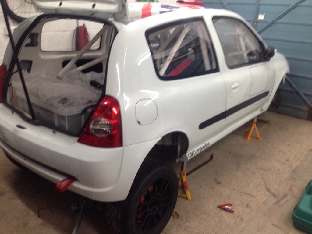

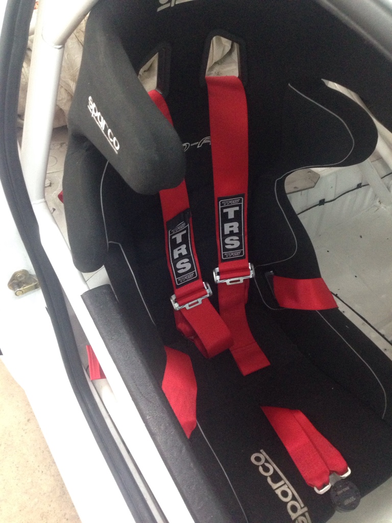

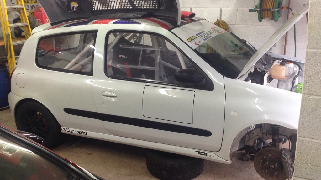

Got the seat and harness back in.

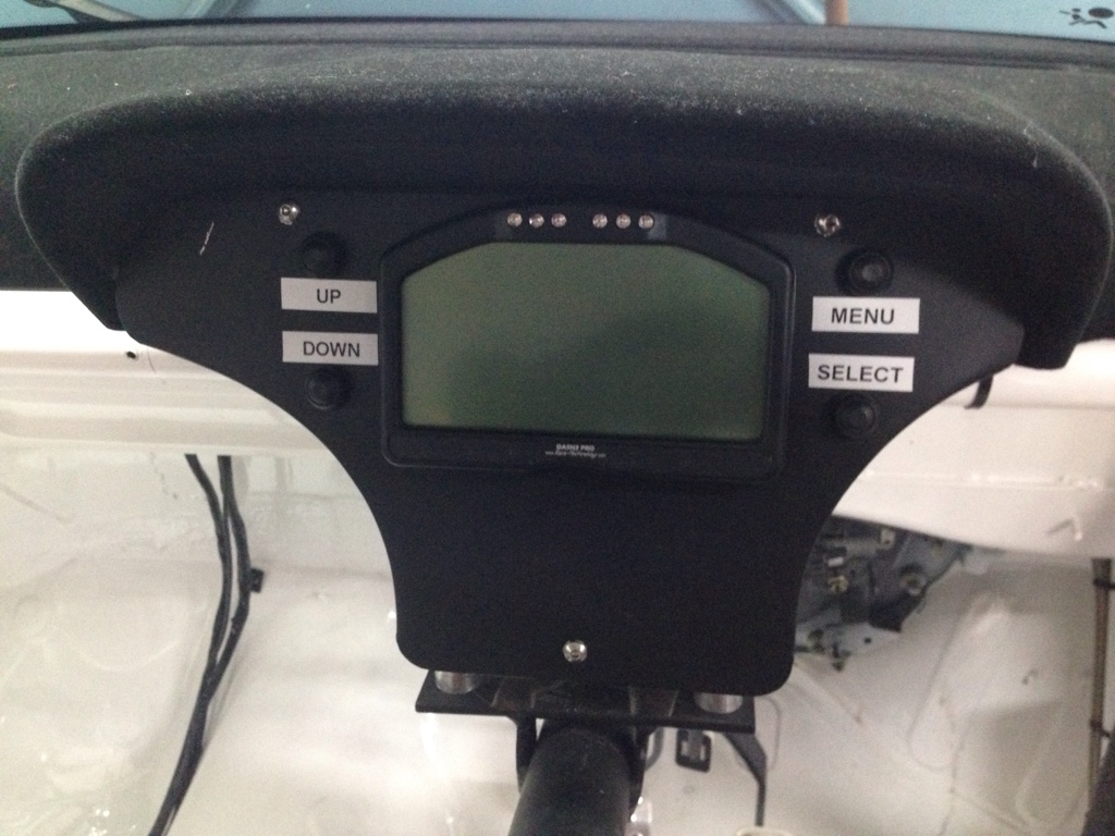

Got the wiring back in for the Dash 2, the external GPS sensor and go pro wiring. Just need to re fit the dash.

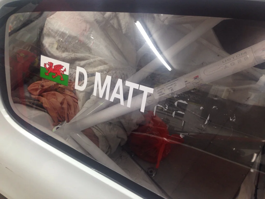

Seen as @Damo-172cup left his name on it on purpose unthought if get that off asap!

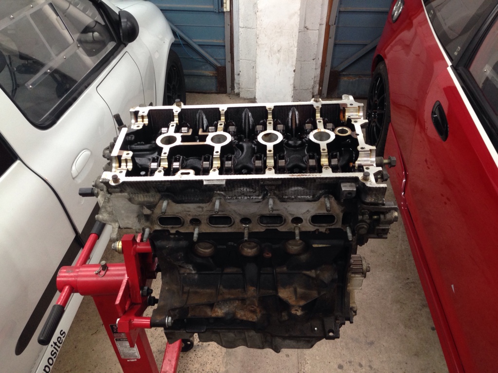

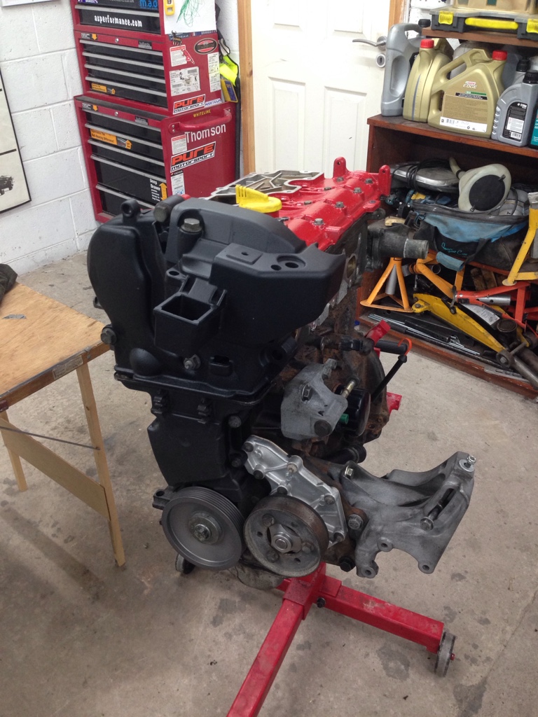

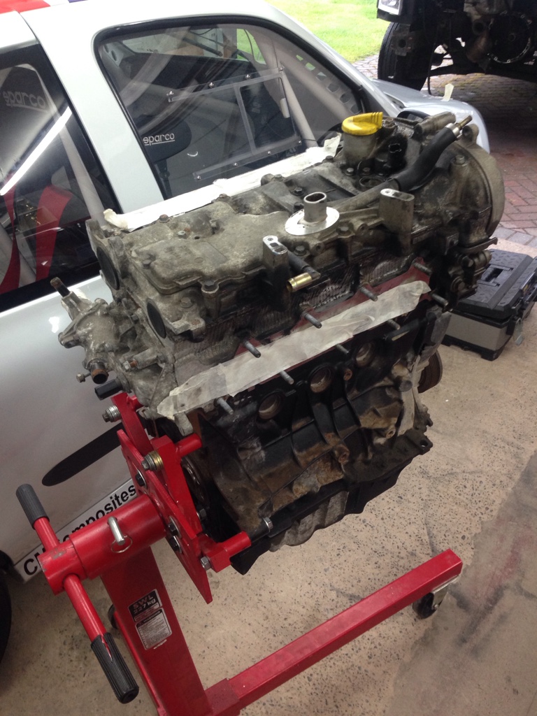

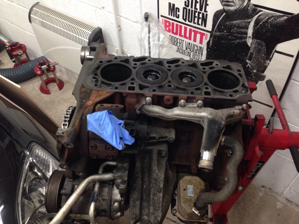

Got the grubby new engine on the stand and started stripping it down, just gonna keep it the same spec as it was before, have the cams ready to go in, just need to get some arp rod bolts and the usual bits, cambelt kit and dephaser, new plugs, sump gasket etc. oh yeah engine is full of oil too! Damo, tell your mate thanks!

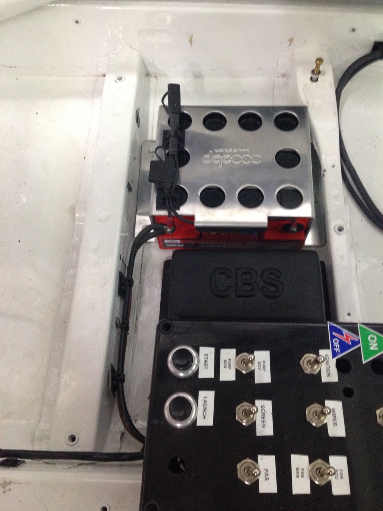

Got the dash refitted though and wired back up.
New battery and cage fitted with charger plug.

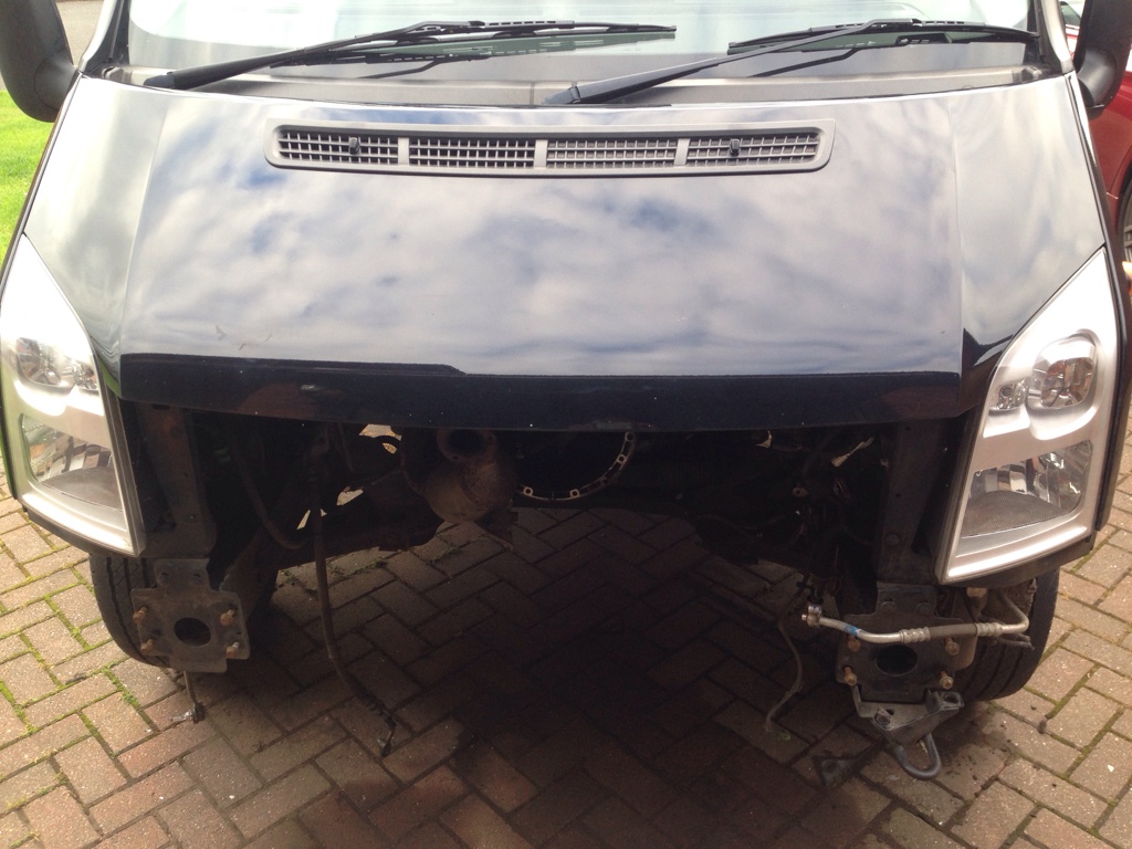

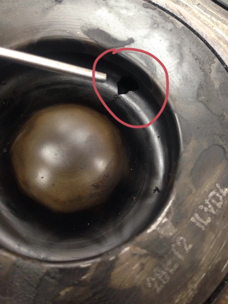

More importantly need to get the van back together. As suspected it has holed a piston. Number 3 actually.
Common problem it seems, new piston on order £66 bargain for a new one. Just all the other bits required to build it back up, head gasket and bolts, new clutch and flywheel, other various gaskets and bolts + complete set of fluids and filters. Currently looks like this.

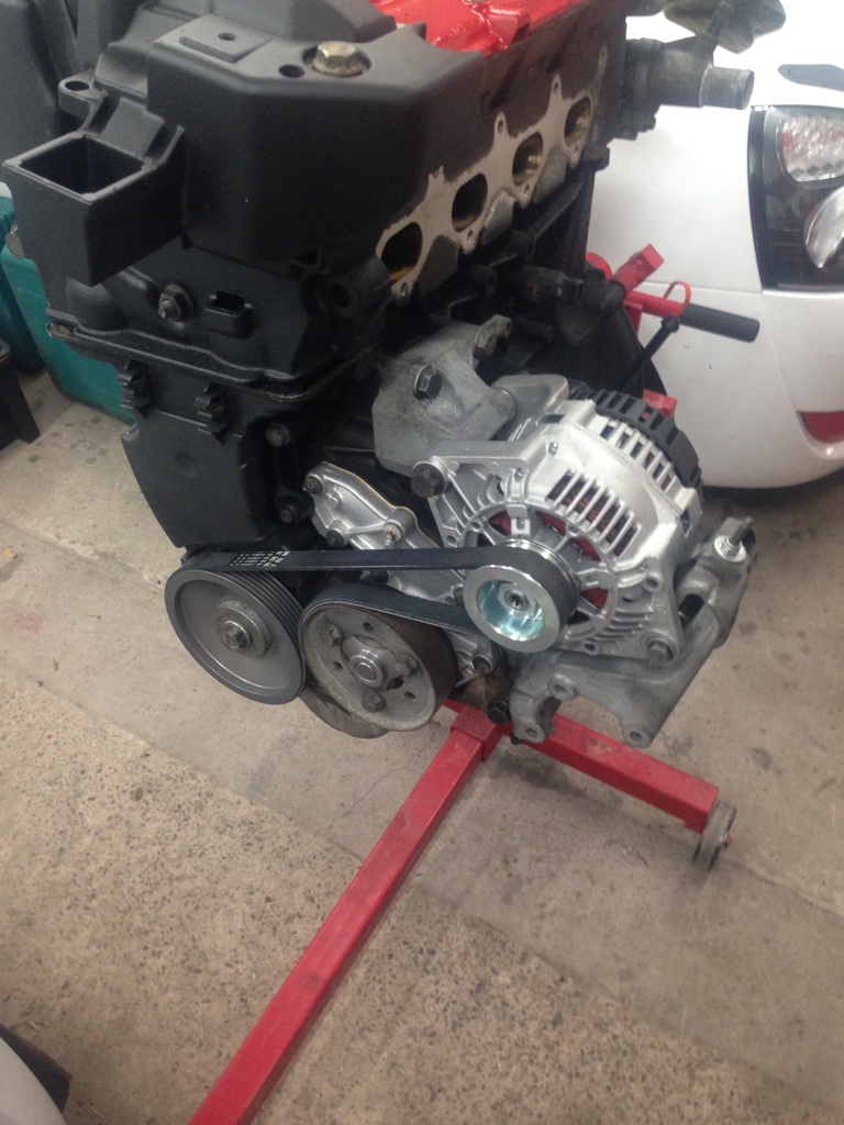

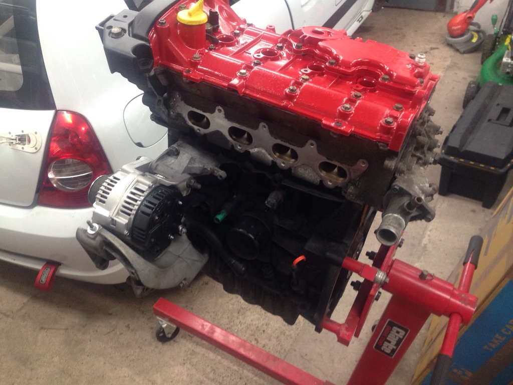

Been collecting parts ready to build up.

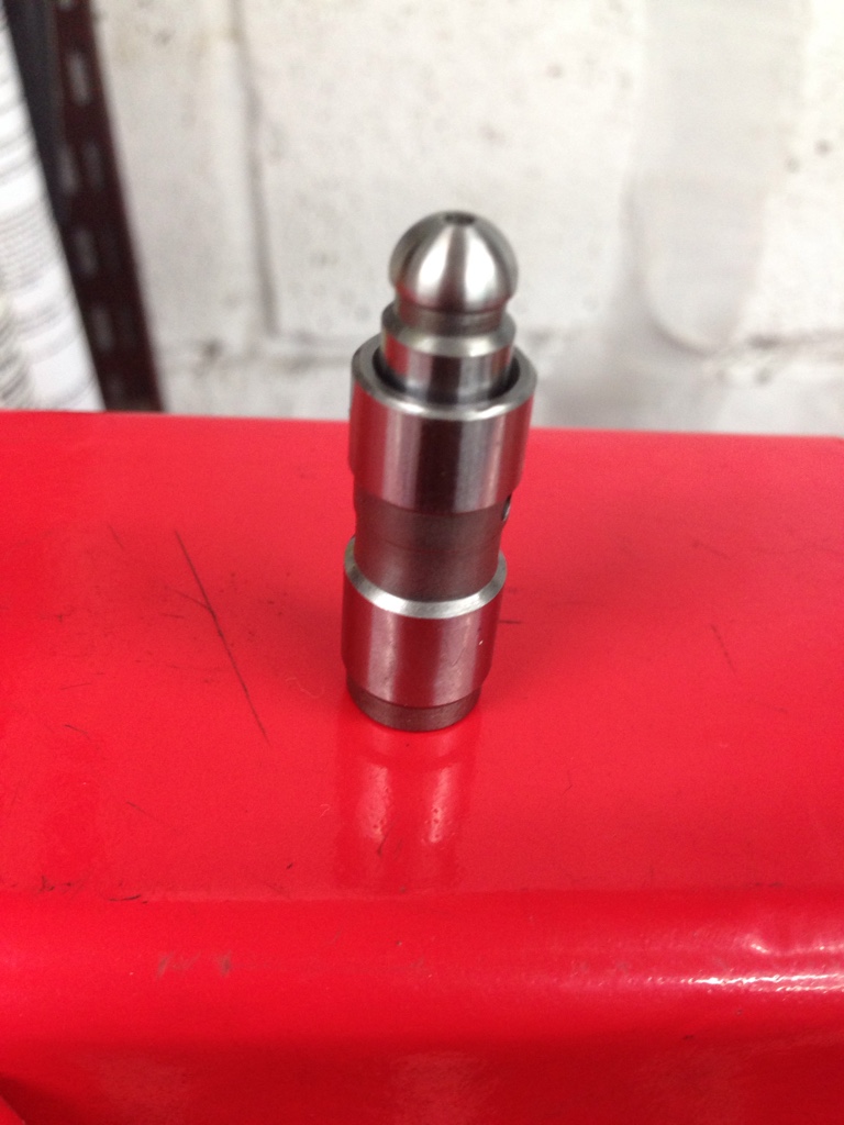

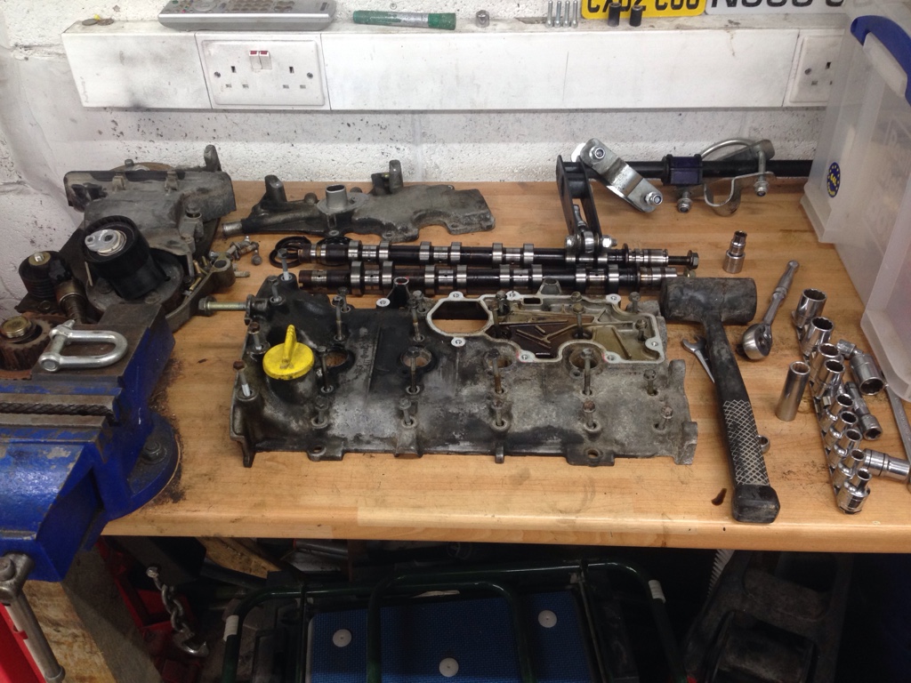

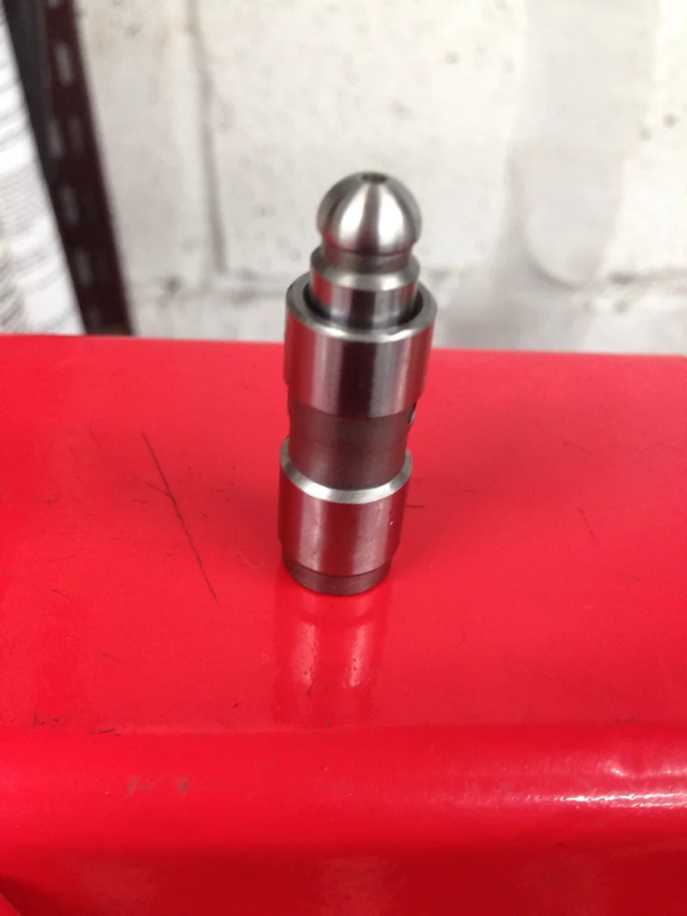

Mostly bits needed to build the engine up, new NGK-R's, ARP rod bolts, cam seals, belt kit and dephaser. Also a set of tappets as I wasn't convinced by the ones that were in the engine.

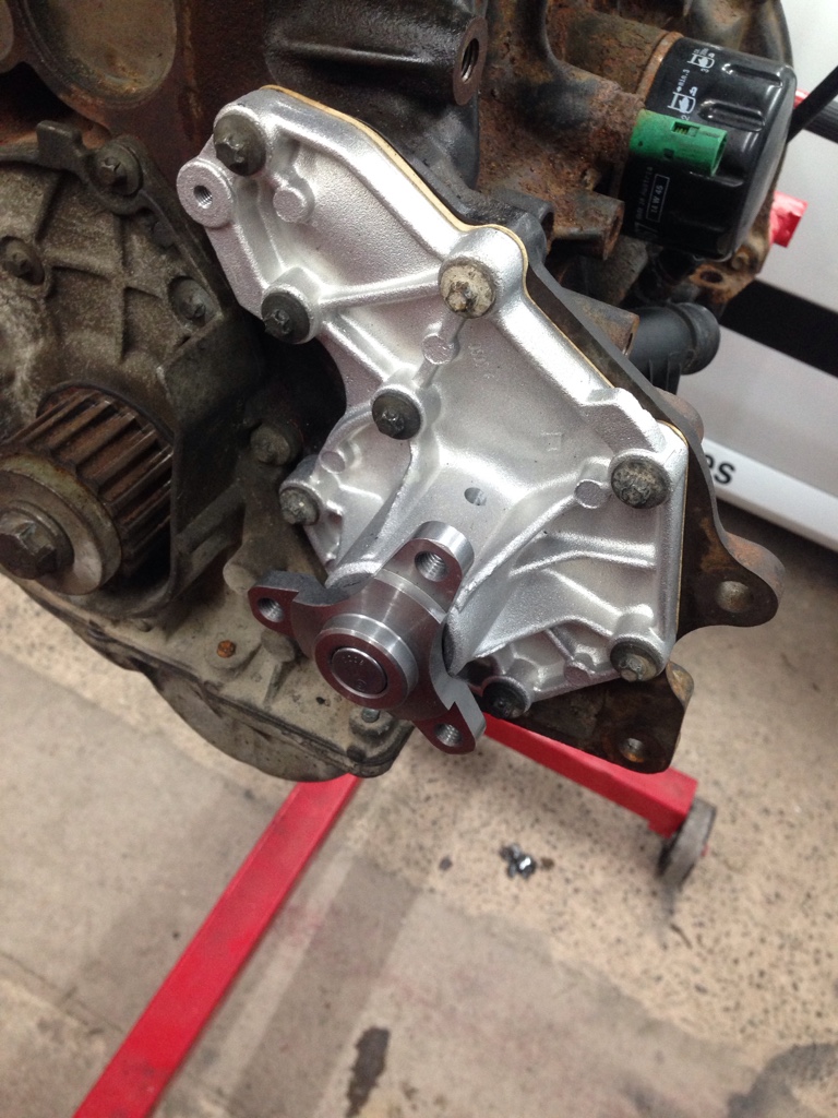

New water pump

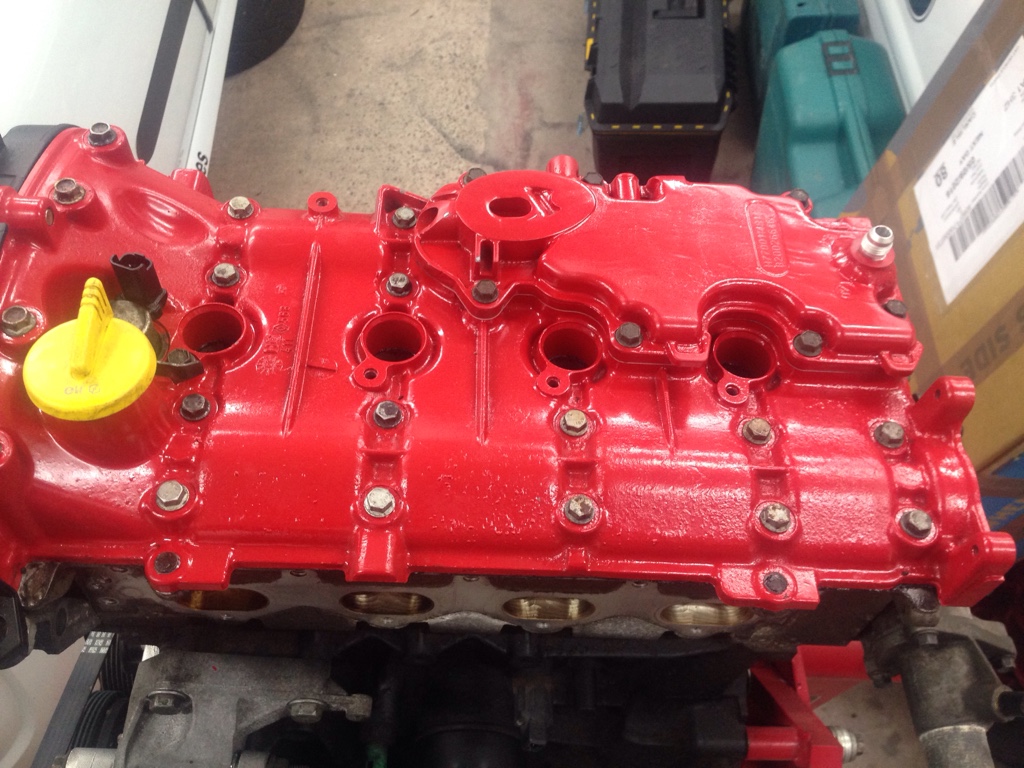

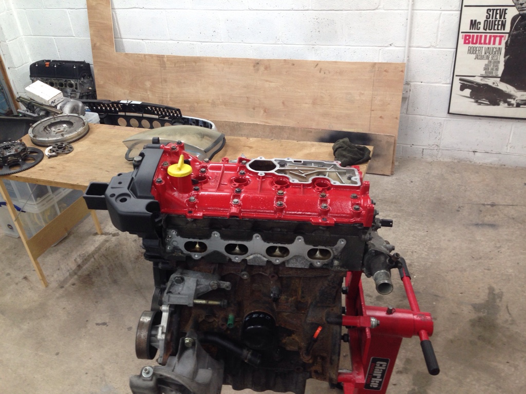

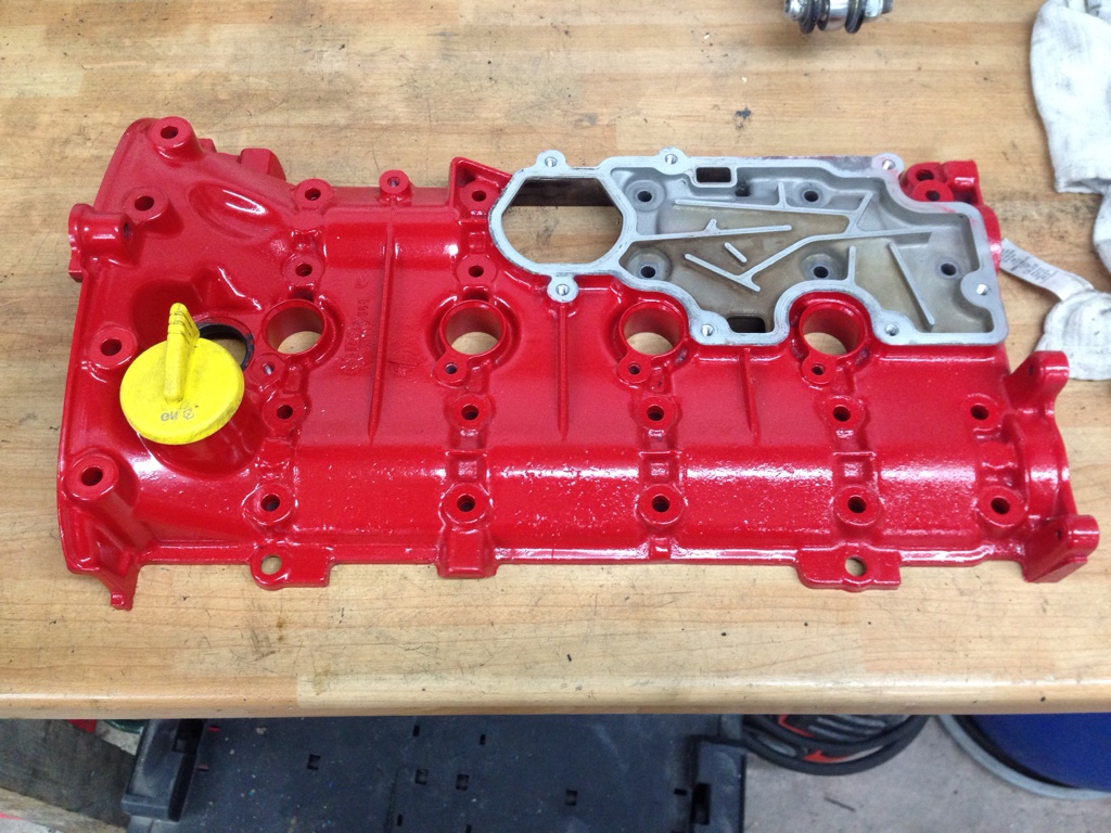

Got the rocker cover painted up in the customary red.

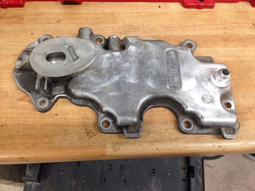

Breather plate modified, just need to run it through the parts washer and paint it.

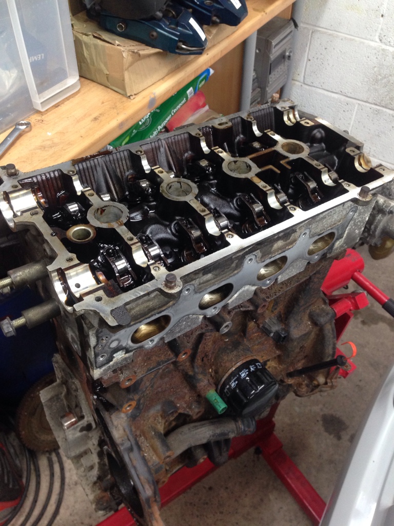

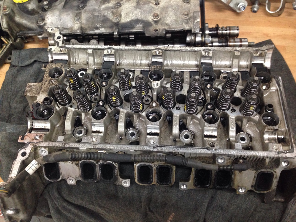

Got the arp bolts fitted and refitted the sump with new gasket. New tappets in and rockers refitted. Just need to put the rocker cover back on and time it up with new belt and it's sorted.

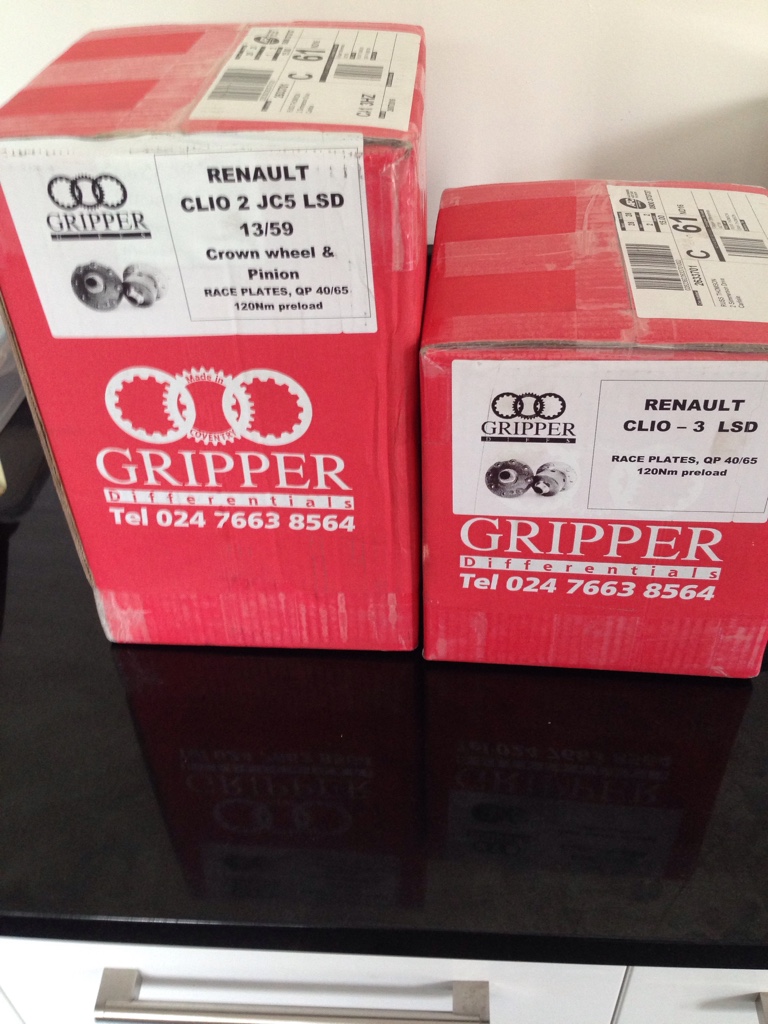

Diff has arrived also to rebuild the 'box to its previous spec, going to my gearbox guy once he's finished a customers 'box, hence the mk3 Clio gripper in the pic.
Gearbox parts are all here too, shorter 5th gear(s), new linkage pivot bush/circlip and new 5th gear cover and seal.

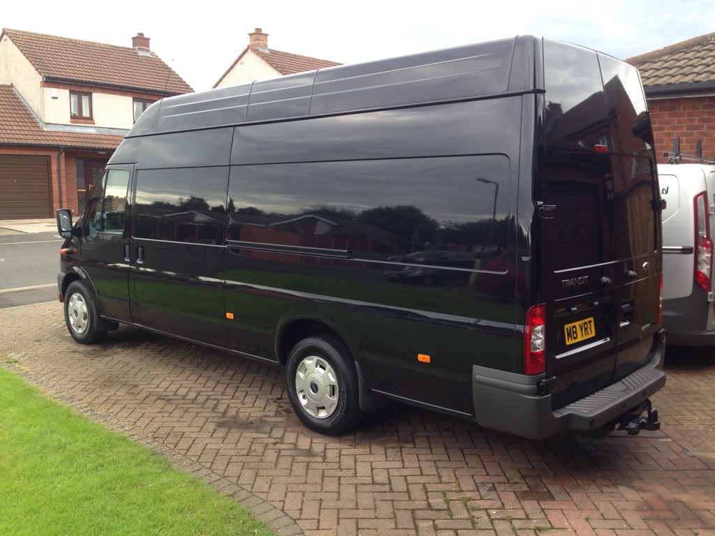

In alternative news, the van is fixed (again) after going engine rebuild it was running sweet until the ecu decided to pack in, putting 2 and 2 together I think it's been the cause or effect of the faulty injector and therefore holed piston previously. Second hand unit off eBay all coded to suit by my tame Ford Tech and it's alive again. Have s couple of small jobs to sort but it should be like brand new! Even gave it a wash, looks good when it's clean.

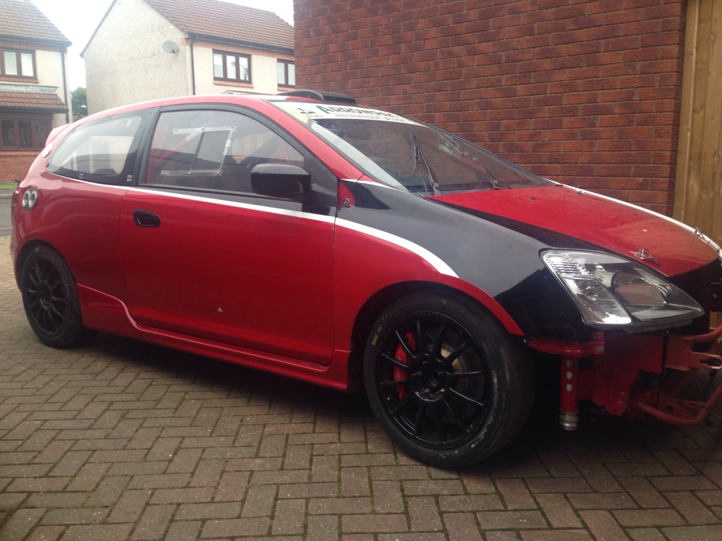

Alternative news 2 is I've decided to sell the civic racer I have as well. Getting this car back was unexpected and I want to concentrate on developing the Clio now so the cash will be most welcome!

Got the engine back together as far as I could. Cams in, new belt and dephaser kit fitted along with all new cam seals and hydraulic lifters.
Just need to finish painting the breather plate and fit my new alternator and it's done.

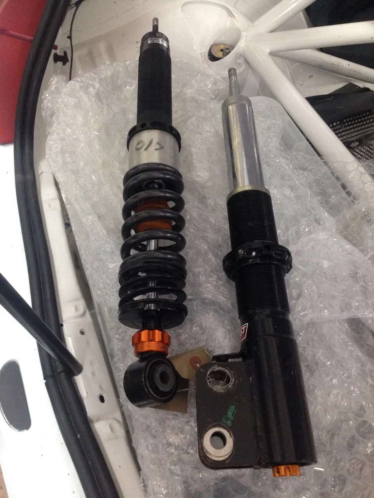

Sent all the AST's away to Cornering Force for a full strip/rebuild.

AST's are back from being rebuilt now. Just waiting for a different set of front springs before I put the fronts back together.
Just putting the rear beam back together with the rebuilt dampers and Pms anti-roll bar that I kept hold of. Rear beam bearings are good so a few jobs ticked off.

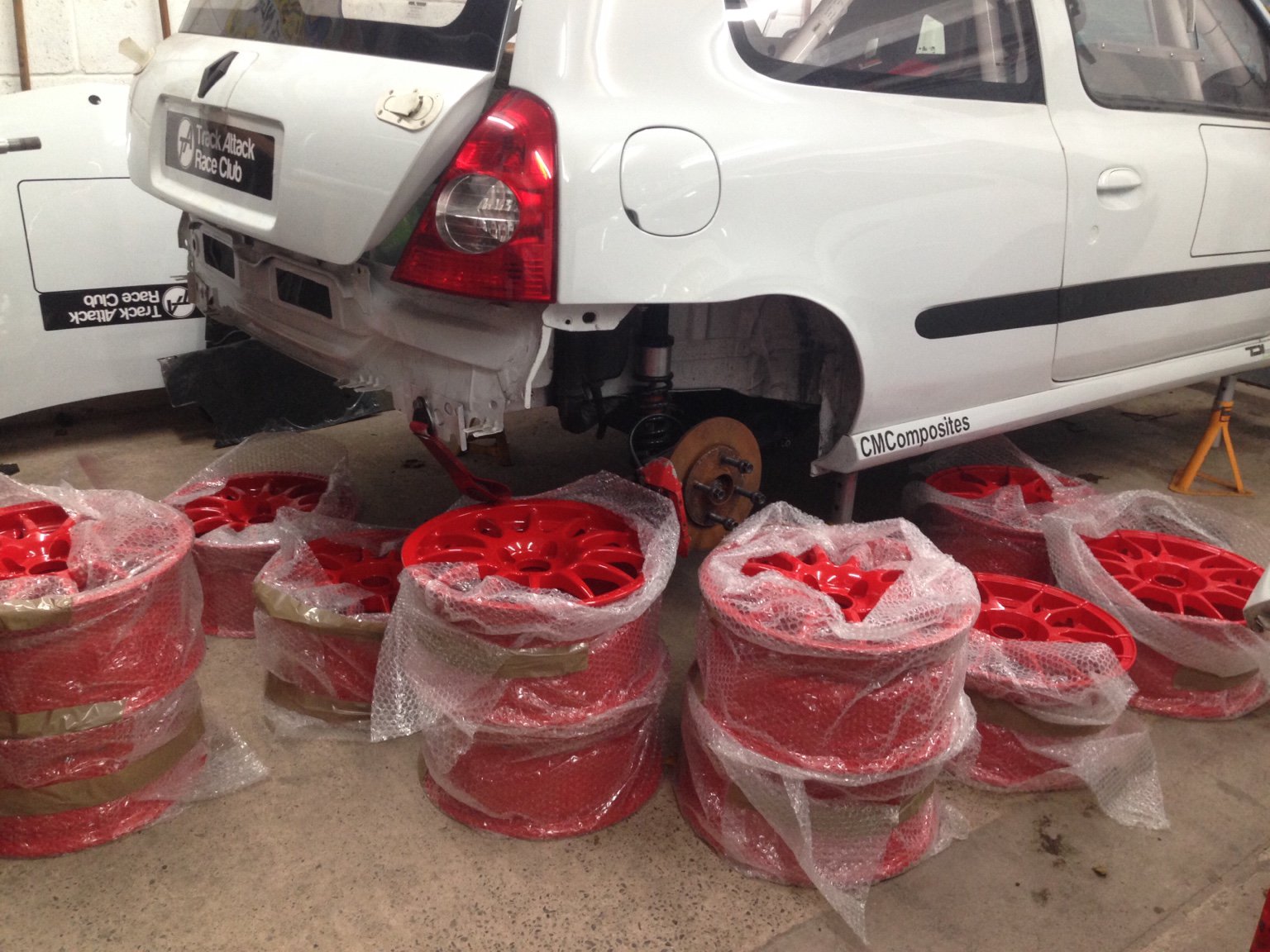

Some cosmetic bits, wheels are looking a bit shabby so all 3 sets going to be blasted and powder coated. 2 sets stripped ready, just need to do the other set of OZ's.
