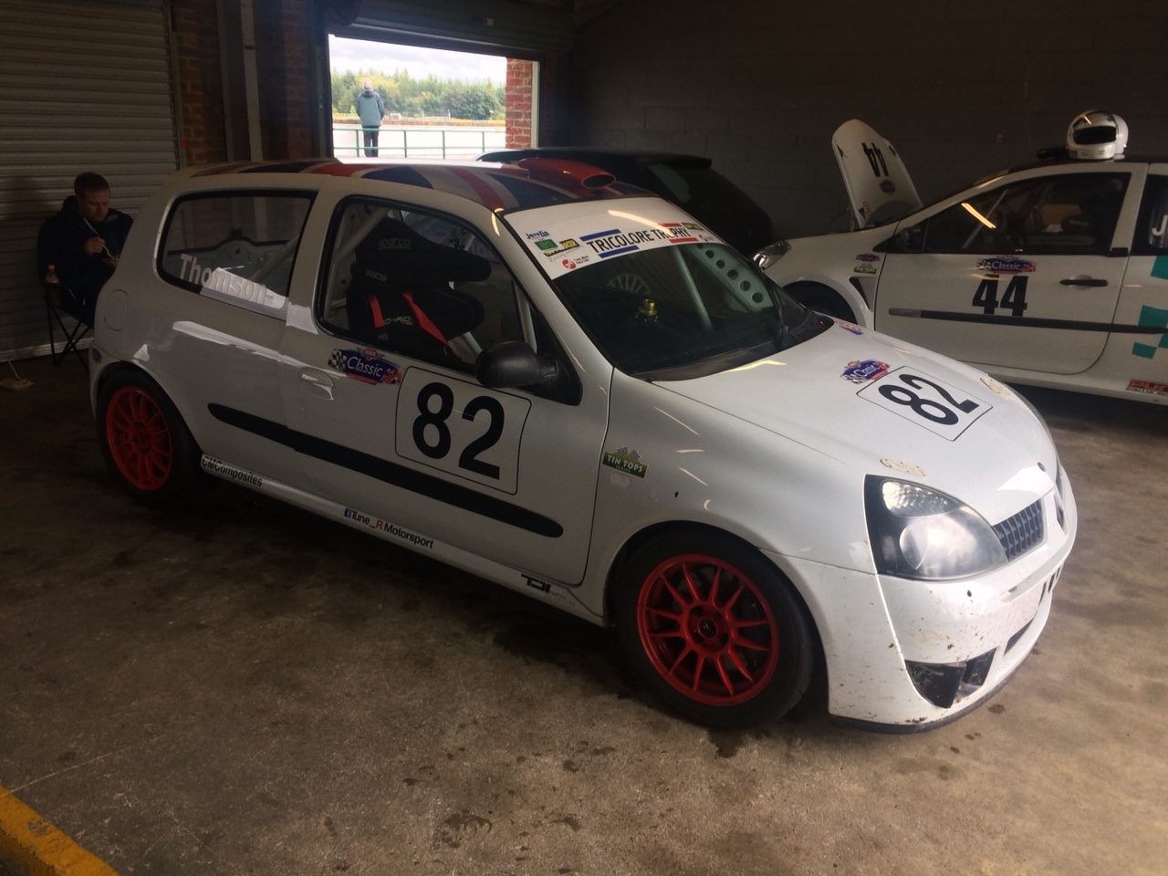

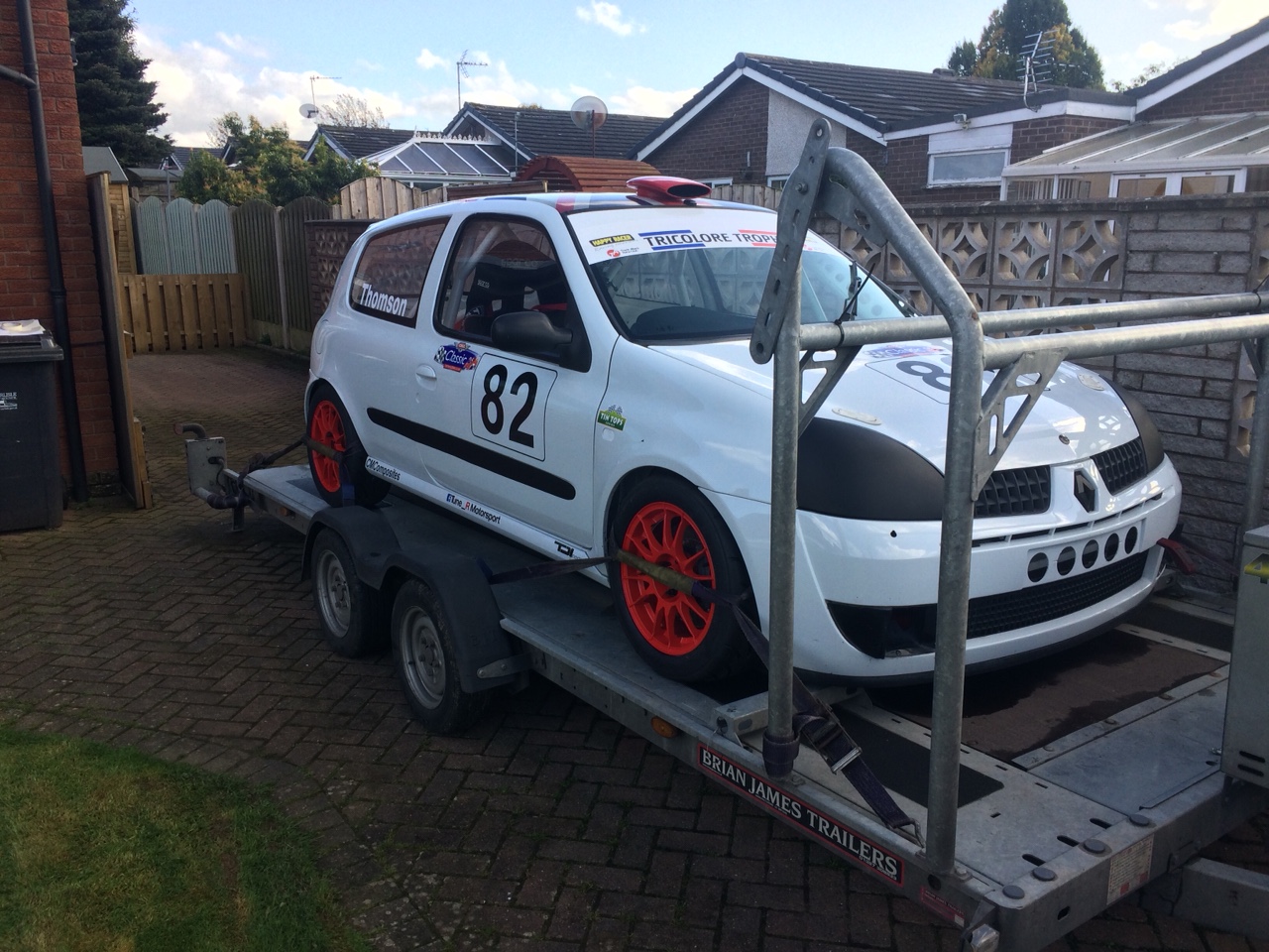

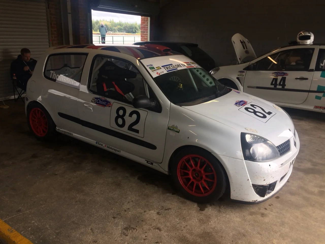

Croft tomorrow for a shake down. Nothing excessive, scrub the Dunlop’s in, bed some new pads in and do some fuel consumption checks + mostly scare myself a little after not driving it for 2 years!

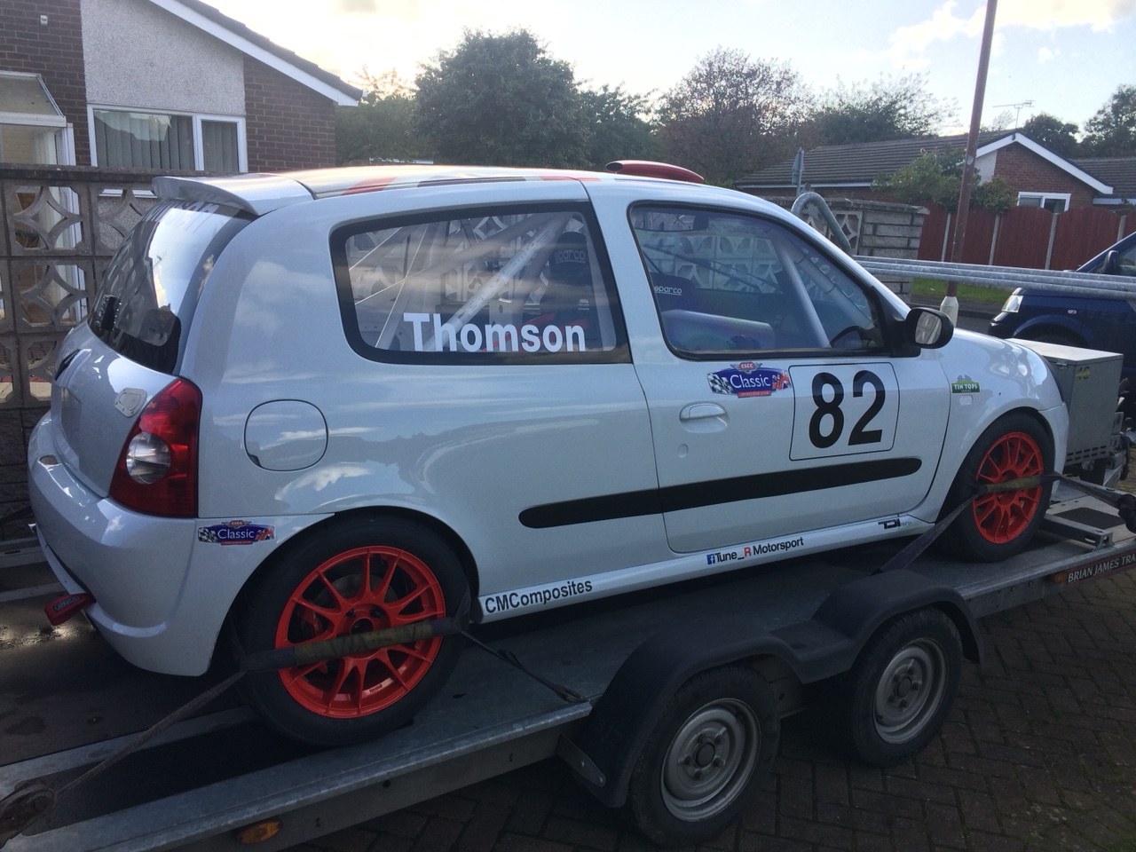

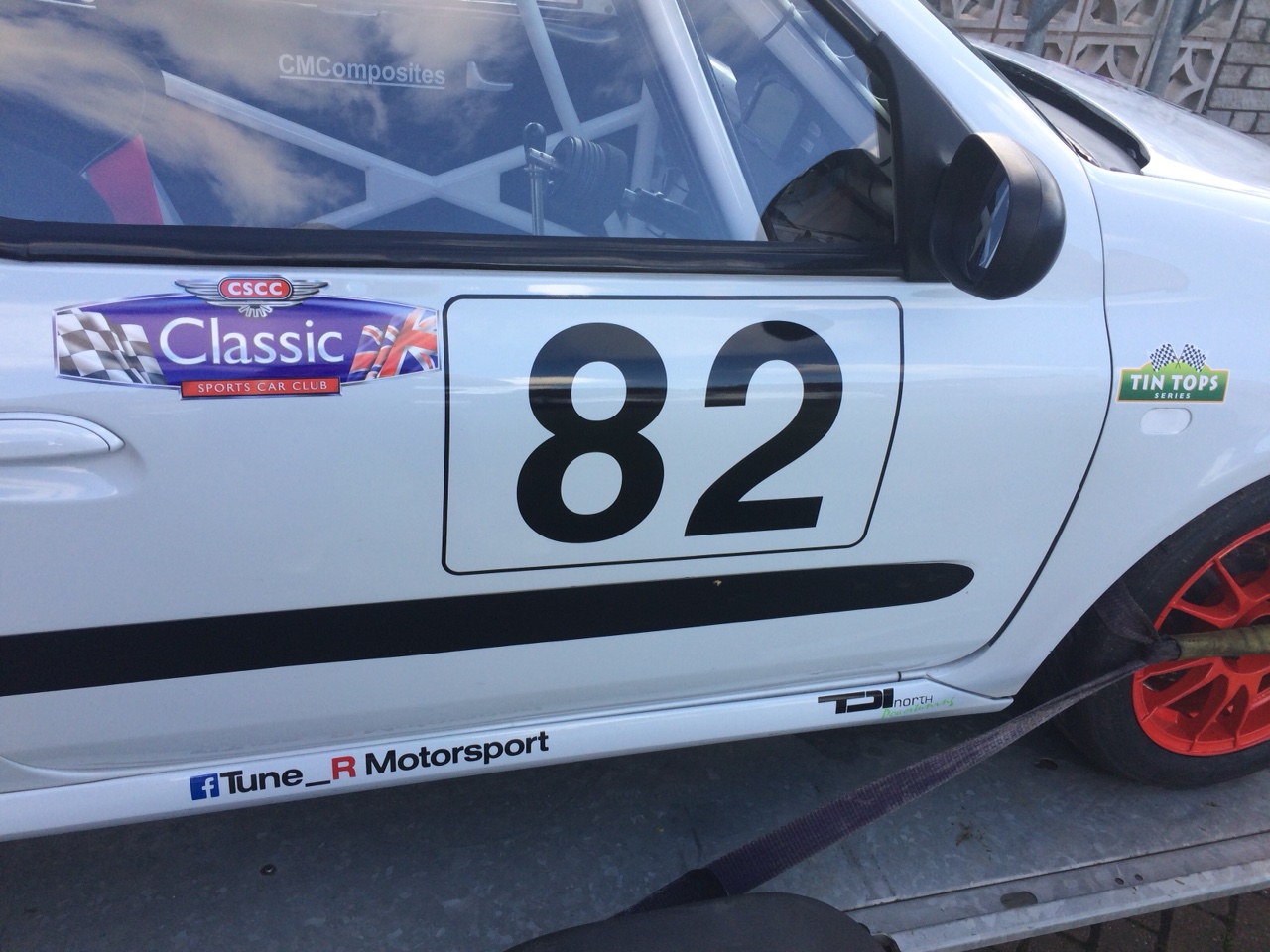

Gave her a wash earlier and got the cscc sticker kit fitted with my numbers.
All loaded up now and ready for the morning. Hopefully get a few videos.

Well..........
It’s not gone well! Long story short it’s dropped a valve and wrecked the motor this afternoon.
Went well this morning no issues and properly quick, forgot how much I love driving it!
On the plus side I got my new pads bedded in and tyres scrubbed in! Just won’t get to use them at Oulton now! @bob the builder where’s that engine I sold you! Lol

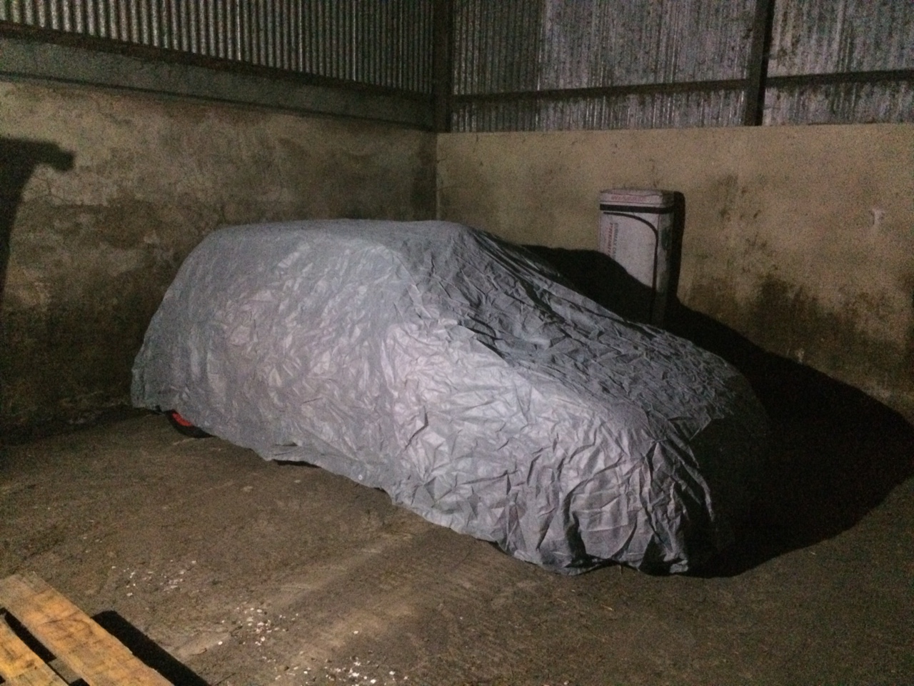

Not a lot going on, not touched the car since I blew it up. Have plenty of engines here now to build a new one(s) with. Think I’ve got 4 in total. Anyway, last pic from when she was running.

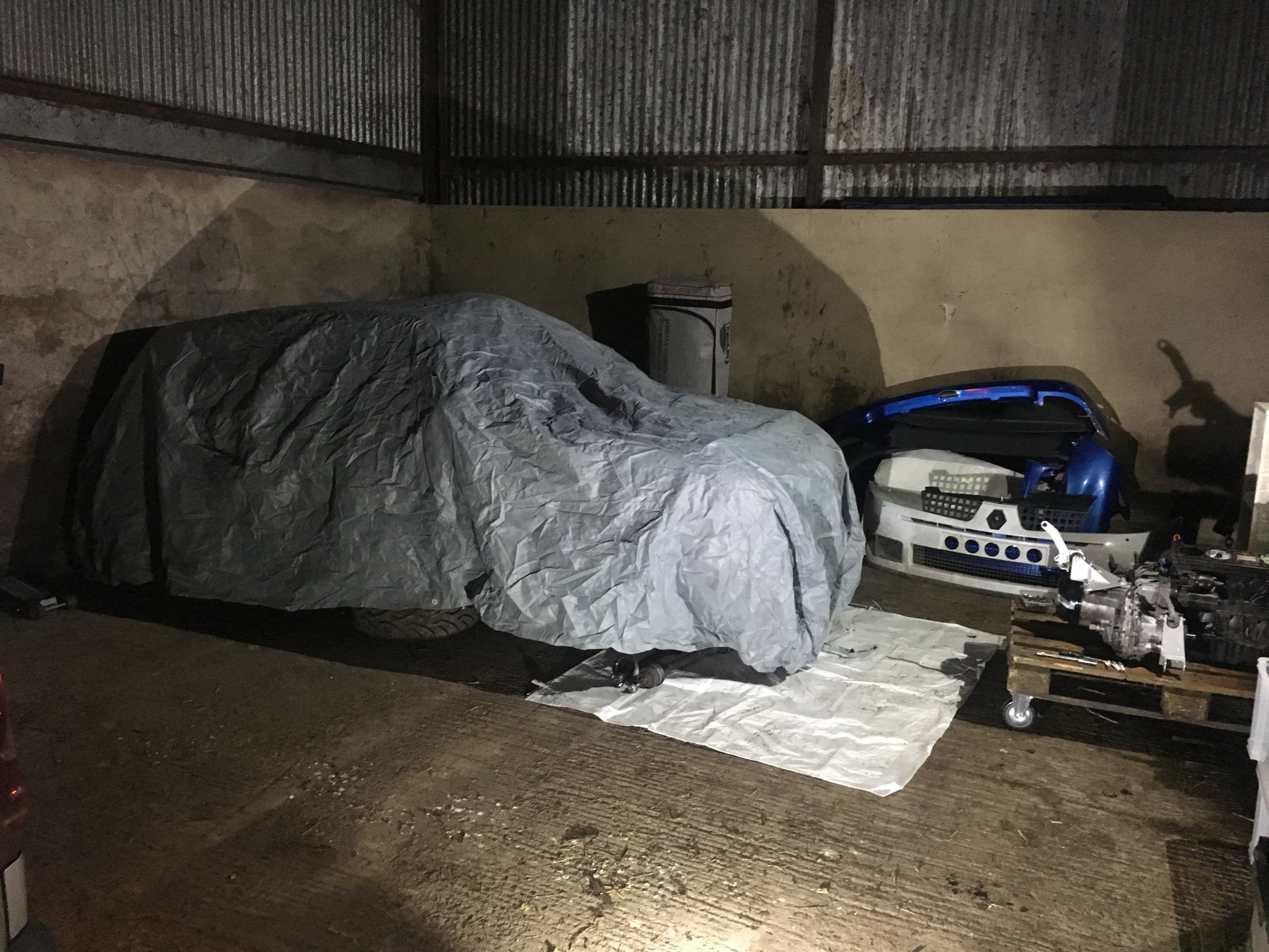

And now, tucked up in storage in the middle of nowhere as I’ve sold my house.

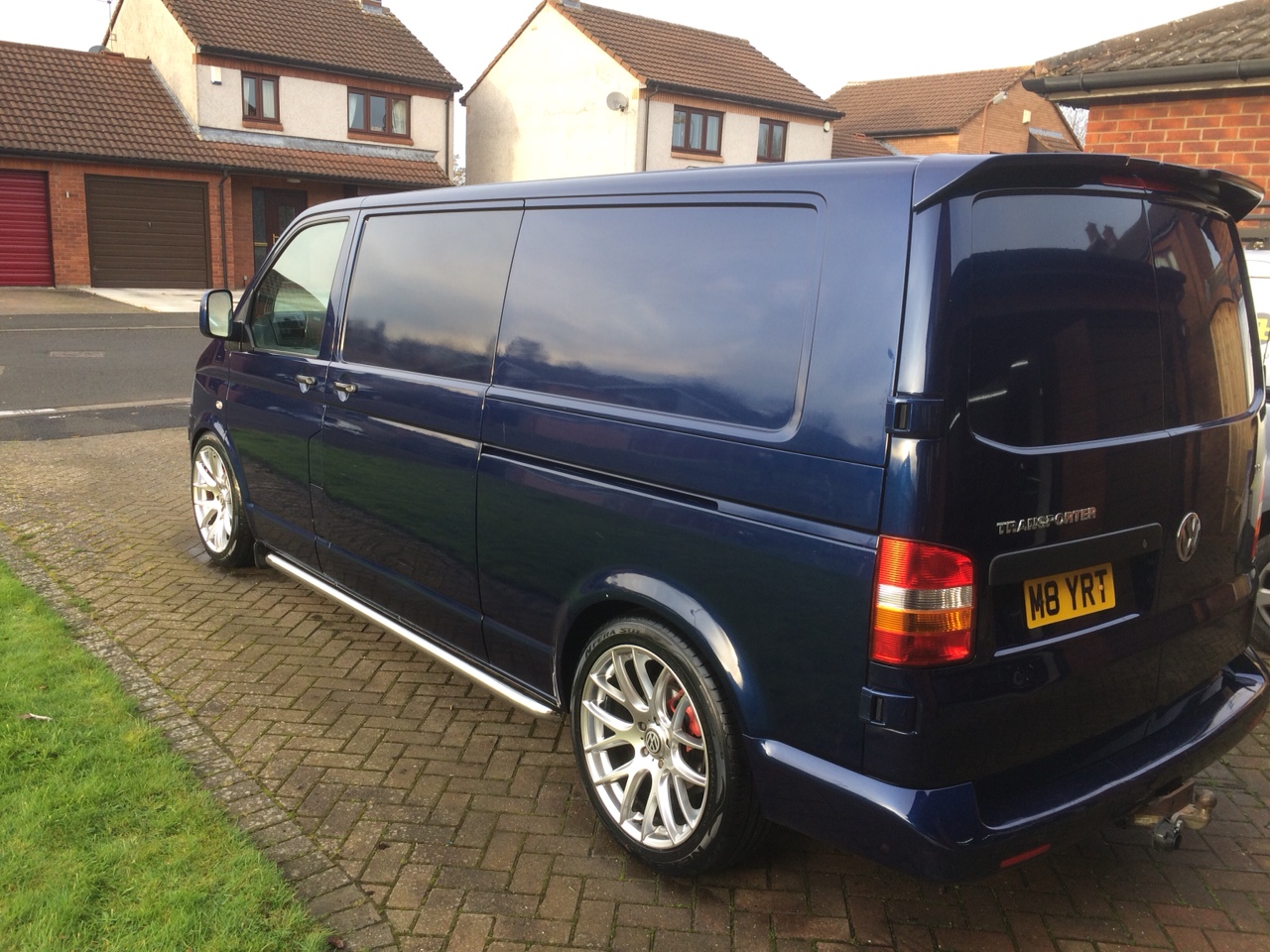

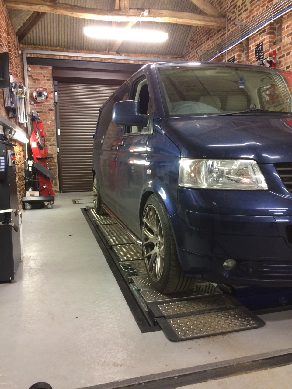

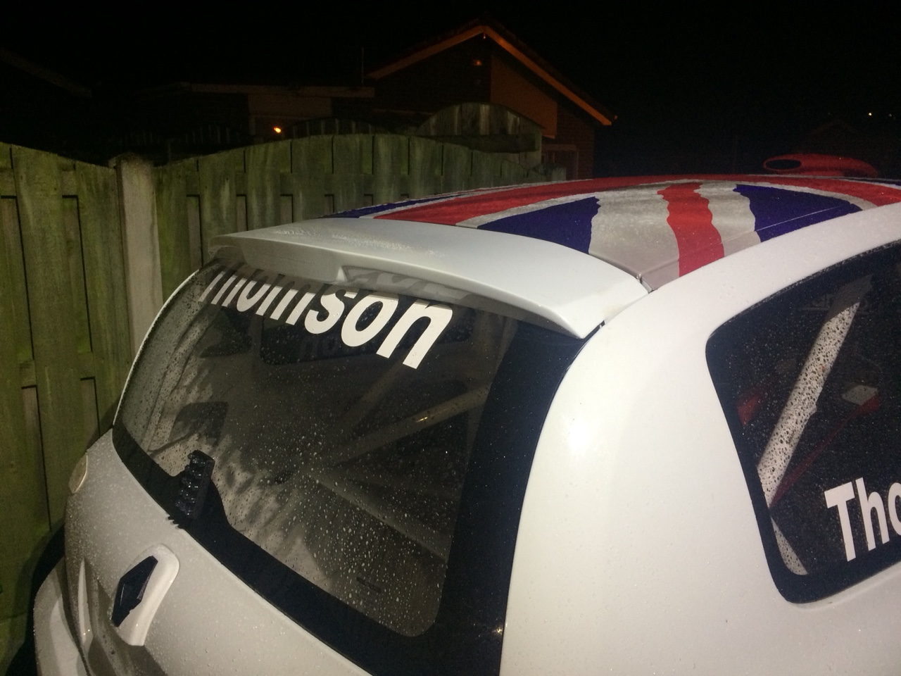

In other news, been tidying up my T5 Transporter with some wheels, bilstein coilovers and some sportline side bars.
Still got a front spoiler to go on and some windows before I do the inside.

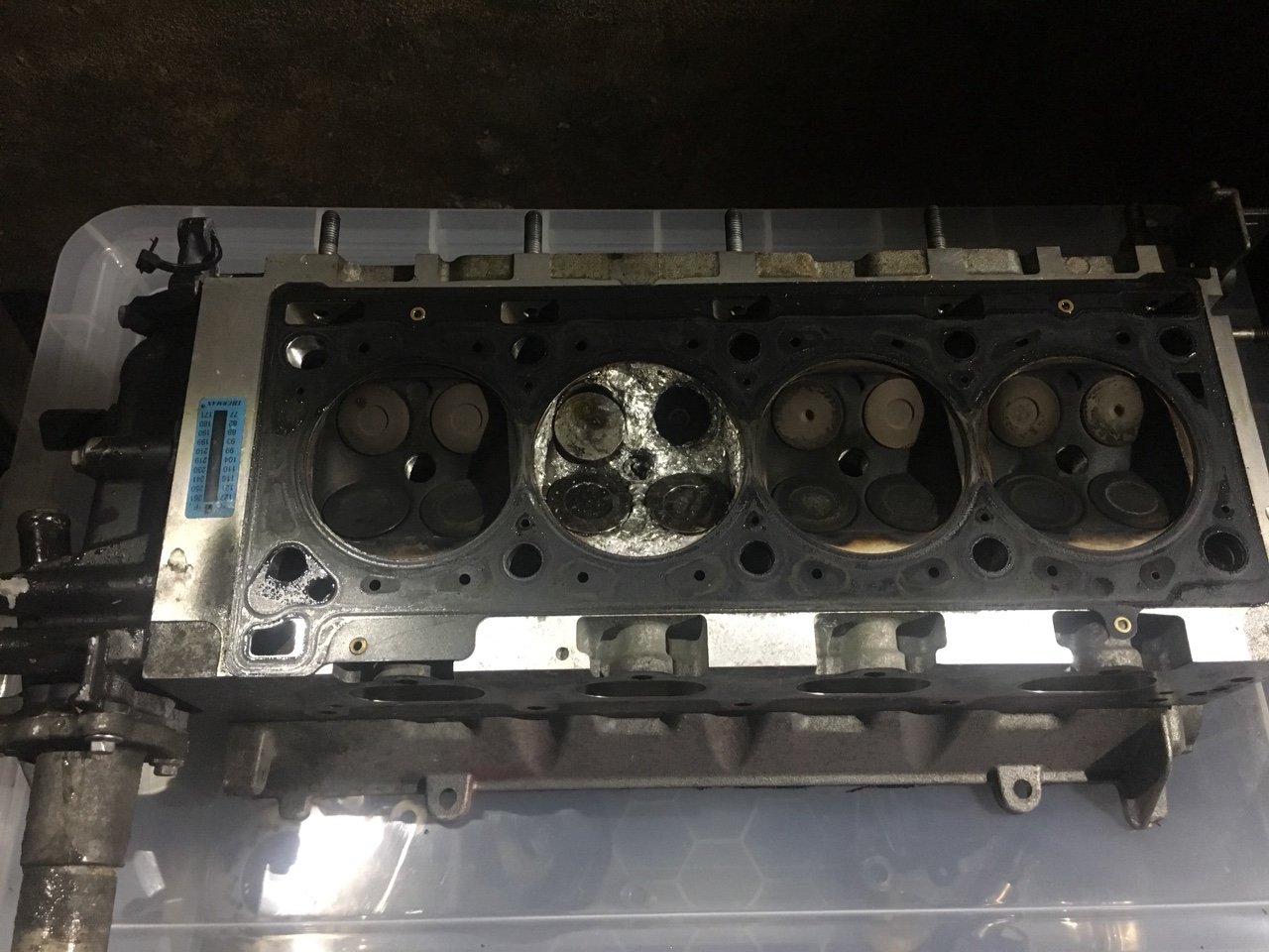

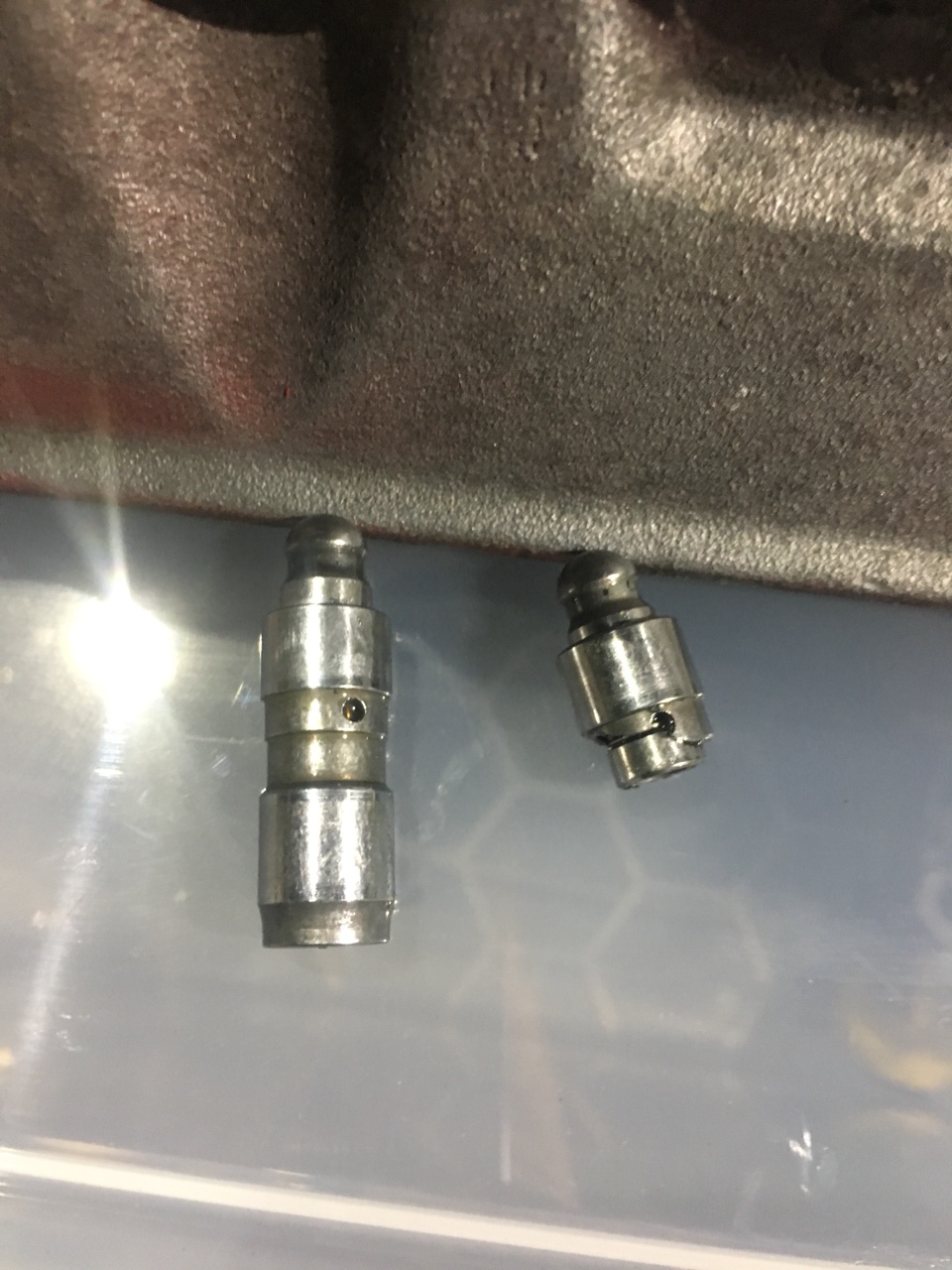

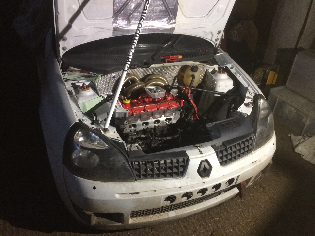

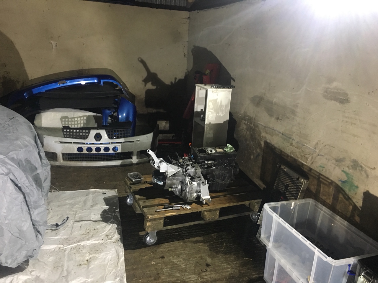

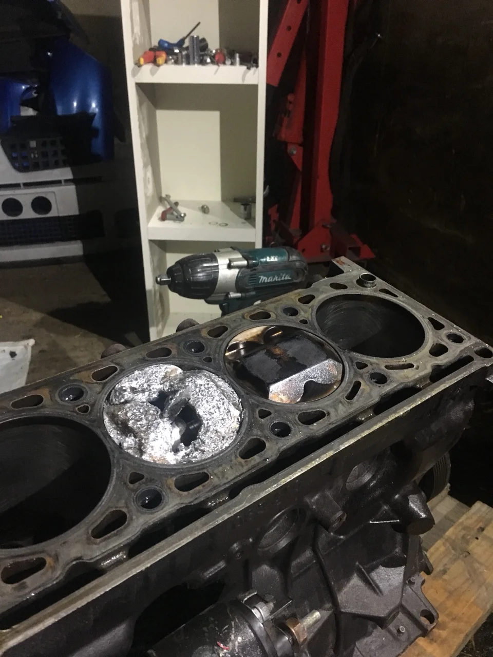

Started stripping Nicole, didn’t intend to get as far as I did. Got everything off the engine and ‘box to allow me to get it out of the car, fluids drained etc.
Only took me 3 hours from complete car to engine put and stripped down. Forgot how easy it is to work on. Just aswell as it’s in a friends barn with one power, lights or heating etc and it was freezing today!

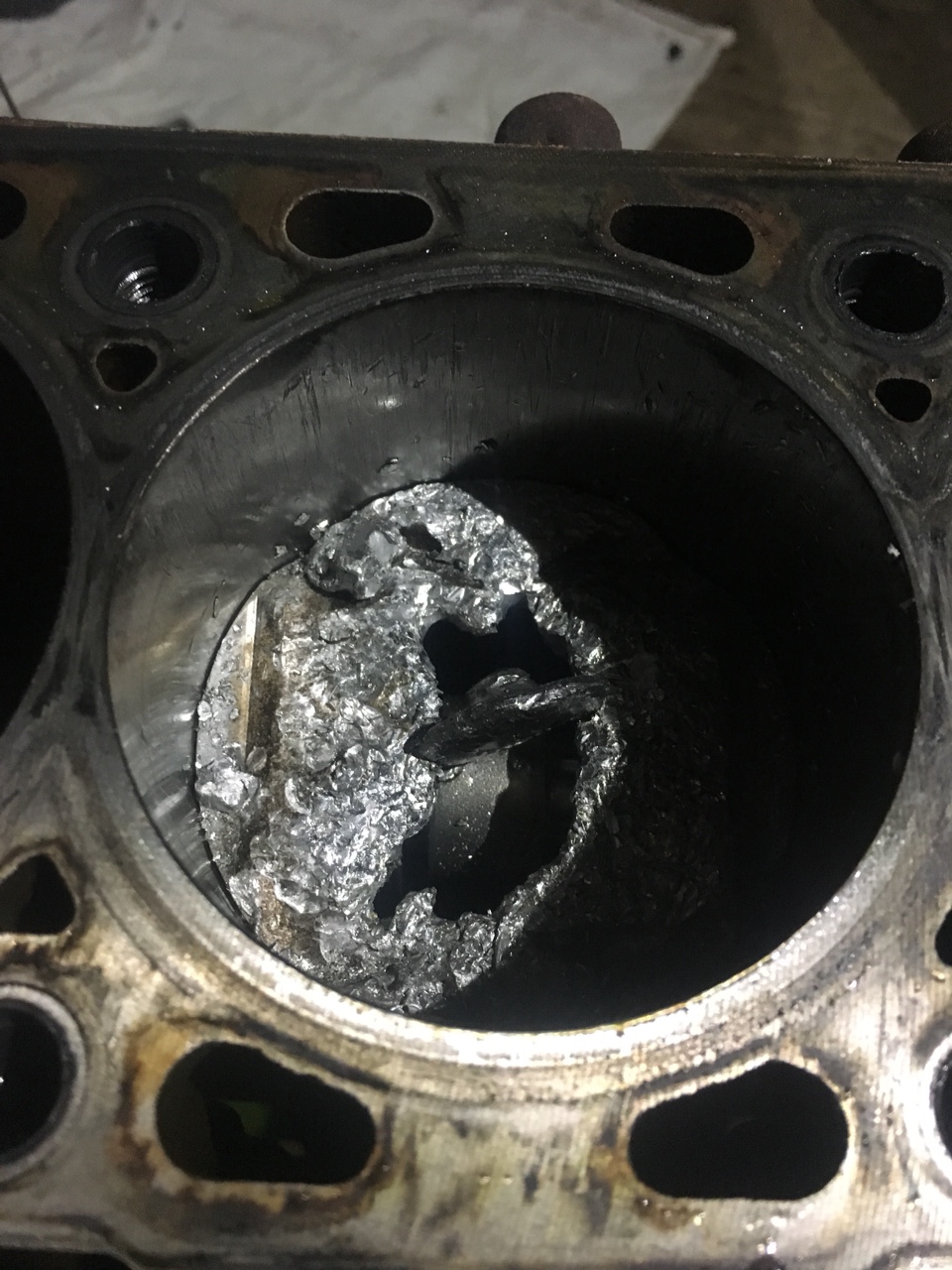

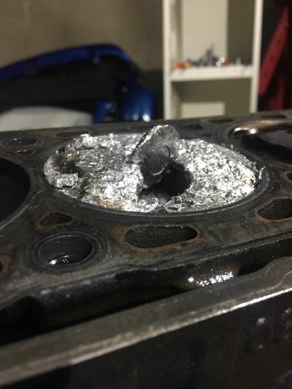

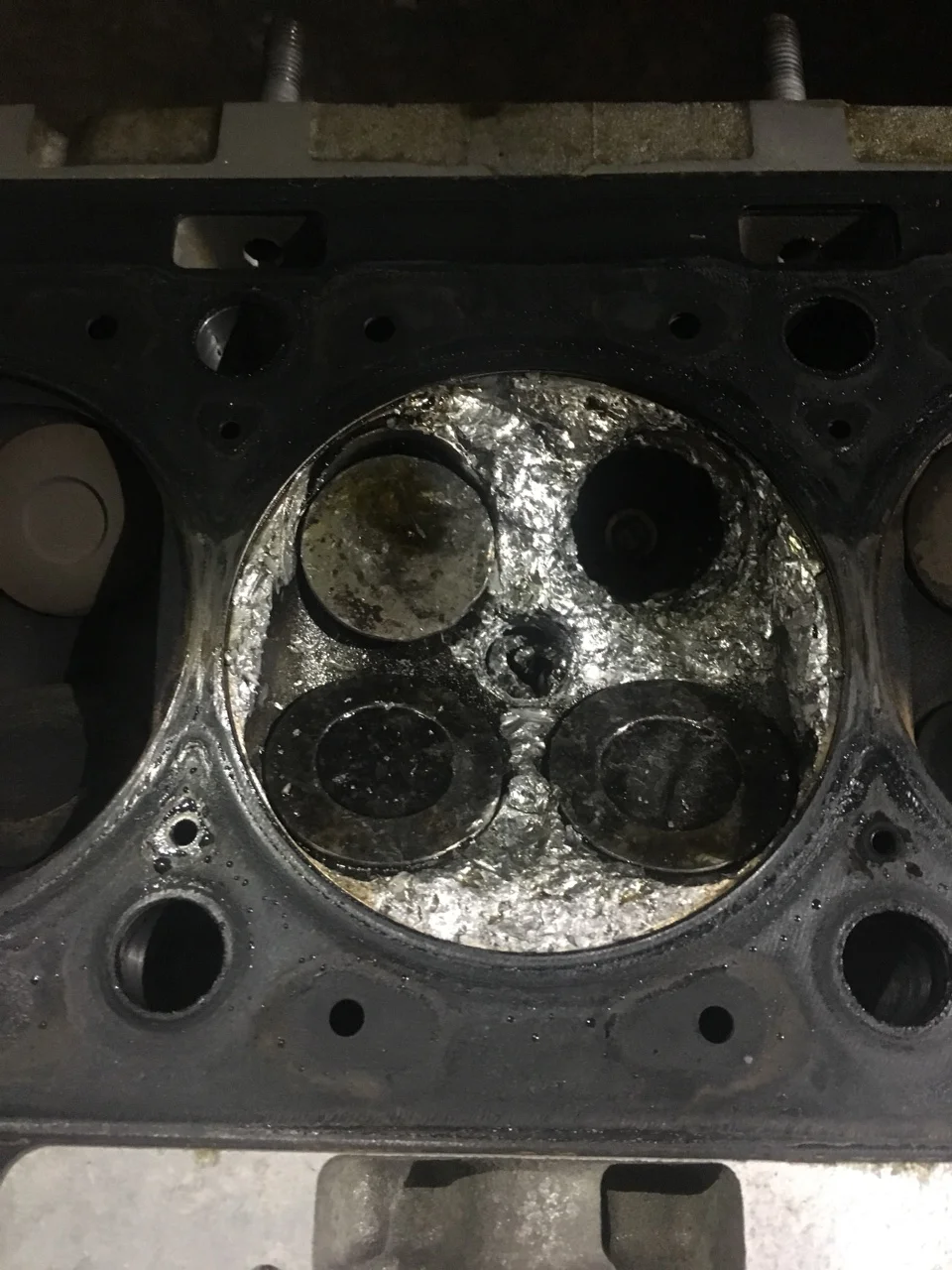

As suspected it’s FUBAR!
It’s dropped the exhaust valve head on cylinder #2 and wrecked the head, the piston, scored the bore and also snapped a lifter on #2 inlet valve, not seen that before.
One for the trophy cabinet too, Valve head is properly embedded in the piston.
Plans are afoot to get an engine built back up ready for the start of the season. Got some bits on order so hopefully timescale is doable.

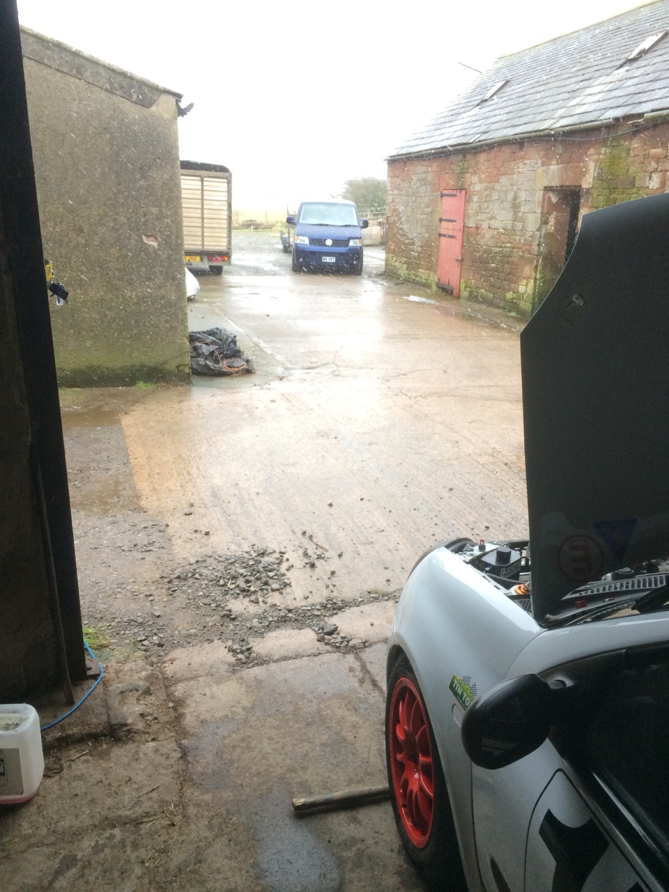

Well Nicole’s alive again, again!
Runs well, takes throttle and drives ok so map hopefully isn’t too far off, a trip
To Paul @TDI North will sort that anyway.
Drove her outside, needs a good clean as she’s filthy but all good. Just gotta refit the oil cooler and put the proper oil in, needs my number 15’s putting back on aswell I guess.

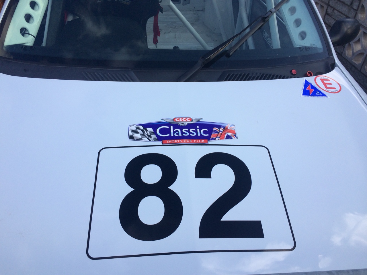

EVO 4LEX
  Golf R and a 172 Cup
Always keep an eye on this build! Good luck on the rollers tomorrow!
One question, the centre bonnet pin, do you have a pic of where you have mounted the pin, from zooming in it looks as though it’s at an angle off maybe the bumper? It’s a nice neat solution to keep the centre of the bonnet from flapping!
