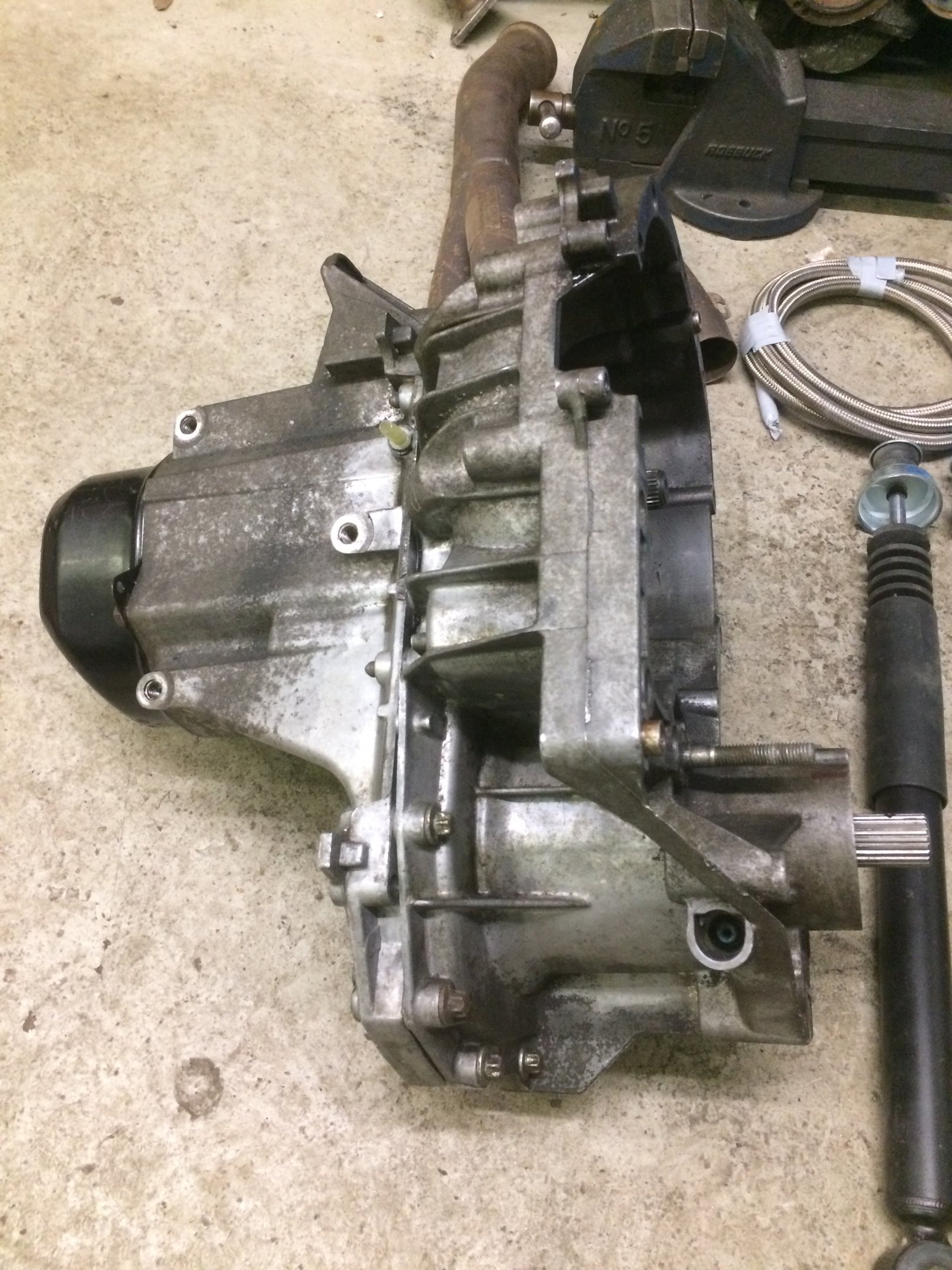

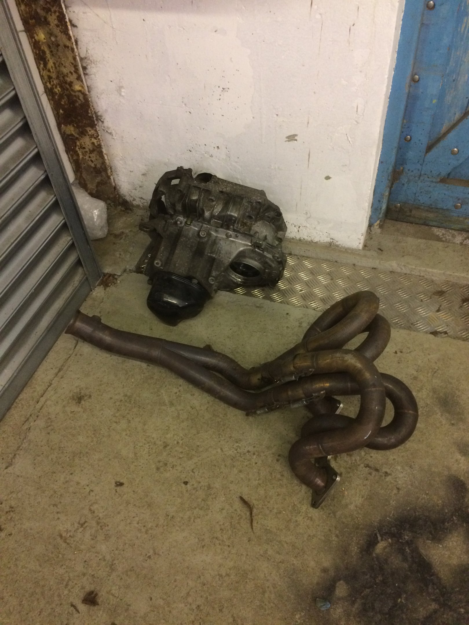

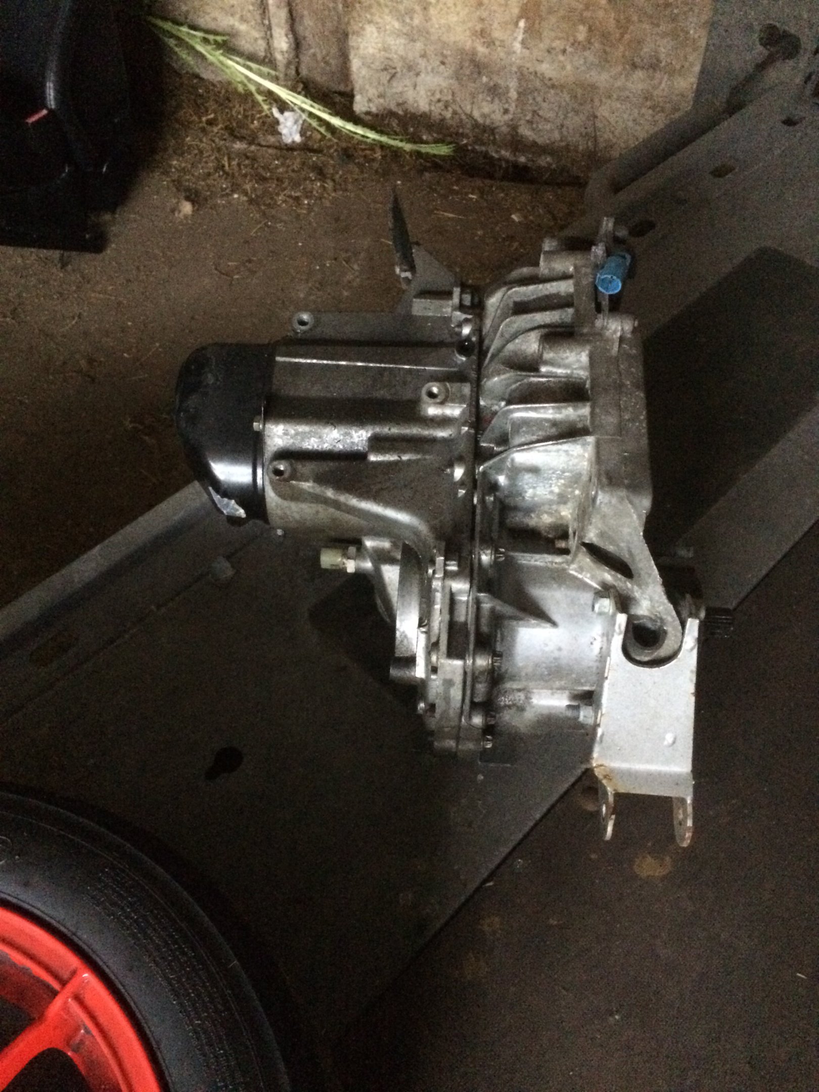

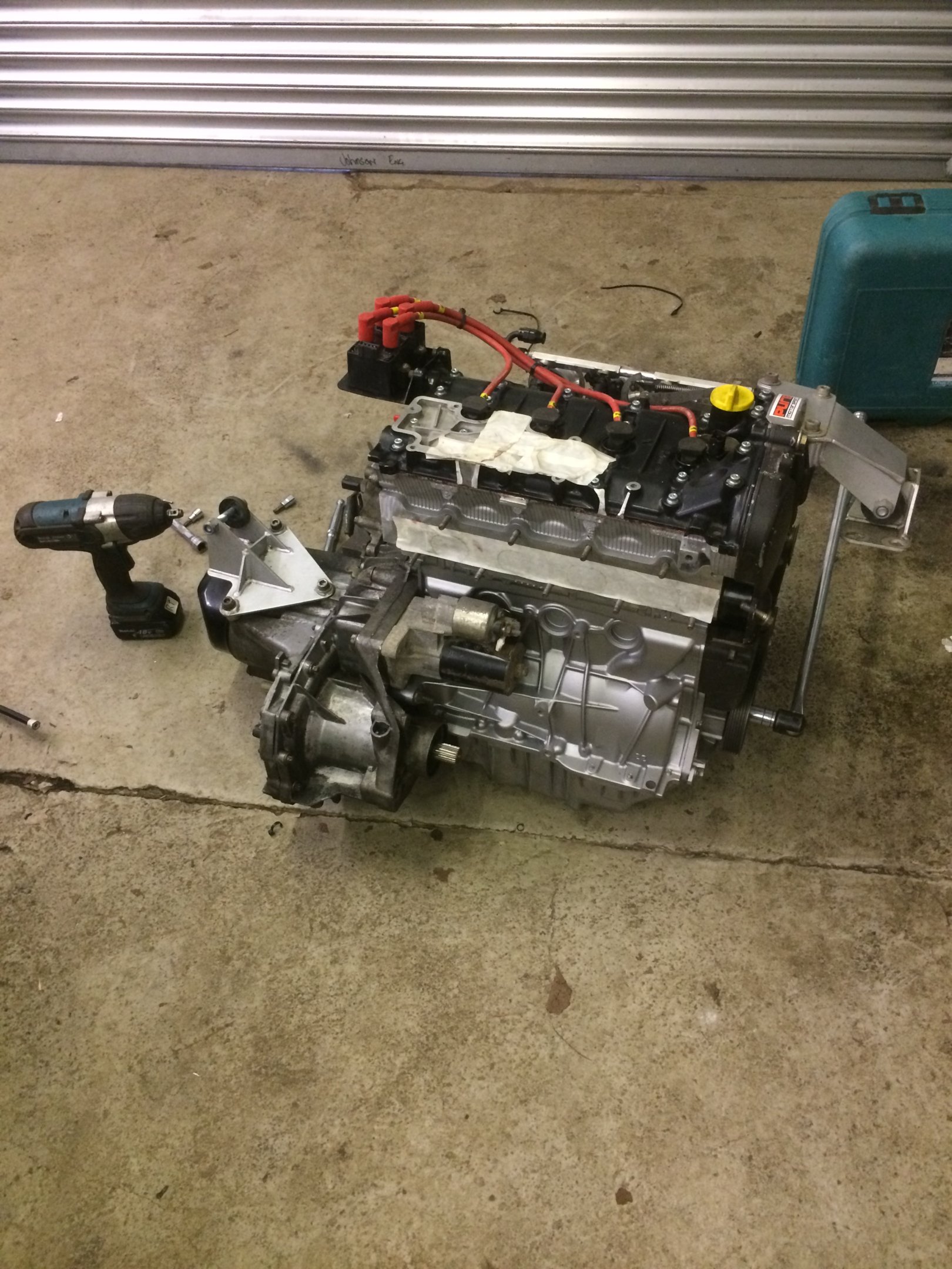

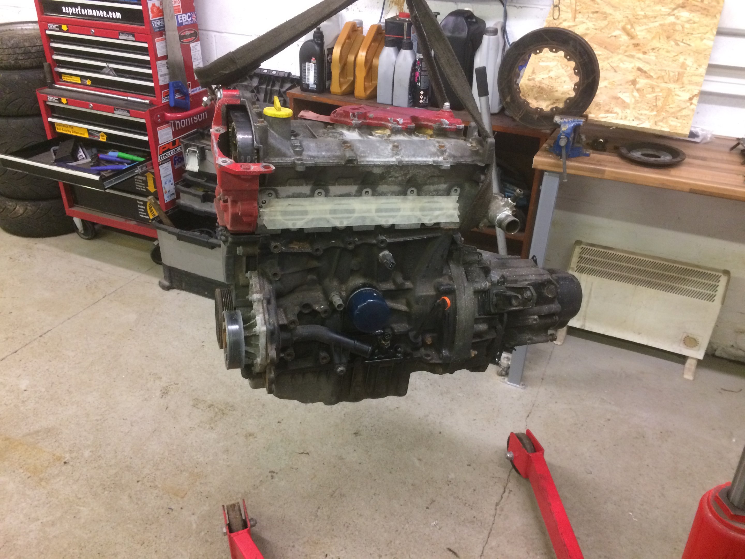

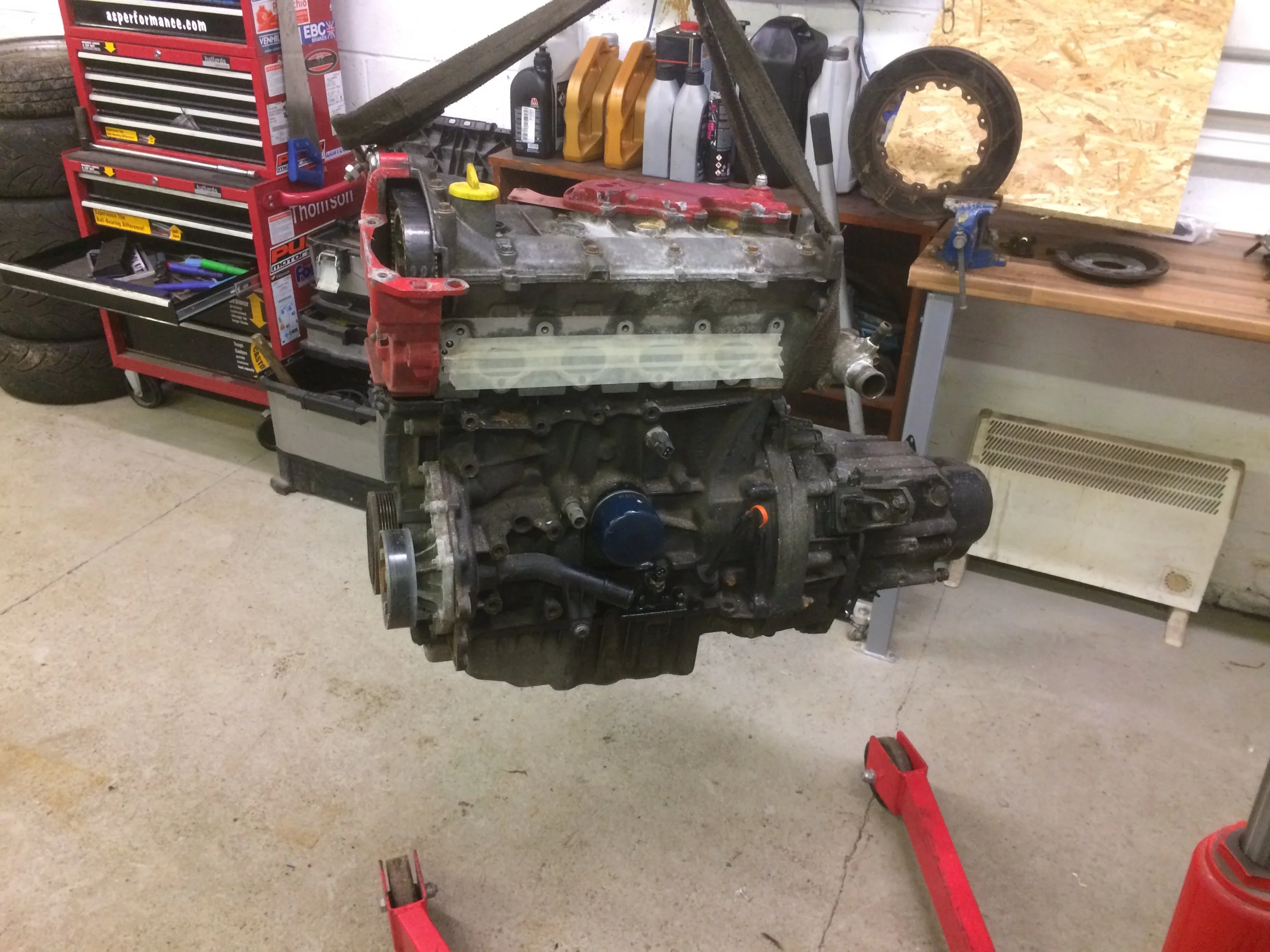

Gearbox is out, decided to drop the subframe and take it out from underneath for a change, I normally just pull the full lot out of the top but I find it a bit fiddly refitting with the pure mounts now. It’s certainly fiddly from underneath and took 2.5 hours, I can pull the whole lot out from above in a similar time.
Anyway.
Dropped it off on Tuesday night and my man stripped it on Wednesday.
Needs a 3rd gear, 3rd/4th synchro hub and 3rd gear synchro ring. Everything else is fine apparently. Ordered the bits from Nick @pure-motorsport today and are due tomorrow so hopefully be all built back up next week and ready in plenty of time for Silverstone TARC meeting on 29th July.

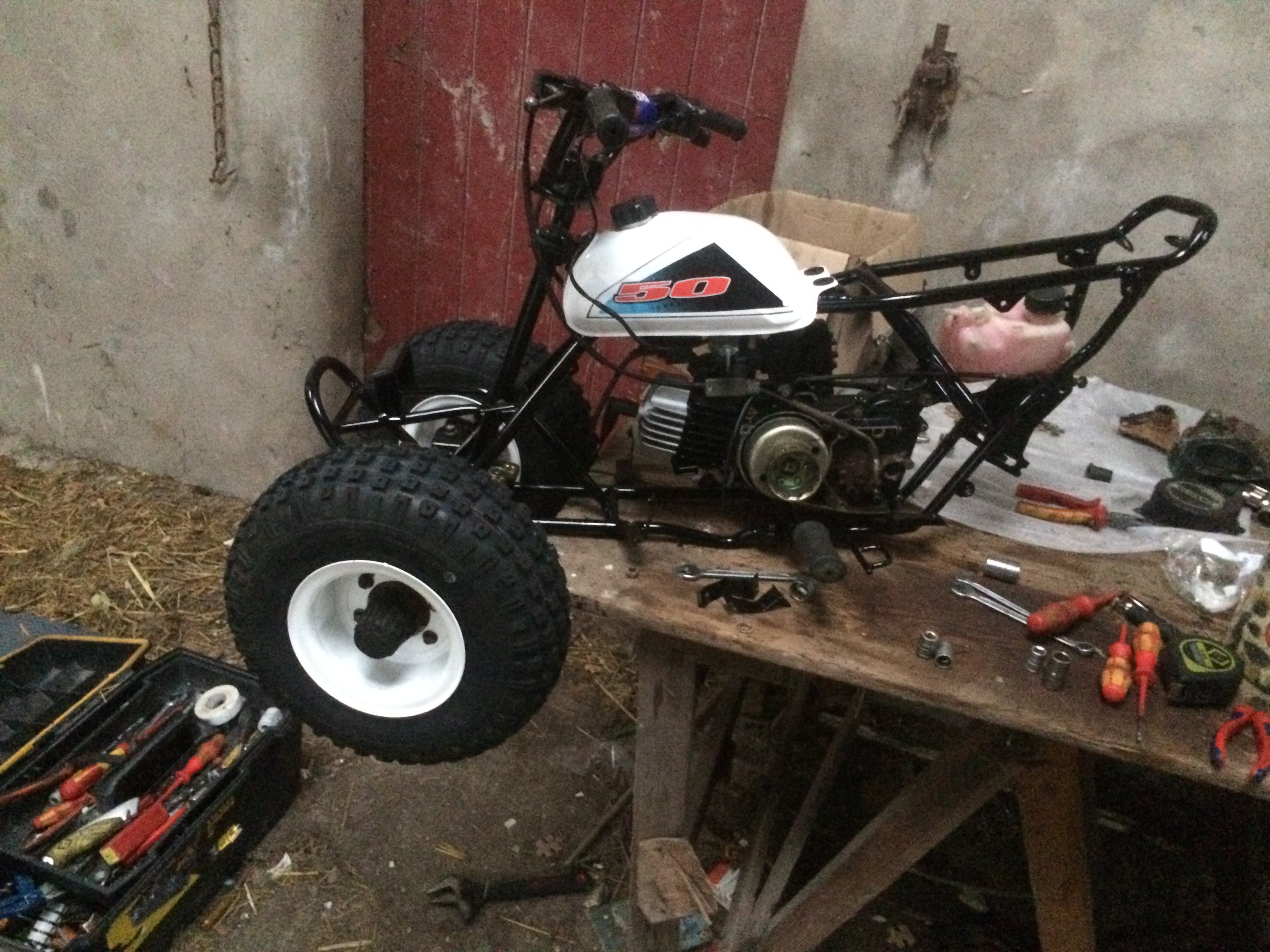

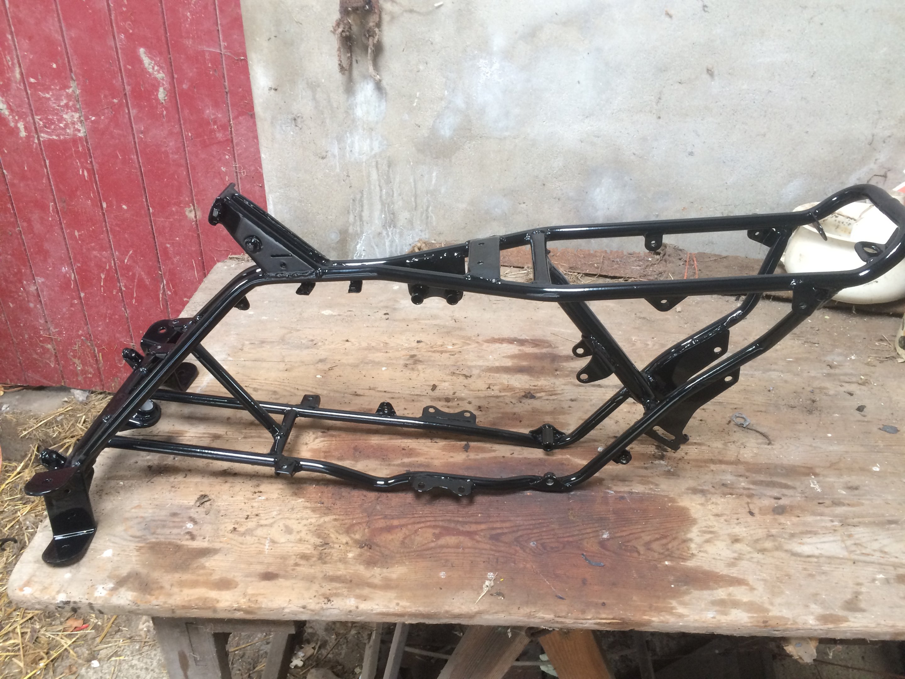

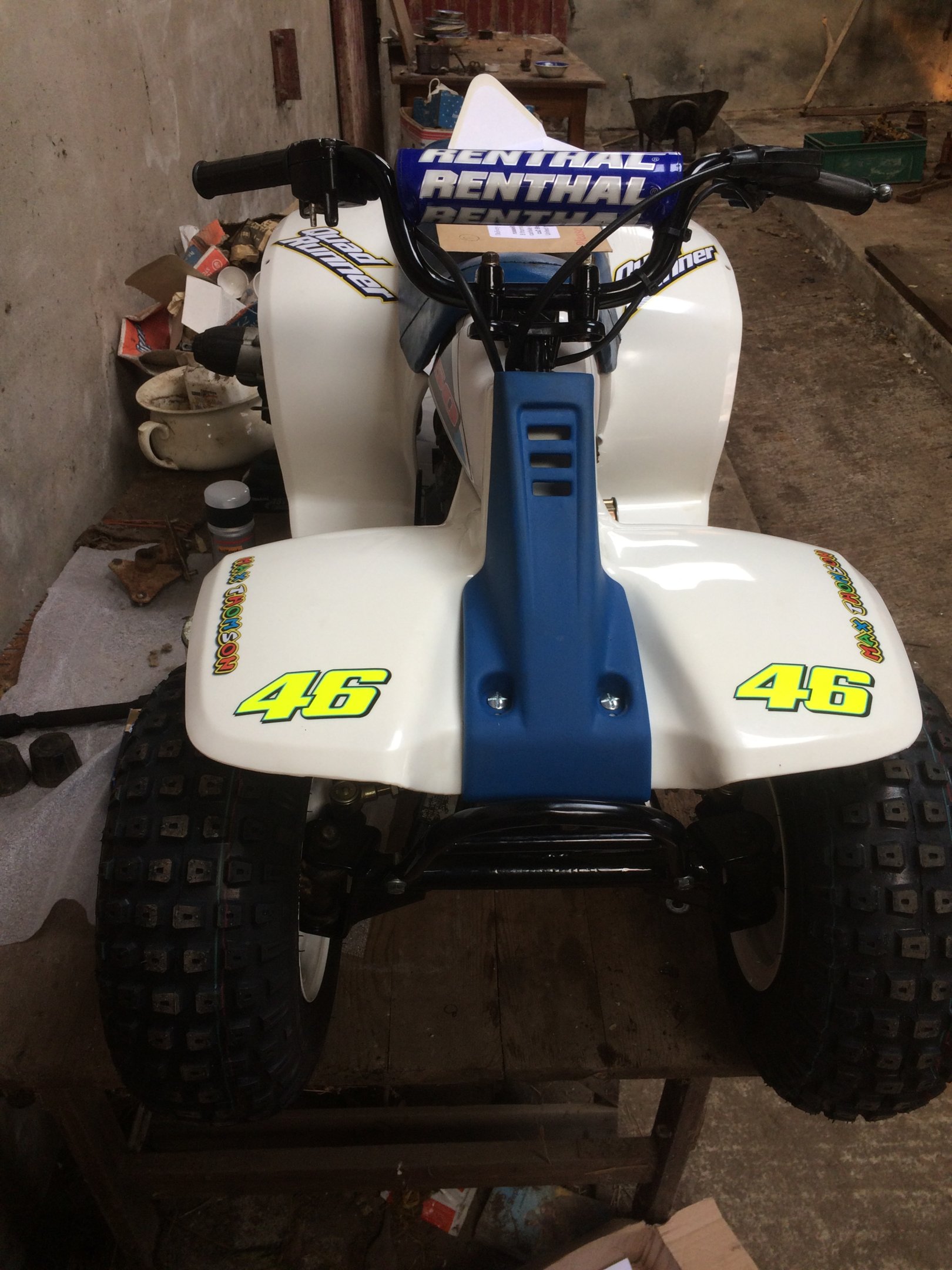

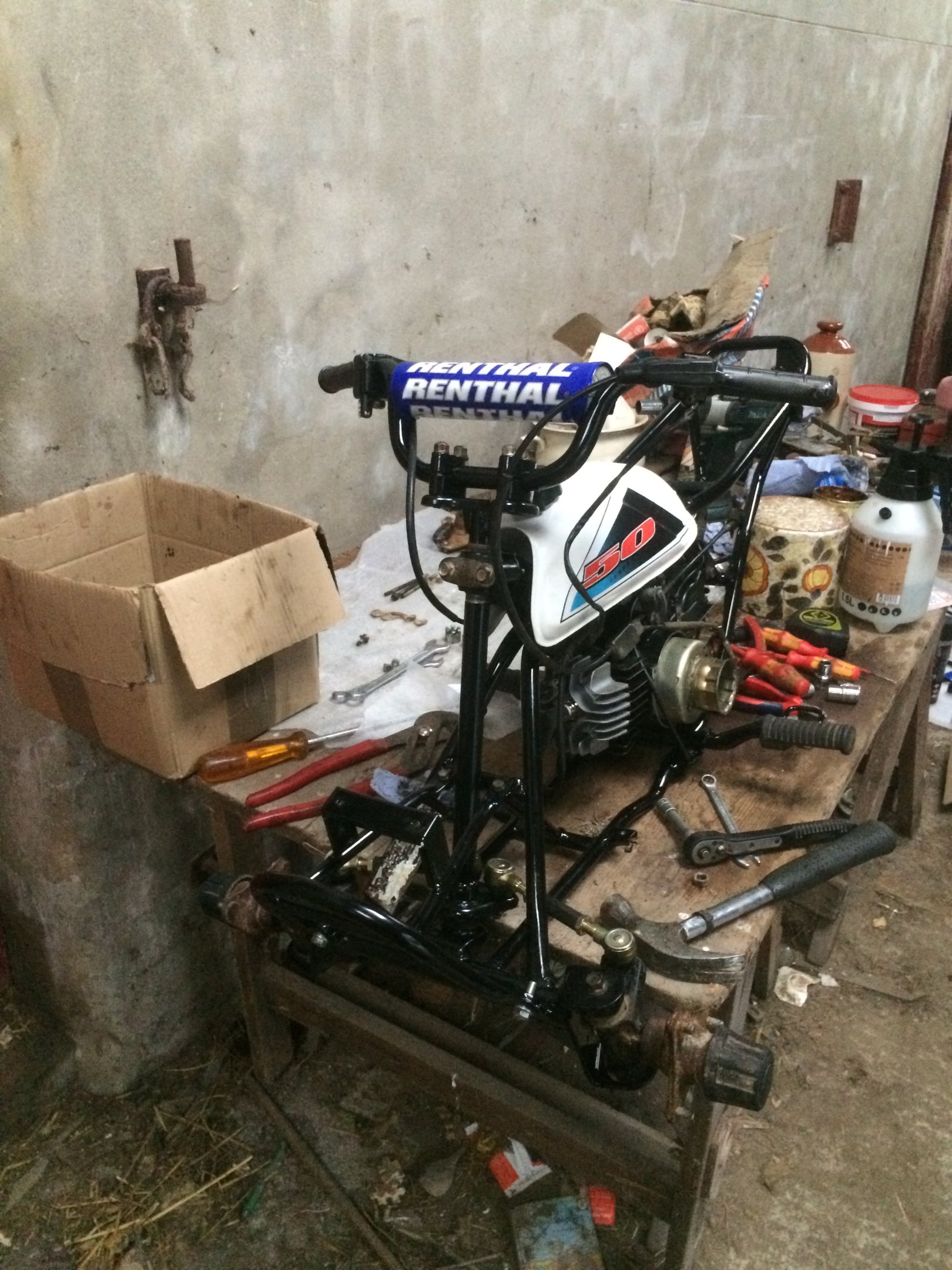

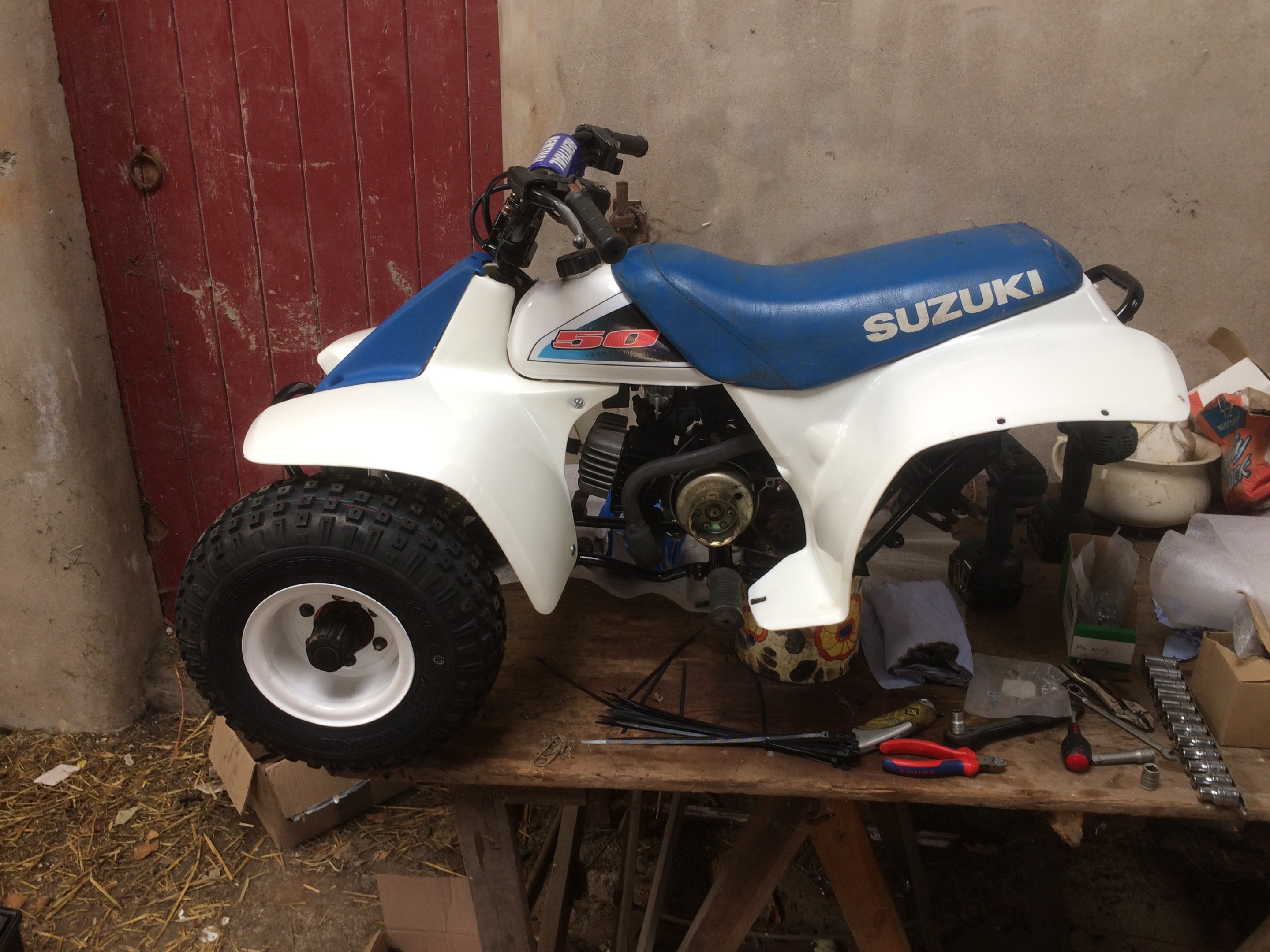

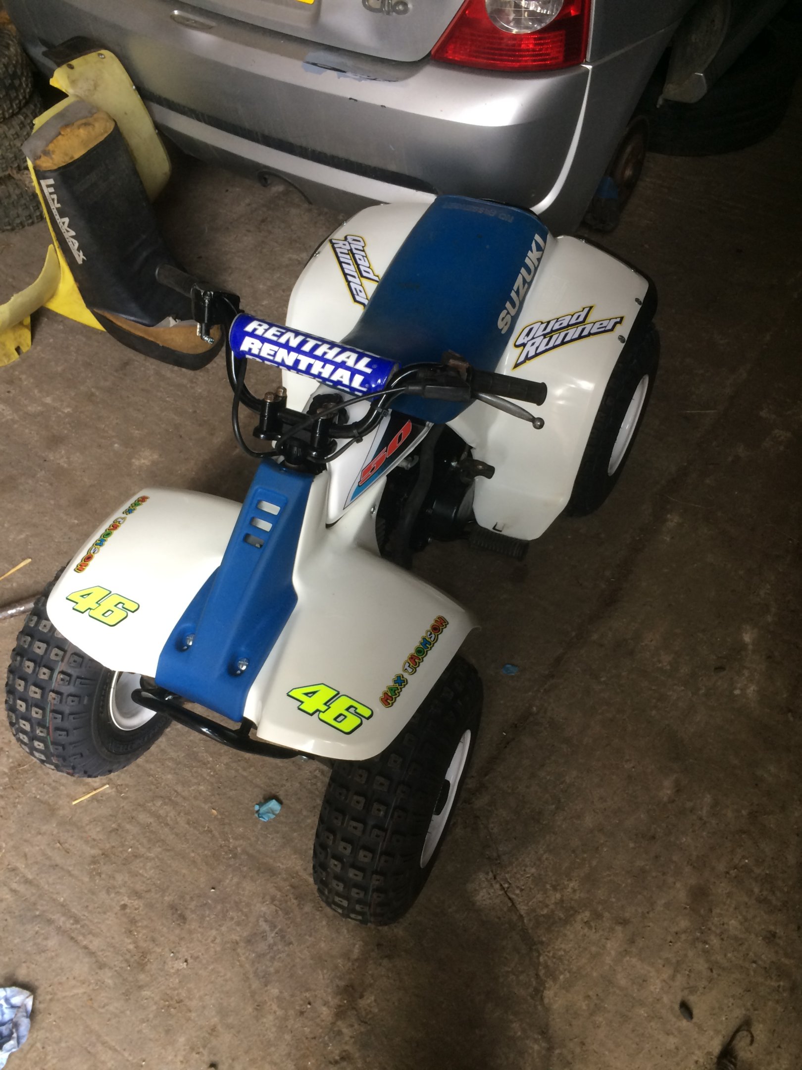

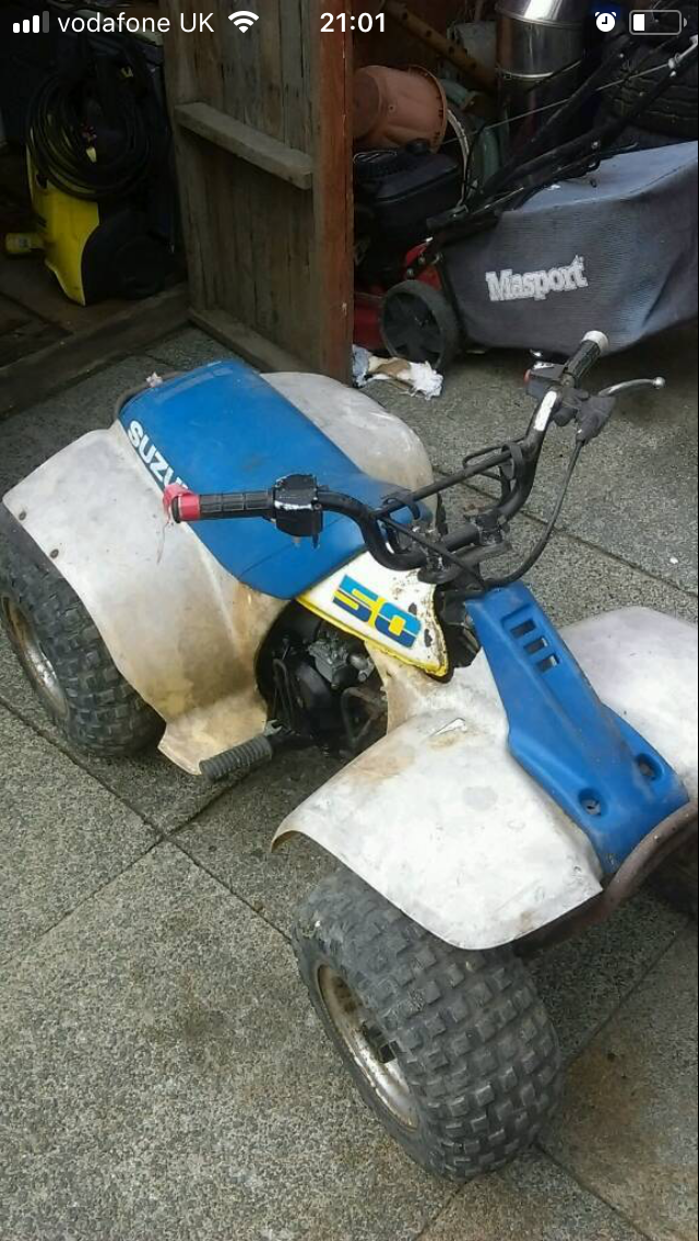

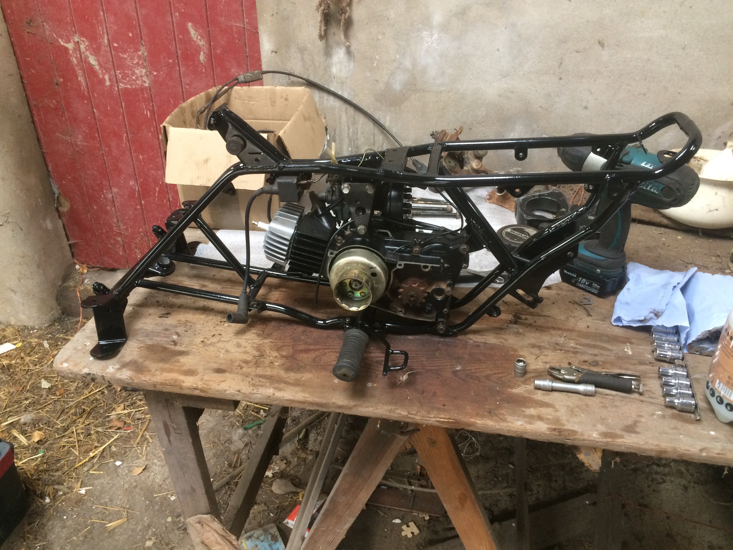

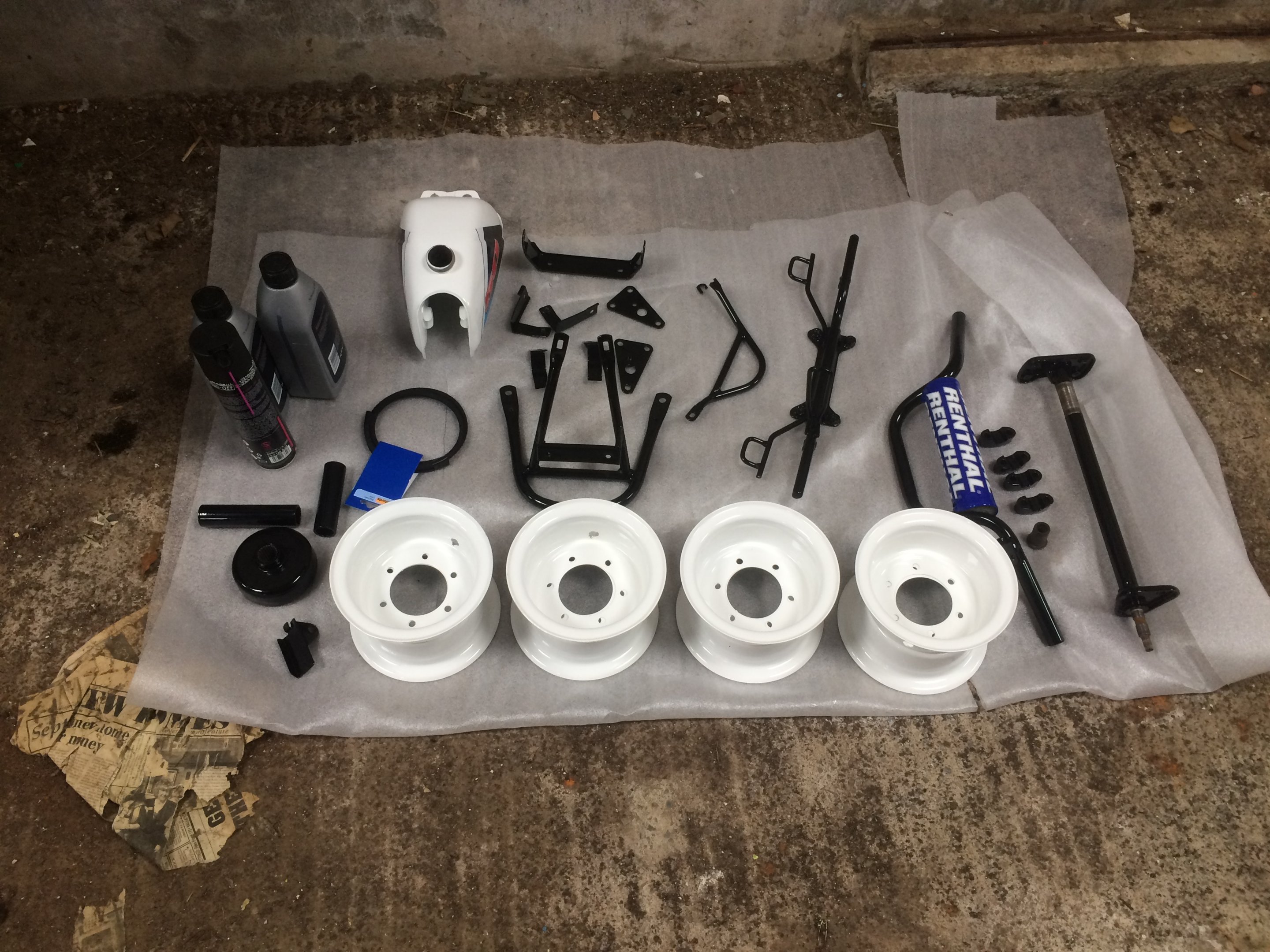

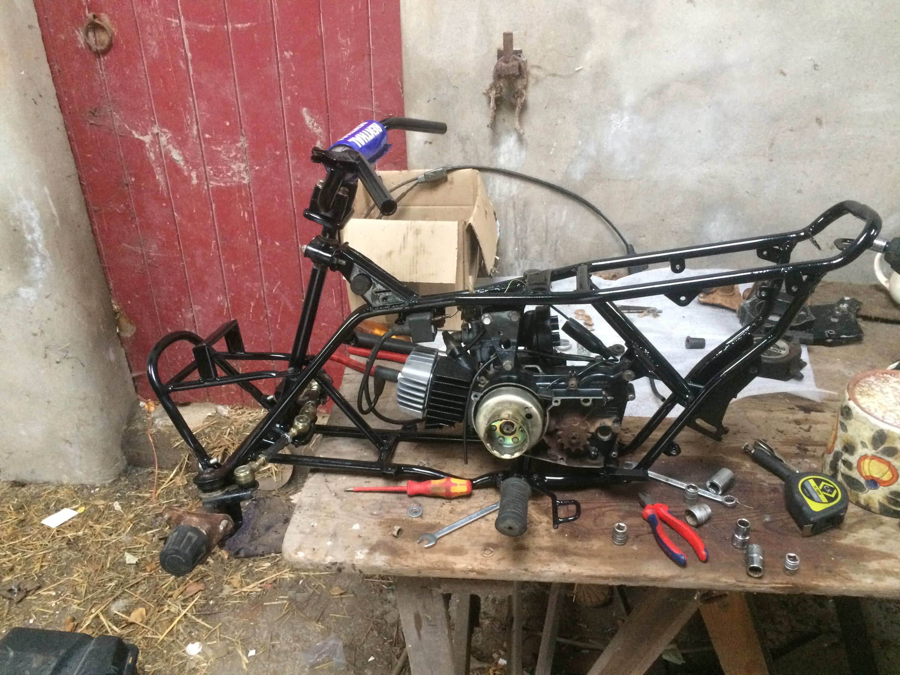

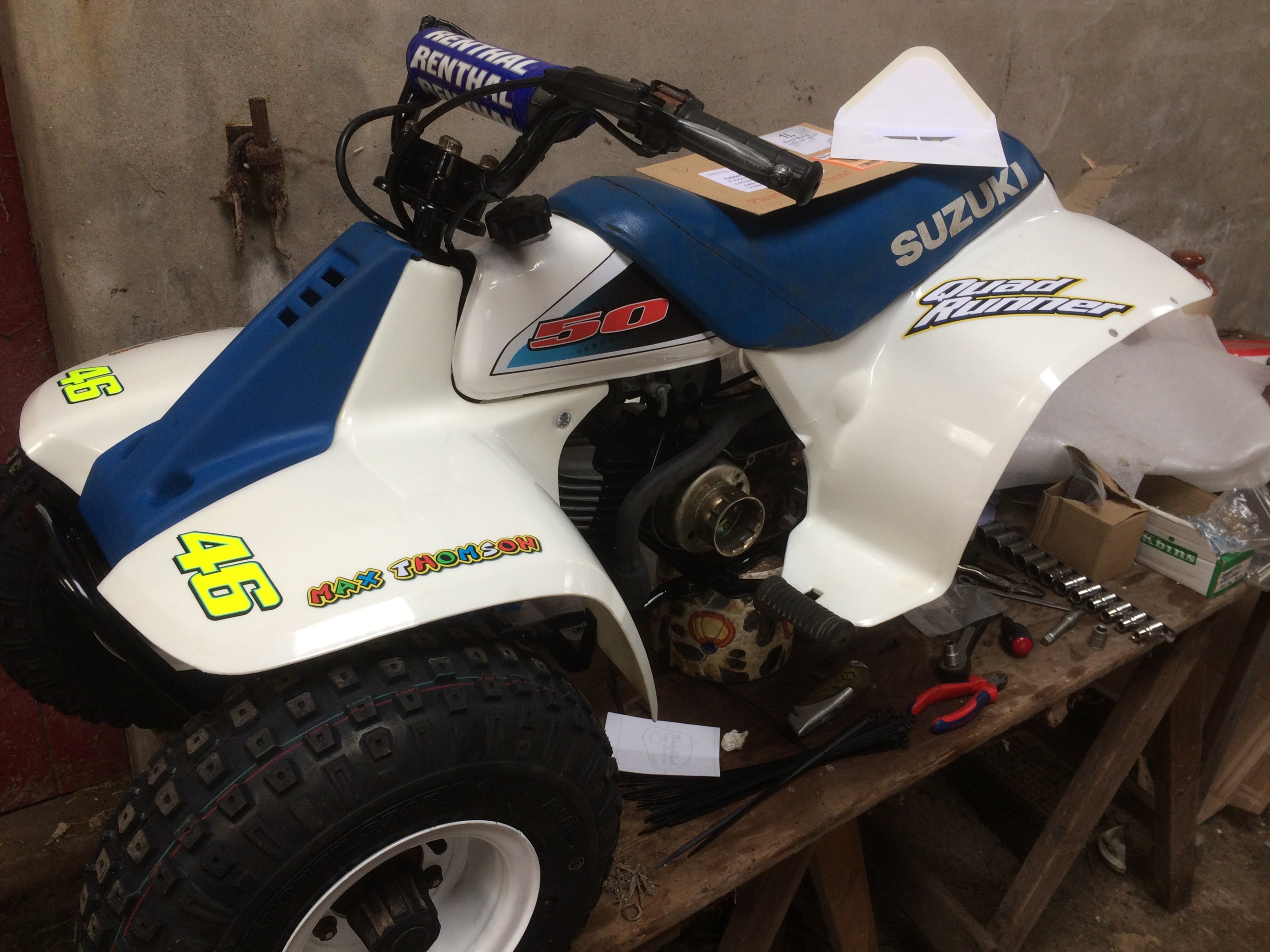

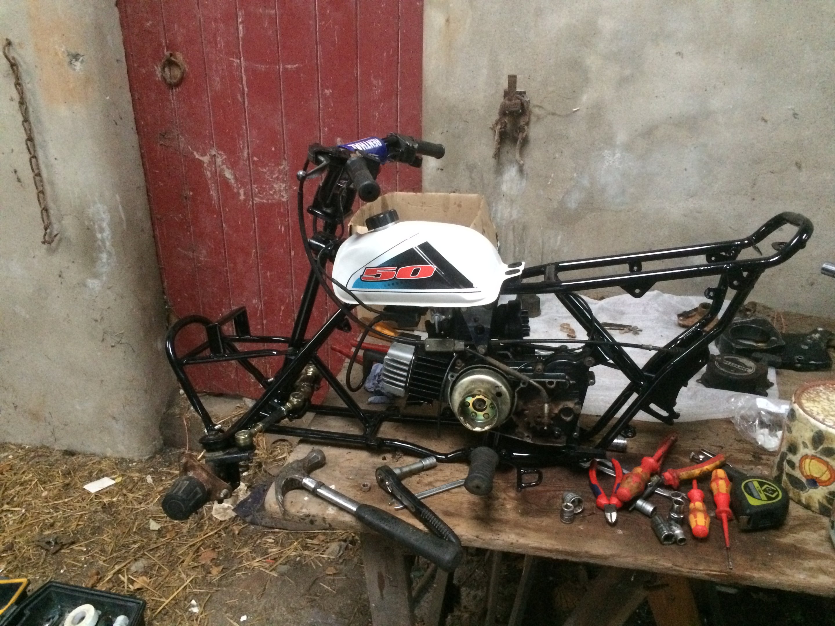

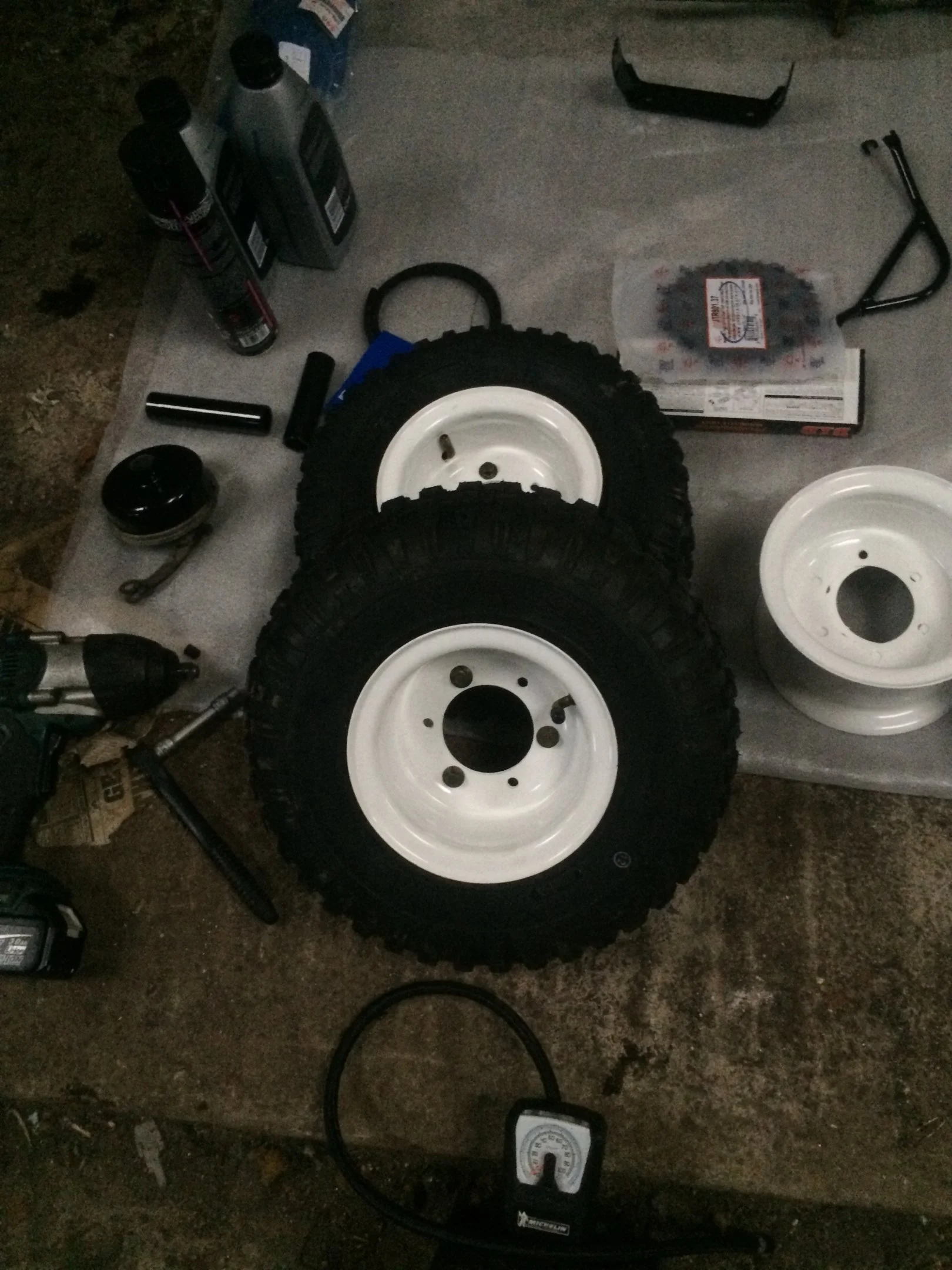

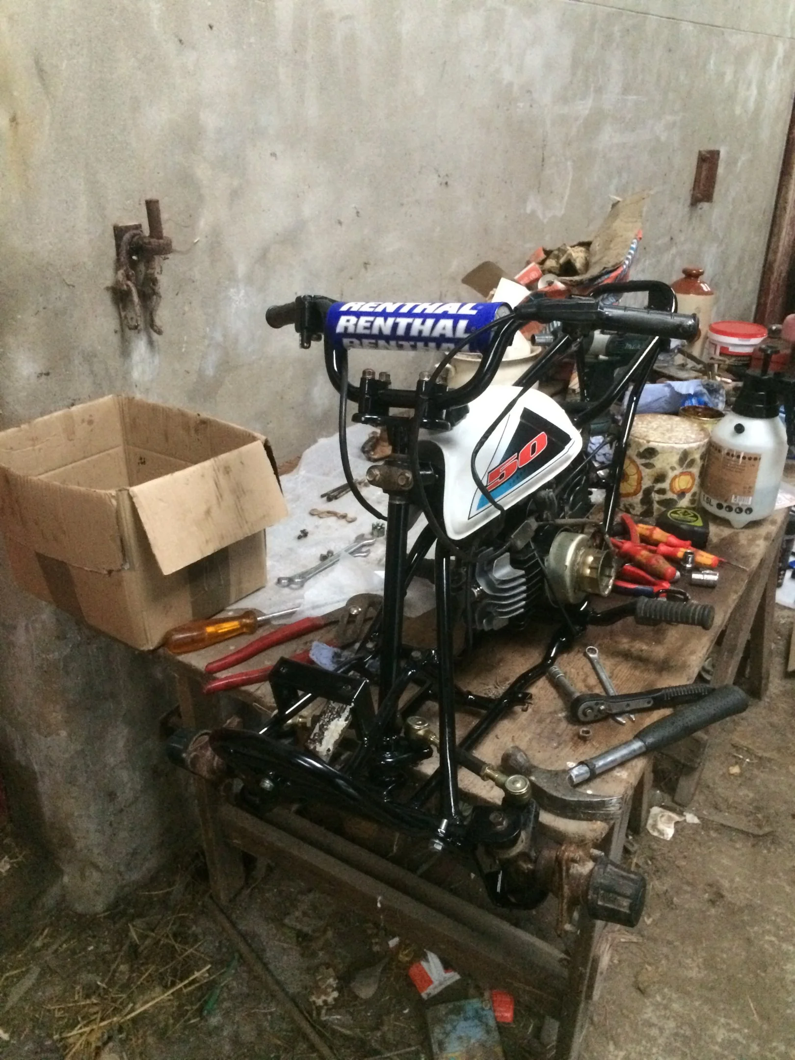

In other news been busy on a mini project for the boy, bought a non running tatty Suzuki LT50 quad.
It was cheap but it’s ruined me getting it to where I want it.

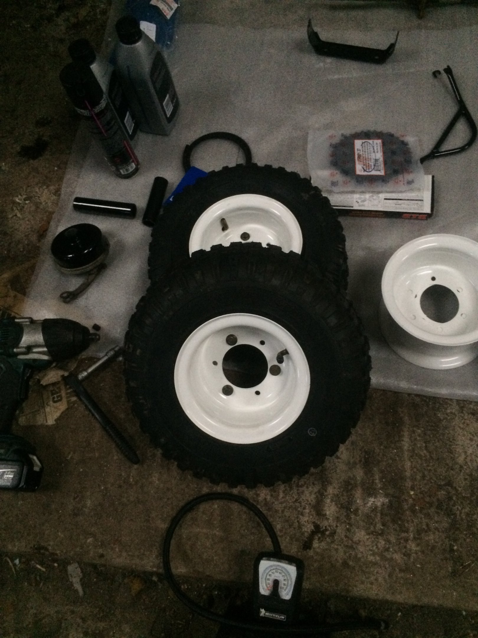

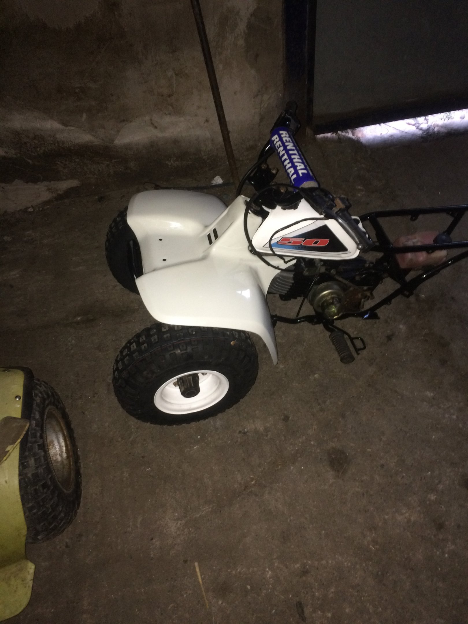

Stripped to the frame and individual components and all blasted and powder coated

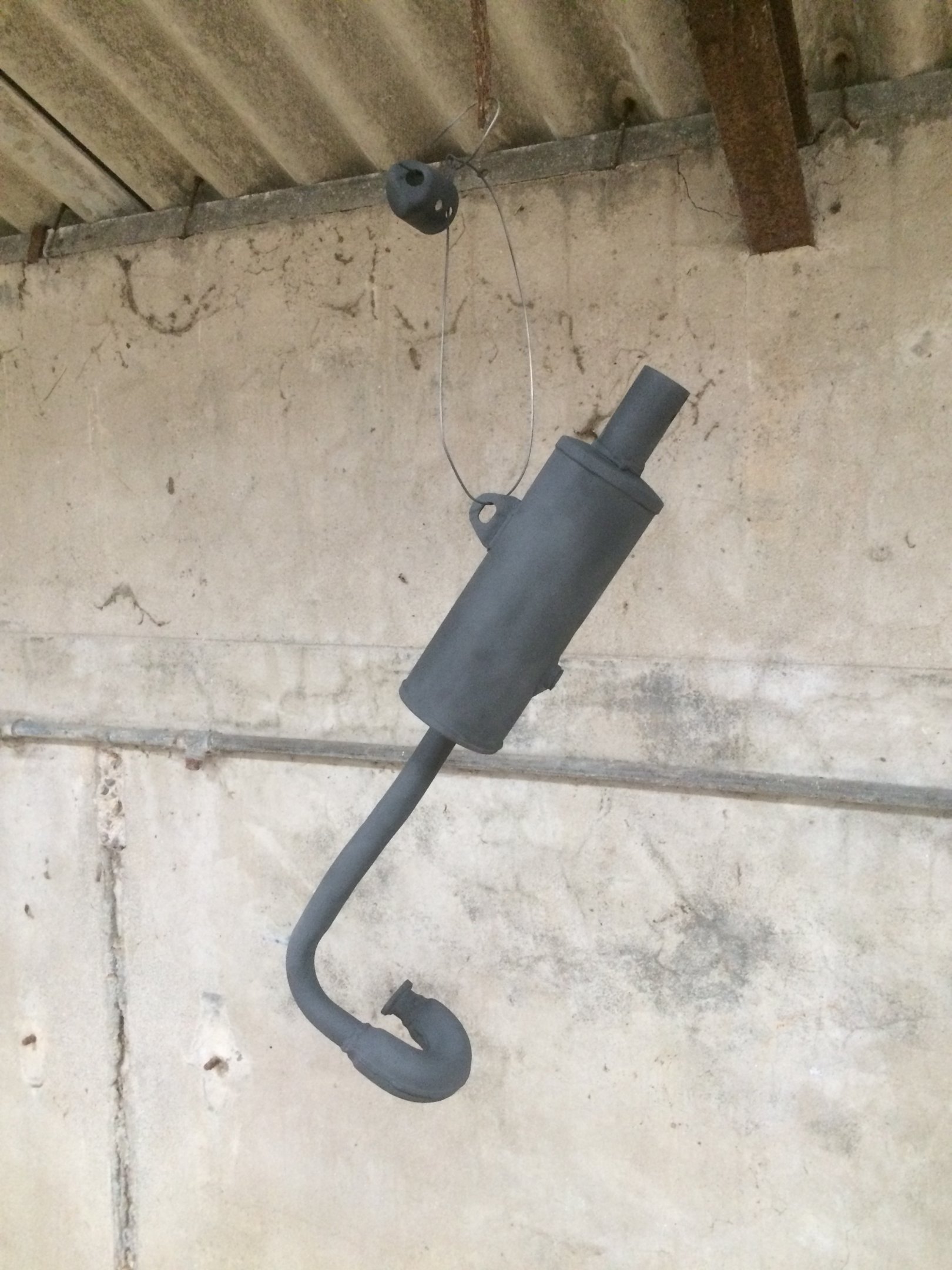

Exhaust blasted and paint with vht paint, tank powder coated, new graphics, new tyres and tubes.
Various stages of the rebuild with all new bits, rear axle carrier and bearings, new steering arms, bushes, chain and sprockets, grips, handle bar pad, complete bodywork and various fixings inc
nuts/bolts.

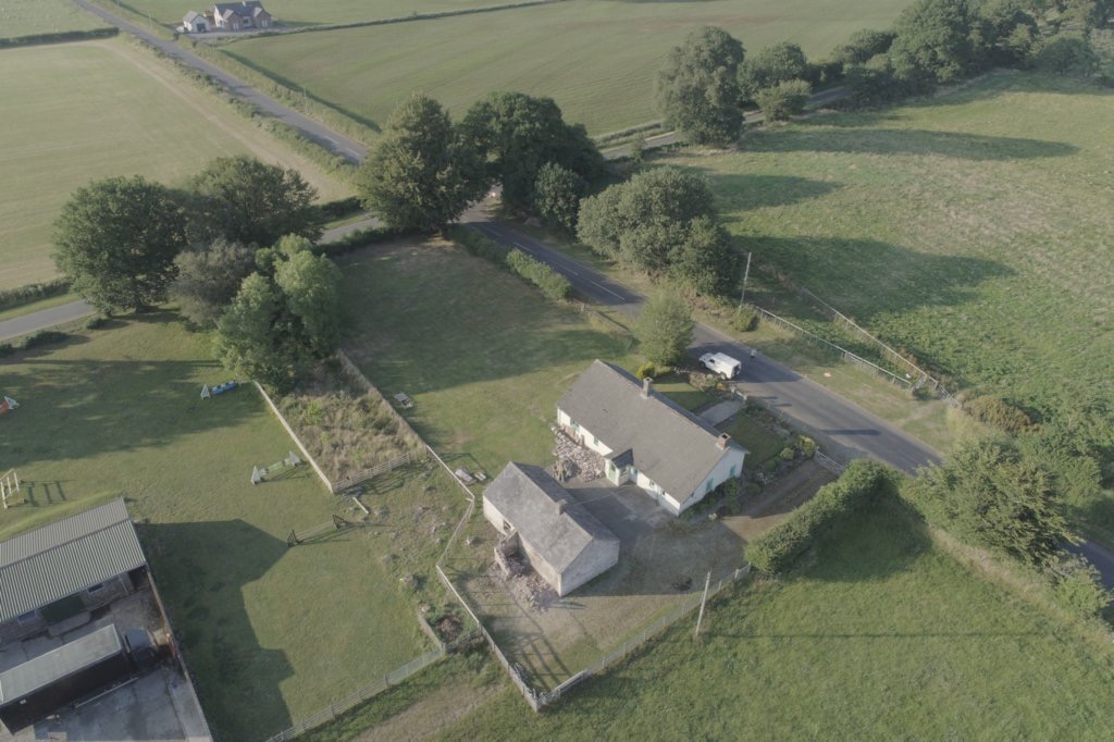

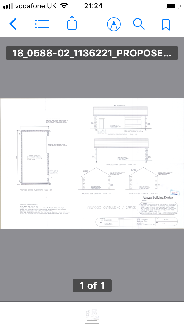

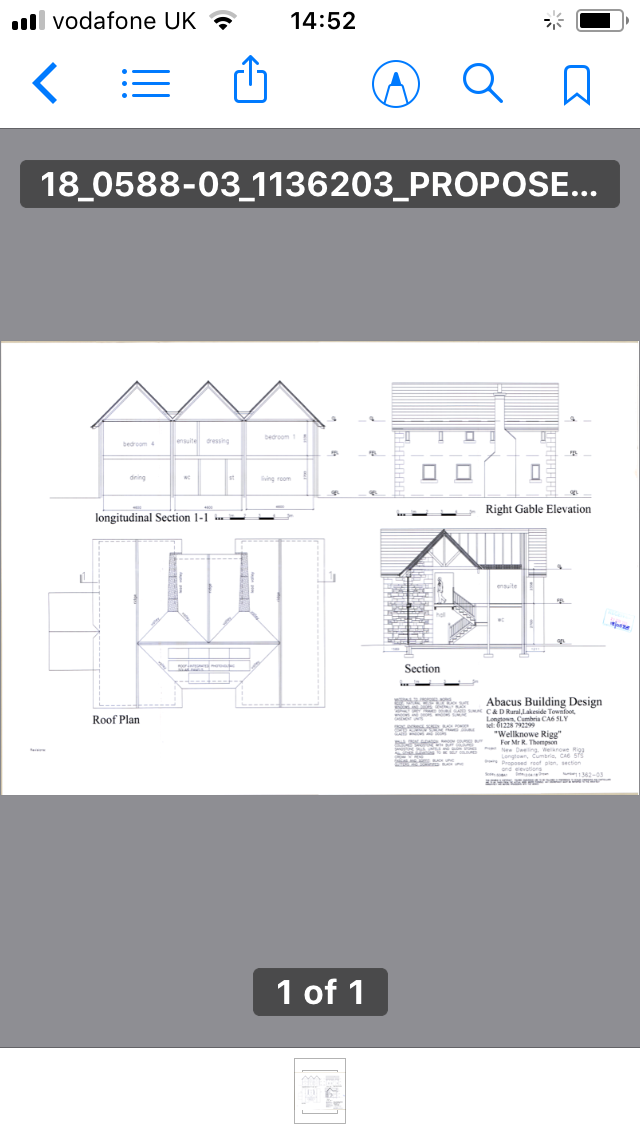

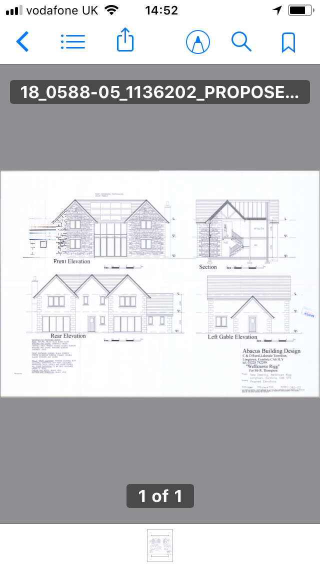

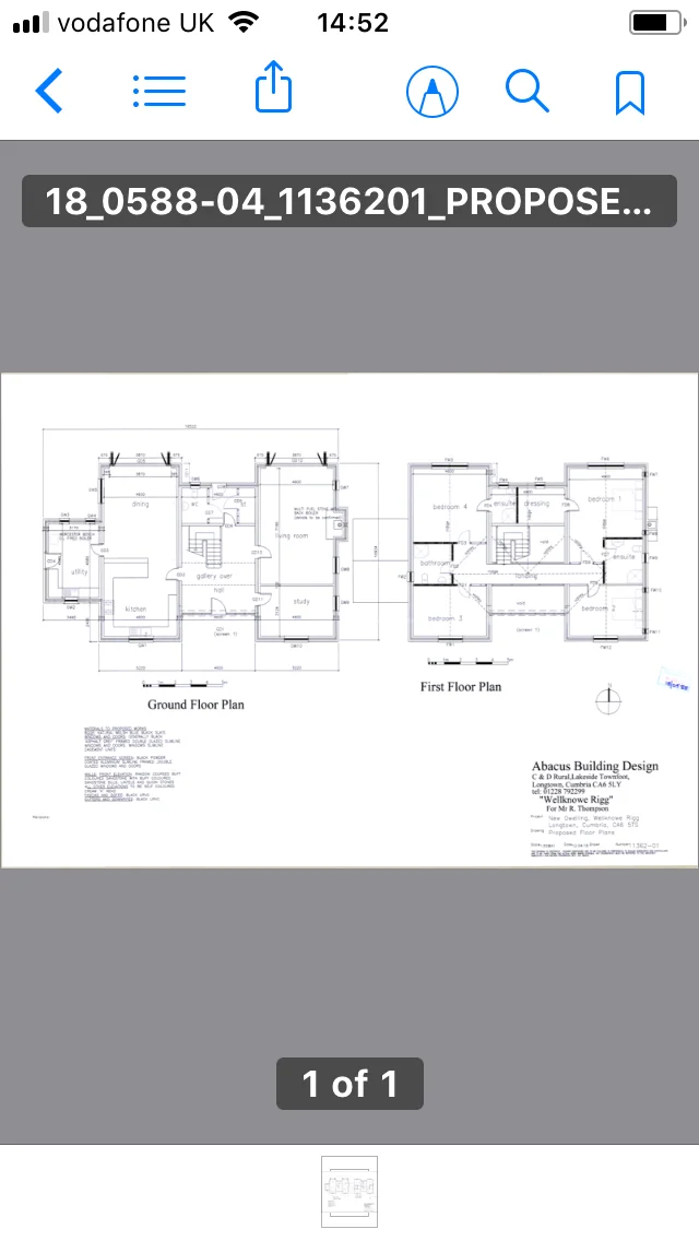

That’s the existing cottage and plot. Planning granted to demolish the cottage and plan was to keep the existing ‘forge’ as my garage but it’s too far gone so is coming down too and will be rebuilt roughly the same only slightly wider/longer. Gotta keep @shiftspark happy until I built my proper workshop!
Below are the plans for anyone interested, sorry for the poor quality.
Russ

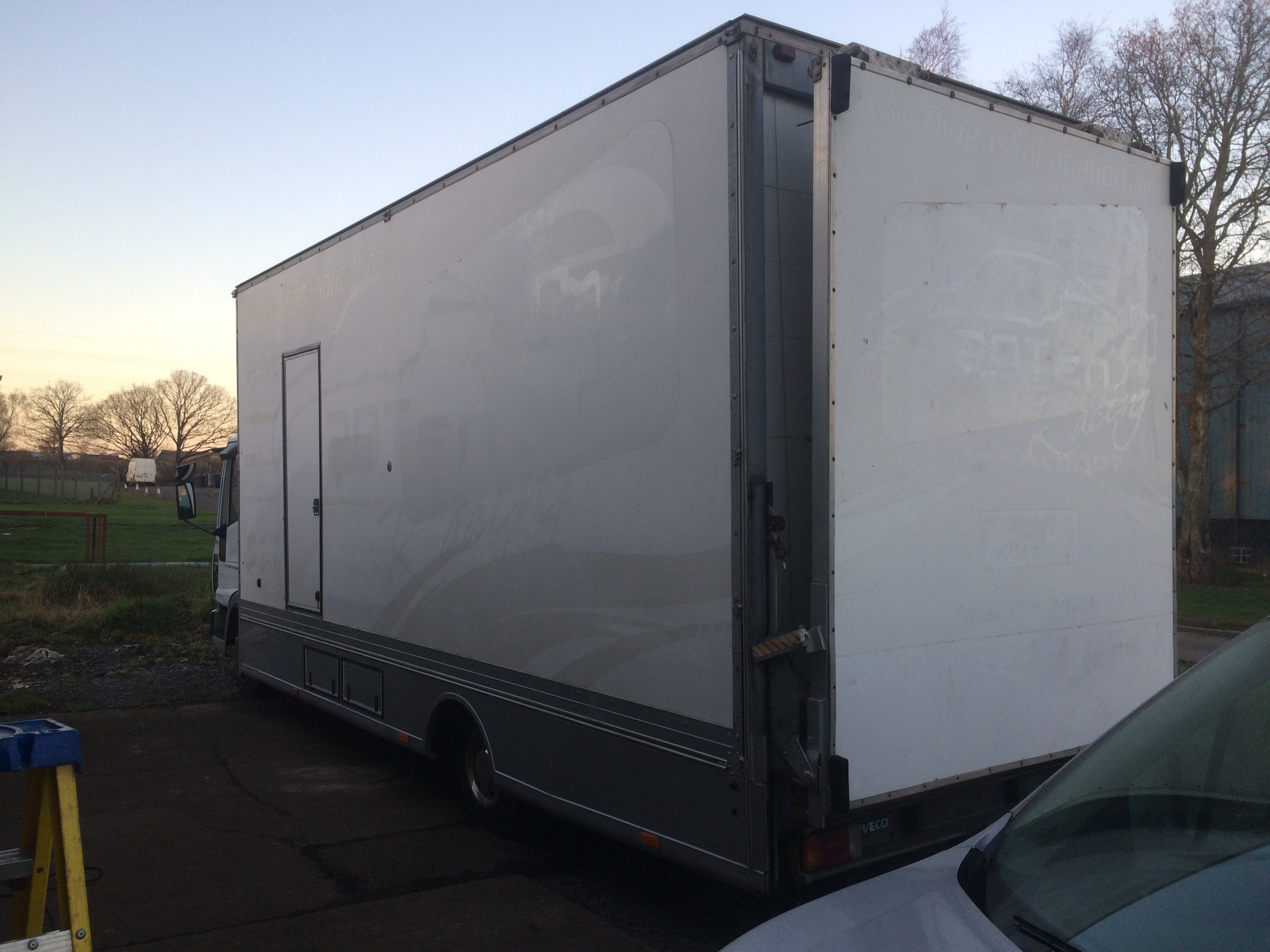

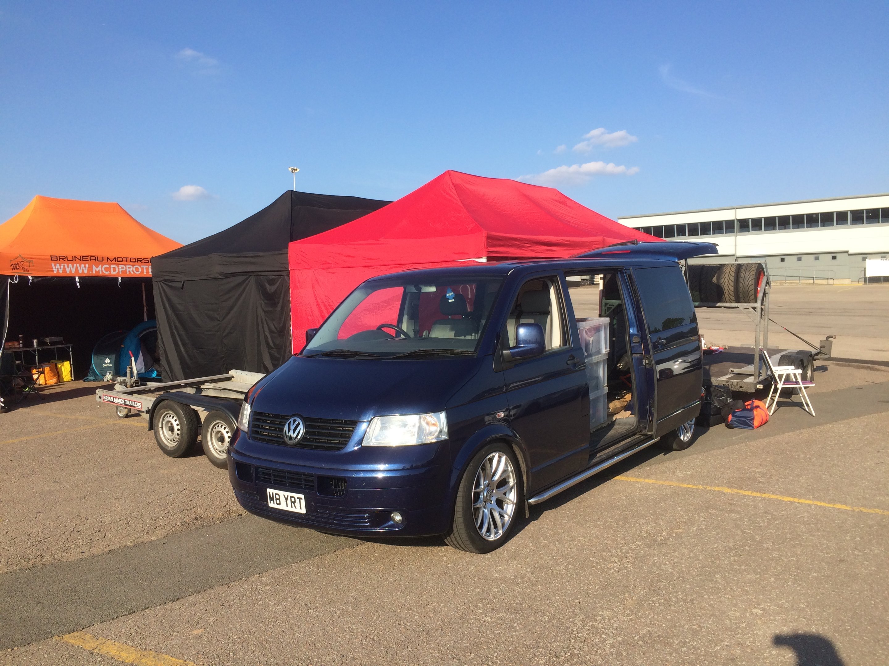

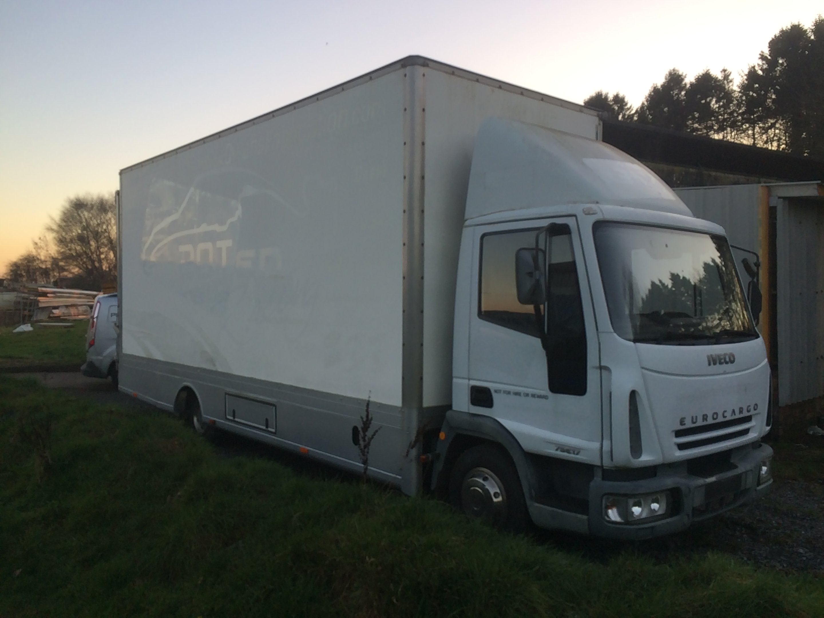

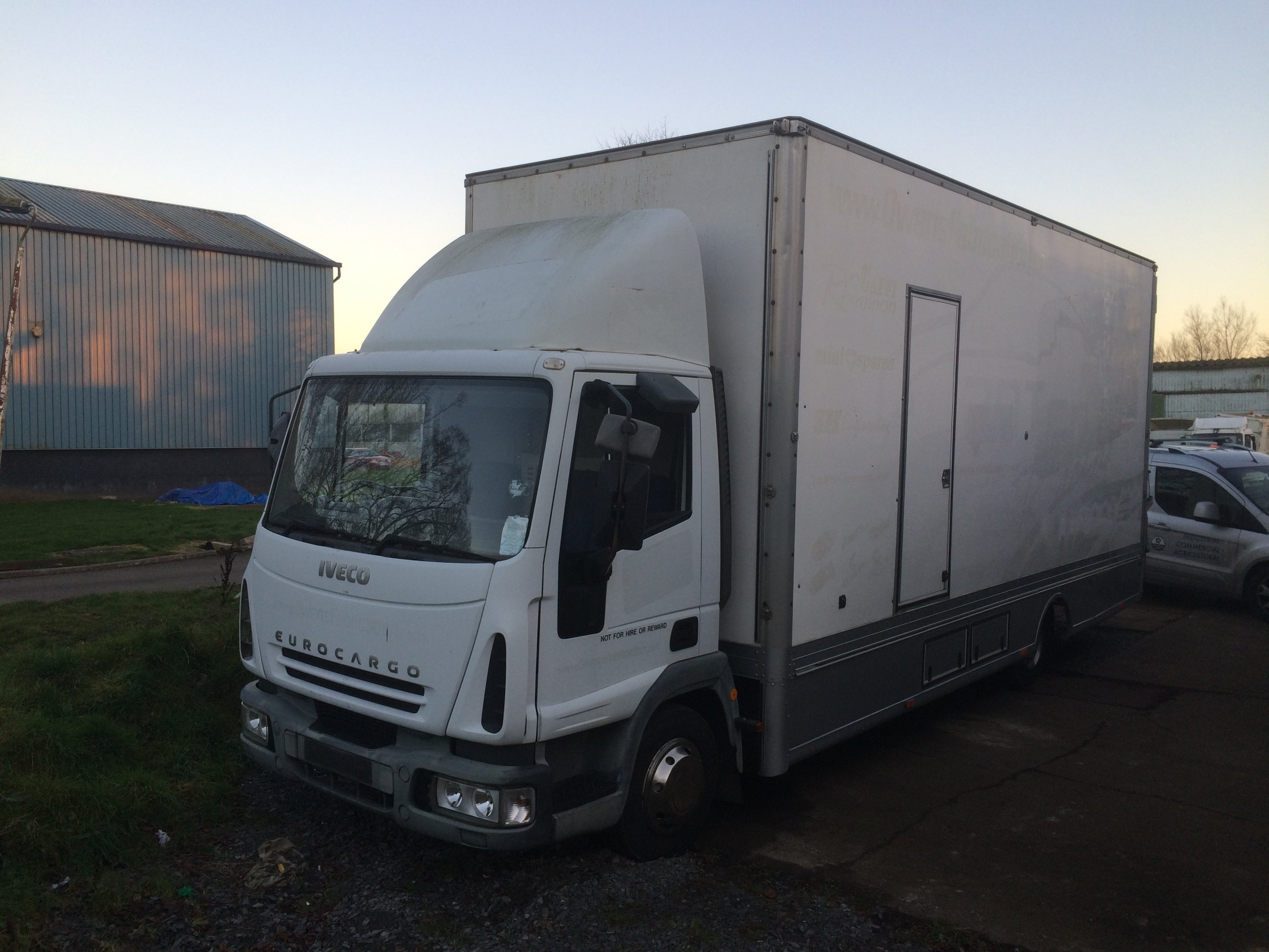

In other news I’ve sold the Transporter. Took a deposit within an hour of putting it on eBay.
Decided after Silverstone it’s too small for racing weekends really so I’m going to get a truck instead! Just a 7.5 ton box truck but with big awning and proper bed to make it more habitable. I also need 4 seats now as the Mrs is expecting our 2nd so again the Transporter isn’t practical as a ‘do it all’ anyway, on the lookout for a nice X5 to do that job.
Full season review coming soon and winter progress but in the meantime if anyone is interested in any engine bits, billet flywheel and helix clutch etc etc let me know

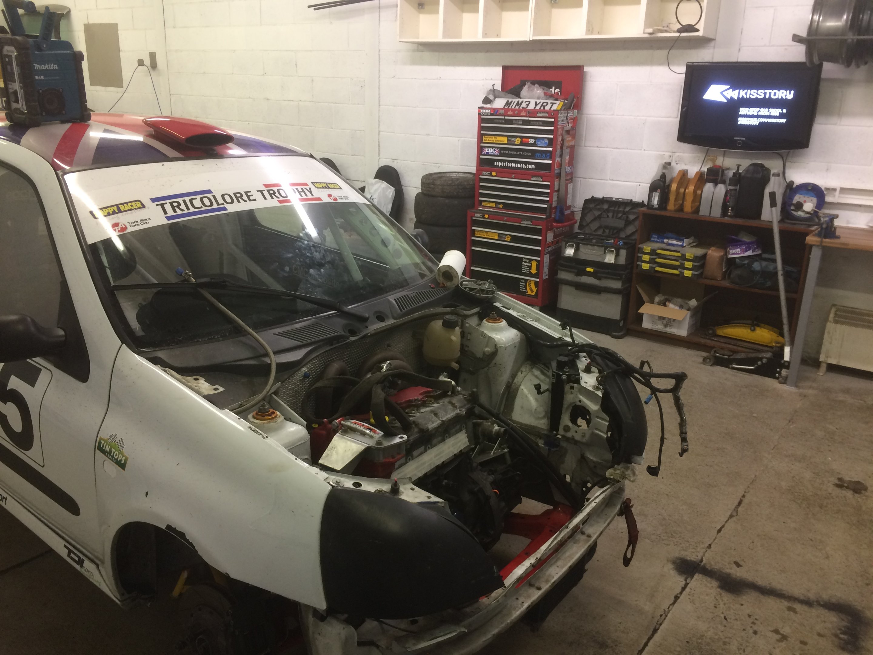

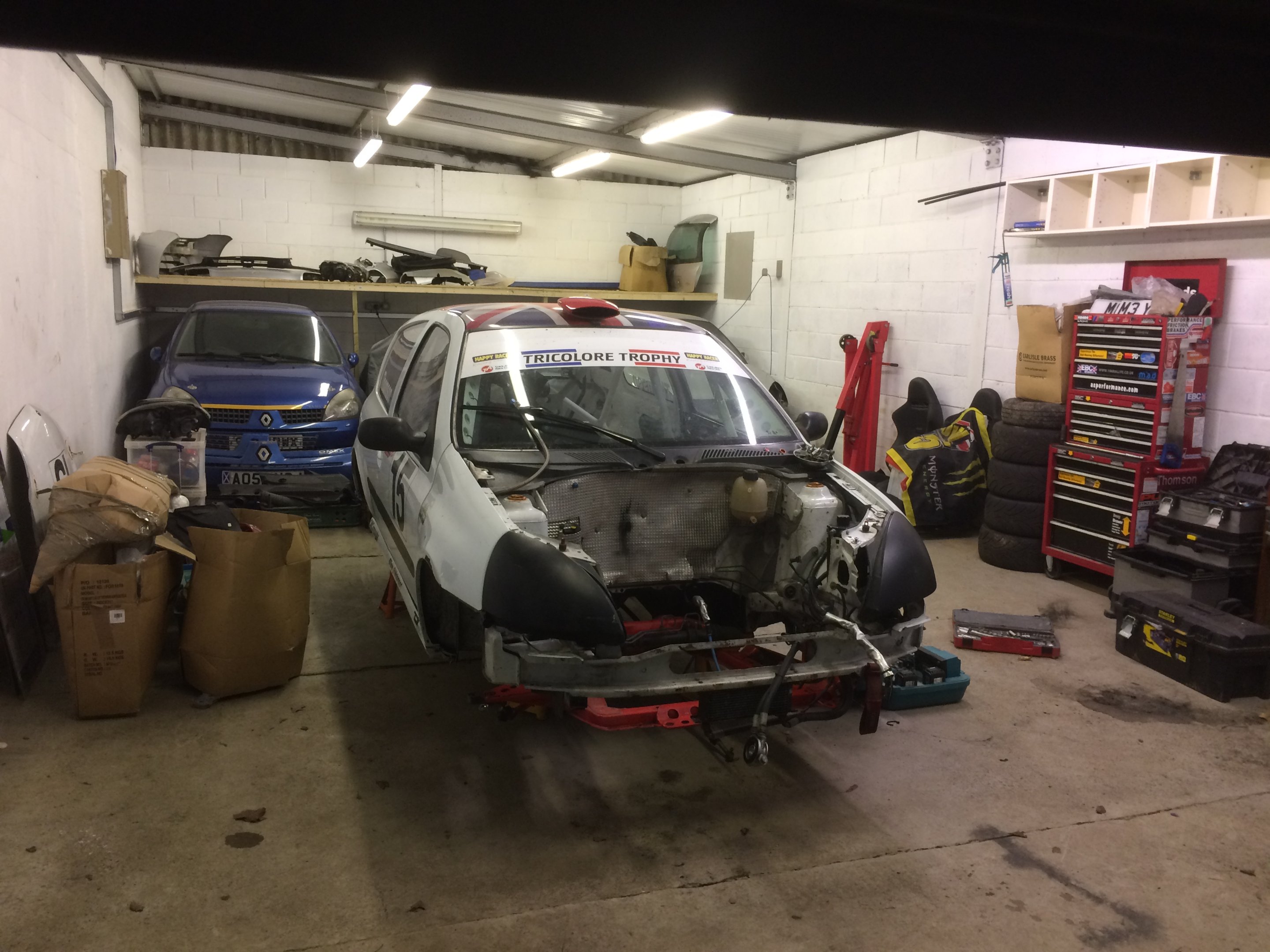

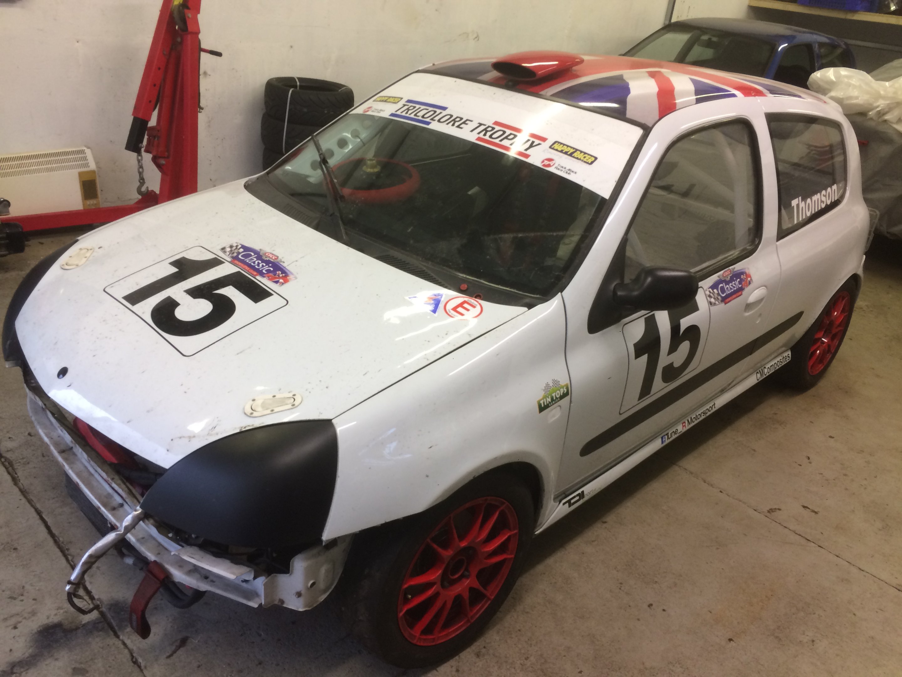

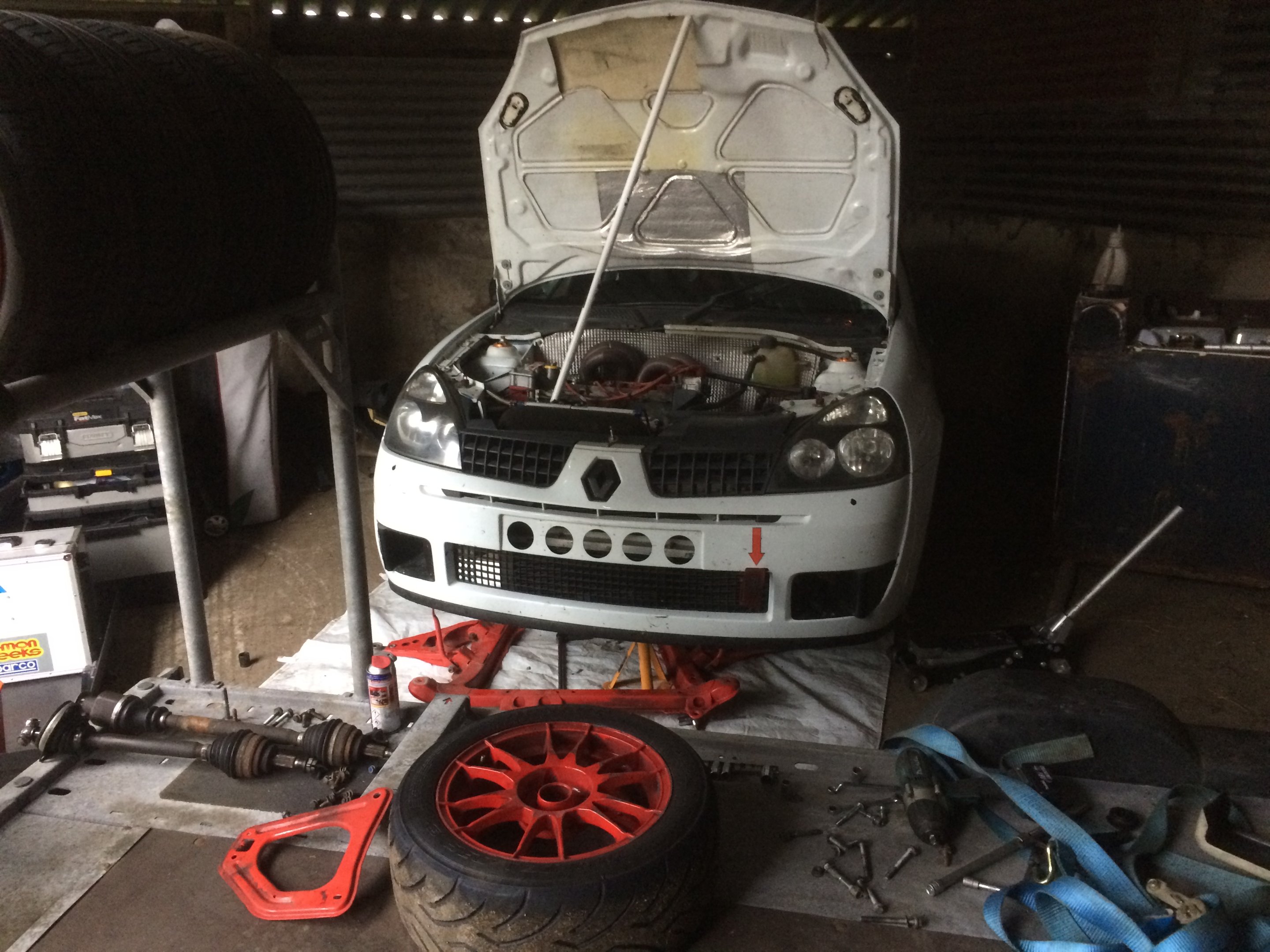

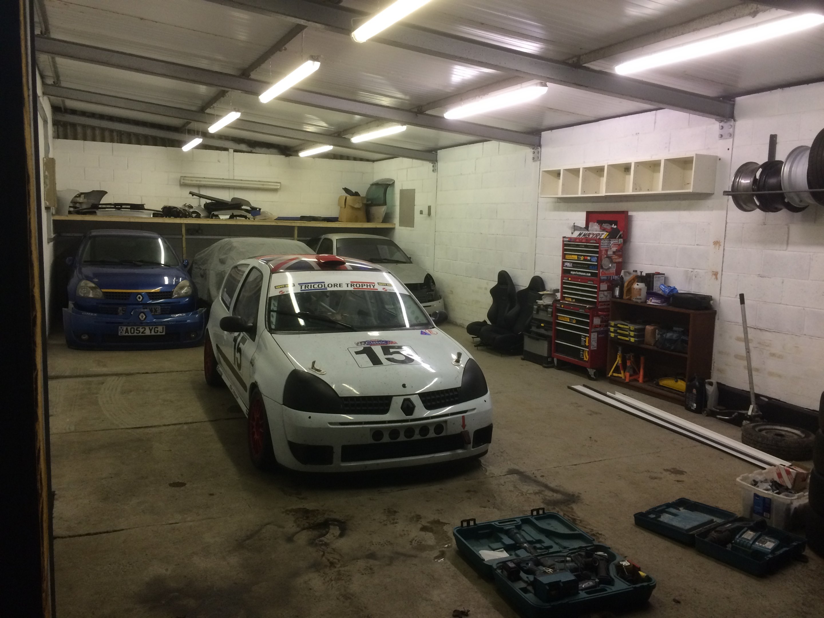

Fear not we’re busy stripping and rebuilding Nicole for the upcoming season, whether that’s with TARC or elsewhere, more on that in a minute.

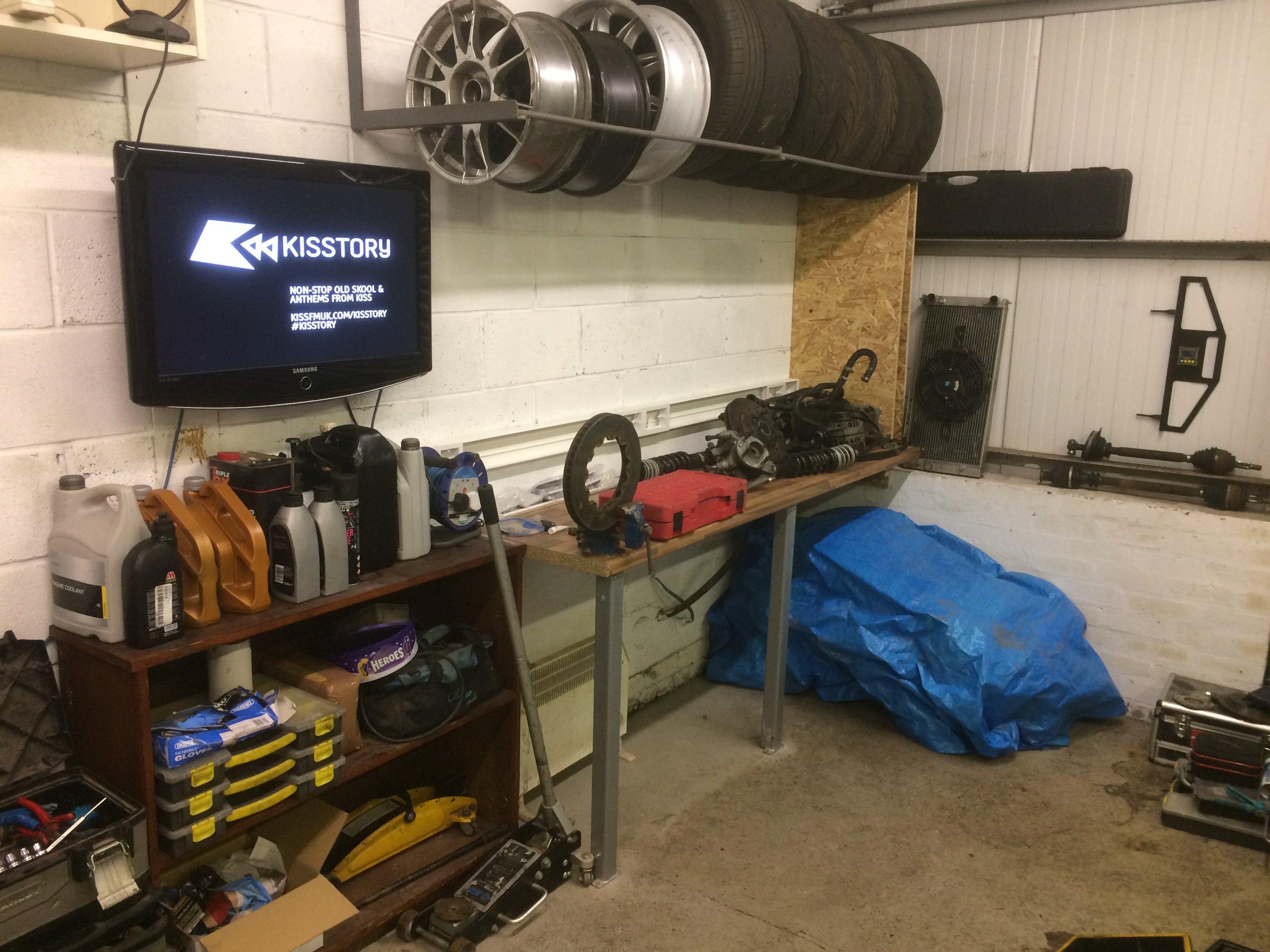

Being technically homeless and having the cars in a damp barn 20+ miles away has been a pain over the last year so I’ve moved to a temporary new workshop and got settled and it fitted out good enough to work comfortably out of. Not massive so trailer and my Clio Trophy are still housed elsewhere for now.

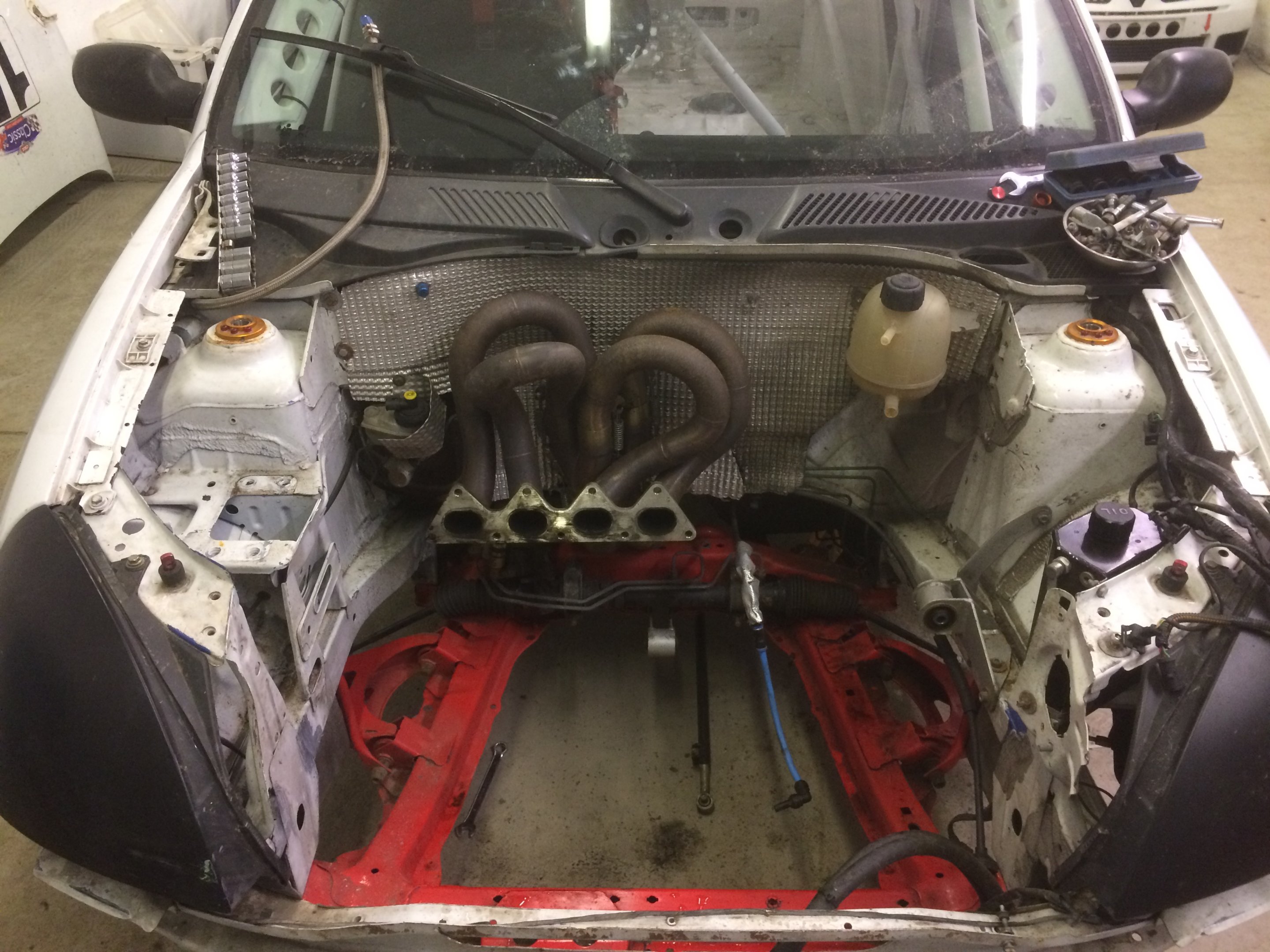

Nicole is in bits now anyway,

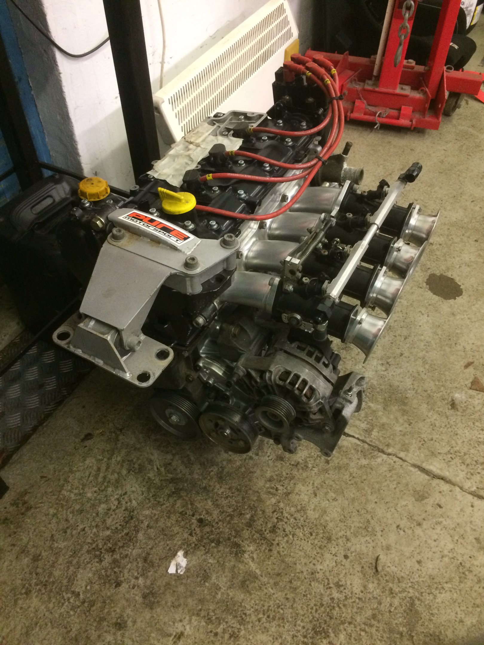

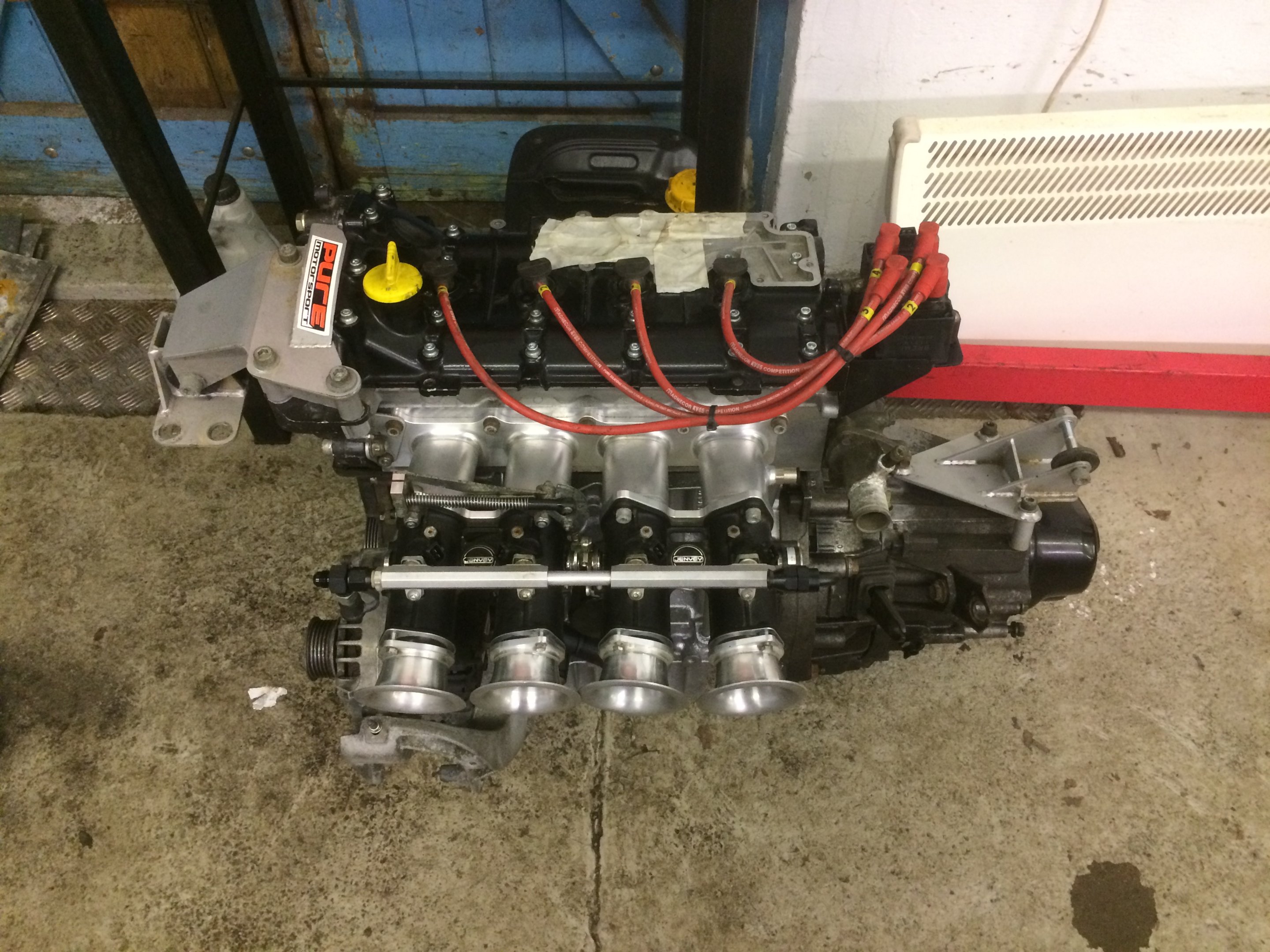

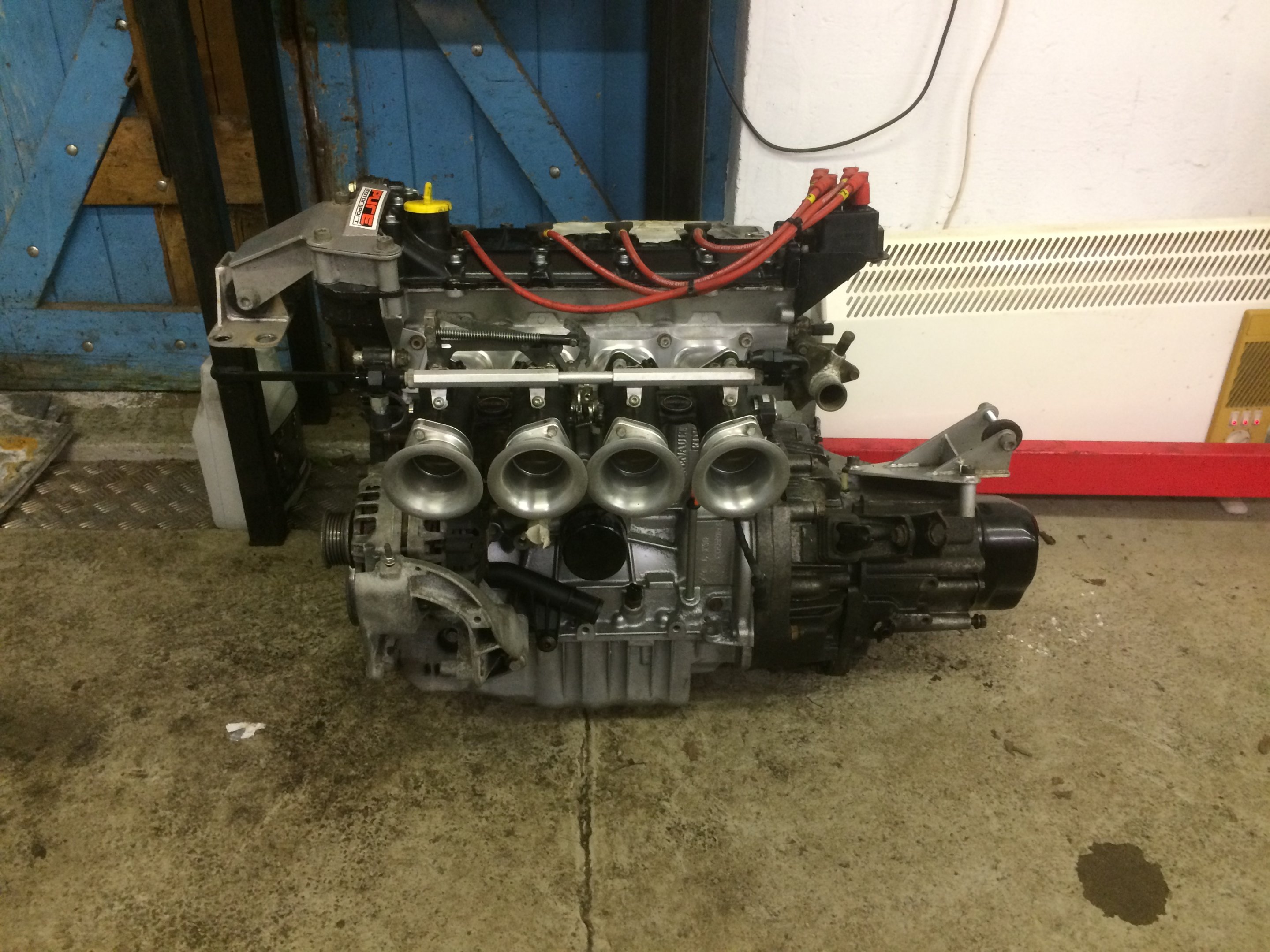

I’m Awaiting the new motor coming back and the gearbox and diff are getting rebuilt as we speak. Exhaust manifold is looking a bit tatty so if I can’t clean it up properly it’ll be going away to be ceramic coated too.

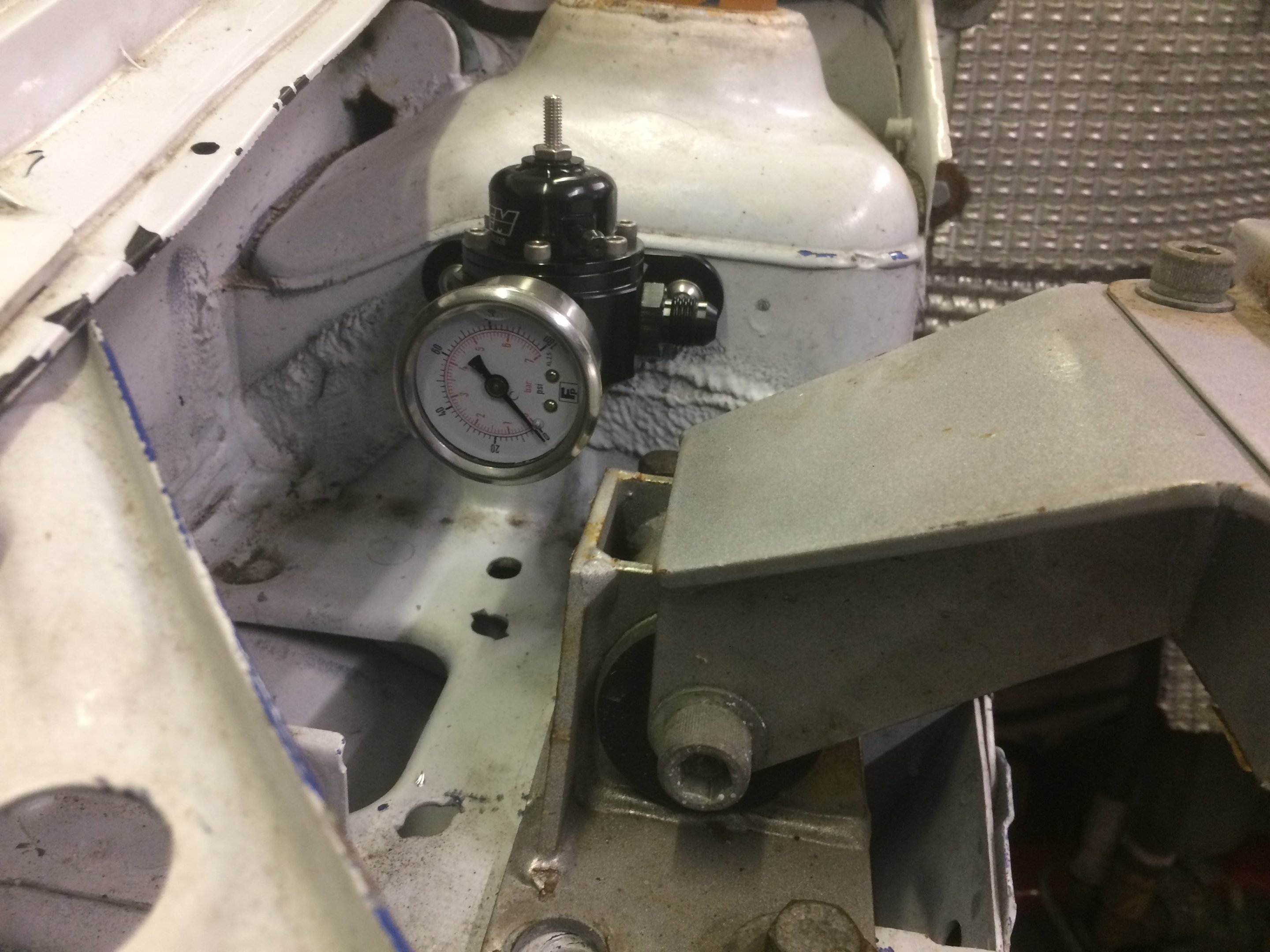

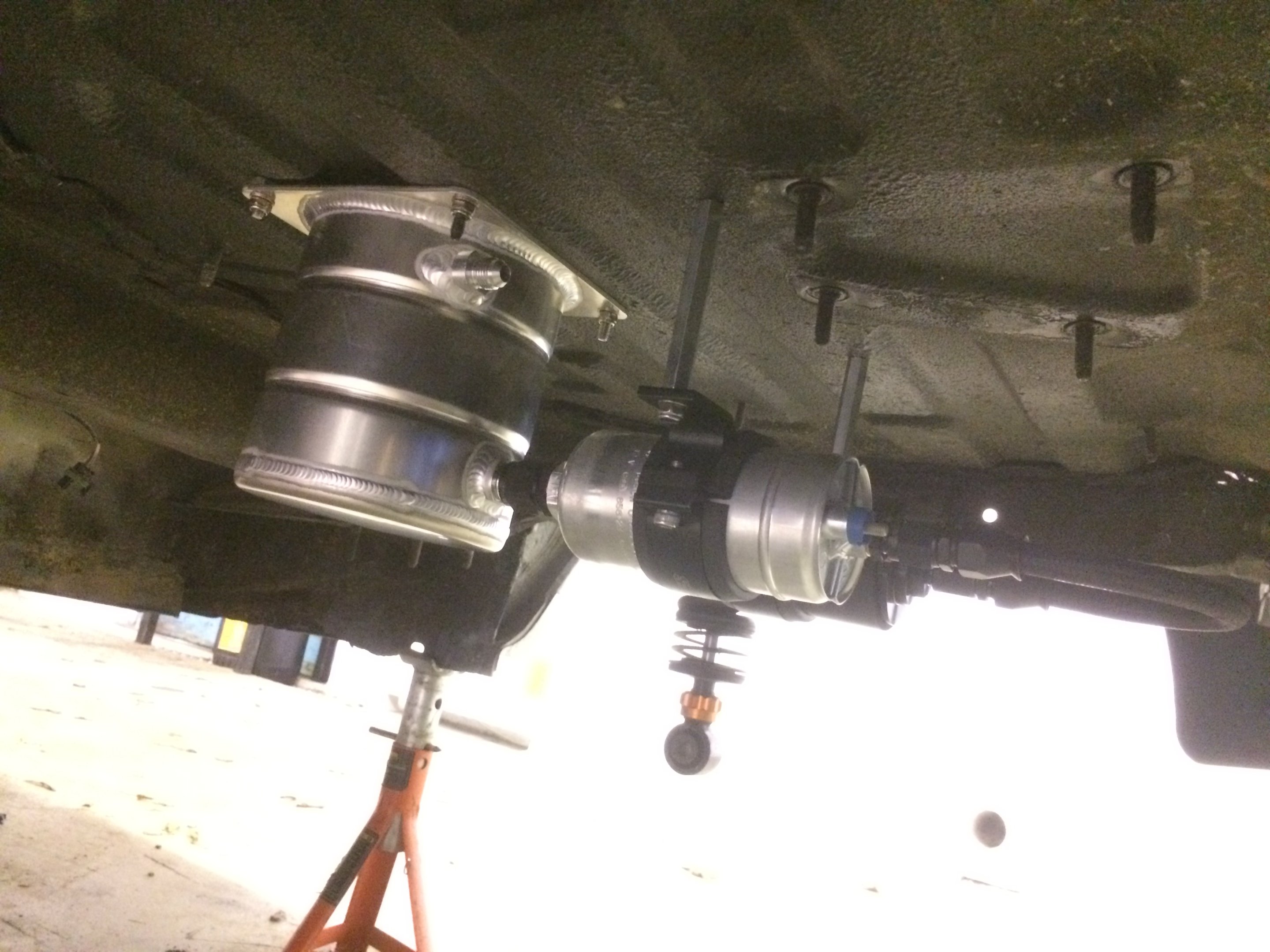

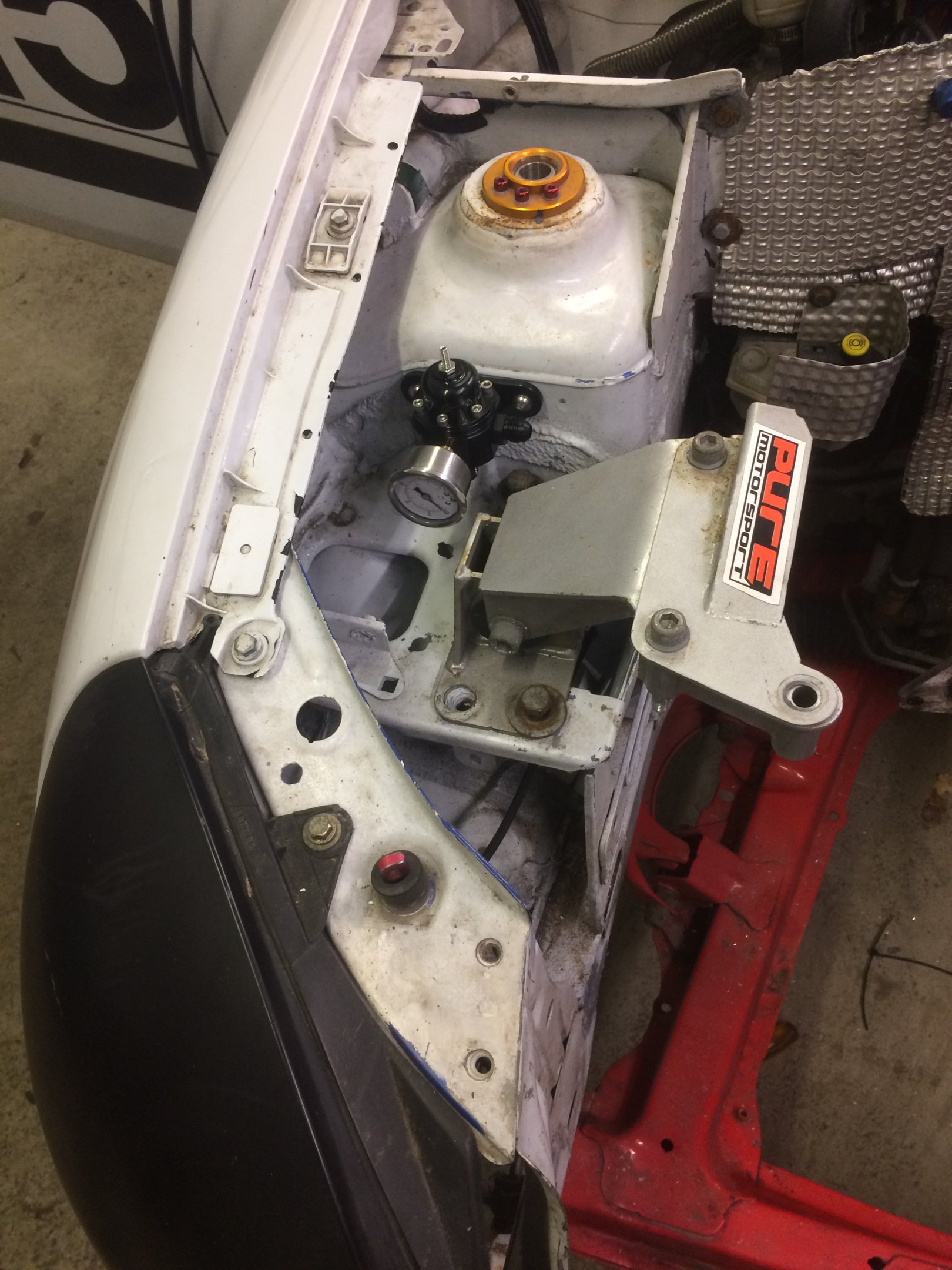

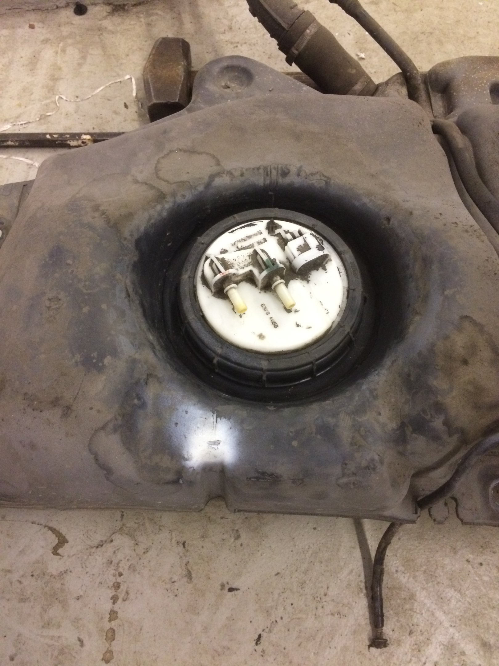

Main winter upgrade is fuel system improvements after suffering fuel surge last season really got the first time since I built the car. I really wanted to put an atl tank in but I can’t mount it where I want so until I can come up with something else then I’m keeping the standard tank. Albeit with a new return system with external AEM regulator, 1.5L swirl pot under the boot floor, Bosch 044 external pump and filter and Ph1 172 sender unit/pump. All re-piped in Teflon lined braided hose.

Upgrade wise that’s probably it, got a few maintenance bits to sort though, I’m not going to have the time or money to cosmetically tidy her up for now so will get a proper job done next winter.

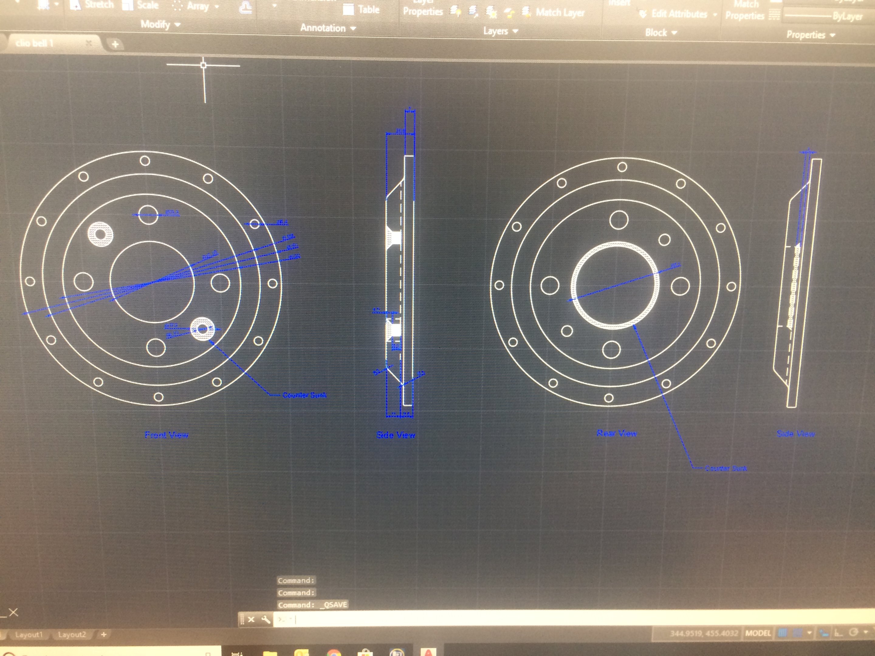

I need new front rotors so gives me an excuse to sort the front bells out that I done a trial fit with 5 years ago with the plan to remake them properly instead of using a spacer behind to bring them out to the correct offset for the calipers they’ve worked well but I’ve drawn up a set in autocad seen as I can actually use it now.
My workshop is attached to my mates who does industrial machining, cnc work etc so comes in handy!

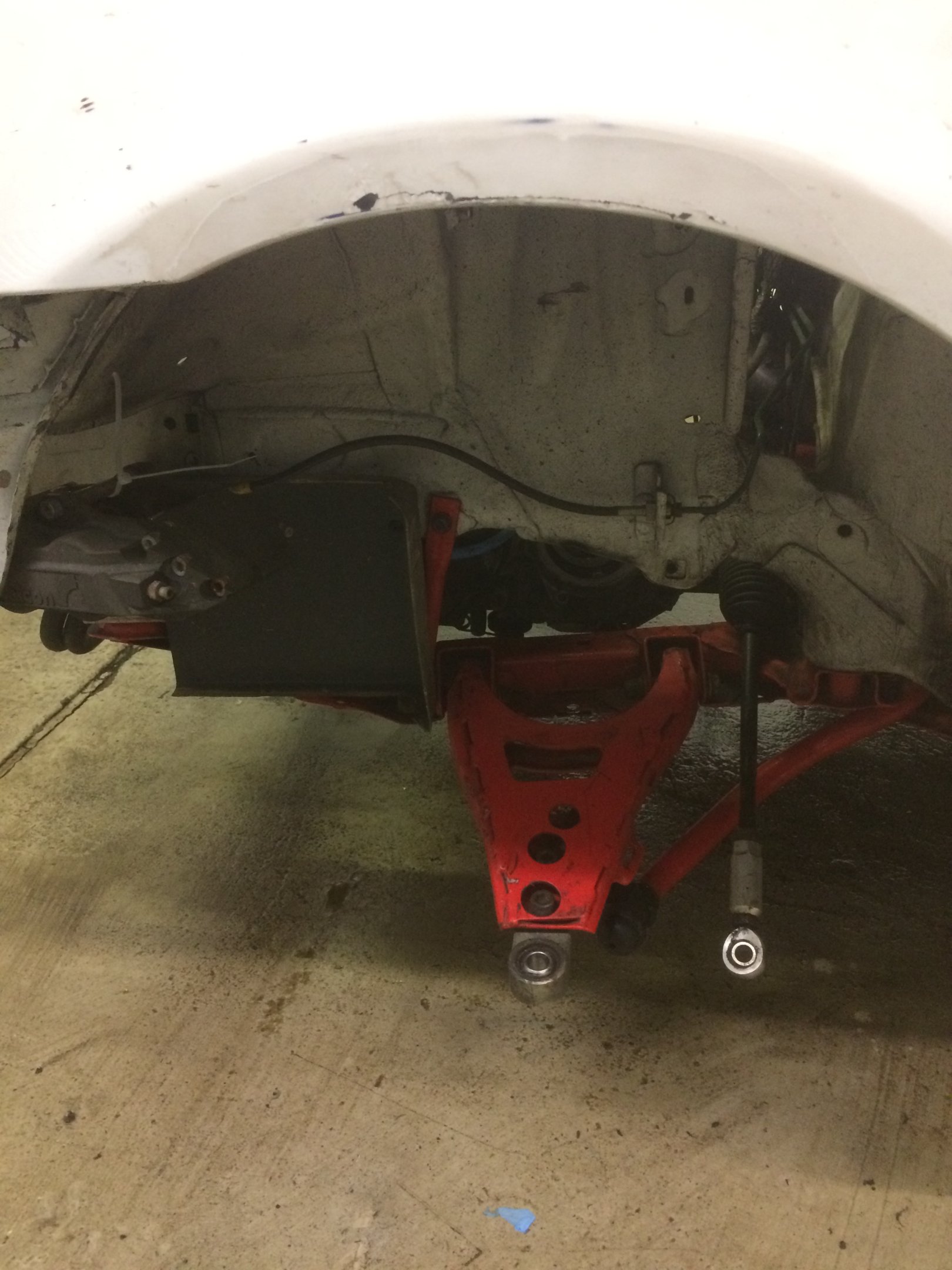

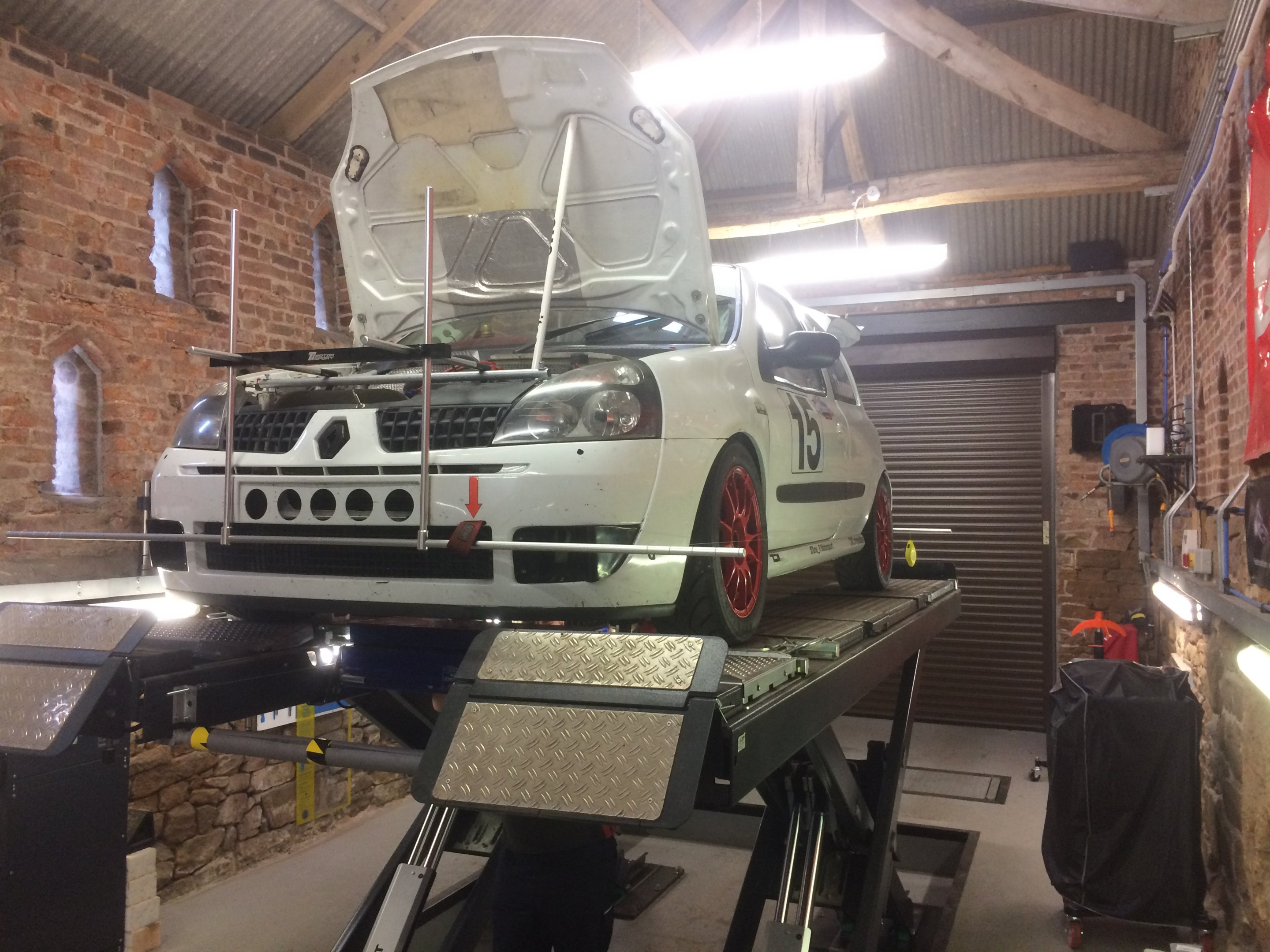

All the suspension is stripped front and rear and all bearings checked, surprisingly all good this time, could do with a set of rear discs/bearings as they’re rusty not worn!
That’s pretty much it for Nicole for now but I’m looking at trying my luck in the 750MC hot hatch series this season as they’re tweaked the (provisional) regs to level the playing field a bit. If I can find the time I have just enough bits here to build another car from a spare 182 shell I’ve got, plan is to use a Ph1 172 front end as I prefer the look and build it to Tricolore trophy class E production + regs and maybe use it myself, keep it as a spare or hire it out and run it for someone if necessary. I also need to sort my truck out before the season starts, more on that soon when it’s at the workshop!
Russ

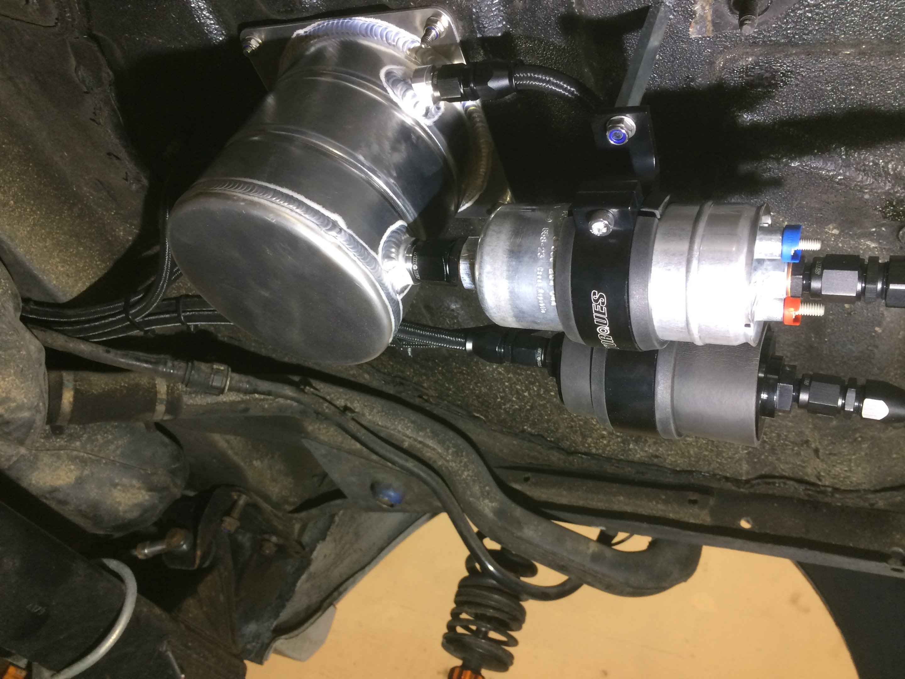

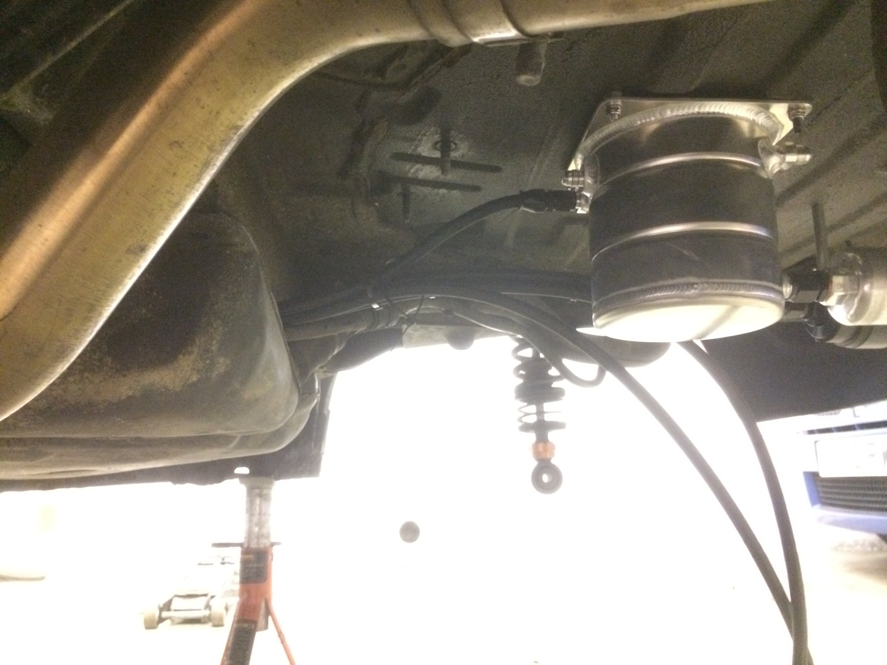

We’re making progress, gearbox is back after being checked over and rebuilt. Gripper LSD has been rebuilt/replated too.

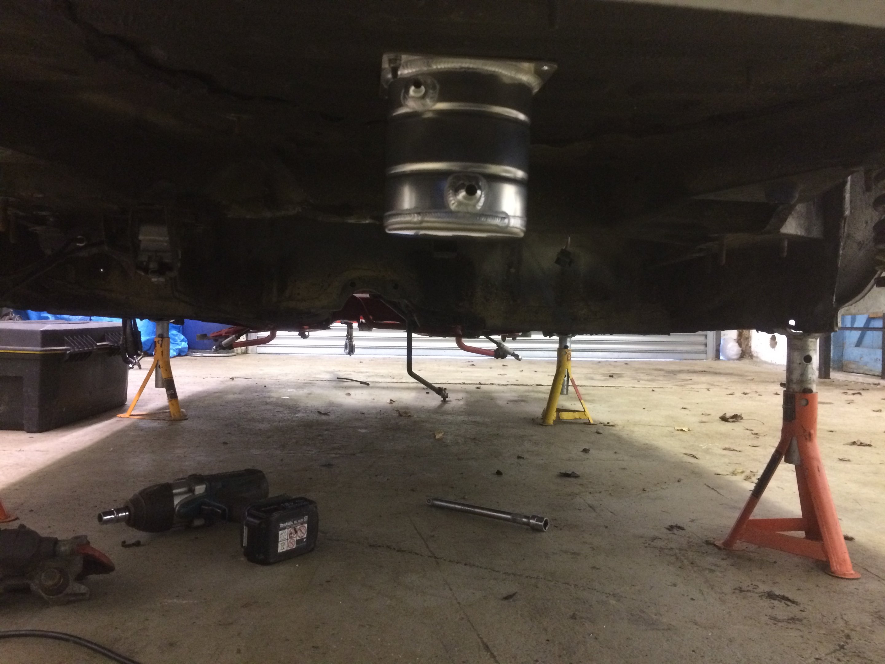

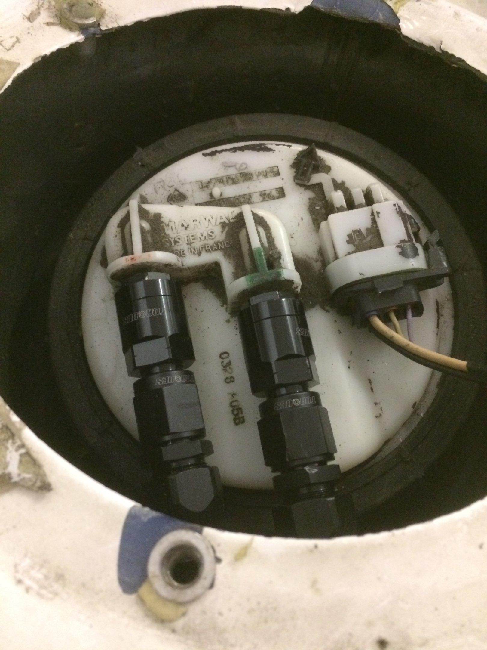

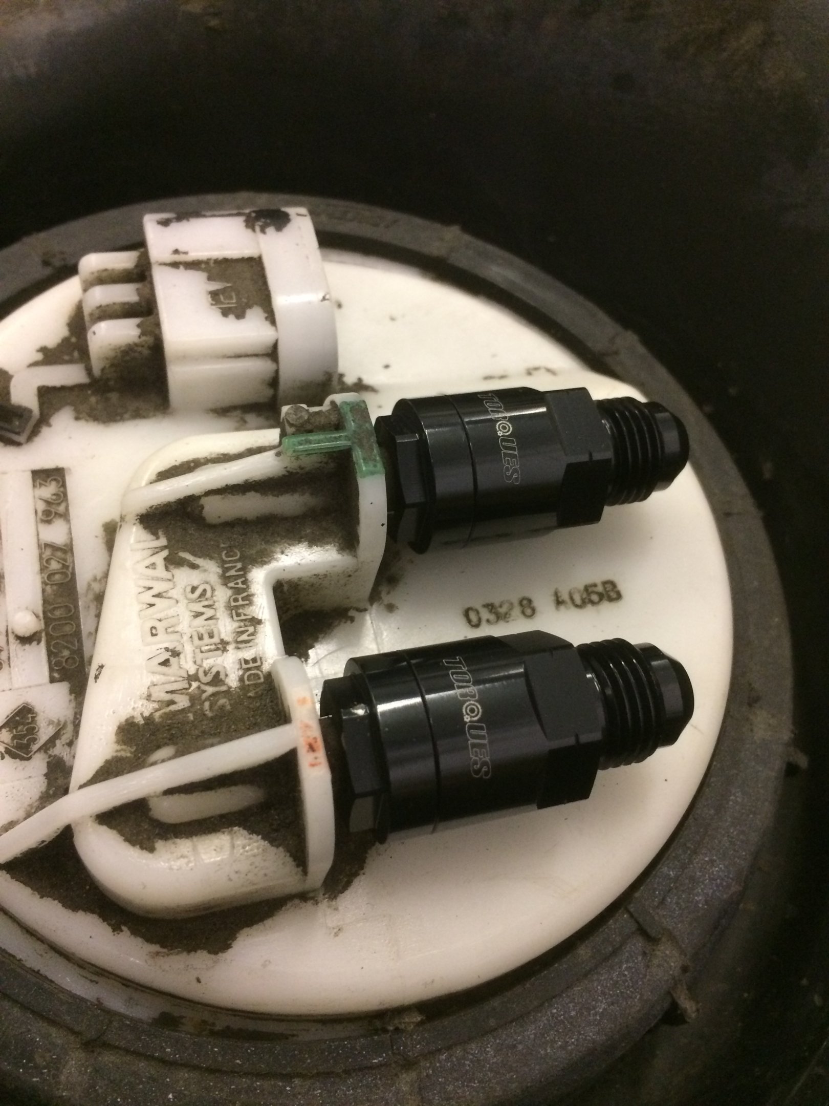

Been getting the fuel system pushed on, got everything mounted under the boot floor.
Started piping everything up with ptfe lined braided hose and associated fittings. Managed to get them over the tank and to the original pump and into the car. Got some proper clips to fit once it’s all piped.
Got the tank, exhaust and beam refitted so pretty much done underneath. Got the new fittings on the oe pump fittings too. Not cheap but should do the job.
Need to get the external reg mounted and get the lines run under the bonnet. Obviously got the wiring to run yet too.

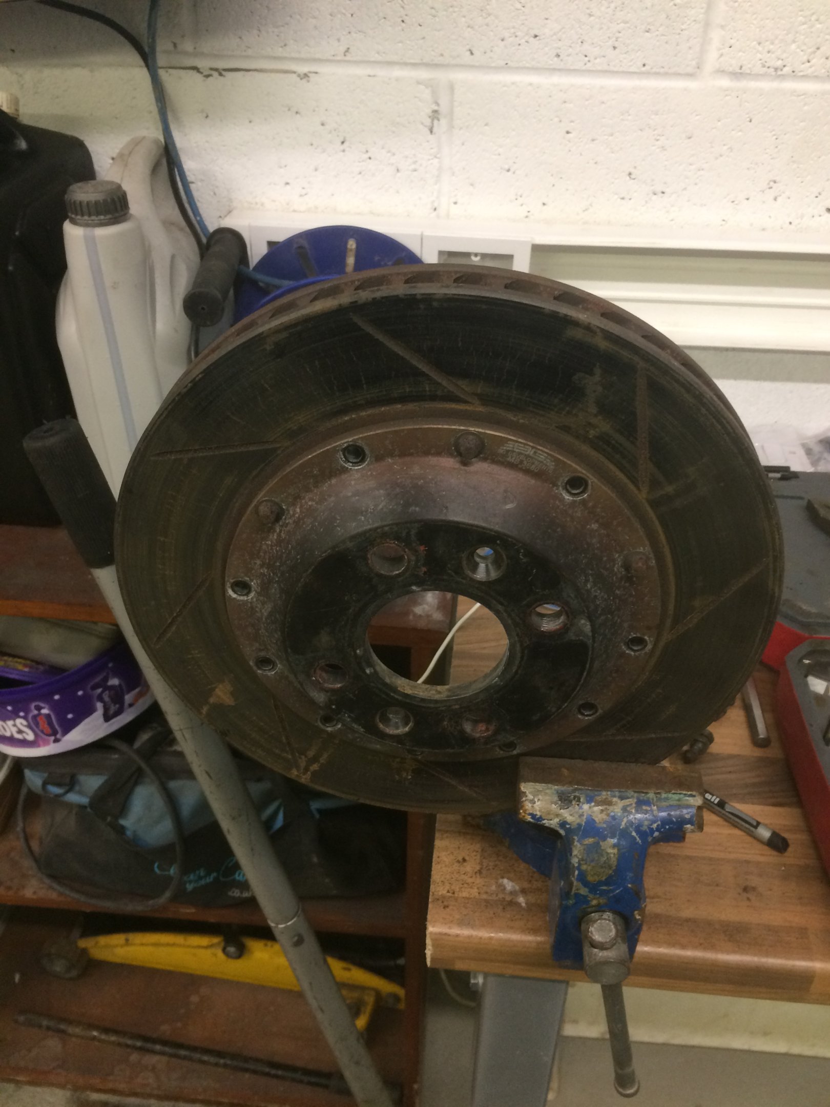

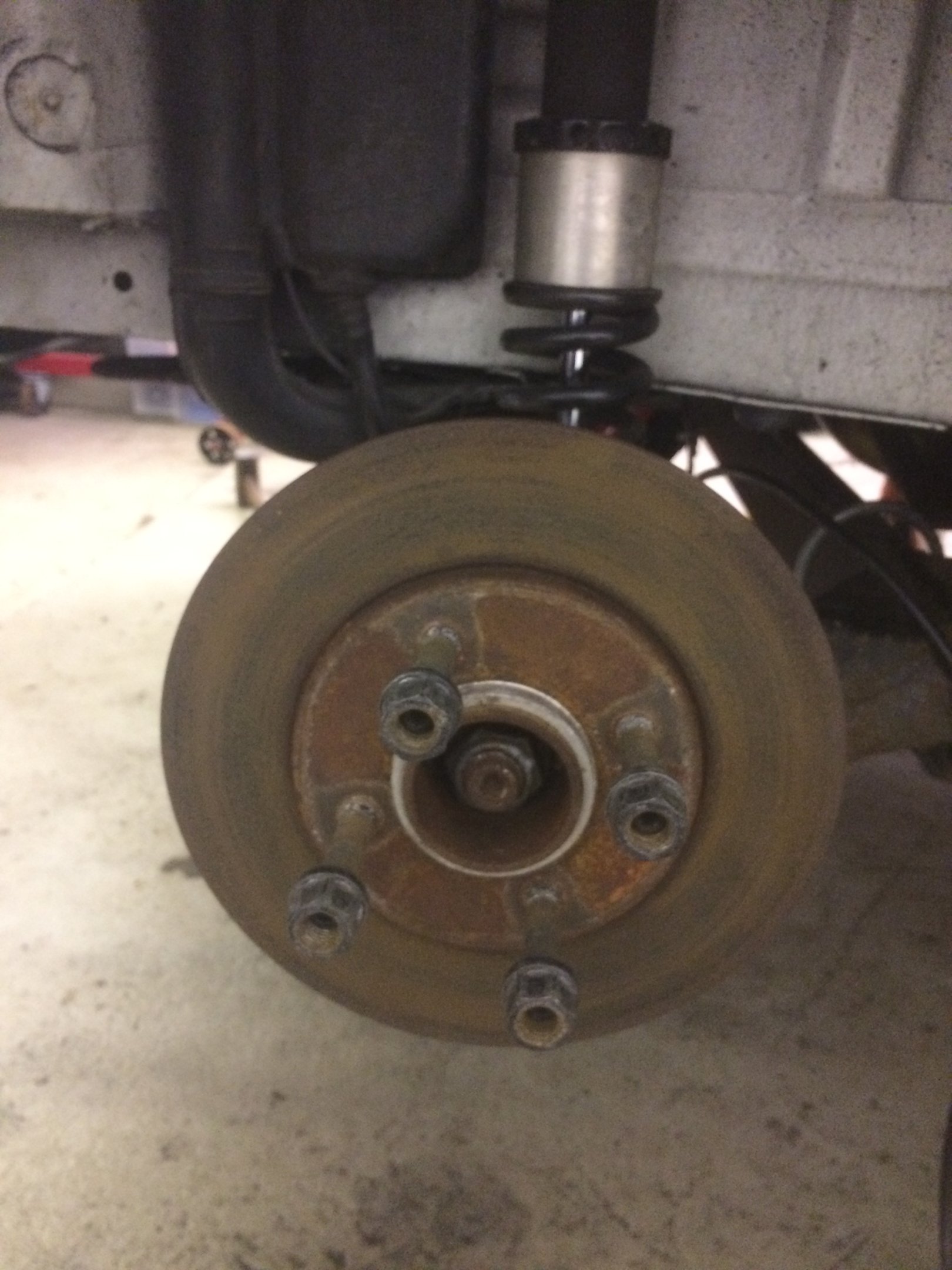

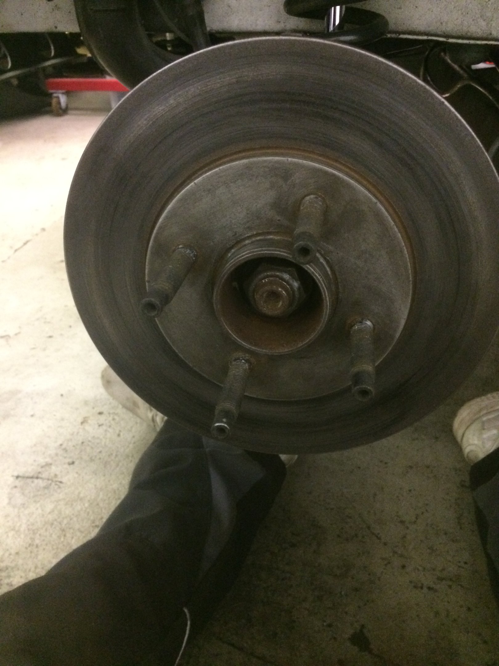

Didn’t want to fit a new set of discs even though I’ve got a spare set! (Tight!) so cleaned my others up at the weekend while doing a couple of other bits.
Before
After
Gave me an excuse to strip the rear brakes anyway.

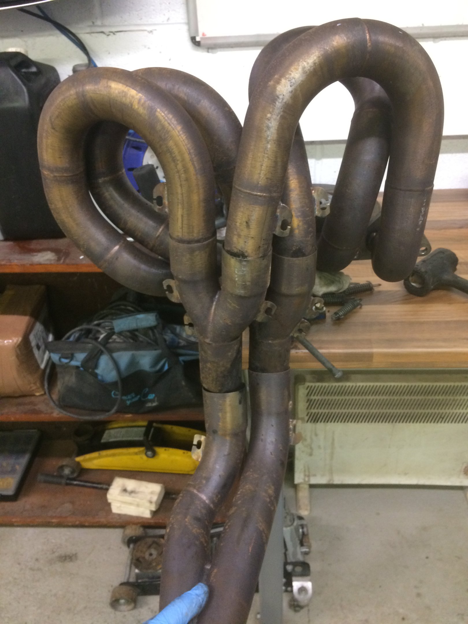

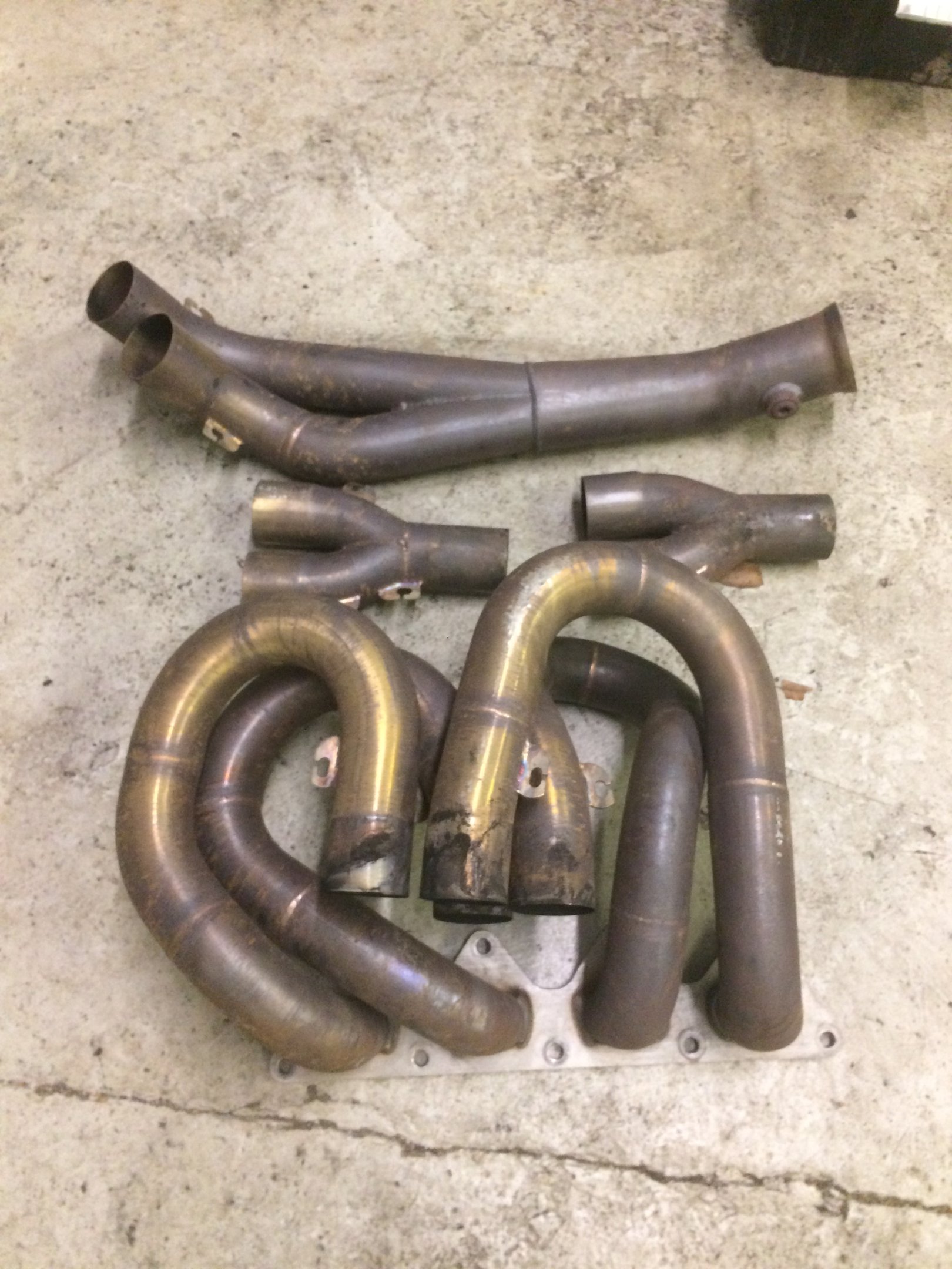

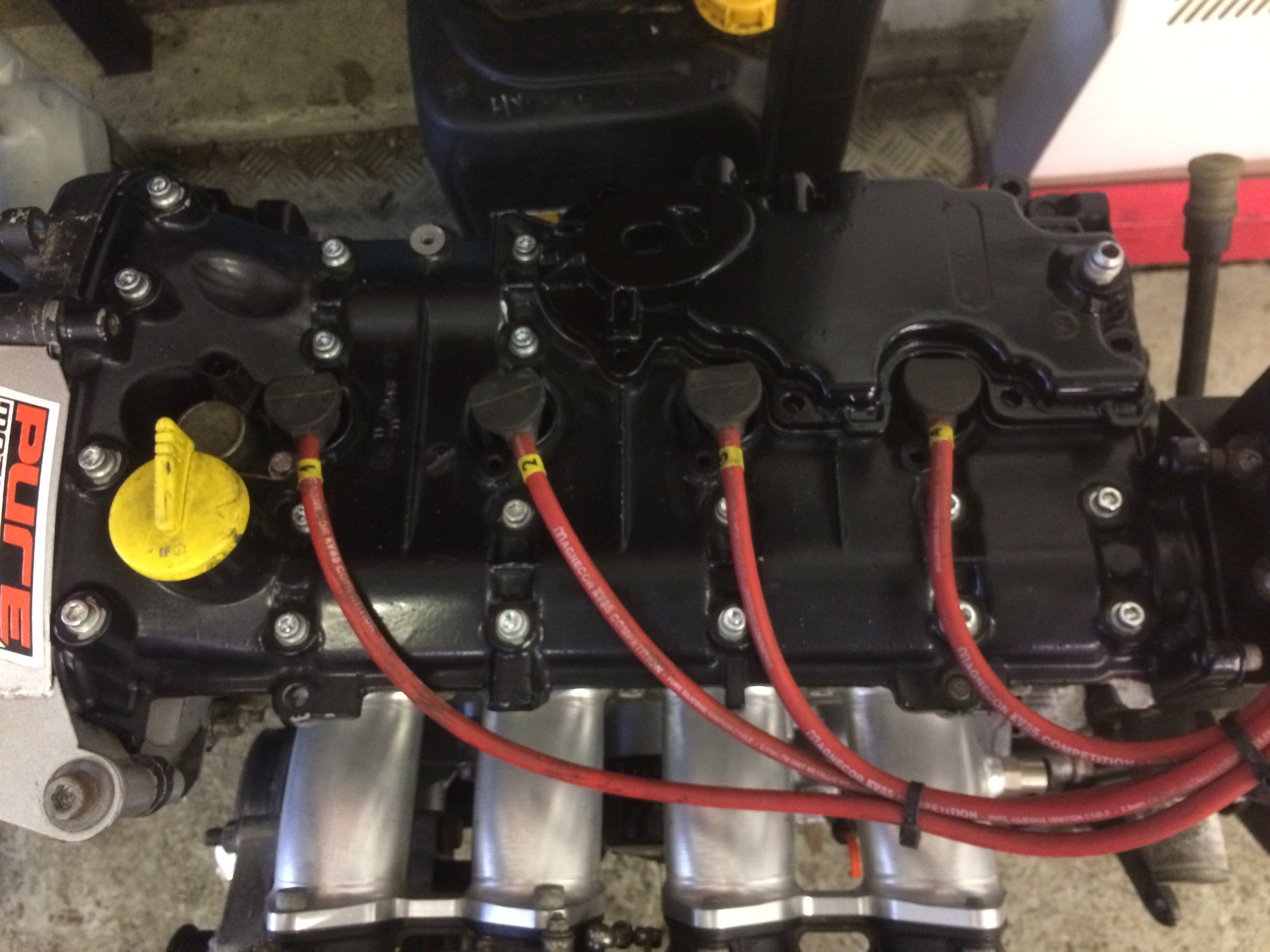

Not done a lot else apart from build the manifold back up.
I’m not going to ceramic coat it now on the advice of Nick @pure-motorsport so will leave it as it is for now.

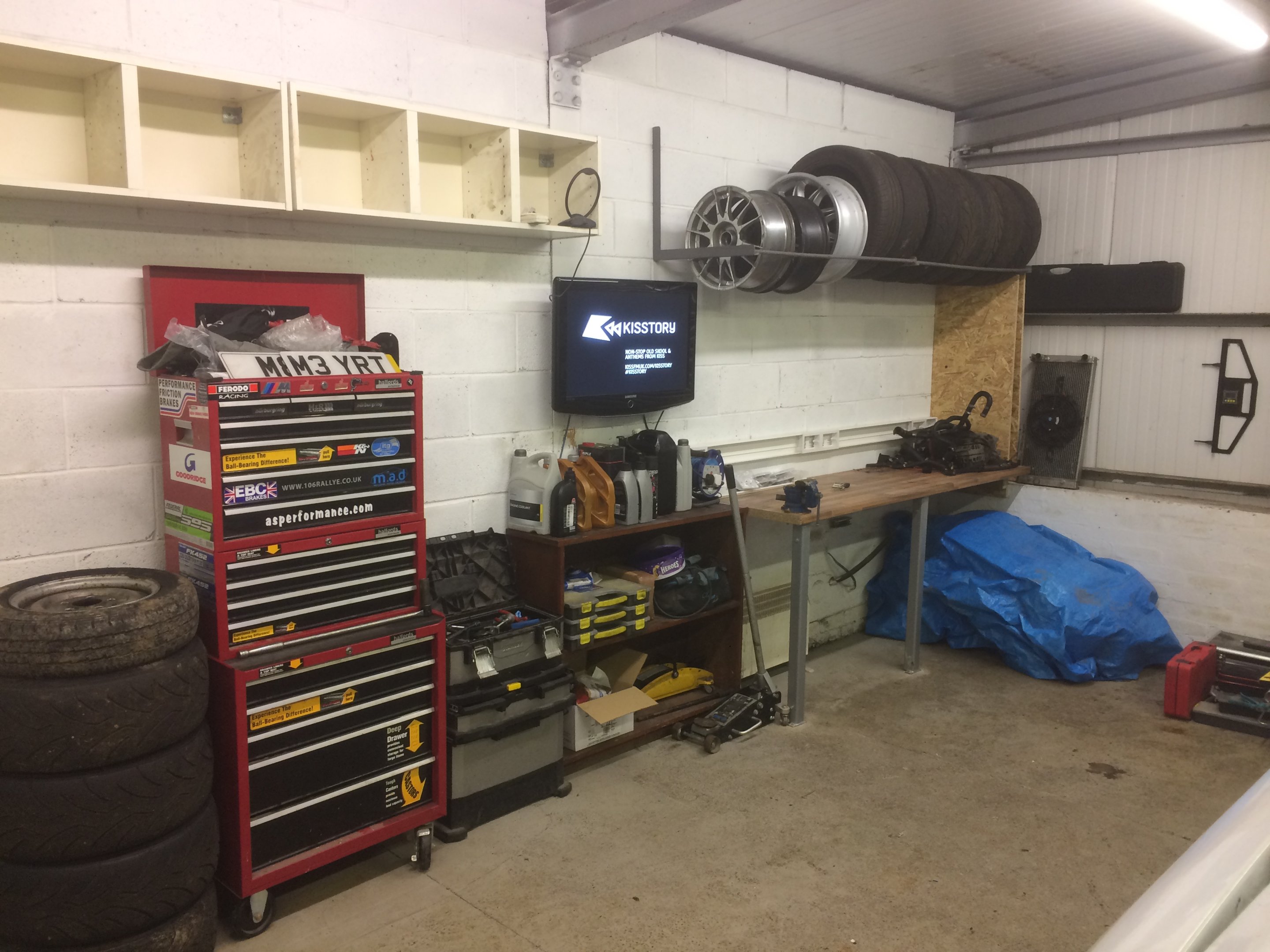

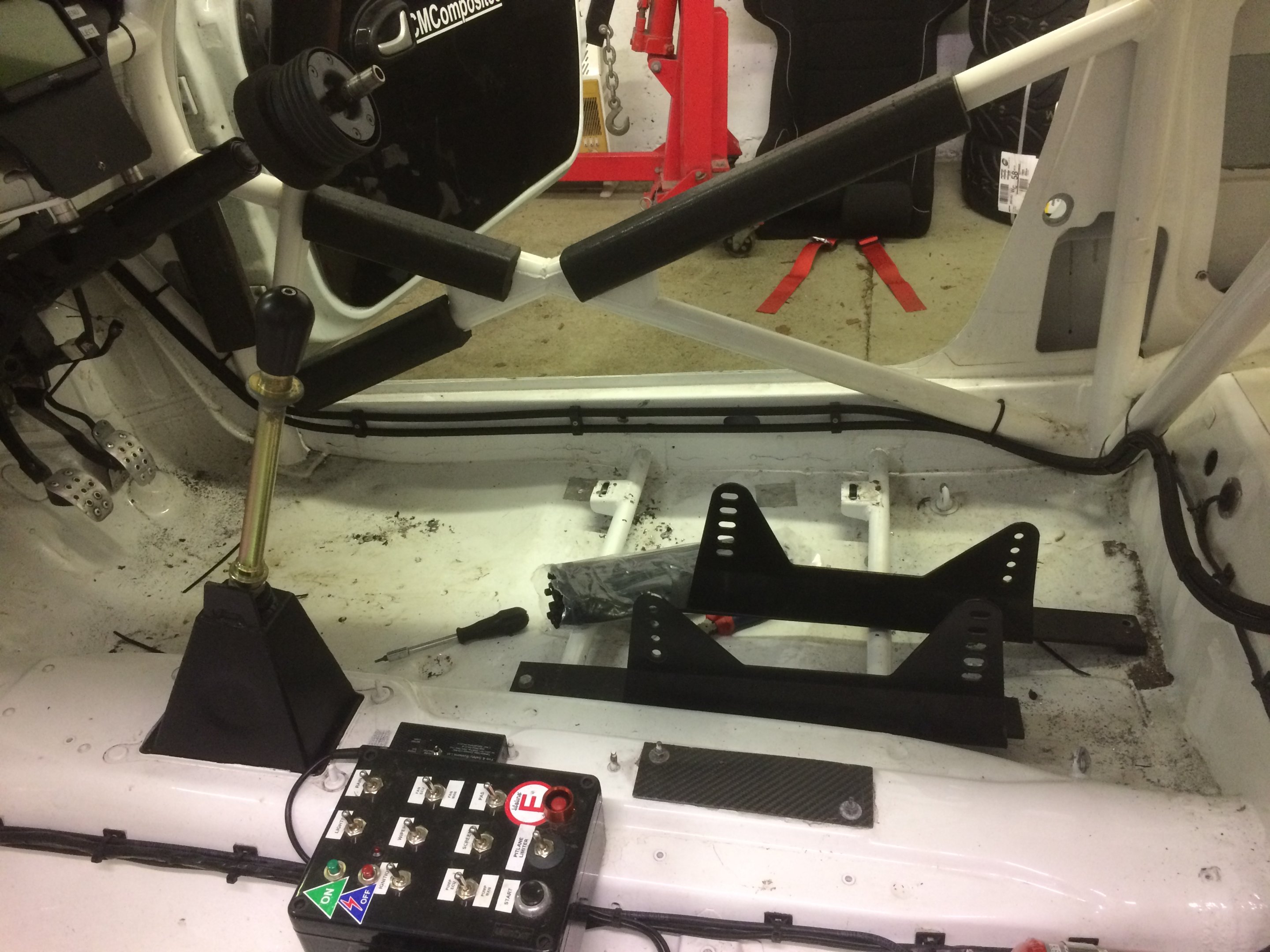

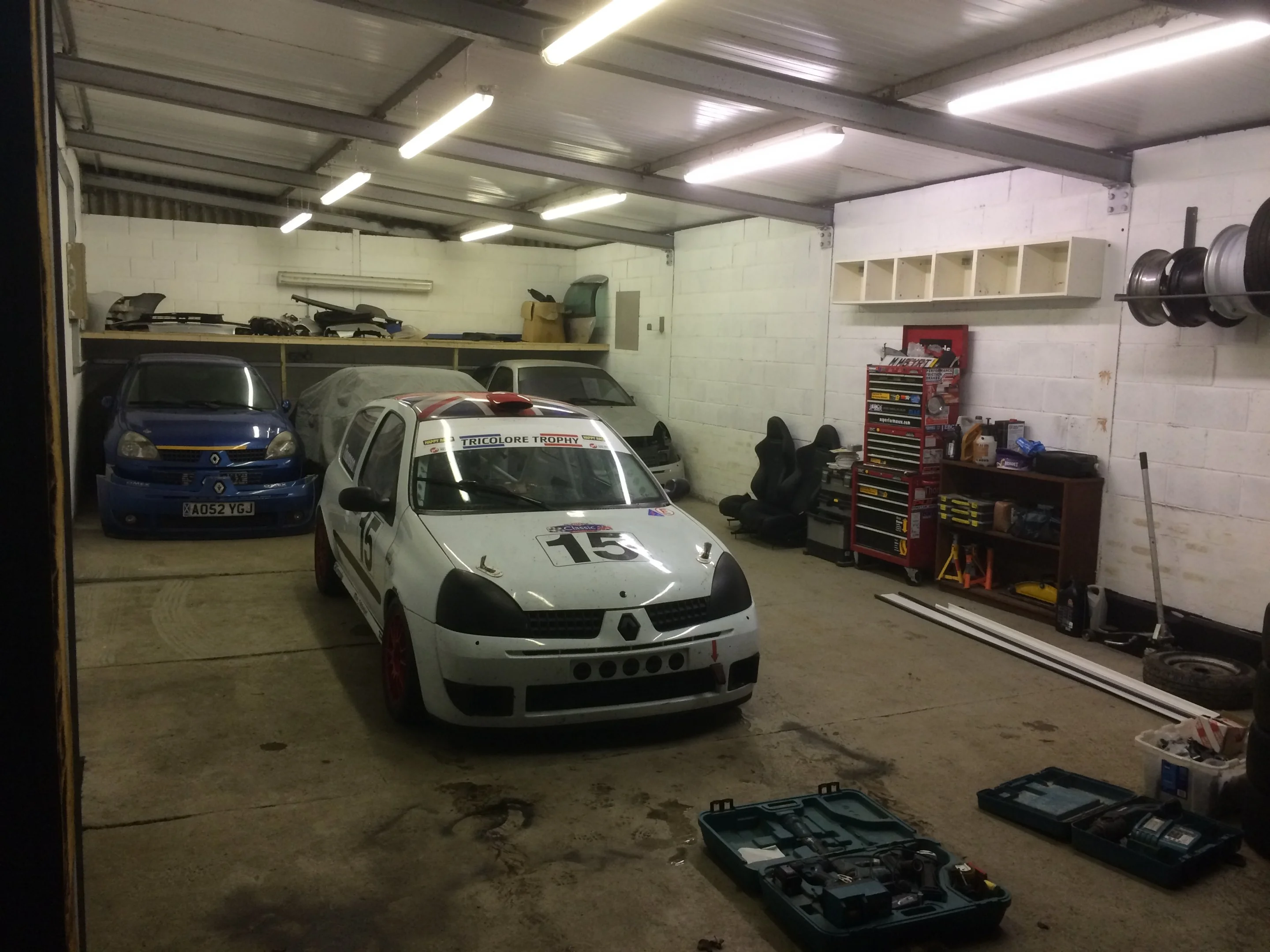

Been busy but seem to be getting nowhere fast. Last weekend was spent mostly doing little bits on the truck.
Still got a load of work to do, making a proper living area with seoerat ‘garage’ and enclosing all the taillift so it looks a little more finished.

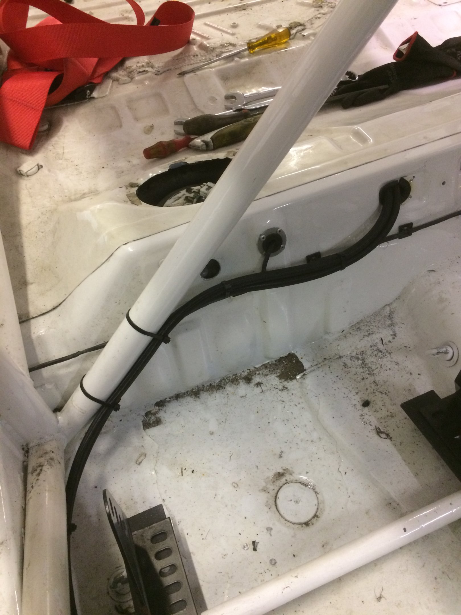

Been trying to get the fuel system finished, it’s 90% done but waiting for x2 fittings which are out of stock everywhere and need to do the last couple of hoses with the engine in.

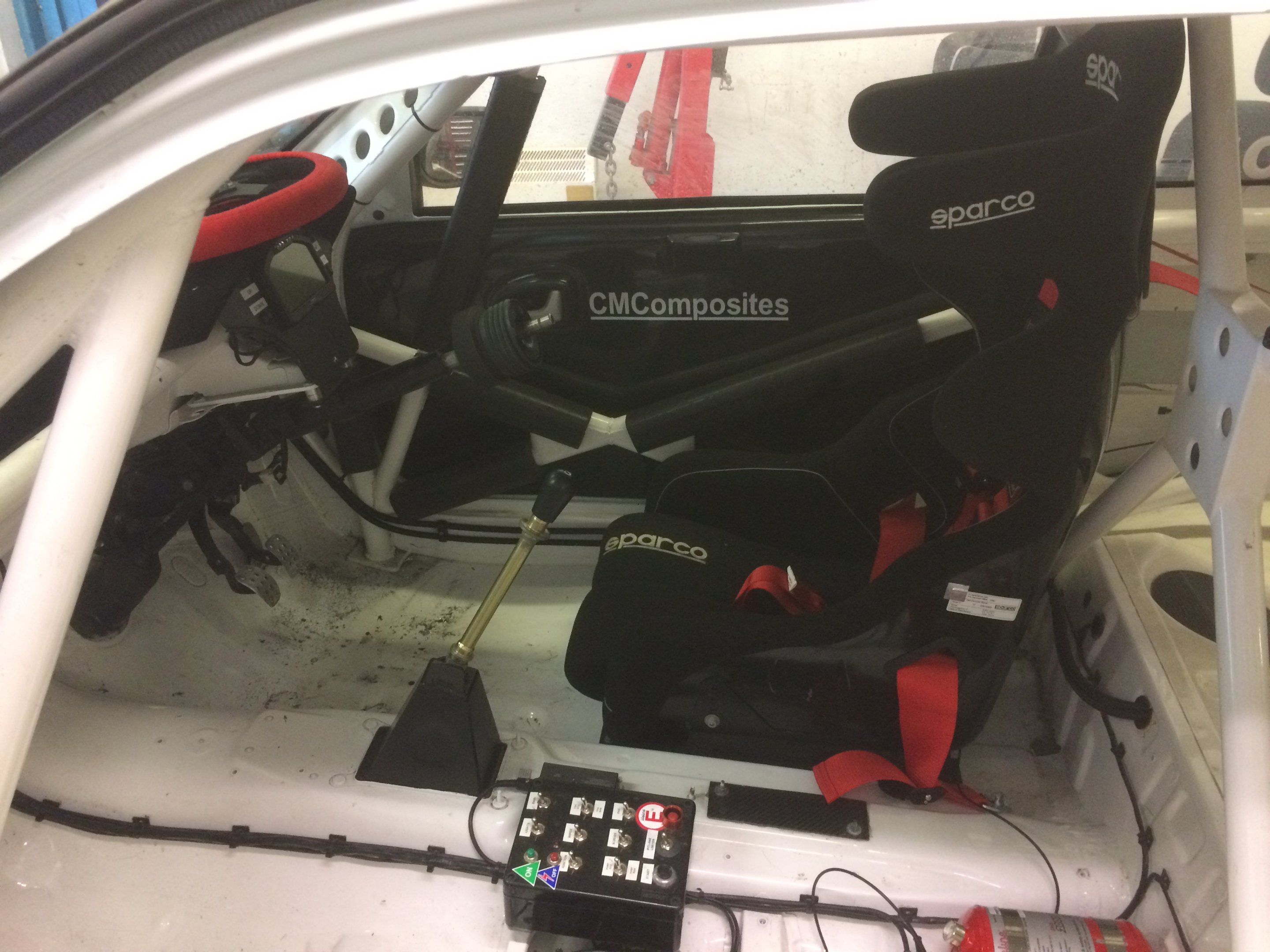

They’re all finished from the back through the interior into the engine bay, just need to finish the wiring at the fuse box too.
Seat and harness back in.

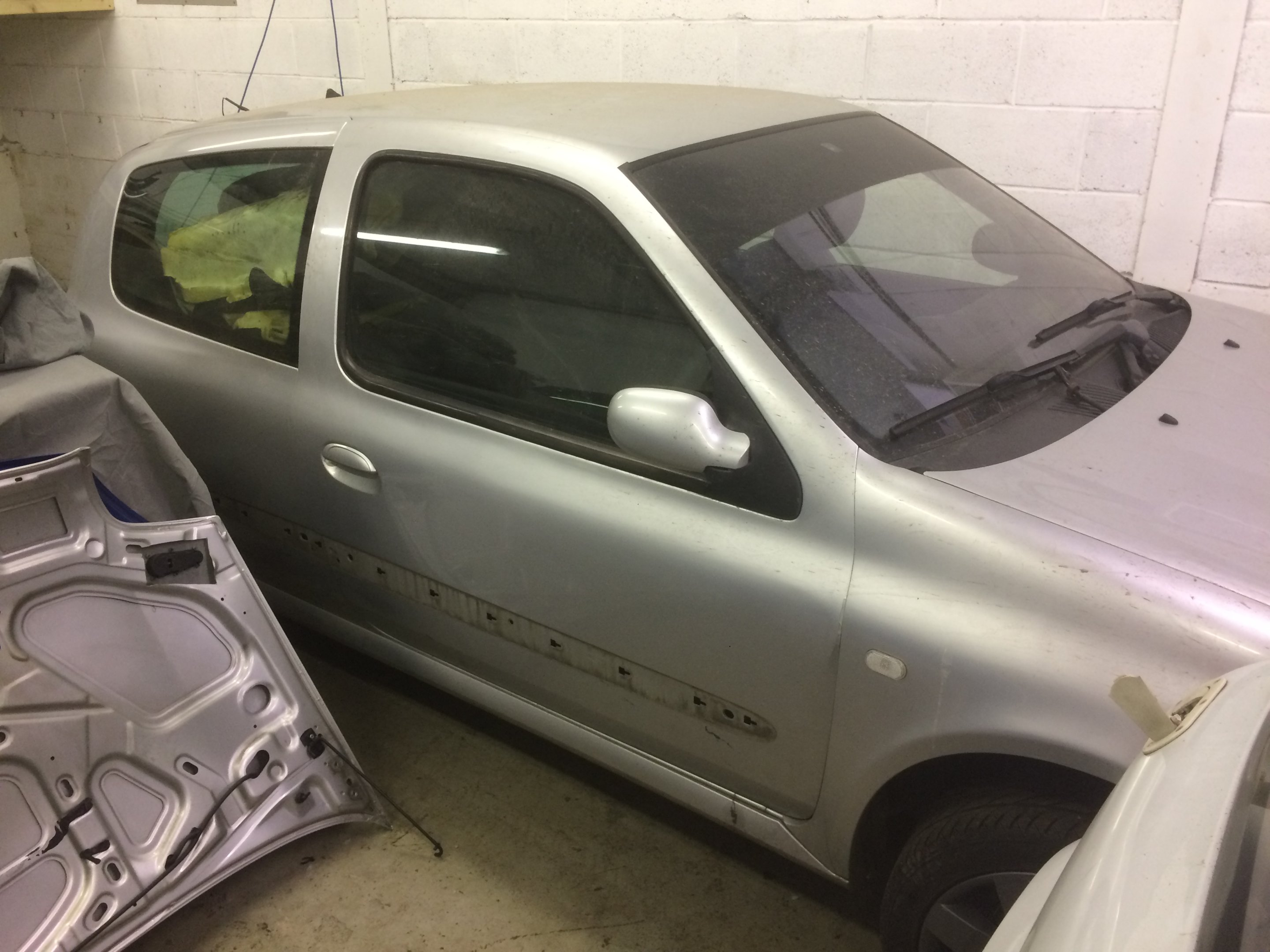

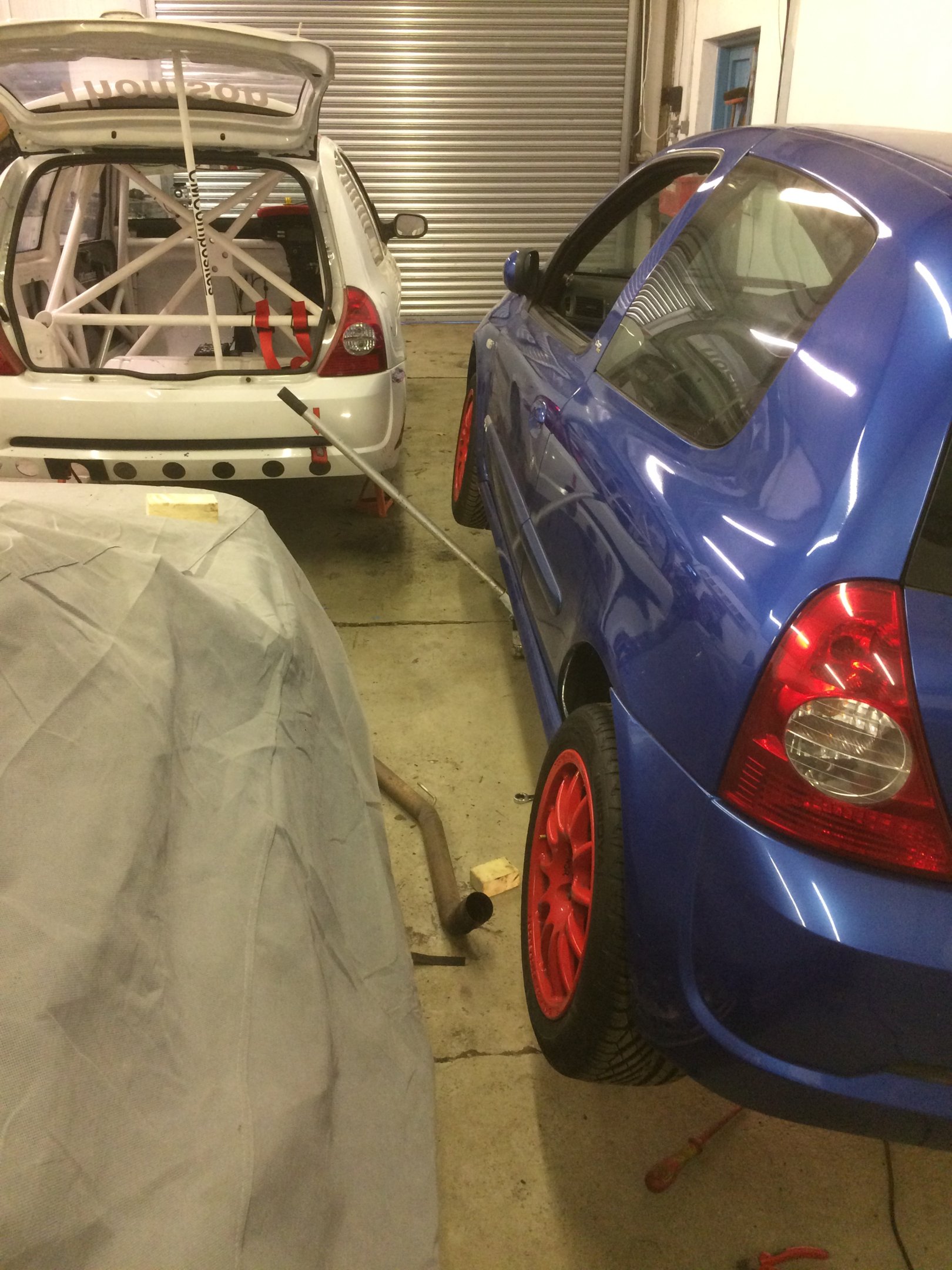

Needed to get it back on it’s wheels as I’m running out of space, tidied the silver shell up and too some pics to sell it so Nicole was pushed outside.

Do you run with the heat shield for the starter motor? And have you got much further with your bell and rotor setup?.. I can’t remember what size wheels you run. I’ve been running a bell and rotor setup near on two years now under a 15” wheel and looking for new bells.
Also just posted so I don’t miss an update of yours (y)(y)(y)
Good to see she’s getting built back up(y)
I don’t run the heat sheild no, I find them a pain to remove if you need to get at the starter, the wires are heatsheilded that go to it though.
Bell and disc wise I run 295 x 28mm discs with Alcon calipers under 15’s, just remaking the bells properly as I used some ones for ap calipers originally and used a spacer behind the bell to correct the offset.
