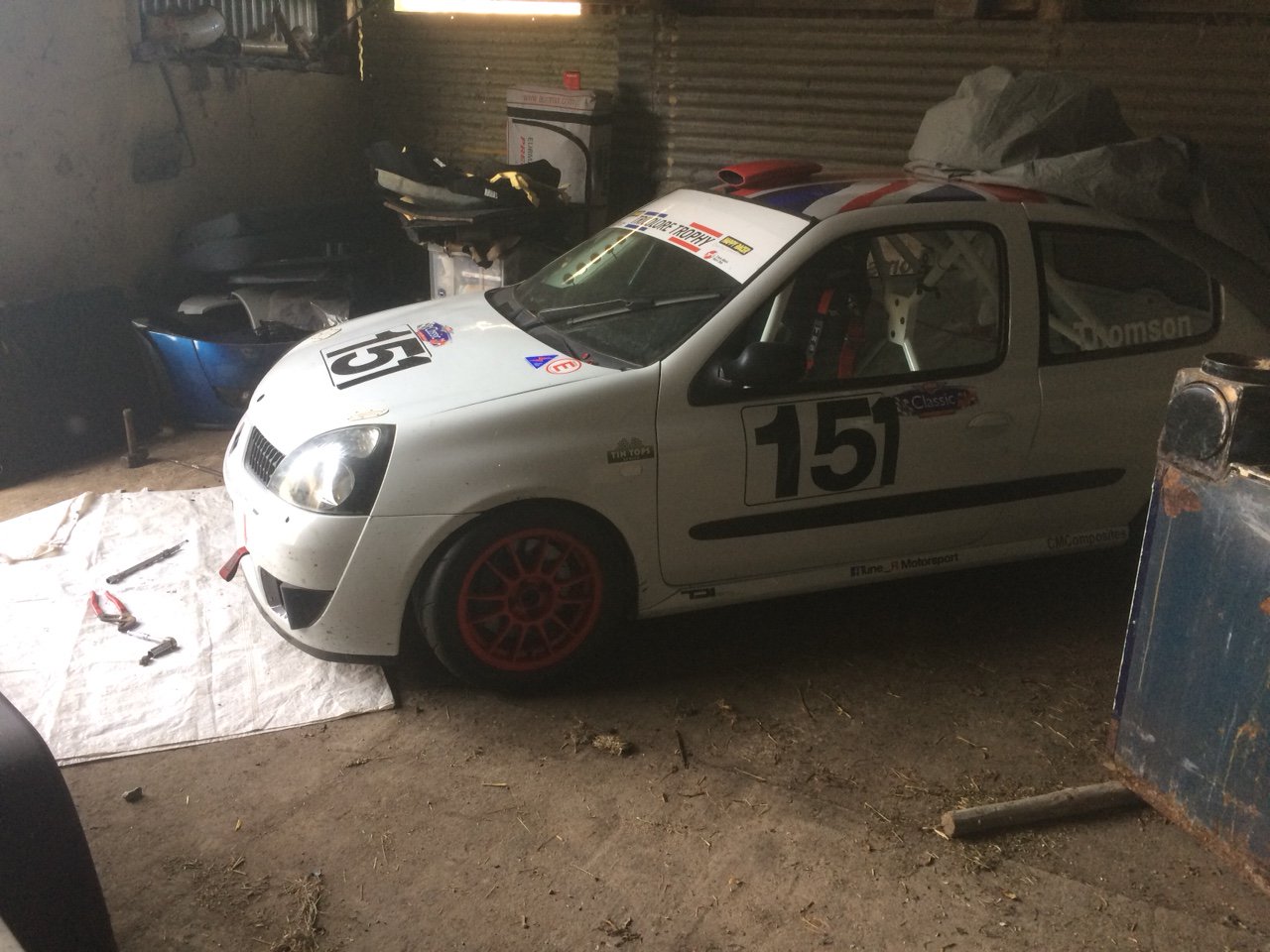

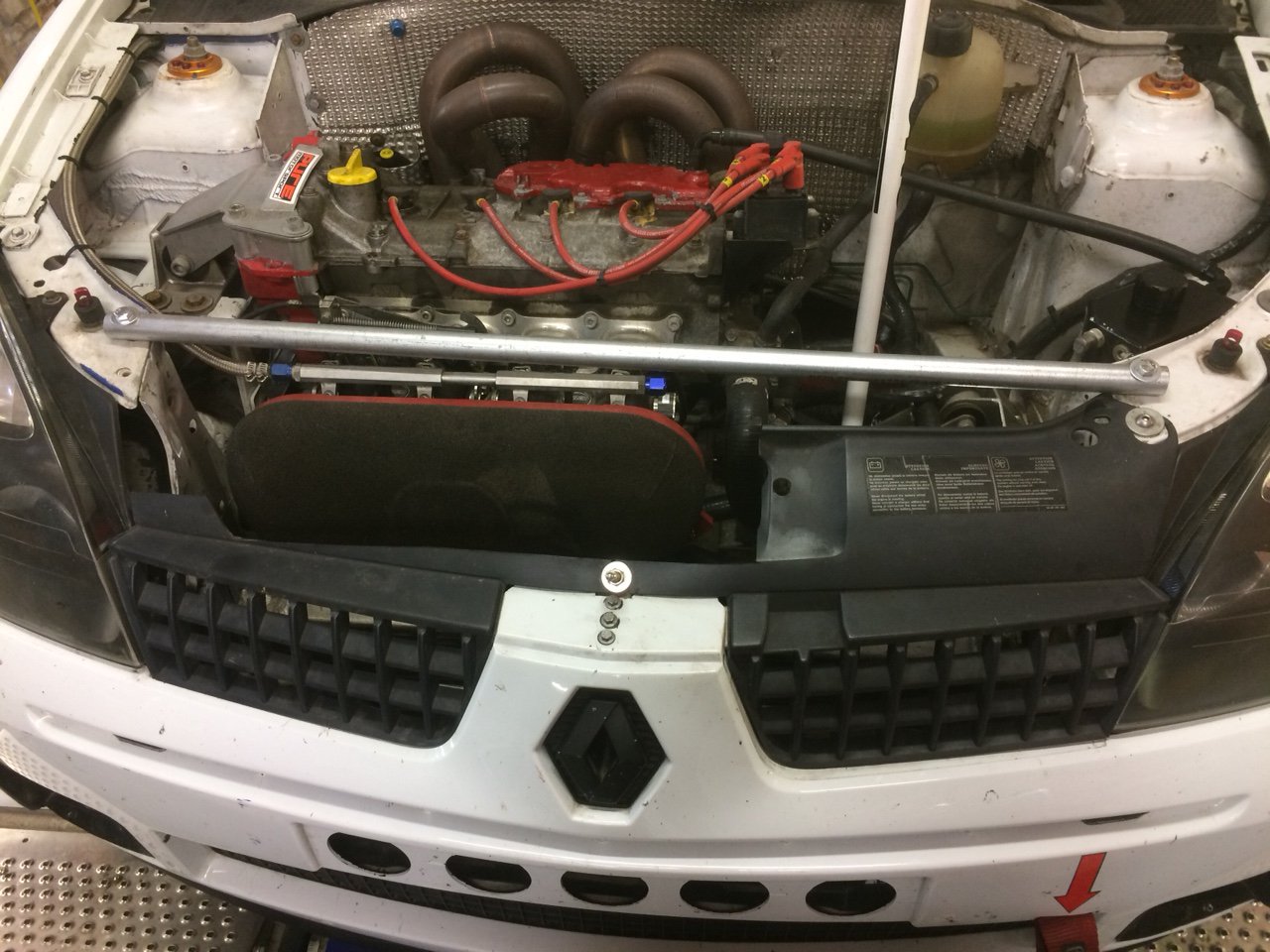

One question, the centre bonnet pin, do you have a pic of where you have mounted the pin, from zooming in it looks as though it’s at an angle off maybe the bumper? It’s a nice neat solution to keep the centre of the bonnet from flapping!
Mounted on the bumper/grille at an angle with reinforcement behind. It’s ‘just’ strong enough to do the job and is the neatest idea I could come up with.
Excuse the state of the bumper!

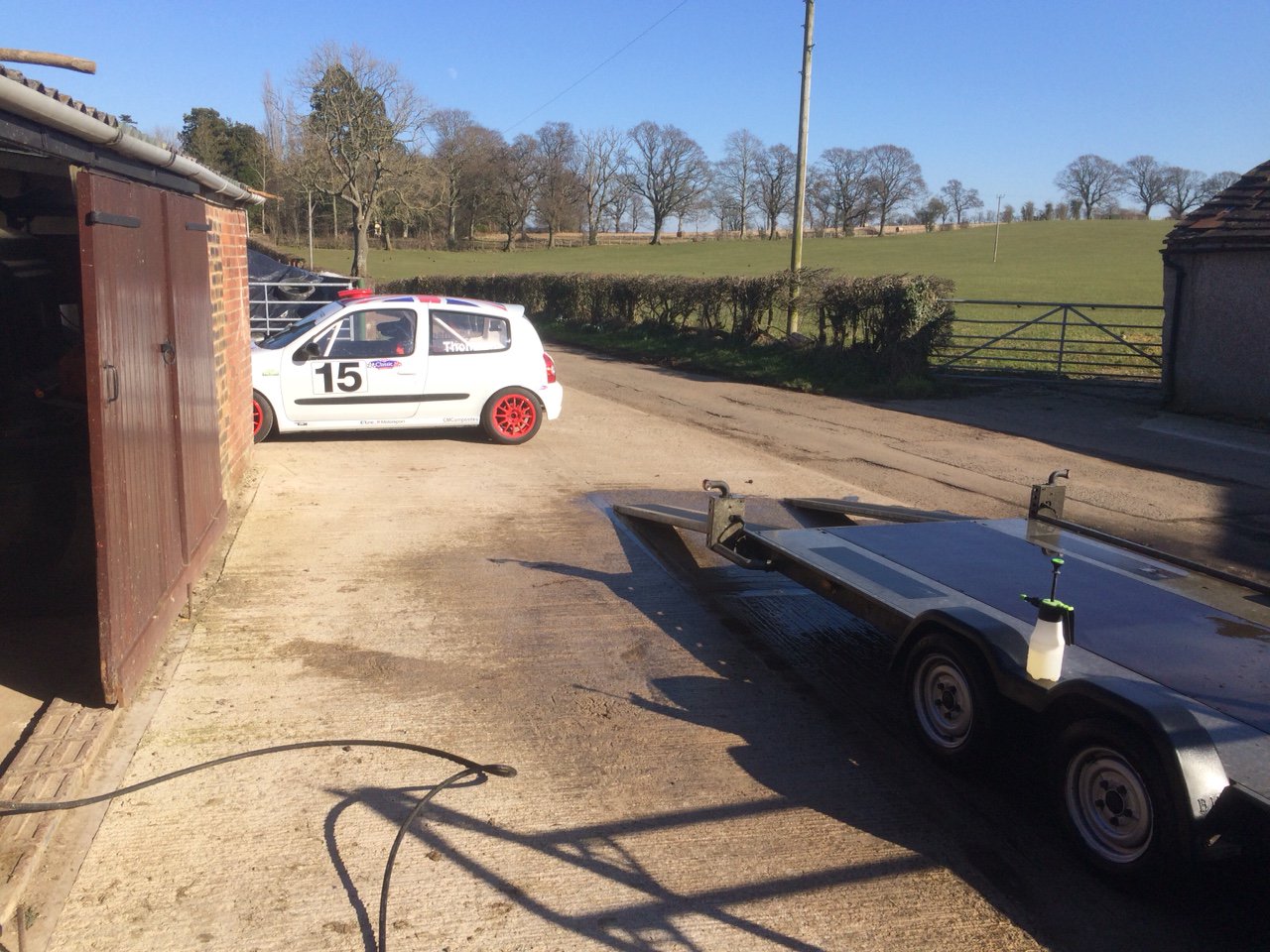

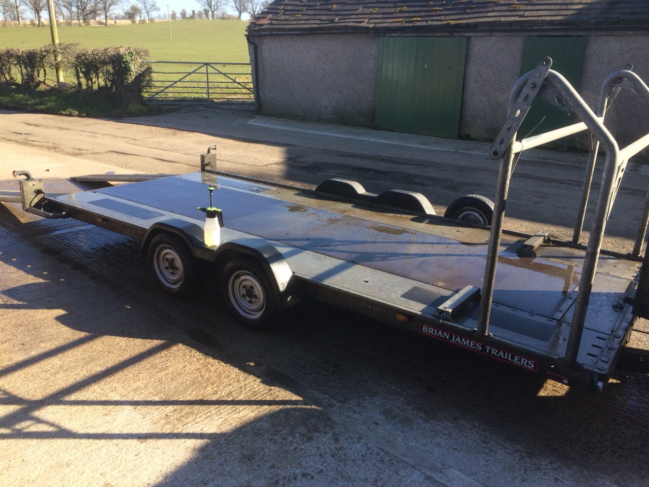

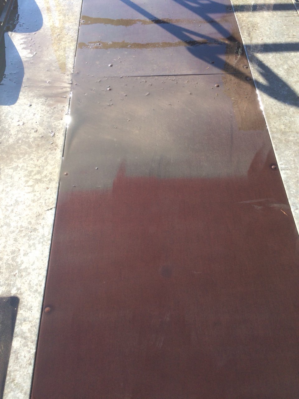

Just getting prepped for the upcoming season. Most important job, washed the trailer!
Centre deck was filthy and it was looking a bit sorry for itself.

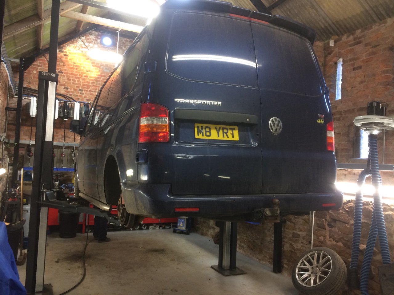

Had the van on the ramp too for new discs and pads all around, new brake fluid, new engine oil, air and oil filter.

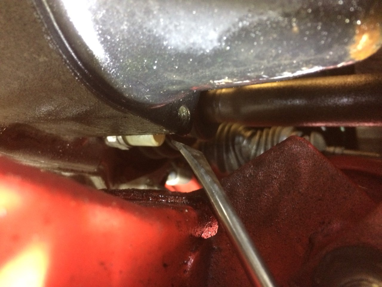

Needed to do a couple of jobs on the Clio that are a pain on my own so got my mate to adjust the gear linkage while I sat in and played about with the lever!
6ft off the ground, perfect view of the tv and still nothing on! Got the linkage perfect though, never perfected the position really since I changed to the new pure motorsport mounts but got it now hopefully. Spanner checked it all too and plan was to geo it but not sure I trust the setup in the workshop even though it’s brand new and expensive I think it’s out of whack at the minute. A check on a friends Hunter will hopefully tell me as I’m not getting the string out!

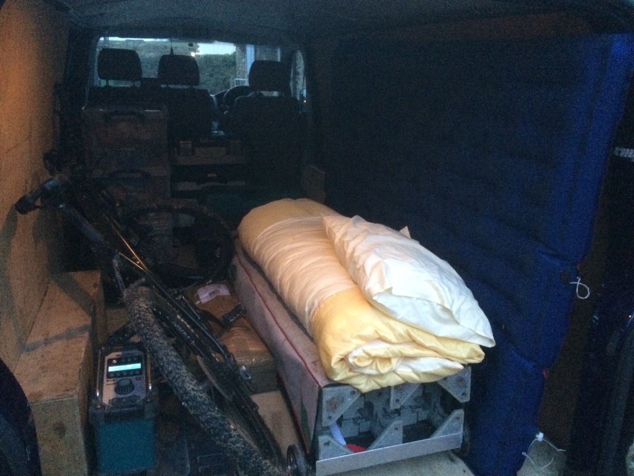

Van all packed up ready to go
My home for the weekend

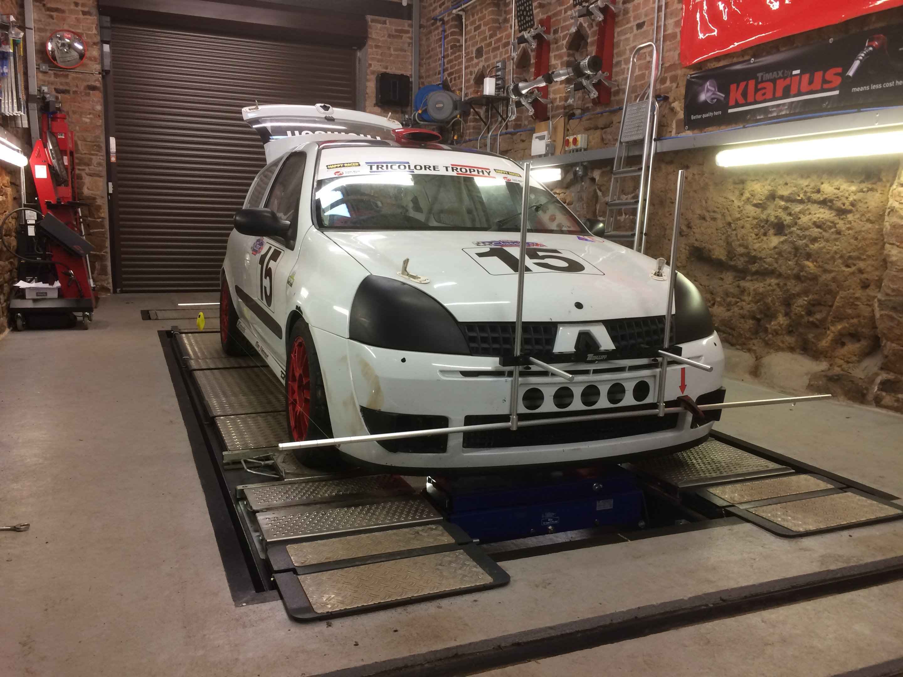

In preparation for the weekend Nicole was given the usual check over and instead of using the expensive wheel alignment kit on the work shop that I don’t trust I resorted to string and a new camber gauge and frame!

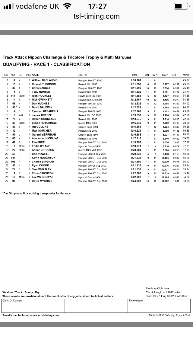

Quali went well, got some quick laps in early before we caught the traffic. Thought there was more in the car and managed to get a space to put a proper lap in but ran out of time and the flag was out. Even so a 1m11.0s was enough for the front row with Will DiClaudio’s 106 on pole.

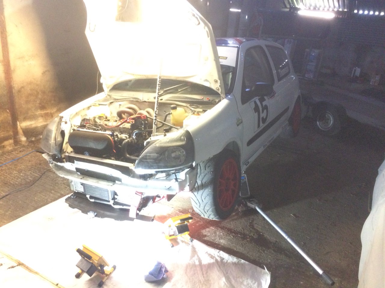

Been getting the car ready this weekend. Changed the engine oil and filter + the gearbox oil as well, they’ve done 2 race weekends and still looked pretty clean so pleased with that, first time I’ve changed the oil in this motor.

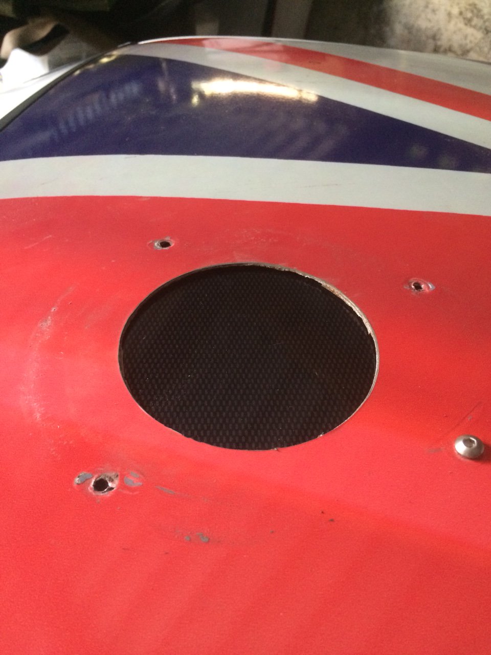

Seen as the tintops have different regs. the headlights are back in and the roof scoop is off.
Had to make a plate to replace the scoop and leave the vent in place.
Plan is if it’s warm I’ll Remove the plate and leave the vent with just a hole in the roof to try and get some air in, regs are there to keep the silhouette as it left the factory.

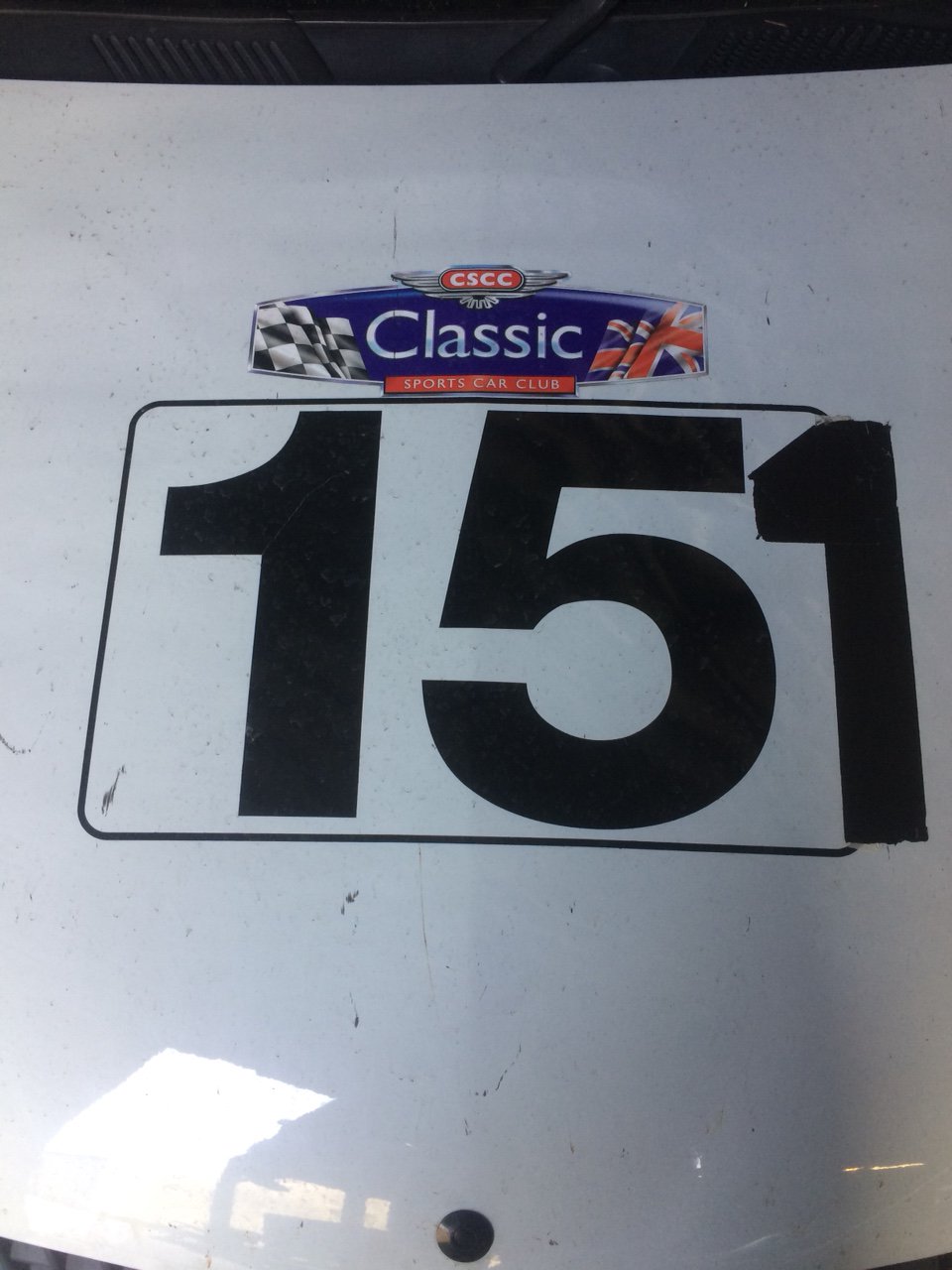

Put some temporary numbers on as well with masking tape underneath so I don’t pull the other stickers/number box off. Has to race in Tricolore again in 4 weeks so want the proper numbers to stay. I know it looks a bit pikey but so be it.

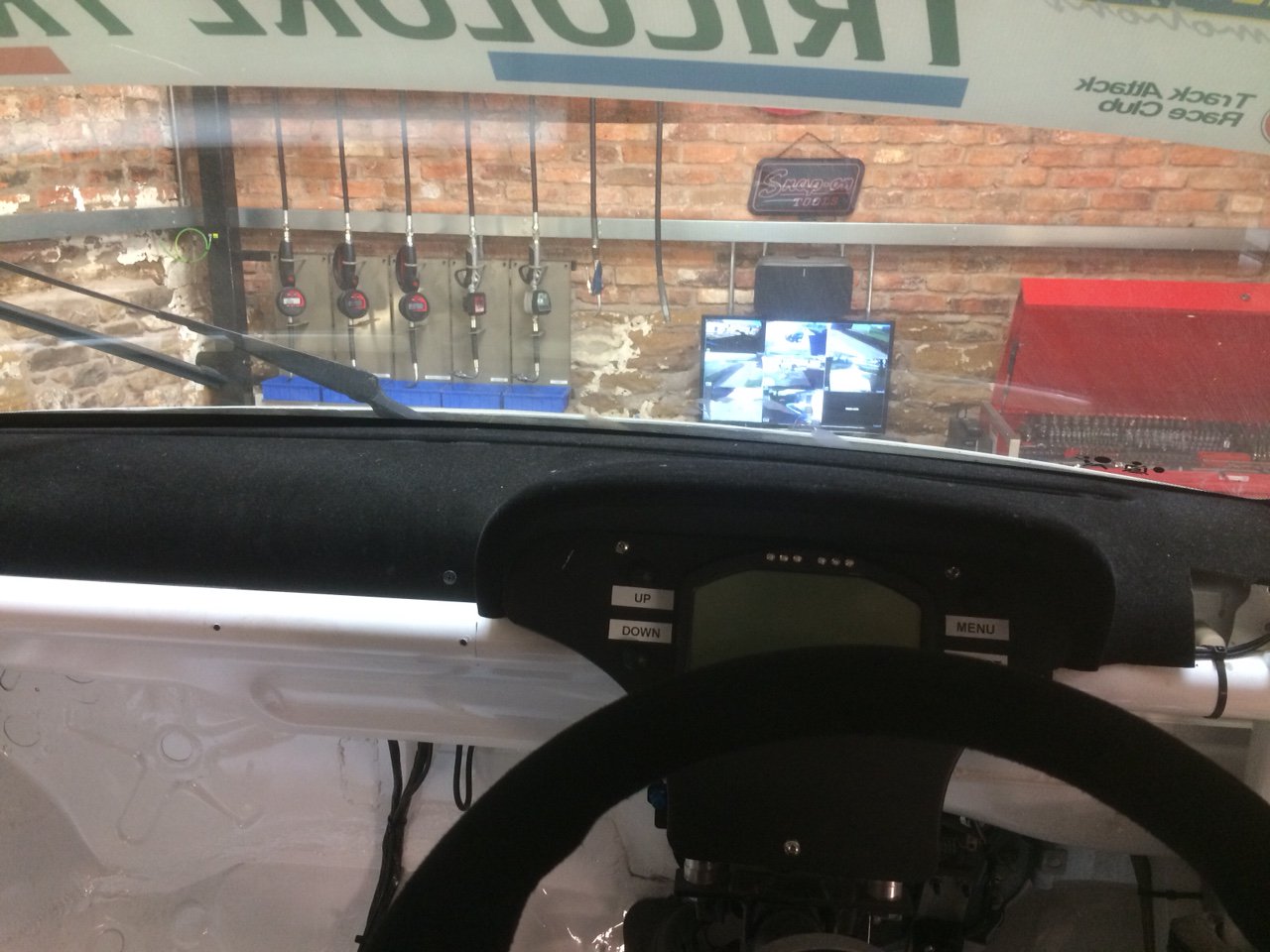

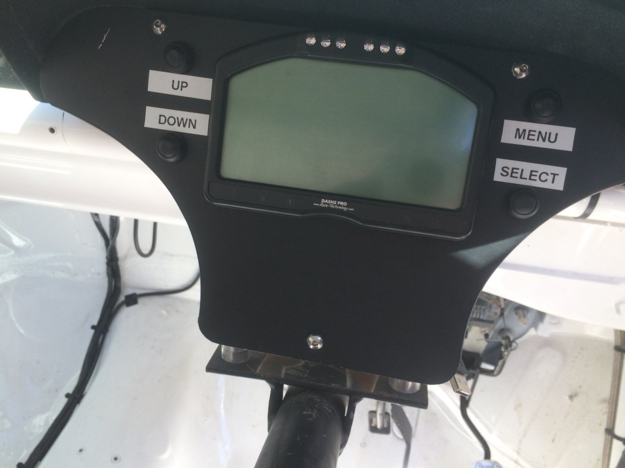

Also sent my Race technology dash away to have the firmware updated. Latest update has some decent features for auto lap timing which will save mesons hassle.
Got a pair of new Dunlop’s to go on after ruining them at Pembrey too.
Only things left to do are the usual geo and spanner check which I’ll do on the ramp this weekend hopefully.

Dash is back with the latest firmware. However race Technology haven’t done what they promised and re-loaded the original configuration back on it! Much pain in the arse redoing it last night as I didn’t have it saved.
Hopefully everything works as it should as I won’t know until race day, I hate that!

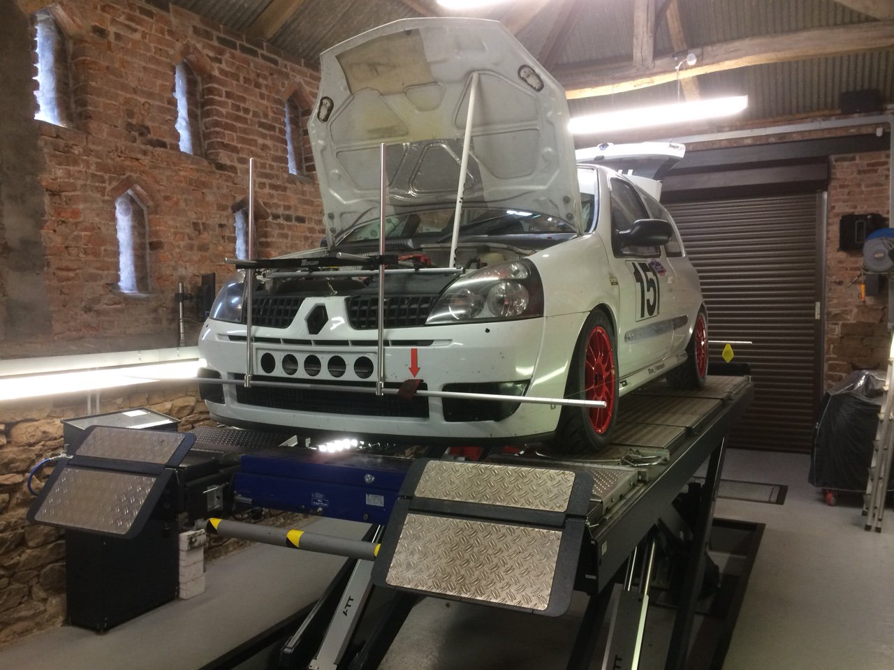

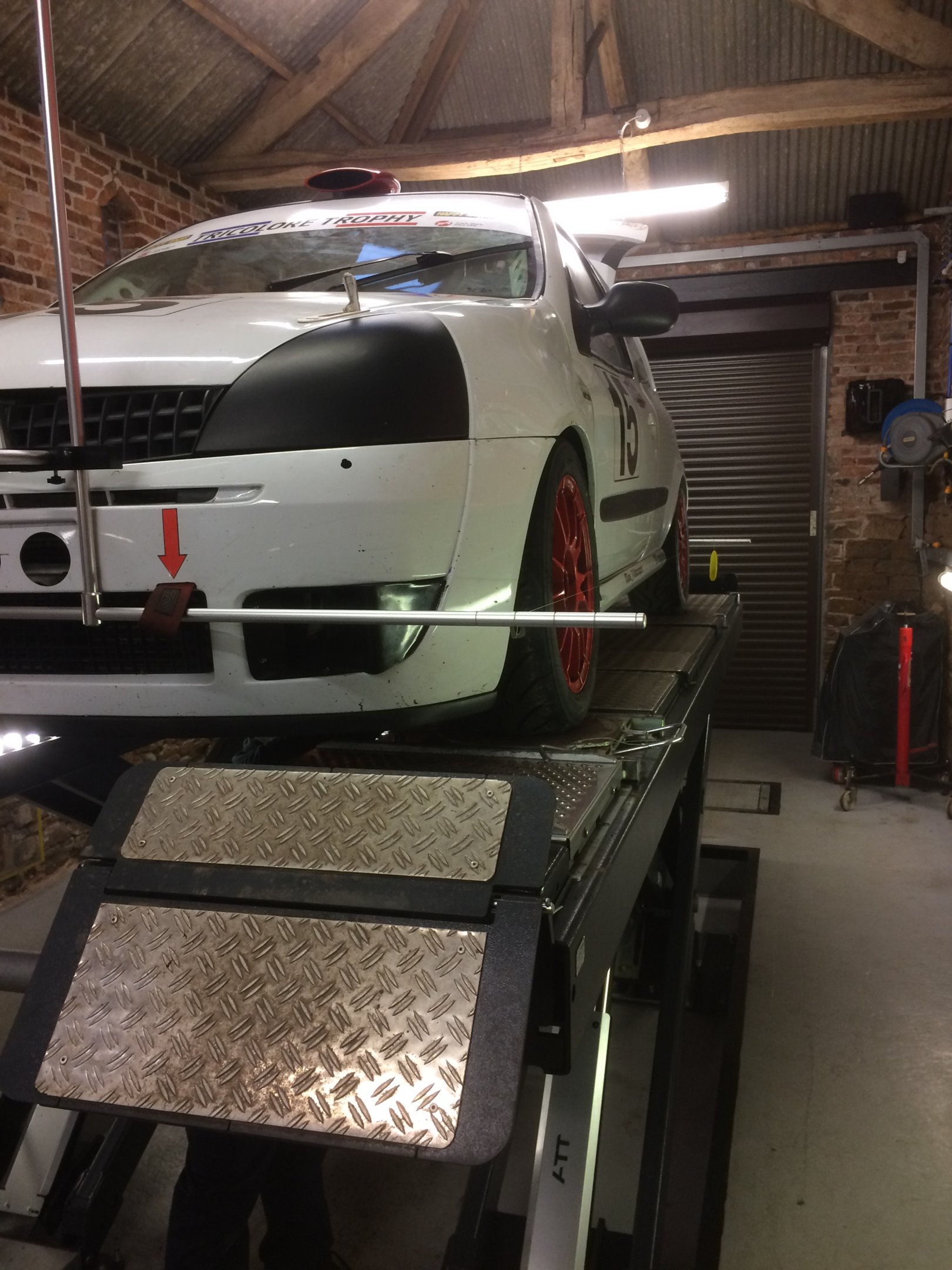

Spanner checked last night all good. Checked the geo and was bang on from last time I did it before pembrey.
Had to make a cross bar to hook the string line brackets on at the front as there’s no slam panel on the car anymore, had them jammed through the grille last time I did it.
