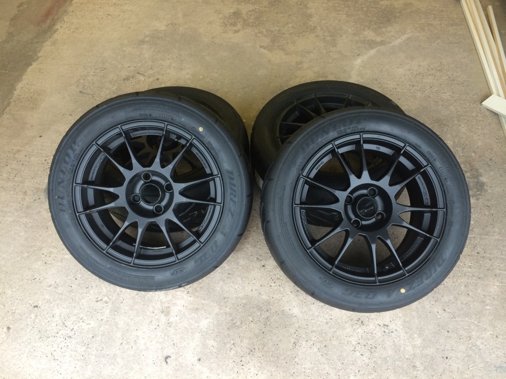

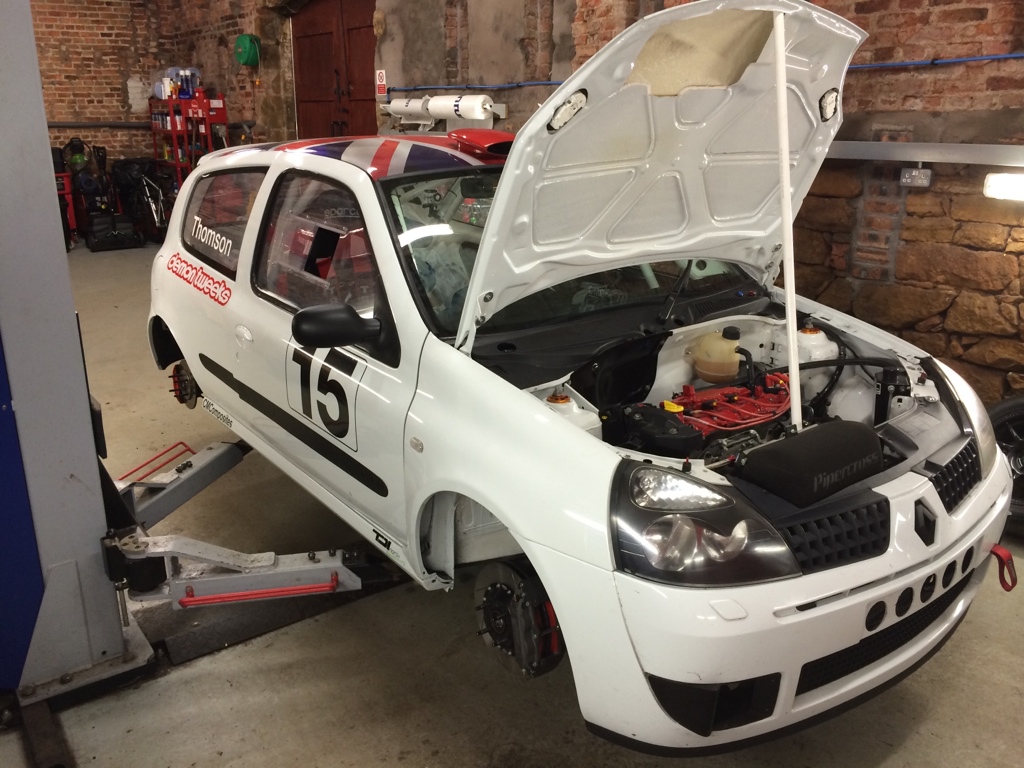

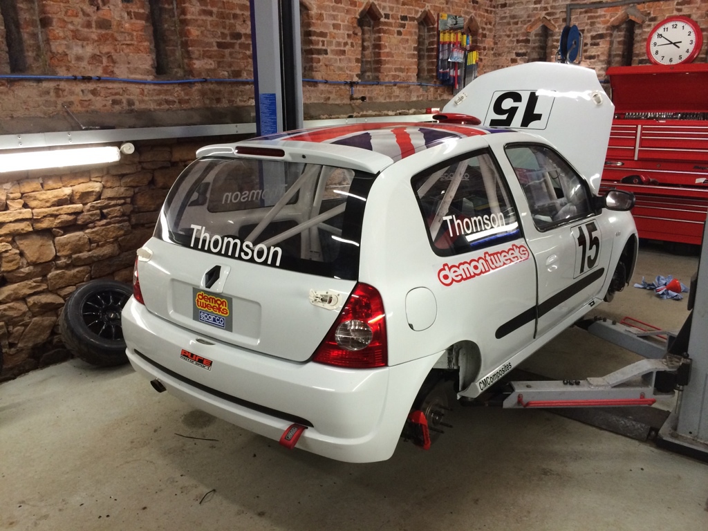

Another few steps closer, had the suspension setup at Blink in Winsford yesterday. Wasn't planning on adjusting the rear but it had moved/settled since last geo so a couple of shims required to get it back to where it should be, gained a touch of toe out on the rear too which should help. Also added some more camber on the front so is now 3.5 degrees, still 10mm toe out on the front and other settings as they were. Corner weights weren't far away from last time but the car was a lot lighter on the scales this time, I must have had it done with full fuel last time. Pretty sure I've got 15-20litres on board now and it came in at 886kg.

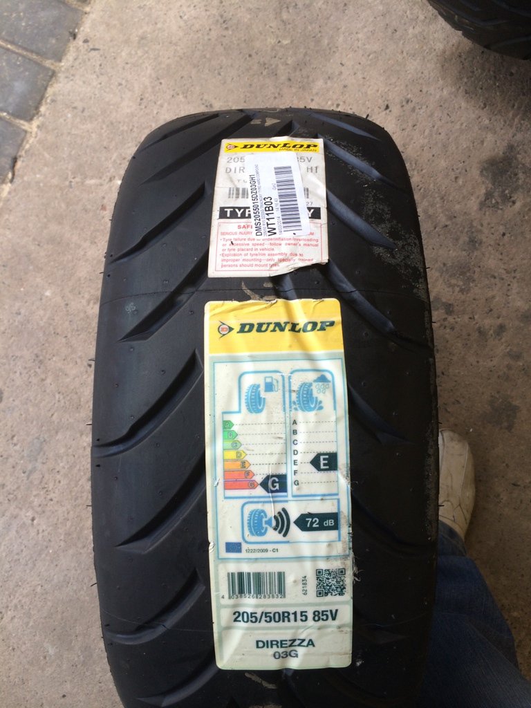

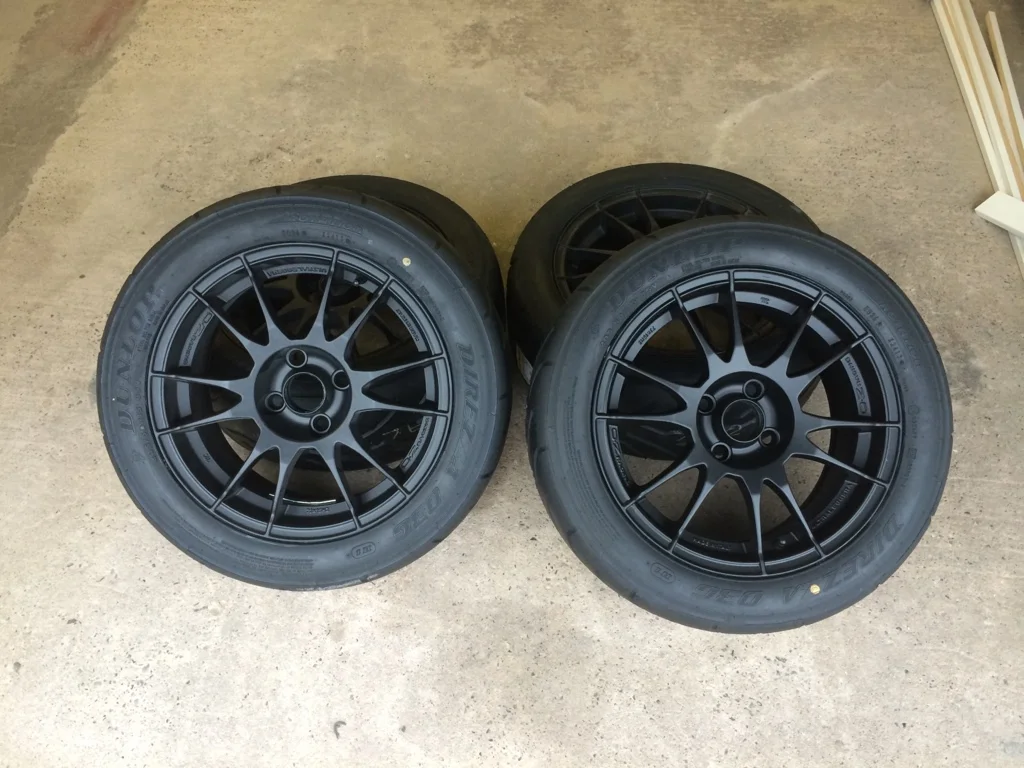

Picked up my new set of Dunlops from Tweeks and had them fitted to my Ultralegs, luckily the front 2 didn't need any weights on them at all so is a bonus for clearing the calipers.

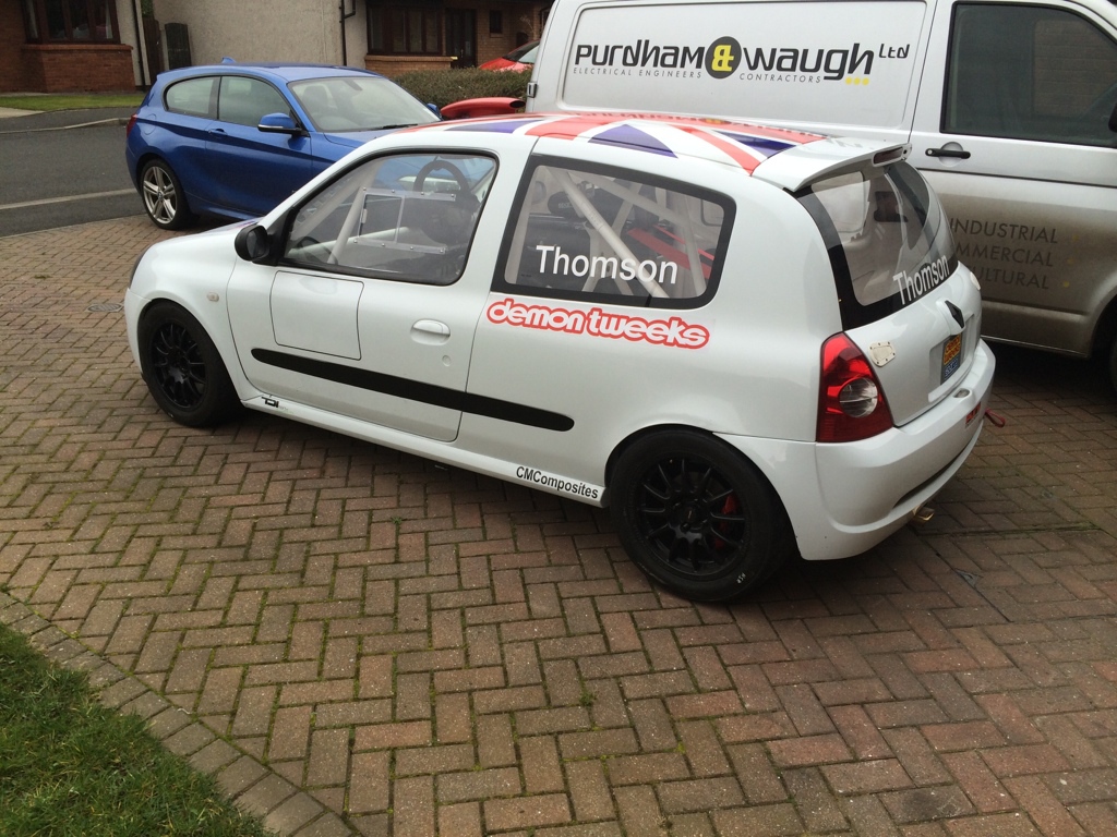

Got my new numbers to go on as well. Just have to change the brake fluid now and bleed the brakes and do a complete spanner check when its on the ramp.

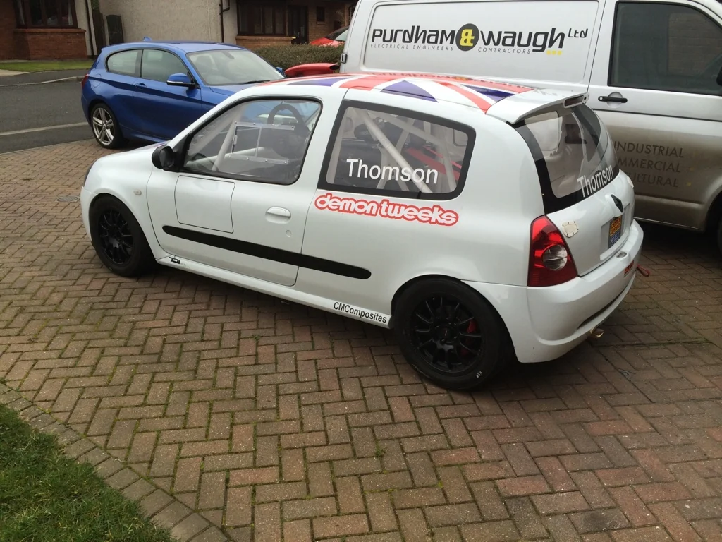

Have it a quick clean while it was out the garage too.

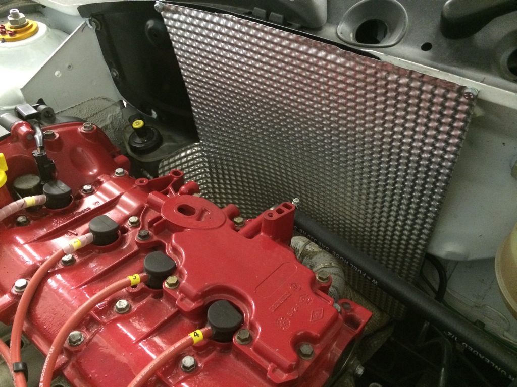

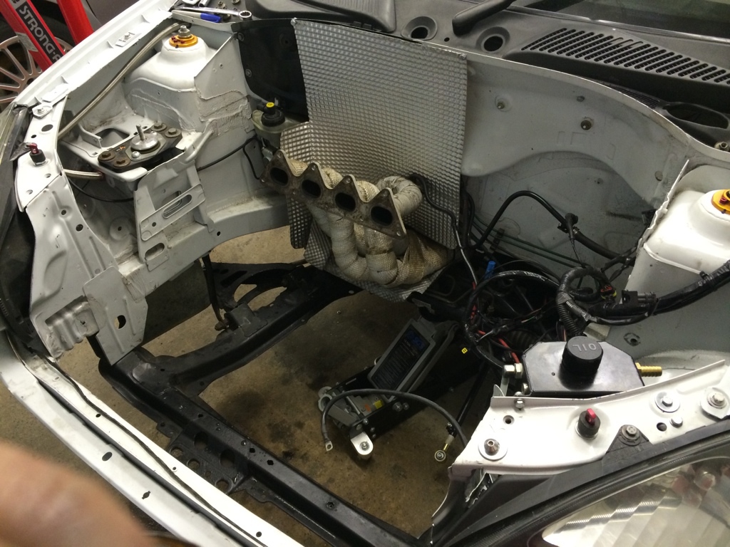

Managed to fit the Nimbus heat shielding behind the exhaust manifold to keep the heat away for the brake lines, pas pipes etc.

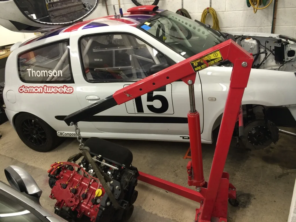

Black flag for drive by noise even though it passed static testing easily. Then I've got a decent engine oil and possible gearbox oil leak too. More info when I've pulled the motor tonight.

Check your thermostat housing seal Russ, can leak between that and the head, give signs of gearbox leak, I had a problem after changing and so did Sonny, Hope its nothing too serious mate

Well to my eyes it's just gearbox oil that was leaking into the bell housing and with all the clutch dust in there has run out black, no signs of any engine oil leaks, back of the flywheel and crank seal are bone dry as is the block under the stat housing.
Gearbox input shaft seal is visibly damaged so fingers crossed that's all it was and we'll be good to go for Rockingham.
