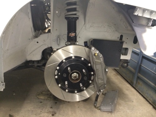

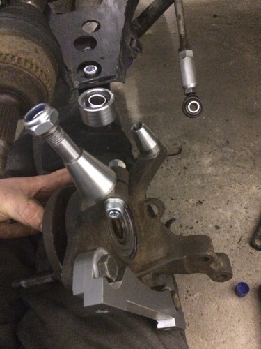

Well managed to get the car back on its wheels tonight. Finished all the fabrication and machine work on the brakes and suspension, made some changes to the AST mounting holes on the front stuts so i can use the oe 14mm bolts and still get as much camber as i need. Managed to get my new hubs fitted as well, got a few pics of the component parts for those that havent seen them.
All torqued up to spec, new wheel bearings fitted. Removed my 20mm spacers for this season too, the hub kit already increases the track by approx 5mm apparently and i have 6mm more either side too so track width will be down approx 18mm from last year (9mm per side) improving the much talked about scrub radius. Car is booked into Blink motorsport again on the 15th March for a suspension setup, hopefully just the front geo to do and the corner weights to tweak if required.

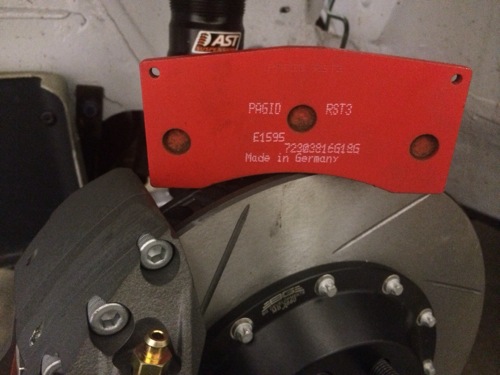

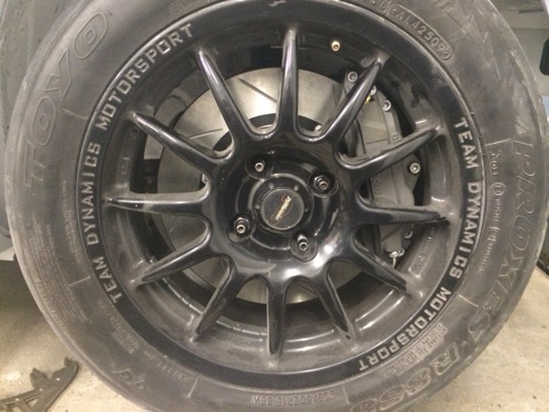

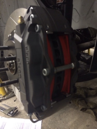

More importantly my brakes are finished and fitted after much trial fitting, machining etc. 295mm x 28mm grooved discs with Alcon 4 pot 'B' Type radial mount calipers on custom made bells and brackets with Pagid RST3 pads. Looking forward to trying them out and expect a massive improvement over my setup from the last race that tried to kill me!

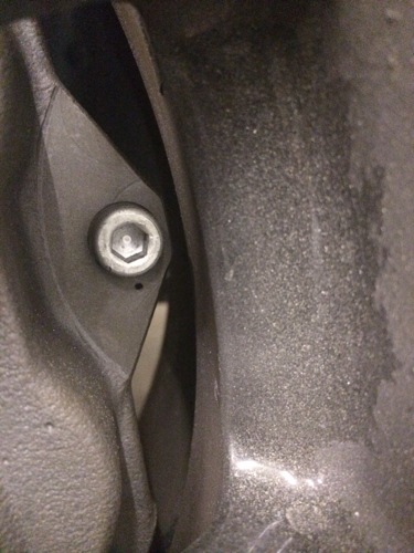

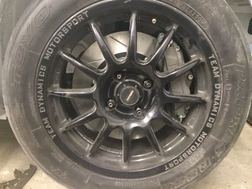

Close to the wheel! Tried all my sets of my wheels, 2118's, Ultralegs and PR 1.2's and all fit fine.
Discs actually look small under the wheels even though theyre only 15's!

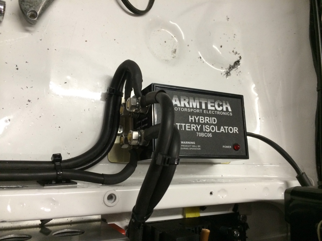

PAS hoses should be getting made up by Pirtek this week too hopefully, need to chase the guy tomorrow see how hes getting on. Only got a few jobs left after that, my radiator is back with its brackets welded on so that can be fitted too. Some wiring jobs after that, got an Armtech battery cut off to replace my cartek one that failed before oulton last season, hopefully this one should be more reliable as it isn't solid state. Also have to wire my fuel sender to the dash and calibrate it, currently have no fuel level indication, so that be a good idea!

Sorry for the rather short answer Morgan, They're B type calipers and am sure the 'standard' alcon kit from tdf/jet stream use H types which have a pad shape the same as a 206 gti and hence smaller than the standard 172/182. I appreciate pad size/area isn't everything but it makes a difference + I've managed to get them fitted and use a 28mm disc where all the other options I've looked at use 25mm thick discs.

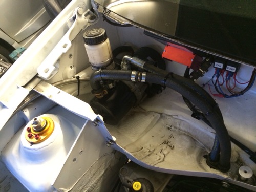

Managed to get the 106 pas pump fitted in the scuttle ala cup racer and plumbed in last night, still needs wired up but it's another job off the list.

Some new pics, pas pump fitted and piped up.

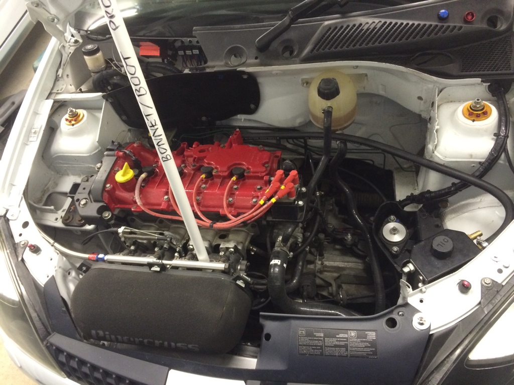

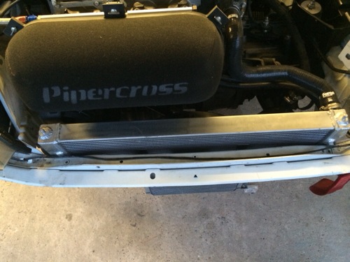

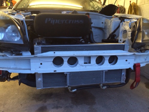

New bigger alloy rad fitted with fan and all fixed and piped up.

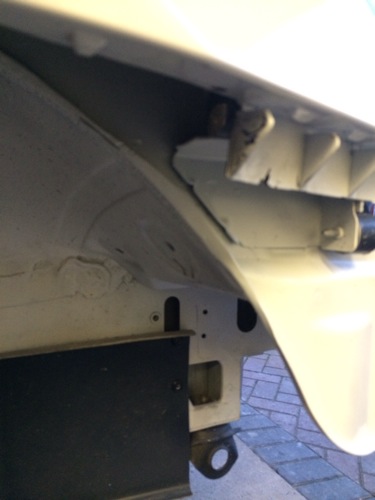

Some housekeeping while it was in the air, tidied up the front bumper brackets that i had to hastily modify at Oulton last year when my wheels were rubbing, cut the rest of the metal back and dressed the inner lip back, primed and painted it up.
Filled the coolant system and gave it some new oil and a filter too before i started it and ran it up to temp, first time its ran since september and all was well, seems a lot happier with the new rad fitted anyway. Quick vid.

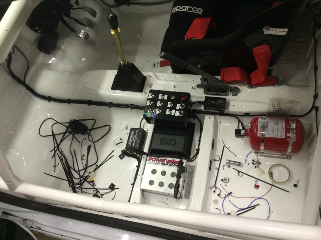

Nearly ready to go, got the pas wired up and working as well the new Armtech battery cut off, hopefully it'll be more reliable than the cartec one I had last time.
Just need to connect 2 wires to the Dash2 to get the fuel level up and running and calibrate it with some fresh fuel.
Removed last years numbers/graphics in preparation for the new Tricolore decals which should be here next week hopefully.
Needs a good clean and Hoover out then it'll be off to blink on Saturday for a setup and testing at oulton the following Friday.

Told you it needed hoovered Tony Hunter, cable, cable tie ends everywhere!
