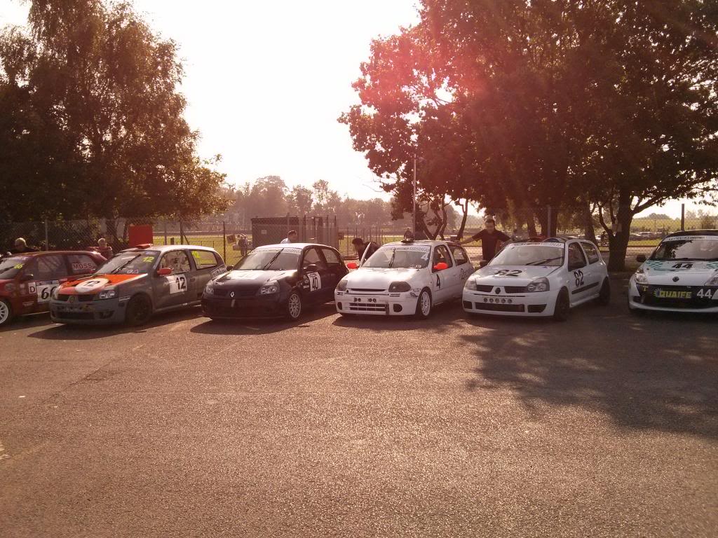

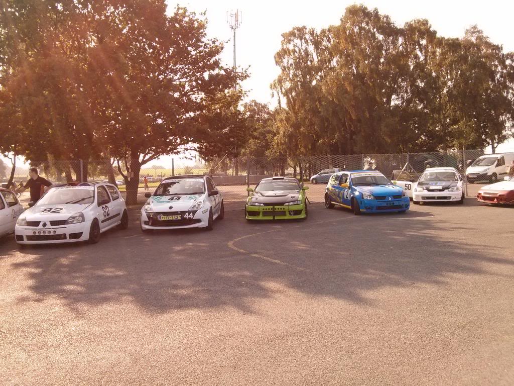

Good to meet you Russ all be it briefly, I took these couple of pictures in the assembly are before the 1st race.
They are from my phone so not great. :)

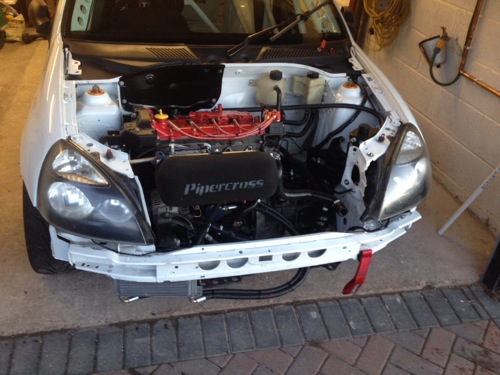

Its in bits again! Got some improvements to come, bought a new rad, a much bigger alloy one, think others on here run a similar one from a Mk3 golf + a new fan. Power steering is being swapped to an electric pump from a saxo/106 using the original rack. Also have some brake upgrades on their way. More info on everything in the coming week or so.

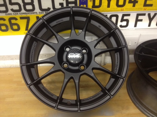

Anyway, my new rad is currently having some brackets welded on so waiting for that to be done before i can fit it. Mangage to give my spare Ultralegs a lick of matt black plaint ready for a new set of dry tyres to be fitted ready for the upcoming season.

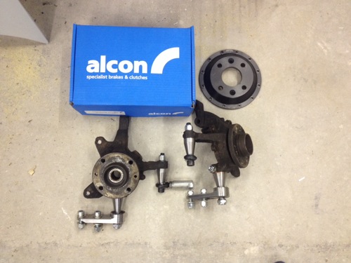

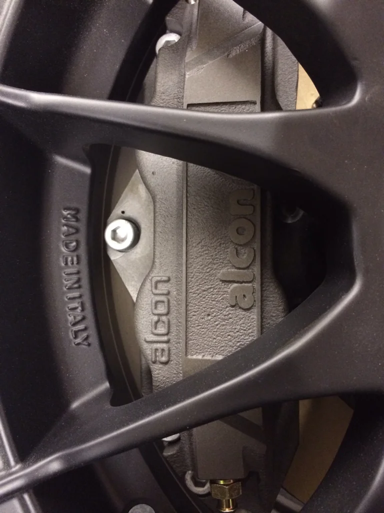

More important is the delivery of more shiny bits, the now cliosport.net 'standard' bumpsteer eliminator hub kit from mark/james. The other bits pictured are parts of my new brake setup, calipers and bells, need to do a fair bit of modification to get them fitted and make sure everything fits. More details as i go.

Not much of an update but a bit of a teaser pic of my brakes, caliper bolted up and just fits under all my wheels. Spent a couple of hours with my tame machinist modifying my brackets to get them to fit. Discs should be here this week and I'll be able to get them and my new hubs on the car.
