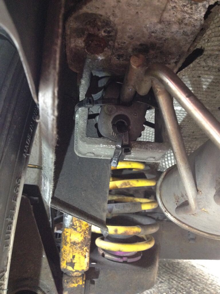

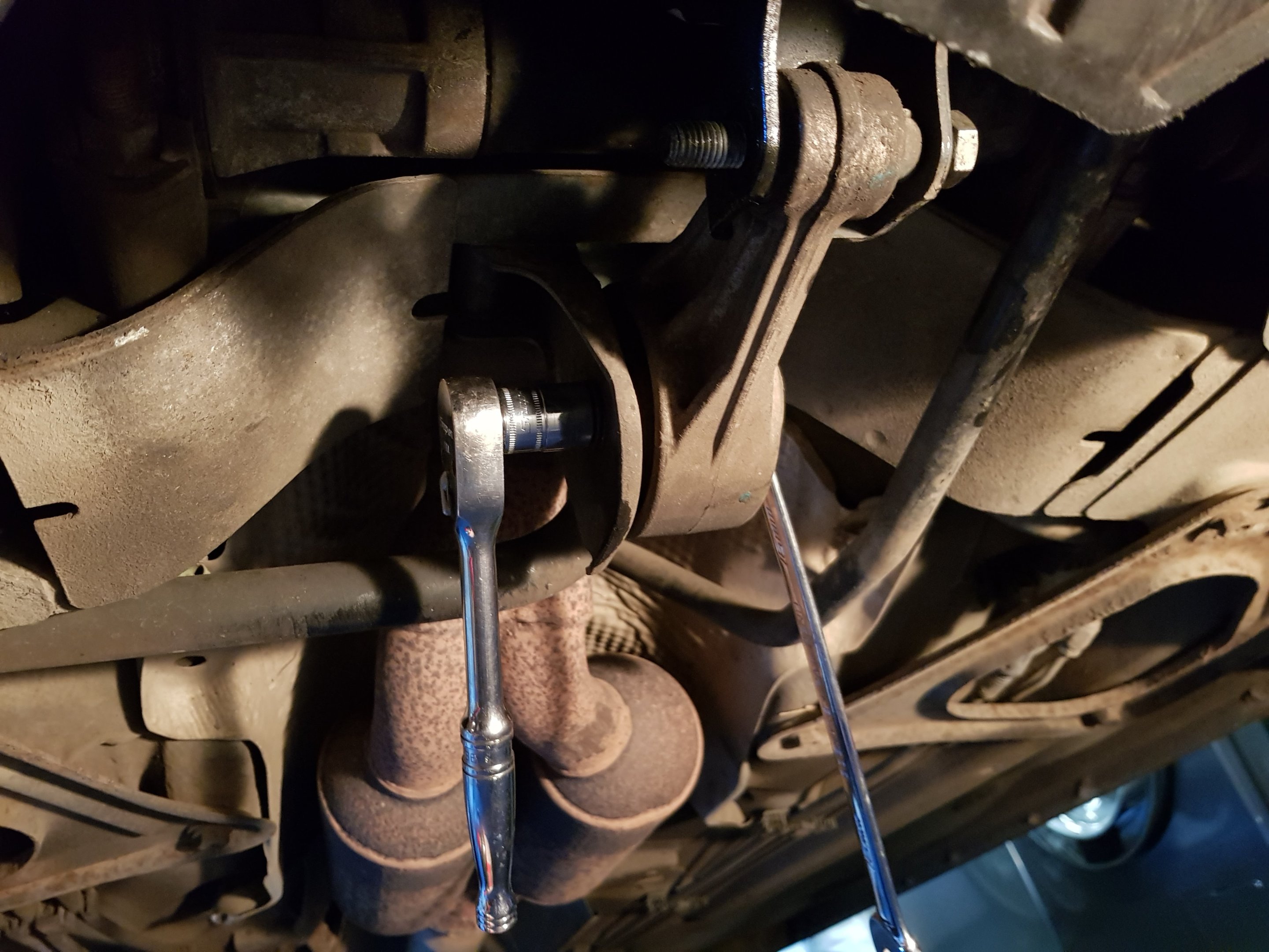

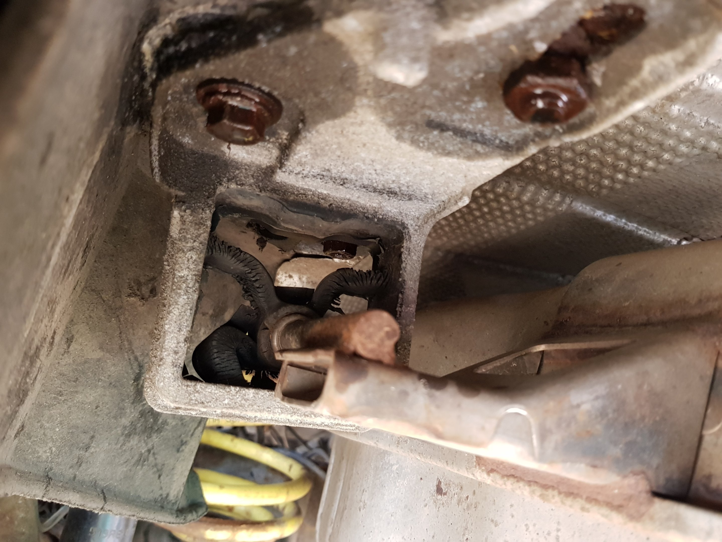

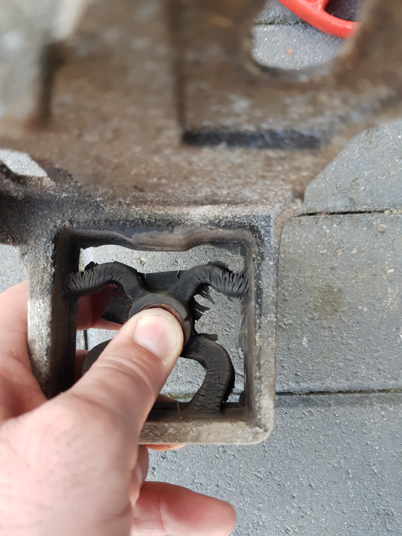

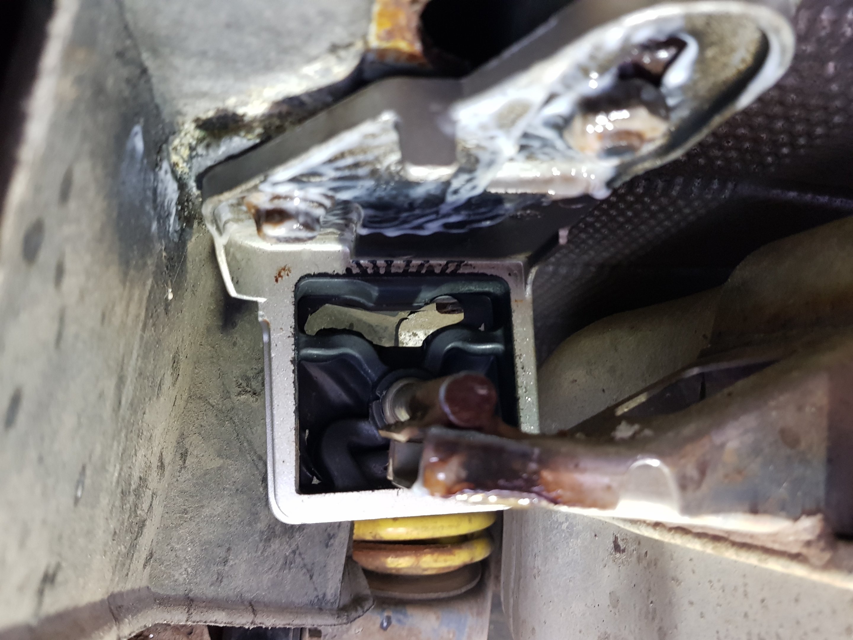

Then for the new rear box hanger as new unfitted one had come with the car, bolts quite stubborn but all came off in the end, one already had been replaced with nut / bot setup as rear one seems to have snapped off earlier in its life.
Cleaned up and back on with some copper slip then wax coat in a vain attempt to keep them from getting any worse
Car in at the dealer tomorrow for the big one, belts, dephaser,water pump and aux set, assuming all goes well next weekend will be pads and discs and oils
Word of advice, those mounts will fail again soon so it's best to support them with some plastic rod or sockets(bodge)in between the voids in the rubber part. Nice looking car.
Thanks for the tip appreciated l, did wonder about that as the new one once on looked well loaded and pulled down.
Was considering using the old mount I took off to to make a powerflex one as they sell the block that fits in the frame
Can always gob the exhaust mount full of Tiger Seal to create a "solid" one....my brother did this on mine and it worked a treat and never had any issues from it.

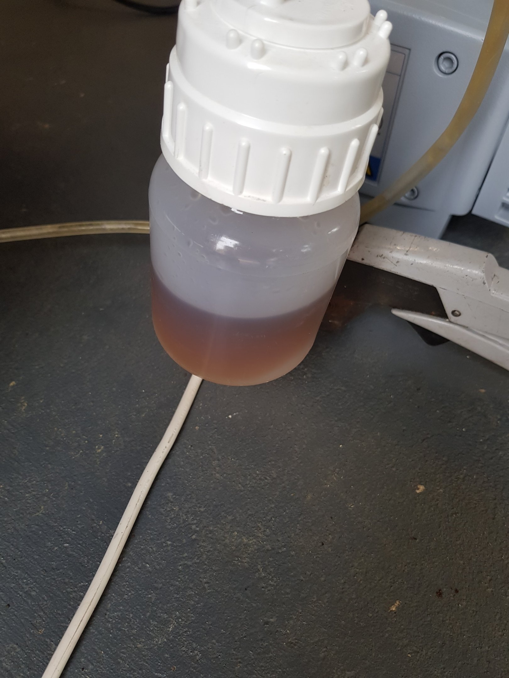

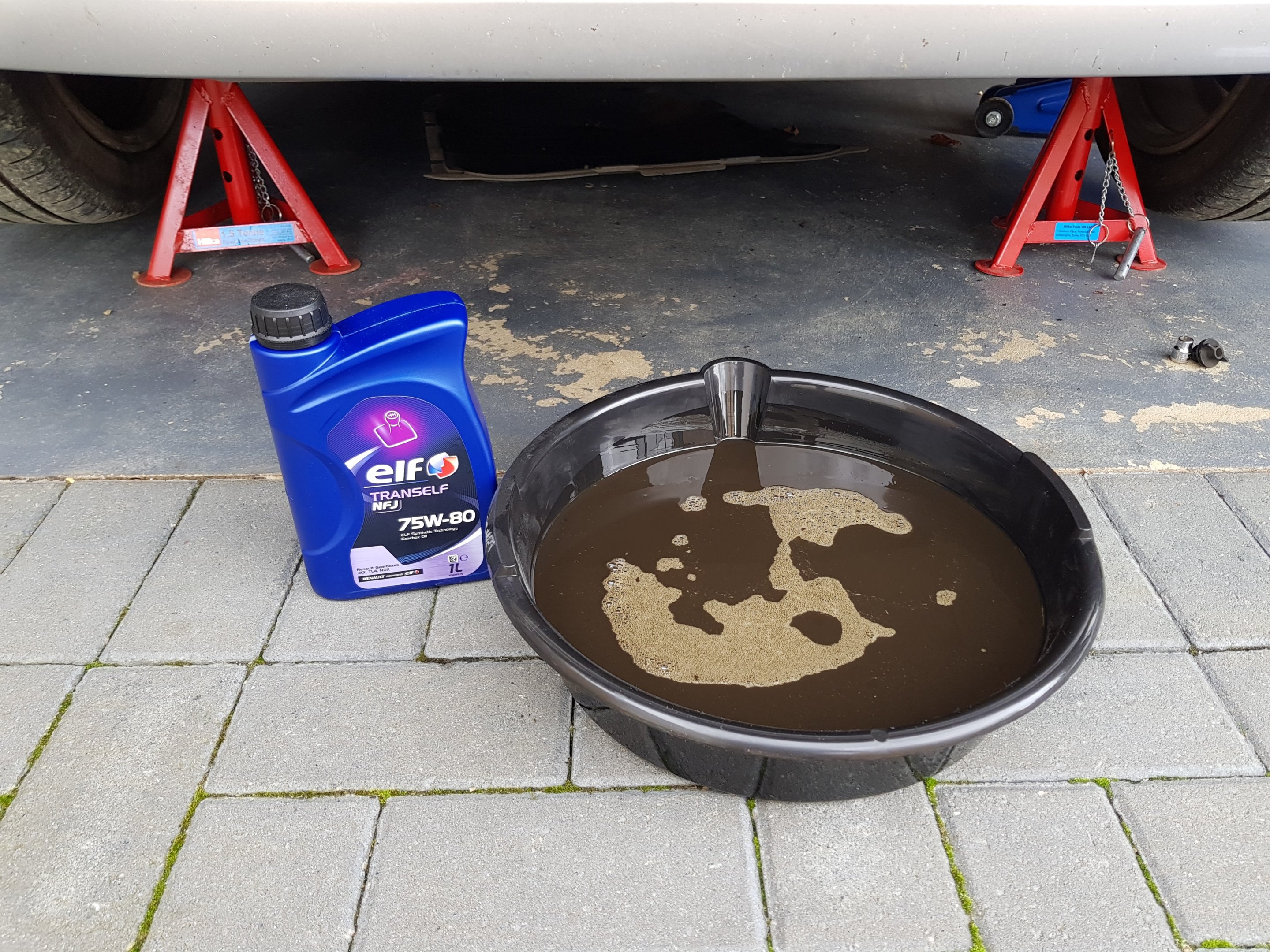

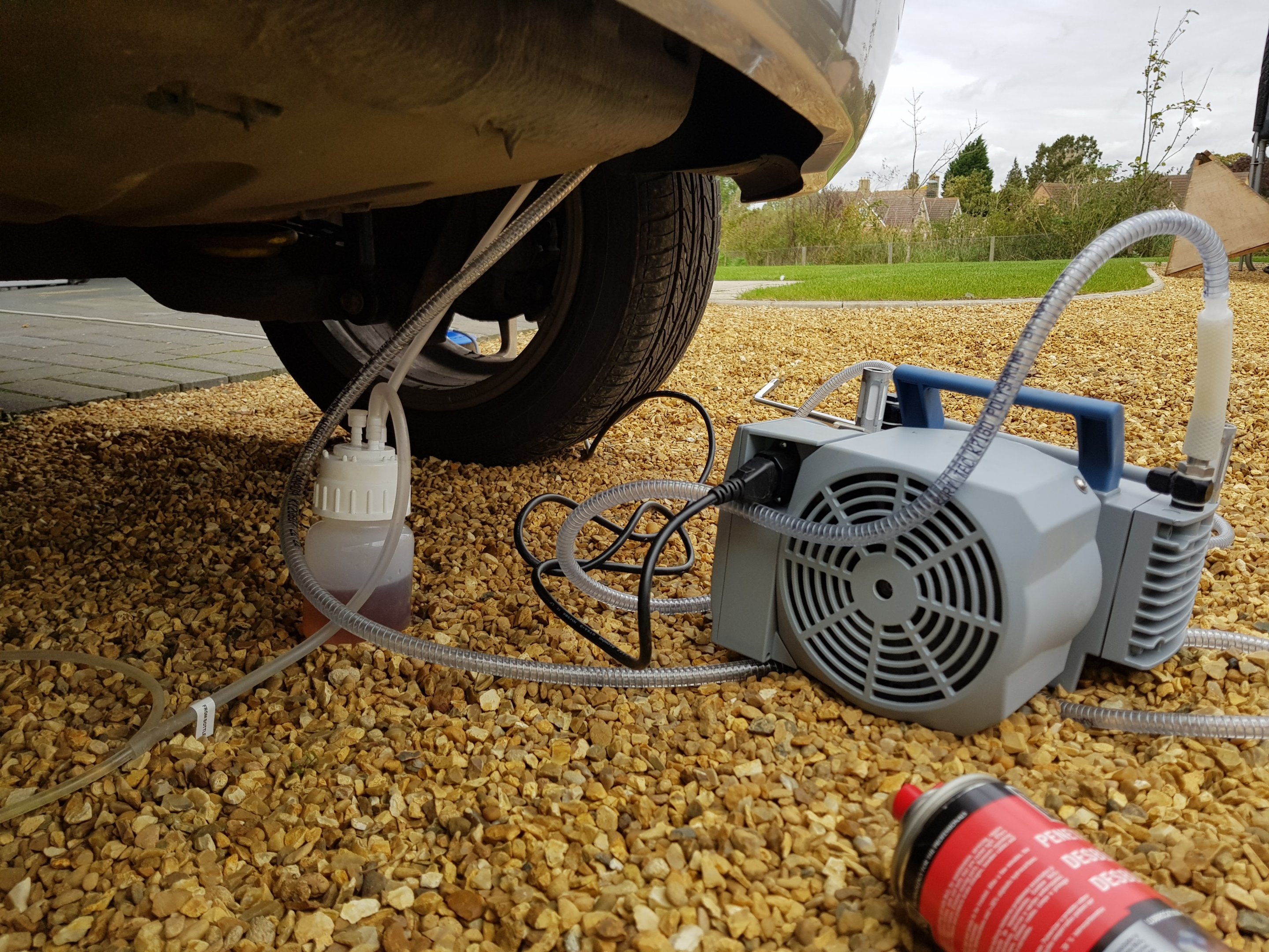

Had some time today so it was engine and gearbox oil change. think the gearbox oil was ready for a change as it came out brown.........

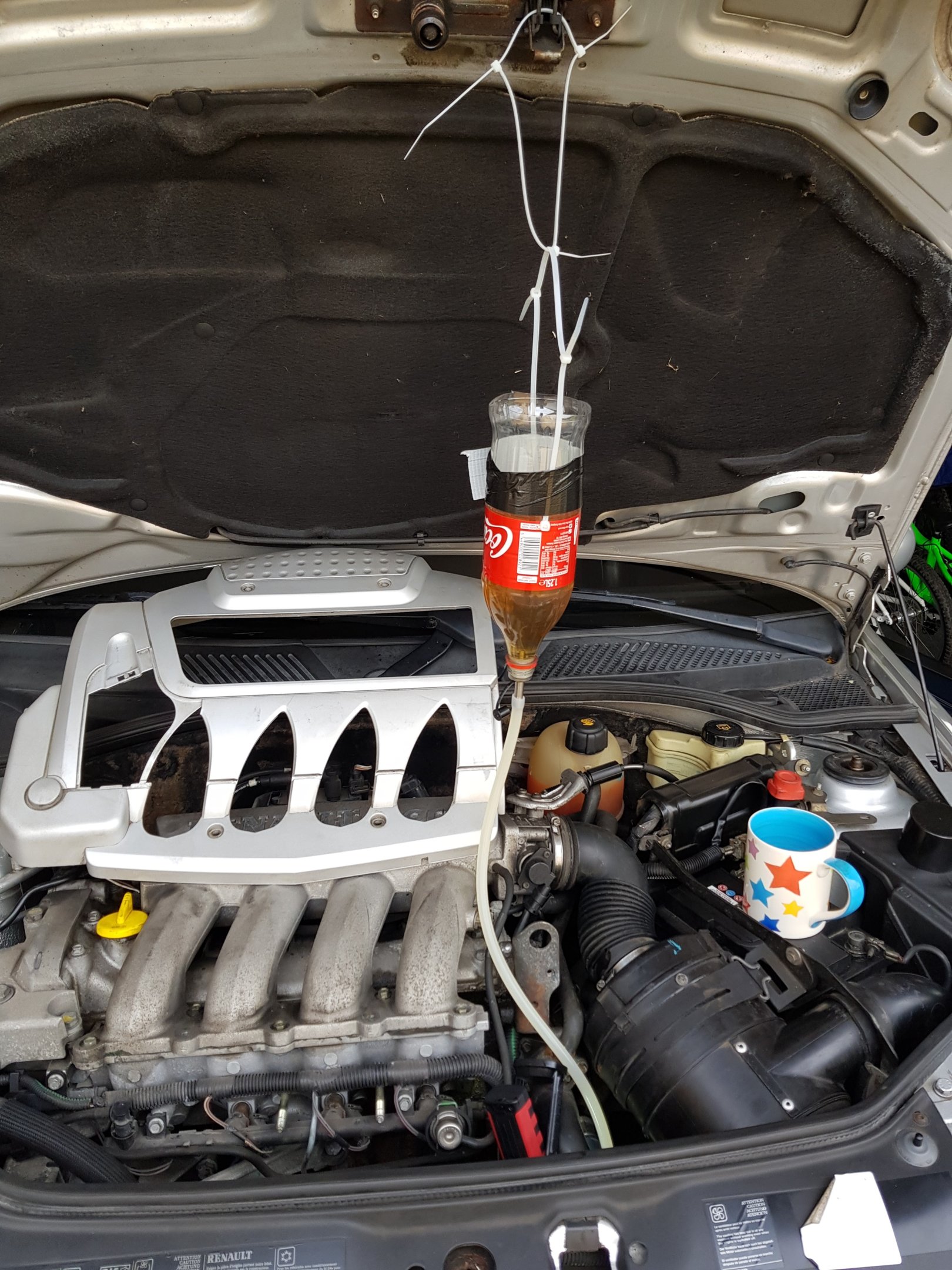

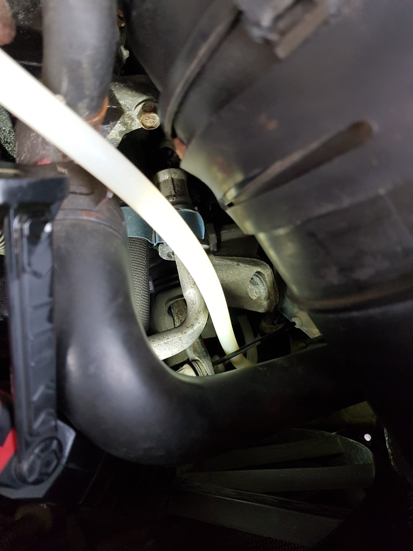

Then for a creative and actually very clean fill method
Into the box
Took about 2.8L until it dribbled out of the fill, had car off axle stands and on the flat!
Engine took bang on 4L of oil with a new filter

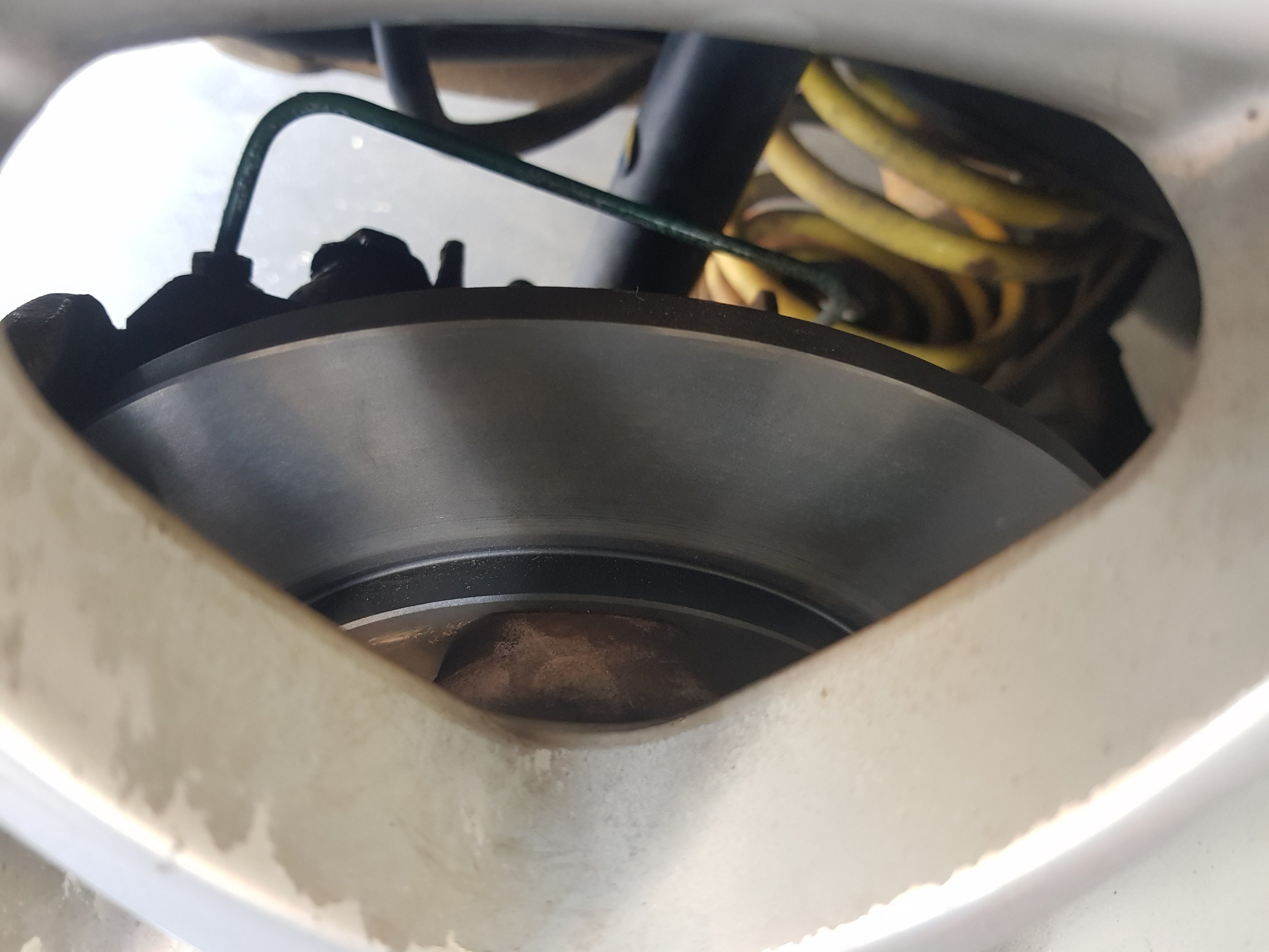

Think new discs next on the list to be ready for bedford trackday on the 13th November

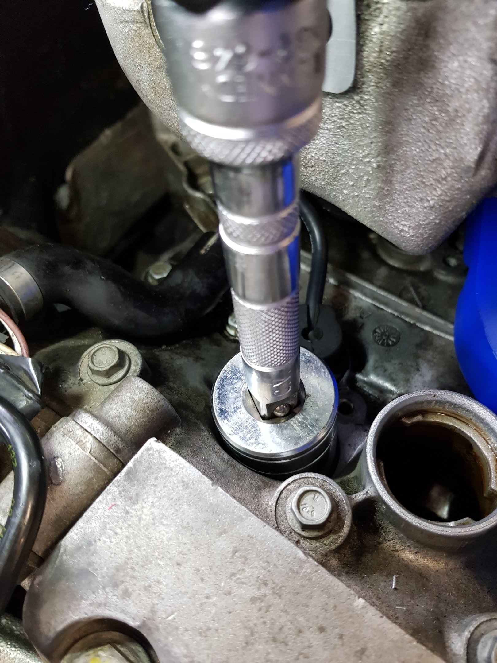

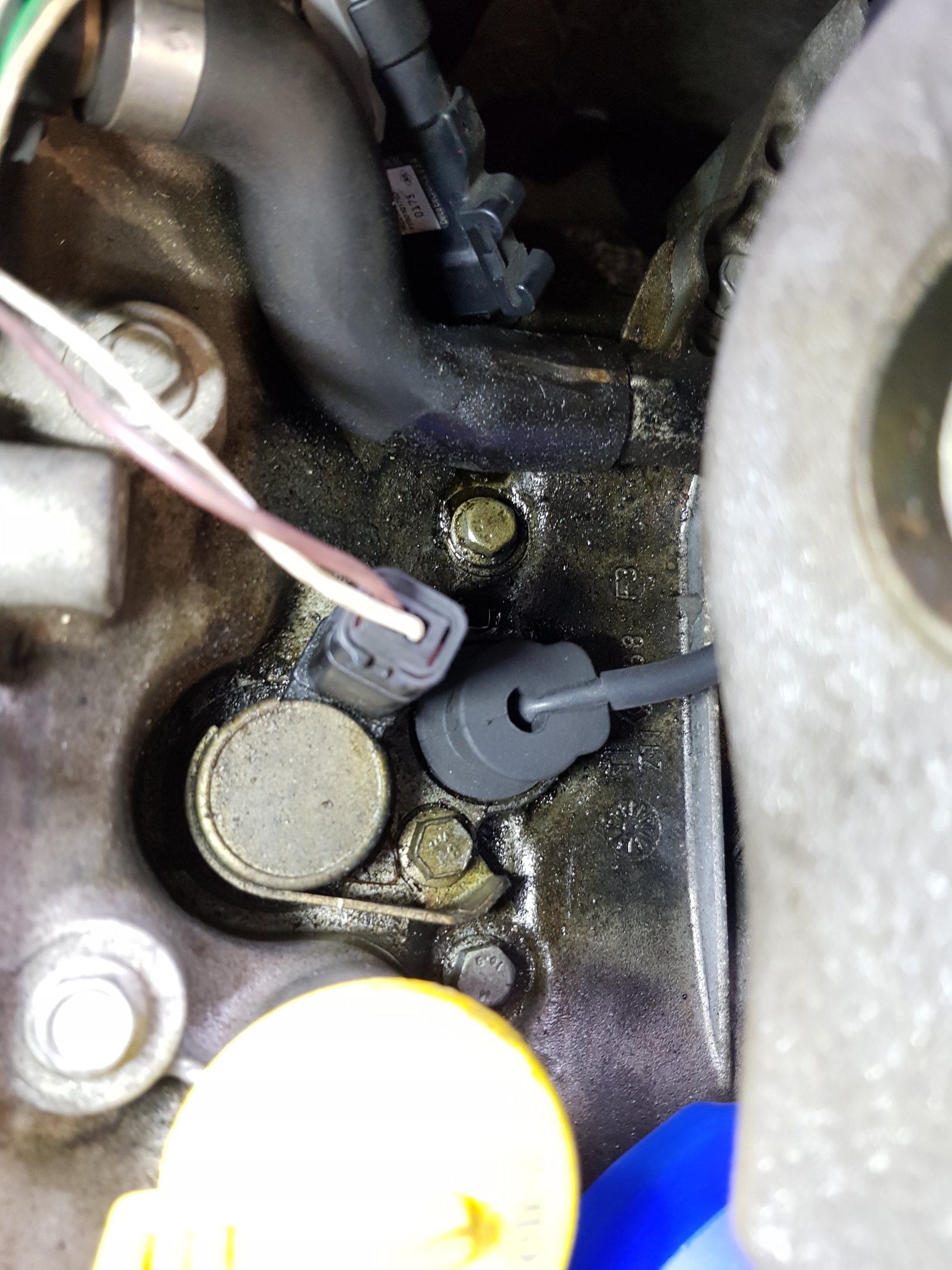

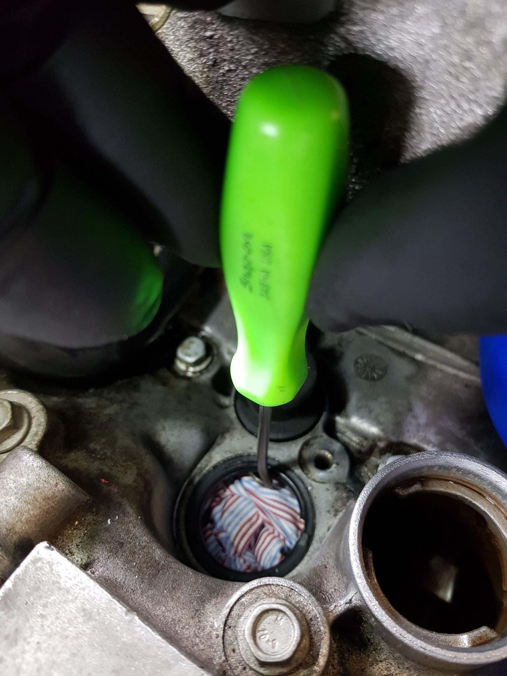

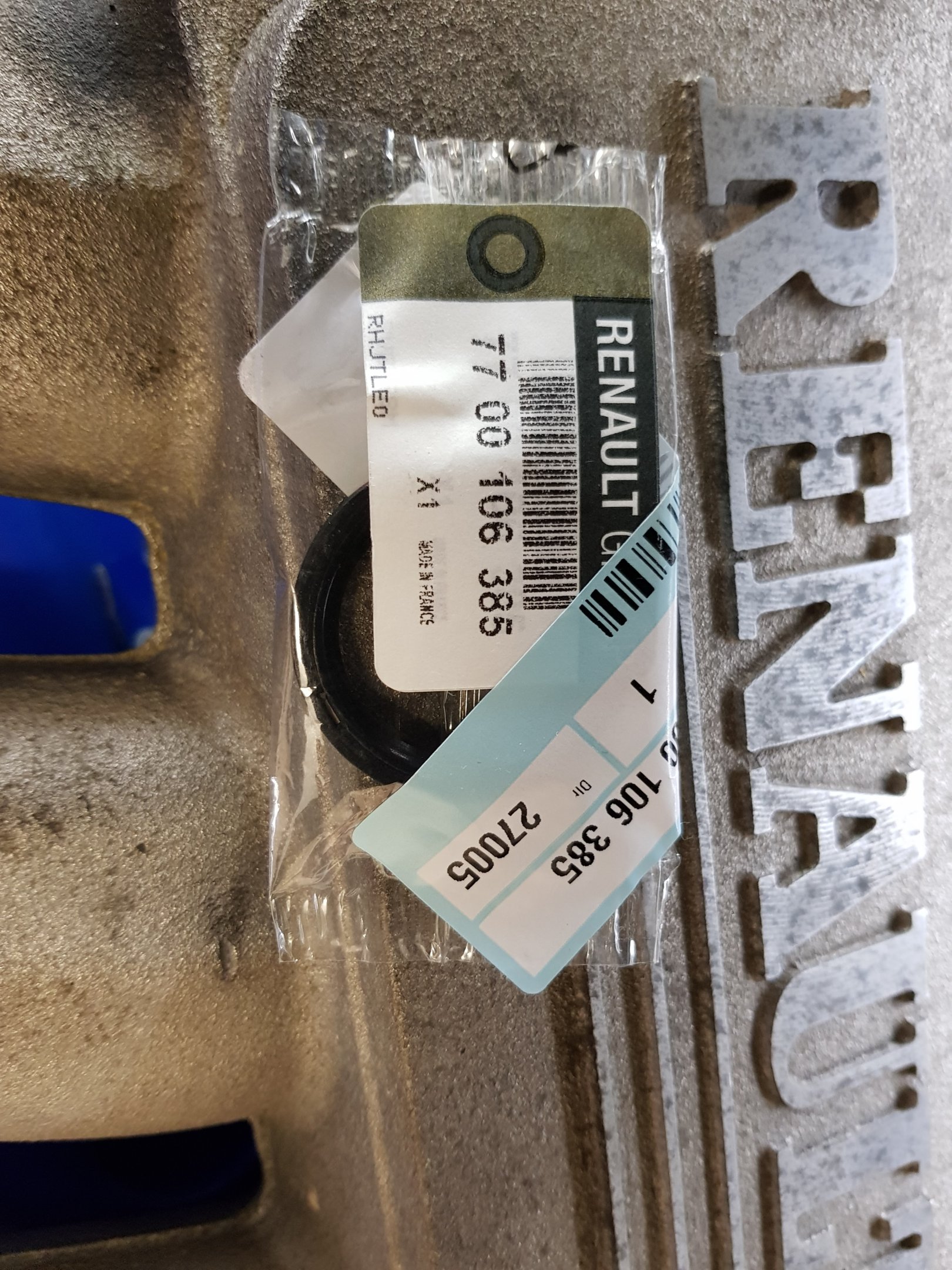

Had some time this morning so attacked the weeping dephaser solenoid seal and replaced
Seal was a little tight to get out but refrained from the hammer and screwdriver attack
New seal and a 30mm Halfrauds socket as the perfect size drift to knock back in
Lots cleaner now, just how long for LOL

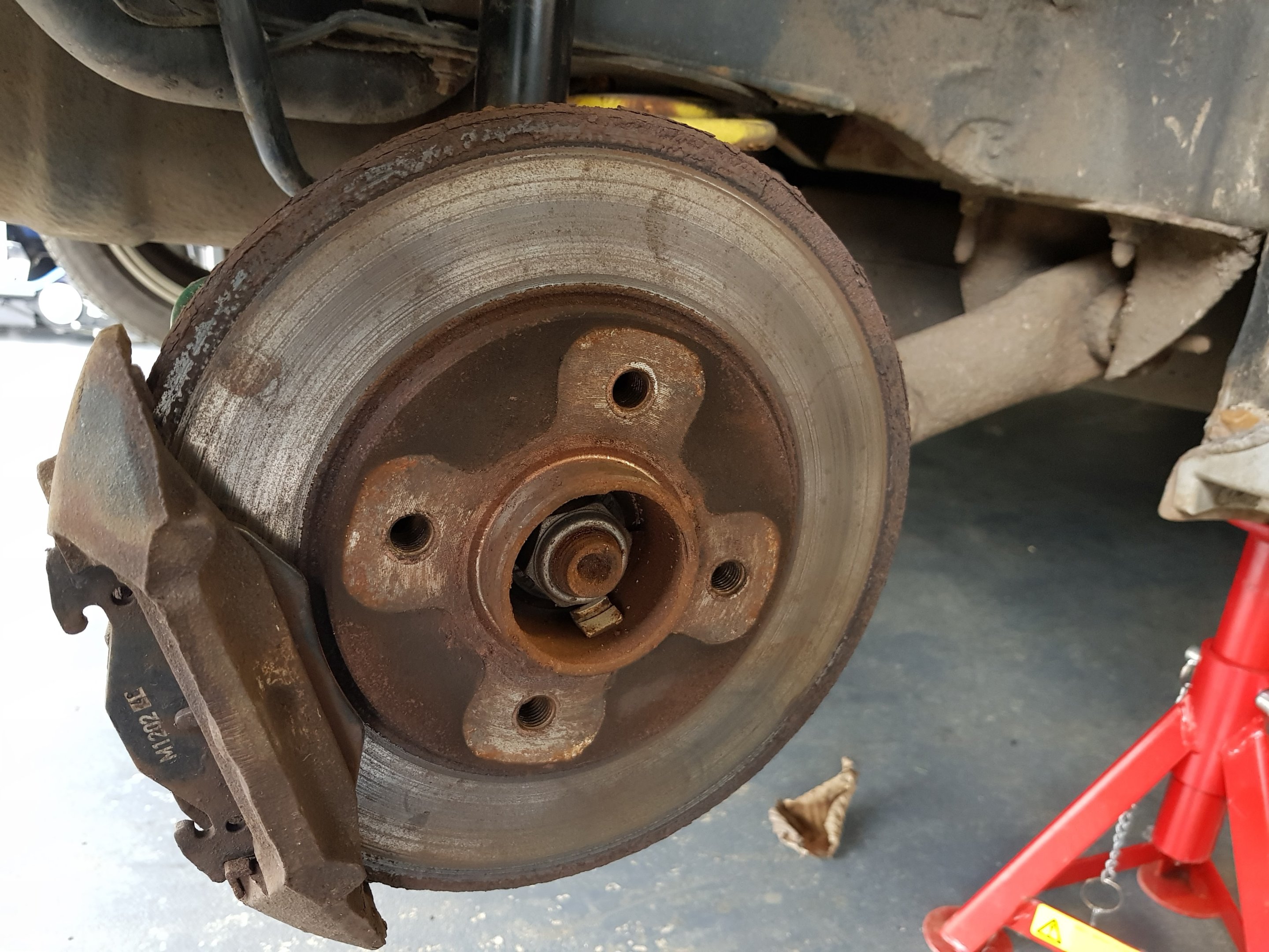

Couple of hours free again today so time for the new rear brake parts and the as new 172 cup rear shocks thanks to @robmuns
Old discs past their best and been on for a while by the looks of it

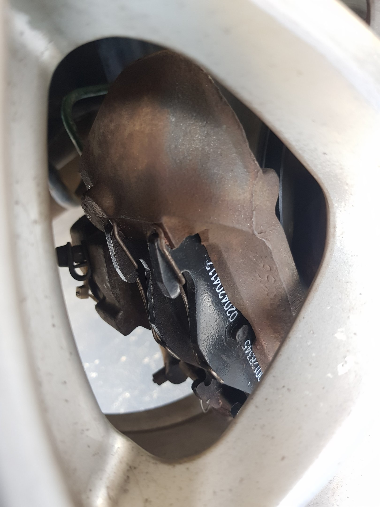

On with the new, gone genuine on the rear as know they get very little loading and hope they will be a little more resistance to corrosion, dealer told me that rear pads are now discontinued but they had a single set left in stock

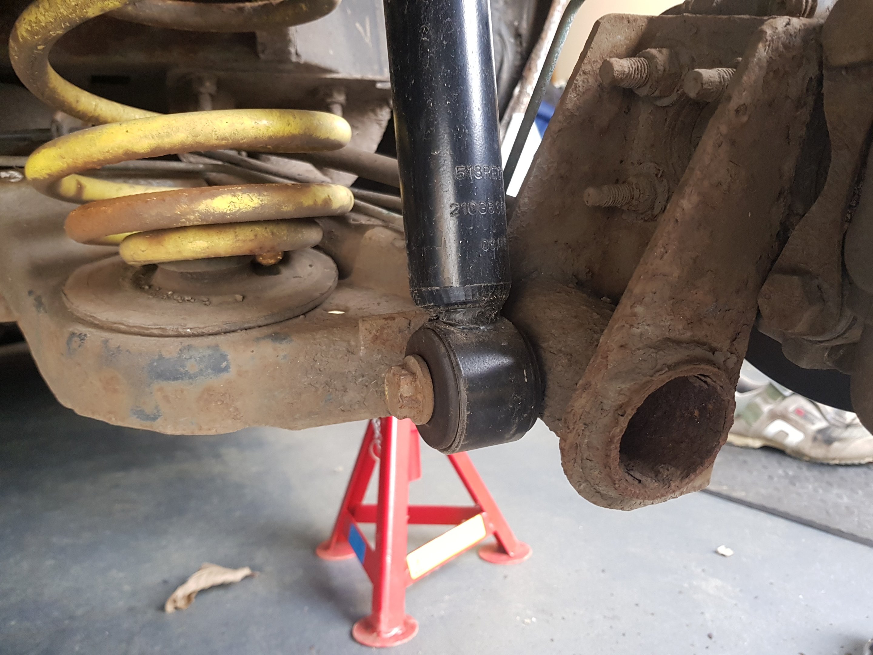

Shocks came off easy enough and no jammed bolts....phew. But did note that old no OE shocks when compressed did not spring back up but the new OE cup shocks did??
Cleaned, copper slipped and put it all back together, much better

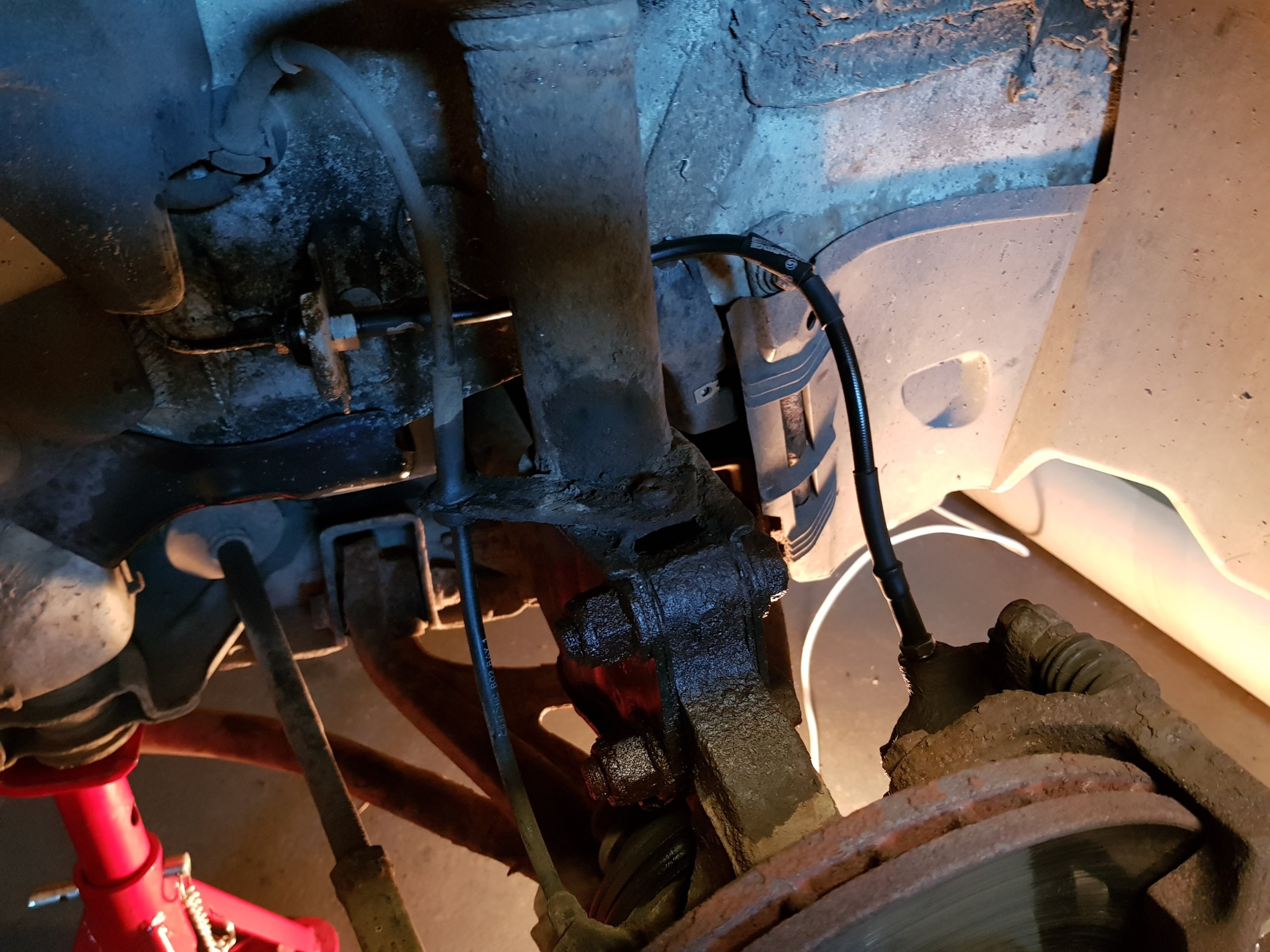

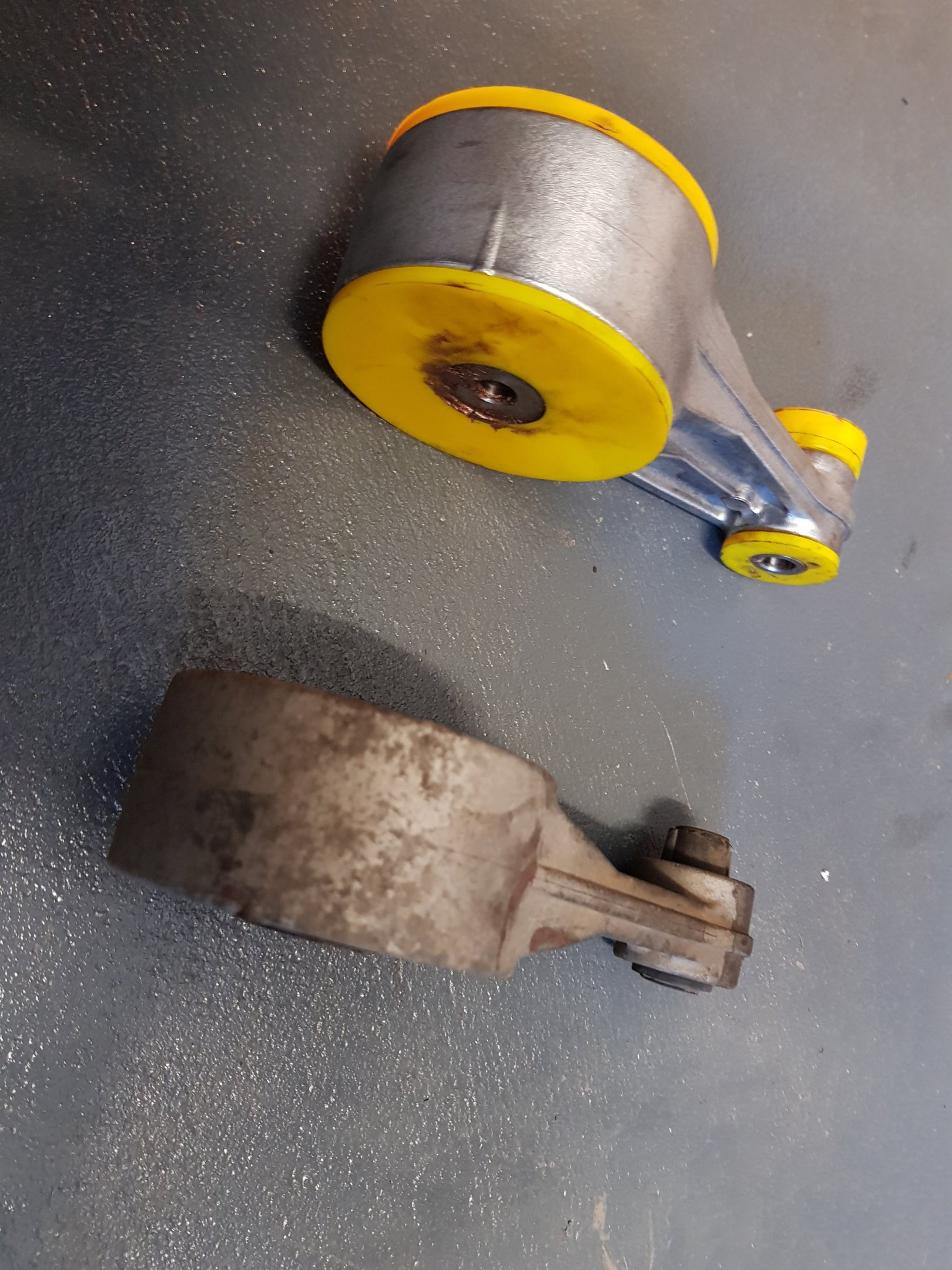

New poly-bushed dog-bone, cup front shocks and some braided lines fitted today, not one seized nut or bolt.... miracles do happen it seems
Old bone out
New one greased and ready to go in

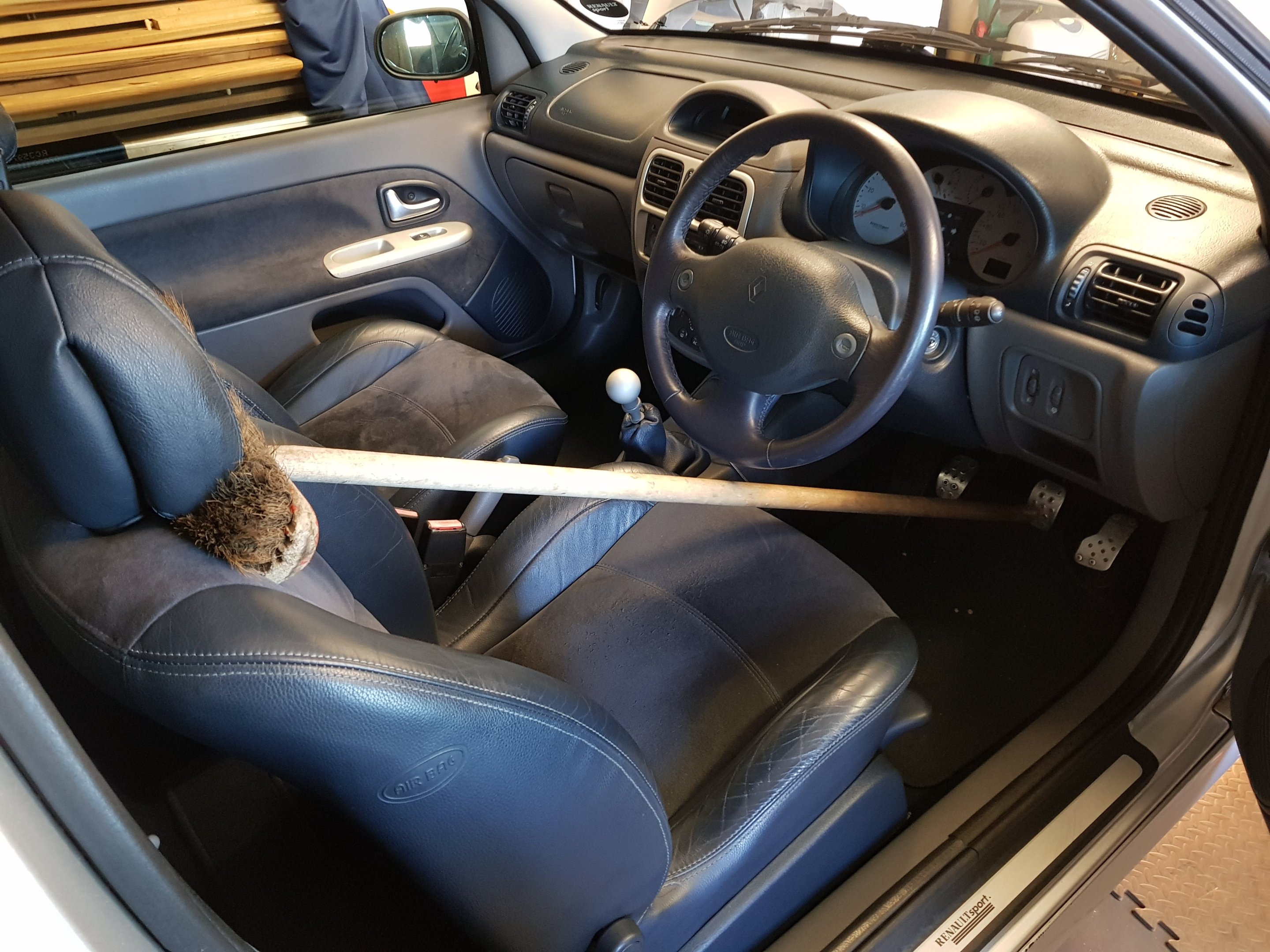

Made the mistake of doing the brake line first then trying to swap the shocks, pulled the new line about quite a bit but not damaged, lesson learnt and shock first on other side
Broom always handy to keep the pedal down when swapping the lines
Bled the lines and quick test drive complete, gear shift so much better and pulling off way smoother with the new dog bone, no extra vibration at present well worth the upgrade

cup shocks are gas filled, none cup are oil filled, that's why the cup ones return piston but none cup dont

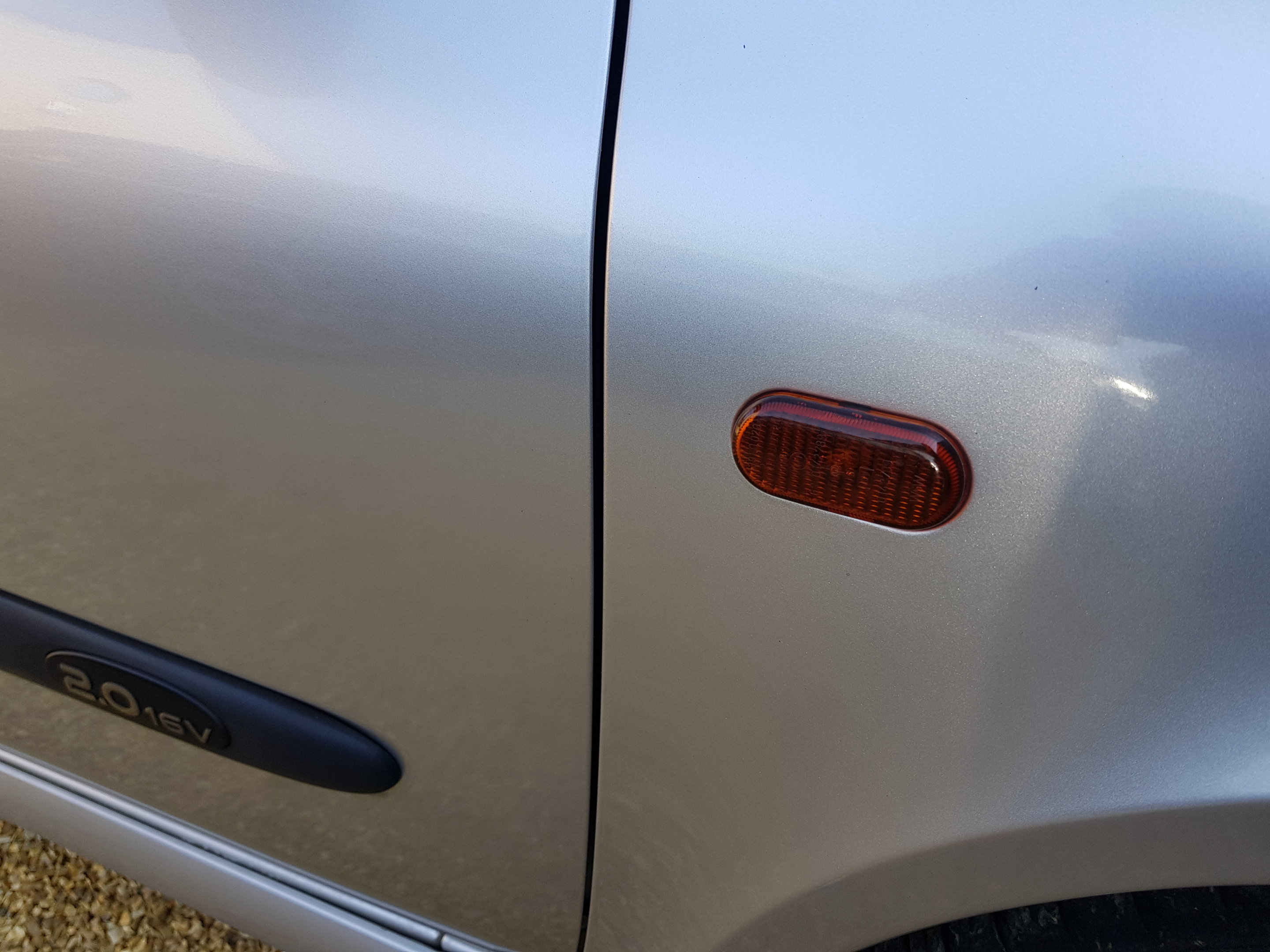

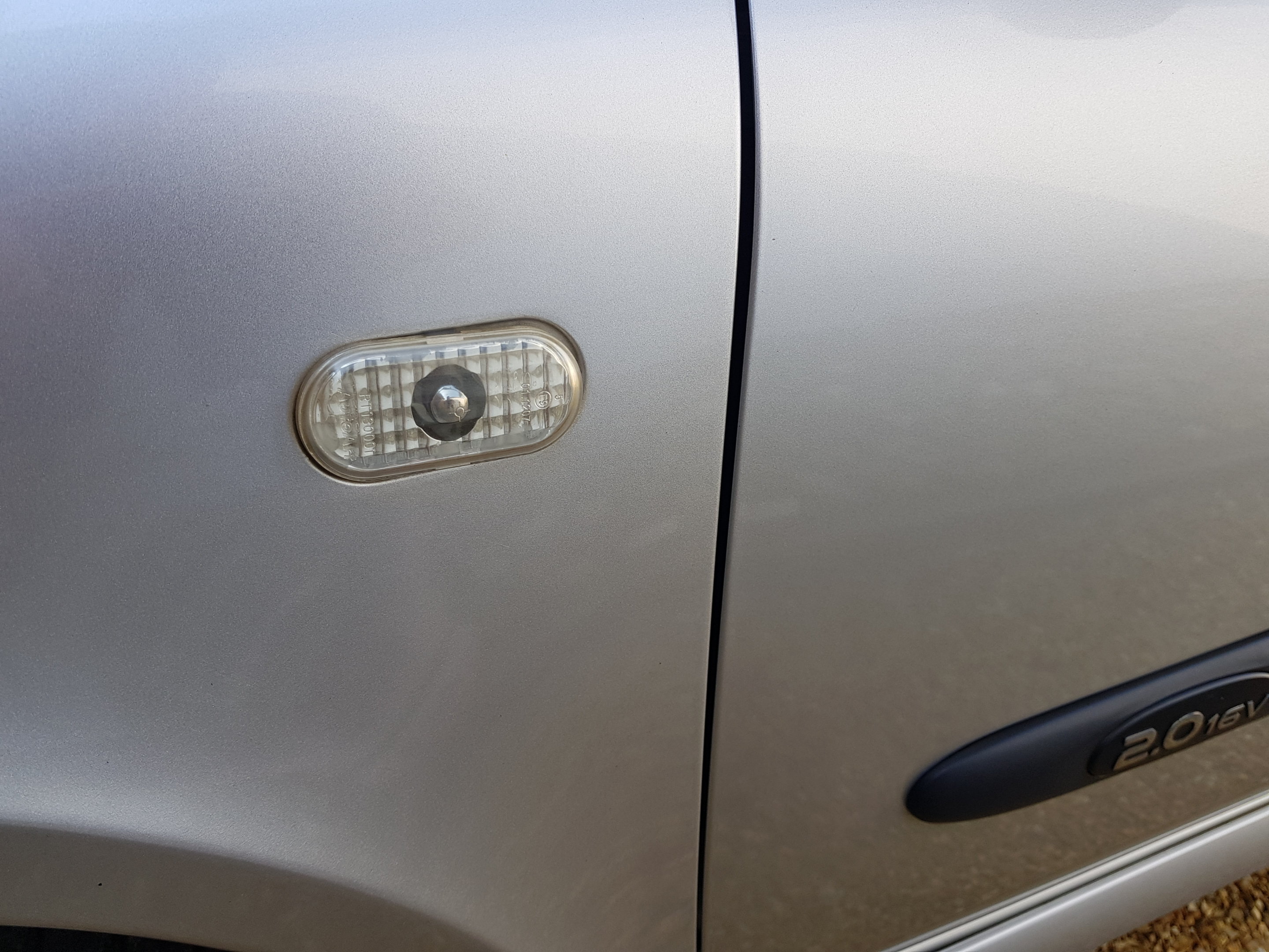

Looks like we were installing amber indicators at the same time ? car looks great ?

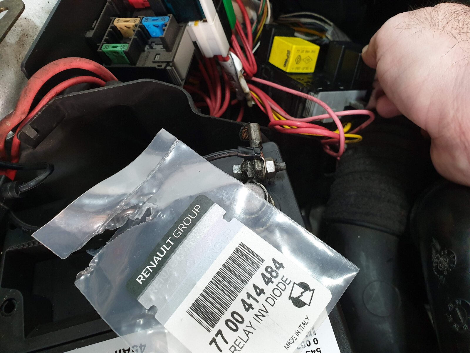

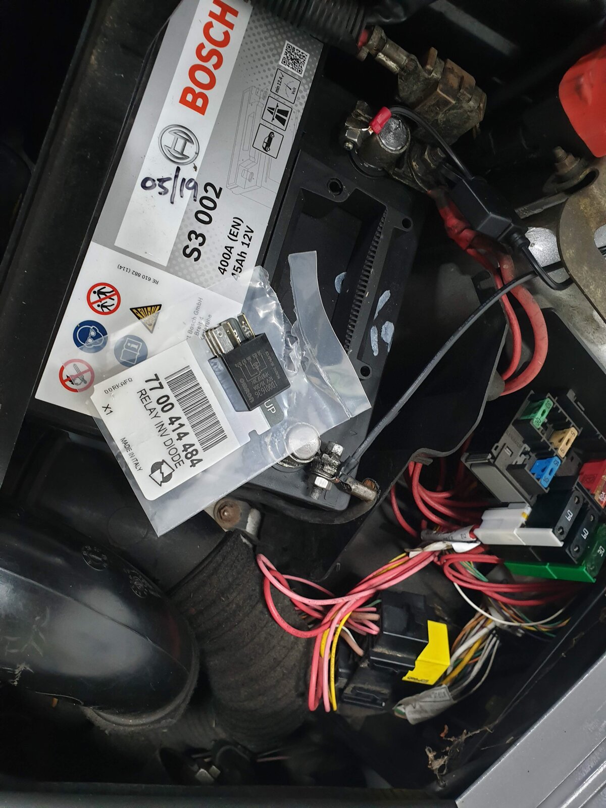

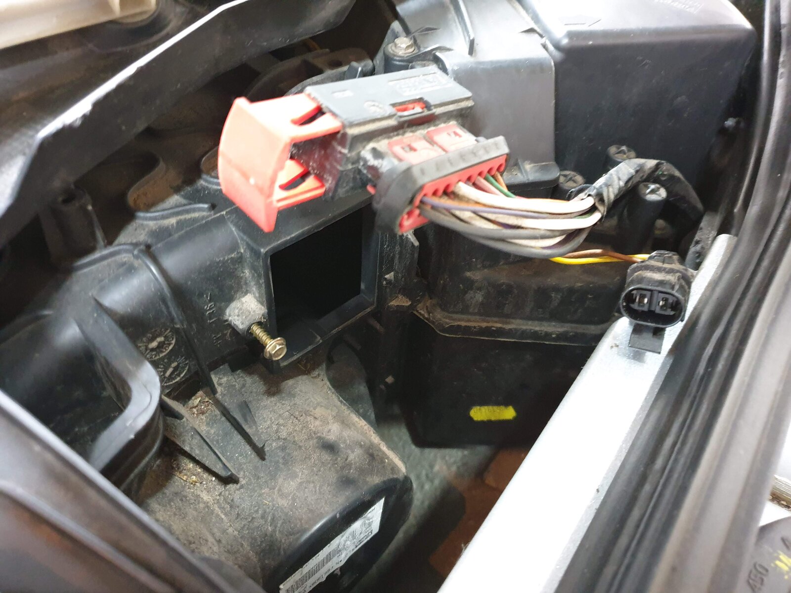

Intermittent starting issue resolved and new Renault relay fitted

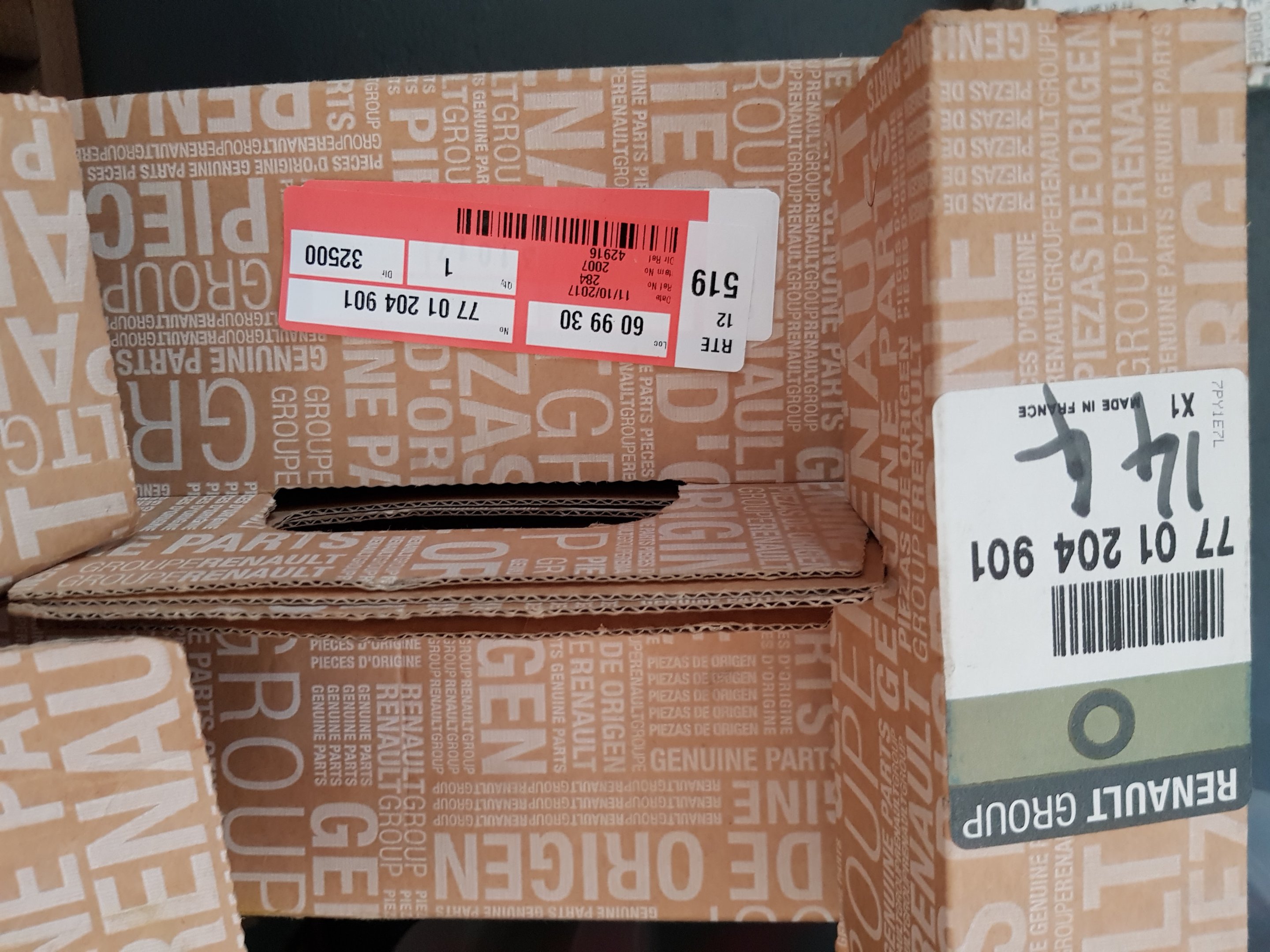

Then while at the electrics thought would sort the one and high speed heater fan it has, after a call to Renault 172 Ph1 part 7701206104 (Valeo) is now obsolete
Valeo part number is 515136 and still available so one ordered should be here this week, needs a clean in the scuttle!

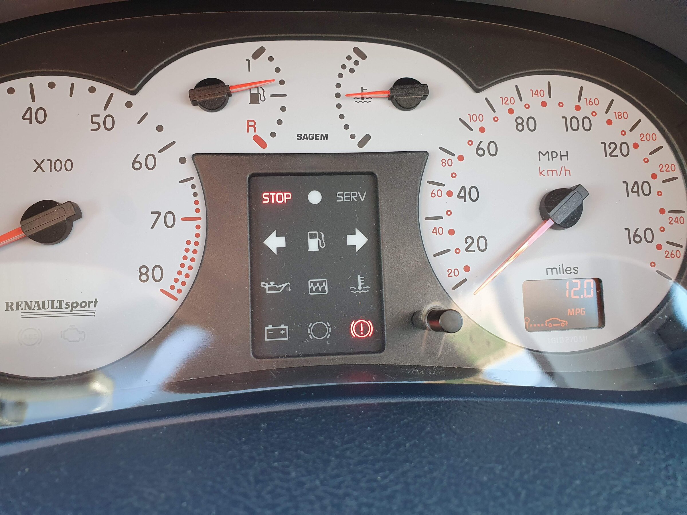

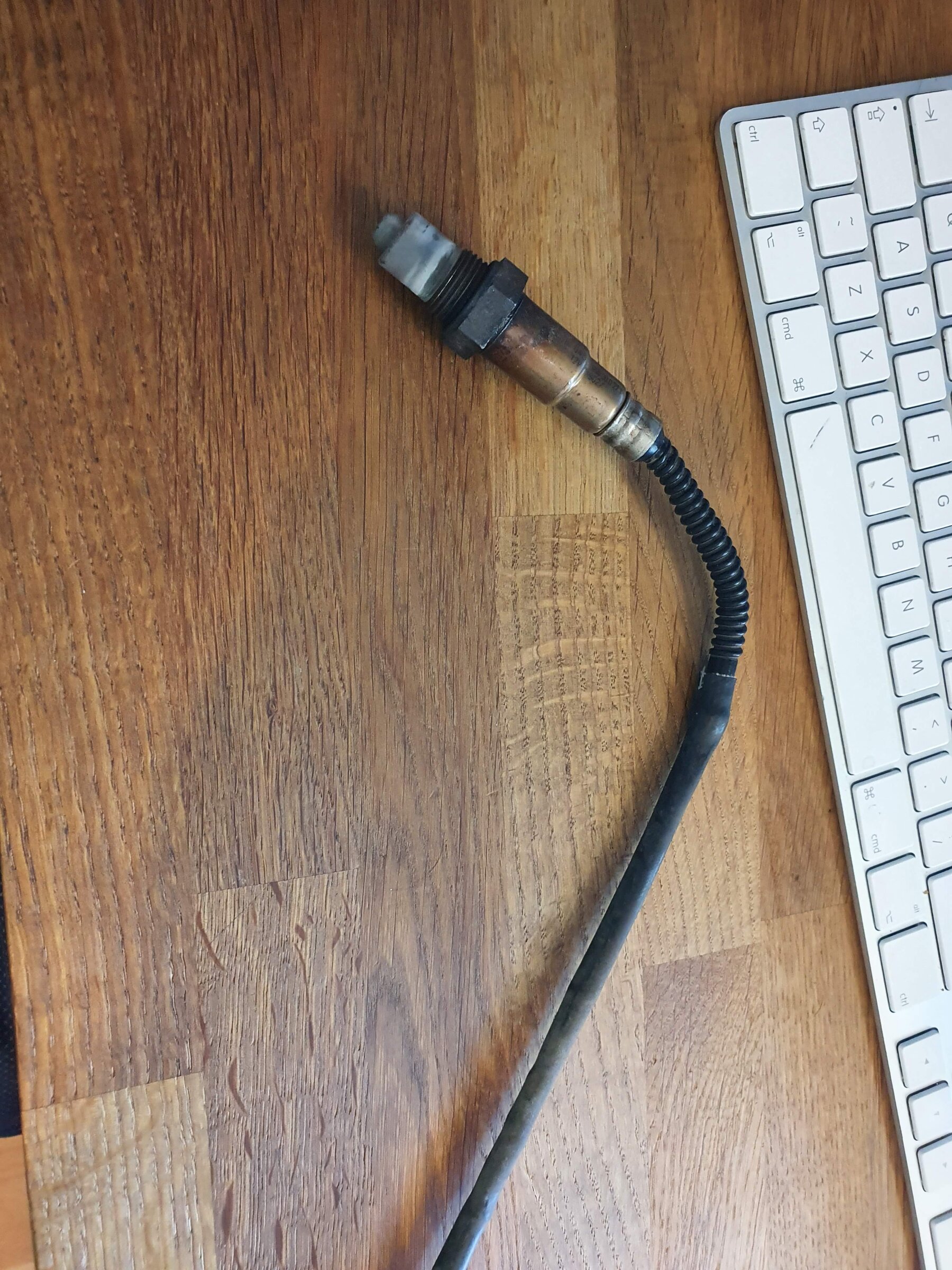

Noticed my MPG has plummeted / dropped to 12 MPG on a steady run last two trips out and from memory only ever get down to 19 MPG on trackdays. Seems to run okay and no lights so suspect Lambda.
Following forum advice, 22mm ring spanner over the connector, squirt of pen oil and got the exhaust hot and it was out in a matter of mins, upon removal looks like the original bosch one fitted 20 years ago. Only has 1 sensor pre cat fitted and was marked 0258006046 upon removal, seems to be a Bosch LS6064 from searching
New one ordered, will see what happens upon fitting the new one

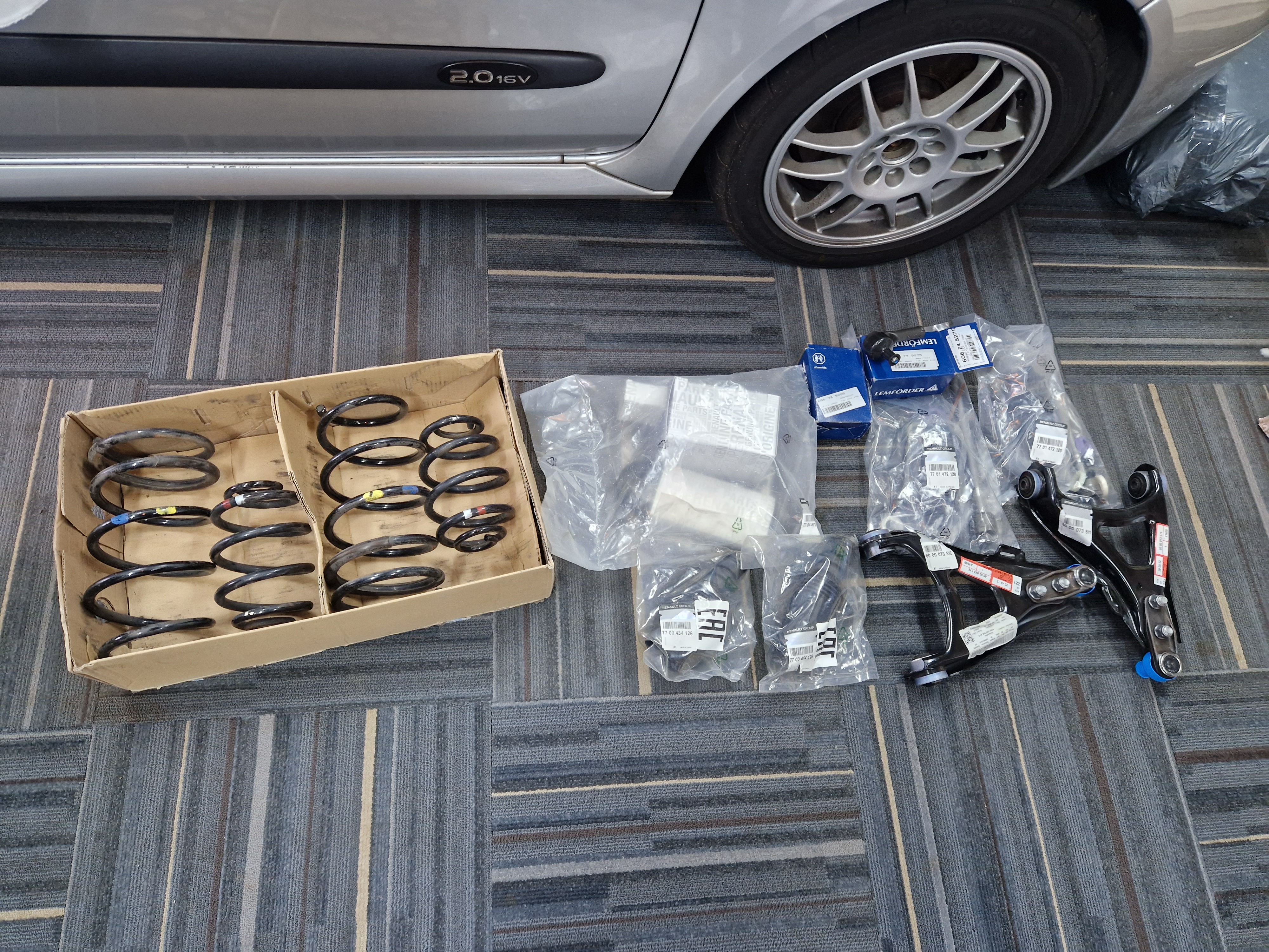

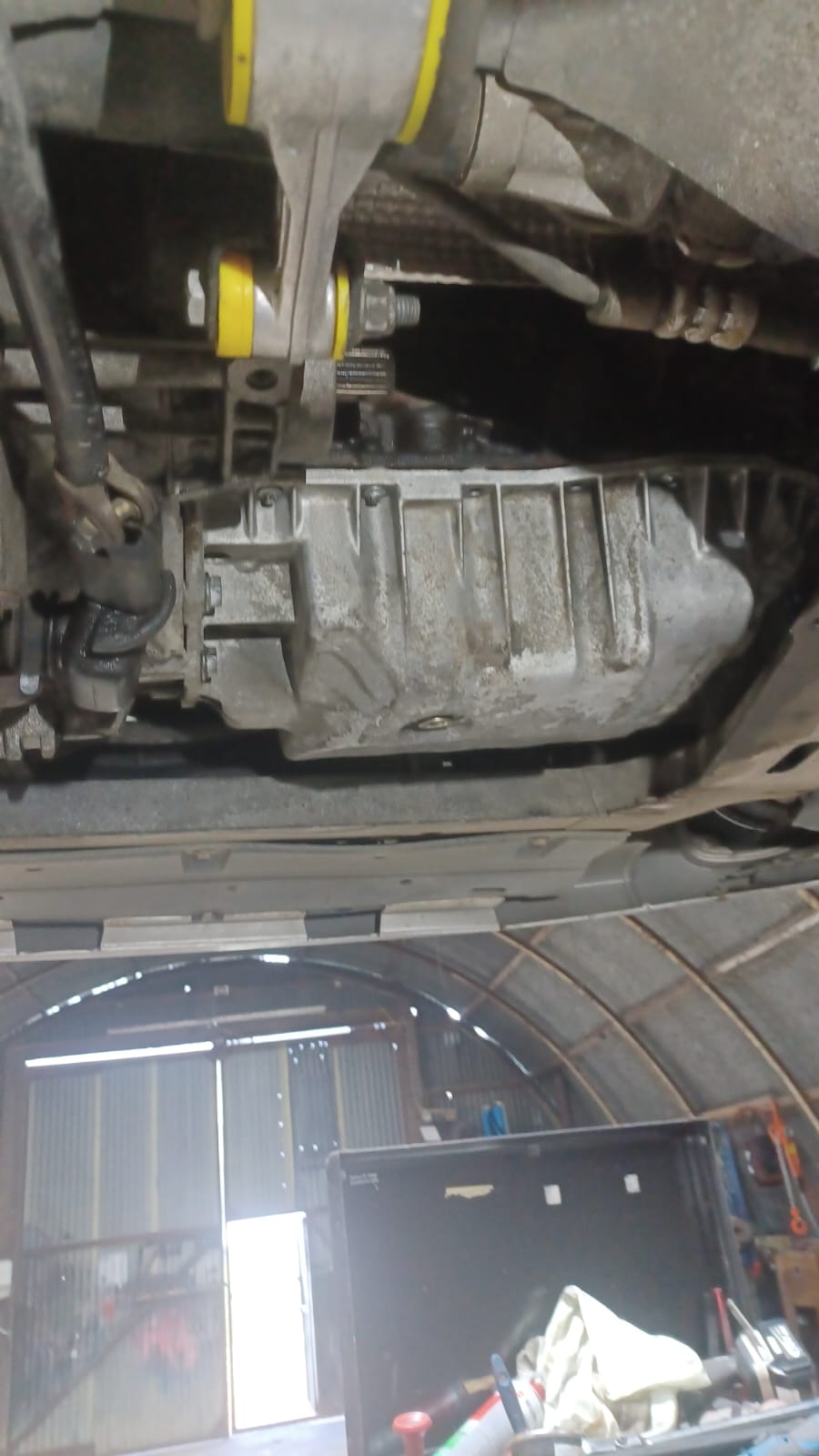

Steering and suspension refresh completed, new wishbones, track rod ends, ball joints, steering rack gaiters and steering rack bushes fitted along with new front shock top rubbers

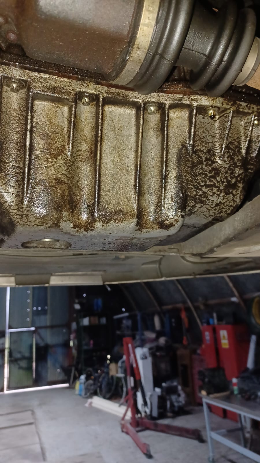

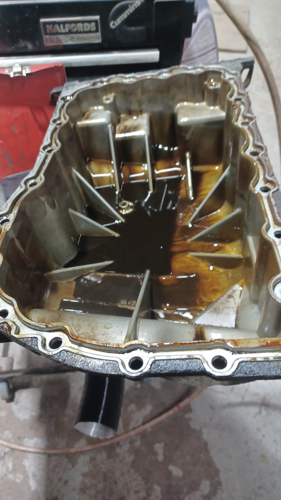

Also sorted the sump gasket leak, no metal present just some oil sludge in the sump fortunately
