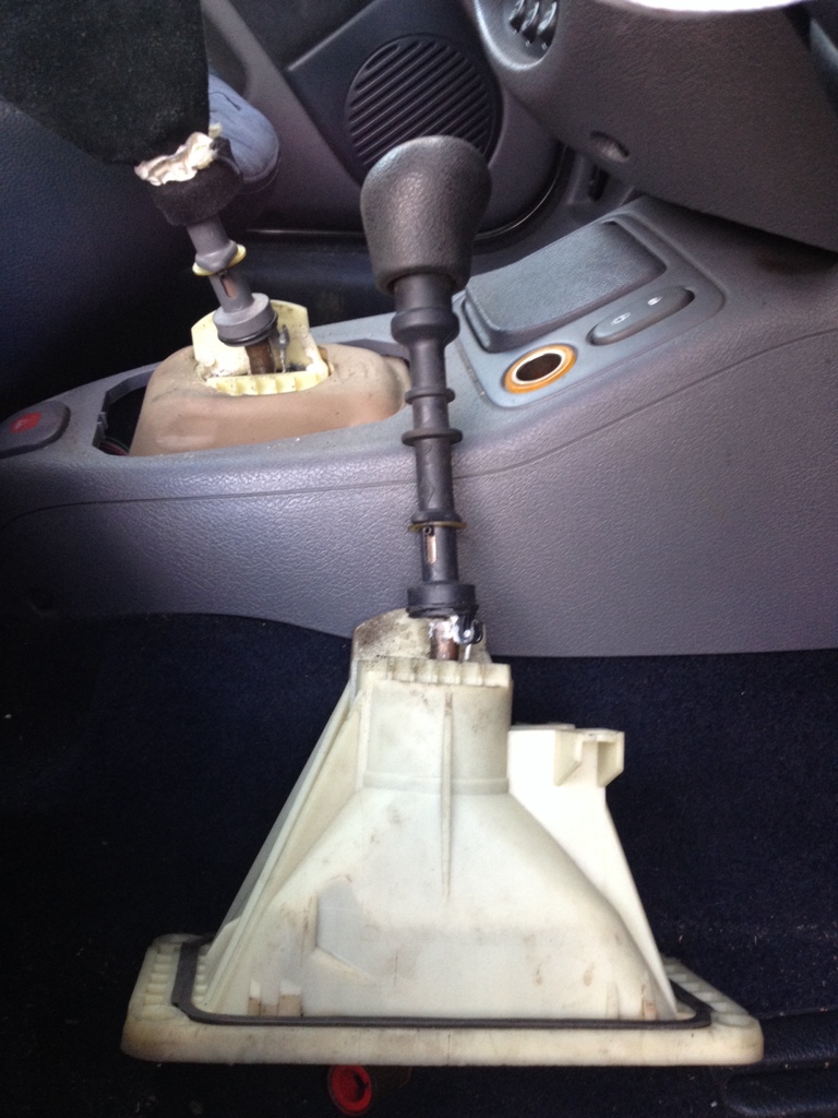

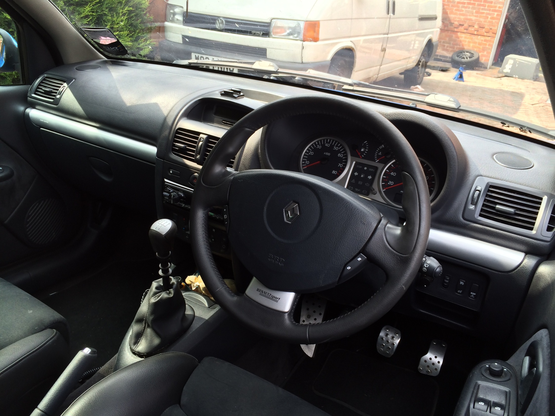

Mark/@northloopcup, this is the scenic shifter mod I was on about by the way:
Sits the lever a little higher up. (level with head unit basically) So less distance to go to and from the wheel.
What scenic was the shifter out of Chip ?
I got me a chance to get one out of a 52 plate phase 2 scenic . Hope it's the same
  182/RS2/ Turbo/Mk1
Don't know exact details mate. Just grabbed one off ebay with same style too as a 182 so we could swap the diagram bit on the top over to keep it original. Some were a different style.

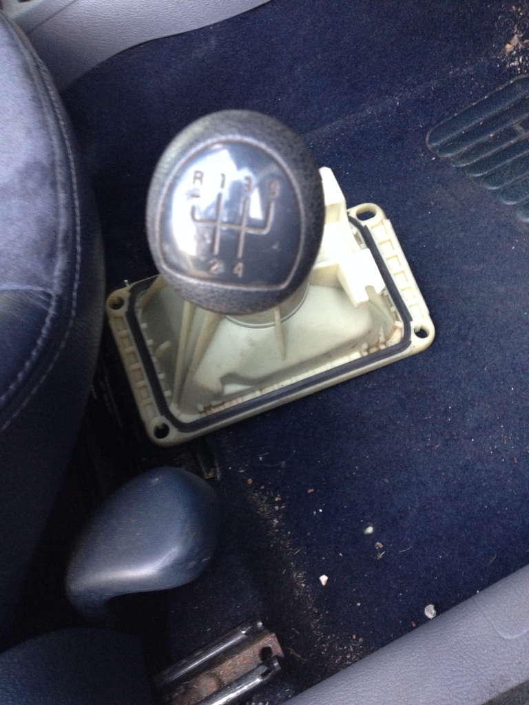

Chip-mk1 , look what I stumbled across in the car I had in the garage . Boot was full of bits . Is this the same length stick as yours - pardon the pun.
And is this this the Knob you have ?
Pardon the Pun again this is getting a bit to saucy on here lol.

Cheers Lesley .

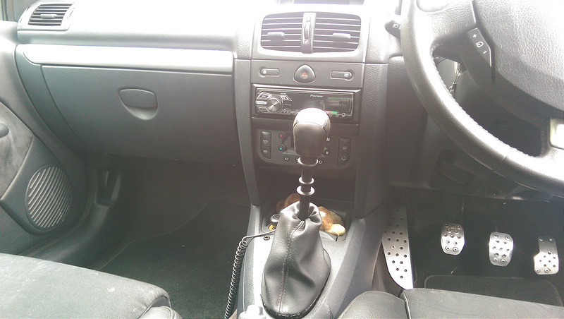

Fitted a new Pioneer stereo so i can play my tunes through it as the original one gave up on me
along with a scenic gear shifter, which is longer
new gear lever by lesley2337, on Flickr

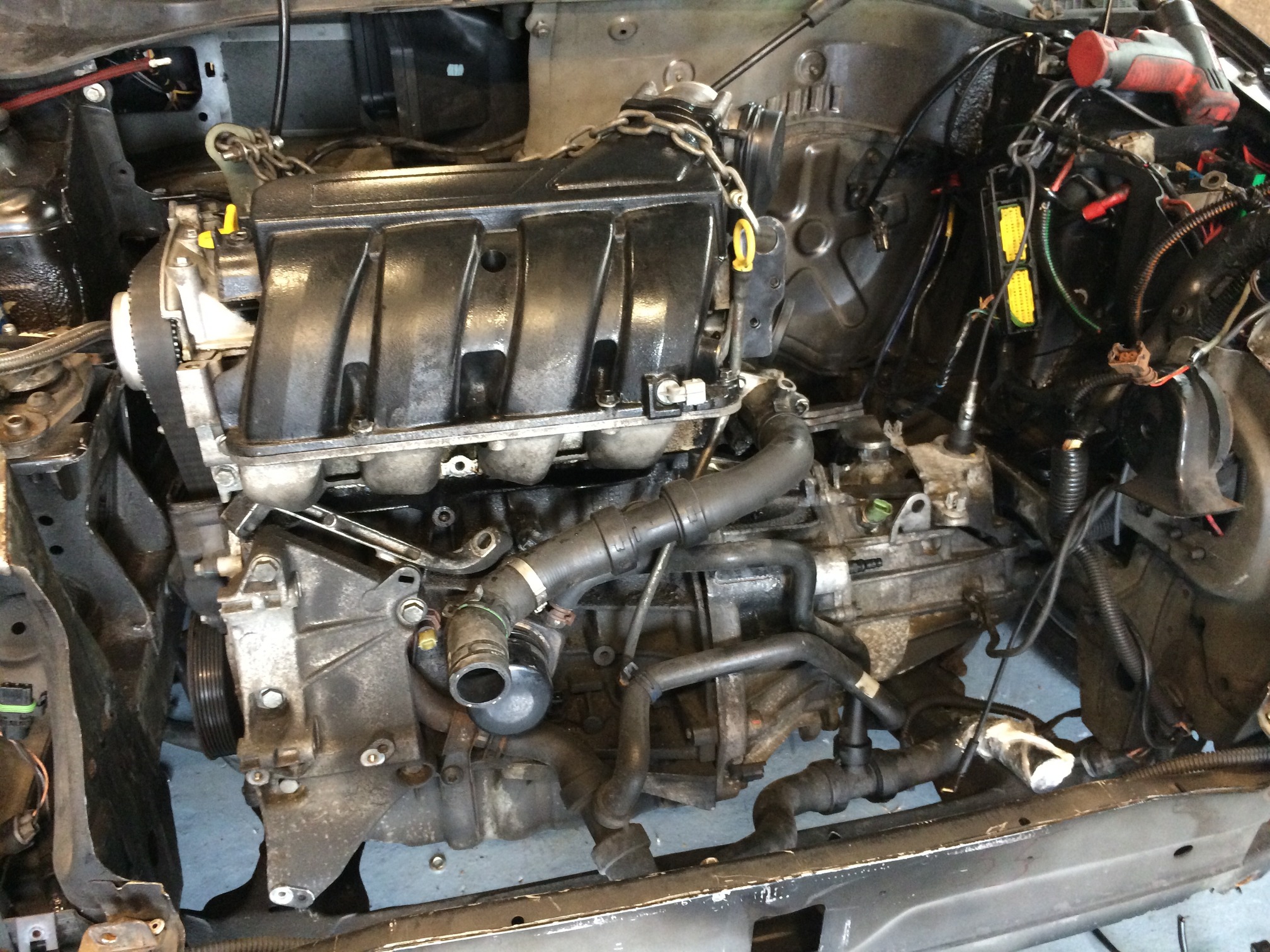

next mod will be the rollcentre correction hubs and then longer term I've just started mocking up the new engine and box I'm going to use to convert the 182 hopefully.
197 engine but will swap to a 182 head and the rs2 inlet with 6 speed cable change 197 box.
very much a background project though so won't be any time soon.

Interesting would you not get the same sort of power just using the standard 197 head and inlet over the rs2 ?
  182/RS2/ Turbo/Mk1
Probably not dissimilar for peak power, but not quite the same power delivery (197 inlet is quite flat at lower RPM IME) the RS2 is also lighter and more importantly than any of that the mrs likes the look of it and wants to keep it.

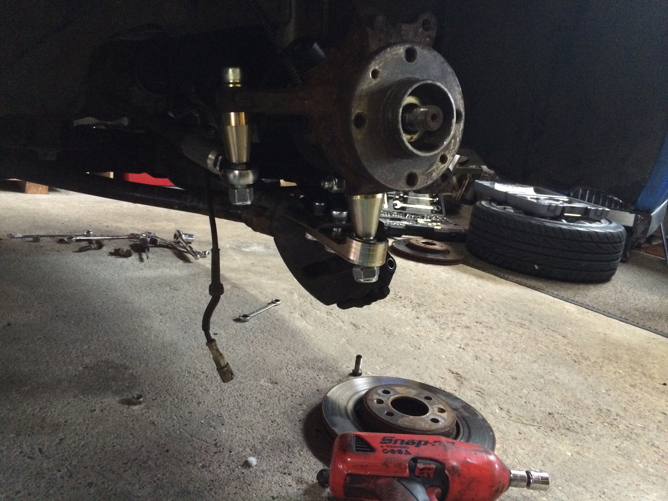

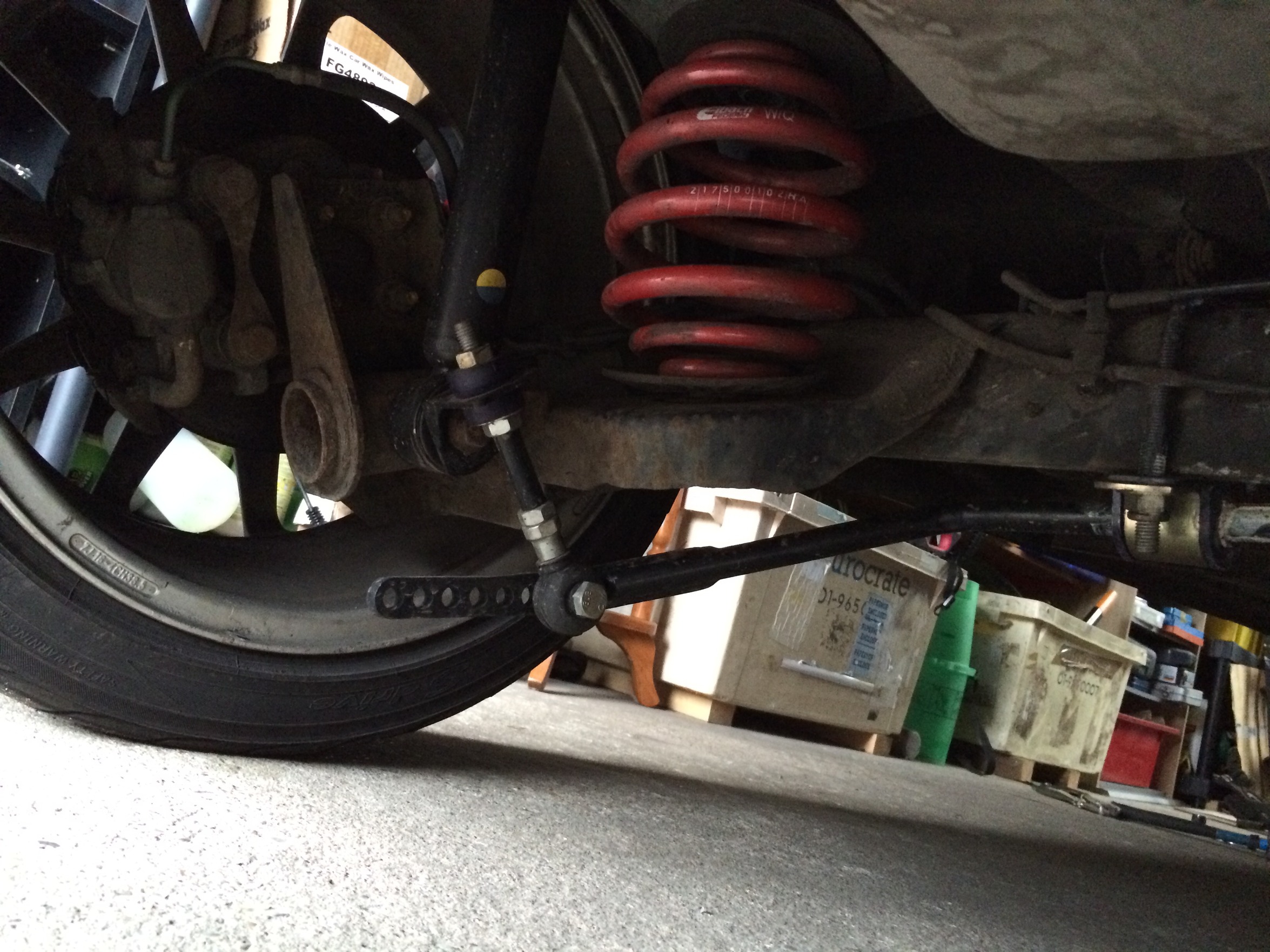

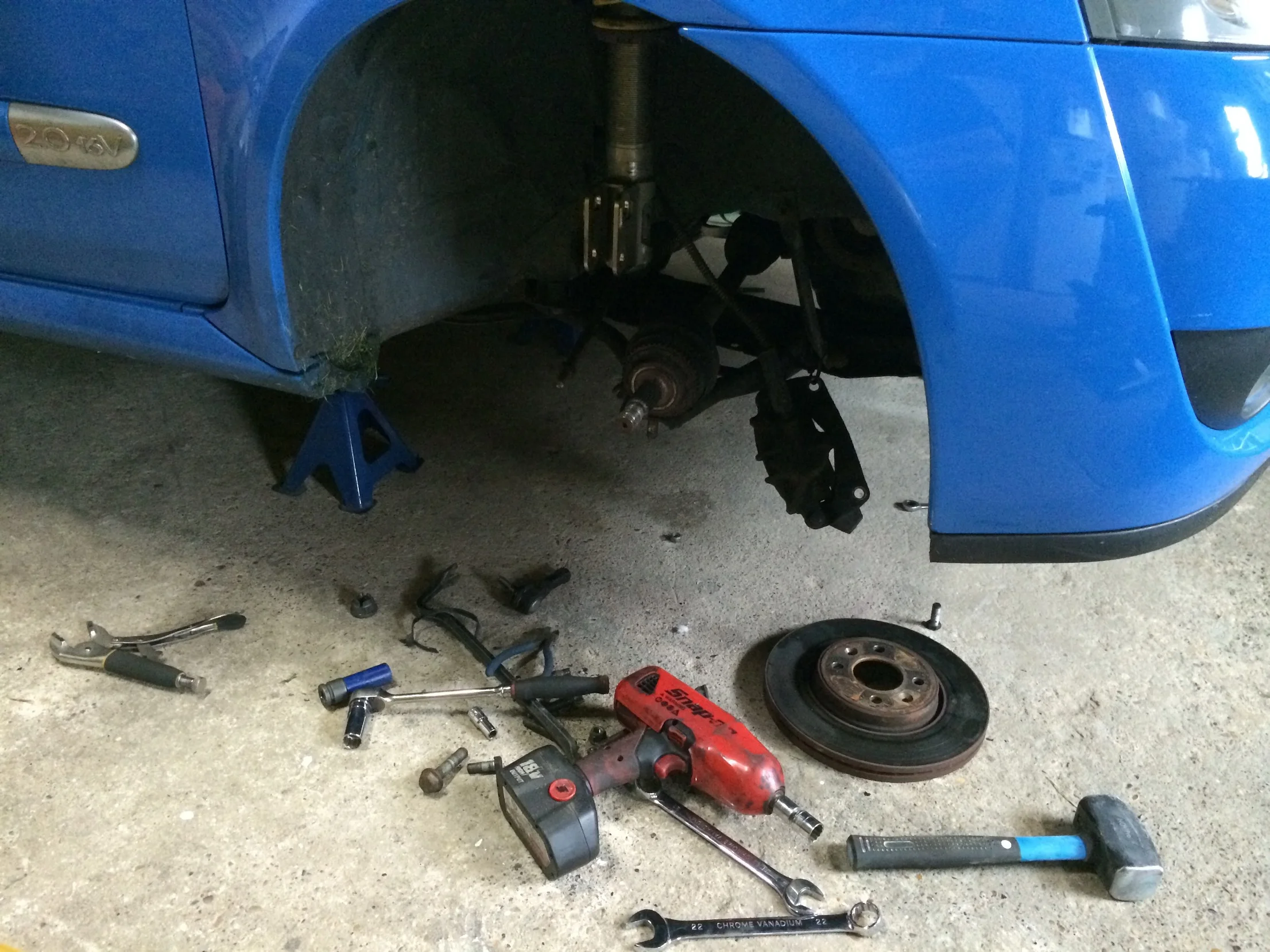

Couple of suspension tweaks today.
Whiteline RARB
Roll centre correction hubs
