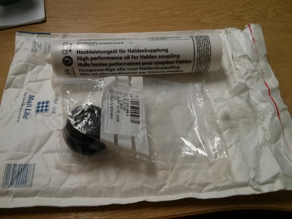

Clutch fitted. :D Feels like a new car and coming on boost it feels like a whole new animal. Haldex service kit has arrived..

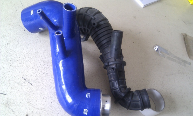

How does the 3" Badger 5 tip work ie what is it ?

Re: My new car. TTQS
Its the pipe that runs from the air filter/box to the turbo. The standard one is rather small and prone to collapsing once the car is mapped.
Standard VS badger
Its been proven many many times to gain 15/20bhp.

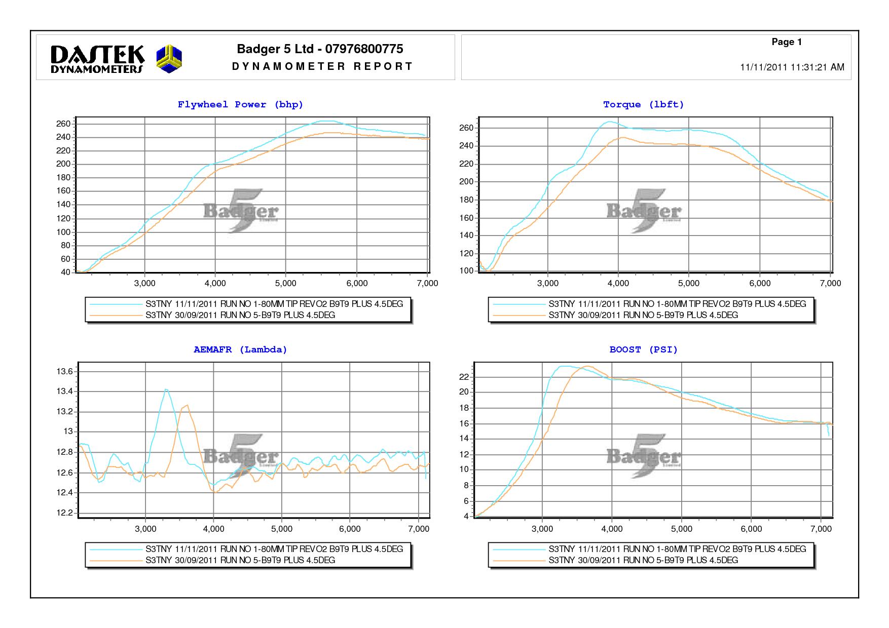

15/20 BHP from just a bigger pipe ?
Standard VS badger
Yep. Considerably more air flow and the fact they don't collapse = more power. :D Proven loads of times. Ive not heard one bad word about them.
That is some gain from the bigger pipe .
Must show how c*ap the std one is .

Thanks gents. Booked in tomorrow for two new track rod ends and the Haldex oil and filter change. (Because im lazy)
Nah, Haldex I'd leave to the pros as well fella. Piece of mind. Similar to what Scrooge said about the Cambelt. You/friends can do it, but it's nice having a receipt for things like that. Oil change/modifications like brakes on the other hand is another matter.

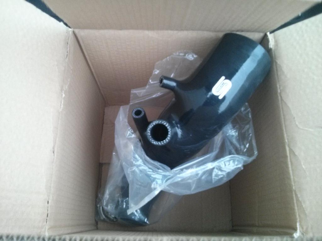

3" Tip has arrived. Now I have to find the motivation to fit it..
Went for black to keep it OEM looking. I don't do bling colours.
