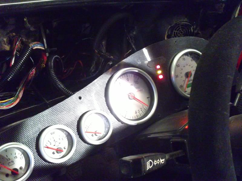

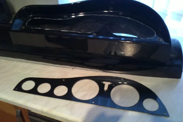

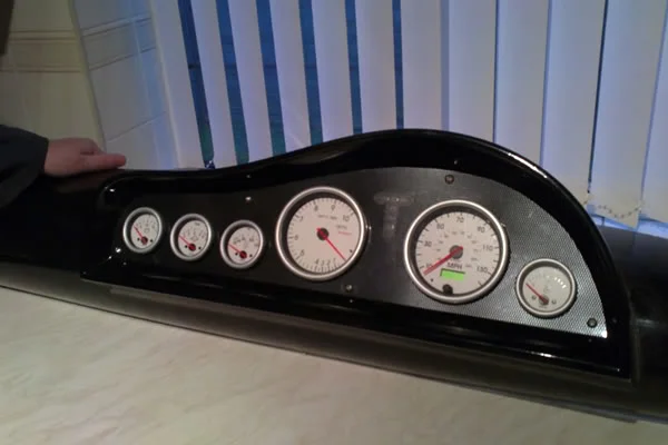

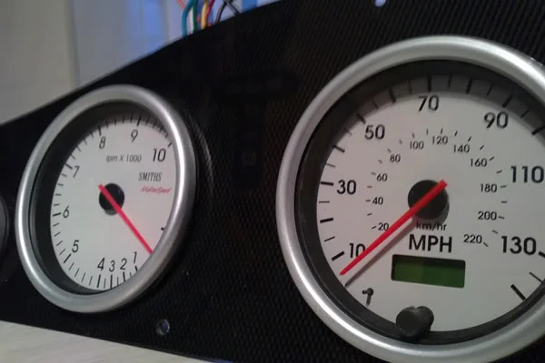

Well, managed to make some progress on the dashboard...

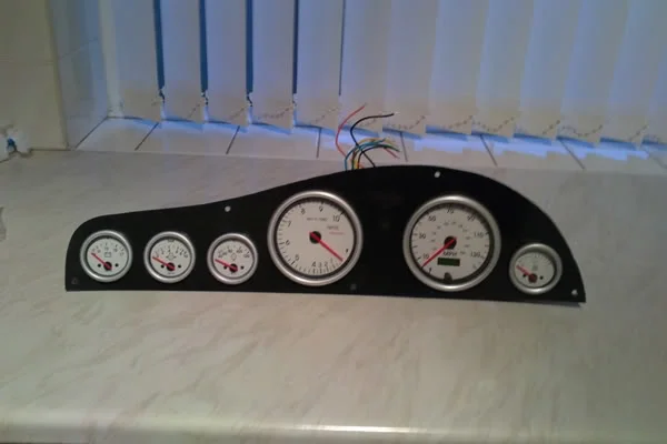

This is the final layout I decided on.
All the holes cut out...
Test fit of guages.. not 100% happy as you may notice the larger gap between the tacho and speedo.
The light cluster doesnt stand out as much as I'd hoped.
But all in all its coming together nicely.

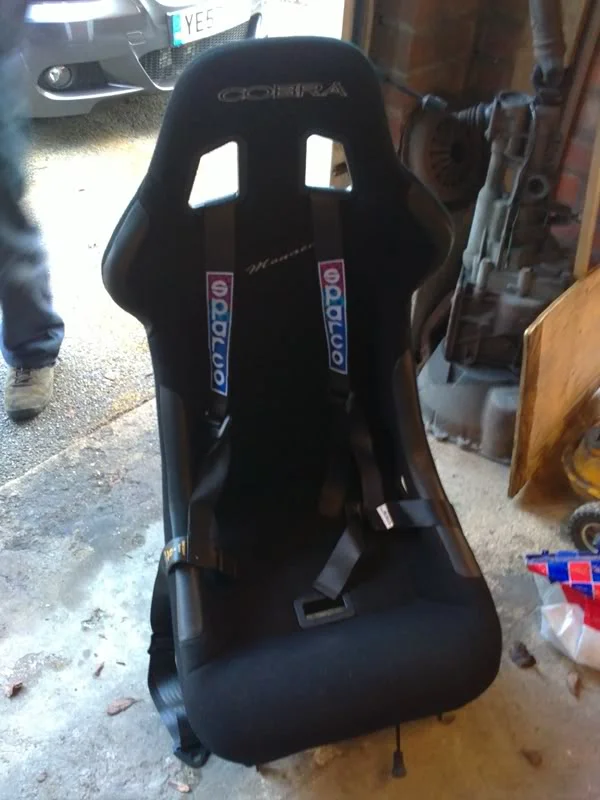

Gave me a chance to get in the back of the car and figure out how I was going to fastern my harnesses.

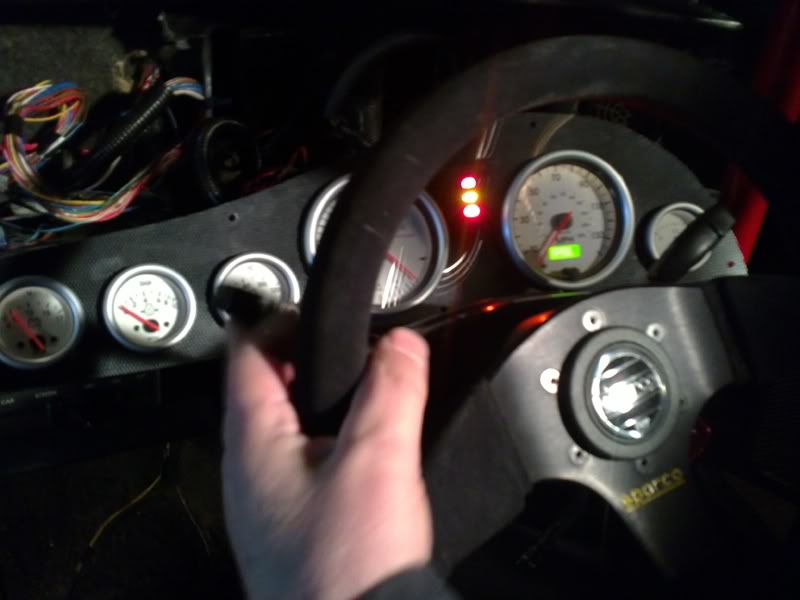

The wiring is about 95% complete now, just the speedo, tacho and fuel gauge to get working and its complete. :-D
A few pics of the interior gauges wired up and working.

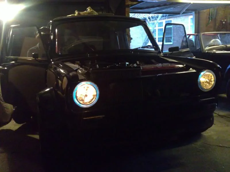

And one of my head lights with my chavvy blue light tints!

They are the side lights, the units have an additional bulb that illuminates the outer ring. The bulbs have various coloured covers but ill remove so they are just normal white, was just seeing what they were like!..
  e91 330d/type r mini
looking good matey :) shame about the water issue though.
my mini came with those style lights but there not what i would of chosen personally but will have to do as im not spending even more money on some lights.

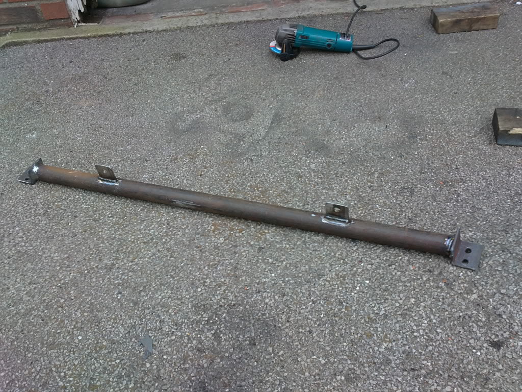

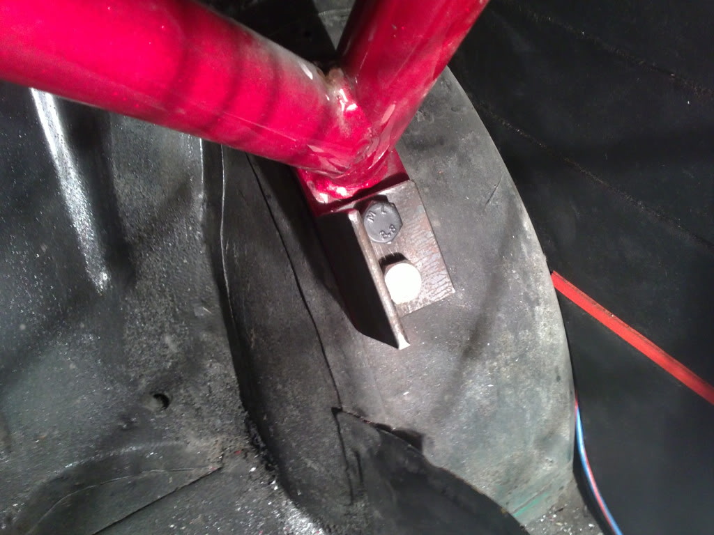

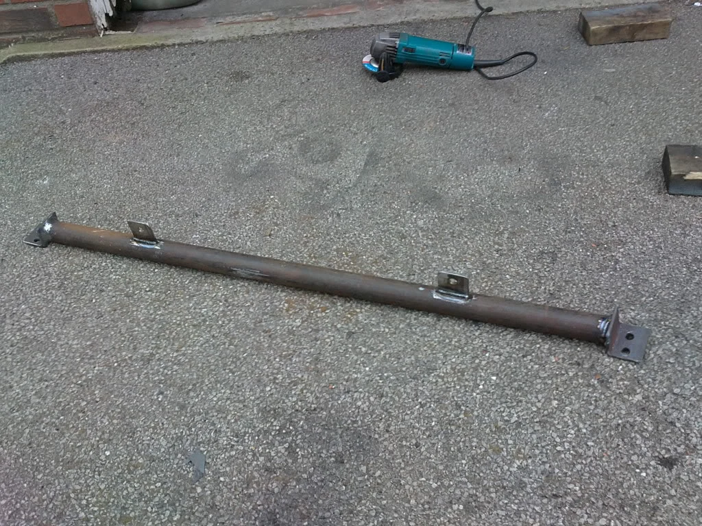

Finally got round to making the harness bar yesterday. Just need to get it powder coated..
Interior is nearly finished now, just need to sort a few little jobs out.

Got the Harness bar back from powder coating.

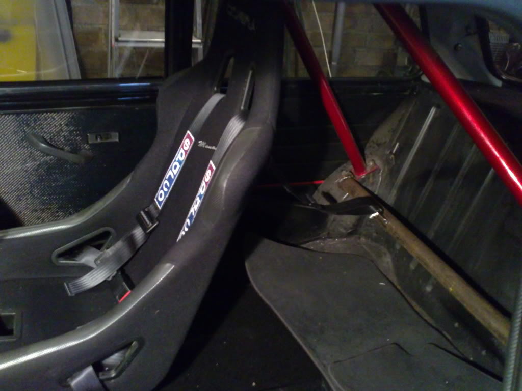

Made a shelf to level out back seat area so it could be carpeted

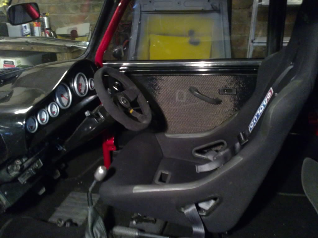

Carpeted the parcel shelf and seats, then finished of with some beading.
picture.php
Then put the harness bar on and painted the inner tubs.
picture.php
picture.php
Finally got the air filter fitted too.
picture.php

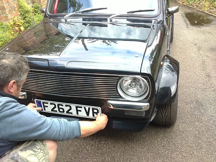

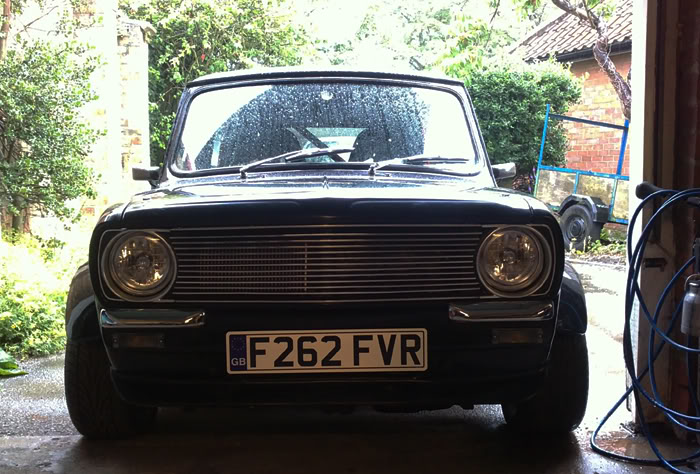

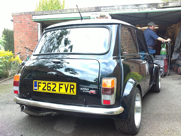

Managed to get the car out of the garage last week and give it a quick swill down
picture.php
picture.php

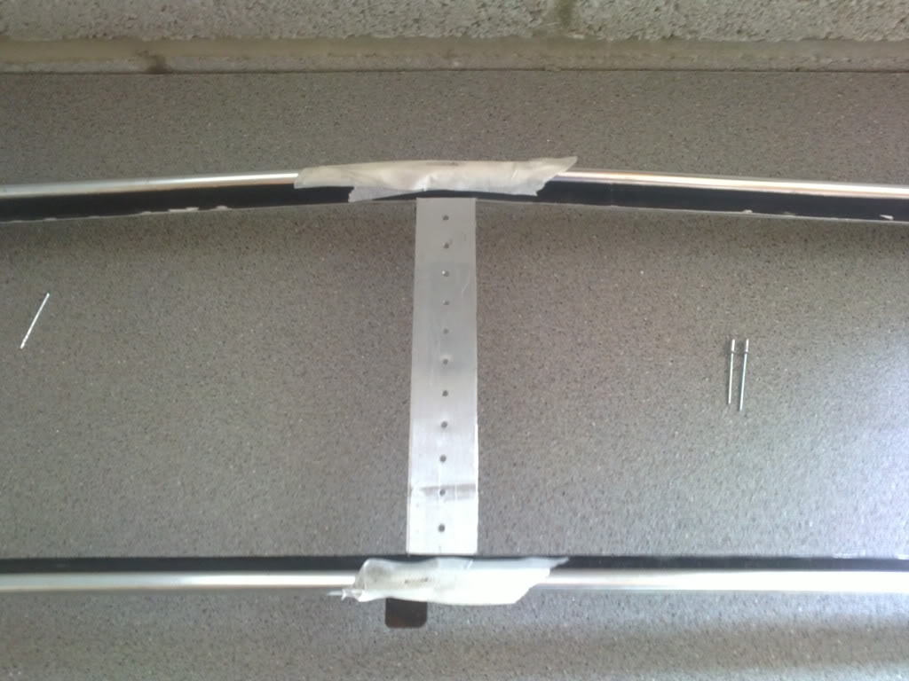

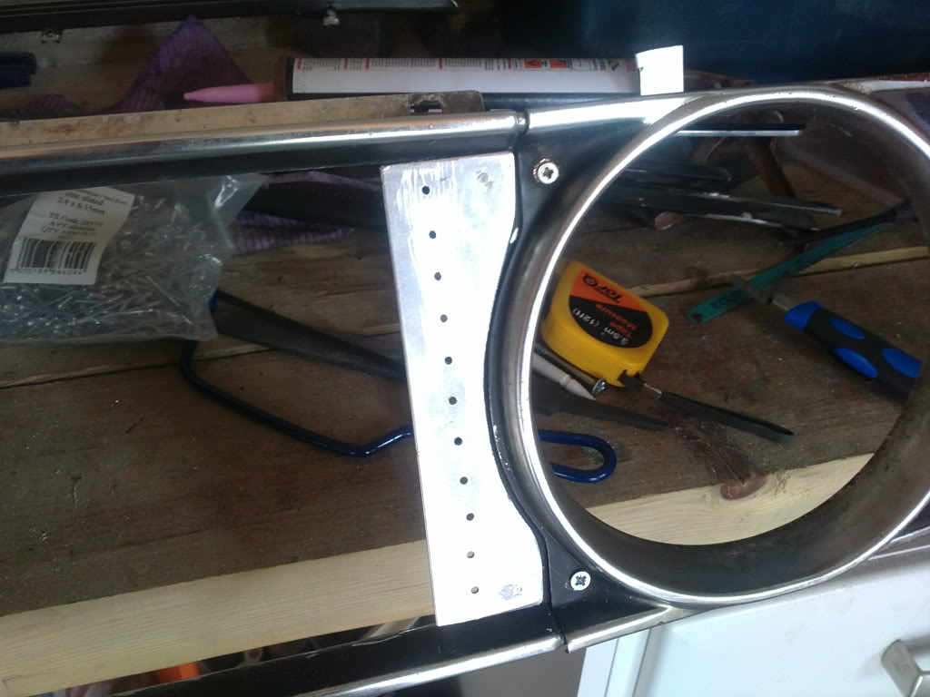

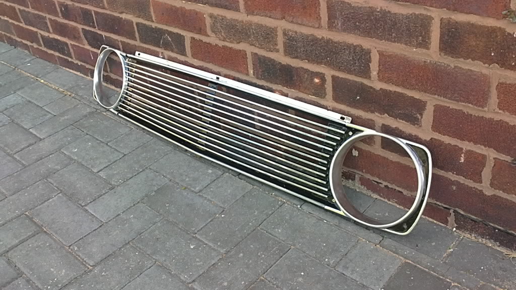

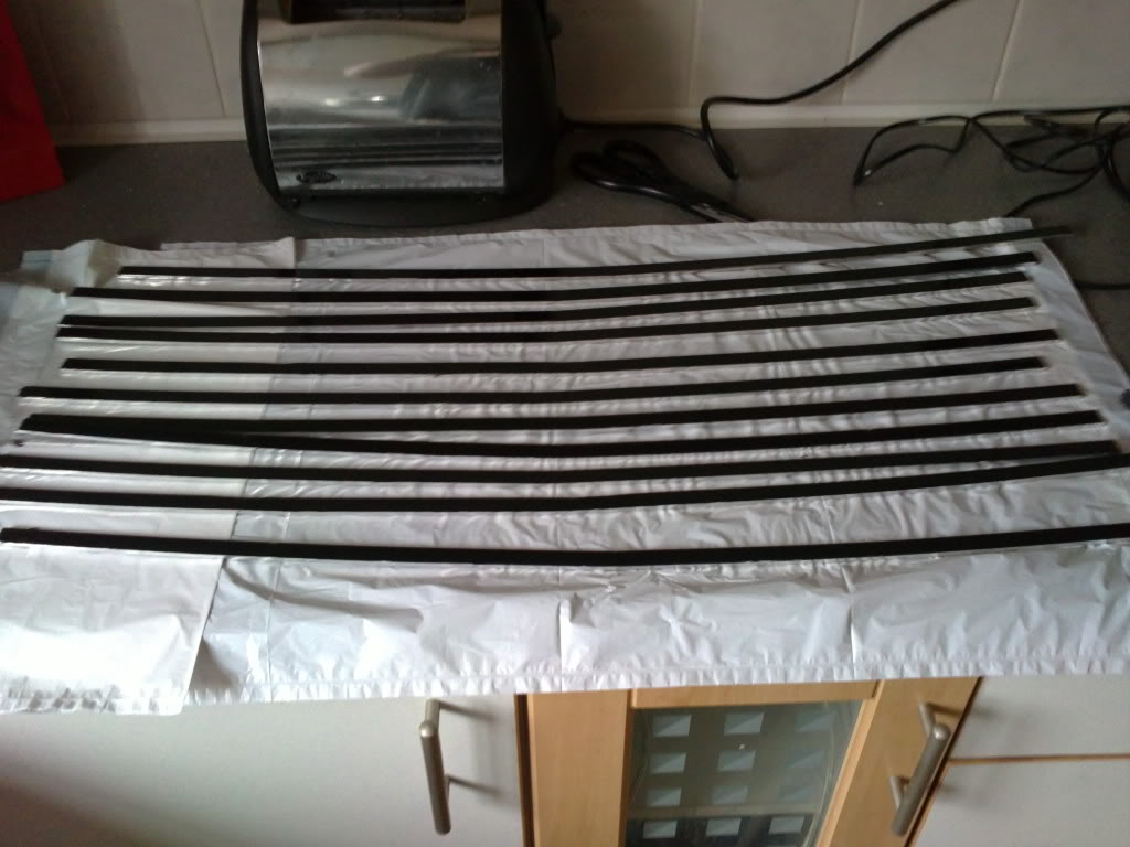

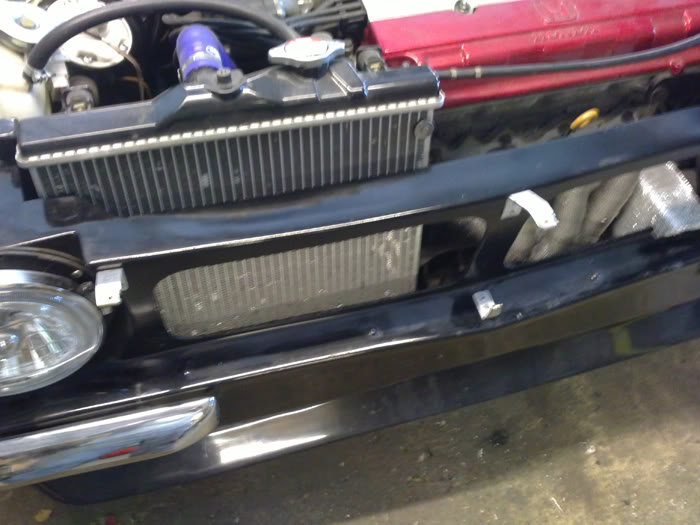

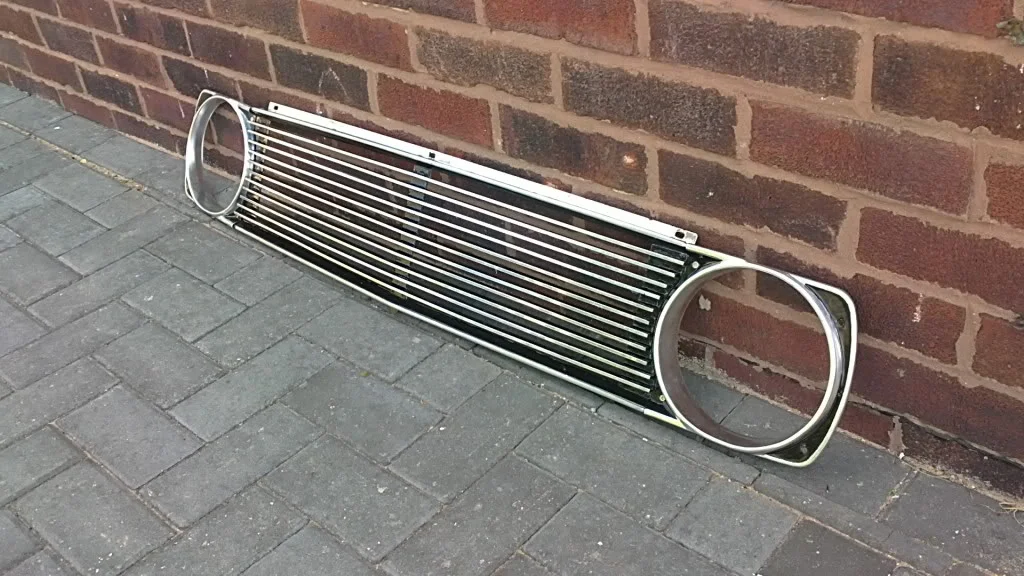

Also made a start on my grill, after hours of head scratching I 'think' Im finally getting somewhere.
Hopefully get it fitted this weekend

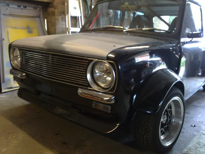

Bit of an update from the last few weeks.
It was either buy some new quarter bumpers off Ebay that look cheap and tinny, or get mine re-chromed.. so I got mine re-chromed and Im glad I did cos they look awesome! cant wait to get these and the grille on the car tomorrow!...

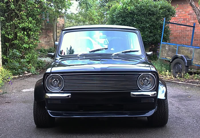

Pic of bumpers and grille test fitted.
picture.php

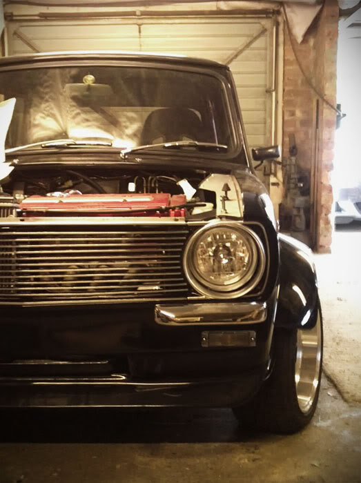

Been doing a few bits and pieces. Made some grille fixings and finalised the bonnet locking mechanism.
Bonnet just needs painting and need to fix a rear number plate light on.

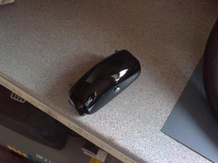

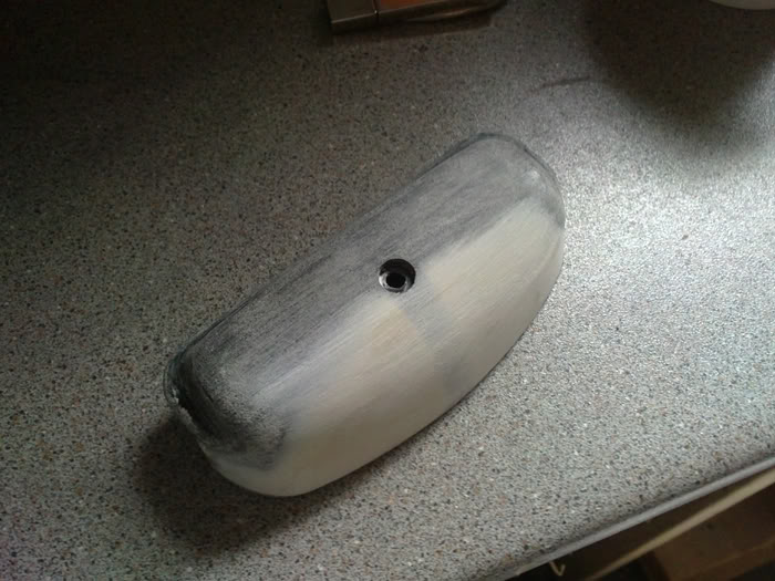

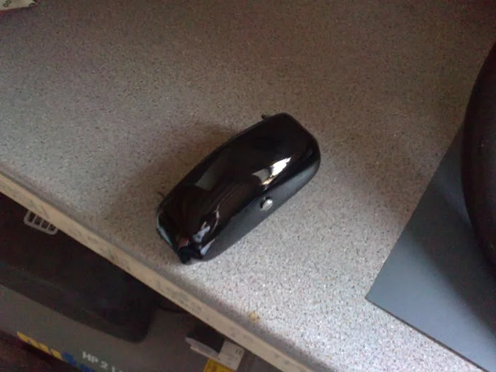

Here is the rear number plate light Ive decided to use. After months of searching on Ebay for something suitable, I stumbled upon it on the back of my old mans MG Midget!..
Decided to fill the recesses.
Then a few coats of paint.

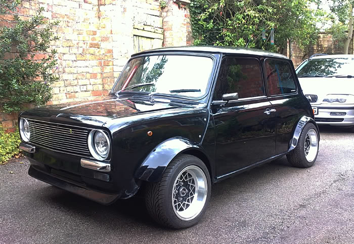

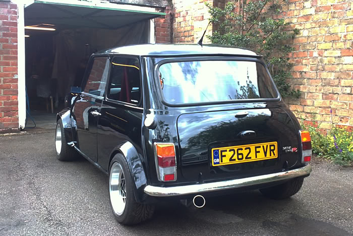

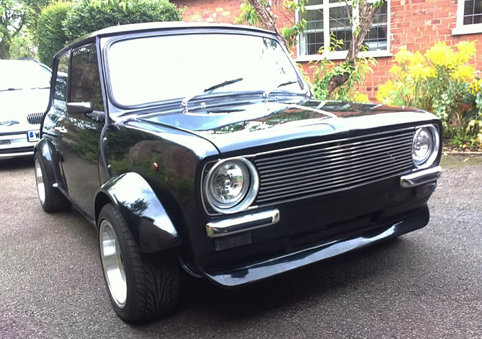

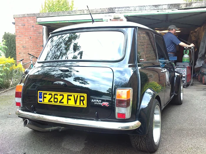

Had a good few days on the car recently spraying bonnet and re-doing the boot as we noticed a few minor dents.
Just a few minor details to take care of then she is off for a four wheel alignments and MOT..
Finally getting there!!..

^^^ this actually is one tho!.. not like a saxo with a type R badge!....
ps - thanks - I think :-D
frayz
Lol, wasnt knocking it dude, like i said its perfect. Just feel the badge cheapens it as the rest of the build is lovely.
Kinda dont think it needs it ya know. Much more impressive to passers by if nobody knows ;)
