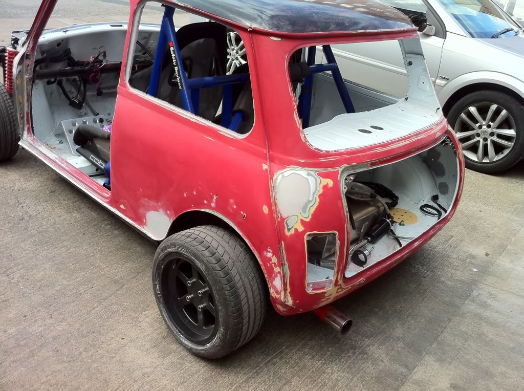

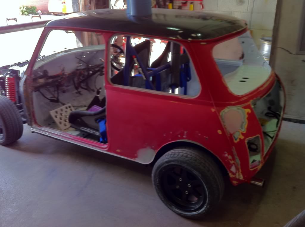

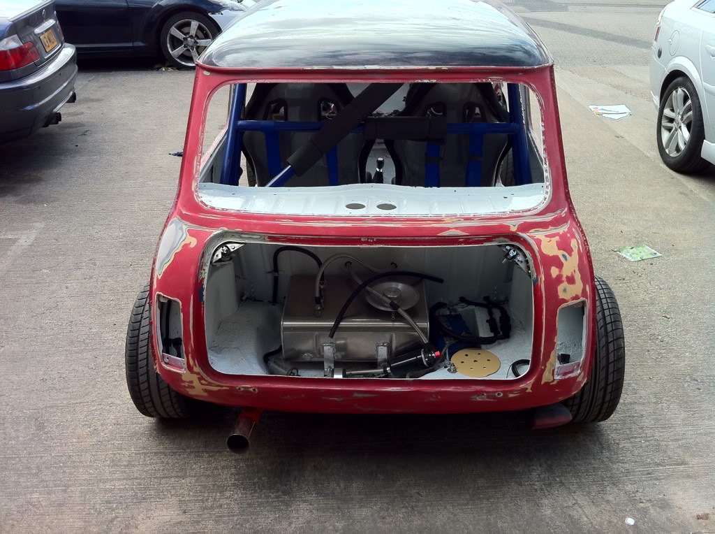

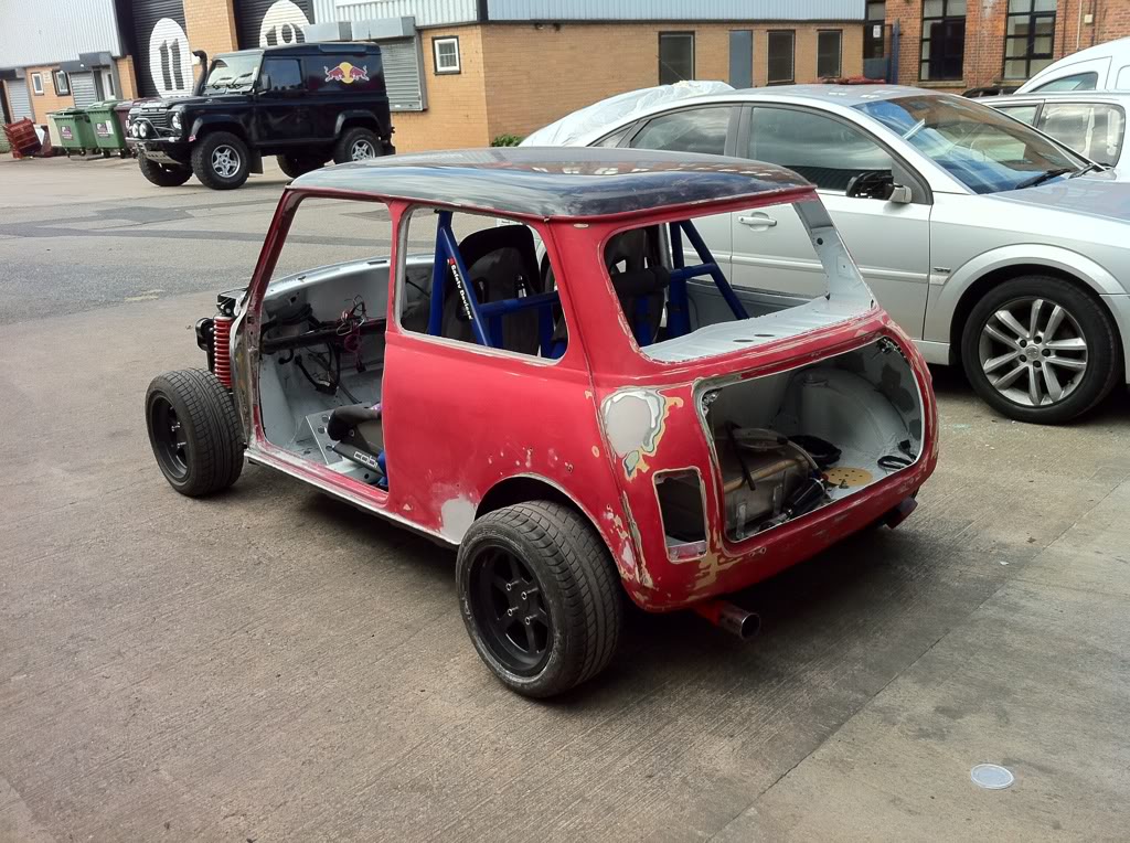

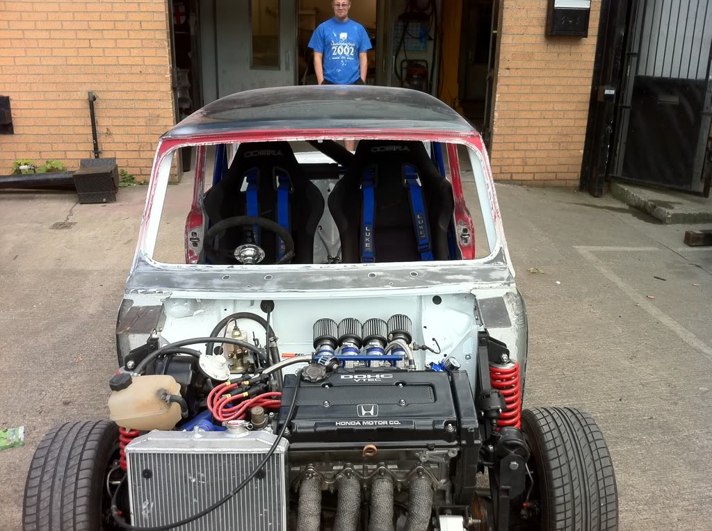

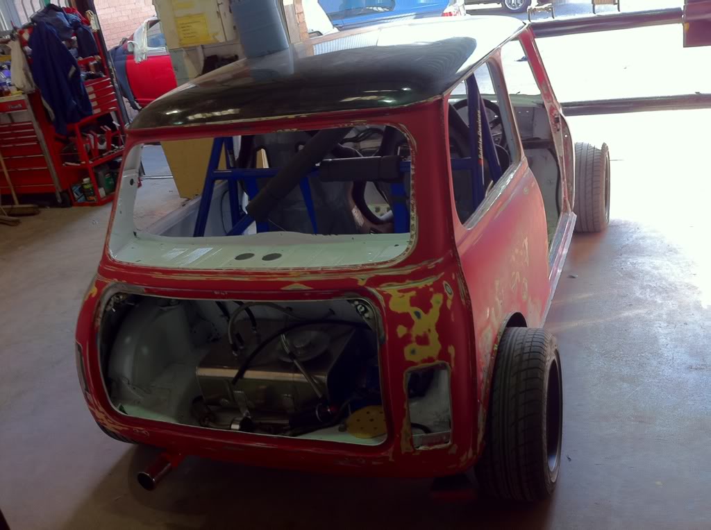

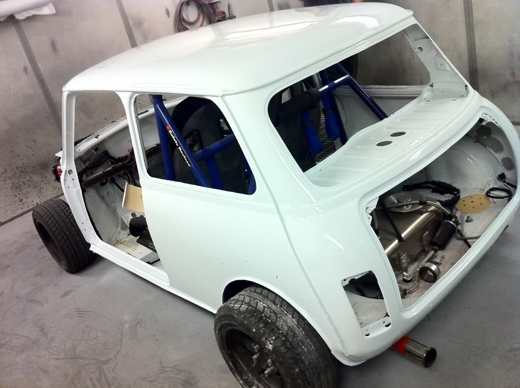

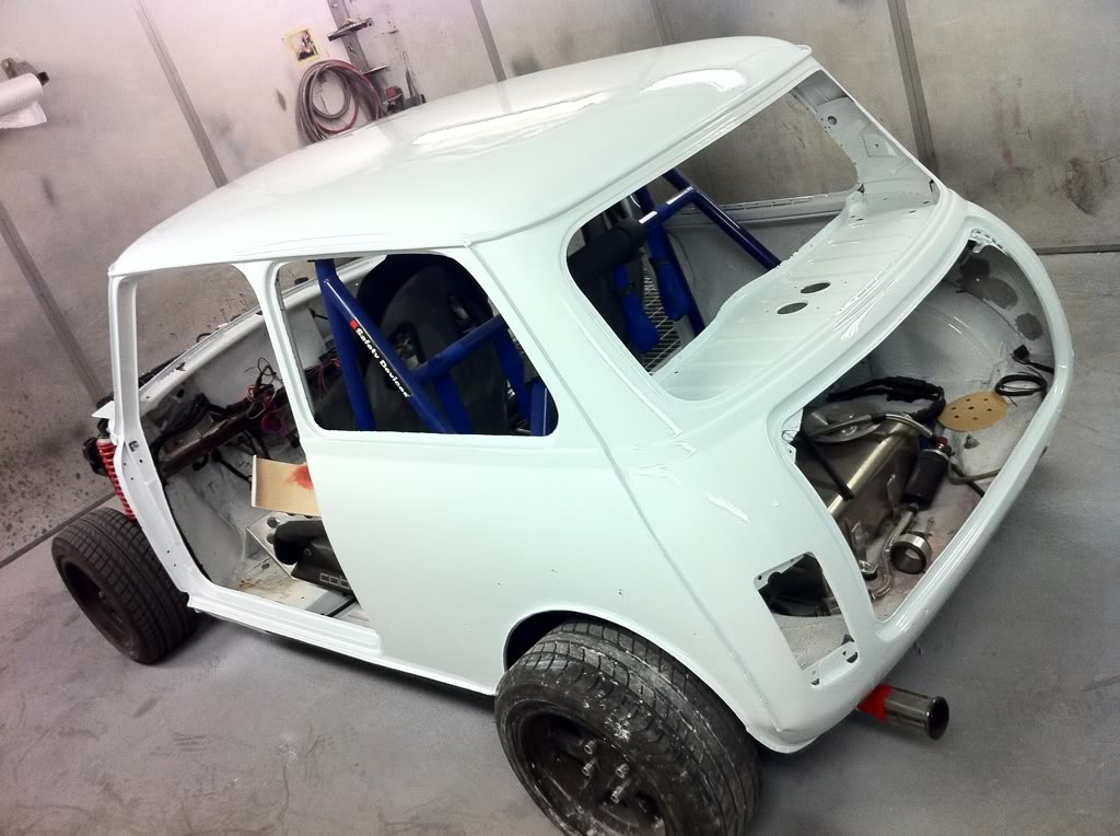

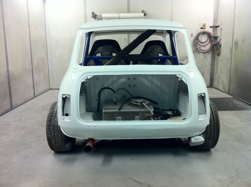

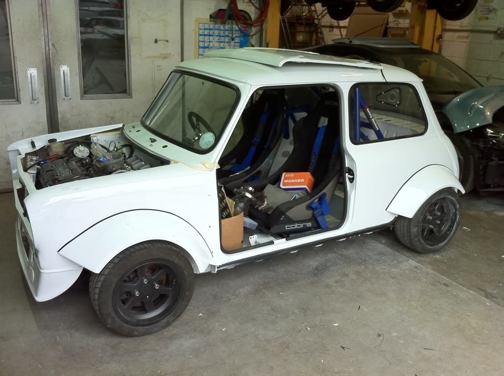

well i have got my arse into gear this week have got the new pump in and fitted and now she runs again, also started with the bodywork shes nearly ready for primer now just a few dents to be removed from the roof then its ready :)
car is going to be be ford frozen white.
getting quite excited now,
a few pictures of where im at

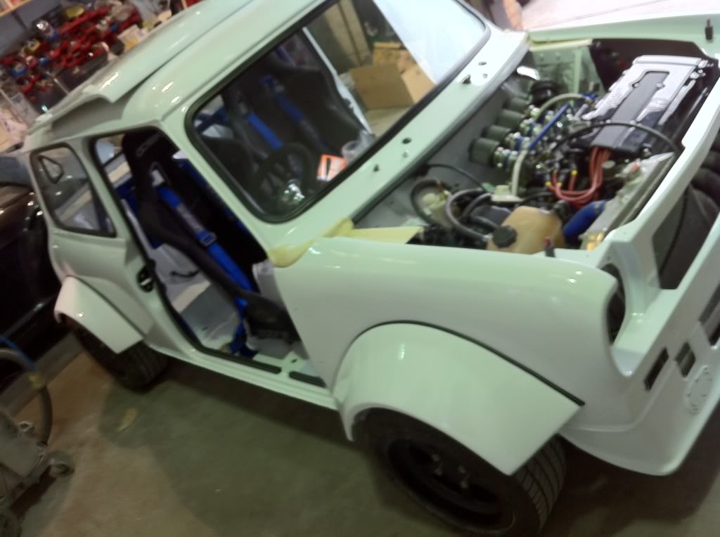

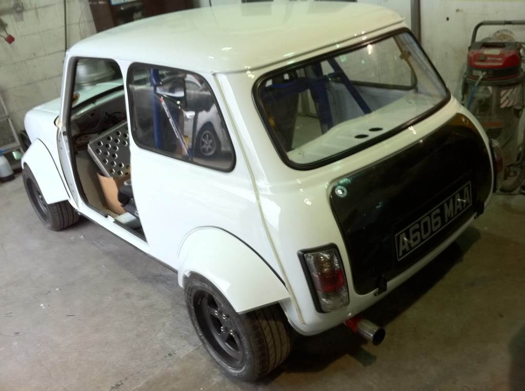

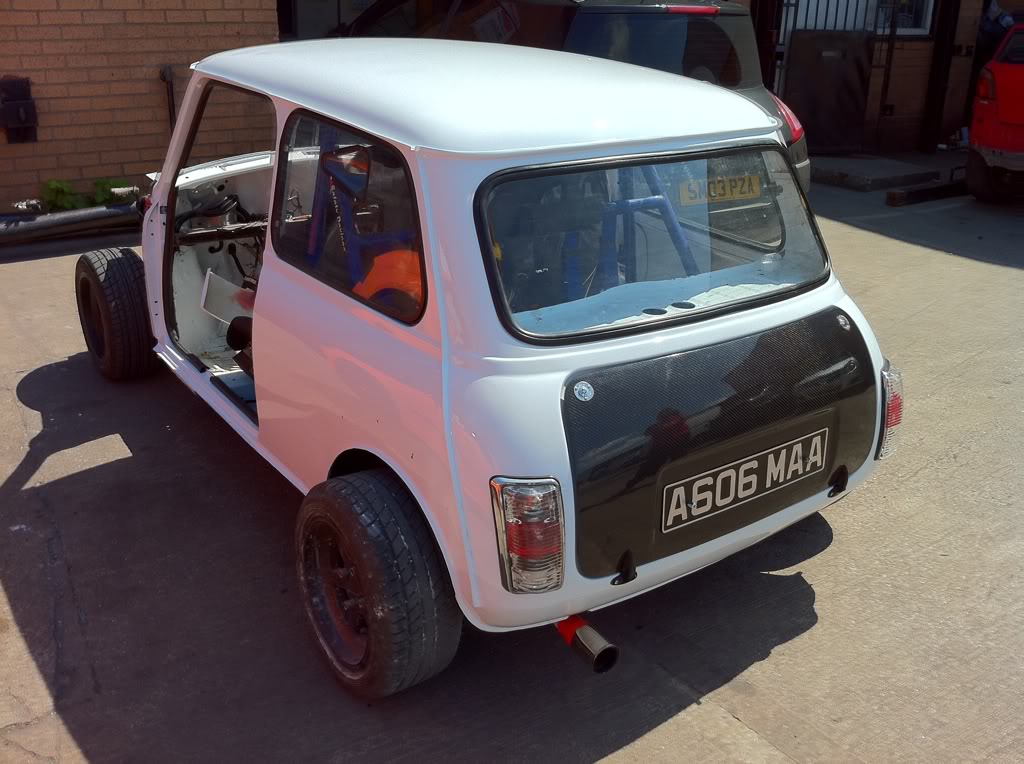

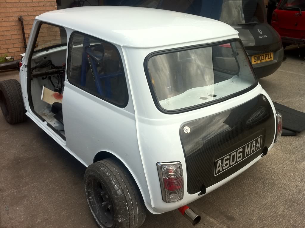

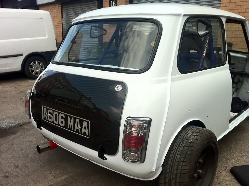

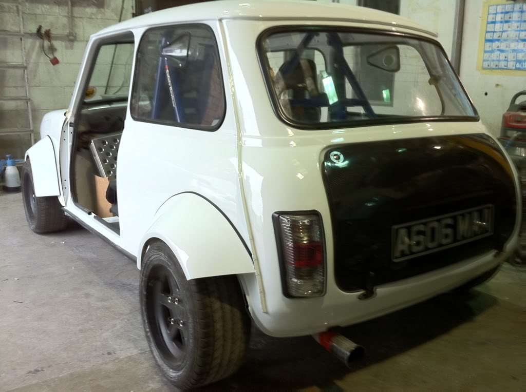

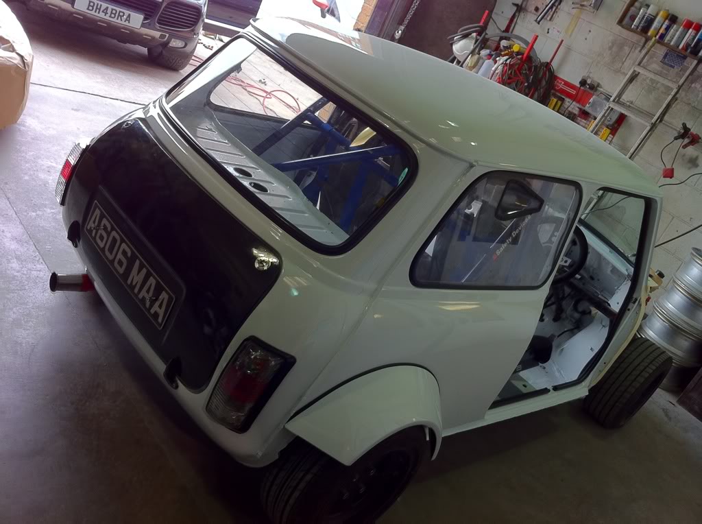

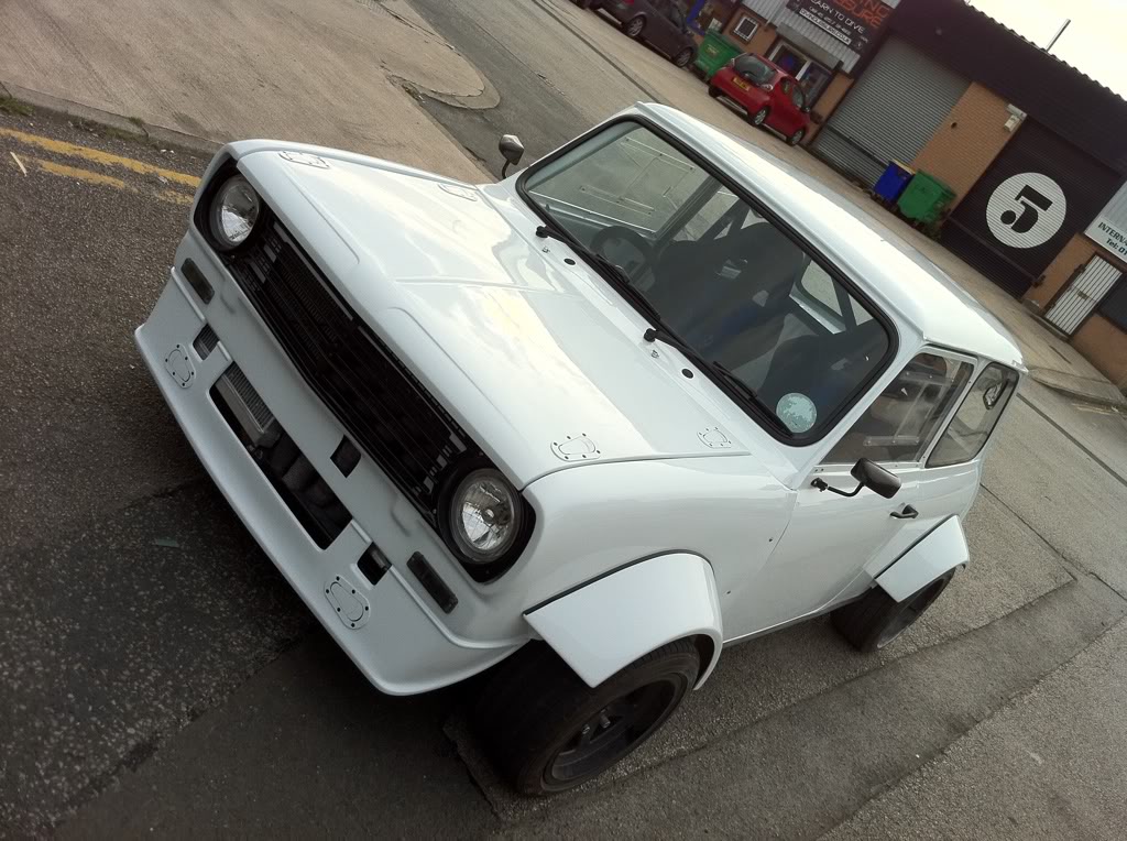

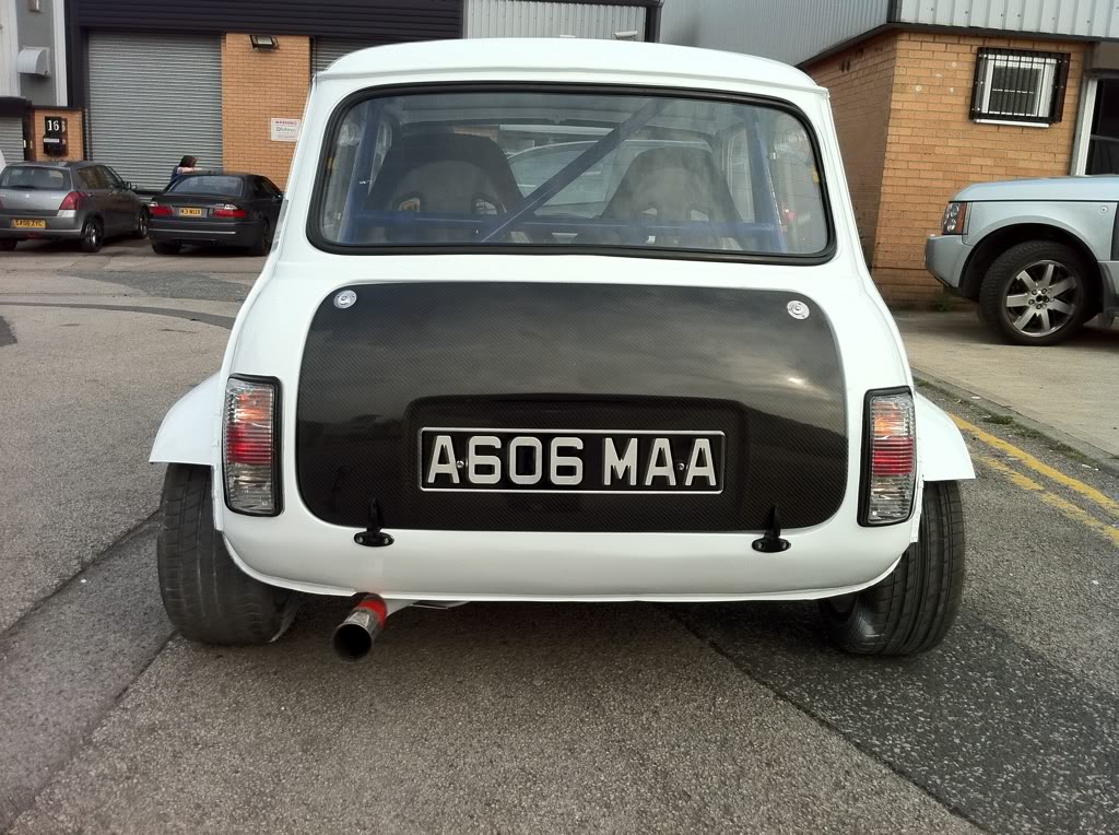

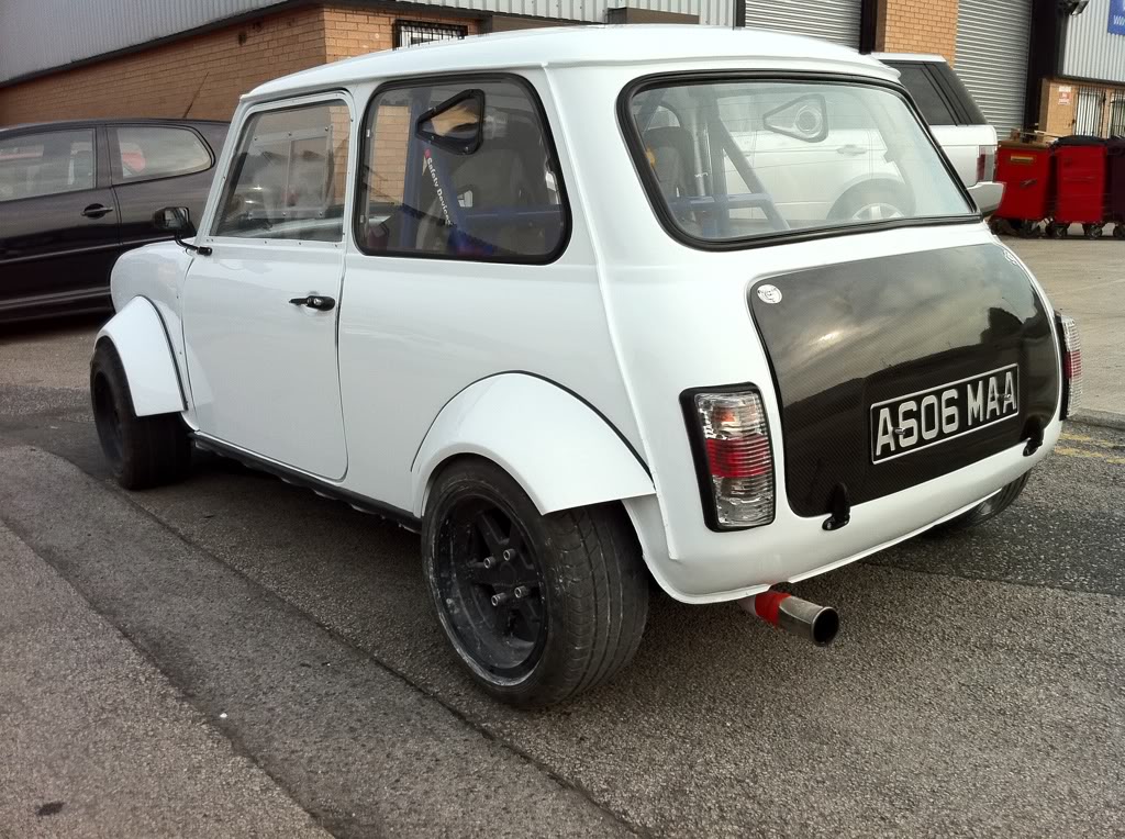

well i stayed late last night and got the shell blown over and started putting a few bits back on today
car is ford frozen white and turned out fairly well for a 30 year old car.
few pics of my progress and where were up to :)

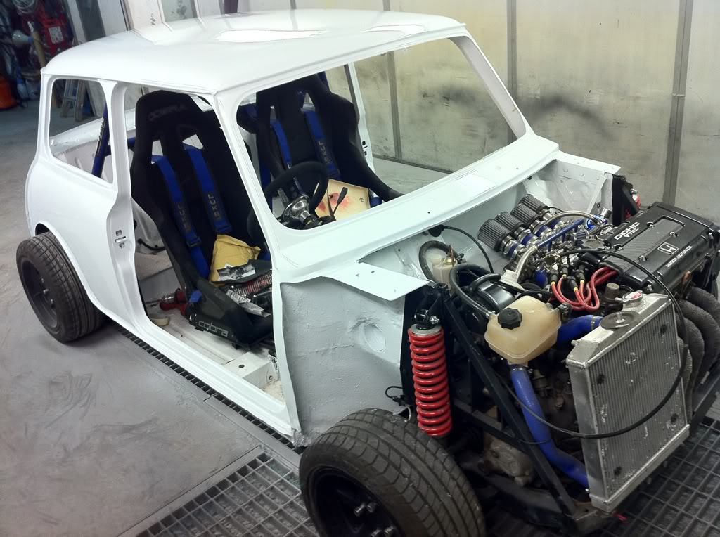

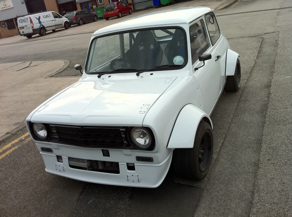

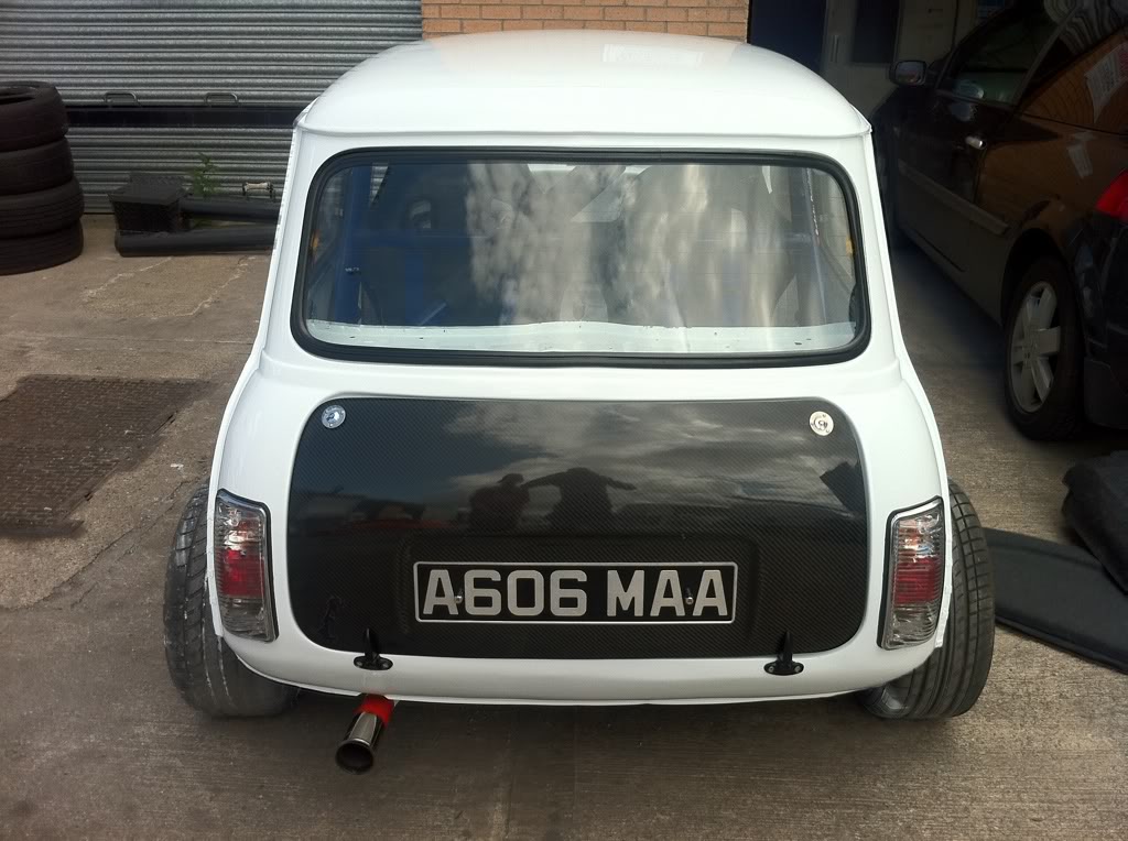

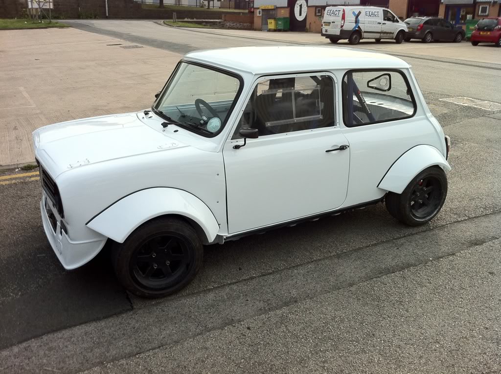

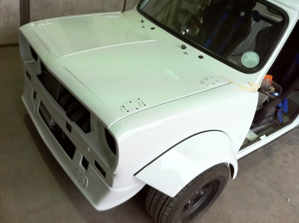

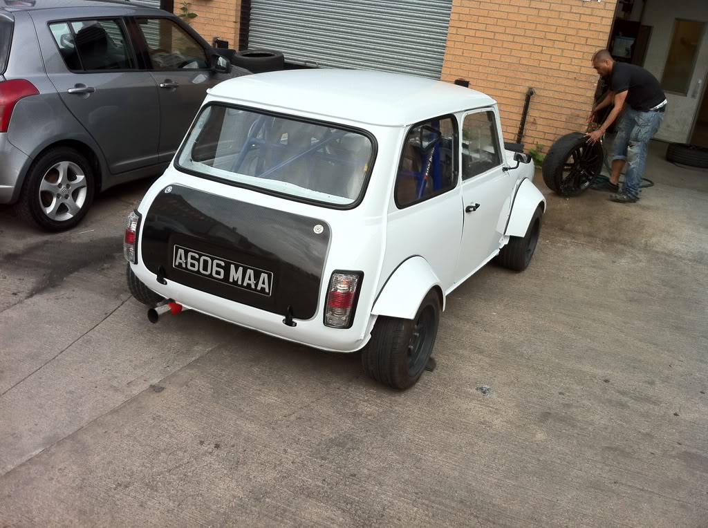

got the rest of my parts sprayed today and started building it back up, had to call it a day as the wife put her foot down about me being home as there has been a few late nights this week :(
any way here a few pics, hopefully have it as a complete car by the end of the weekend :)

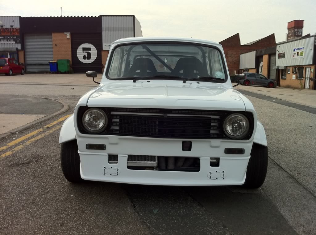

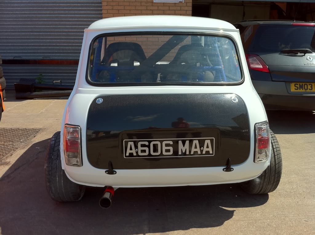

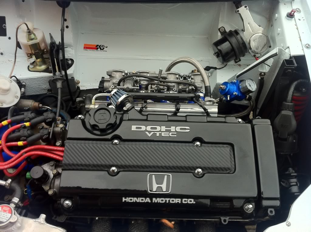

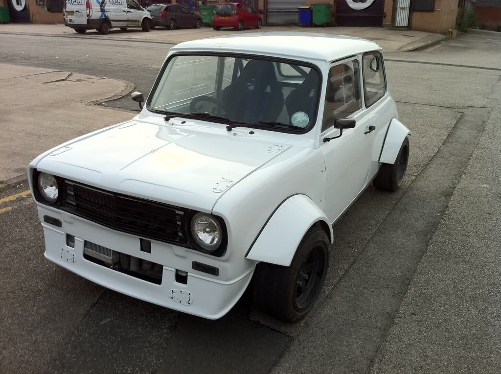

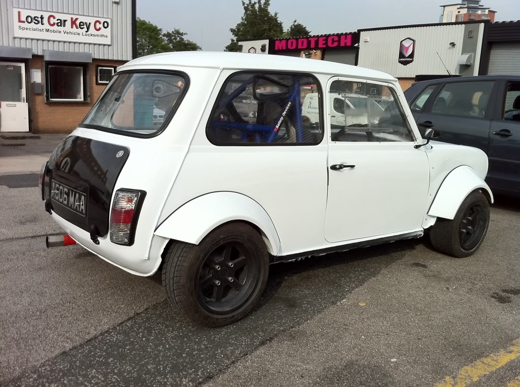

well its back together finally, just a few bits of alignment to do then i will be happy, what do you think?
i also took it for a cheeky drive up the road (sshh dont tell the law)
it needs a dam good tracking session and mapping but a bit of work and it will get there,
anyway a few pics for you

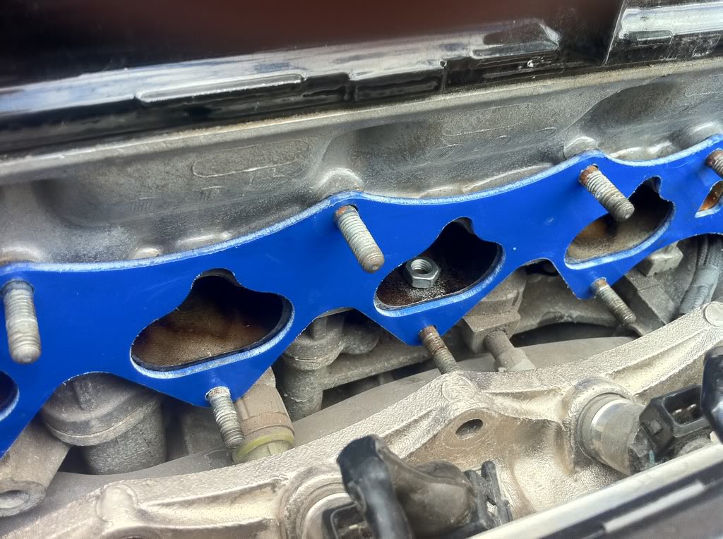

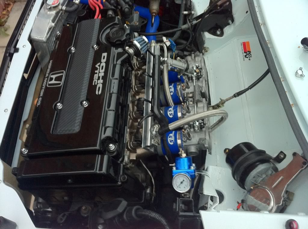

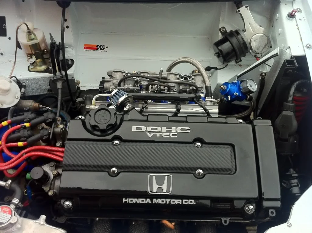

well i had the car with paul @ rs tuning for him to work his magic, i had a small issue with the inlet manifold and had to take the itb's off only to find a foreign body in there.
i removed it and thought id got away with it but after a bit of time on the dyno it was soon apparent something wasnt right :(
paul did a cylinder test and confirmed the inlet valve was leaking by on that cylinder :(
he did what he could with the car and lets just say he gained 90bhp from what it went in there with but still not what i was after ( please dont ask for the figures lol)
pic of the foreign body
a few of the dyno runs for you to enjoy some vtec flames :)
http://www.youtube.com/watch?v=7xTBZ..._order&list=UL
http://www.youtube.com/watch?v=zawU9zXpBVM
now to remove the head and sort the valve seat out, just when i thought i was finished lol.​

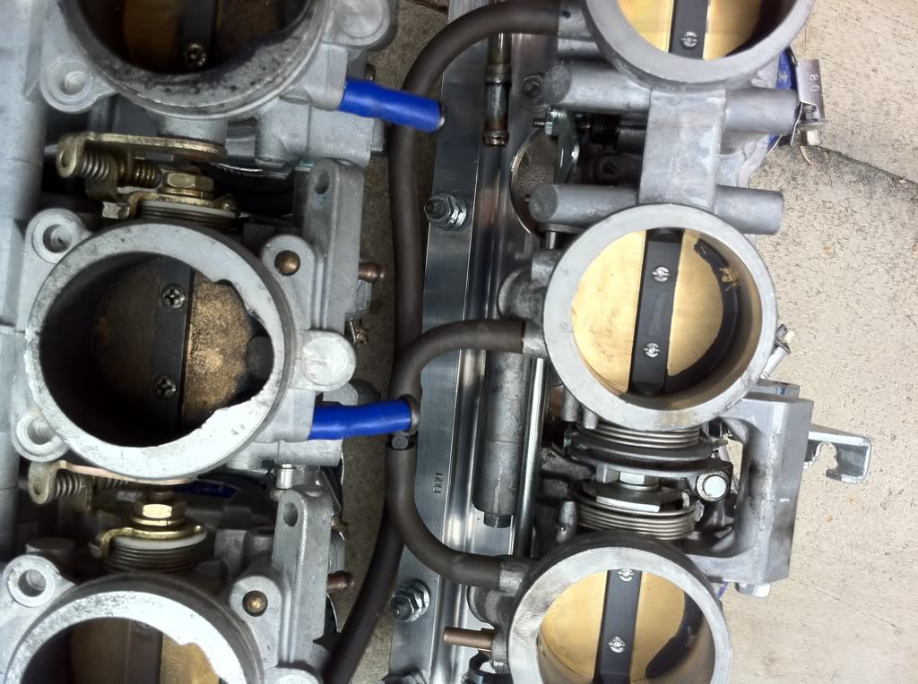

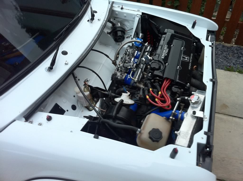

a little update on the mini, i decided the 38mm r6 itb's were to small and have bought some 42/43mm cbr1000 itbs that i have fitted and have to say sounds like a completely different animal now, got to sort out some trumpets and some kind of filter box then just need to get rs to sort out the map now and i can go have some fun :)
couple of pics
and a pic of the difference in size of the itb's
