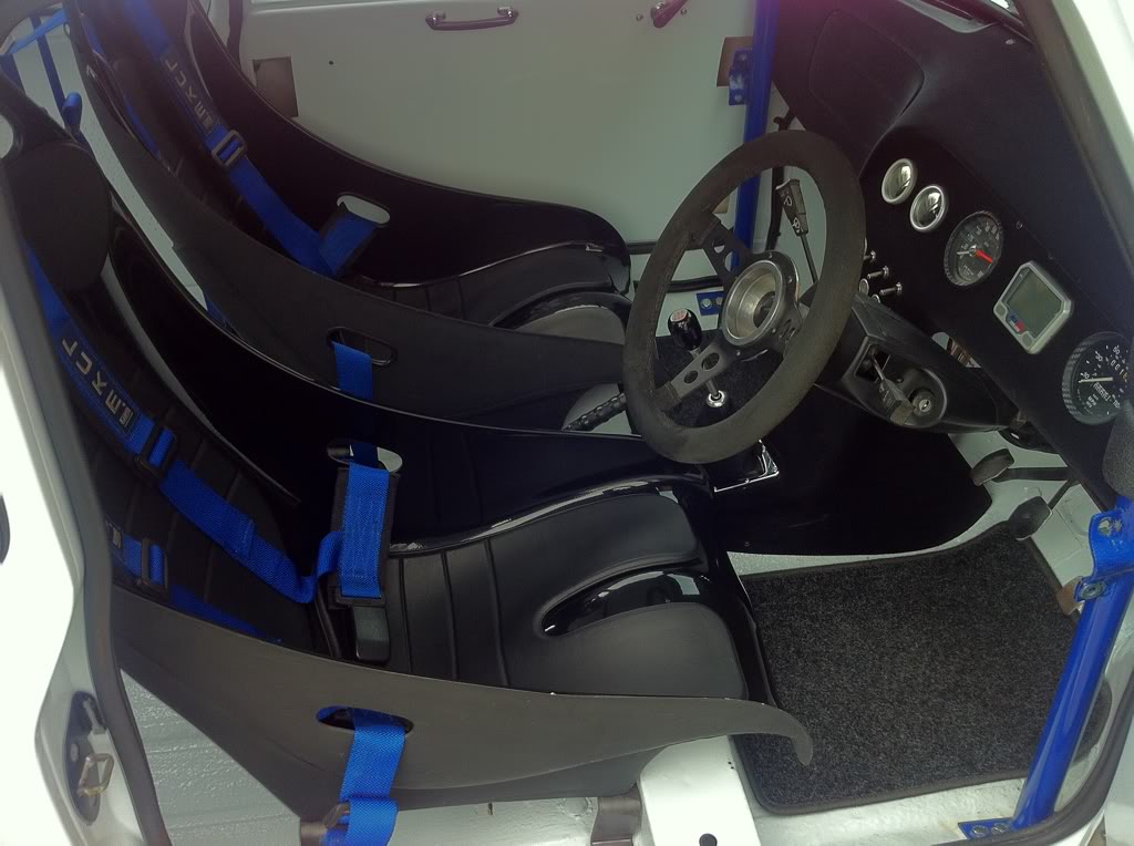

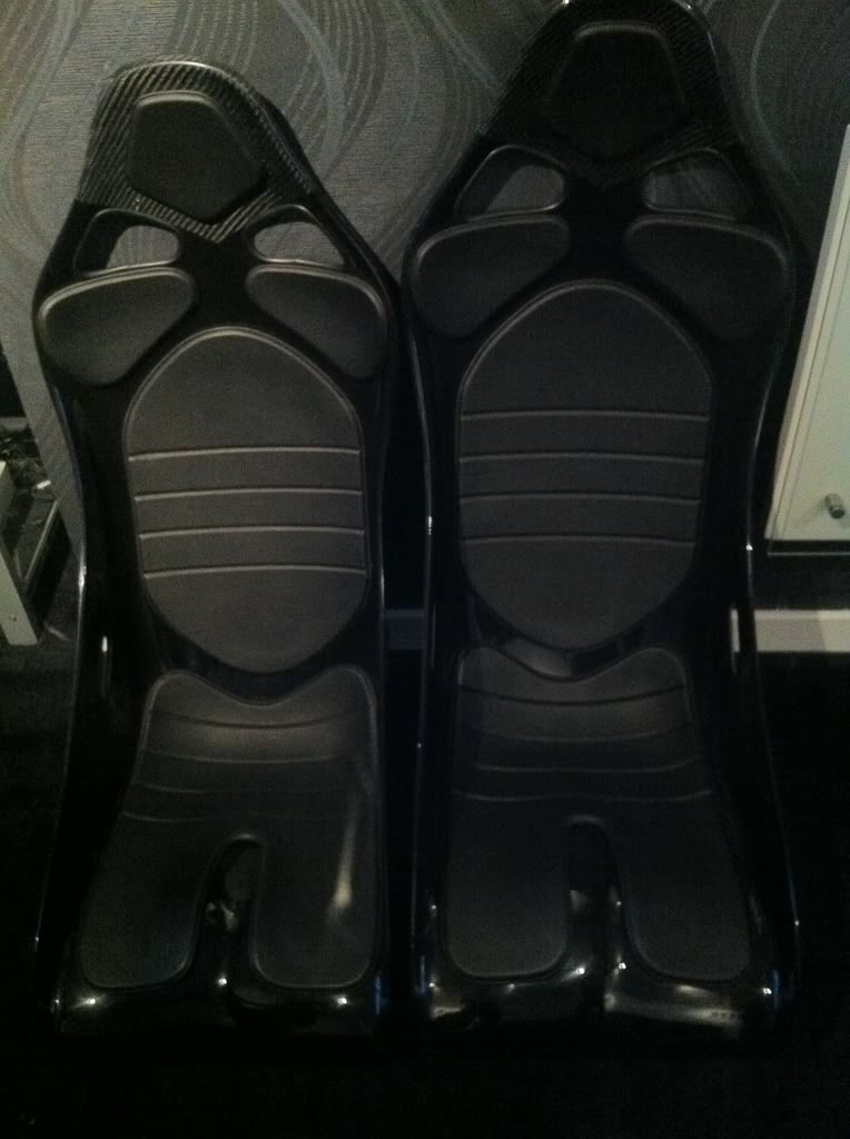

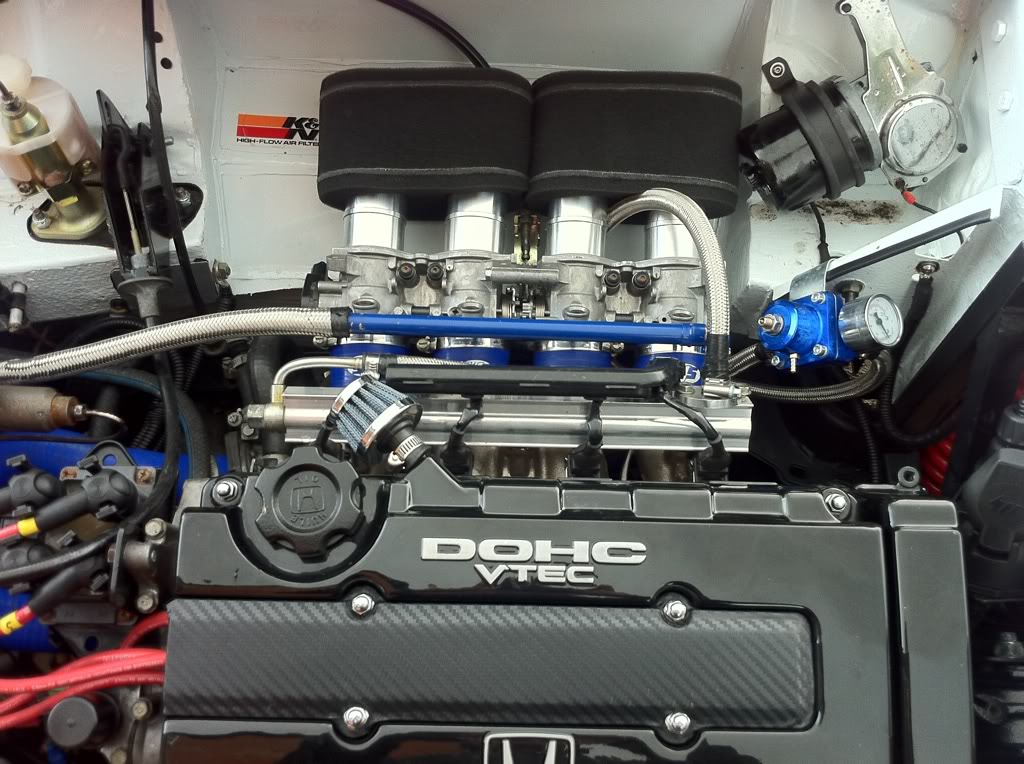

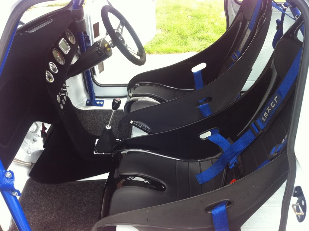

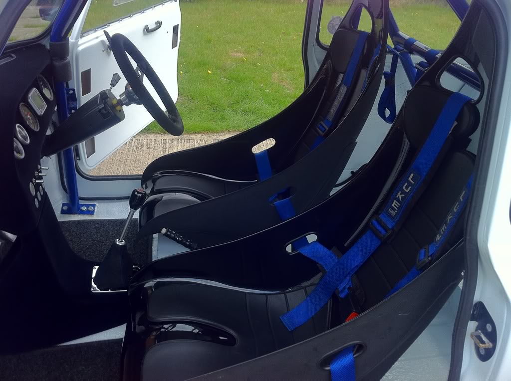

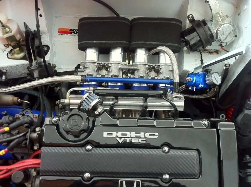

been busy with the mini lately, got my new seats in and fitted and got all the niggly little bits sorted with the new itb's, paul @ rs tuning came to my house to sort my tps out for me as i was stumped (thanks paul)
now its ready for its final map when he's not so busy and the car will be as good as finished at long last :)
  e91 330d/type r mini

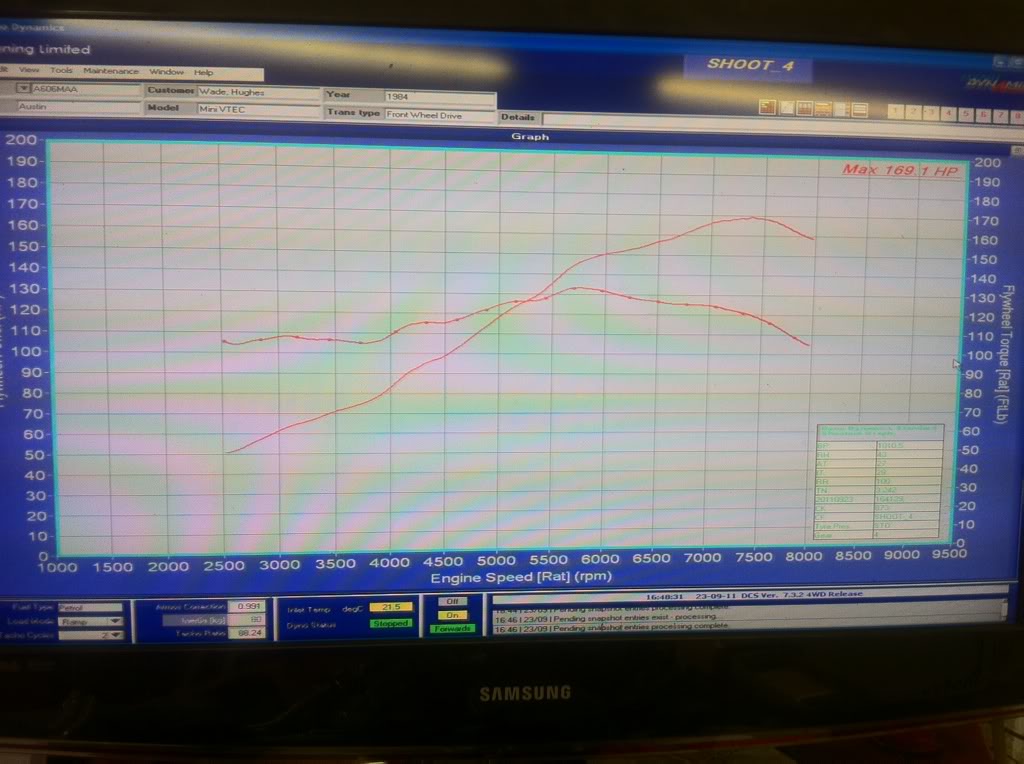

had the mini in at rs tuning for mapping and once again hes done a sterling job and it goes like stink :)
the car made 169bhp and about 135lbs ft of torque.
we took it for a quit blat and it goes well but needs a dam good set up on the tracking and needs its brake bias valve fittiing desprately as its currently 50/50 front to rear lol
THANKS PAUL AND SPECKY
yes true applying to the b16a1, but the b16a2 was around 160
Yes your right it's 160ps which is 158 bhp standard and itb's don't give massive power gains but has helped with low down torque and a sound that cannot be matched with normal inlet :)
For the people who asked the power is at the flywheel
So bodies have added 9?? Or am I misreading? Unless that figure is wheel?
thats asuming it would of made the standard 158bhp beforehand. it also increased torque by nearly 15-20 ft lbs depending on what standard figures you go by.
you never gain big bhp with itb's on these engines but help with much needed torque.
oh and the sound is in a different league and would be worth all the work alone if it didnt gain me any power what so ever :)
Sorry! I'll butt out next time! It does seem though that virtually all the B16's make 10ps more in Japan. Why don't we have 100 octane fuel!? Ah well ignore that i don't want to take this thread off topic.
If your tuning a B16 it's alway good to look at what honda did to the B16B to make it what it is and safe to 8400rpm instead of 8200. Not that the A's seem to mind being over-revved occasionally!!

im not 100% sure but i think they have higher compresion pistons and a better ported head and different cams and retainers.
i will look into changing the cams later on, my rev limit is set at 8500 but has already peaked before then.
