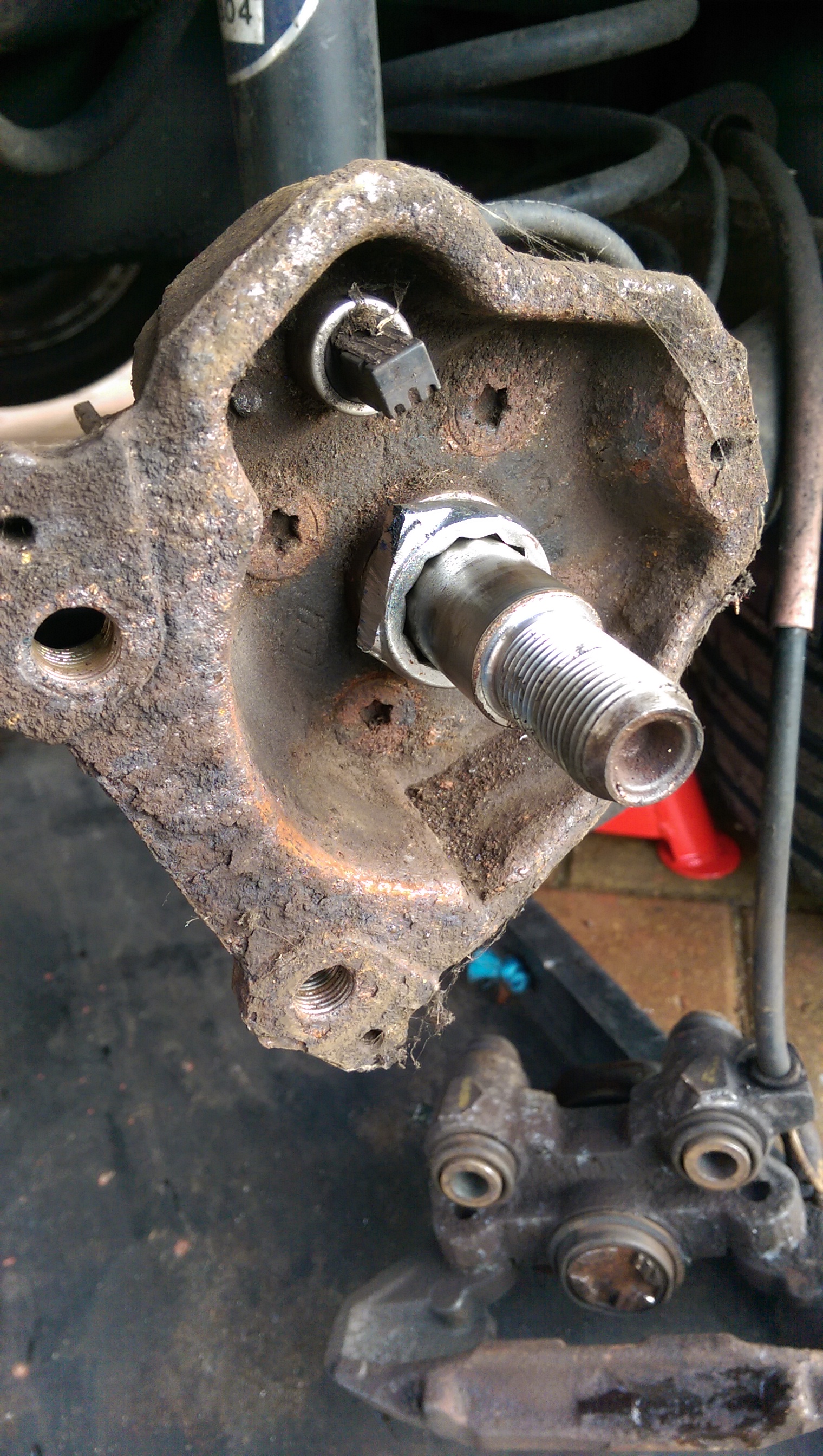

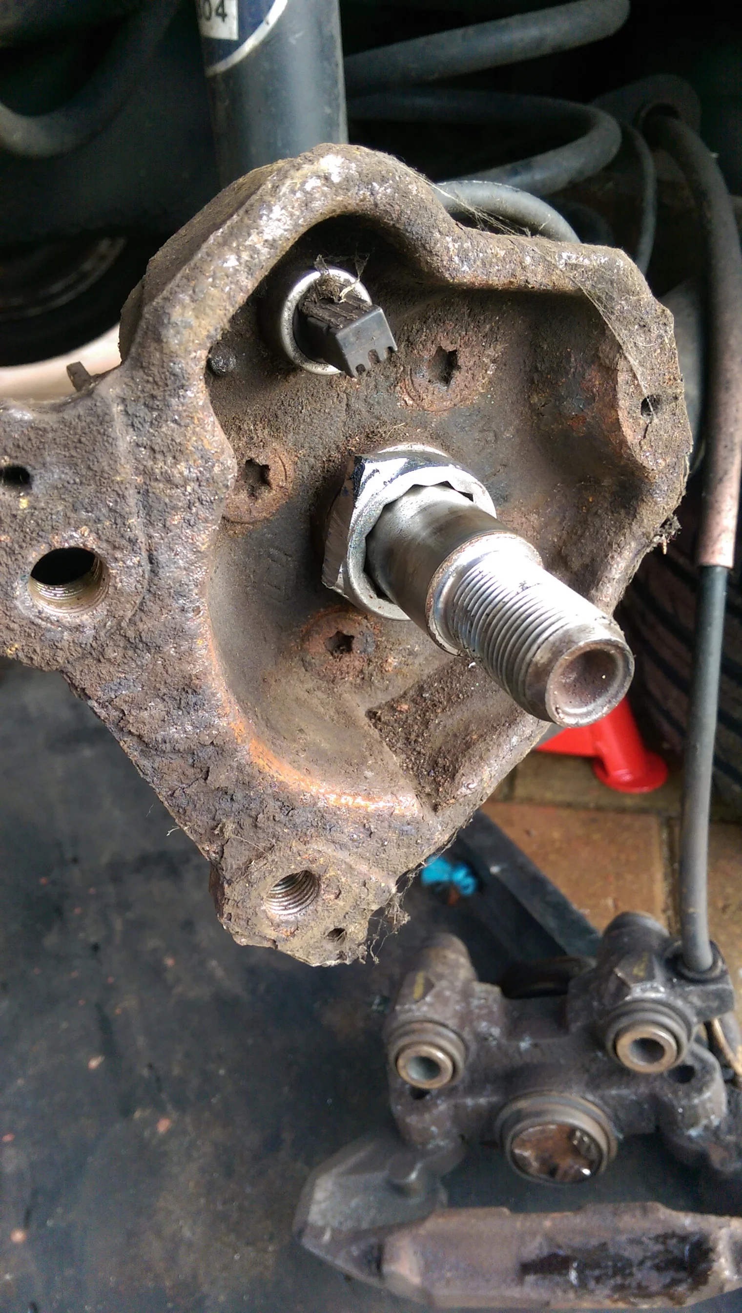

Also, behind the hubs is a small spacer ring (between the stub axle and back of wheel bearing). This disintegrated when I took the old hub off. Putting the new hub in wont turn without it (fouls on various bits). For the meantime I have sawn the end off a 24mm spanner and used that as a spacer with the old hub and bearing in order to be able to put the wheel back on to move the car around (don't worry - I am not driving it until this is all fixed properly).

Just as a final thing for anyone who is interested... my temporary fix to replace the broken wheel spacer so that I could get the hub and wheel back on to move the car around (it was not driven like this)....
