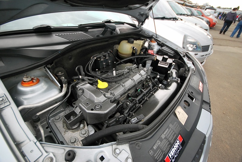

Mine :
Halfords own VHT Black Metallic with VHT petrol resistant Lacquer.
It actually came out Anthracite.

Mine :
I was going to say that's come out a lot more anthracite than black lol
It does look good though, I think I'd prefer that colour along with black crinkle cam covers, I felt the silver would stand out too much from the black, but then my throttle body is freshly sprayed silver haha, although it will now be a fair distance from the rest of the engine I suppose.
