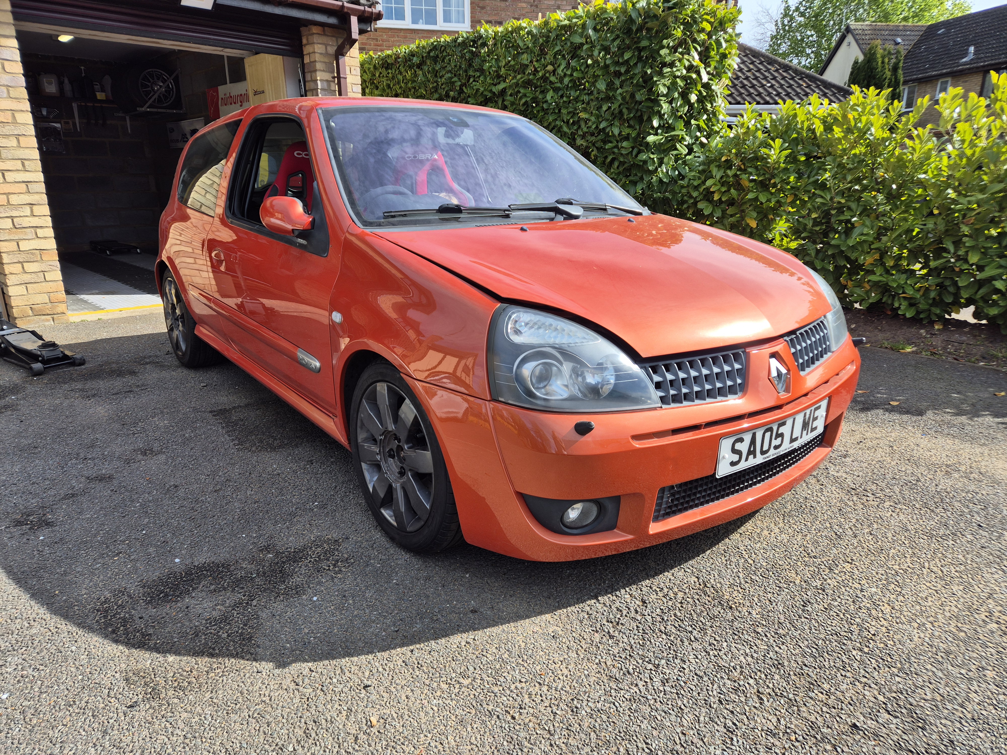

I bought this car back in October 2024 with the intention of turning it into a weekend toy / road legal track car... It was in a pretty sorry state when I picked it up with a huge list of requirements but I have wanted an inferno orange 182 since I was about 15 years old so I made the purchase. It is fairly low mileage with 84k on the clock.
Here is the day I bought it and got it back home and in the garage where it has remained since apart from getting it out for fixes / modifications.

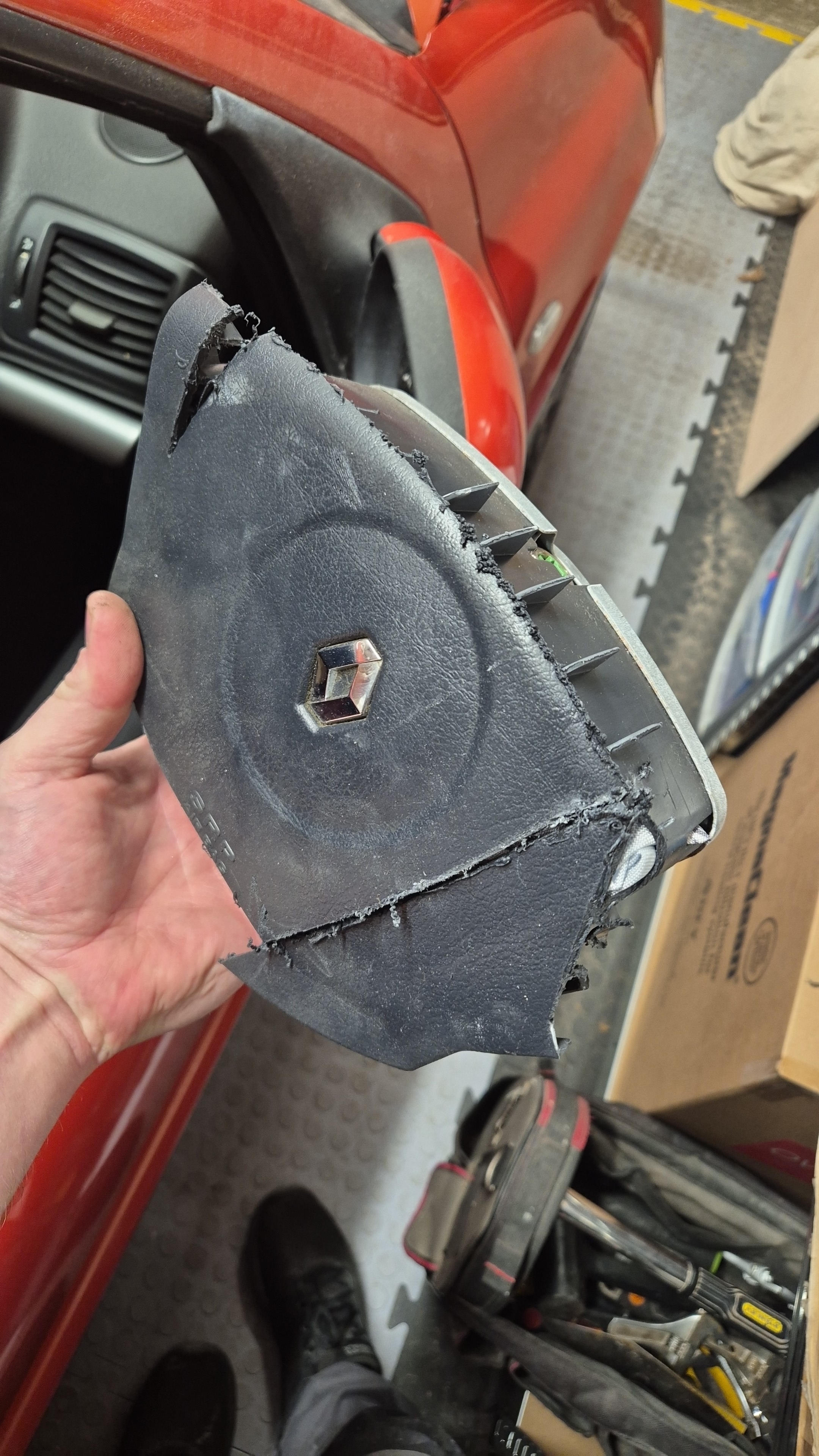

I had a bloody good battle with getting the stock steering wheel off. I simply couldn't get the airbag off so ended up taking my multitool to it. Yes I was careful and stood in a position of safety incase it went off!

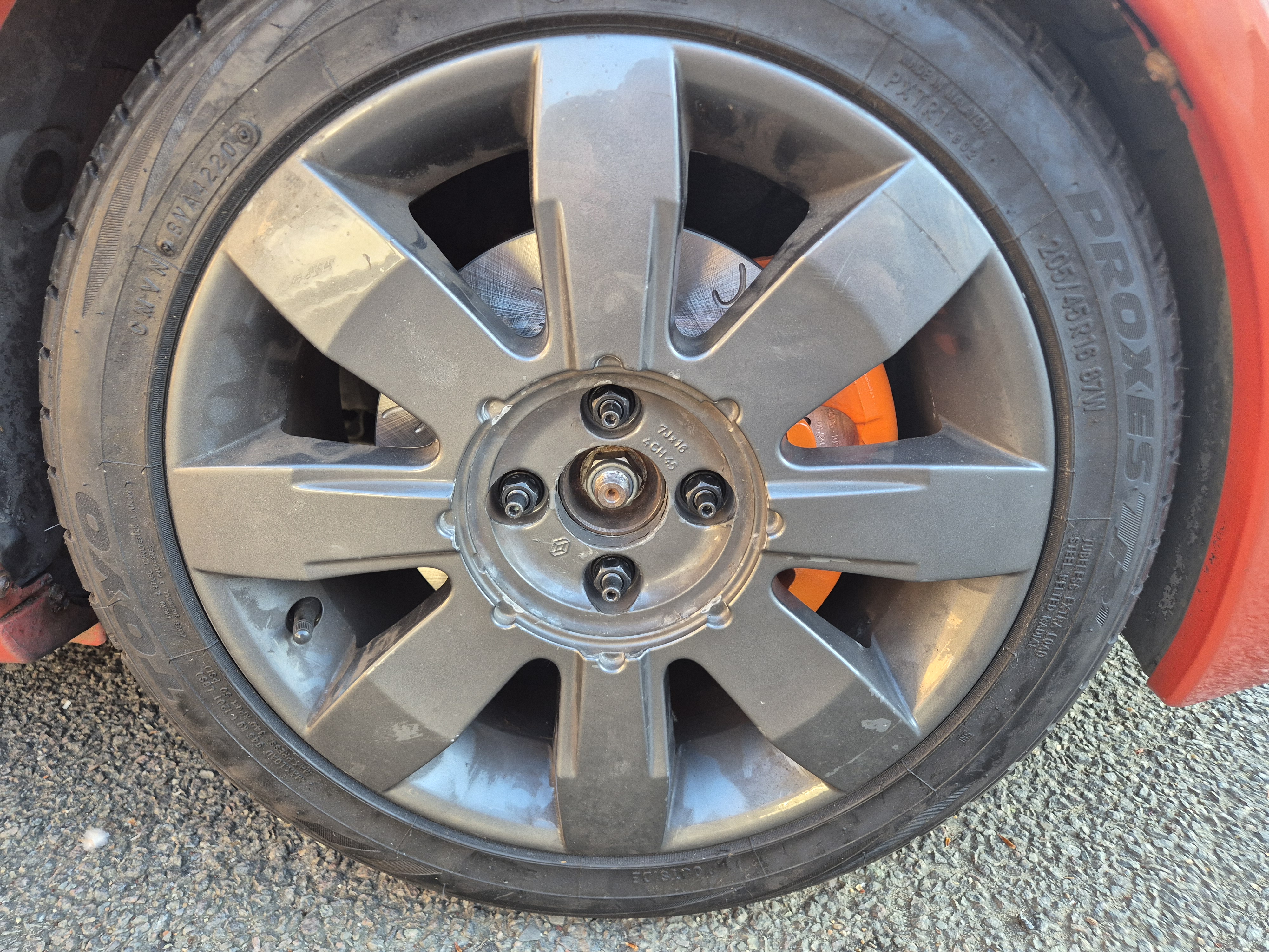

Your coilovers look a bit too low. I’d raise them to let the dampers rebound properly and absorb bumps, so you’re not bouncing around the circuit. You can also cause uneven tyre wear as the car skips across the surface. It may not look as cool, but you’ll get better grip, handling, and avoid damaging the suspension or tyres.
  182 Inferno Orange
Yeah I have just realised that photo is actually before I raised it up. This is a photo as of yesterday, raised the rears onto the highest spacer and the fronts were raised by about 30mm

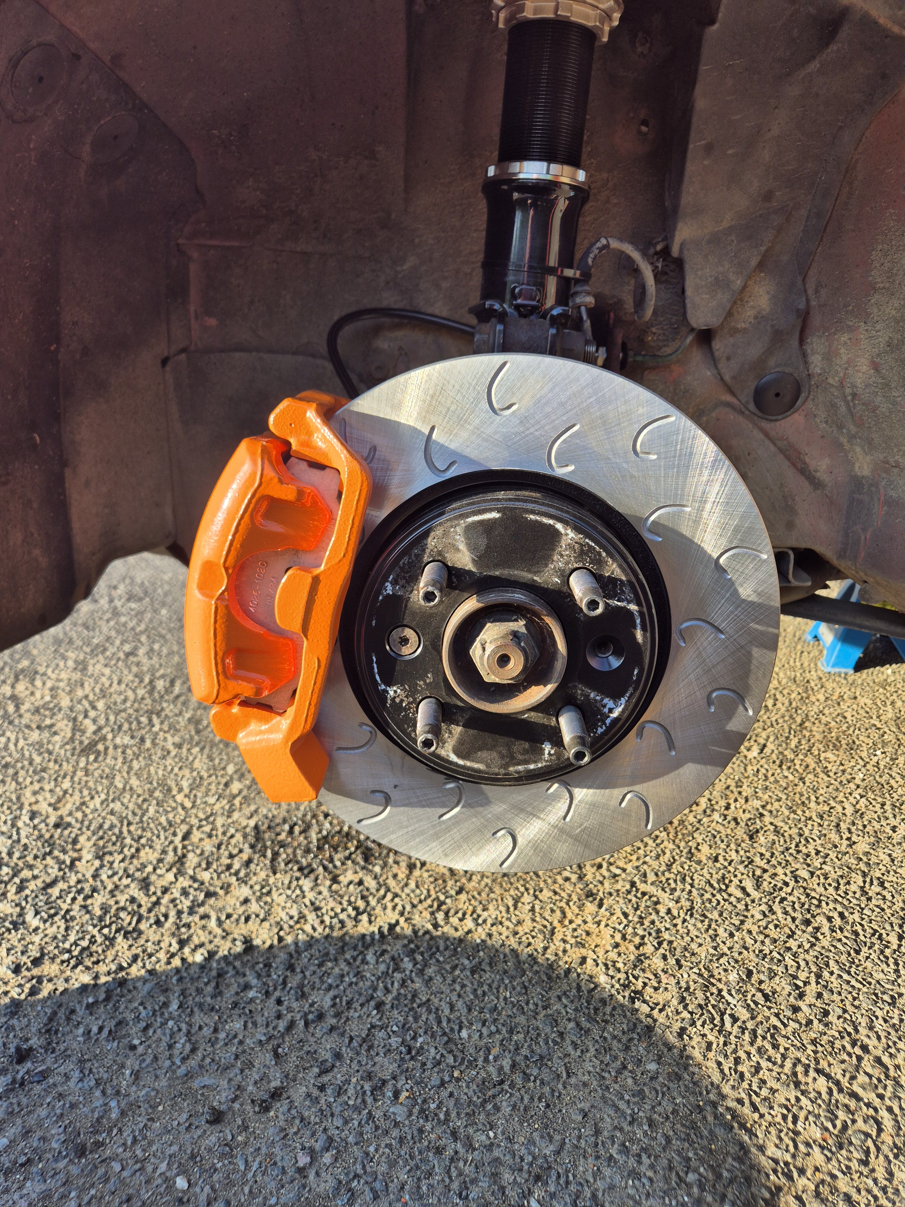

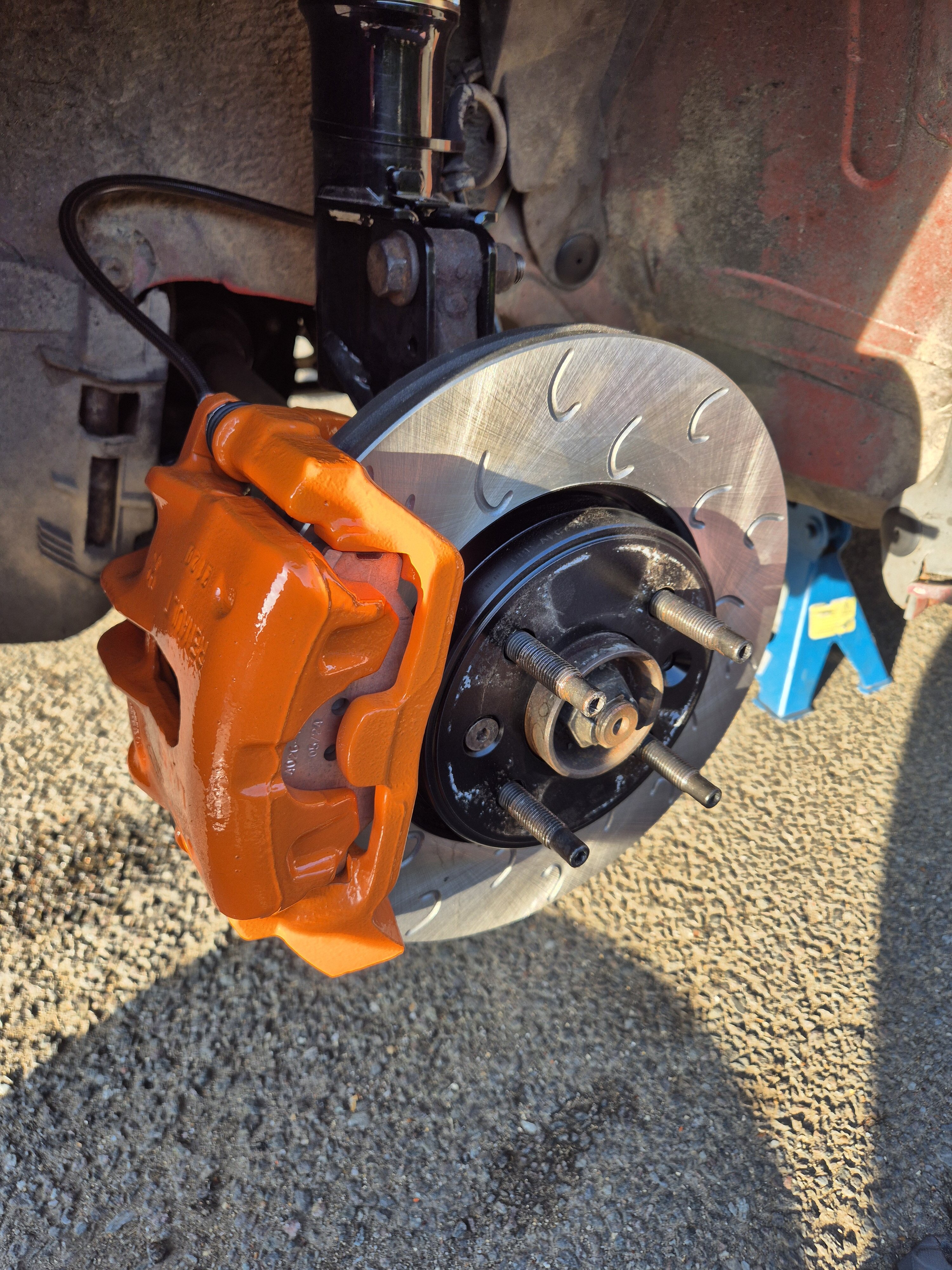

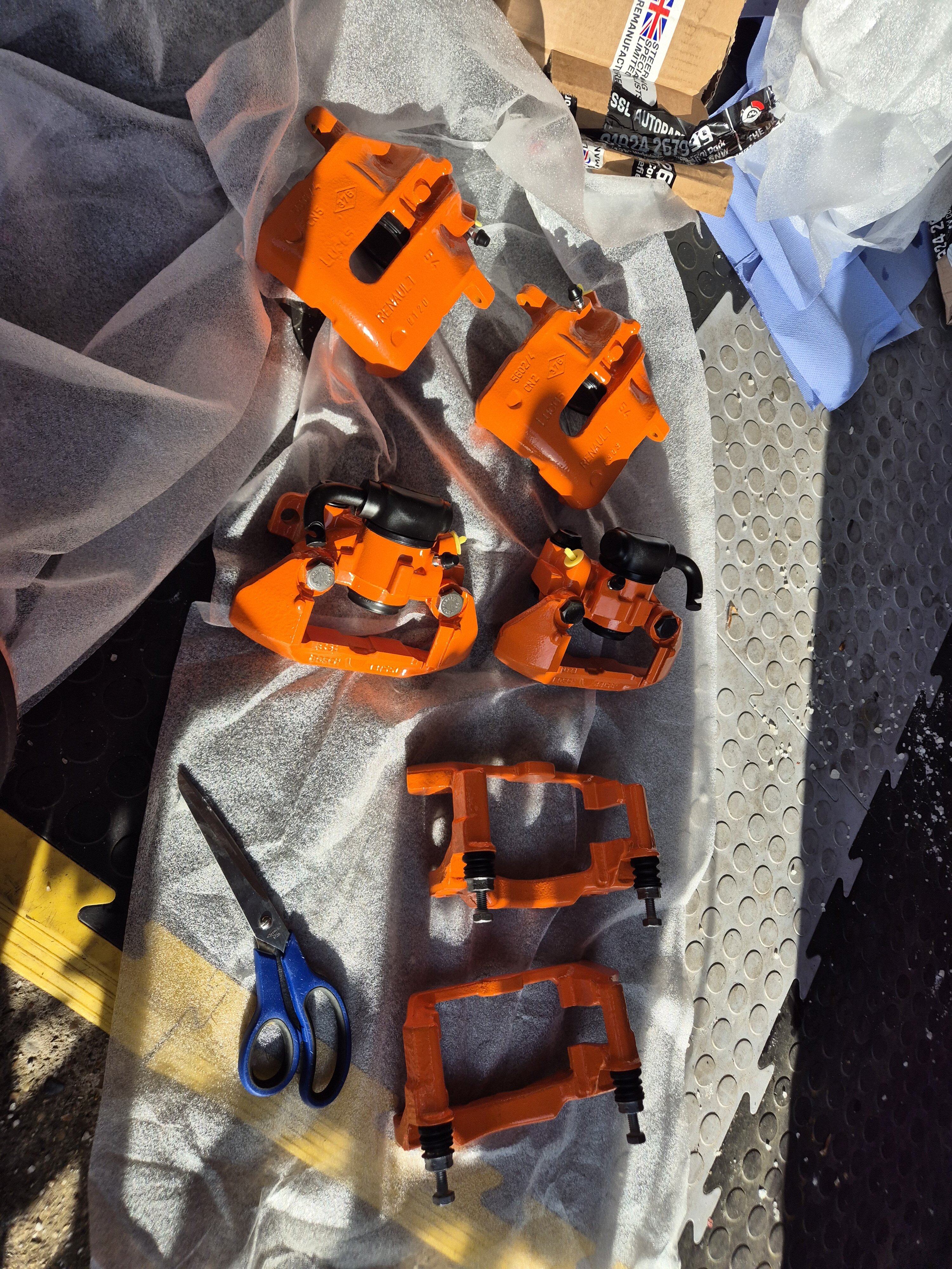

Another small update and what should have been significant! The brake calipers arrived back yesterday afternoon from SSL. Cracked straight on and had them all fitted inside 2 hours.

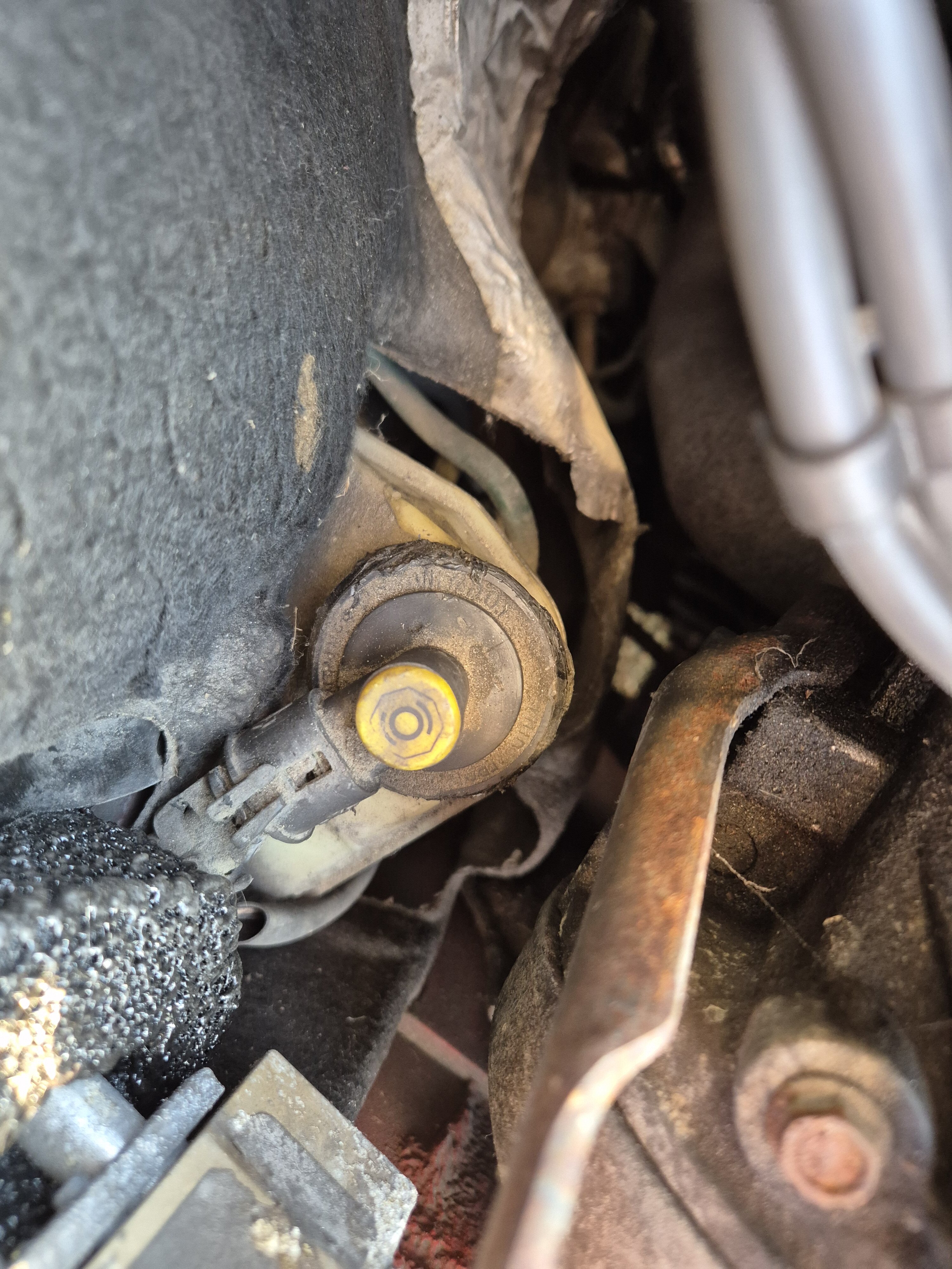

However there was an issue when I went to attach my pressure pump to do a fluid flush/bleed. Yes the cap was/is melted on! Absolutely gutted. Now going to have to try and source a new cap and then somehow get the old one off. I tried all kinds of different grips/pliers with no luck so almost definitely going to need cutting off slowly and carefully.
Nice one Renault. s**t design and a even shitter place to have the brake fluid reservoir!
