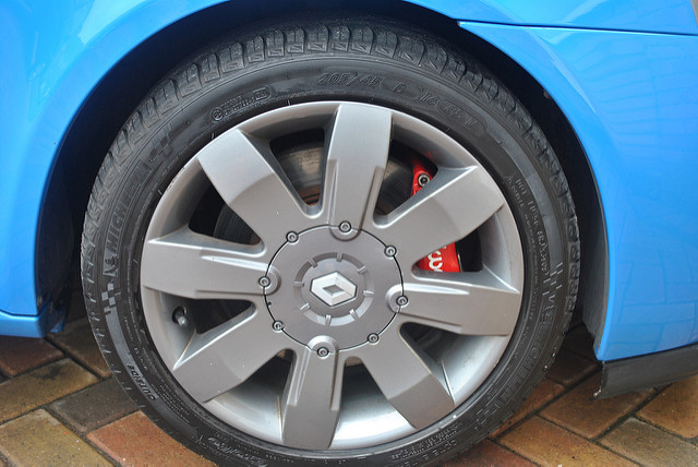

Not really an updated but a review of the 4pots. And pics from today

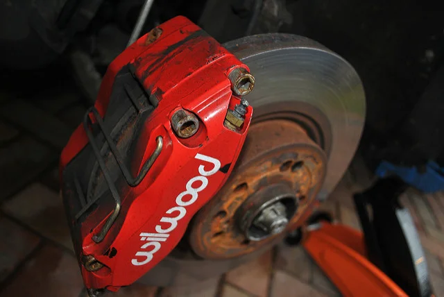

Well the brakes are truly amazing, If im totally honest i didn't expect to see a massive dereference over the setup i already had (Brembo max discs, Ferodo DS2500 pads and Ktec lines) but there is and the dereference is HUGE. Just normal driving around town you can notice it you literally have to just rest your foot on the pedal and u quickly come to a halt. Using them properly on a fast B-road is were the dereference becomes apparent, From the very instant you touch the pedal it starts to slow down rapidly, if you put your foot down harder after that you Stop. On cold mornings the brakes are a bit shy but after a few miles the heat has got in to them there amazing. Honestly one of the best things iv ever bought for the car. Again thanks to matt and mark at JAM-Sport for sorting everything.

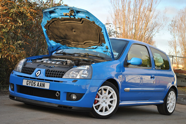

Little update but mainly a chance for some w*****g. Got a tow eye again, also waiting for the carbon gear insert and the interior will be complete apart from the seats.

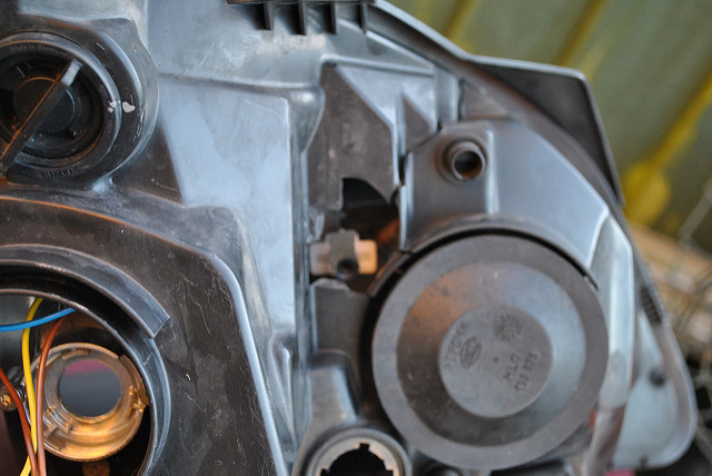

Yet another weekend fixing something on the car :mad: This time the Passenger headlight just decided it was going to break ! Don't have a clue how its happened but what ever holds the inside of the headlight together gave up and broke, resulting in getting a replacement from Tim (atouba), cheers mate. Anyway whipped the bumper off today and replaced it only to find one of the bulbs also had blown aswell.
This is the hole on the back,where one of the fixing points for inside the headlight was. You can see its cracked the plastic up toward the top.

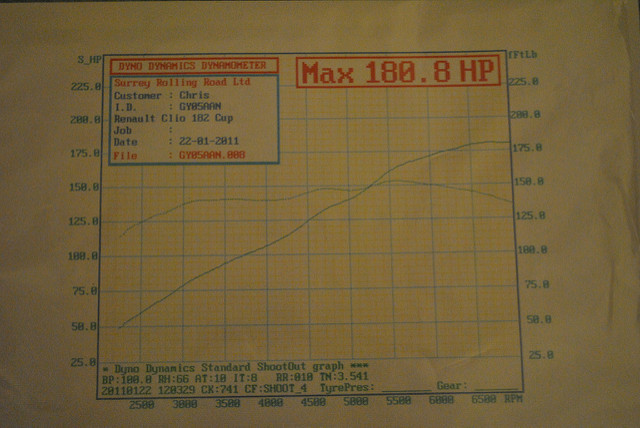

Looking forward to Surrey Rolling Road at the end of the month. It will be good to see how much BHP its putting out, the last time it was on some rollers it made 195.6 at Regal. Bit optimistic if you ask me, seeing as its only had a k-tec exhaust. Not too fused with what it makes TBH but will be nice to see what the guys at SRR make of it.

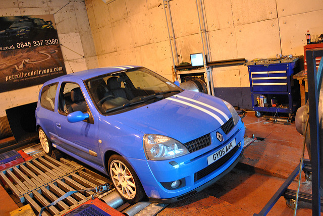

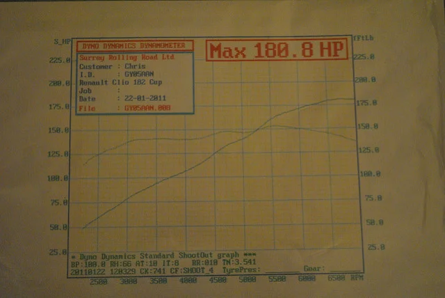

Had a great day at Surrey Rolling Road. Made 180.8bhp and 150.9lbft, chuffed with the results. More accurate than the 195bhp I got at Regal a couple of years ago. TBH don't really plan on doing anything to the engine, unless I come into a fair bit of money and then will get throttle bodies. But that's a long way off yet.
  BMW Z4
Re: destined for the track
What is that 180 giving you at the wheels out of interest? Did you get that figure?

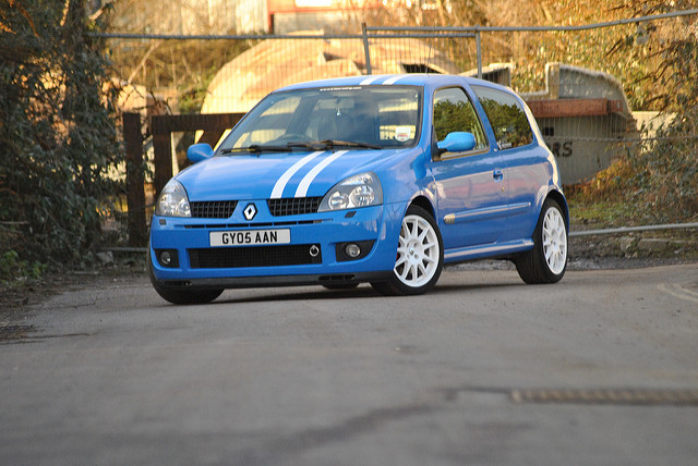

Have decided id had enough of cleaning the turinis now, so got a Michelin pilot sport from camskill at a good price and then fitted yesterday for a pint of beer. Put the original cup alloys back on today after a good clean and sold the turinis. Think they will stay on for the foreseeable future until i get hold of some 2118's. The draw of cheep tyres is too much.

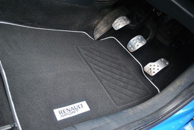

Also got some RS matts from the group buy. Now all i need is for someone to sell me his seats ;) and the interior is complete.

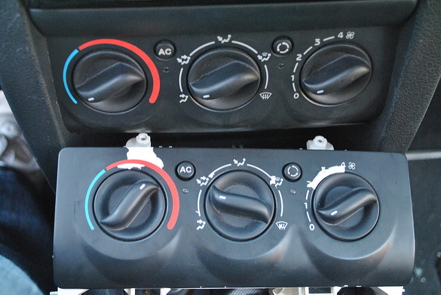

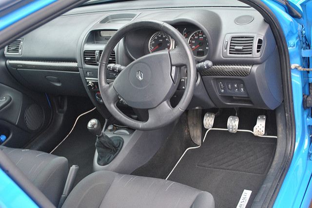

With Castle Combe 'performance action day' round the corner i have wanted to tidy up the interior of the car and get it to a stage of where i actually like the innards of the cup. With its campus-esq seats and the campus steering wheel, these are the only things left to change. The seats are coming from Fletch's bus as soon as there out and the wheel comes in the form of an OMP targa. I was in the group buy for a sabelt item but have decided against it. With the new mats and carbon dash strips everything is coming along nicely. The only thing else i wanted to do was change the heater control panel as the old one was flaking and looking tatty. Got one from flebay and changed it over today :mad: Honestly the hardest thing i have ever done to this car, If anyone still believes clios are badly put together give taking this out a try ! Pretty much took 30mins to even get out !
Old V New
Oh and i might change the splitter, just so i can call the car 'finished' (to my standards)

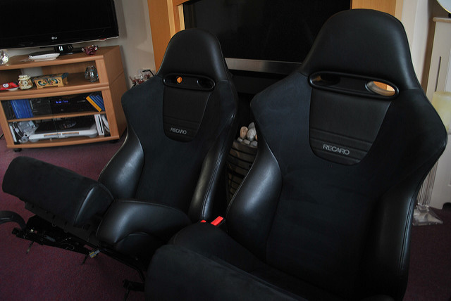

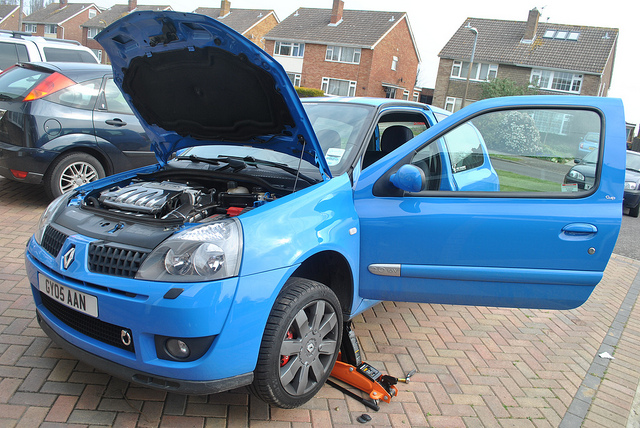

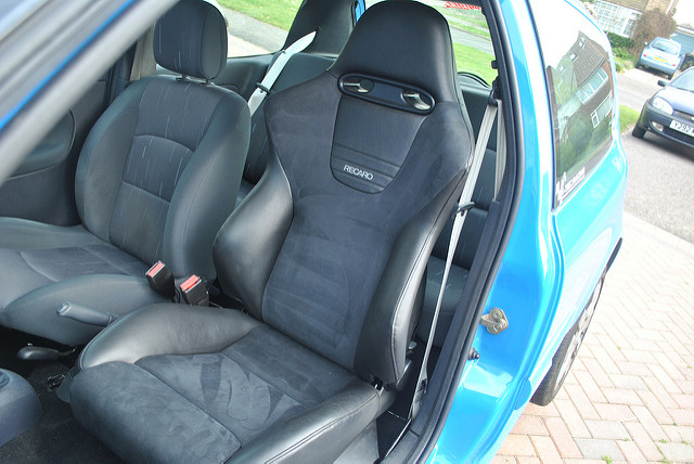

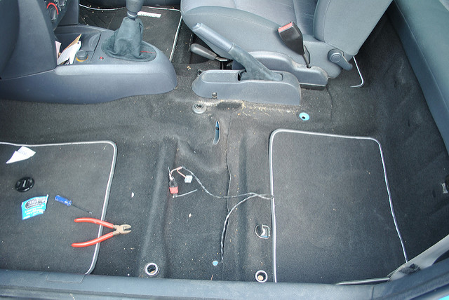

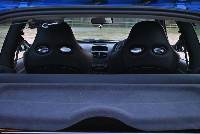

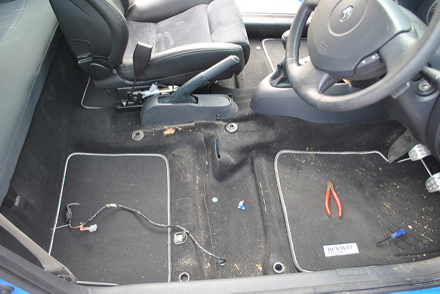

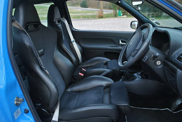

Well next week was too long to wait. Pretty easy when you know what's involved, was quite hesitant at first because of the trouble Team Anorak Racing had the first time round with Fletch's bus. But after a long good look at what was involved its quite simple. Unbolt-unplug-take out, put in seat-plug in-bolt in.
Started off with jacking the car up as far as i could, there's also an axle stand under there.

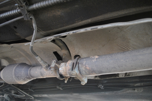

So glad i have a straight through pipe here, accessing the gearbox side nuts is so much easer !

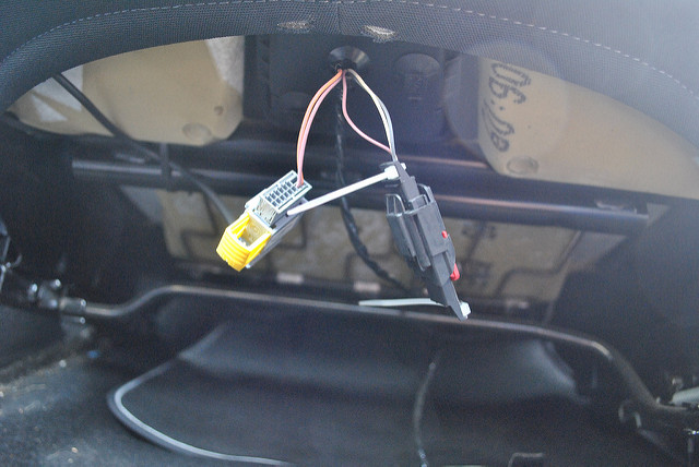

The two plugs under the seat. From what i have read and understand the left is for the pre-tensioners and seatbelts. The right is the air bag, notice as its a cup the air bag has noting connected so no need for resistors :)
Passenger seat out
Passenger seat Recaro in
Lunch time :)
Drivers side out, also found £1.20 :D

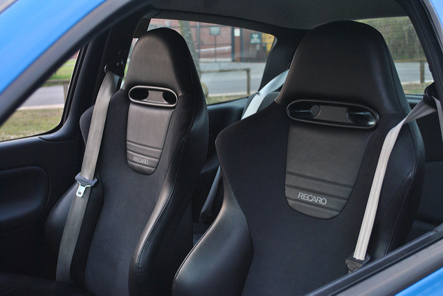

Both Recaros in and cleaned then up Goodwood for some pictures
MOT is due Tuesday, so gotta sort out a few things tomorrow. Then hopefully the wheel will be here and fit that next weekend. Splitter will have to wait till next month tho :(
