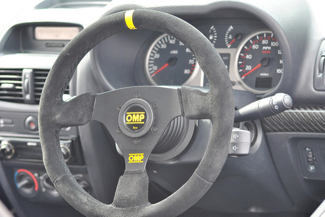

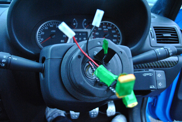

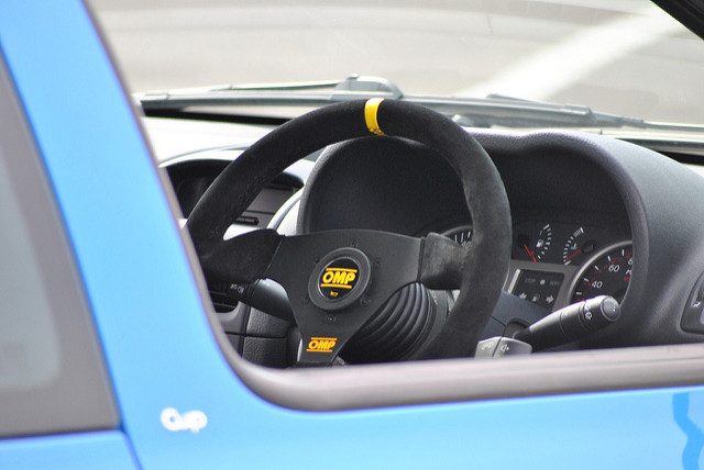

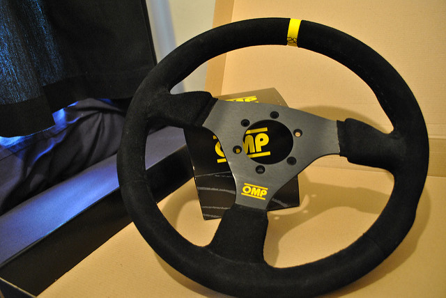

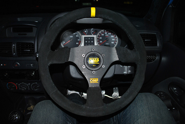

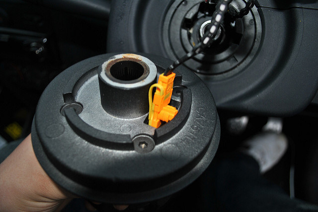

New OMP targa wheels fitted, interior is now complete :) Cars finaly back from JKM in pompey for its MOT, had no advisories but failed on the very leaky rear shocks. The wheel is awesome, had a little problem fitting it. The hole on the hub for the leads is no where big enough for them to come through with the plugs on the end, so had to take the two airbag plugs apart and also take the cruise control lead off all together. Put them all back together and fitted the resistors, wired the horn in and put it all together. Must have messed up somewhere because the Serv light and airbag have lit up, so will get whoever does the 48k service to have a good look at it all. Only been out in it very quickly but it feels brilliant :)
Out of the box
As you can see the don't fit through
All through and taped up
And finally all together

Looks good mate! Does the horn work on these OMP's or do you need a ph1 indicator stork?
Yea horn work but its a bit of a bodge TBH. Had to use some battery connectors from an old alarm panel iv got kicking around and then soldered the ends in the existing horn plug! but it works so im not to bothered.

Do your indicators still self cancel? Mine don't with that boss, and seems to be pot luck with most
  Saab 93 Aero Wagon
Re: destined for the track
Have your wires behind the steering wheel caught fire yet?
If not, make sure you have a can of Pepsi ready for when they do ...
Or just do what i did and yank the horn button out of the steering wheel with wires still attached until the smoke stops.
Probably one of the biggest "oh fack!!!" moments I've had in my car.

Depends what corner i take i think, the small quarter wheel turns it doesn't but the big turn of the wheel it does !

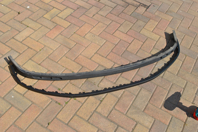

Splitter update time.

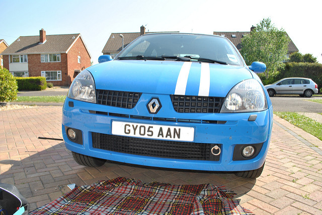

Ordered the Skoda Fabia VRS splitter on Wednesday and it arrived yesterday. Whipped the Laguna one off and drilled the new one on in record time :) Its gone to a new home on my mates 206 GTI 180.
Old V New

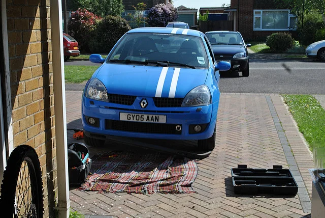

Hanging off the car

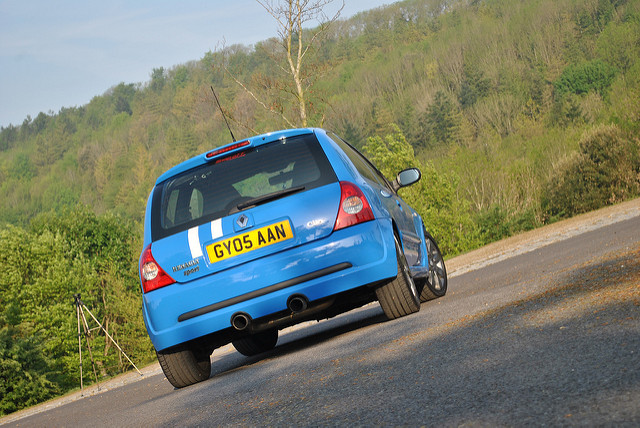

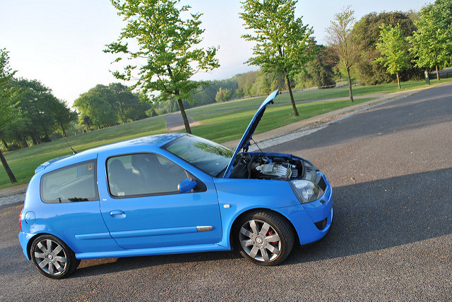

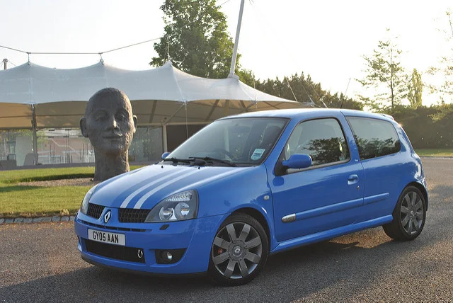

Then gave it a wash last night and up to Goodwood racecourse for some pictures, with a massive head ! Also removed all the RS stickers on the skirts and the k-tec ones and also the Elf sticker on the rear window. Will be replacing it with the newish one.
Well one sticker had to stay, sort of sums this car up TBH
Just got to take it back to the garage on Tuesday to see about these magical cup springs and then i can officially say this car is FINISHED !
If the springs turn out to be rhubarb im going to get the eibach lowering springs and fit them, Iv never really wanted coilovers so the lowering springs seem the way forward. There's nothing else i want to do to the car now apart from maybe replacing the stripes. So after the springs are sorted there is NO excuse any more for me not to take it on track. So il be looking at doing my first around July-august time so if anyone is doing any around this time please do tell.
