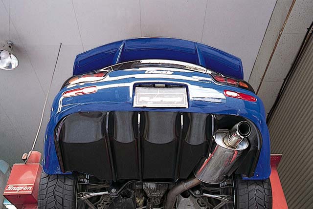

i sold my re amemiya carbon pro spec rear diffuser and now have a re amemiya street spec diffuser
same as this

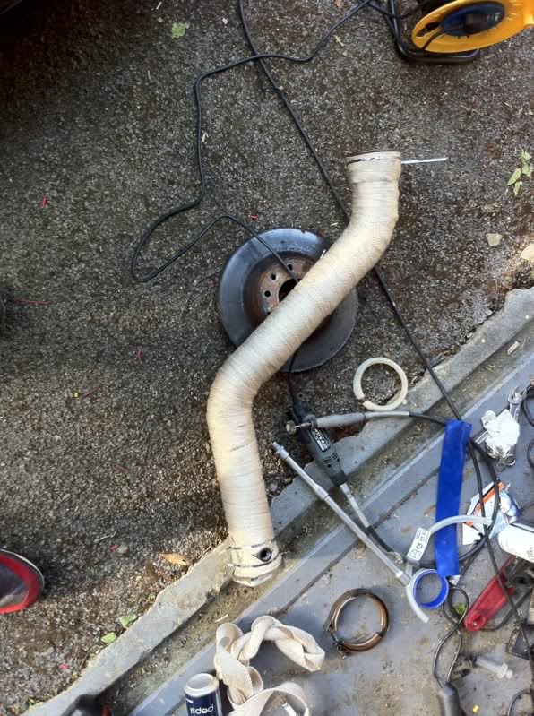

other side went fine though.... then just got to remove the front disks and finish wiring in the rear fog light, gonna remove my downpipe and get the wideband boss welded on then wrap it before i stick it back on :) also need somewhere to mount the gauge lol!
downpipe just had the lamda boss welded in, i wrapped it and now itch all over! just going to refit and check all is good...

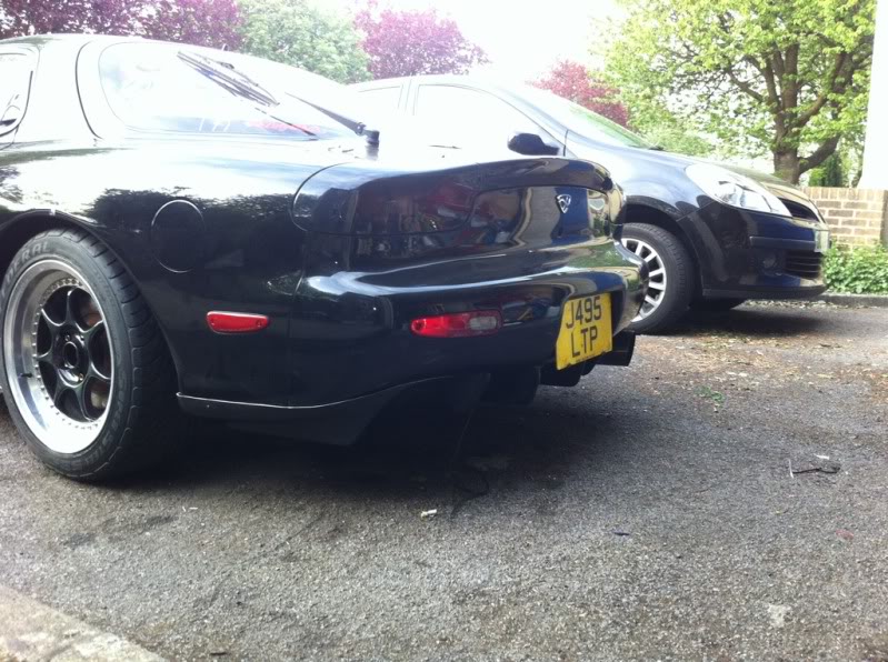

diffuser fitted... got a bit of tweaking to do then its coming off to be painted satin black...
cos im childish lol!
