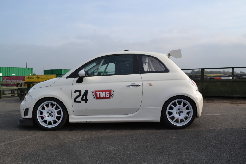

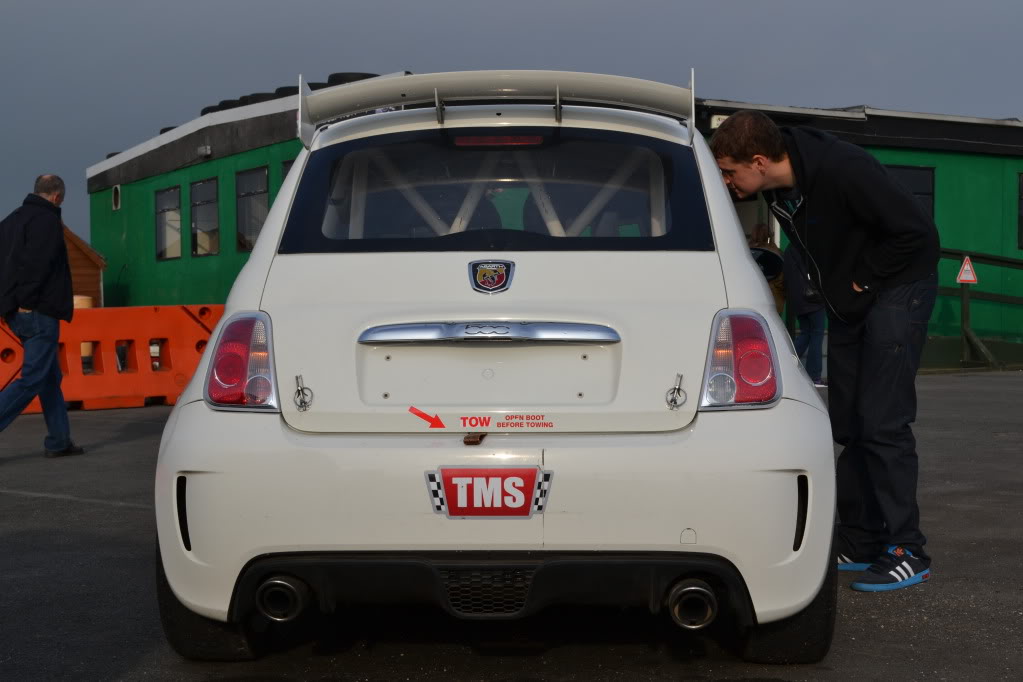

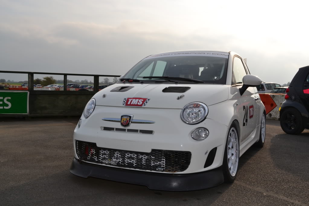

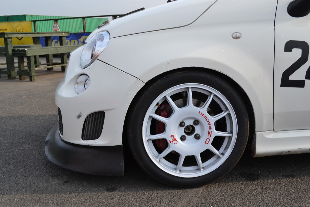

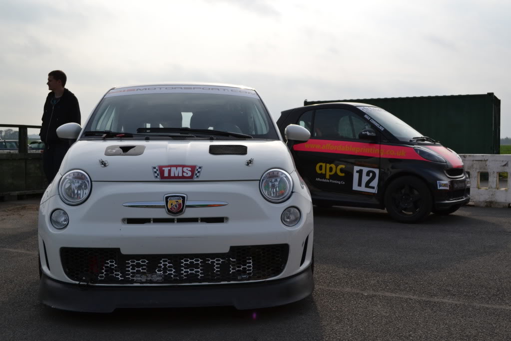

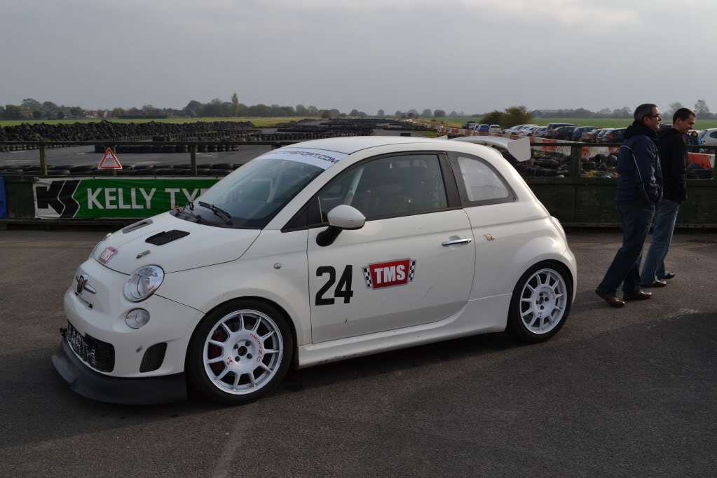

Spotted this today. You need these wheels, splitter and stance!
  MINI-R32-integrale
That's a Trofeo race car & the front splitter provided massive downforce at the front. I have heard there is one that's been made road legal here in the UK. Must be a very fast road car as it weighs about 950kgs with fluids and putting out 215-220bhp & 240-250lb ft. The road cars all tip scales over 1100kgs not the 1030kgs listed, but then no road car does weigh what's quoted.
You need to open the boot releases before towing as it would bend the tailgate as it attaches to where the original boot lock mechanism would be, hence the sticker to notify the marshals if car beached in gravel etc as there is nowhere underneath to attach a tow strap to.
The OZ wheels actually have the Abarth scorpion cast on the rim and painted, it's not just a decal & supplied with big stickers inside marked not for road use & are very light weight, though you can now buy those style of wheels from OZ which are made for road use.
