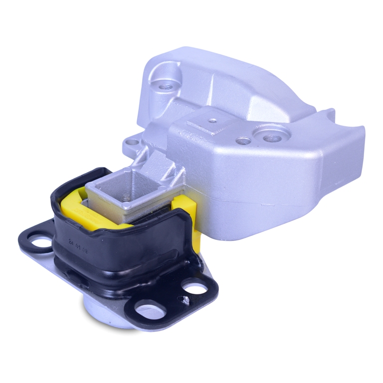

New FRONT UPPER RIGHT ENGINE MOUNT INSERT powerflex 172/182
  Clio 172 2002
black is extremely hard, yellow is the least hard.
go black if it's a track car, I wouldn't even entertain the idea of having black mounts (which are advertised as "race") in a street car.
  182
Great bit of kit and works very well.
Pointless fitting it on a 10+year old mount though.
But fits with the bolk mount off ebay well the one @Darius mentioned

I'd imagine this works quite well but I've been shimming my mounts out with rubber gasket for years, costs next to nothing and no noticeable difference in vibrations or over stiffness. Makes a nice difference on a tired old mount. My personal preference is poly dog bone, shimmed new standard upper mount, vibra technics gearbox mount. Nice compromise for road and track, very little vibrations but nice keeps that engine from banging off the bulkhead.

Got mine fitted too......and, well......I don't know if I did it wrong, but Christ the night.....my car is like a dildo now......lol.
Srs vibrations. I expected a bit but holy god :|
Everyone else like that?
On another note......when removing one of the 3 engine mount bolts (the top ones) one of them was just spinning :(
This courtesy of the dealership that did the timing belt nearly 5 years ago now so I have absolutely no come back. In the pics above, its the lower left bolt. I managed to get it out slowly with a flat spanner underneath and it is nipped hand tight with a small spanner, but I guess my question is....what are my options?

Yeah so I fitted this today. Just can't feel f**king any difference whatsoever basically haha! Don't get these vibrations or anything lol. Already does vibrate a bit with the polybushed dogbone so I suppose could be that!
