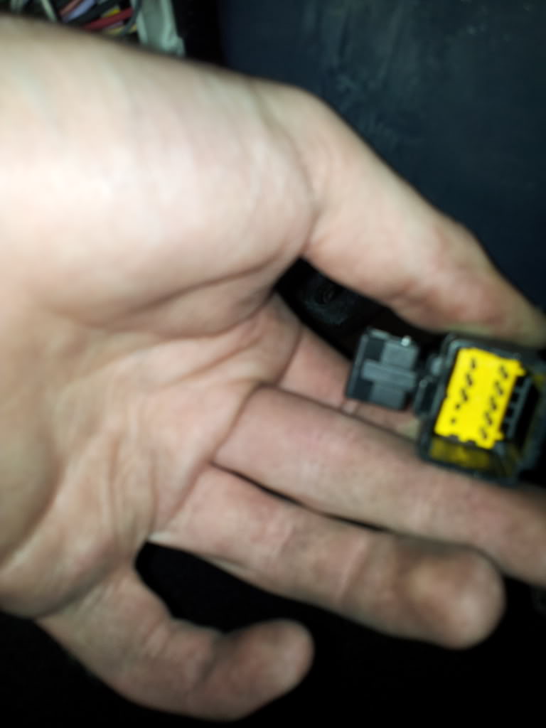

I also found this plug under the glovebox.
Is it related? Any ideas anyone?
Cheers!
that hangs down under my glove box too. had the car for 4 years and never needed it lol. no idea what its for
