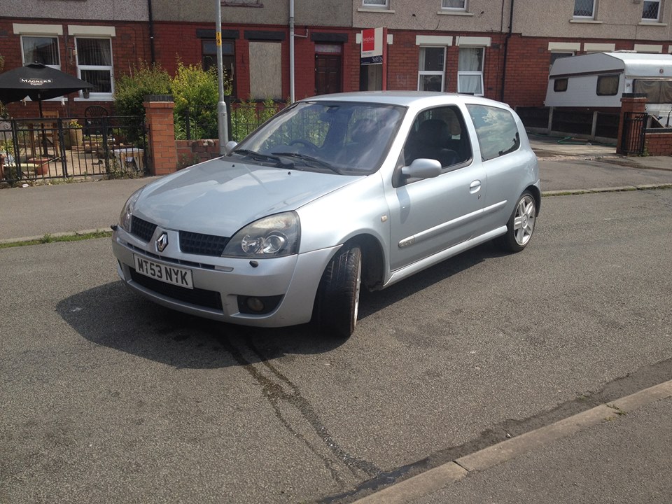

I am new to the Clio 172 Sport.
Ive Just picked mine up (On the back of a trailer) Its a 53 plate with 115k on the clock with the Dephaser-pulley on its way out.
Ive been trolling throught the net but need some kind of guide how to fit a new one. Do i need a cam and crank locking tool?
I have changed cambelts and water pumpers on other cars by locking the cams with drill bits, Or Mole grips on the camshaft.
Or unless someone is in my area (St Helens) which can give me a hand and can pay them to show me.
Its going to be a ongoing project as it needs other little bits doing like the drivers seat won't fold, the heater blower does not work ect.
